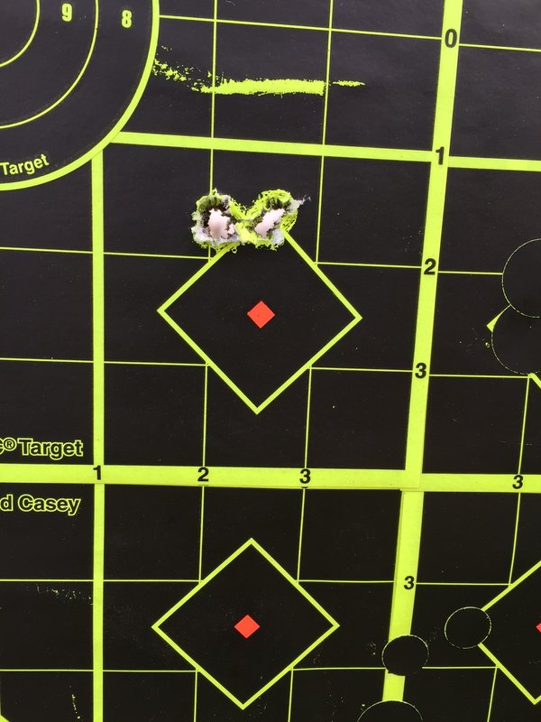

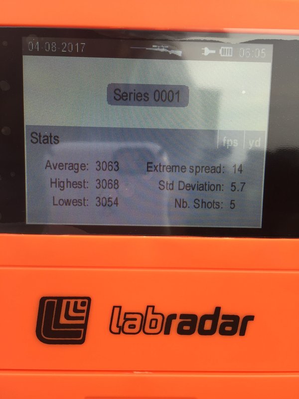

GAP recently finished up my 300NM hunting build. This cartridge is freakishly accurate. This is a 5-shot group at 102y I shot this afternoon during load work up. 88gr of N570 under a 215. The wind was howling today - 25-30mph - so a little bit of horizontal. Time to stretch her legs!
Those are some pretty good ES and SD numbers. How clean is the N570 for you? I saw someone else said it was dirty. How long is your barrel and I assume you are using 230 gr Bergers?

Here's my 300 Norma MHSA just put together for me.
Bartlein 1:10, 28"
Defiance deviant
Kmw sentinel
Premier 5-25
This group was during load development on Sunday.
84.5 gr h1000
Berger 230 hybrid
​​​​​​. 025 off lands
3030 Avg fps (the five shot string from the picture)

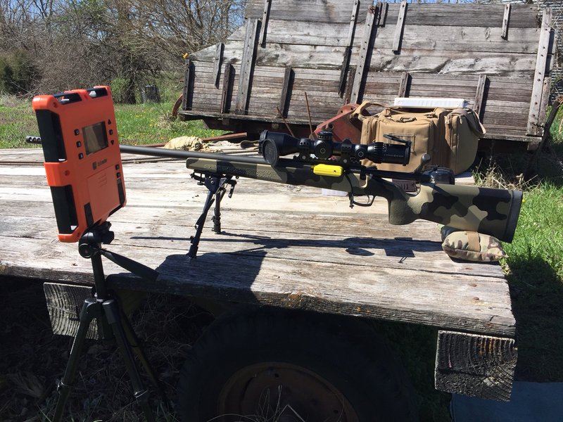

Well, i kept reading about the optimum twist. I got 2 nm both are 35* improved one is 30" shooting 3015fps with 230s barrel aint cheap so i dont do HYREV on load. If theres high and low node for every barrel i much prefer low node. Anyway this barrel is Broughton 1.9twist 5c ive shot her to a mile no prob. My other nm is 26" proof carbon and its a lighter version use for 75% hunting target here n there pus 215hybrida and 212 edl-x only becoz its what my other reamer intended for.. 8.4twist..i pre ordered another barrel as a spare after reading about the twist here.. I decided to do Broughton 5c 9.5" twist. Now i can go on and dnt need to wrry if i should keep reading the debate between 10 and 9*twist :)
I took my 300 NM out to 1931 yards today for a test run. Its performance far exceeded my expectations! Unbelievably accurate at that range. I was able to achieve consistent impact strings with only wind effecting the hits (conditions were a little erratic 8-20+ mph) . Next outing I plan on going to 2500!

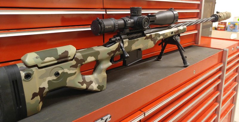

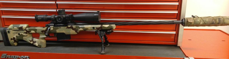

McM A3 non-adjustable stock, GAP camo
Templar V2 long action, lefty (cause left hand is the right hand!)
Bartlien sendero contour 1-10" twist finished at 27" w/ Badger thruster MB
Badger M5 DBM - CIP length
Finished in GAP OD green
S&B 3-20 Ultra Short w/ H2CMR sitting in NF 6-screw rings
Rifle and scope: 12lbs

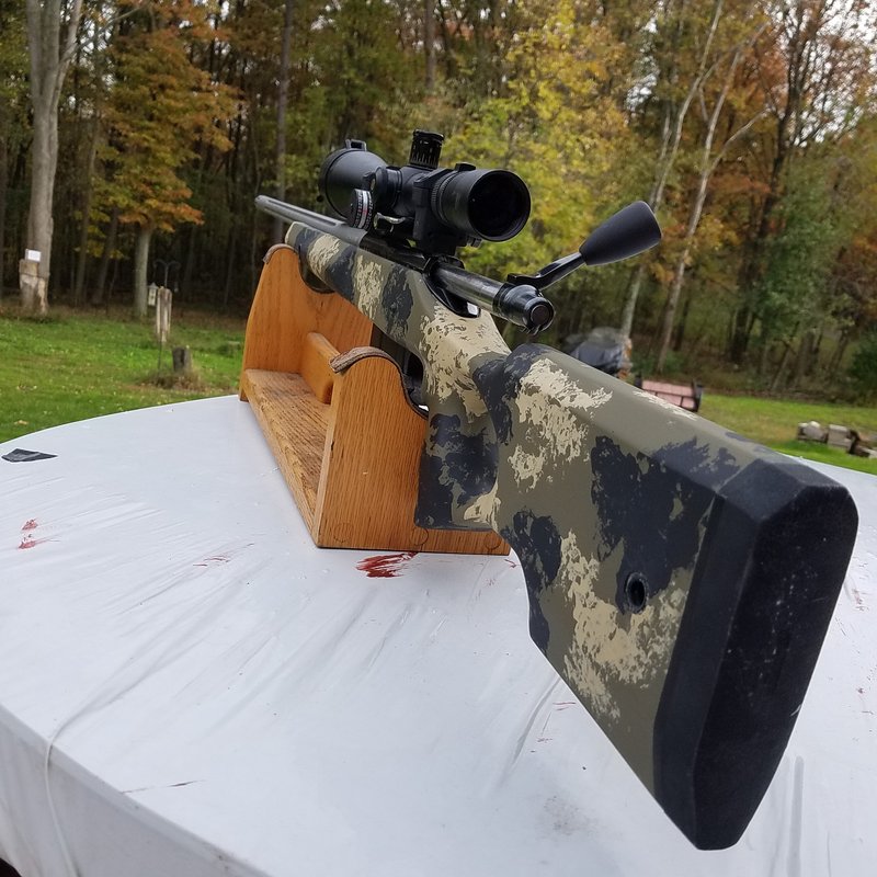

I'm slow on posting a pic as I had to send the barreled action to Manners for its fitting in the mini chassis. Kind of like sending your wife off for her wedding gown lol !
First two shots of the day was at 1250y. Can’t complain too much about that. Pushed out every 100y from there out to 1950, but mirage washed out the trace at about 1400y. Time to invest in a target camera.
Defiance action
Bix n Andy TacSport trigger
26” Proof research CF barrel
Fat bastard brake
Manners T4
Leupold MK8
230gr BHT
86gr retumbo
.02” jump
2954fps
