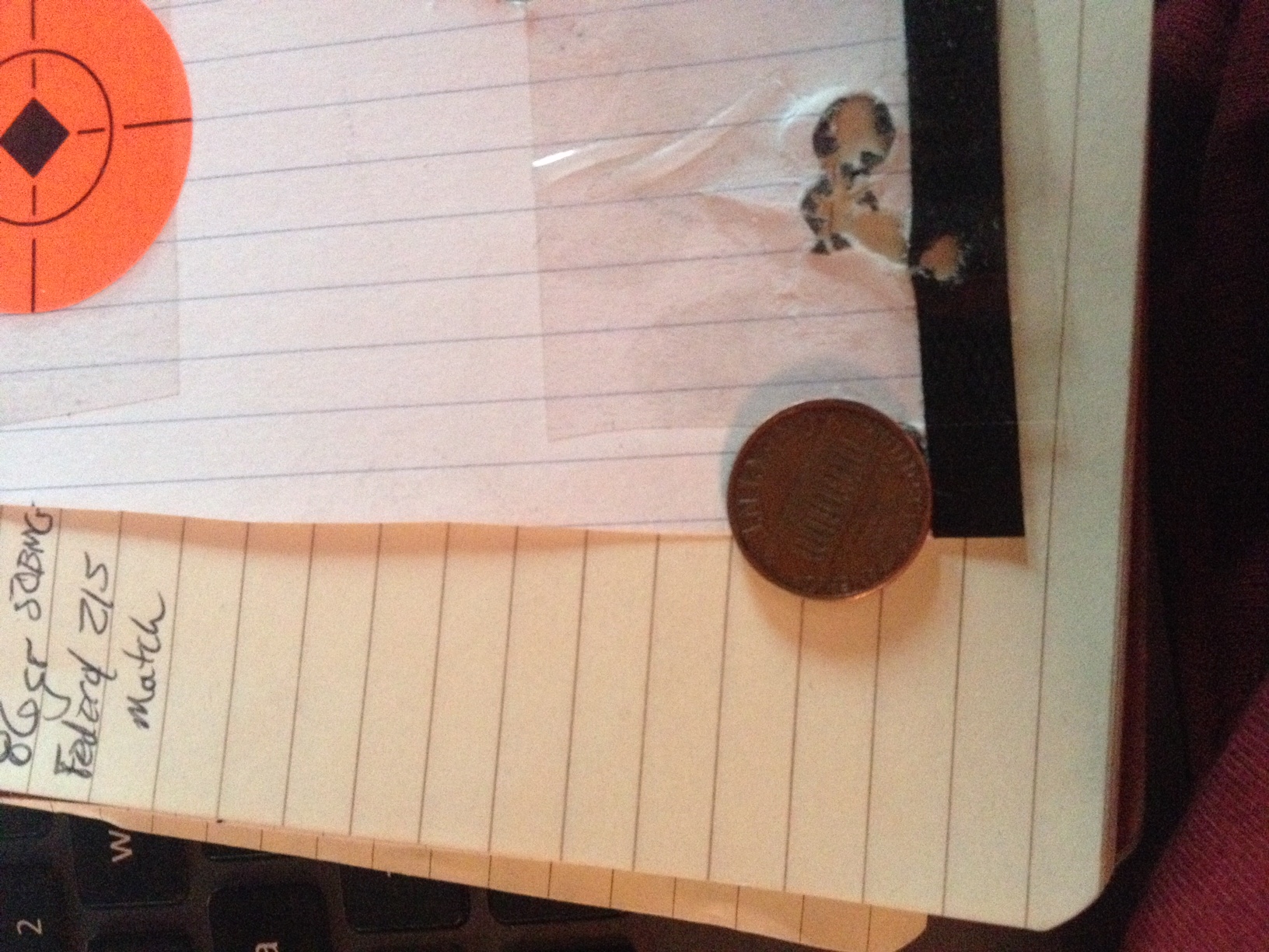

This is a 4 shot group at 1120 with the 338 ackley improved and fire forming loads, 95 grs of rl33 and 300gr Bergers

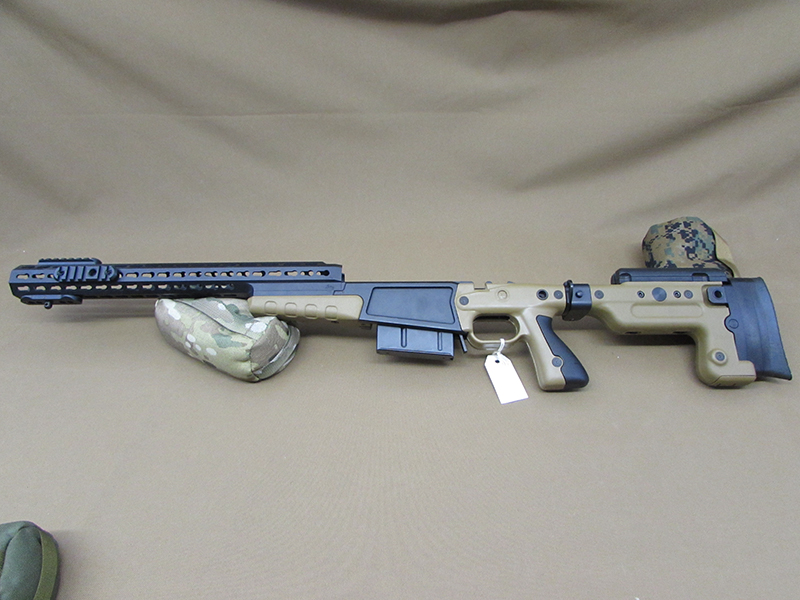

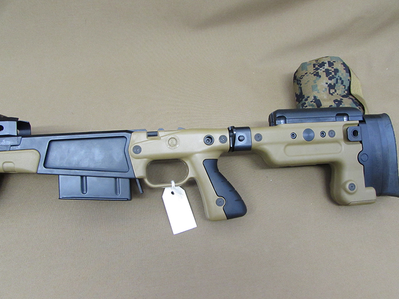

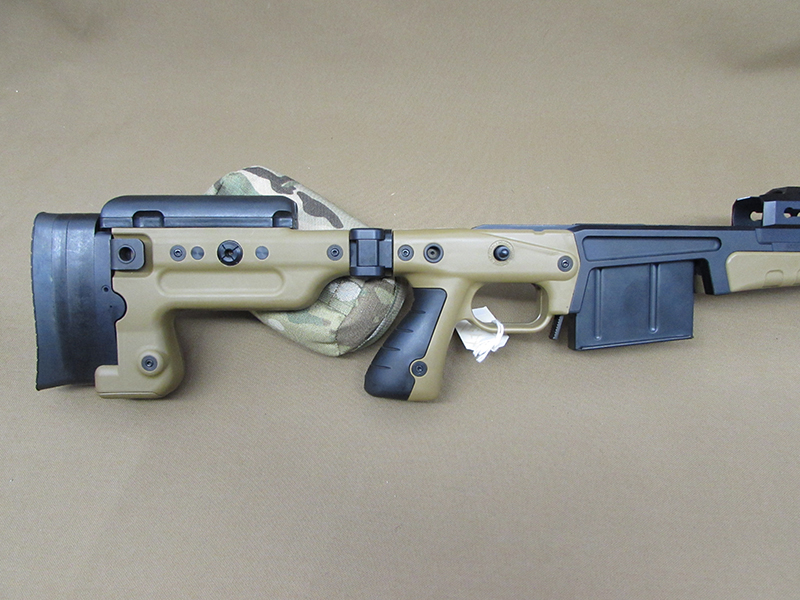

I found a bit of a unicorn (a left-hand long action AX chassis) so I figured now was my chance to build a 300NM and bought it. I'll be driving down to GAP this week to drop it off so they can work their magic. To those who shoot a 300NM, school me on what I need to know. I'm planning to shoot the 215's over RL-33 or H1000 - I've got lots of both. Is Forster the only company that makes dies?
I have had the best results with a Redding 300 Norma neck die, body die, and bullet seater die, using a neck neck bushing that puts .002 neck tension.
Took the chassis down to GAP yesterday and got the build moving along. I'm hoping to get 3100fps from the 215 berger with this setup.
Build specs:
AX chassis - multicam dip
Templar V2
28" Bartlein med. contour palma 1-10 twist
Mini FTE brake
Timney trigger
Let the wait begin!
