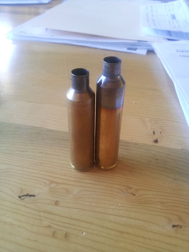

Bjay and I both got our dies. I also got my 30-338 Lapua Imp chambered last Sunday and fireformed 10 rounds today. I really don't want to waste much barrel life fireforming so I'll probably only do 20 rounds to see if it shoots and then rechamber a Remington factory barrel to form brass in if it shoots. When I get me reamer back from Bjay's smith I'll do the same for my Norma Imp. I found some other brass to use in my Norma Imp that will require neck turning and fireforming but should last a good long time. BTW my Lapua Imp is .572 at the shoulder.
Here is a picture of my 30-338 Norma Imp versus my 30-338 Lapua Imp. Both have 35 degree shoulders and roughly the same taper. The Lapua Imp holds 122.7grs of water and the Norma Imp. holds 110.3.
Looks really good ;)
