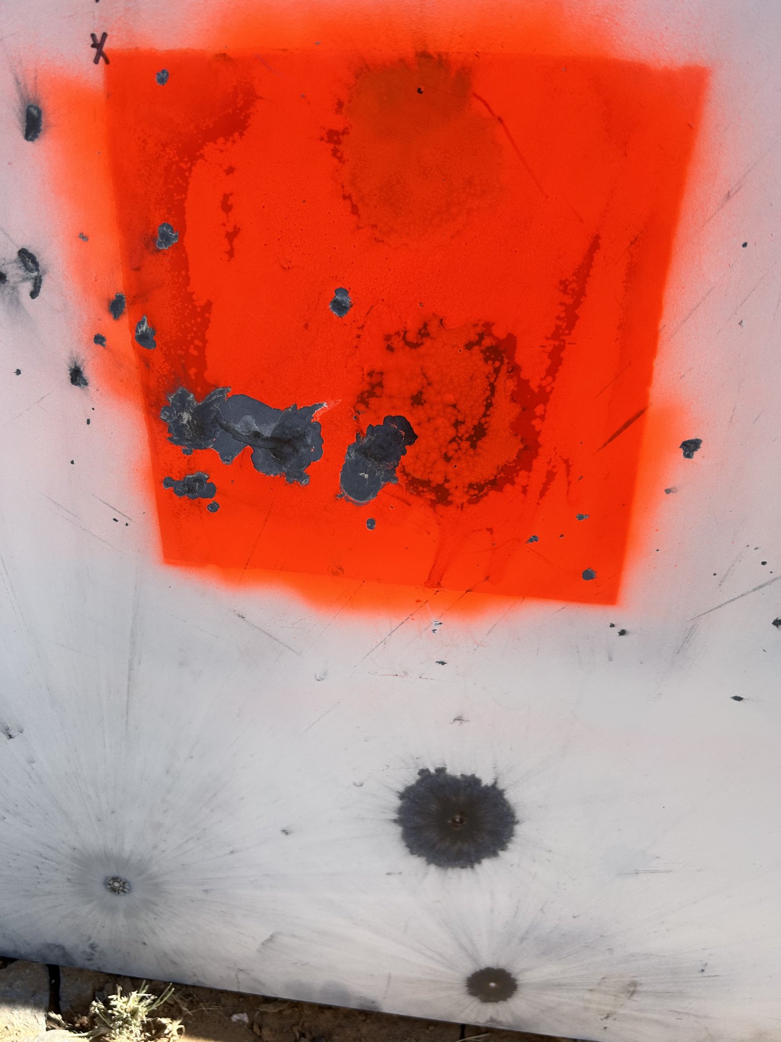

Chambered in 300PRC. I live in the desert and have a spot I can shoot to 1.5 miles into a mt. I have hunting guns in 6.5 and 7mm that I play with out to 1000 yards. This will be my first 15 lb gun. Gonna go Nightforce scope and see if I can get to 1.5 miles. Attached is a pic of 1000 yards this weekend with my 6.5. I put 2 of 3 shots in the orange 6in square.
I hear you on the Bergers, I shoot the 156gr factory ammo in the 6.5. I used that factory ammo for that group in the pic. The problem with Berger is finding the bullets. They are beyond scarce. Let me know if you have any other input.
