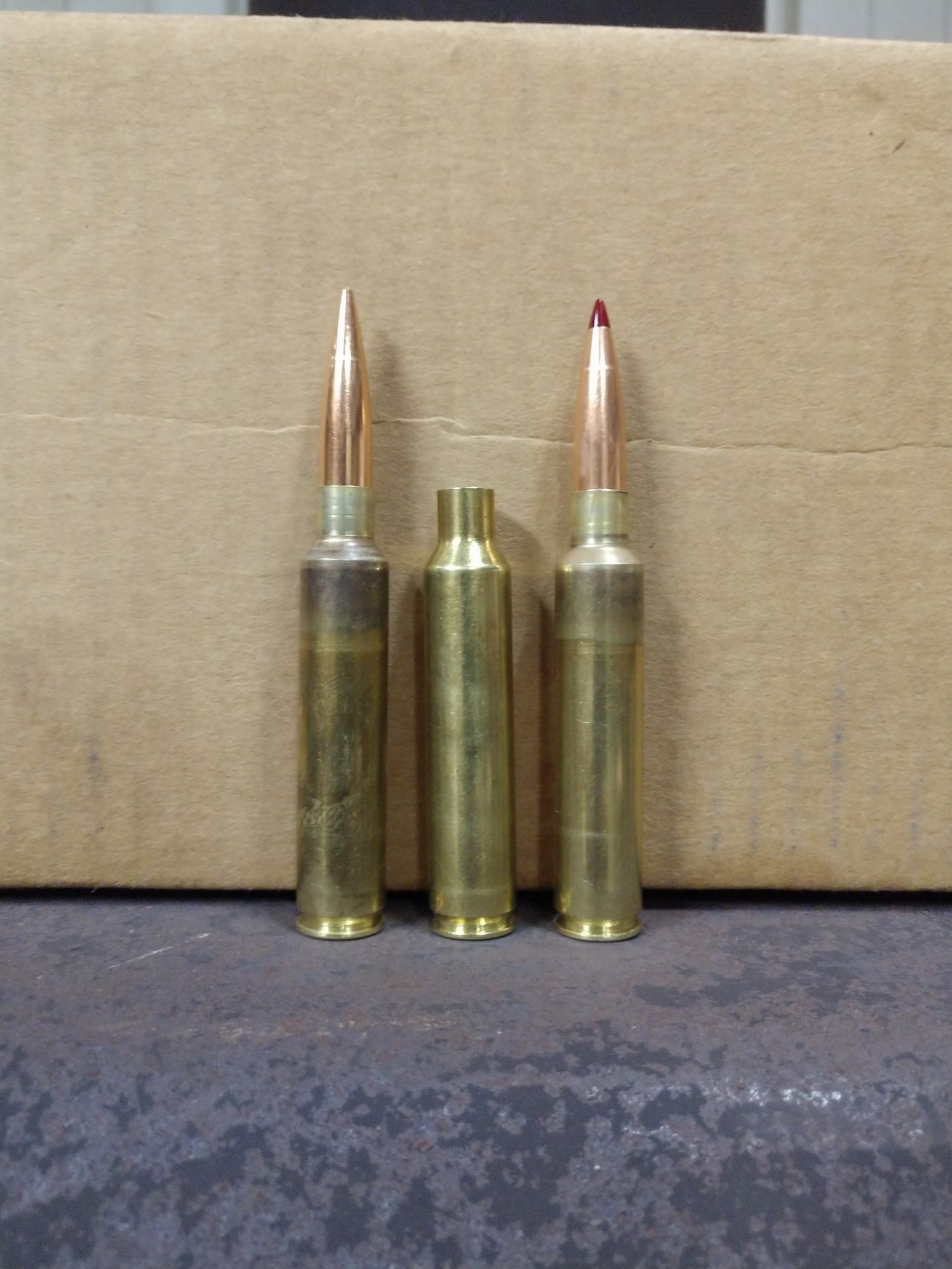

Will the 300PRC reliably push 225gr ELD-Ms to 2900~2950 out of a 24" tube? Or is it going to just depend on the barrel. Came across the 30 sherman which is the 300 PRC improved essentially and can be fireformed with factory hornady match ammo.
Left and right are 30 sherman, middle is the PRC.

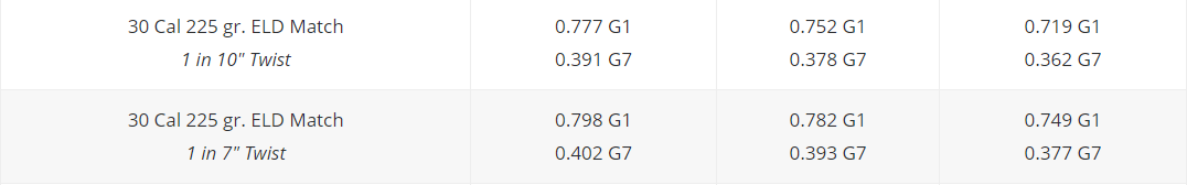

I saw this pic that said the 225gr ELD-M BC was higher with a 1-7 twist but i honestly knew nothing about that which is why i asked. Thank you for clarifying. I'm pretty set on 30 Sherman at this point. Would probably be pushing just like i am with the 7 SS. Though barrel length is of concern just because i run cans and don't want a javelin. That said could go 26" and grab a resonator K as intended at 5" that's shorter than my 24" 7 SS with the hybrid at the moment.
Probably Hornady published dopler data. CD does decrease (BC increase) with faster spin rates. I just get worried when velocities approach or exceed 3k and twist rates get faster than a 1:8. Seen some failures in smaller caliber stuff and most bullet manufacturers specifically call out the 300k rpm number for thin jacketed match/varmint bullets.
Yup i thought i posted that pic in that post. But it was showing various bullets BC at faster twist rates and it got me to thinking.

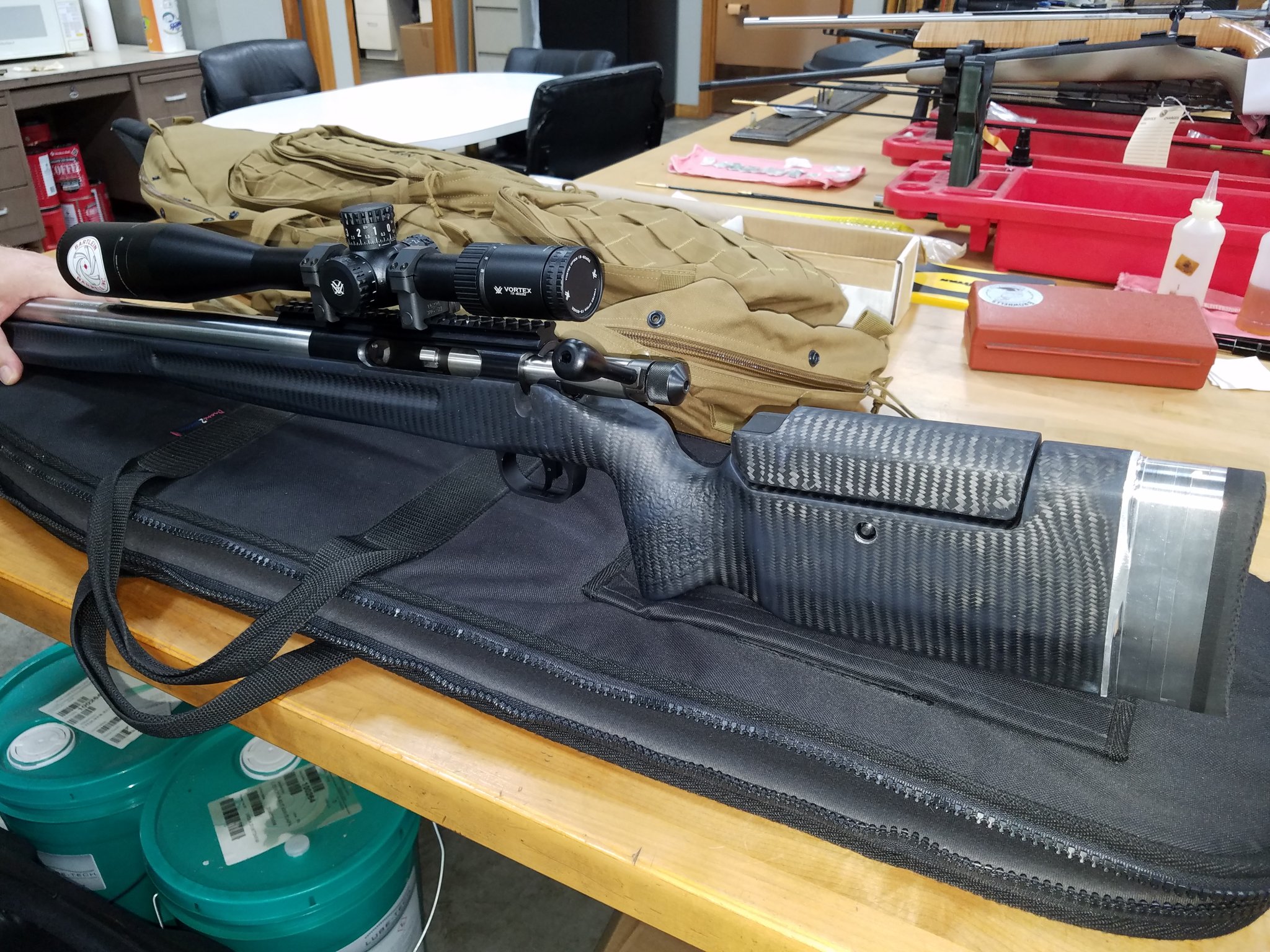

Here is a pic of the rifle. It weighs just under the 22# limit for F Open. The action is a Barnard Model PL. The barrel has a 1.350" breech diameter x 5" and str. tapers to 1.125" at the muzzle.

@Frank Green Beautimous....it almost appears that the bolt is made from the same piece of steel as the barrel. Now you are going to have all the lefty shooters on the boards jealous.
Yep it is a lefty!!!!

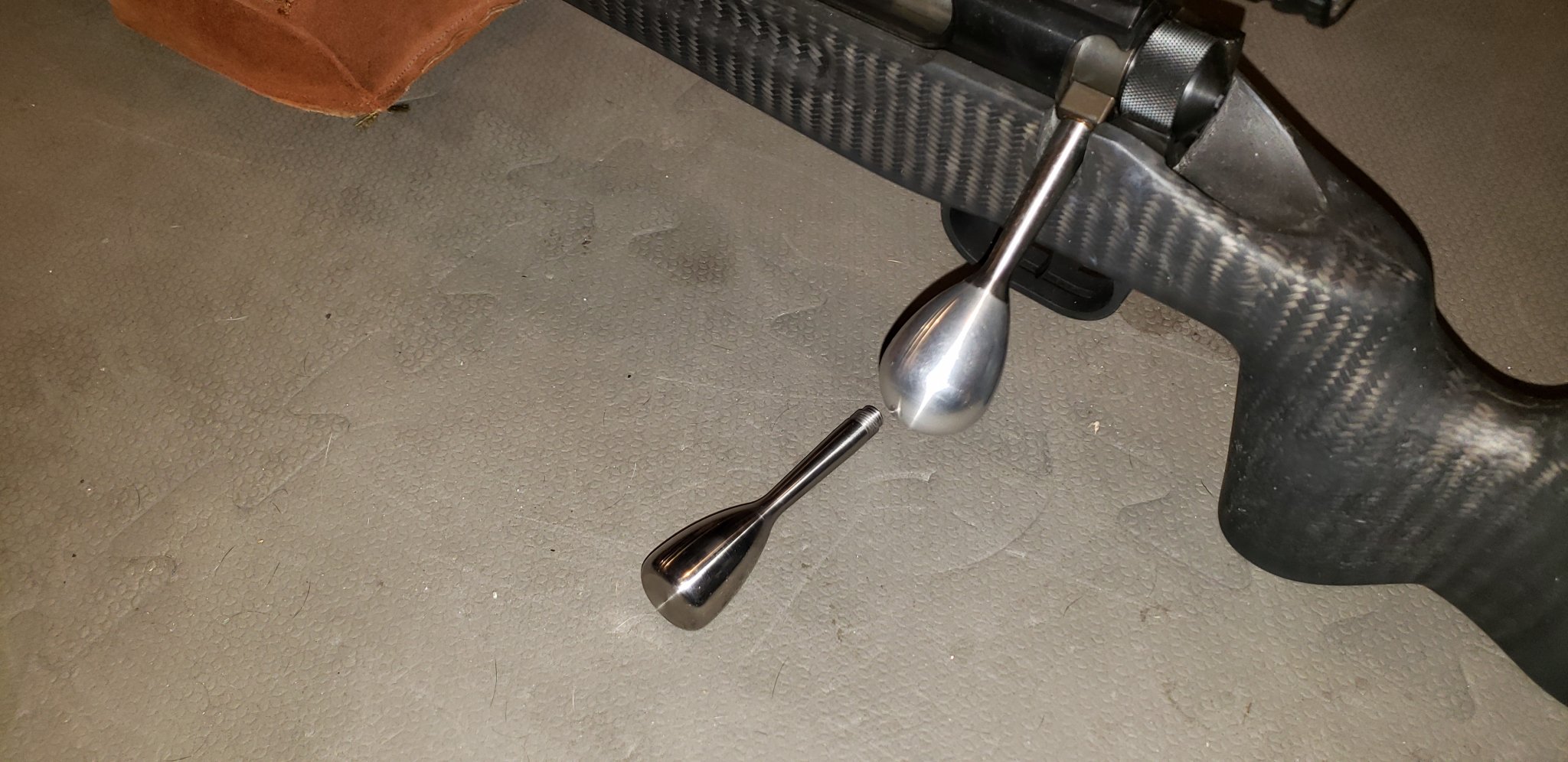

With a custom bolt handle and knob that we made at work. The handle is patterned after the one my friend John H. use to make for the Barnard's and RPA type actions. He had one left that wasn't finished and gave it to me to use to copy. I have one of his originals on my other one. The factory Barnard handles are aluminum. My handle the shaft is SS (yes made out of gun barrel material) and the knob itself is made out of aluminum that I polished. The handle on the floor is one piece SS.

It's my second Barnard if that tells you anything. It's tough to beat. My first one is a standard Model P. They have excellent triggers that can be used as a two stage or single stage. Mine is set as a two stage and the second stage breaks at 15oz to 1# as close as I can measure. :)
The stock is a Manners F class stock in carbon fiber. (y)
