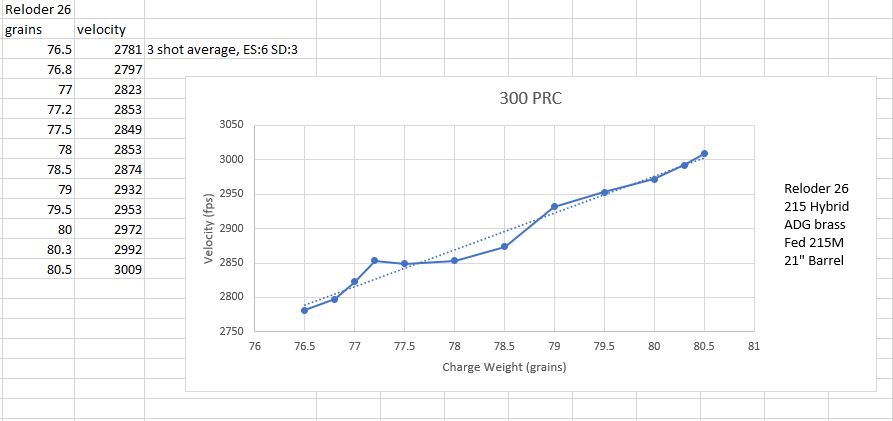

Tried to find max.... never did. No ejector, no hard bolt lift. Did get a recoil increase at 80.3 grains rl26.
I’m going to post these numbers, but anyone loading for their rifle please don’t be a dumbass and work up.

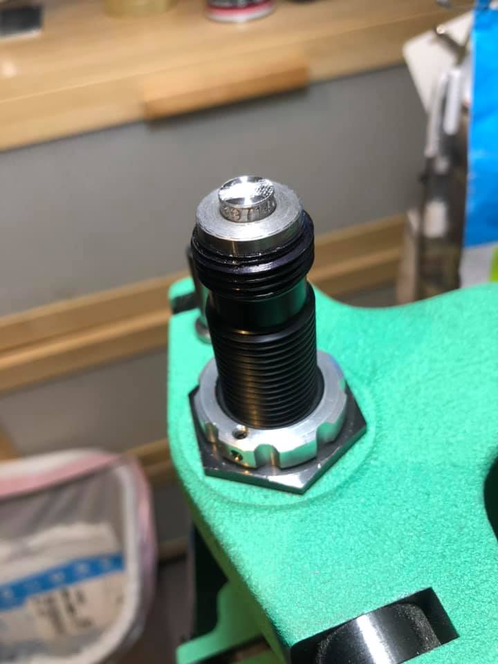

Now I’ll need the dies. My apologies if its been covered (I did search) but anyone know the bushing size for ADG brass? Planning on Whidden dies.
Thanks.
edit: found this,
Any updates on the size of bushing being used on ADG brass?
I'm using a 0.335
Apr 9, 2020
I too am using 335....have used 336 and will work...I just wanted a little more squeeze...
using a .336 now...and still using a Sinclair Neck Mandrel to get my optimal neck tension.

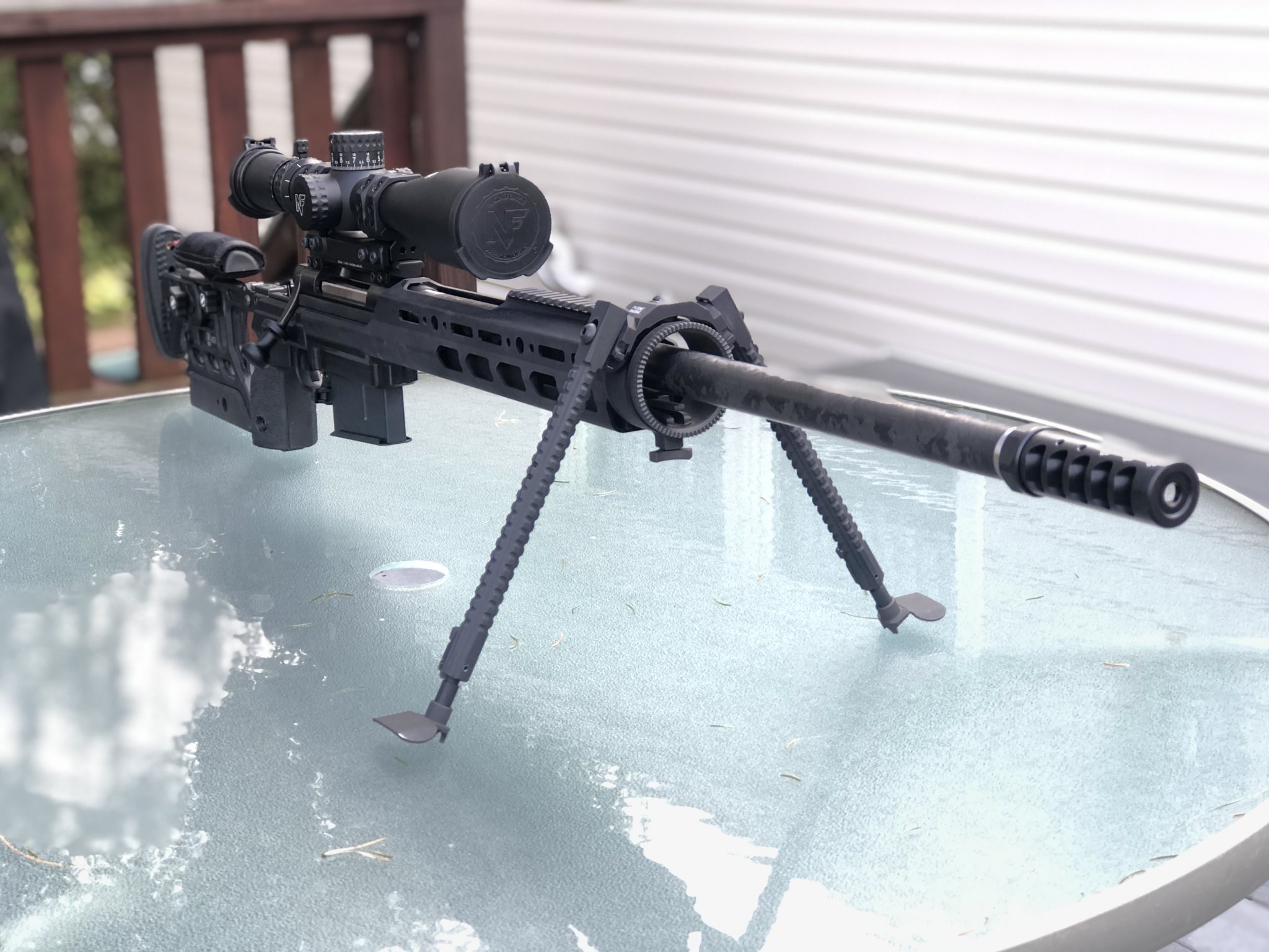

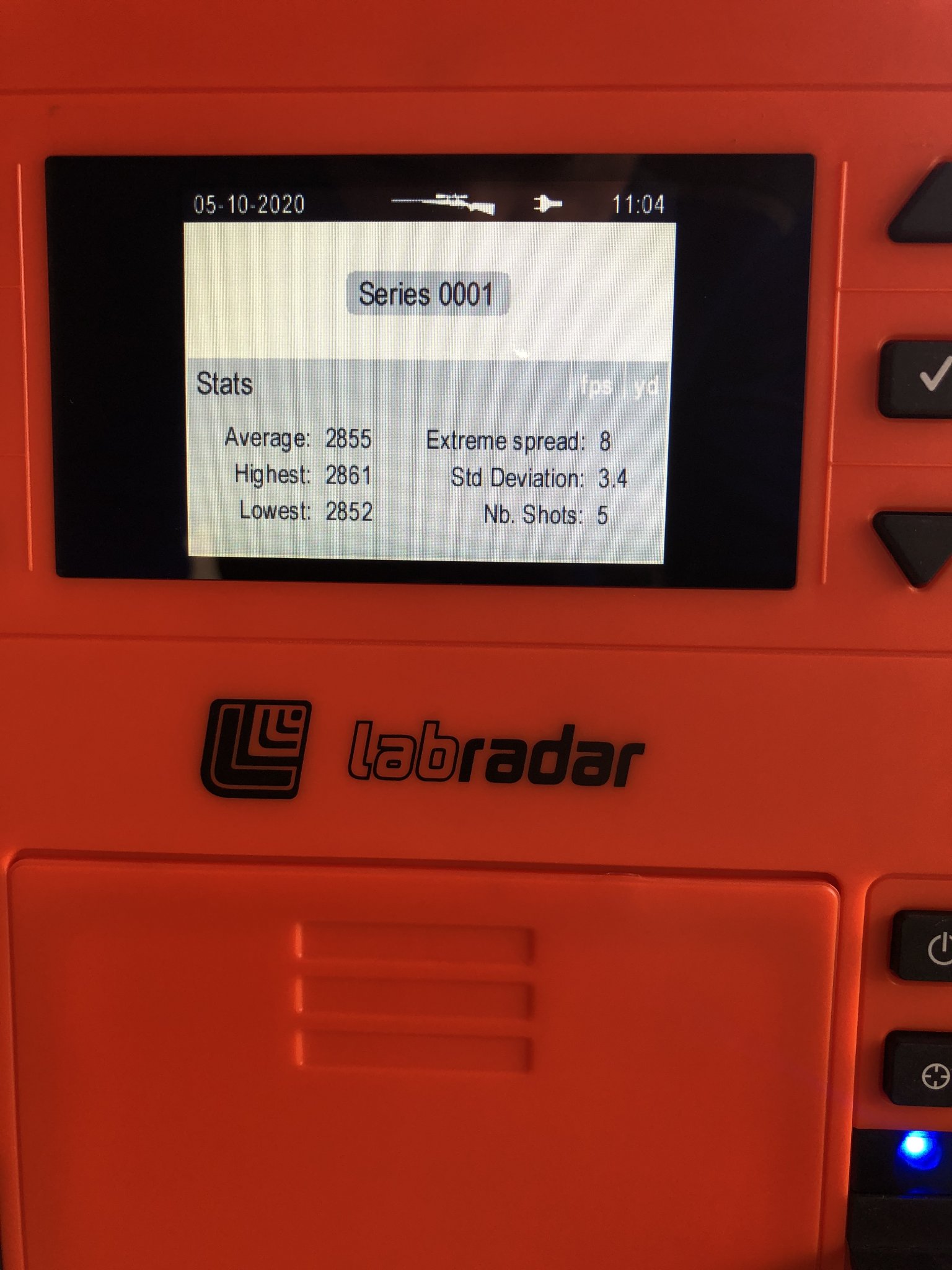

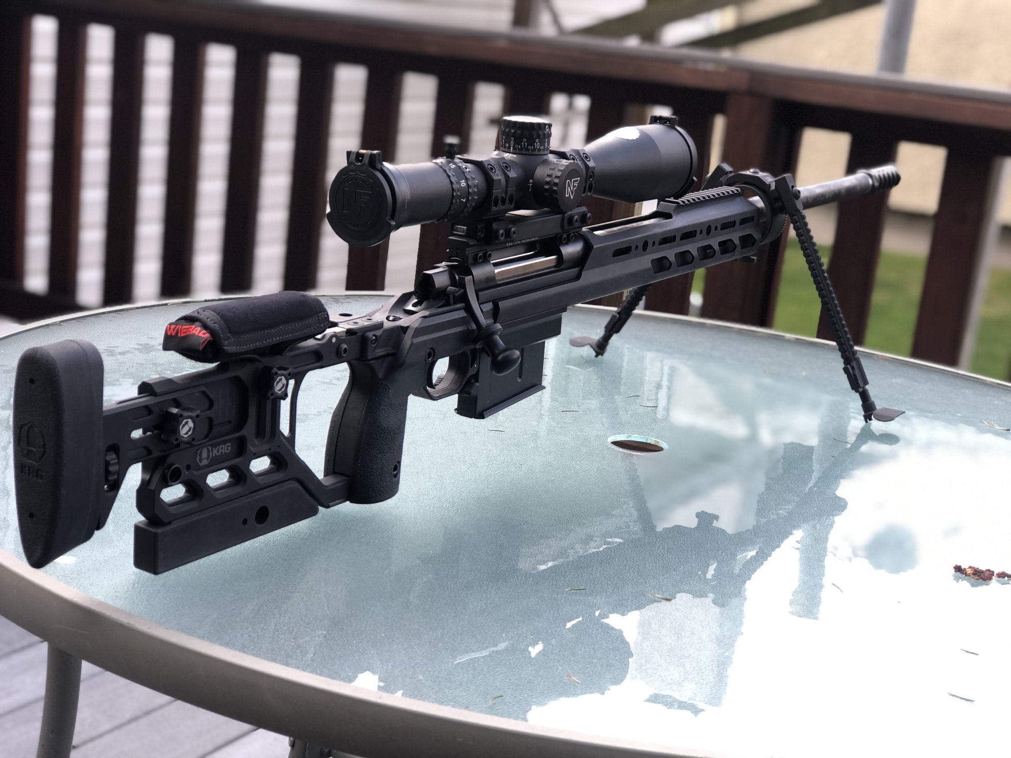

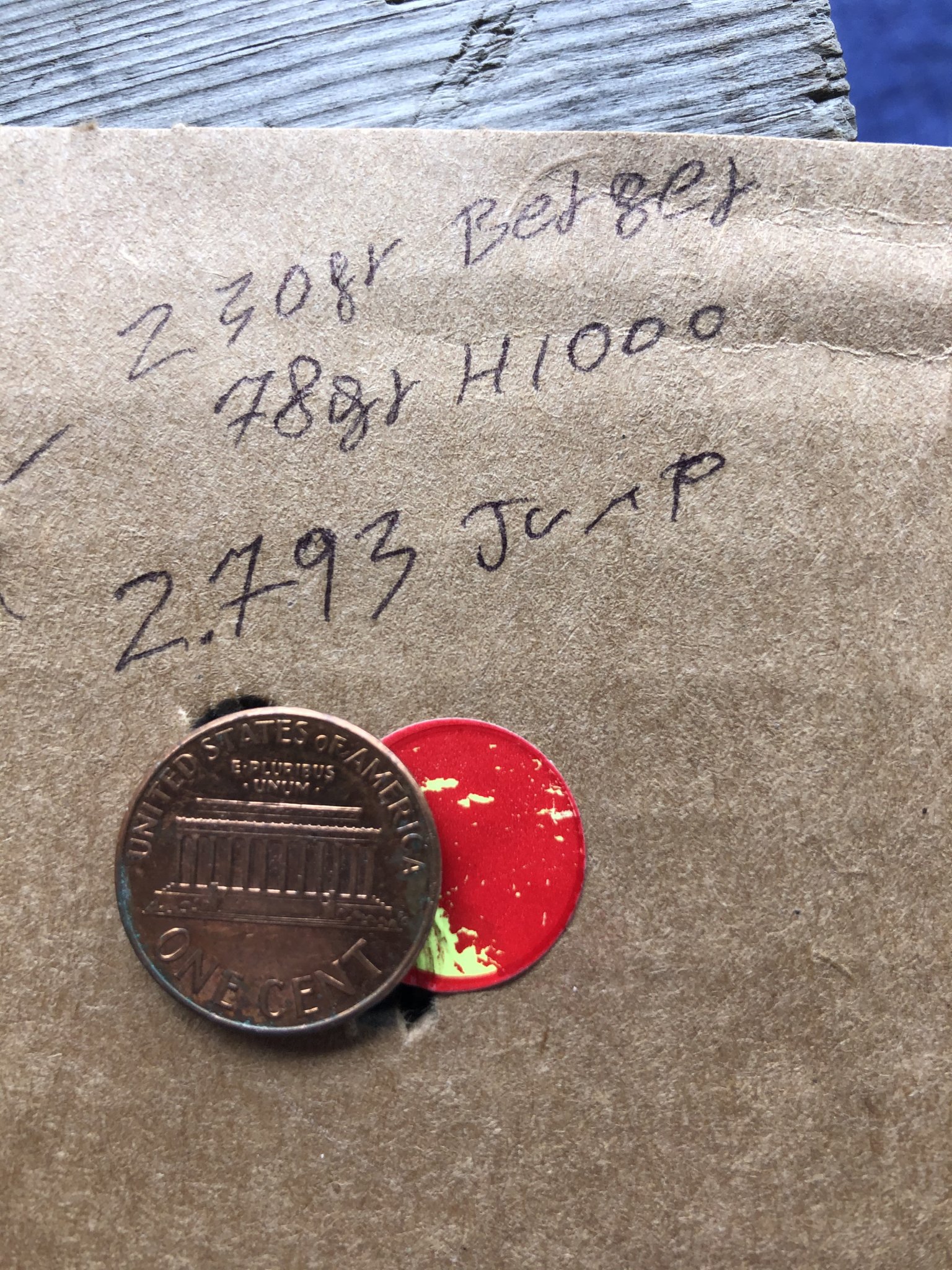

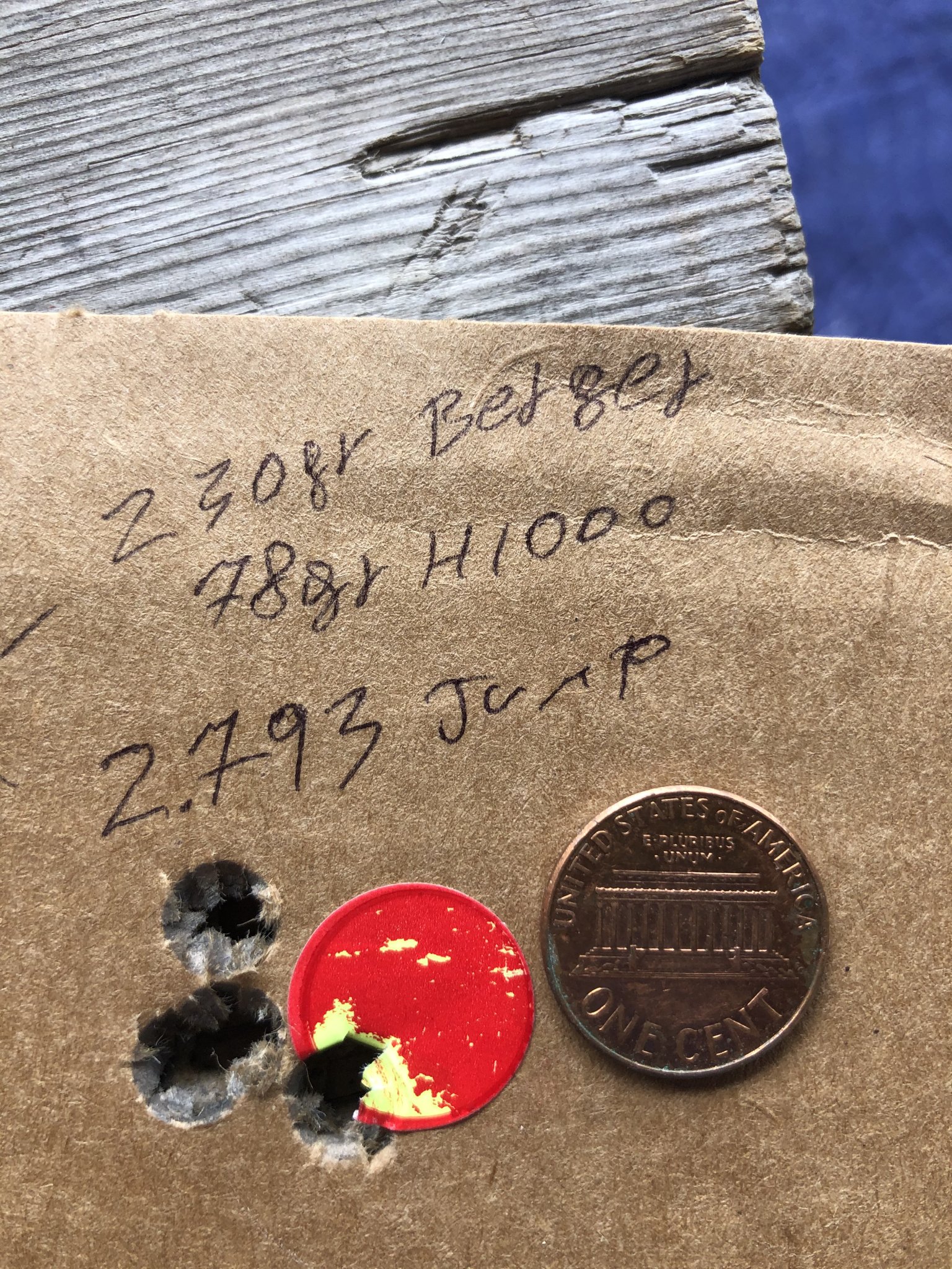

Some Load Data on 300 PRC.
Rifle Setup:
Chassis: KRG Whiskey 3 Chassis with Enclosed Forend and Folding Buttstock.
Bipod: Elite Iron Revolution Panning model.
Scope and Mount: NightForce ATACR 7-35x56 F1 Mil-XT. Mount: 20MOA SPUHR
Action and rail: American Rifle Company Mausingfield Gen 2 with 45MOA scope Rail.
Barrel: Proof Research 26 inch Twist rate 9
Brake: GEN 3 Fat Bastard Self Timing Muzzle brake
Trigger: Triggertech Diamond Pro Curved
Ammo this is load for my Rifle be careful.
Brass: ADG
Powder: H1000
Charge:78gr
Bullet: 230Berger Hybrid
FPS: 2855
Took rifle today to 1744 yards group 4 hits out of 5 and group measured 9 inches.
Group at 100 yards
in pictures.
