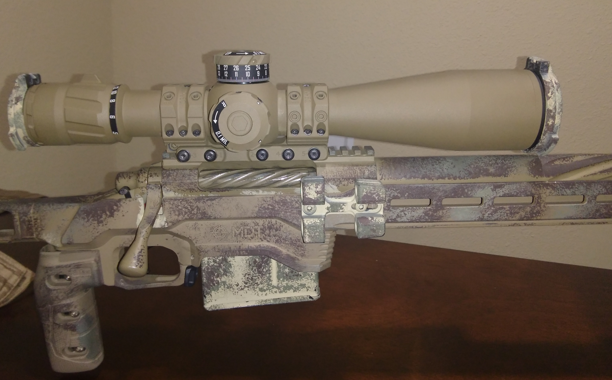

@b2lee that is sexy, is that a cerakote on the chassis? Looks almost like a rattle can job.
The base cerakote of the MDT Chassis is the same FDE as the scope.....the base cerakote for the Action and barrel is slightly darker than the Chassis and scope.....then I sponged transferred the other colors in using Krylon Camo Series.
The good thing is...later on if I want to remove the paint..I can..without damaging the cerakote...because cerakote is tough.
My intention was not to be snipery or operator as fuck....but to simply not look like every rifle that day at the range...plus...if you have everything looking all neat...you are afraid of dinging it...if you can paint a $5k rifle and a $4k scope and rings....then maybe you can concentrate on using the system as a tool to get work done...instead of worry about minor scratches as you gently place it in your safe wrapped in cashmere.
