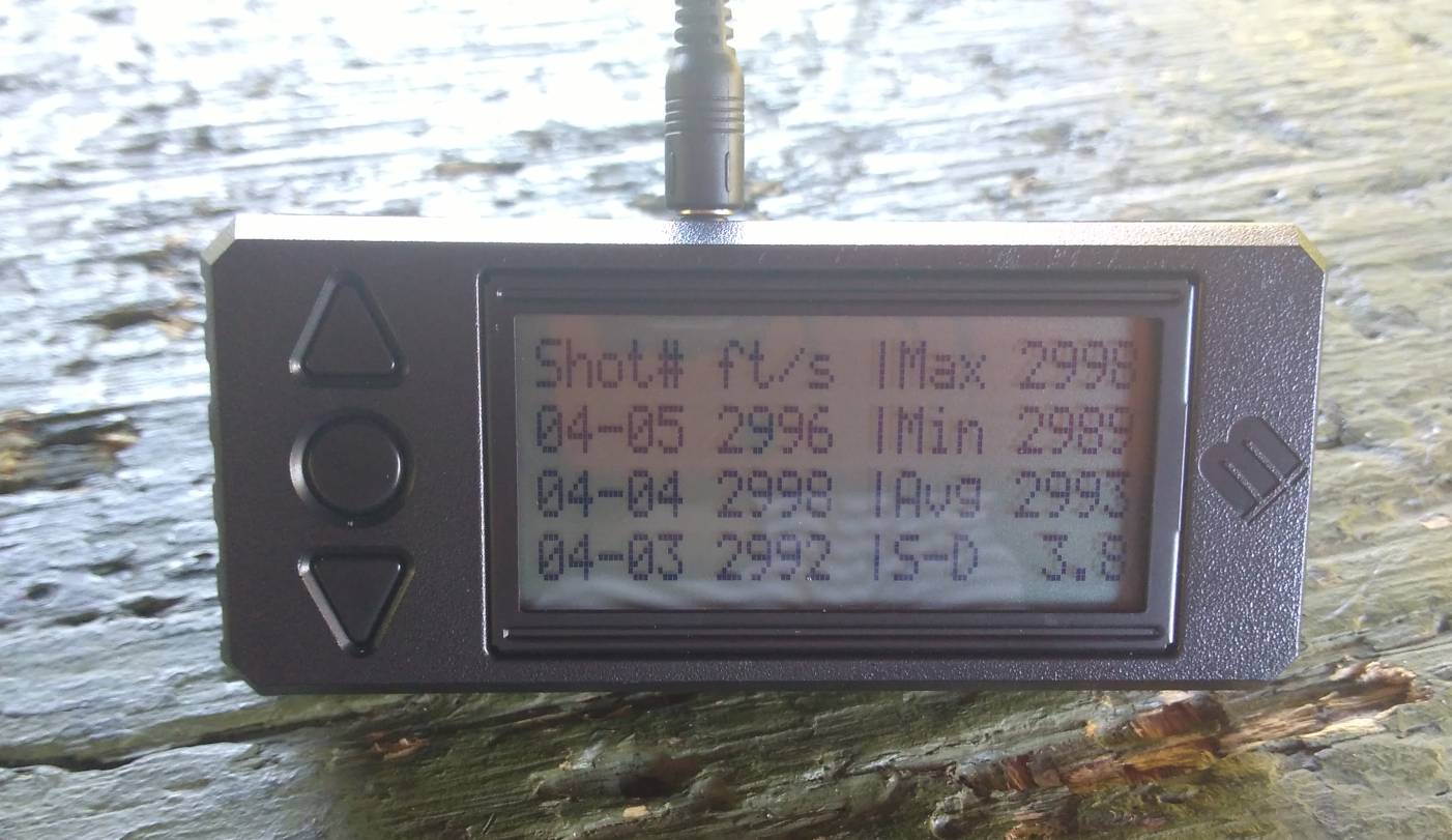

I started out over 3000fps with 225 ELD-M's and even pushed a few 230's and 250's over 3000fps at 900ft ASL. I've 'backed down' to 2950fps on 230's and 2915fps on 250's. My next barrel I'm going to find a speed node around 2900fps with the 230's that is wide enough to take care of all my temp variations and then tune with seating depths.

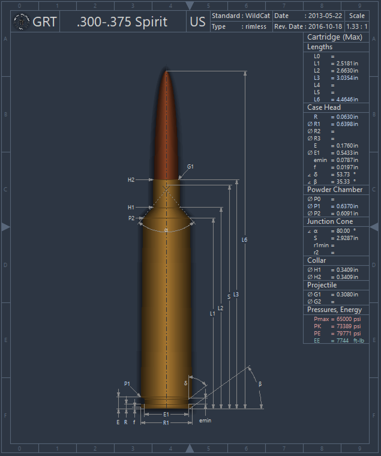

I did some prelim work on your wildcat (I hope you appreciate the name). GRT says it can push the 250s at 3120 fps with 124 grains of N570 :)
Heh...That's a LOT of powder to gain 100fps...then again...it would be much nicer on the brass than when I pushed a 250gr A-Tip over 3000fps. Anything bigger for me will be like a 37XC or similar. I'll probably end up building a rifle where reloading is easy...you just put the entire 1lb can of powder inside the brass...easy peasy.

I was shooting at 600y today at Quantico. This Dave Tooley 27" Bartlein barrel has sped up right at 100rds. The berger 220s over IMR7977 were clocking 2810 initially and are now at 2840.
I also shot some of the 212 ELD-X Hunters today - not bad - 2905fps and grouped well, even in gusting winds. Top shot is cold bore, then four more. The amount of energy this round has is telling, my 2/3rds IPSC was flapping in the wind with each hit.
