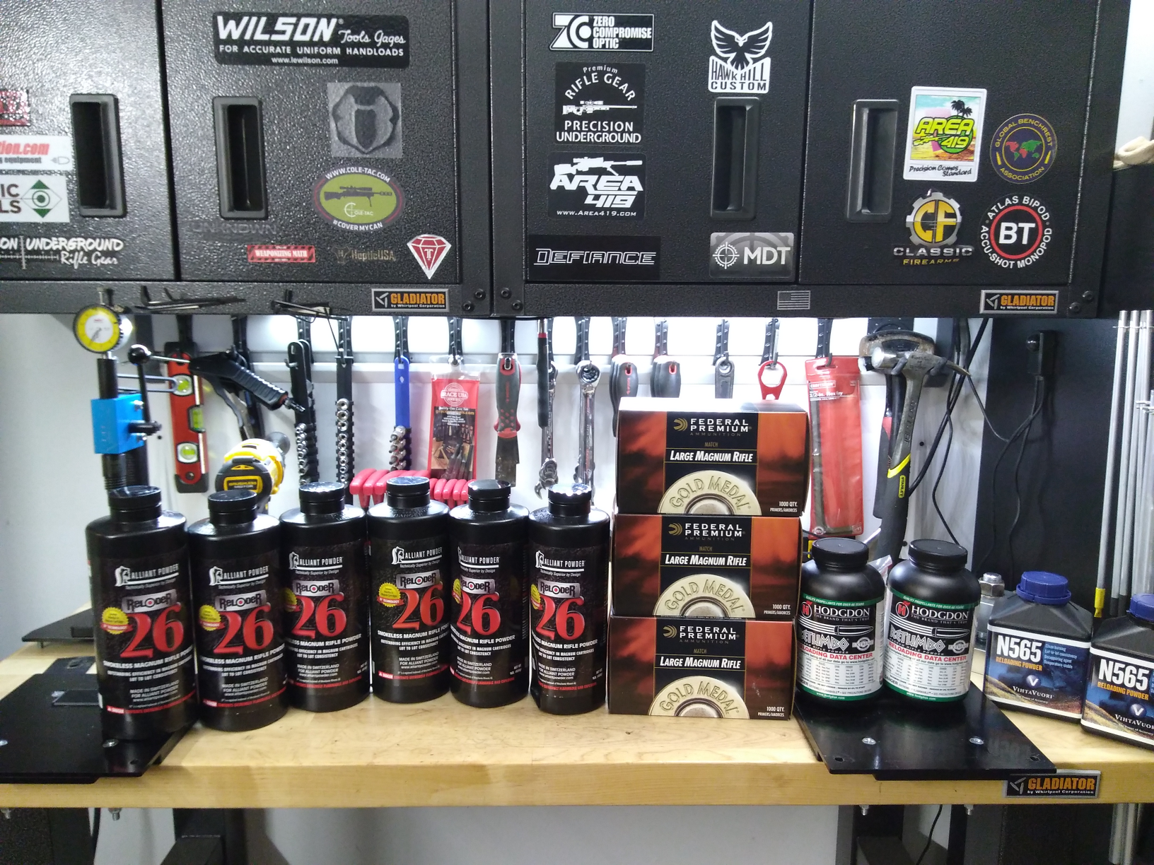

Had a few deliveries today while I was work...came home on a cool and rainy day...expected delivery tomorrow...but it was on my doorstep...and luckily nothing got wet....I've already opened one bottle of N565 for a speed node verification test tomorrow.

Are you working a load for the 225s with N565 and Retumbo?
I have a load at 75.0gr of Retumbo and 75.2gr of N565 that at the seating depth I have listed for my barrel...works pretty good for the 225's...however...I don't like to shoot the 300PRC less than 1mile...I will do it for 1000yd paper..but don't really like to...so I tend to use the 230 A-Tips.

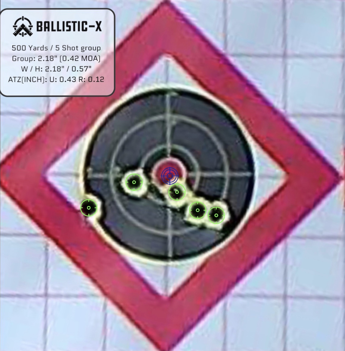

Barrel length? (Curious because I feel I’m in a mid node at 2900)
I spent 200 rounds with H1000 and R26 with 28” Bartlein and 2900 was best with both powders using 230 hybrids. RL26 @ 76 gr. and H1000 @ 77 gr. (holds .3 MOA at 100, 1/2 minute at 500 with decent vertical)

Barrel is a 28" Bartlein with a 1-9 twist with over 1300 rounds through it. ADG Brass and Hornady A-Tips. I've found lighter weight bullets hitting pressure signs way earlier than these A-Tips. I have pushed the 230's well over 3k...but that is most likely stupid on my part. In the summer...I found my best loads were in the 2950fps range.

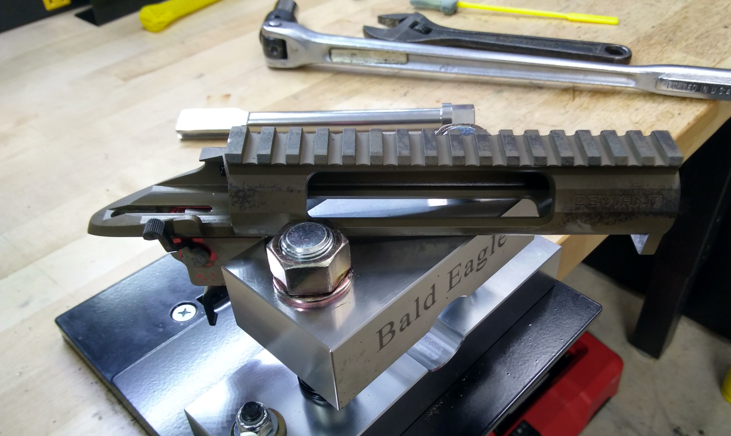

Spun off barrel....removed scope...removed chassis....going to clean everything up. After ~1350 rounds...the barrel still looks really good. Letting it soak over night filled with Boretech Carbon Remover....then a good scrub...but it was already almost a mirror finish. Barrel looks better than every other rifle I own.
When new one arrives...I'll put it on...confirm if it has the same velocity and seating depth node....shoot it until it stops speeding up...and then put the old one back on for practice sessions.
