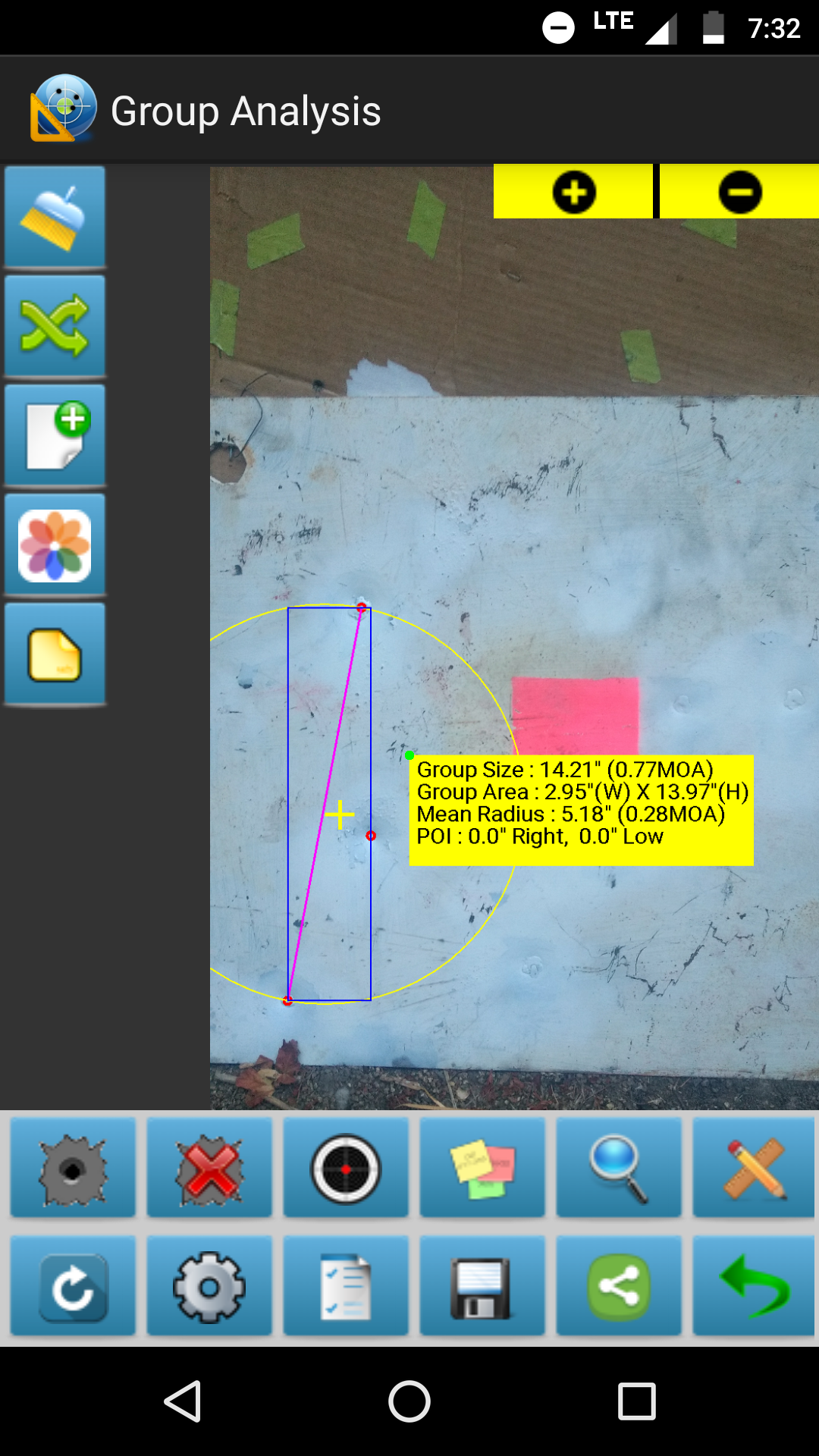

With 1187 rounds through the barrel...my last group at 1 mile had an estimated 6 inch verticle...but my horizontal with the twitchy winds pushed one 10" off the paper for a Zero score. It would maybe have been an 18" 5 shot group....almost all horizontal.
The point being...so far....the barrel still has some long range life in it. We will see in a few weeks when it gets to go out to maybe 3000 yards....most likely 2700yds.

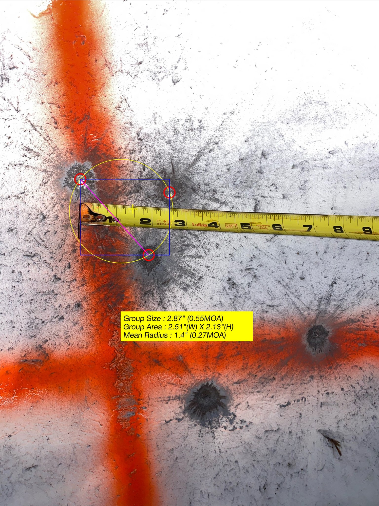

Here is my 620yard group with the ELDMs
Here is my 3 shots at 1mile. On a 20x20 target. My first time at a mile. I have a bushnell scope and ran out of dial. Was holding over. My spotter walked me in. 2nd shot was just a few inches above target.3rd shot connected. 4th and 5th hits. Wind was blowing 6mph. Dialed a lil for wind too and it worked.

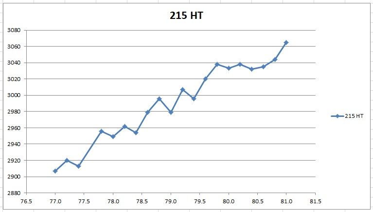

Range Report/Ladder Test
Rifle: CA MPR CF 300 PRC 26" 1:8
Suppressor: SC Omega
Scope: NF NXS
Bullets: Beger 215 HT and 245 EOL
Powder: VV N565
Brass: new ADG ran through Sinclair .002 mandrel
Primer: F210M
Chrono: MagnetoSpeed V3
Location: Central TX
Temp: 97 deg F
Berger 215 HT
CBTO: 2.930" (.020 off lands)
COAL: ~3.708"
(grs) - (fps)
77.0 - 2907
77.2 - 2920
77.4 - 2913
77.6 - Bad reading, adjusted V3
77.8 - 2956
78.0 - 2949
78.2 - 2962
78.4 - 2954
78.6 - 2979
78.8 - 2996
79.0 - 2979
79.2 - 3007
79.4 - 2996
79.6 - 3020
79.8 - 3038
80.0 - 3033
80.2 - 3038
80.4 - 3032
80.6 - 3035
80.8 - 3044
81.0 - 3065 (little harder on bolt lift, no ejector marks)
81.2 - 3095
81.4 - 3082
81.6 - 3080
81.8 - 3082
82.0 - 3103 (hard bolt lift and strong ejector marks)
4rds of 80.2: Avg=3049 SD=6.9 ES=16

I also loaded four rounds of the 215 at 80.2 just for the hell of it, see attached pic for 3 shot group at 500yds.
Seems like my nodes are around 78.0-78.2 and 80.0-80.4 for the 215. And 74.7 and 75.5 for the 245.
Going to load up 5 of each in those ranges and then mess with seating depth on the 215.

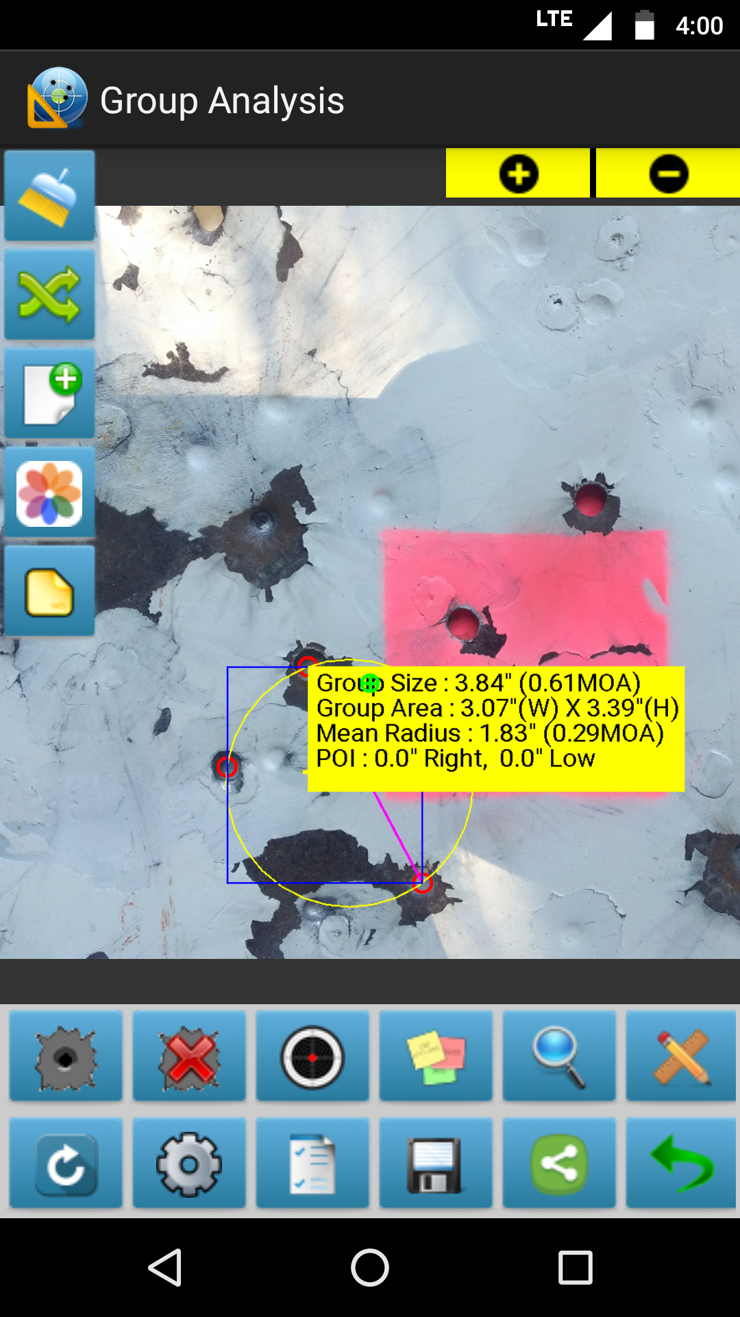

Btw.....a little load development today at the short range gearing up for this weekends TVP ELR Invitational. Today I was trying to play with seating depths to get better groups and rezero my scope for the 250 Atips instead of the 230 Atips. I loaded up my pet load of VV N565 and seating depths of OAL 3.8565, 3.8610, 3.8680, 3.8720, 3.8770, and 3.8825.
I got group sizes of .751, .690, .450, .500, .689, and 1.01. The last one was me....probably should have been around .750.
On the 3.8680 load that shot the .450" group I got a muzzle velocity on 5 shots of: 2901, 2908, 2901, 2906, and 2905. Overall...the muzzle velocity didn't change that much between each seating depth.....28" Bartlein 1-9tw.
