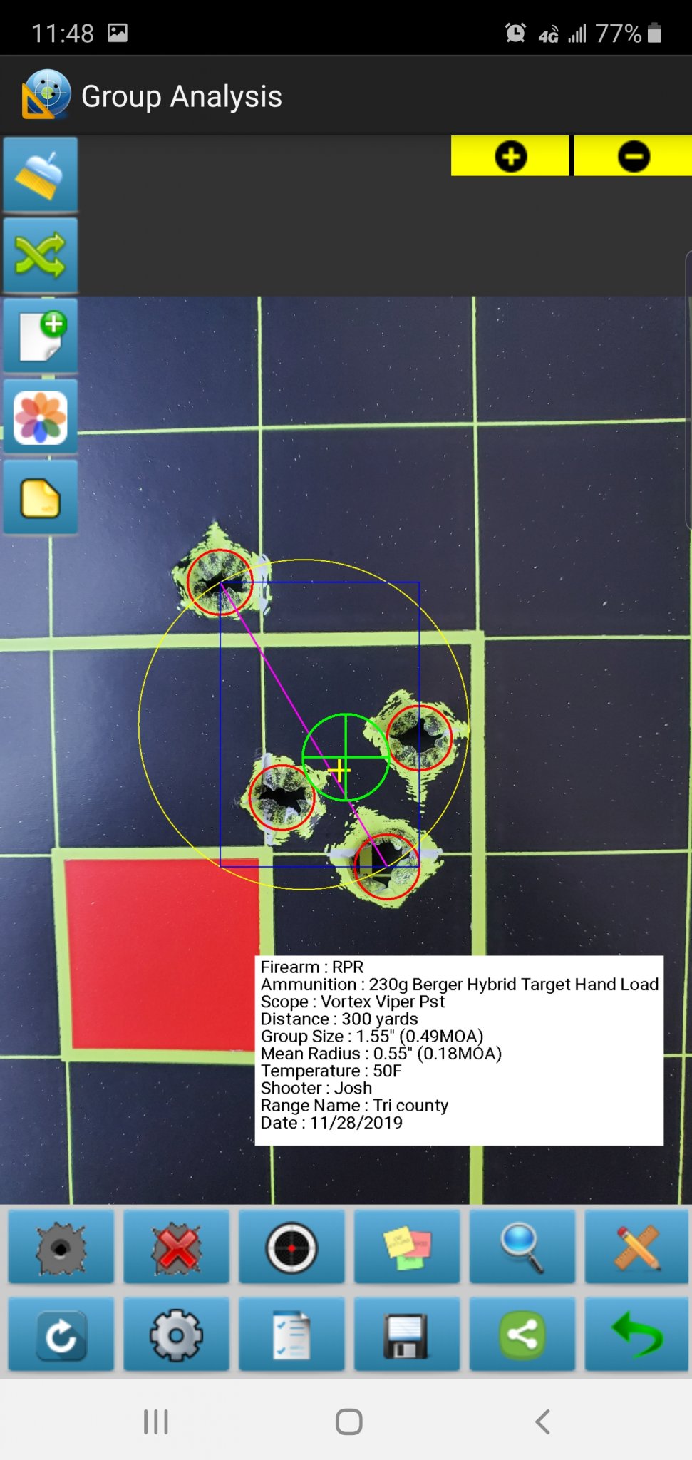

Oh yeah I did ! My best groups to date. .49 moa at 300 yards. 230 Berger hybrids targets with 72.0g of h1000 in nosler brass .010 off my lands @ 2700fps. My go to load for my ruger precision now.
