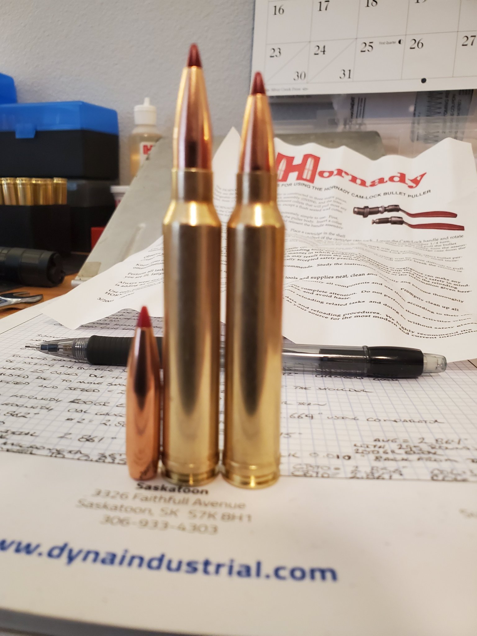

I had 5 boxes of Hornady 225gr ELD M projectiles and I noticed the bullets in 1 of the 5 boxes were noticeably different. Looking at the lot numbers on the 5 boxes, the oldest is the different one.
Ogive, boat tail length, boattail taper and tip material are all different. I loaded a few and had to adjust seating depth until the same CBTO was achieved. The resulting COAL was visibly different I'll shoot them at short range < 350 yards as I'm sure the visible differences would yield practical B.C. and trajectory differences at long range. They obviously changed the design at some point. As sensitive to theses bullets are to jump distance (for my rifle anyway), I hope they still shoot ok at the same CBTO. Pisses me off as they aren't cheap and I don't appreciate the variability.
Could u post a pic of both projectiles side by side so we can see the shank length?

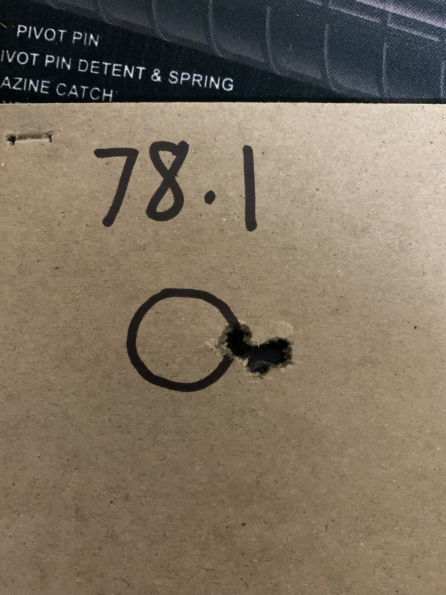

I recently bought a 300 WM and finally found a load it really likes. Tried H4350, H4831SC, and H1000 with 180 grain Accubonds. H1000 turned out to be the best by far.
78.3 grains gets 3000 fps with an ES of 4, an SD of 2, and 0.6" groups.

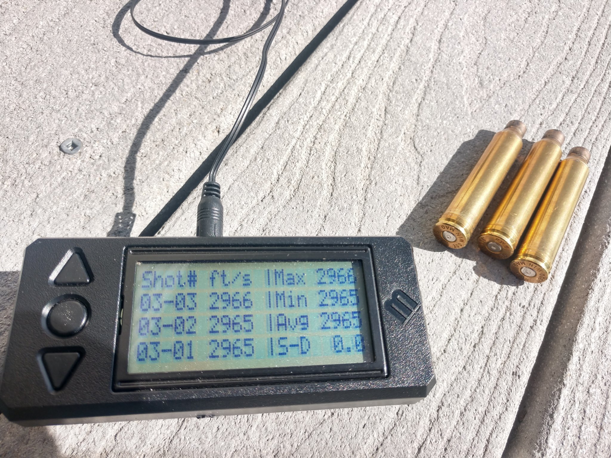

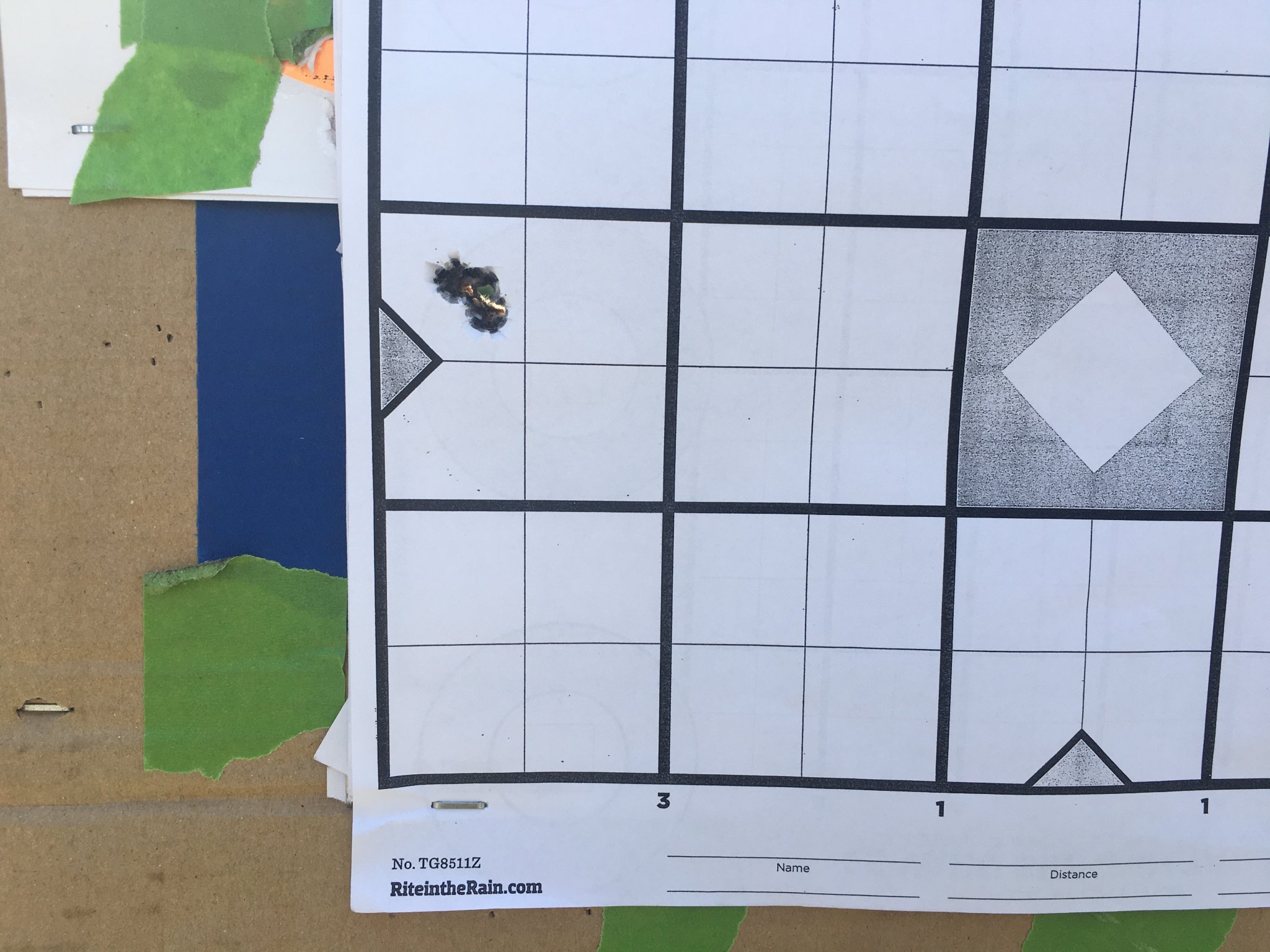

Was shooting 73.0-gr of H1000 @ 2860-fps. 215-gr Hybrids. Federal 210M primers, in Virgin RWS brass. Primers where starting to get slightly flat, but nothing serious. Rifle hammered with this load, crazy accurate, with single digit ES/SD.
Now look what I have with 72.7-gr of the same lot of powder and bullets, but now with the same brass, but once fired.
