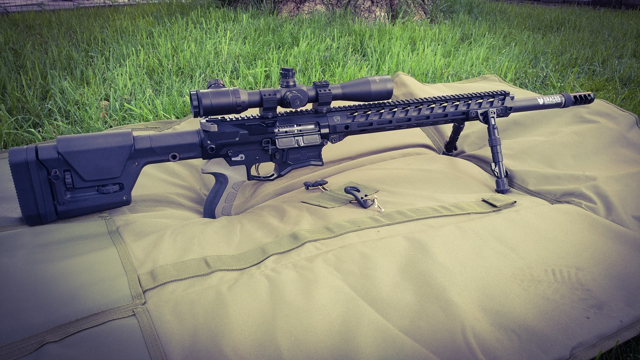

308 AR10 Build Info/Picture Thread

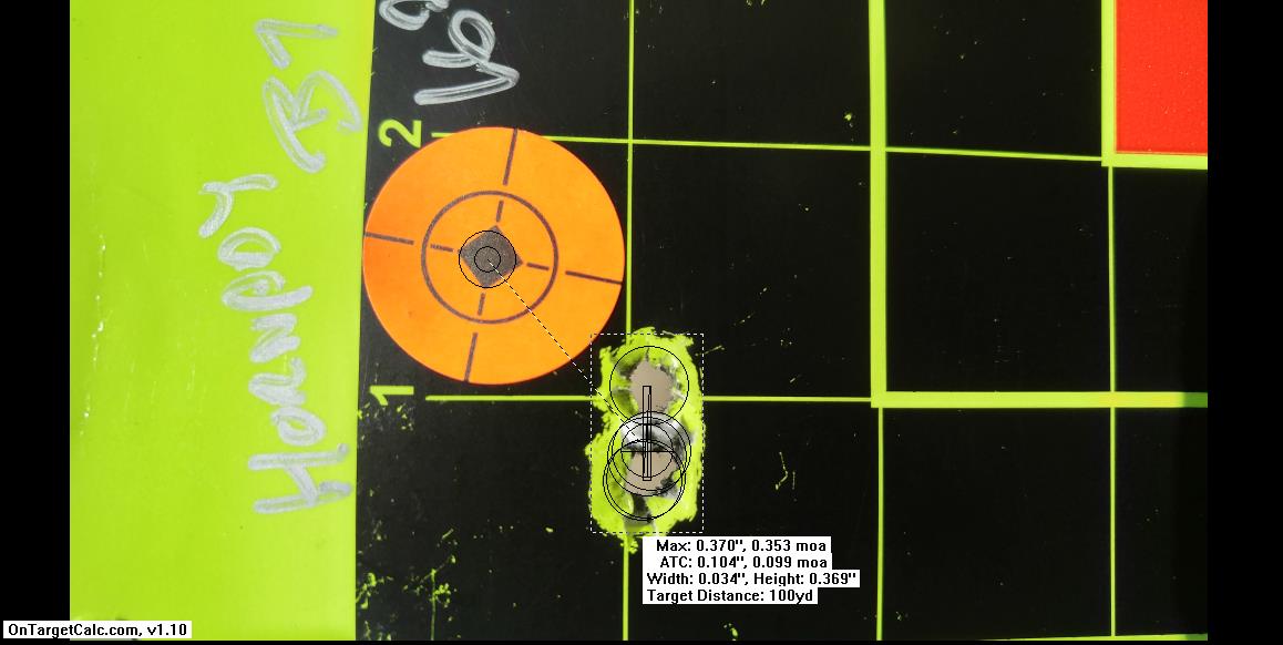

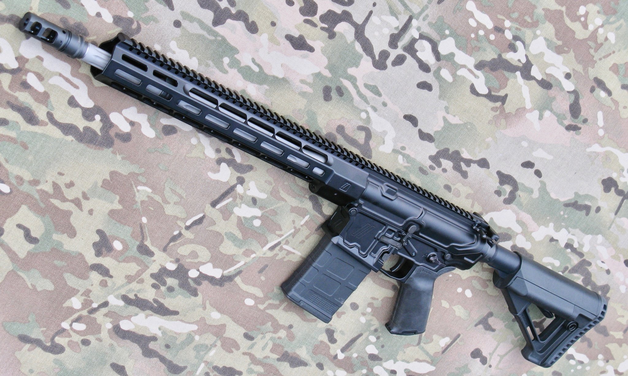

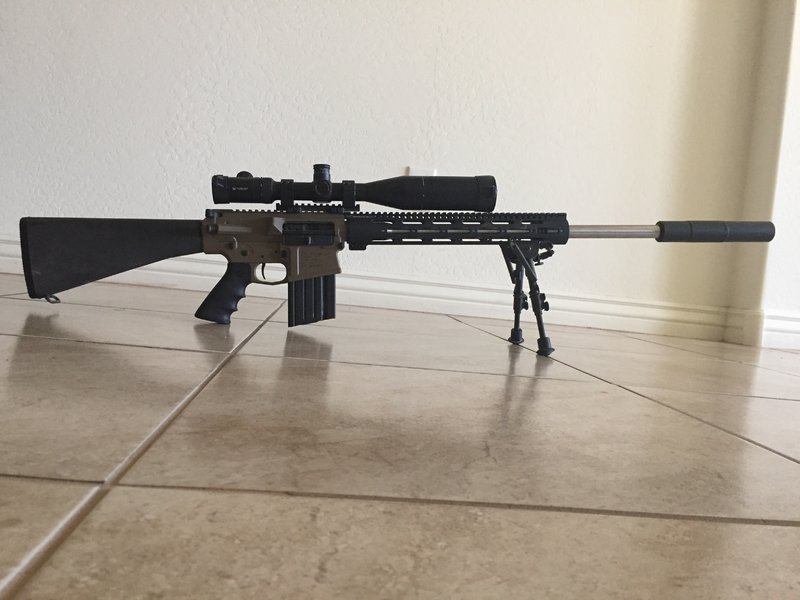

65CM shoots solid ~0.4MOA with Factory Loads
Mega MATen Mega Ext receiver set
22" Krieger barrel
Mad Scientist Muzzle
SLR Sentry 9 adj gb
US Optics ER25
Bobro mount
Geissele SD-E trigger
XLR Stock
JP LMOS BCG HP
JP SCS
AXTS ASS
Atlas Bipod & Accu-Tac bipod
Ergo grip
[IMG2=JSON]{"data-align":"none","data-size":"full","src":"https:\/\/scontent.fsnc1-1.fna.fbcdn.net\/v\/t31.0-8\/18056607_1171748479603539_5490774435134618350_o.jpg?oh=7cd1fe5894df805bfee6efa9f3f0cd34&oe=5A26BC43"}[/IMG2][IMG2=JSON]{"data-align":"none","data-size":"full","src":"http:\/\/i.imgur.com\/ajY5op4.png"}[/IMG2]
Reactions: shooter65

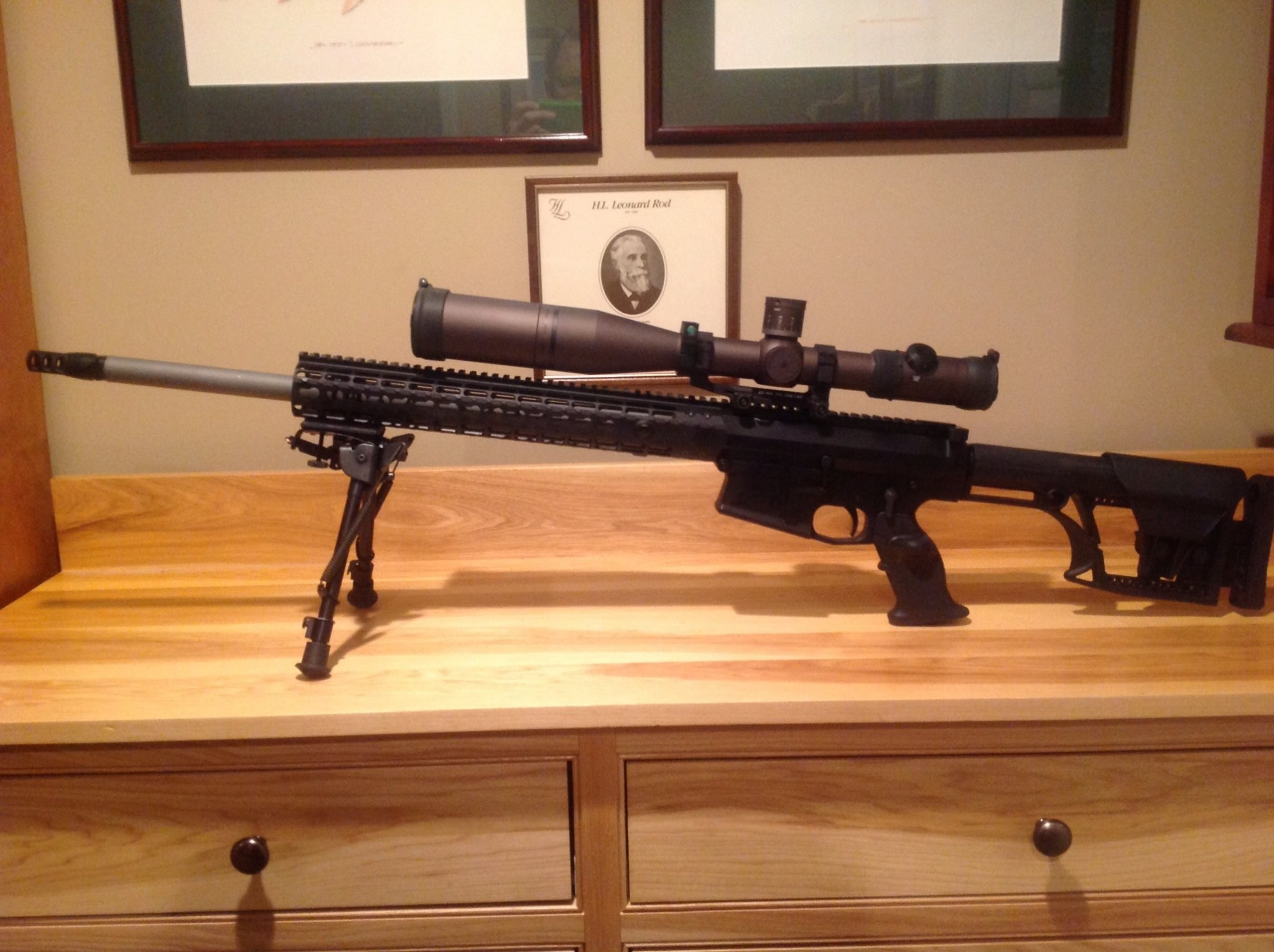

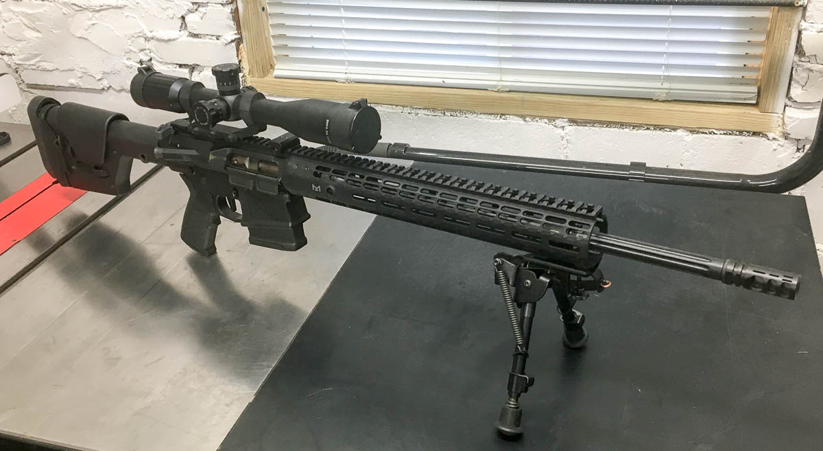

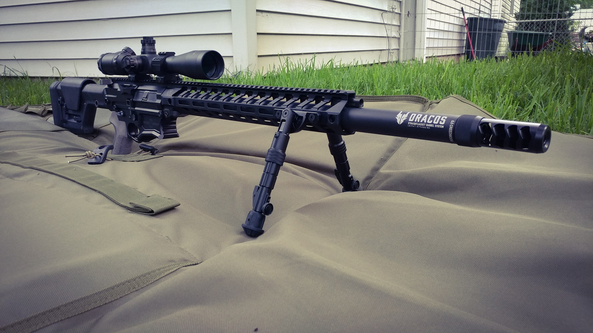

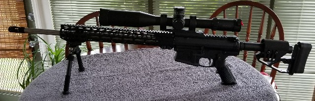

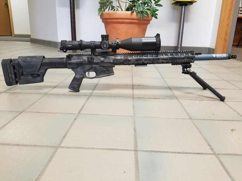

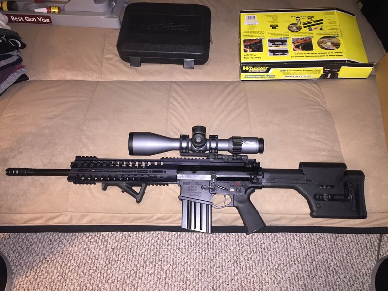

Just finished this build. 6.5 Creedmoor
Aero Precision upper, lower, bolt and hand guard
Magpul PRS gen 3
Rise Armament RA-535 Trigger
JP Silent Buffer
Athlon Cronus BTR
Larue Mount
Thunderbeast Muzzle Break
Dracos Barrel
It will need a few final adjustments but I wanted to get everything mocked up. Can't wait to get out and shoot it. 6.5 Creedmoor1.jpg6.5 Creedmoor1.jpg

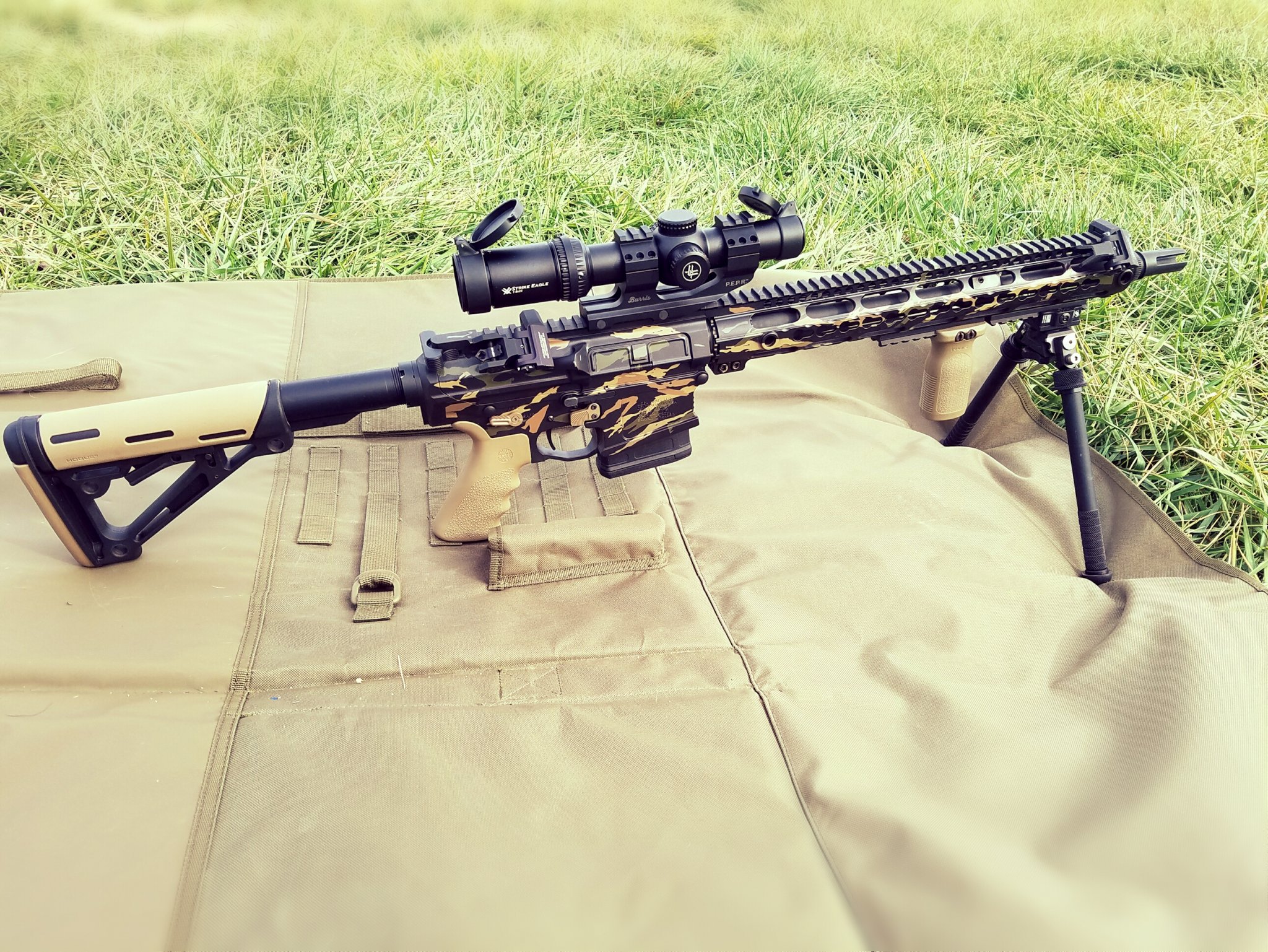

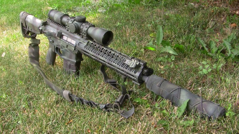

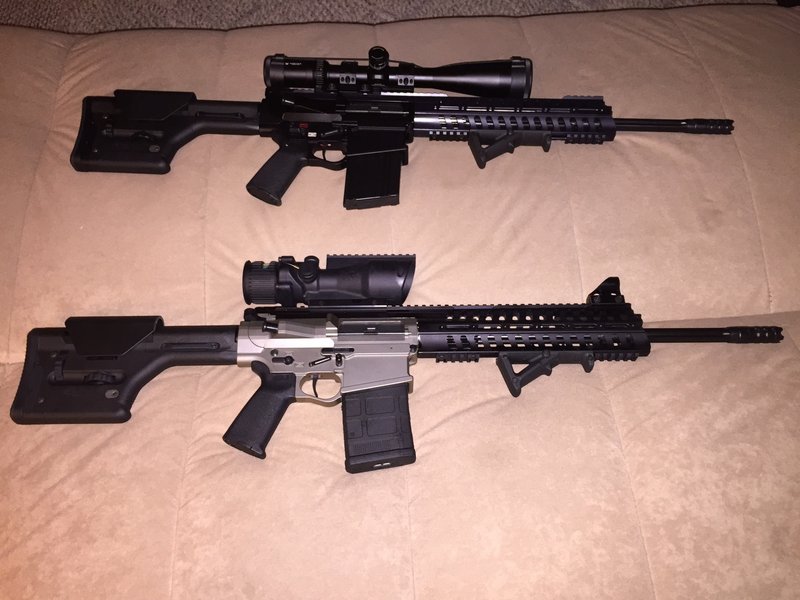

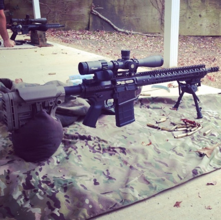

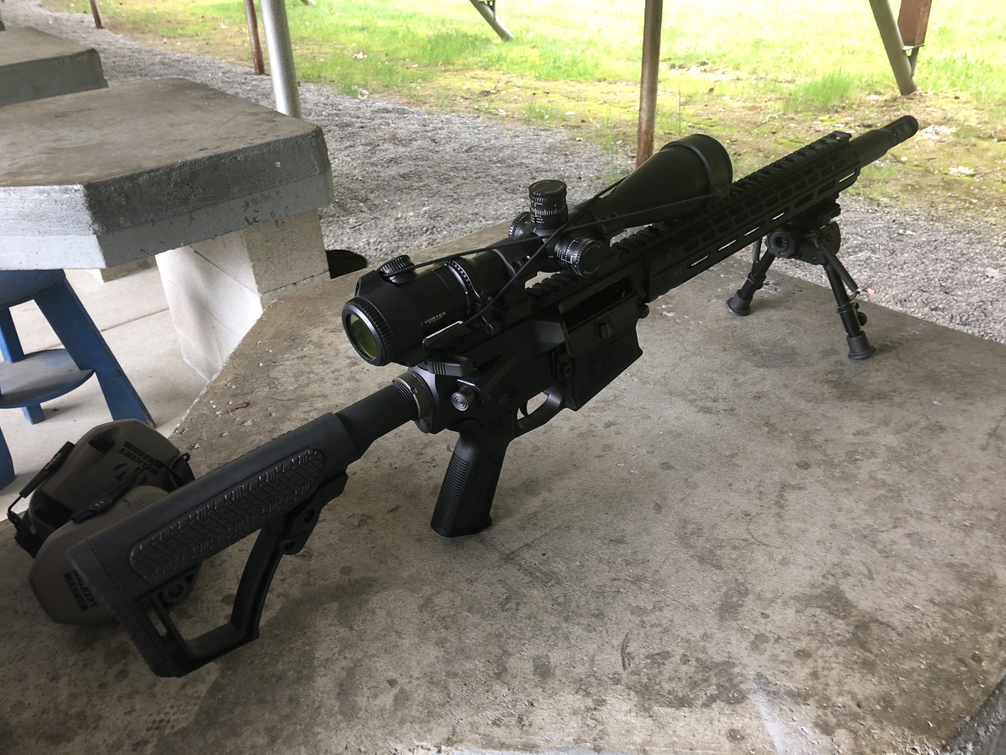

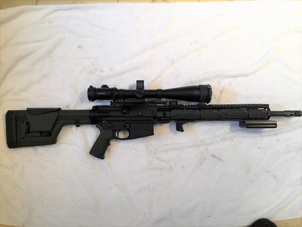

My personally owned but current deployed duty rifle:
16 inch Lanxang Tactical VL-34
Lothar Walther barrel
Geissele SSA-E trigger
Luth-AR MBA-3 stock
Sig Sauer Tango6 2-12 scope
Geissele Super Precision extended mount
Sig Sauer Romeo3 reflex sight on a 45 degree Daniel Defense mount
Harris bipod
This is an older picture but I also changed the brake to a Precision Armament M4-72
Looking to trade in the scope soon for the Vortex Razor HD Gen II 3-18

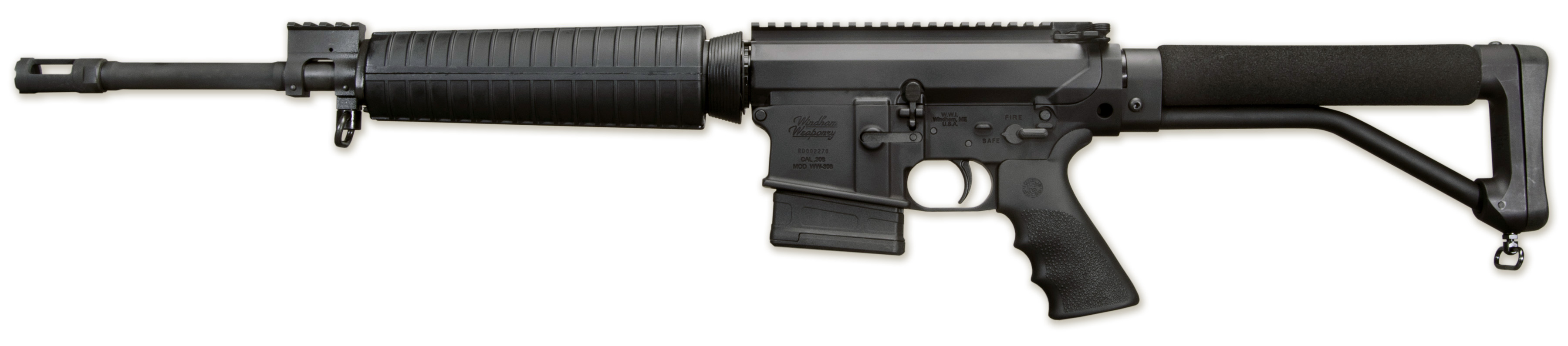

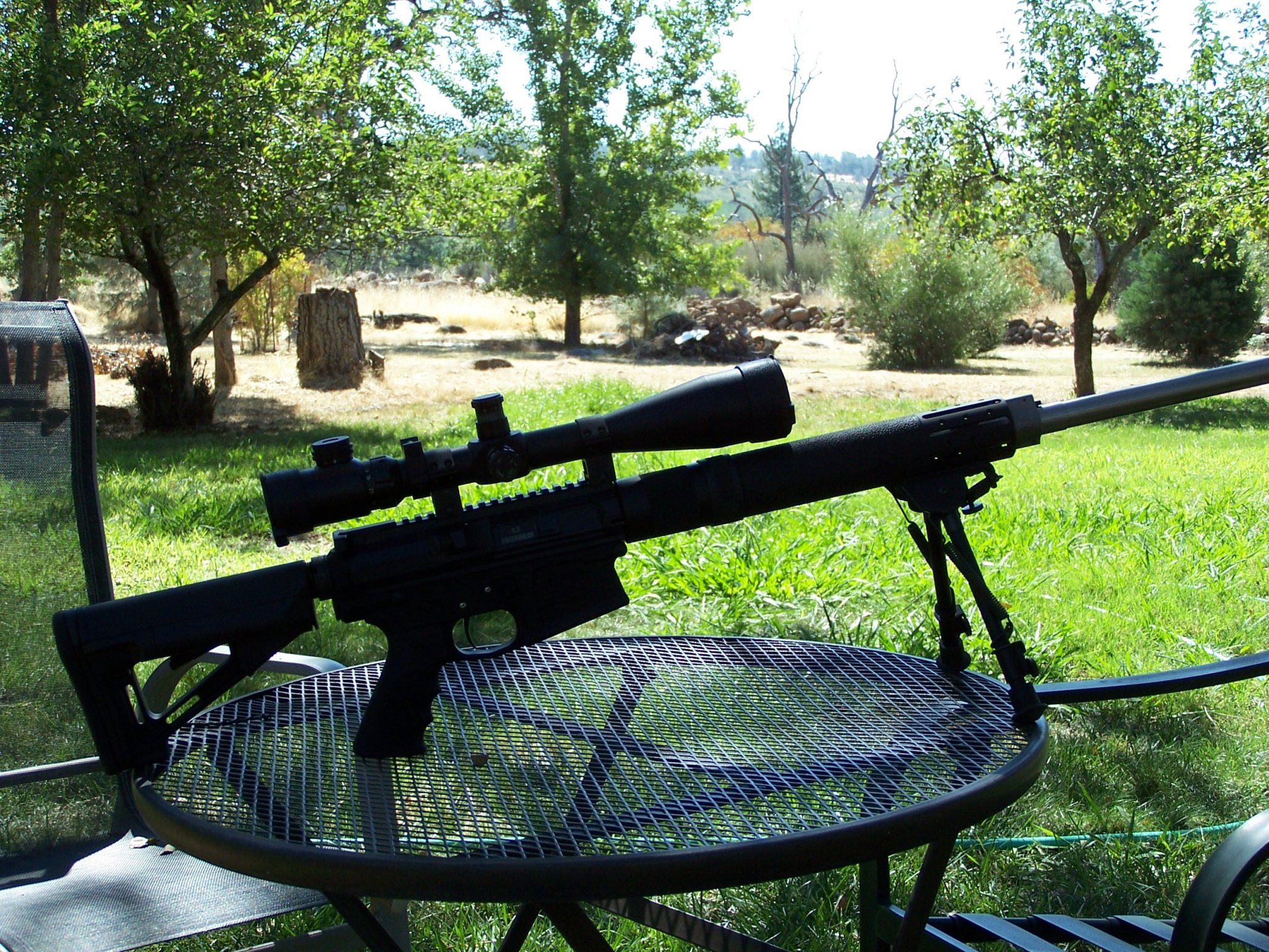

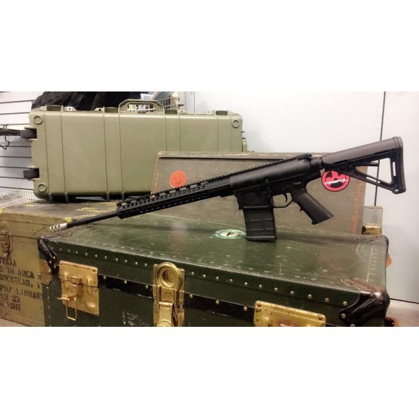

AR-10 .308/7.62 24" Long Range Premium Stainless Steel Tactical
Barrel: 24″ Rifle Length Stainless Steel, threaded
Chamber: .308 Win/7.62x51
Twist: 1 in 10”
Thread: 5/8x24
.936 Gas Block Diameter
Rifle Gas System
Flat top low profile DPMS style upper receiver
Forward Assist
Ejection Port Cover
X-treme Muzzle Brake
Rifle Length Free Float Slim Keymod Handguard
308/7.62 Bolt Carrier Group
308 Charging Handle
308 Lower Parts Kit
Magpul Moe Stock Assembly with 308 buffer and spring

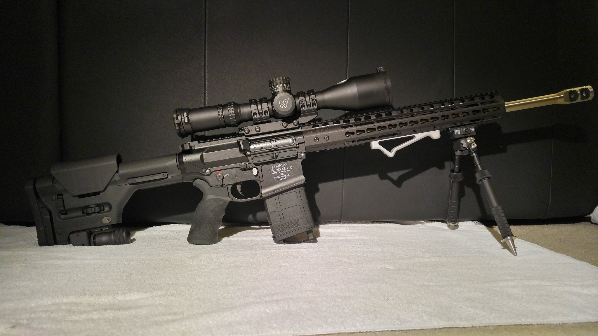

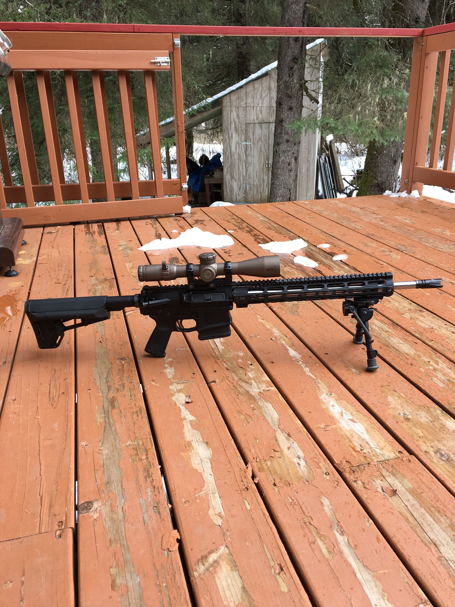

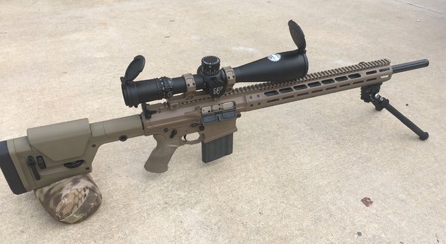

IMG_1517.JPG Mega Maten Mega Extended M-Lok set
22" 6.5 Creedmoor (+2" gas) Bartlein w/ JP extension
SLR Sentry 8 Gas Block
Magpul PRS Gen 3
Larue Grip
Geissele SSA-E
JP Silent Capture Buffer Spring
JP HP Bolt
POF BCG
V Seven AMBI Safety
Geissele Optics Mount
NF ATACR 5-25x56 Mil-C
Reactions: PorkChop and gnatmm

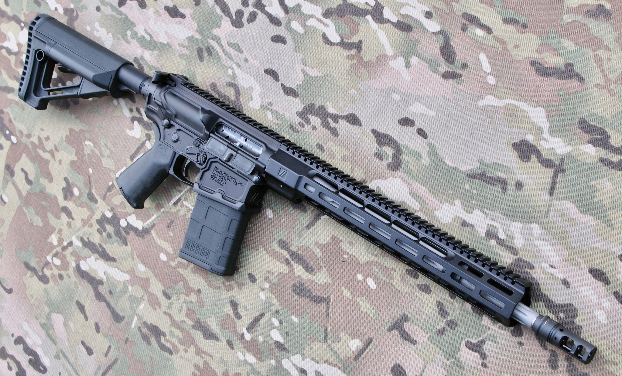

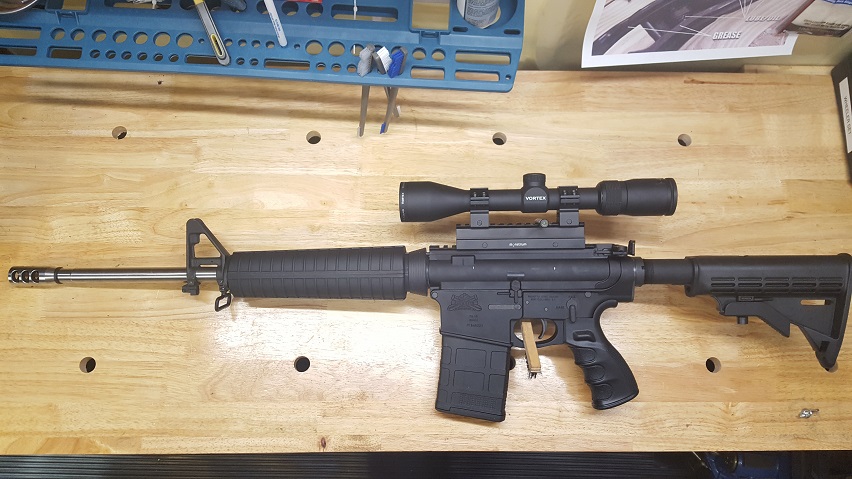

Budget build 308 Hunter.
Not truly "precision" AR, but holds ~1moa w/Hornady 165 Interlocks at 2625fps.
PSA (gasp!!) stainless 16" mid length
-RRA NM trigger (tuned a bit)
-Syrac G2 adj gas block
-GunTec Mlok
-Magpul ACS-L (for my tactical snacks)
-BRT Covert Comp (linear brake for putting all the bark down range)
-US Optics SR8C w/RWF 3 Gun reticle (BDC tracks w/in 1/2moa to 600yds with above mentioned load)
-roll of tape and krylon
Down the line it will get a JP high pressure bolt and a quality barrel.
Magpul PRS gen 3
JP Silent Buffer
Athlon Cronus BTR
Larue Mount
Dracos Barrel
nice barrel, id get a bigger muzzle though looks so little lol

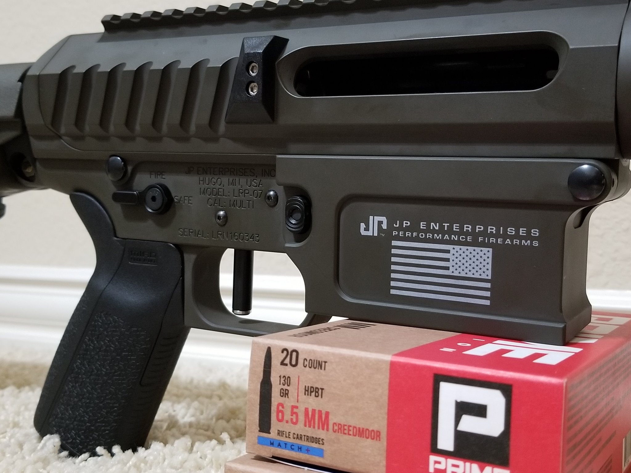

IMG_1028.JPG Just finished the build.
Aero m5e upper receiver
Aero lower
Areo lpk
Geissle ssa e
Noveske bad ass charge handle
Jp 18" light contour barrel with rifle length gas tube
Jp low mass bolt carrier
Jp hp bolt
Jp silent capture buffer spring
SLR adjustable gas block
APA little bastard brake gen 2
Magpul stock and grip
Trijicon 1-8x28 accupower
JP-LRP07
6 Creedmoor
22"
JP adjustable gas block with detente adjustment screw.
Silent capture spring.
Total awesomeness
JP Coupon code: 43SS1015
5% off major builds
10% off accessories.

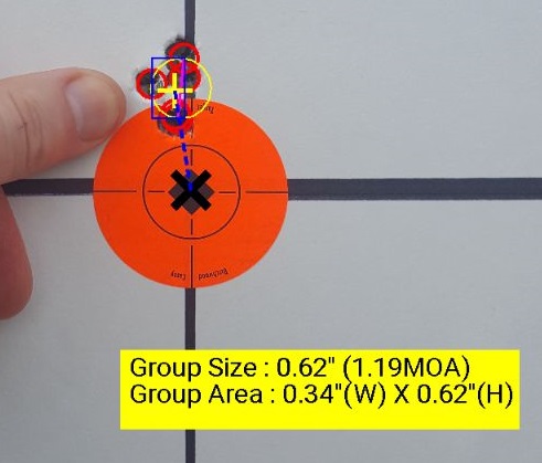

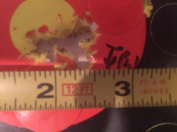

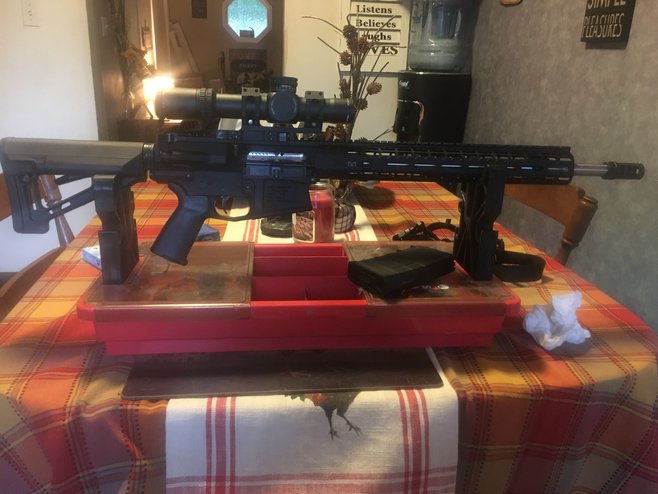

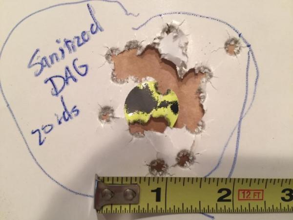

PSA carbine, Criterion 18" Middie barrel, trued receiver face and Loctite 609 , LaRue MBT, some QC , burnishing and polishing from me ( what do you expect from a $700 initial purchase ) Vortex 6-24x50 PST FFP EBR-2C MOA
100yd groups, benched bagged front and squeeze rear... 5rds FGMM 168gr, 20rds "rapid fire DAG"

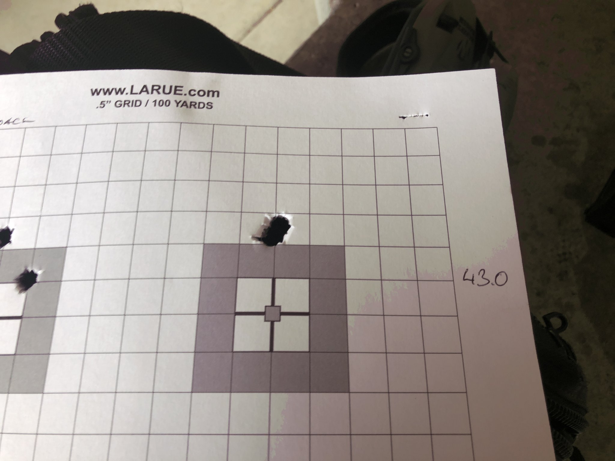

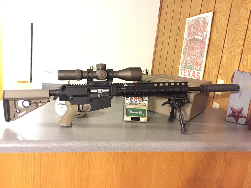

This is my first precision build. I've moved quickly to a bolt rifle. Or soon to be. I just received 200 rounds of Federal Sierra Matchking to take out beyond 100. I assume I'll be collecting this brass and reloading as I'm going to start w/ the bolt gun in 6.5. I'll try and report back some groups at distance.
Finally finished this build. PSA Gen I lower w/ Geissele SSA-E and Strike Ind. flat wound AR10 buffer spring. PSA Gen II upper 18" SS. PA 4-14 ACSS reticle on Aero Precision mount. Magpul Pro BUIS.
The groups were using 175 gr. Federal Sierra Matchking. 90 total rounds in 90 minutes. Zero malfunctions. Extremely happy.

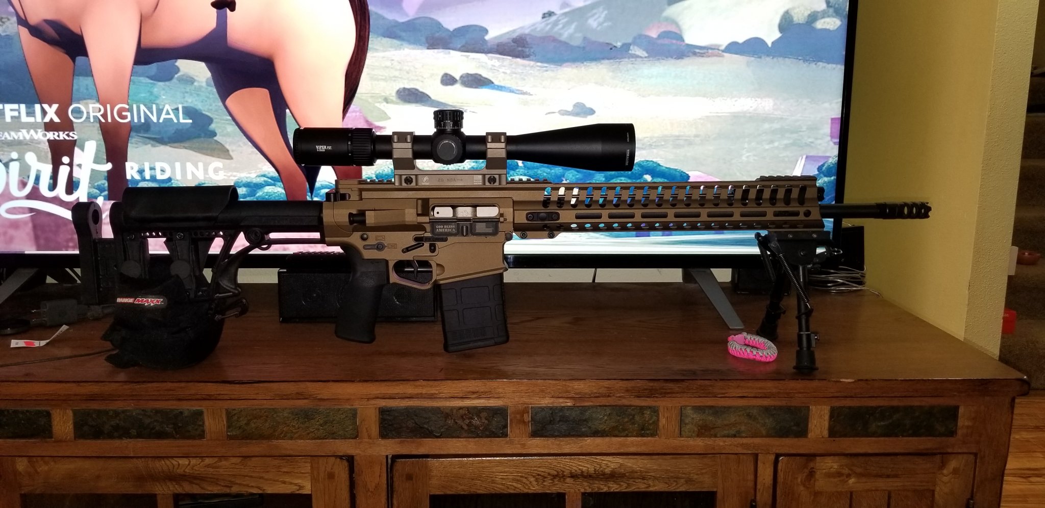

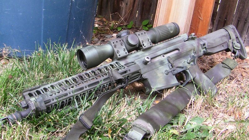

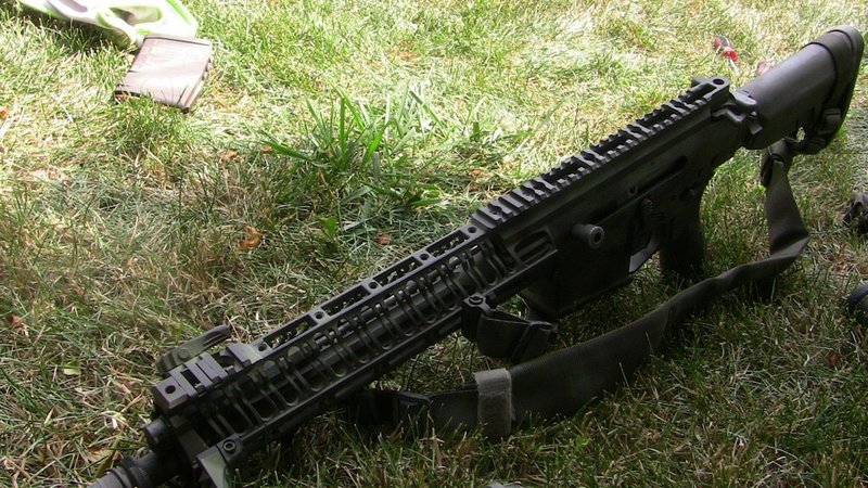

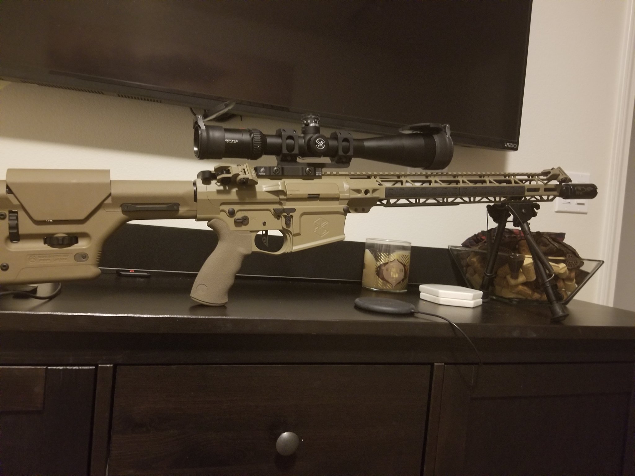

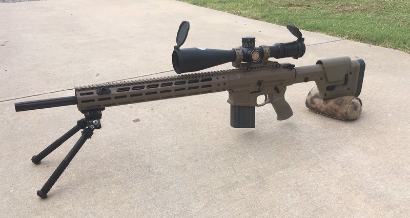

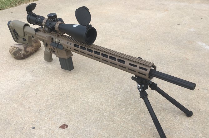

Here is my most recent build:
- Aero M5 upper and lower, Cerakoted a custom mix of burnt bronze and midnight bronze.
- Troy 15" MLok rail, Cerakoted burnt bronze.
- 20" Ballistic advantage 6.5 CM barrel.
- Brownells NiB BCG (looks alot like a Toolcraft BCG).
- Geissele SSA-E trigger with a yellow JP trigger spring (nice, crisp 2.5lb break).
- Bushnell 4.5-18x44 LRTS in an ADM Recon mount.
- Stock has been switched to a FDE SOPMOD with an LMT/Ergo grip.
I will be adding a Surefire SOCOM muzzle brake so that I can mount my can, as well as a Geissele Super Charging handle and upgrading to a Geissele Super Precision SR-25 20-MOA mount in the very near future.
I love the look and feel of this beauty. I'll be taking it to the range this weekend for the first time...can't wait.

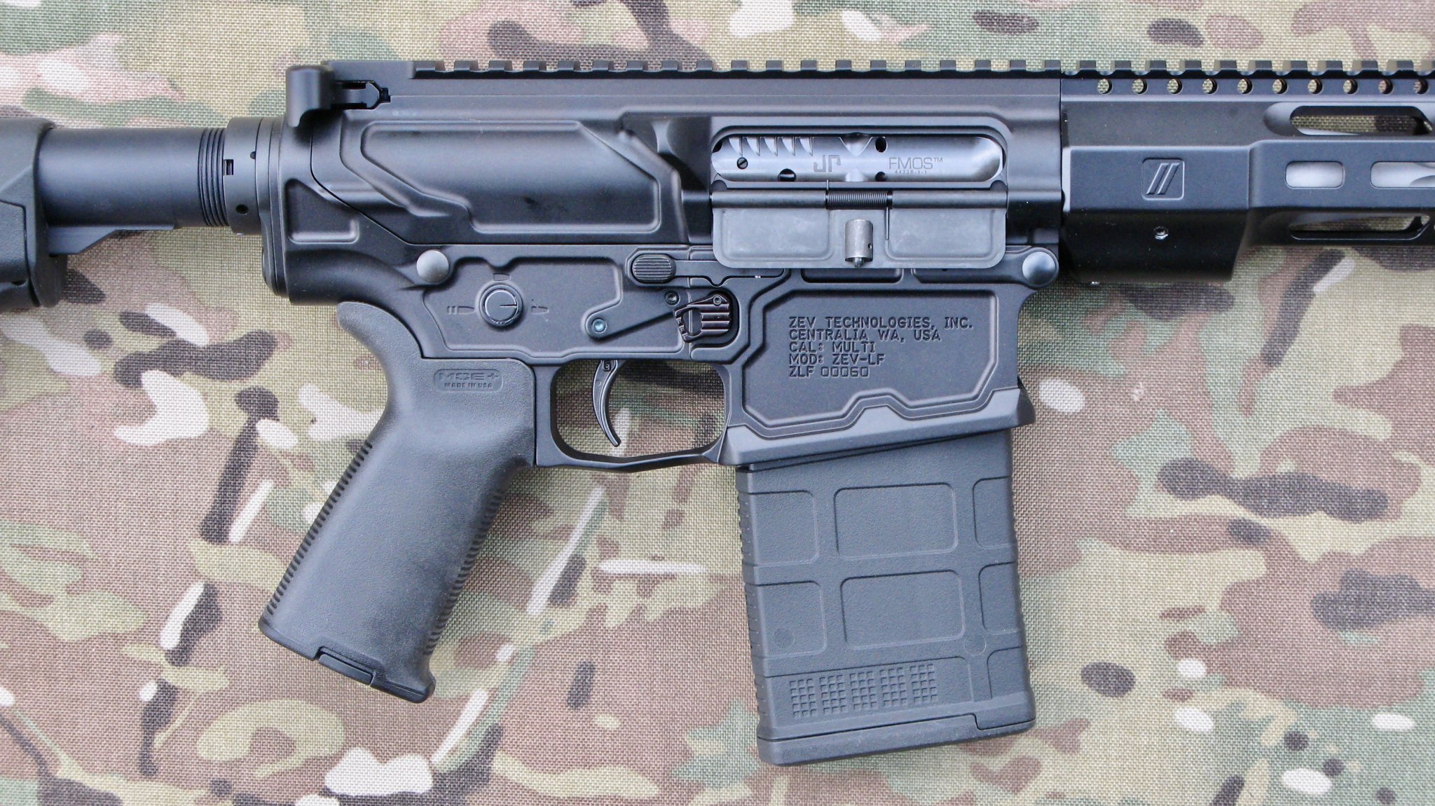

Who doesn't like a handsome big block gas gun that weighs in at what most small block 5.56 guns weighed just a decade ago? This 16" .308 sports a not-so-sveldt fluted Bartlein by Craddock Precision with an intermediate length (KAC) gas system with a full mass JP bolt carrier group (high pressure type) and a fairly heavy Magpul STR buttstock. Yet the rifle weighs in at just a few ounces over 8 pounds!
Who doesn't like a handsome big block gas gun that weighs in at what most small block 5.56 guns weighed just a decade ago? This 16" .308 sports a not-so-sveldt fluted Bartlein by Craddock Precision with an intermediate length (KAC) gas system with a full mass JP bolt carrier group (high pressure type) and a fairly heavy Magpul STR buttstock. Yet the rifle weighs in at just a few ounces over 8 pounds!View attachment 6886595View attachment 6886596View attachment 6886597View attachment 6886598

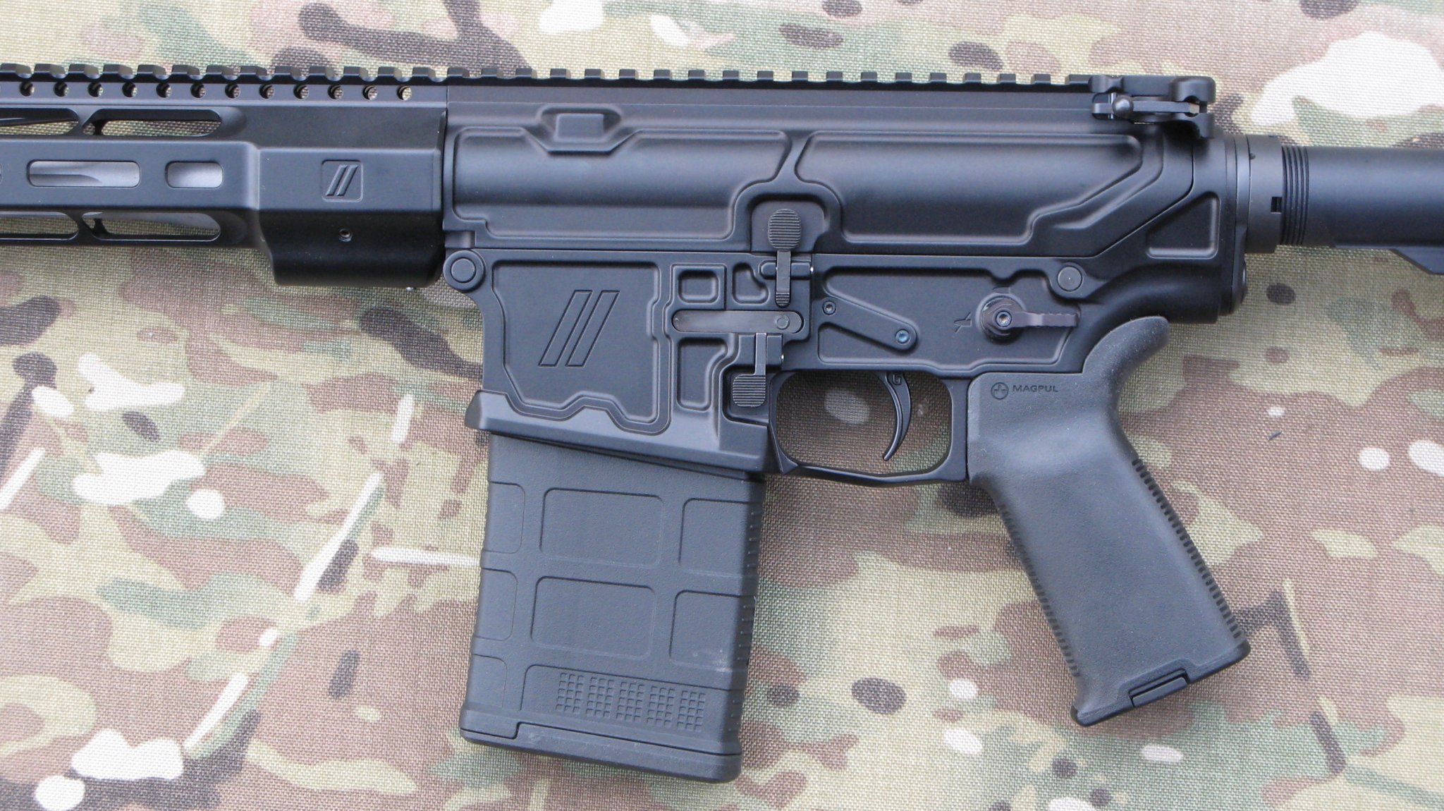

Interesting. Didnt know Zev did rifle stuff, how do you like those receivers Mr Wes?
I have a couple. Waiting on a Saker ASR 762 can to try out on them. I really like them both.

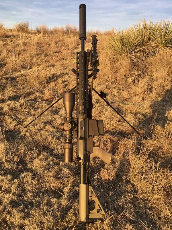

First up (6.5mm Creedmoor):
22" Rainier Ultramatch 6.5mm Creedmoor barrel
Aero nitride BCG
15" SLR Intrepid rail
SLR Sentry 9 adjustable gas block
Nitride rifle length gas tube
JP muzzle brake
LaRue LT745 QD 20 moa 34mm scope mount
Steiner 5-25x56 M5Xi Military
Flatline Ops scope level
Aero charging handle
XLR stock
JP silent captured spring (H weight configured)
Magpul MIAD grip
BAD-ASS ambi selector
AR Gold trigger
Atlas QD bipod
Next up (6mm Creedmoor):
22" Wilson Combat match 6mm Creedmoor barrel
Toolcraft nickel boron BCG
16" SLR Solo rail
SLR Sentry 8 adjustable gas block
Stainless rifle length gas tube
Wilson Combat Q-Comp comp
Steiner 3-12x50 Miltary/Tactical scope
XLR stock
A2 grip (to be changed)
Elftmann Tactical Match adjustable trigger (full rifle pic has LaRue MBT, was changed after ~80 rnds)
Atlas QD bipod

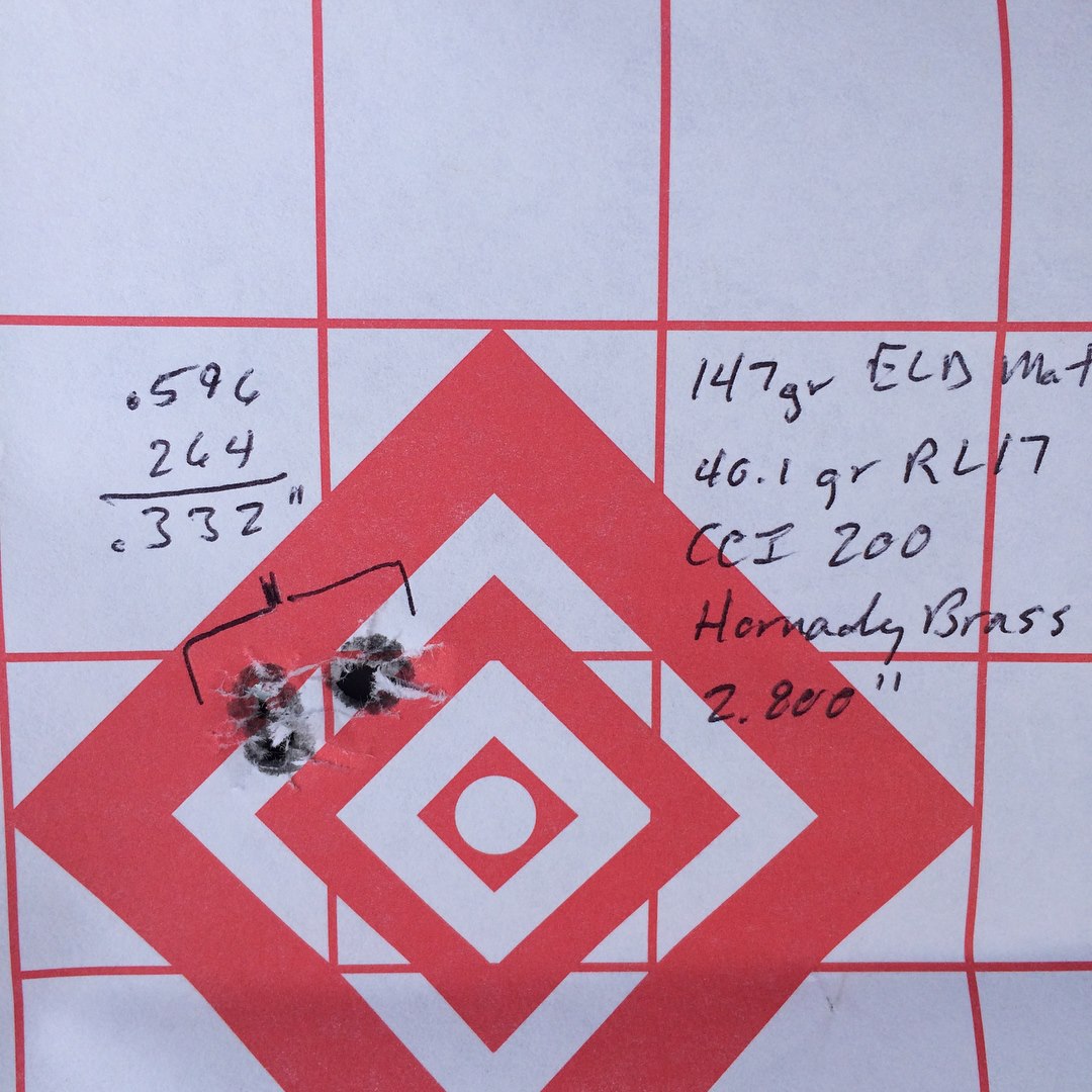

Shoots sub-MOA with 168 grain FGMM and reloaded clones
3 shot group with 175 SMK and Varget.

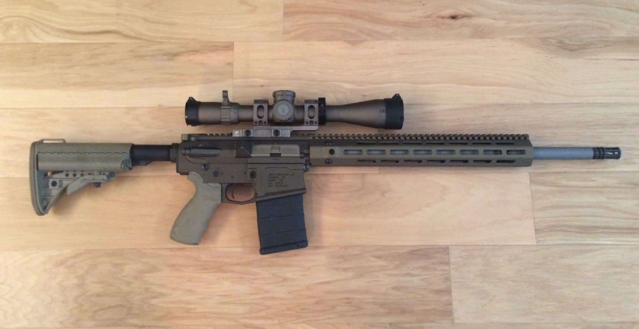

*EDIT* Finally got a chance to put some rounds down range with this, and all I can say is wow! The 6.5 Creedmoor is like cheating in the wind. I'll be taking her out to 1000 yds this weekend.

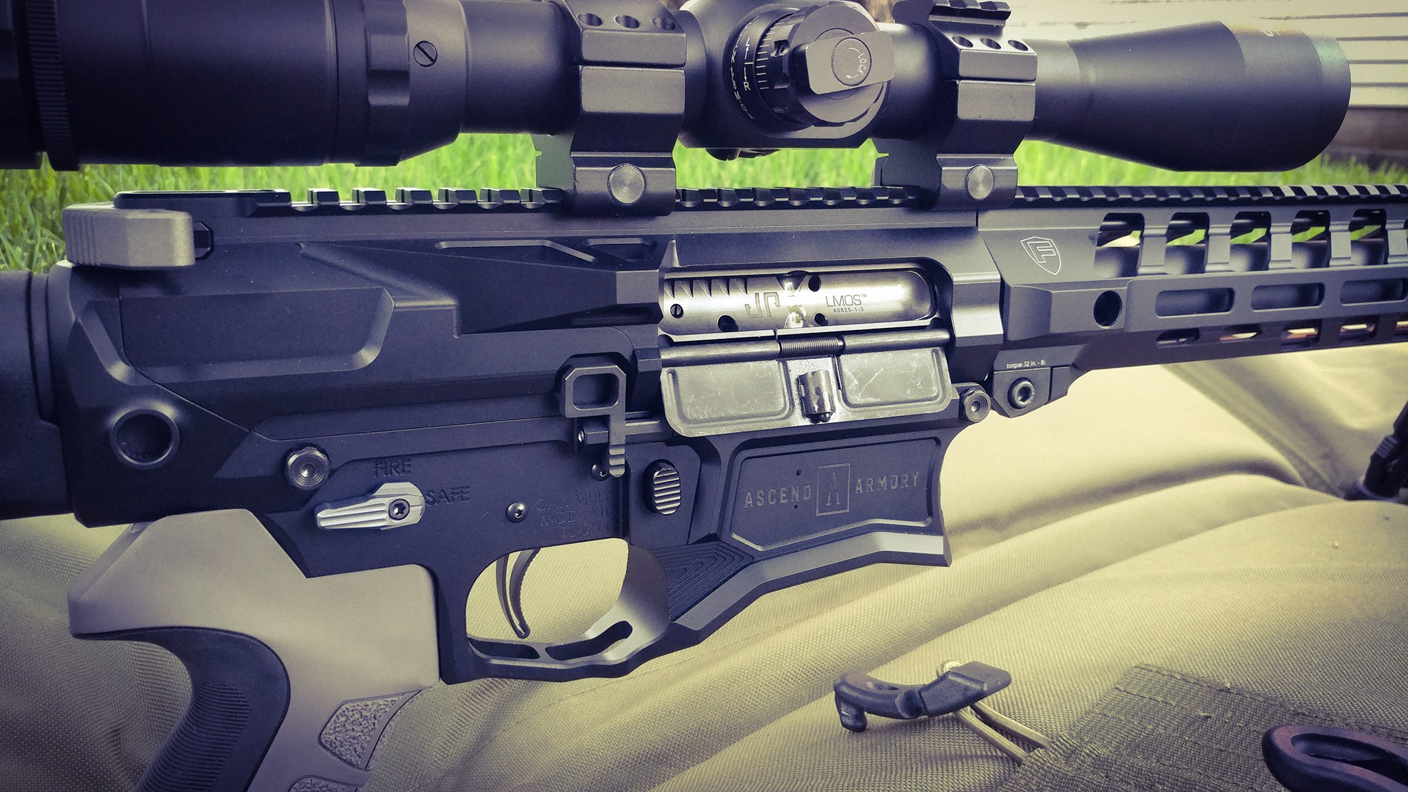

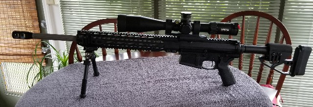

Here's the build list,
-Ascend Armory 7075 Match Receiver Set
-JP Low Mass Bolt Carrier w/high pressure bolt
-JP Silent Capture Spring / buffer assembly
-Draco's 22" 6.5 Creedmoor barrel
-Area 419 Sidewinder Brake
-Elftman .308 Match Trigger
-Fortis 15" Switch Rail
-Magpul PRS Stock
-Radian Raptor Ambidextrous Charging Handle
-Leaper UTG MLOK Bipod Set

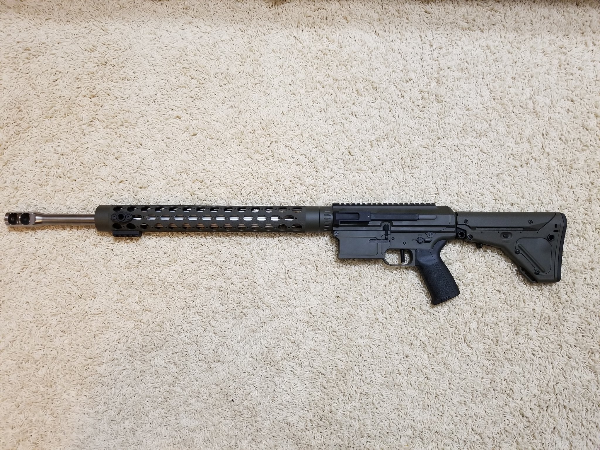

Wow, some awesome stuff here. I'll add my humble budget rifle and hope it doesn't stain the thread :)

This is a Palmetto PA10. I have been on disability since December due to my back issues so my funds are limited. I have had good luck with Palmetto in the past so I decided to take a chance on this. I told myself that I would be happy if it is a 1.5 MOA rifle at best.
This group was shot with an early load workup consisting of '87 LC brass, Factory seconds Sierra 168gr MK and 4064. I am still developing loads and working on the rifle, so groups should only improve. I have around 350 rounds through this and the only malfunction I've had was caused by my brass catcher.
When I shot this attached group, I still had the horrible mil spec trigger, a 15 dollar pawn shop scope sitting so low you could hardly scrunch down to get a sight picture, and of course the barrel is not free floated. It also had the Magnetospeed chrono on while shooting. Not bad for a budget rifle for someone who is in so much pain they can hardly sit still to shoot...
In the picture I have the new Vortex Diamondback 4-12 scope on and the riser which is temporary until I get the money to buy a proper handguard and gas block to free float this bad boy. Then I will get a proper mount/rings... I have also installed a RRA 2 stage match trigger which should really help my groups as well. This had a particularly bad and heavy milspec trigger when I got it.
I'm also getting a spinal fusion surgery so hopefully I'll be less gimpy soon!
Sorry for the long rant.... Now to the pics.
Specs:
Palmetto Gen 2 PA10 (535 bucks shipped!)
18" Stainless 1:10
Ebay special muzzle brake
Ebay special grip
Monstrum tactical riser
UTG cheap-o rings
Vortex Diamondback 4-12x40 scope
Upper Parts
JL Billet Upper/Hand guard
Faxon 18’ rifle length barrel
Noveske KX5
Odin adjustable gas block
Spikes Tactical Nickel Boron BCG
Spikes Tactical gas tube
Strike Industries dust cover
BCM Mod 3 charging handle
Magpul Bipod adapter
Harris 9-13 bipod
Troy Industries Dioptic offset BUIS
Lower Parts:
JL Billet Lower
CMMG lower parts kit
CMC single stage flat trigger
Ergo pistol grip
Battle Arms 45 degree ambi safety
Luth buffer tube and spring
Enidine buffer
Magpul PRS stock
Optics:
American Defense Recon QD 30 mm 20 MOA Mount
Vortex Viper LR 6-24X50
