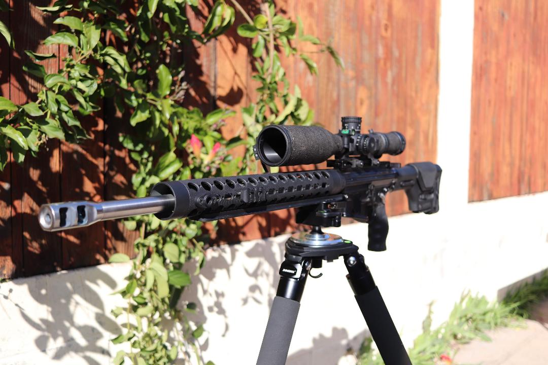

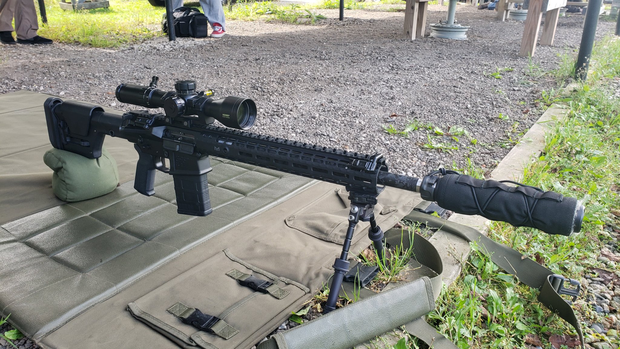

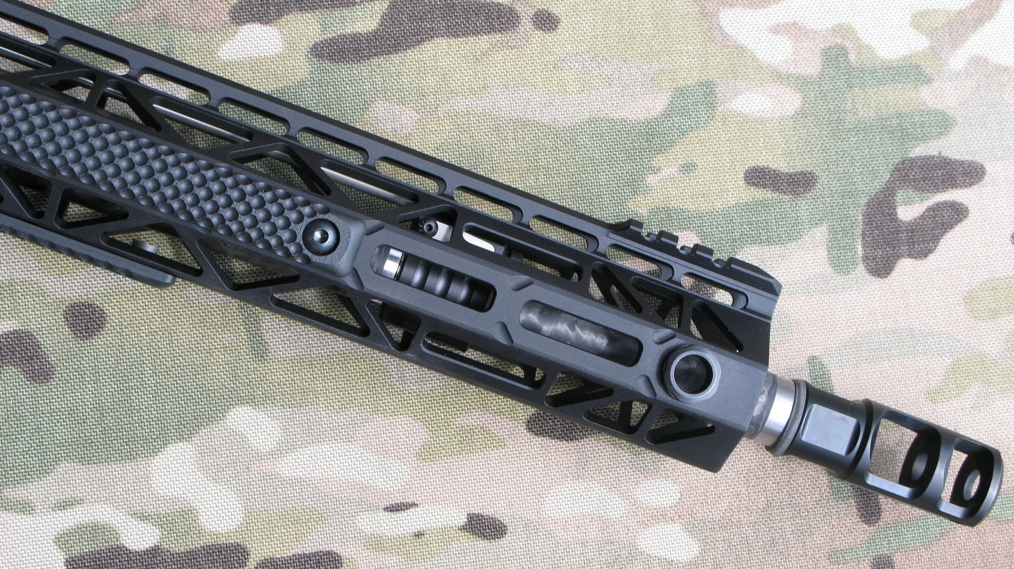

Lewis Machine and Tool LM8MWS Upper Receiver with MARS-H Lower Receiver, 20" SS barrel Fat Bastard Brake, Harris bipod, Nightforce NX8 2.5-20, Geissele mount, Geissele SSA-E trigger, LMT DMR buttstock.

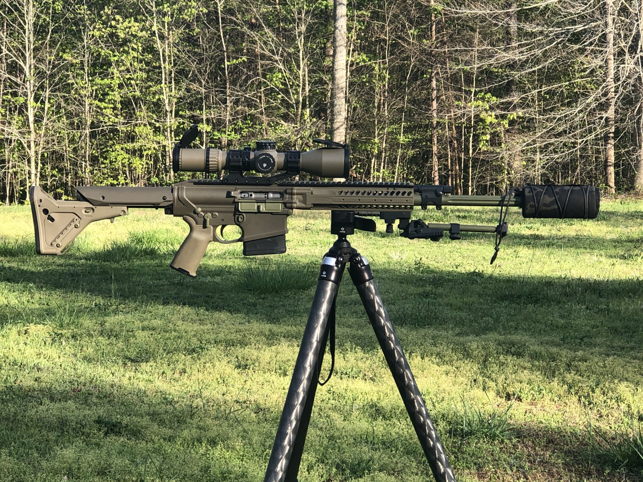

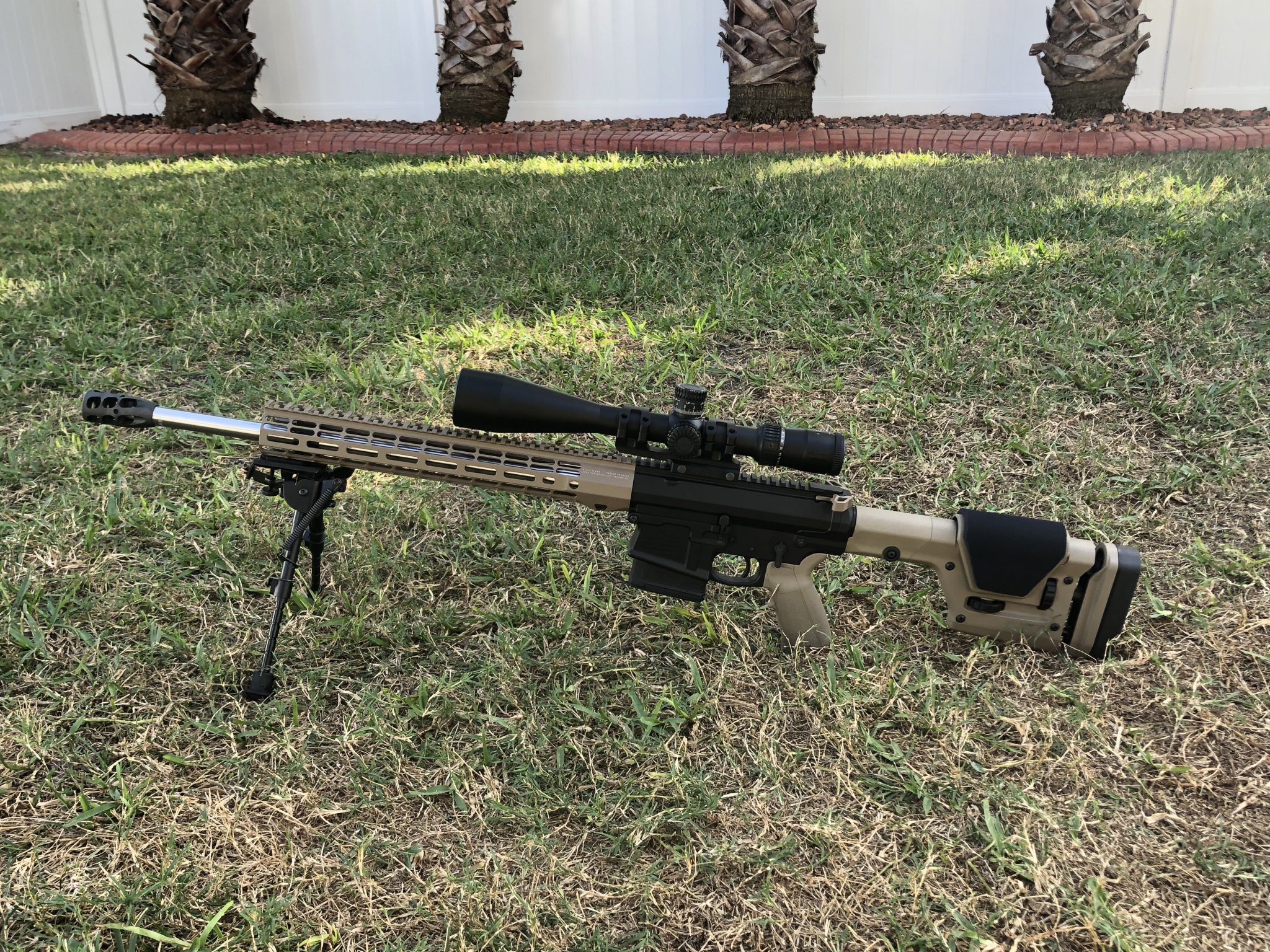

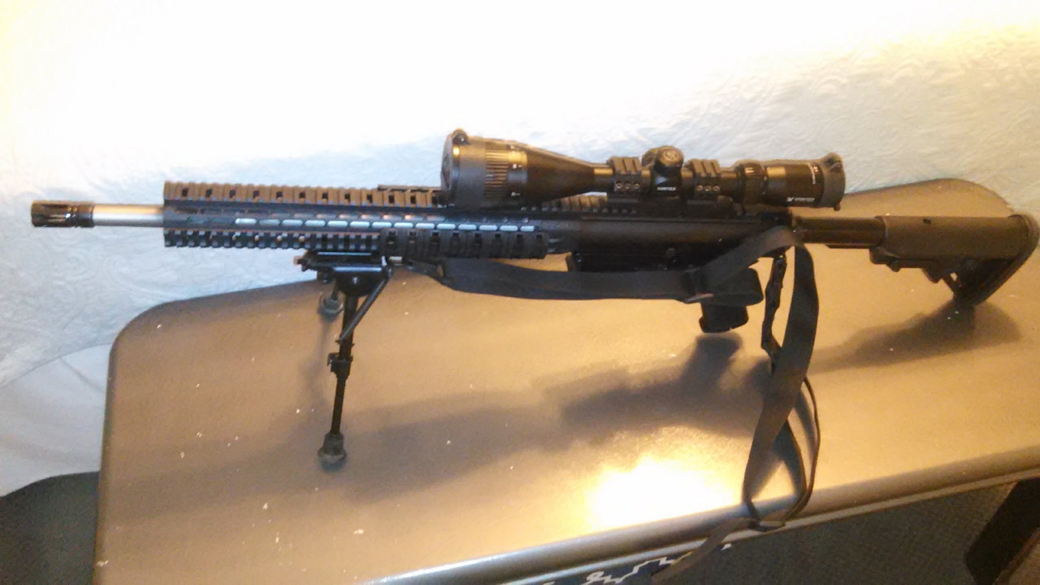

New to the forum and LR. Here's my first (cheap) gas build.
- PSA Lower
- OdinWorks upper 24" 6.5 Creedmoor (1 MOA barrel)
- Griffin Explorr (Until my TBAC comes in). Took 60 days to get the griffin out of jail!
- UTG Bipod
- Sightron S-TAC Duplex :( riflescope
- Timney trigger on it's way.
I like how light and simple the rail is on the Odin.
Looks great, I just got the 22 inch odin 6.5cm upper. Does it have the +2 gas tube?
How does the utg bipod hold up?

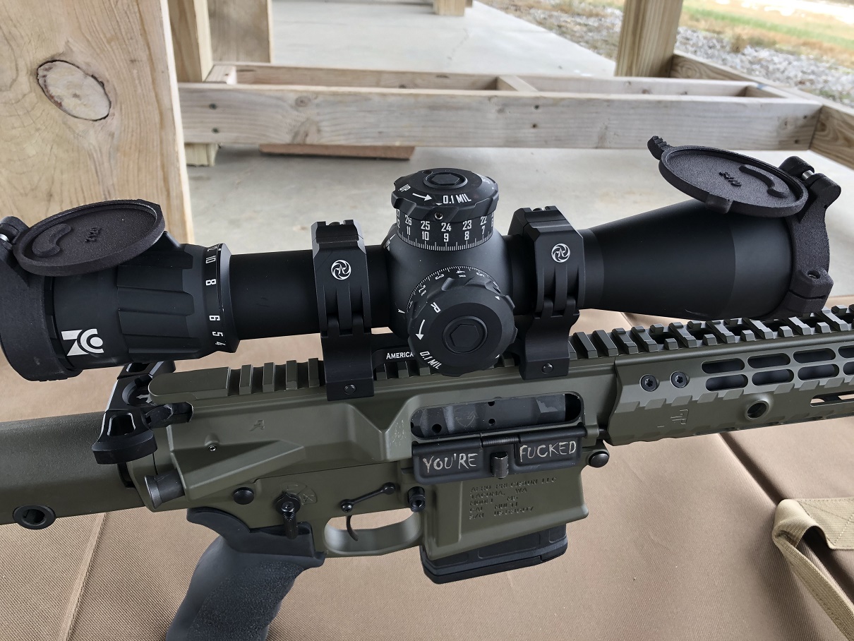

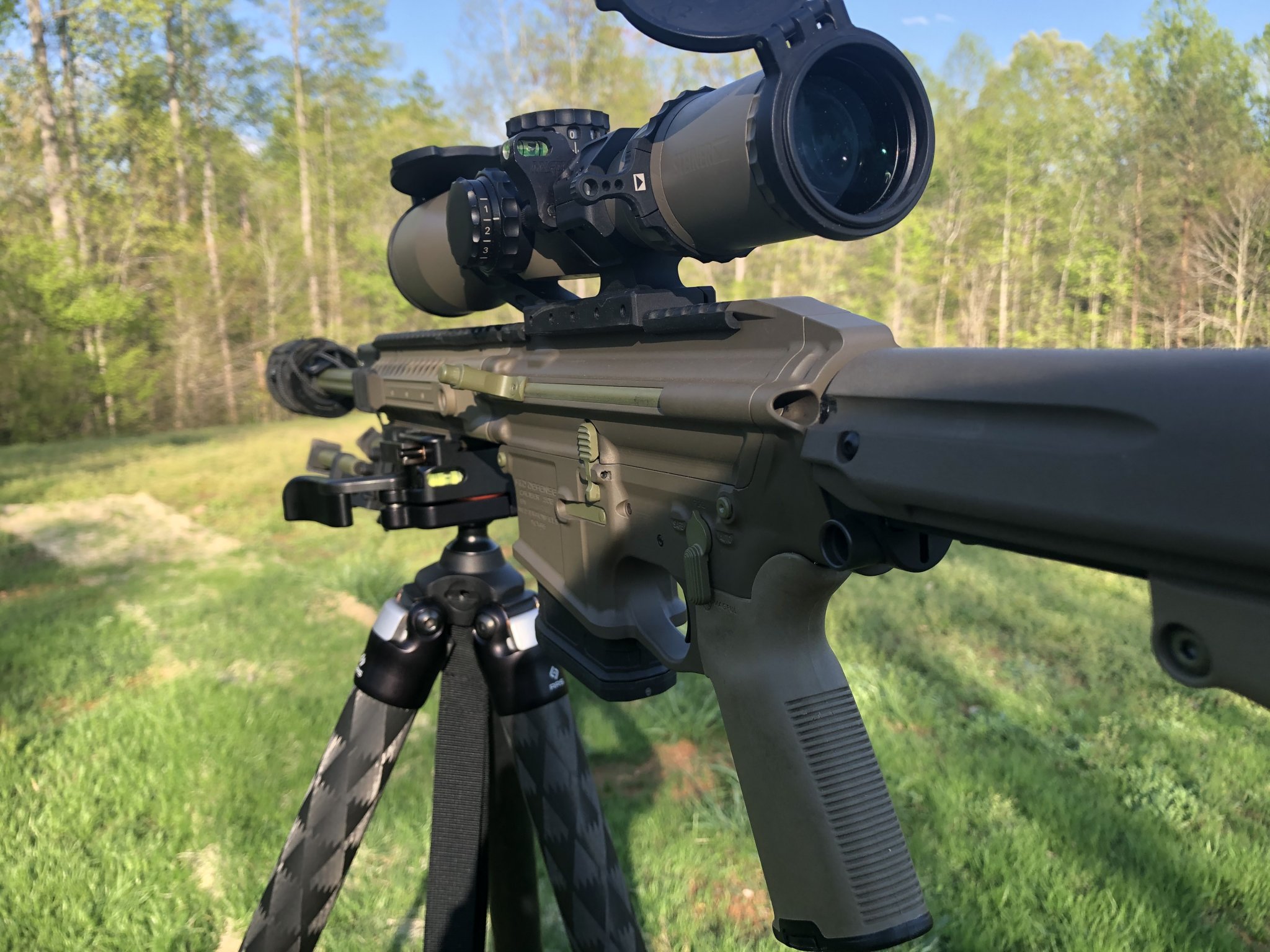

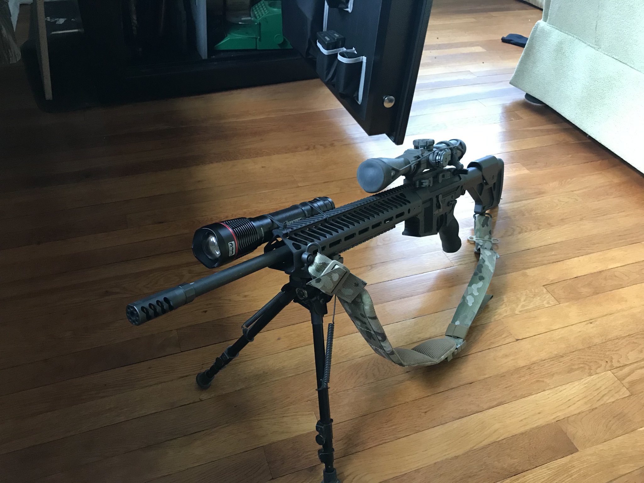

I put this AR10 in 6.5 creedmoor together several weeks ago. The build is as follows:
Aero Precision M5E1 builder set. I had the set cerakoted OD green...turned out great, IMHO.
Dracos 22" barrel in 6.5 creedmoor
DT Brake (fits my suppressor)
Rubber City Armory Titanium BCG ( the bolt isn't Ti, just the carrier)
JP Silent Capture Spring
Triggertech AR Diamond trigger
Ergo Grip Tactical deluxe grip
POF Charging handle
Magpul PRS stock
ZCO 427 scope
ARC mount (20moa)
Of the variety of ammo I've tried so far it really likes the Hornady American Gunner ammo, and the 147 grain Hornady match ammo. I really wanted it to like the Berger ammo for the lapua brass (for reloading), but that ammo shot the worst of everything I've tested thus far.

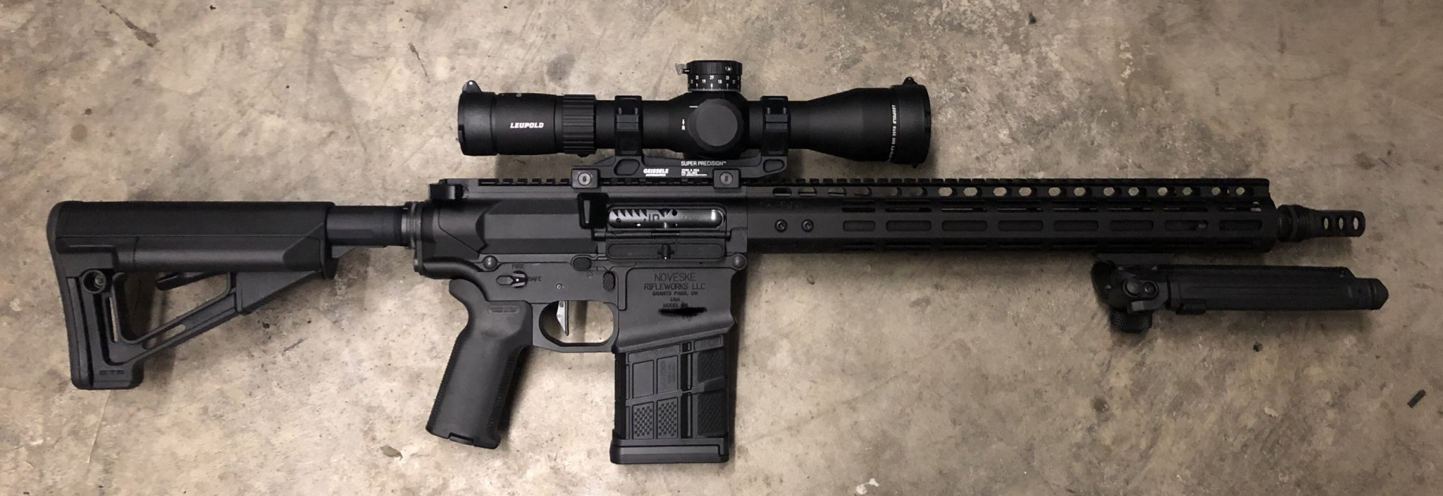

Built out a "budget" gas gun (is anything in long range actually budget though?...)

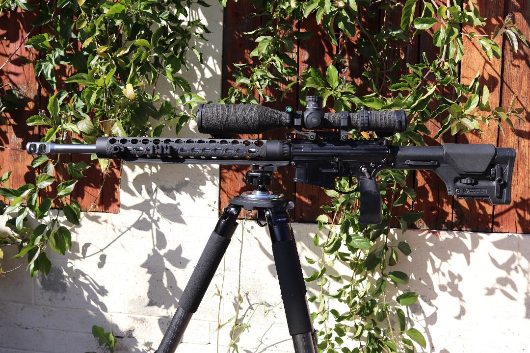

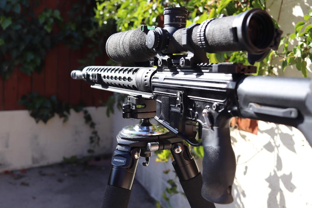

-Aero M5 upper/lower/handguard
-Vortex 4-16 mil/mil (freaking LOVE this glass)
-BHW 20" BBL with a 1:9 in .308
-LaRue MBT-2S
-Little Bastard brake
Things a tack driver.

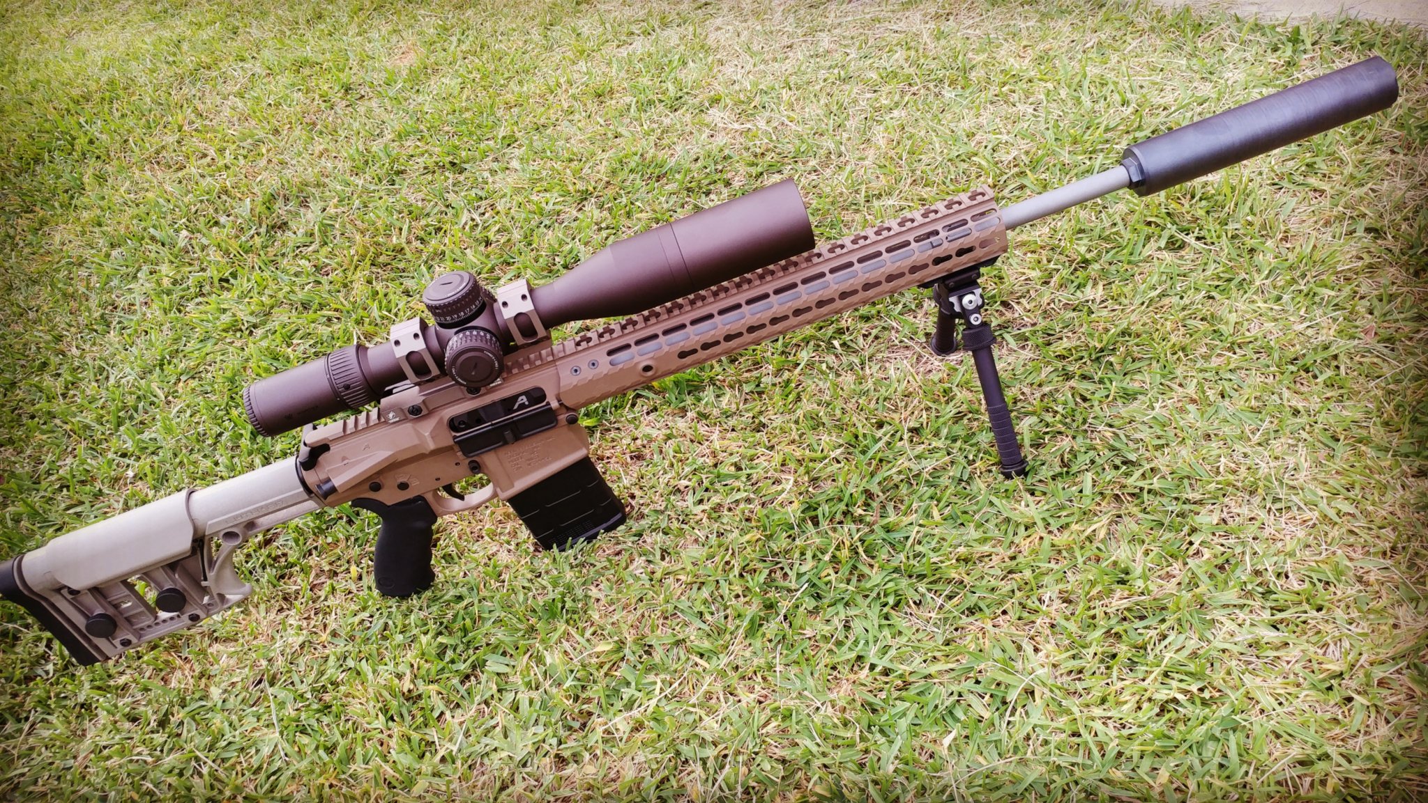

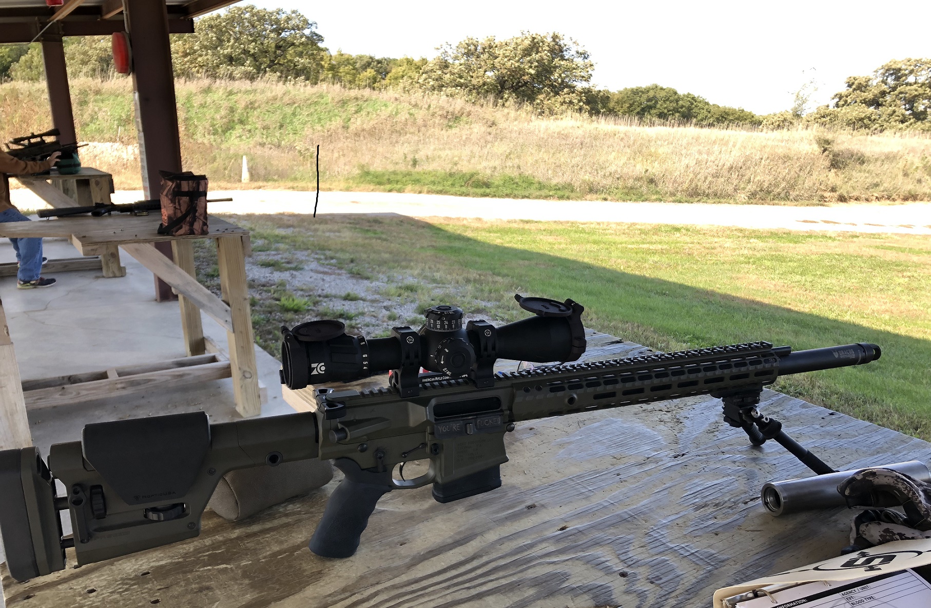

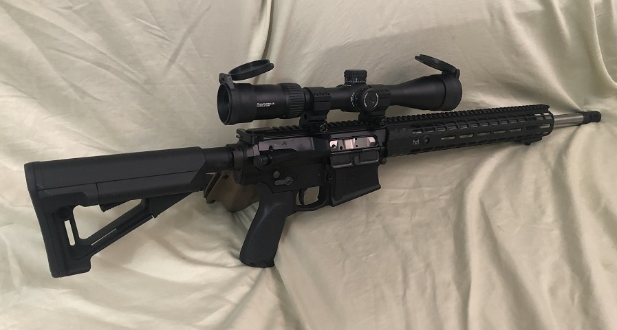

my 6.5CM upper build. Lower is just my workhorse/mule that I swap around to various uppers.
Aero M5 upper
Faxon 24" barrel, rifle-gas
Brownells HP nitride BCG
SLR Solo Lite 16" KM
SLR Sentry-7 adj GB
Armalite AR-10 rifle gas tube, painted flat black
VG6 65 Gamma brake, PA shims
dust cover by CustomARDustCovers
Rainier Avalanche charging handle
Vortex PST Gen I 6-24x FFP MRAD, SV-2 throwlever
AD Recon-S scope mount
Aero M5 lower, Geissele HS-NM, B5 Bravo stock, POF carbine buffer tube, Norgon ambi, KNS Gen G pins, KAK 5.3oz 2.5" buffer, Slash/Heavy-Buffer 308 carbine spring, CPD 20rd mag.
shot it this past weekend, after dialing in the gas block for last-round bolt-hold-open, no feeding issues, perfect functioning with factory ammo: Federal 140gr soft-point and AE 120gr OTM. Very pleased with the accuracy, but was only plinking at 600yd and 800yd steel silhouettes, the fun stuff. Follow-up shots can be done quickly, before the preceding round hits at those distances, but then you don't get to hear the gratifying "ting" on the steel.
Armalite gas tube extending into upper receiver. please ignore the liberal slathering of grease, just a mock-up assembly to check fit. Gas tube does not bottom out in carrier gas key.

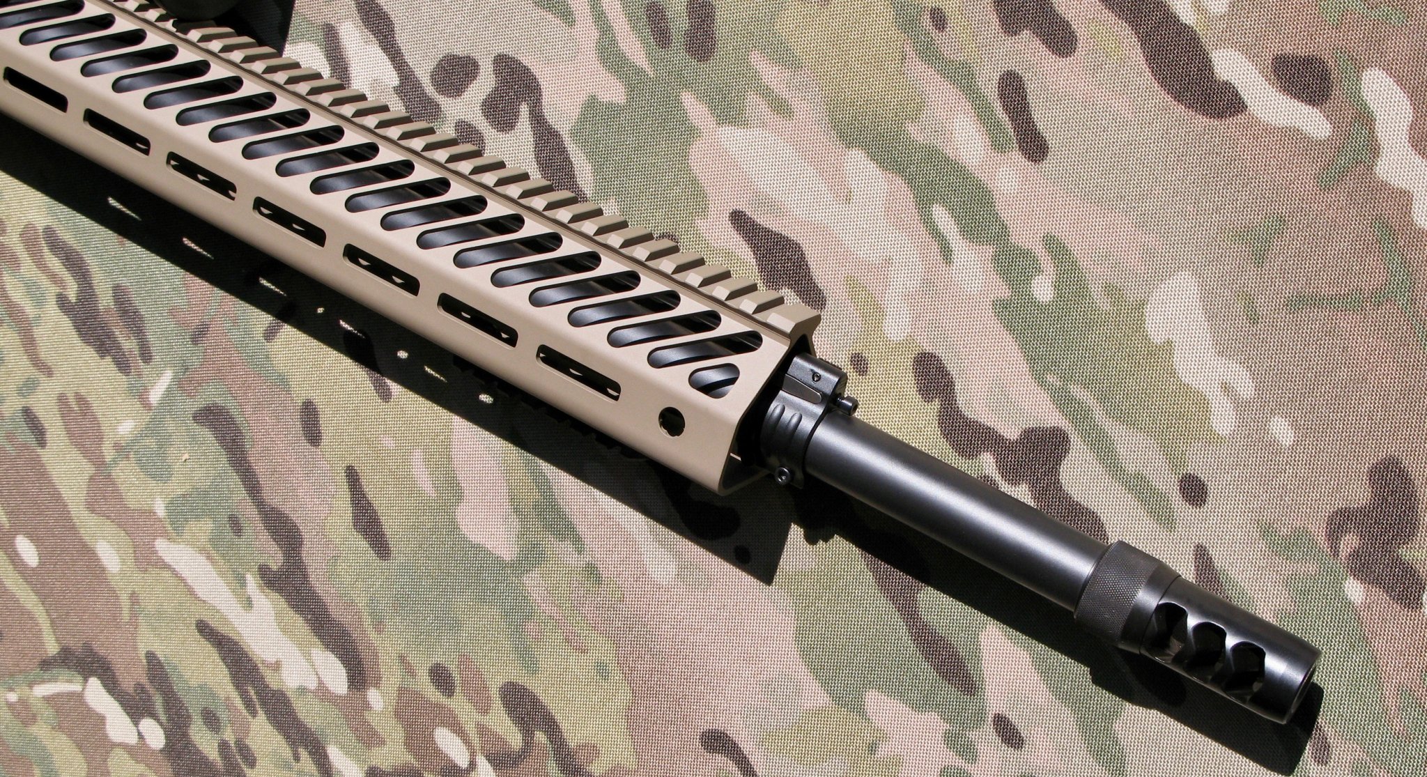

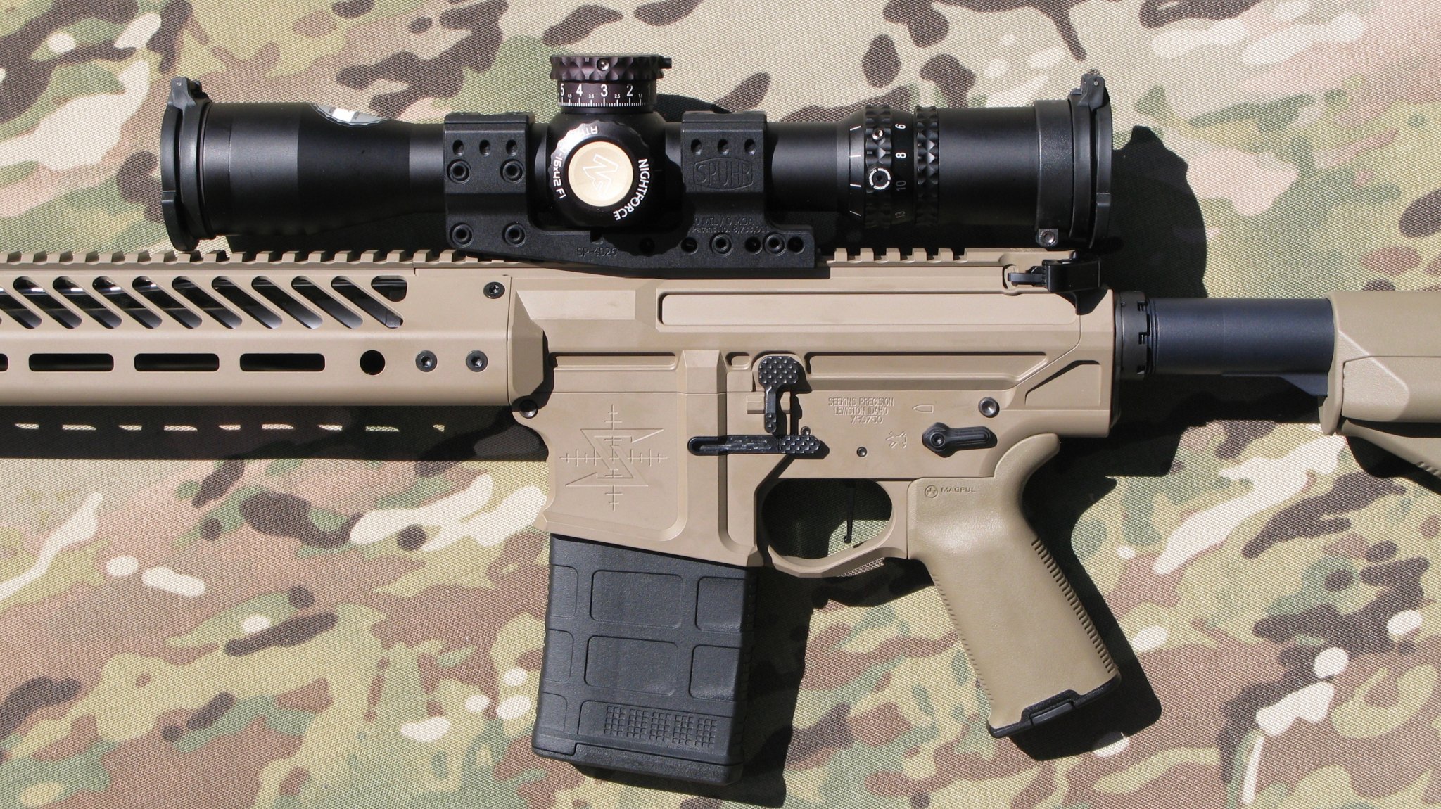

My first large frame AR build. 6.5cm built on a Maten set. Should get it out tomorrow morning to give it a test drive.

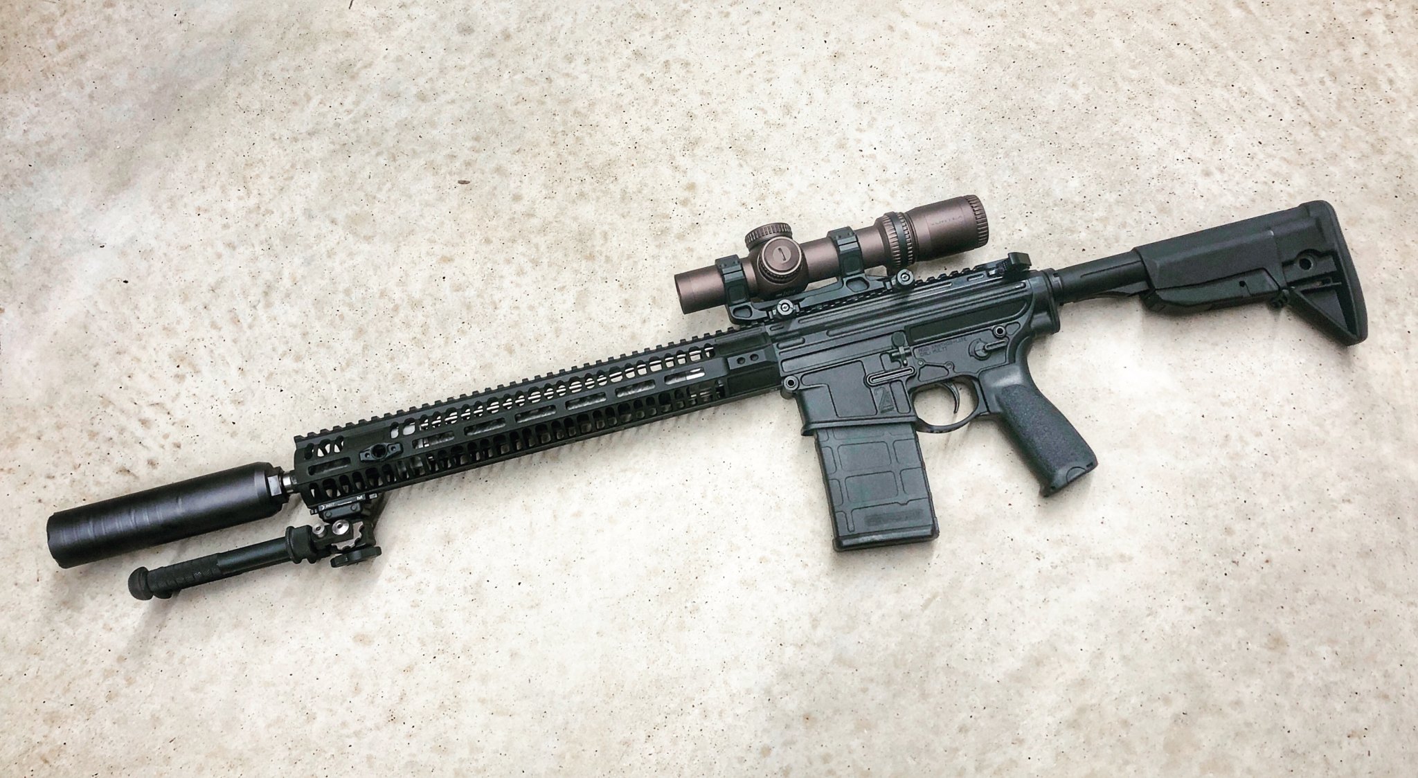

Just posted this in the new members section, but figured it made sense to add to the thread. Haven't tried it yet, but I have high hopes!
IMG_0227_zpsqmke61sm.jpg~original
- Aero precision enhanced upper and grip
- Technical machining lower
- JP supermatch heavy contour 20" barrel with matched bolt
- Aero precision nickel boron BCG
- VG6 Gamma muzzle break
- Geissele DMR trigger
- Magpul PRS stock
- Atlas PSR bipod
- JP adjustable gas block
- JP silent capture heavy buffer
- Leupold Mark 4 rings
- Vortex Viper PST FFP

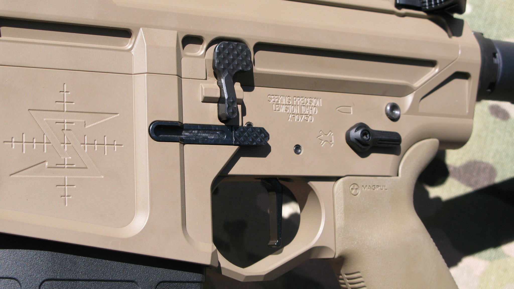

Love the color man. I too have an LMT-MWS but it came in factory burned bronze which I'm reluctant to blast off. What was your hardener mix on it? Looks satin finish which I like. If I may ask, is that the 18SS barrel which you cut down or is it a 16? Did Marvin Pitts do the work on that barrel? Mine came with the 16CL barrel and I have a 18SS which I might send for work.
Great looking beastie.

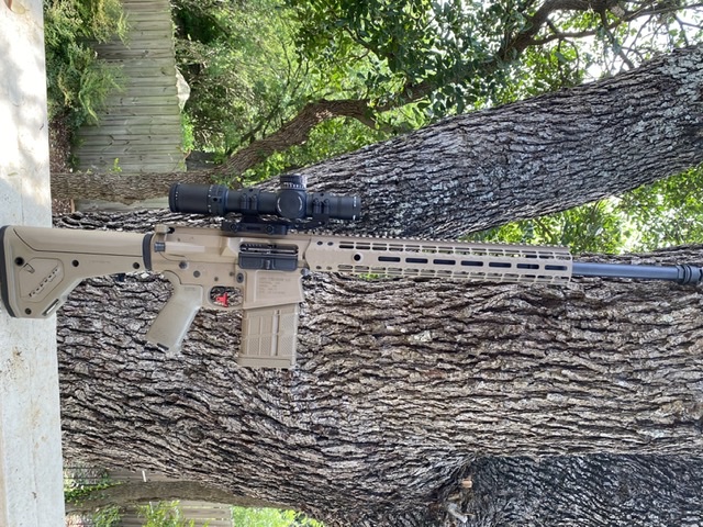

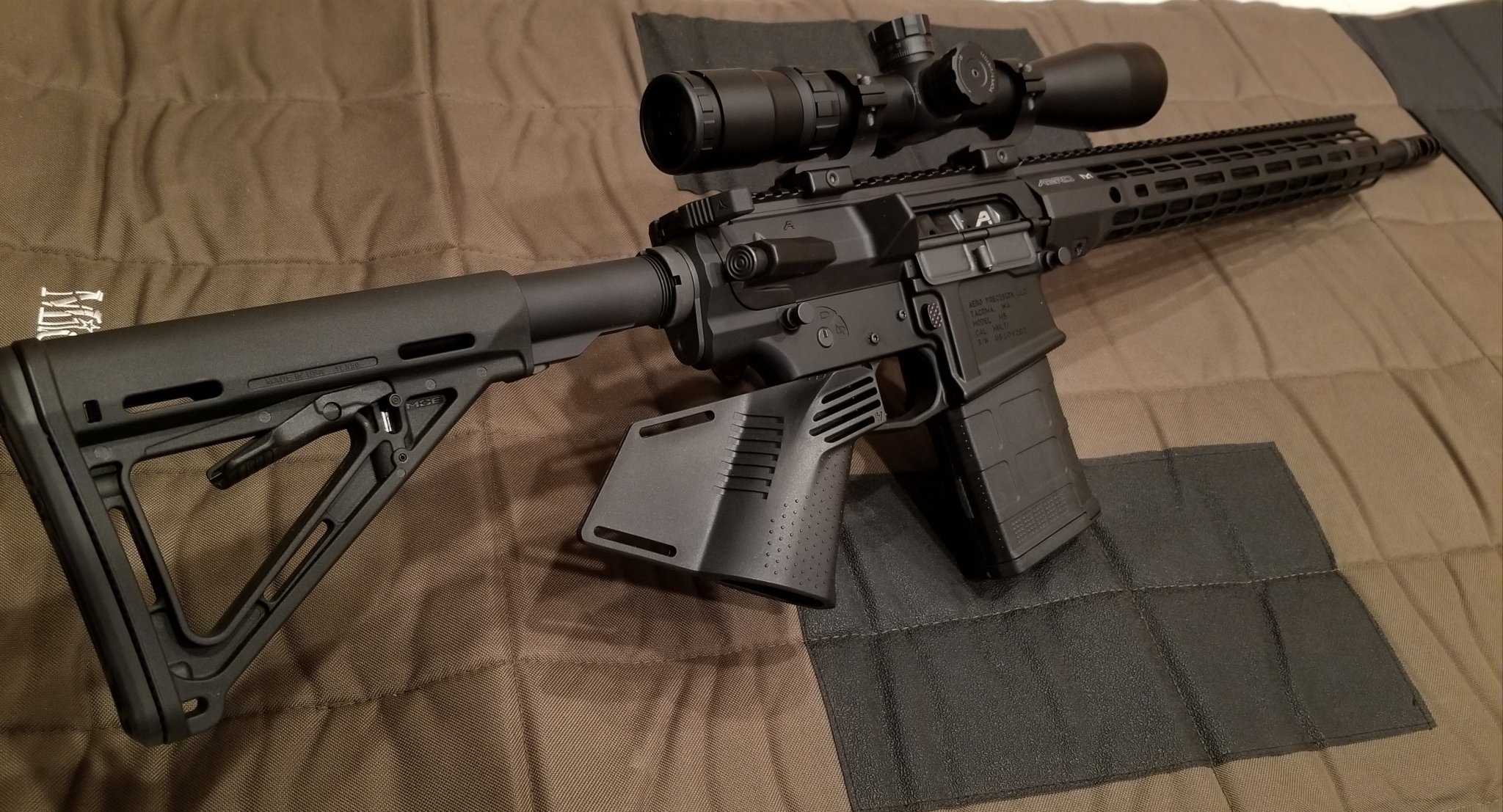

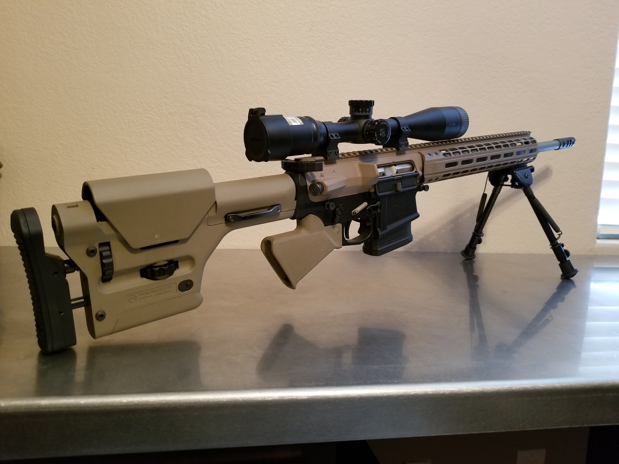

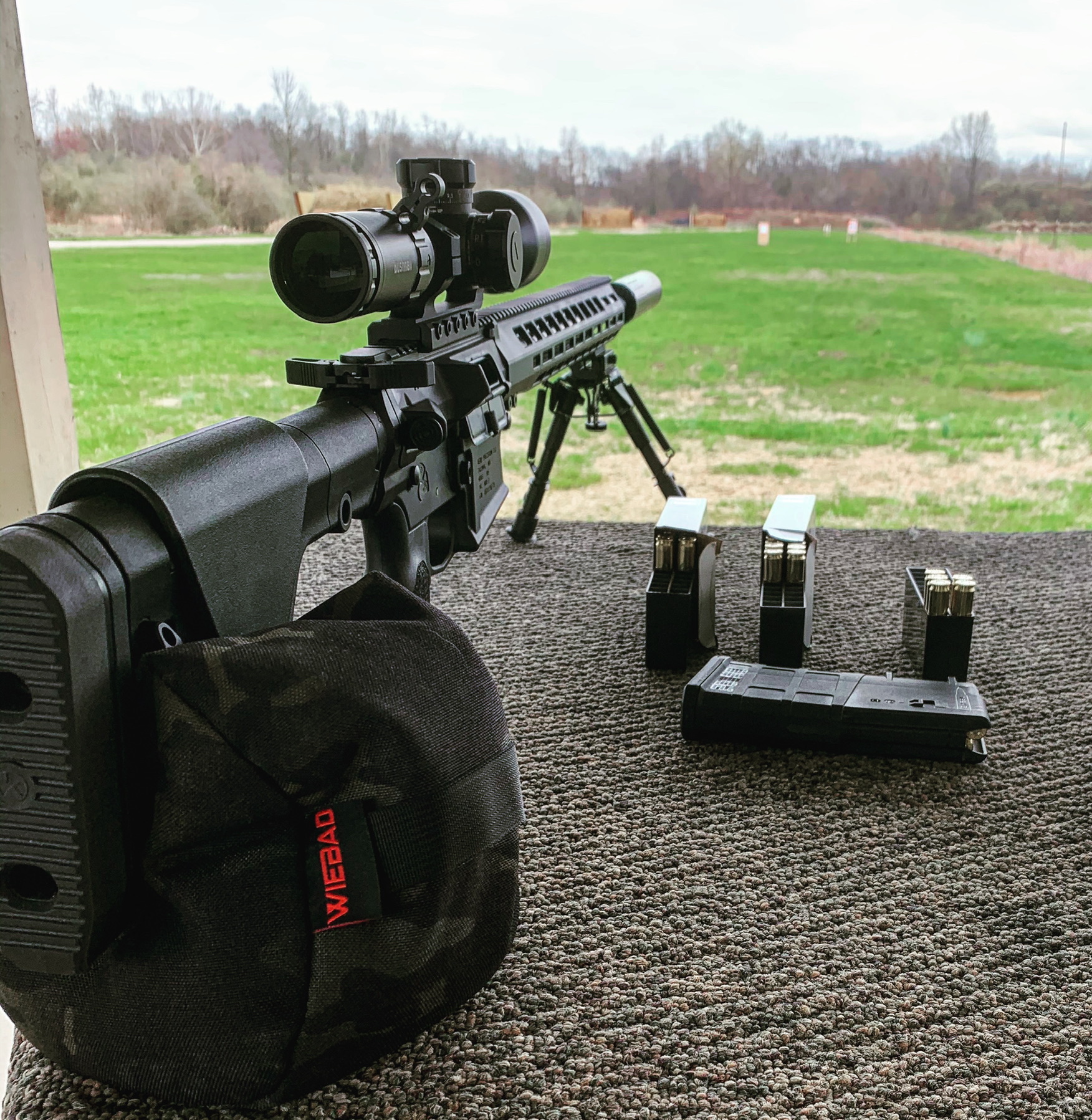

Here's my budget build. First time building anything AR related.
Nothing fancy:
-PSA blem lower/upper (upper bedded with some jbweld to take out the slack).
-Ballistic advantage ss 22" 6.5cm
-JL Billet 308/AR10 15" Angle Cut M-Lok Handguard Low Profile
-aero precision black nitrided bcg
-schuller brake
-superlative arms adj clamp on GB
-armalite ar10 buffer
-rifle length buffer tube and spring
-magpul moe fixed rifle stock
-PSA EP trigger
-Ergo tactical deluxe grip
-Strike industries UDC
-American Defense AD-RECON-S 20 MOA 34 STD scope base
-Burris xtr-II 5-25×50
Showing some promise with Hornady eld-x 140gn factory ammo (5 shots at 106 yds while prone on top of 16"of snow and this monkey behind it)

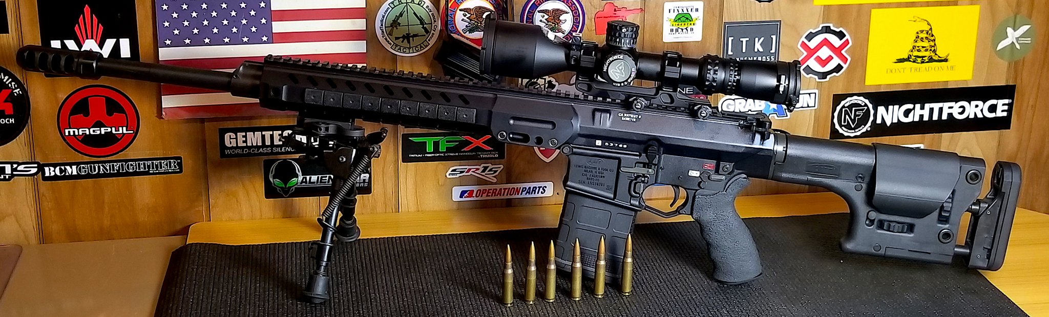

Aero Precision M5 upper/lower
Aero Prescision lower parts kit (minus FCG)
Aero Precision R-One MLOK handguard
Hiperfire Reflex single stage trigger
Magpul MIAD grip
Magpul PRS Gen 3
JP SCS H2 weight
Lantac Enhanced BCG in NiB
Radian Raptor-SD charging Handle
Rainer Arms ULTRA MATCH MOD2 20” polished barrel - 308
Superlative Arms adjustable gas block
Precision Armament M41 muzzle brake
Nikon Black 30mm cantilever mount
Nikon Black FX1000 FFP 6x24x50
Harris bi-pod w/Midwest Industries MLOK adapter
She weighs in at 13Lb 5oz as shown with empty mag ?
Haven’t shot her yet and still need to get the scope mounted in final location.

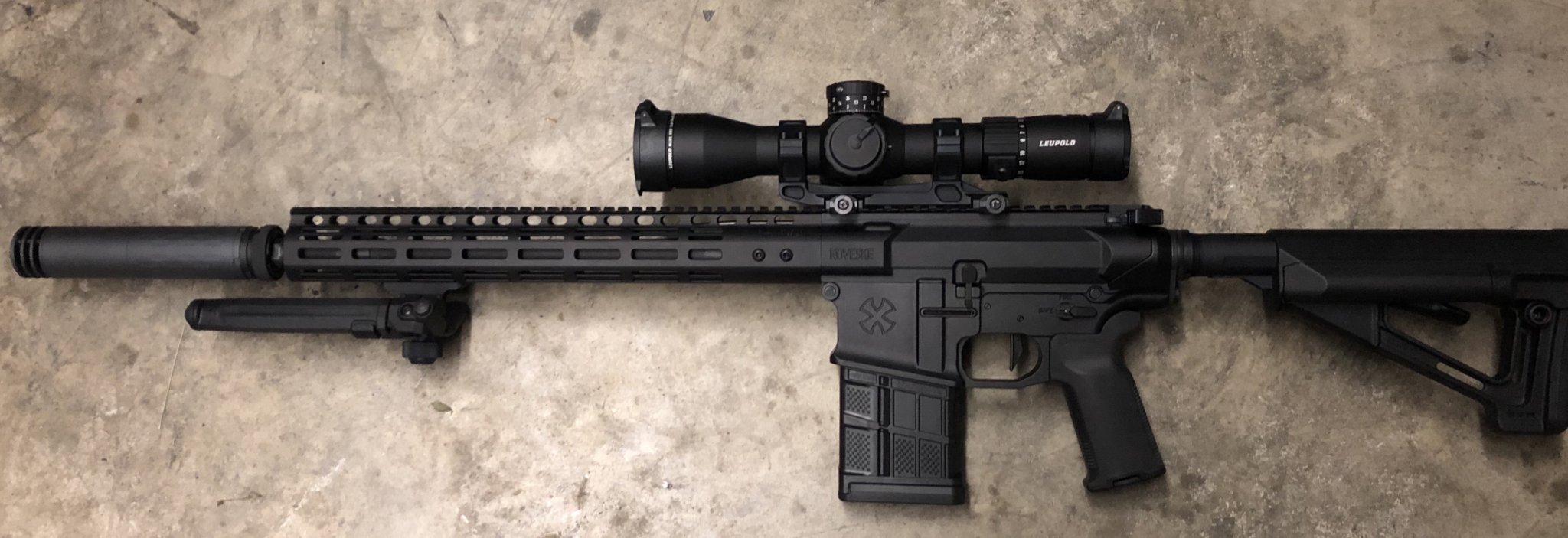

Aero Precision receiver set
Criterion 22” hybrid heavy contour 6.5 creedmoor barrel
Grey Ghost Precision 18” rail
Magpul PRS Stock
Geissele G2SE Trigger
Superlative Arms bleed off gas block
Bushnell HDMR II Tactical H59
Leupold Mark Series 34mm mount
Silencerco Hybrid

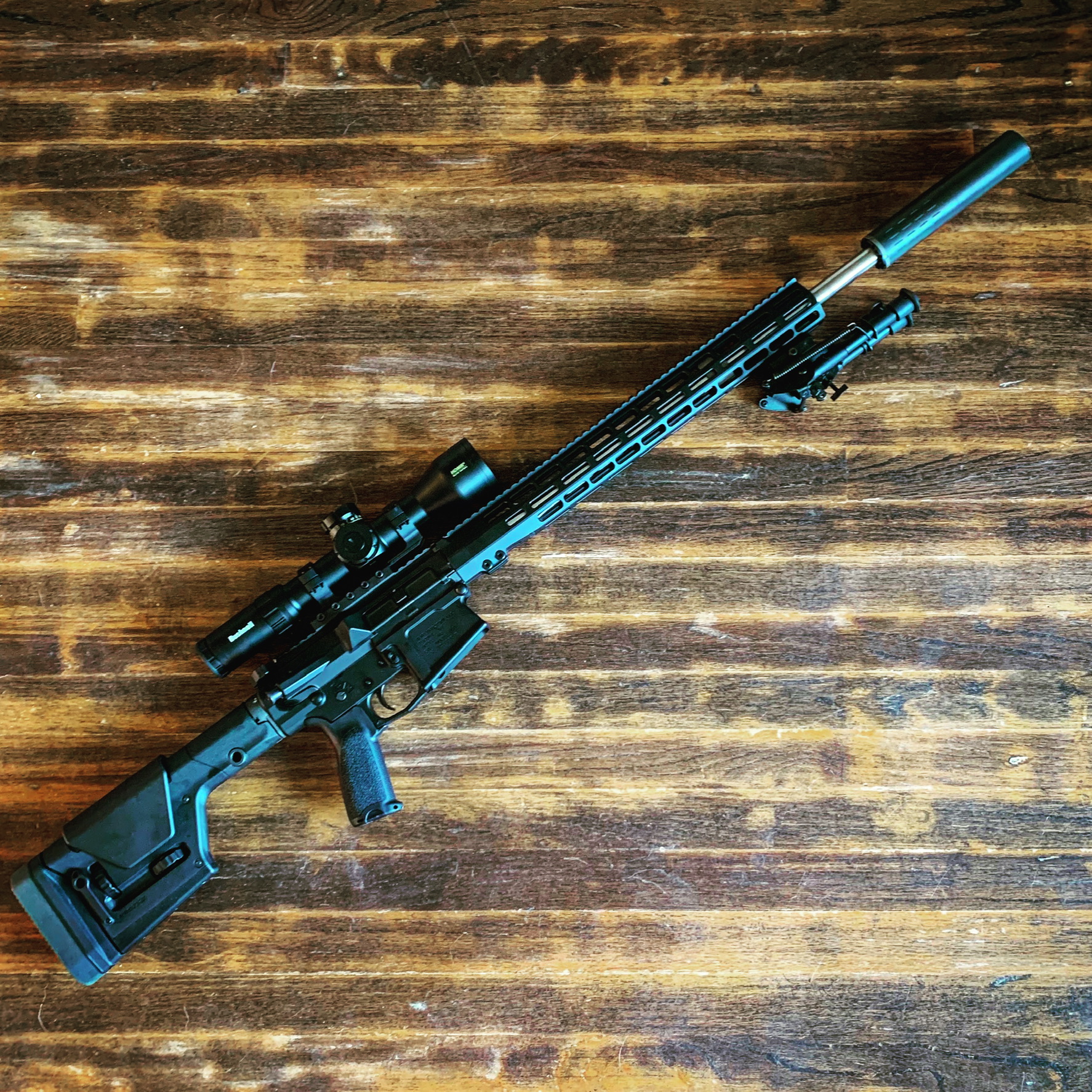

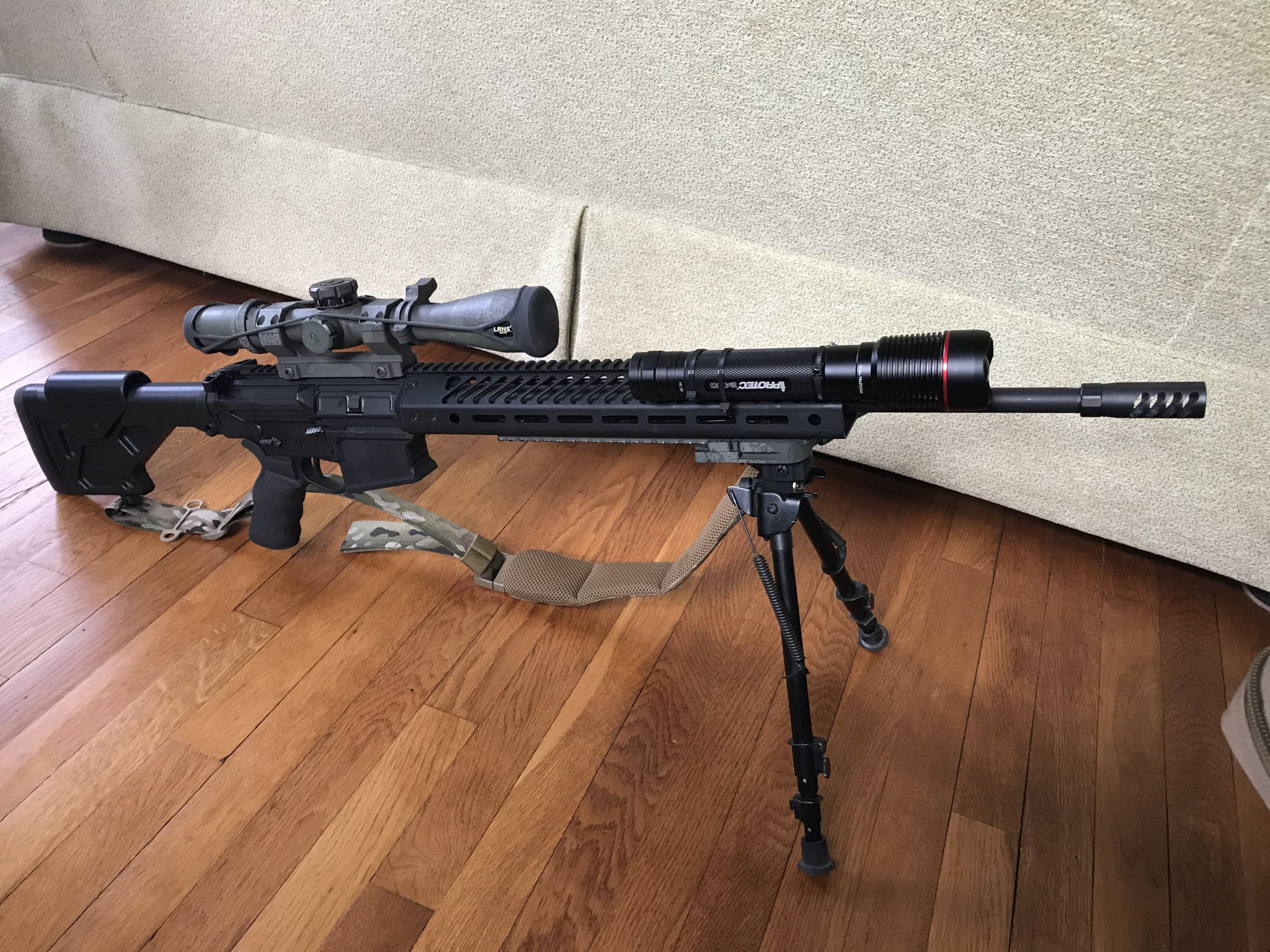

My pig rig at the moment. It needs some rattle in its life. When I get it done, I’ll post.
6.5 SP-10, Bushy LRHSI 4.5-18, Harris 25S with the ADM Pic Mount, Seekins MRAC system, Accuracy 1st level, Ergo Tactical Deluxe grips, and cheapo Bikini Scope Covers.

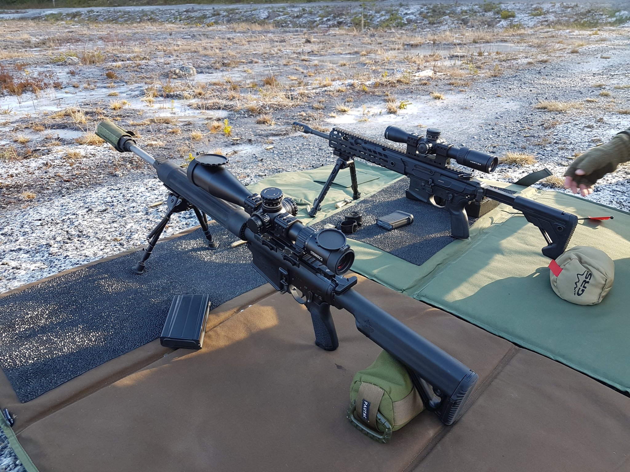

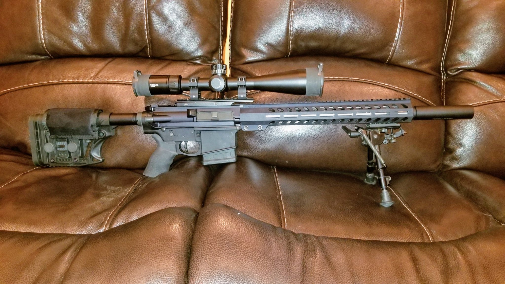

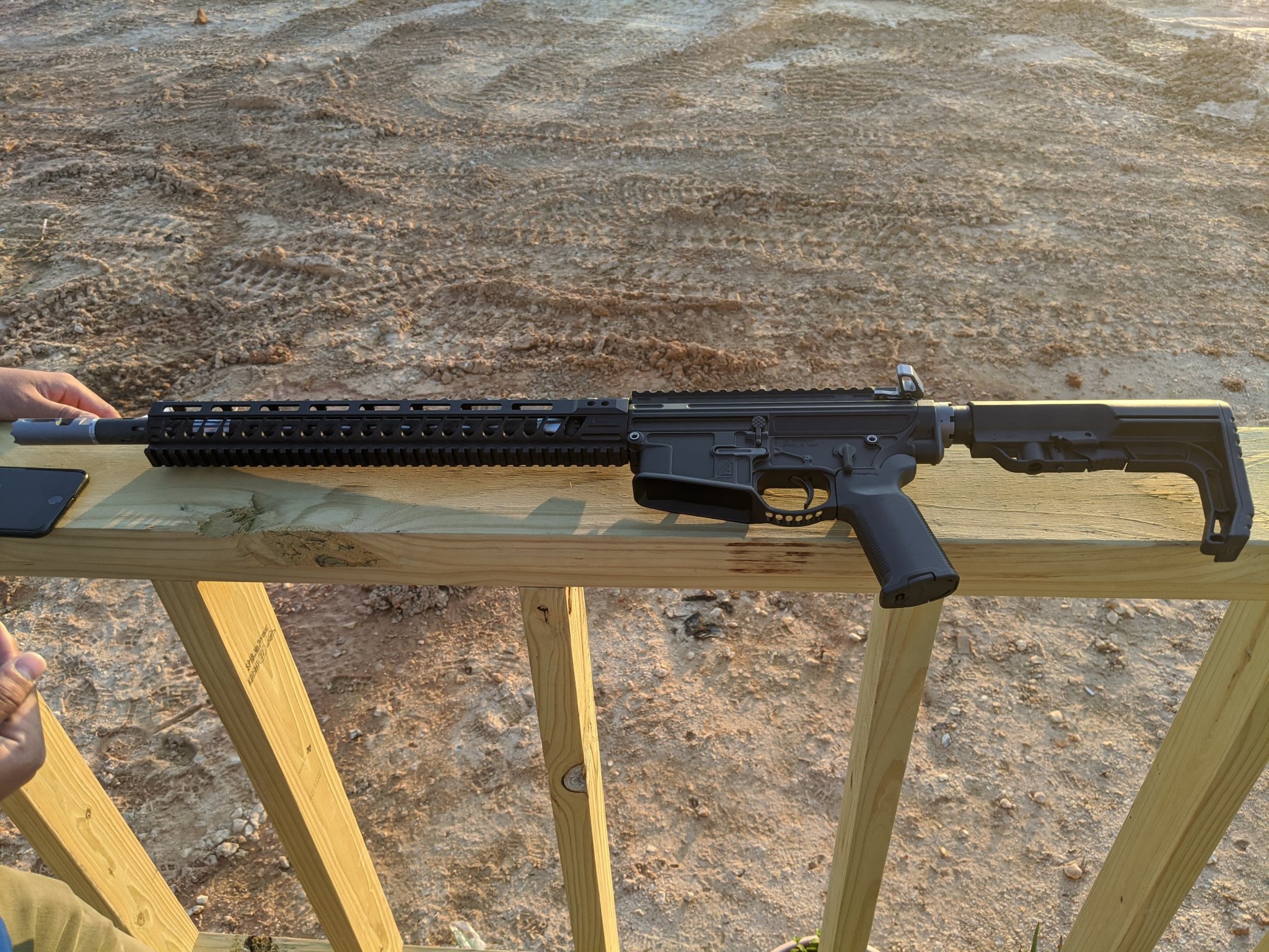

Here's my .308 I've been working on and finally close to finishing. Getting ready to actually go test her at the range to see that she actually shoots.
Mega Maten receiver set
Mega 20" rifle gas barrel
SLR adjustable gas block
SLR Solo Rail
AAC Brake Out 2.0
Aero NiB BCG
A5SR RE
Magpul ACS stock
Parts on order:
atlas bipod and unipod with magpul adaptor
Still need to order:
Giessele SSA-E
Scope and mount
-between NF and S&B. Was set on a 4-16x42 but the amount of 5-25x56 I see here has me reconsidering.
-mount wise I believe it will be a Spuhr mount just need to figure out what MOA base the scope I end up with needs.
- Current scope and rings were borrowed from friend for photo and use while test firing.
Under consideration:
Looking into suppressor options. At the moment I'm leaning towards a TBAC Ultra 9 with CB mount.
BI SAPR attachment
<a href="http://s177.photobucket.com/user/WittieM/media/BA75091F-BBE8-4F0B-A123-020F65BB8A06.jpg.html" target="_blank"><img src="http://i177.photobucket.com/albums/w227/WittieM/BA75091F-BBE8-4F0B-A123-020F65BB8A06.jpg" border="0" alt=" photo BA75091F-BBE8-4F0B-A123-020F65BB8A06.jpg"></a>

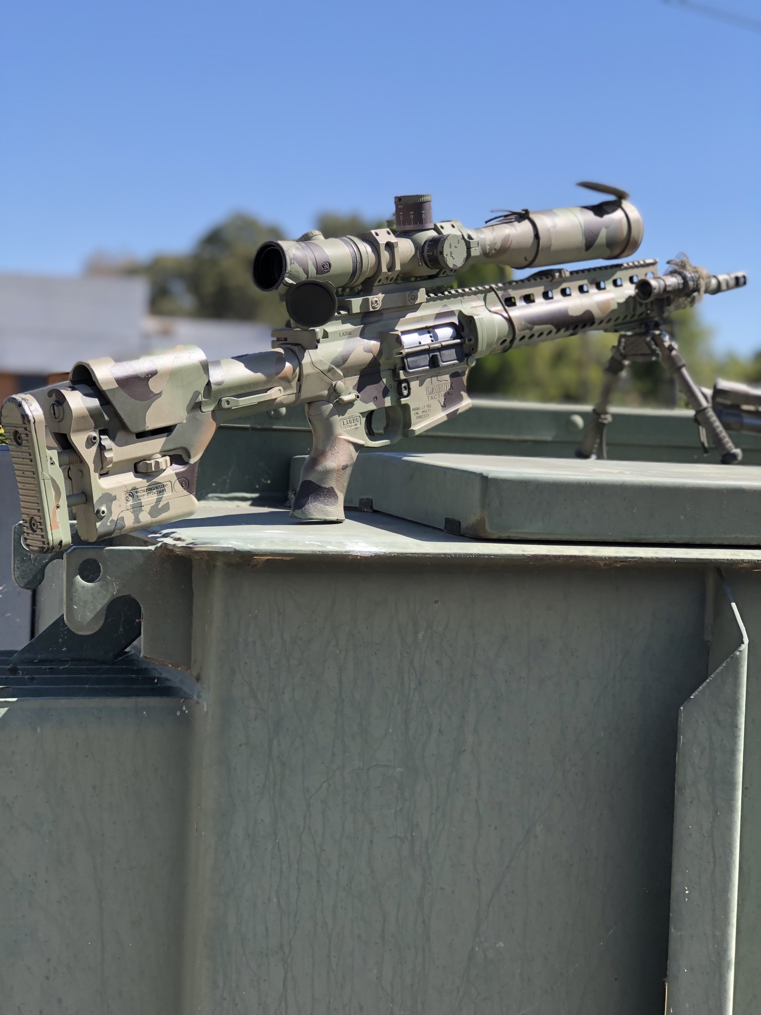

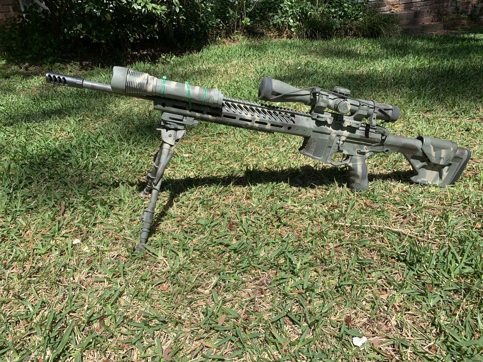

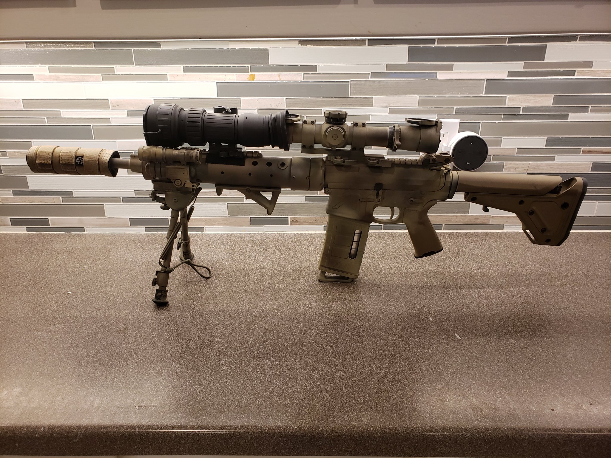

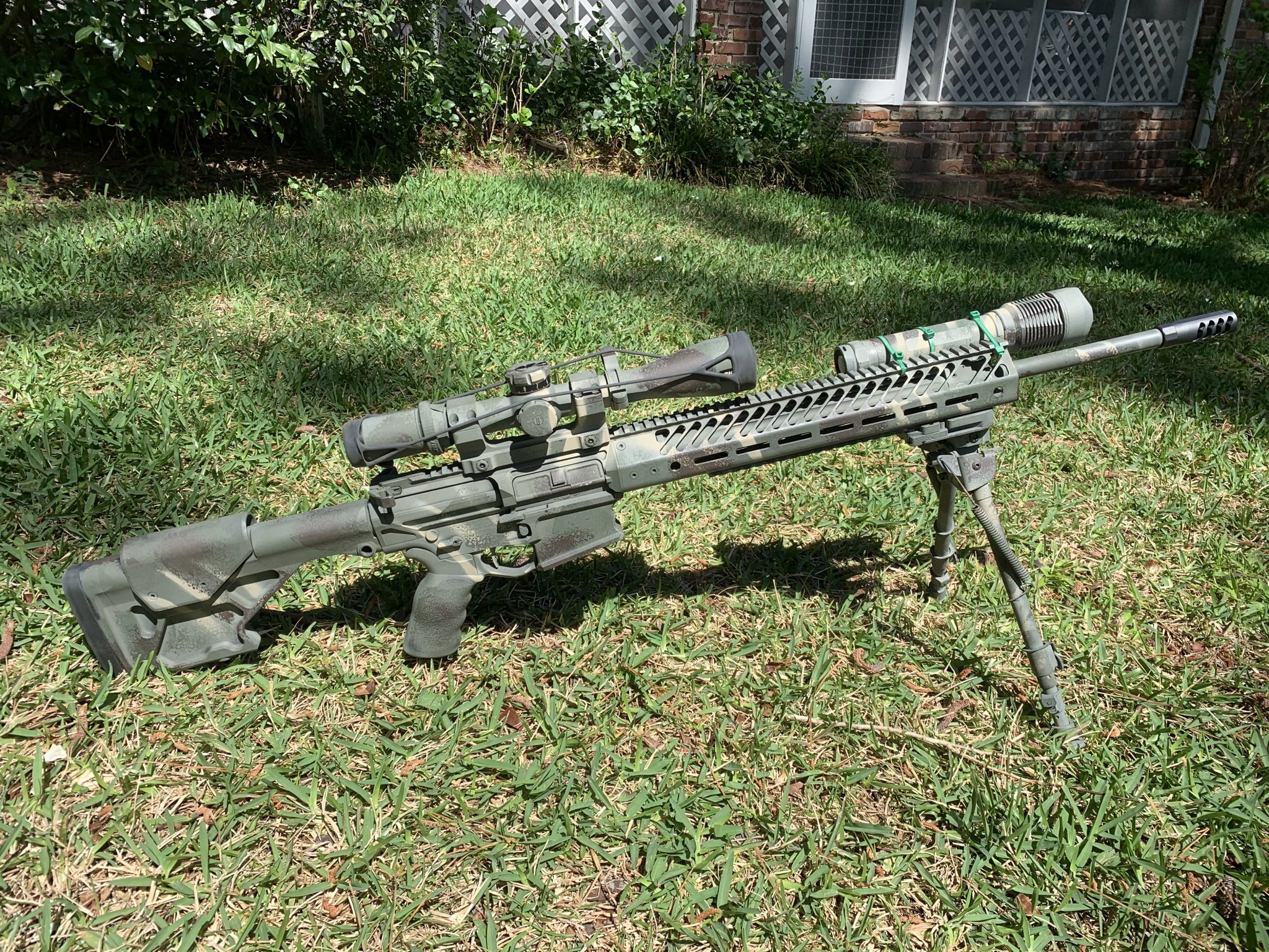

I sprayed my piggie rifle.
Reactions: Trumpinator

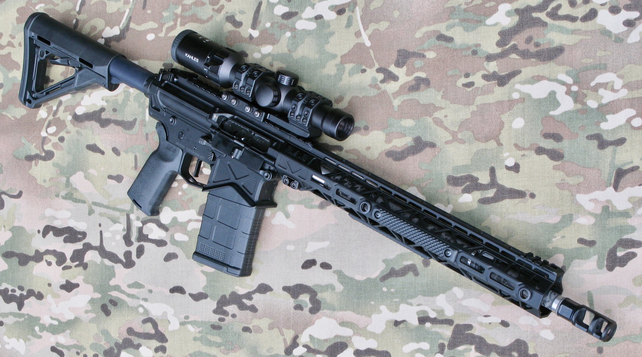

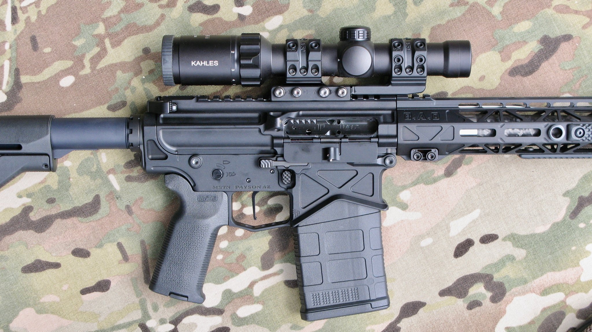

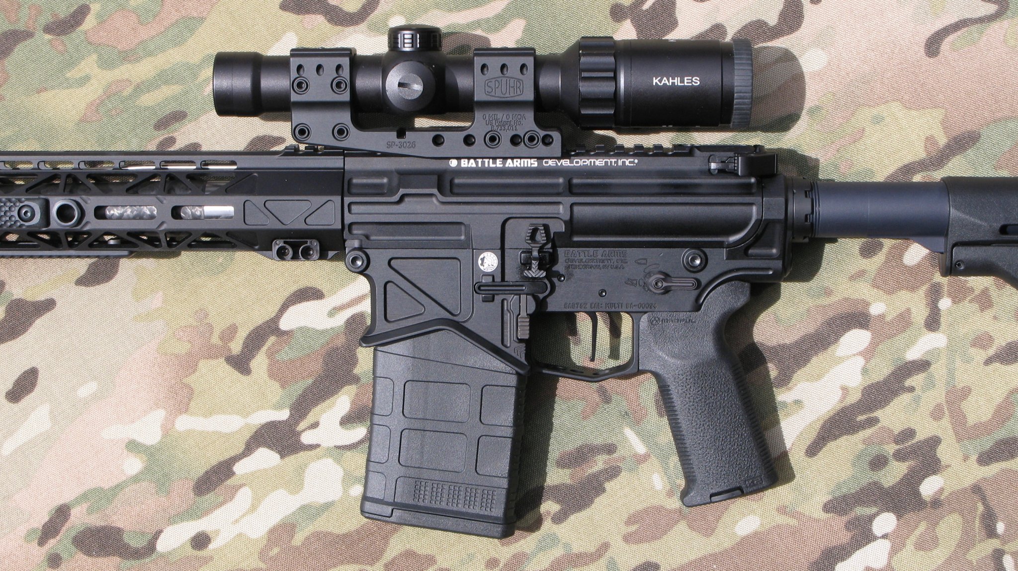

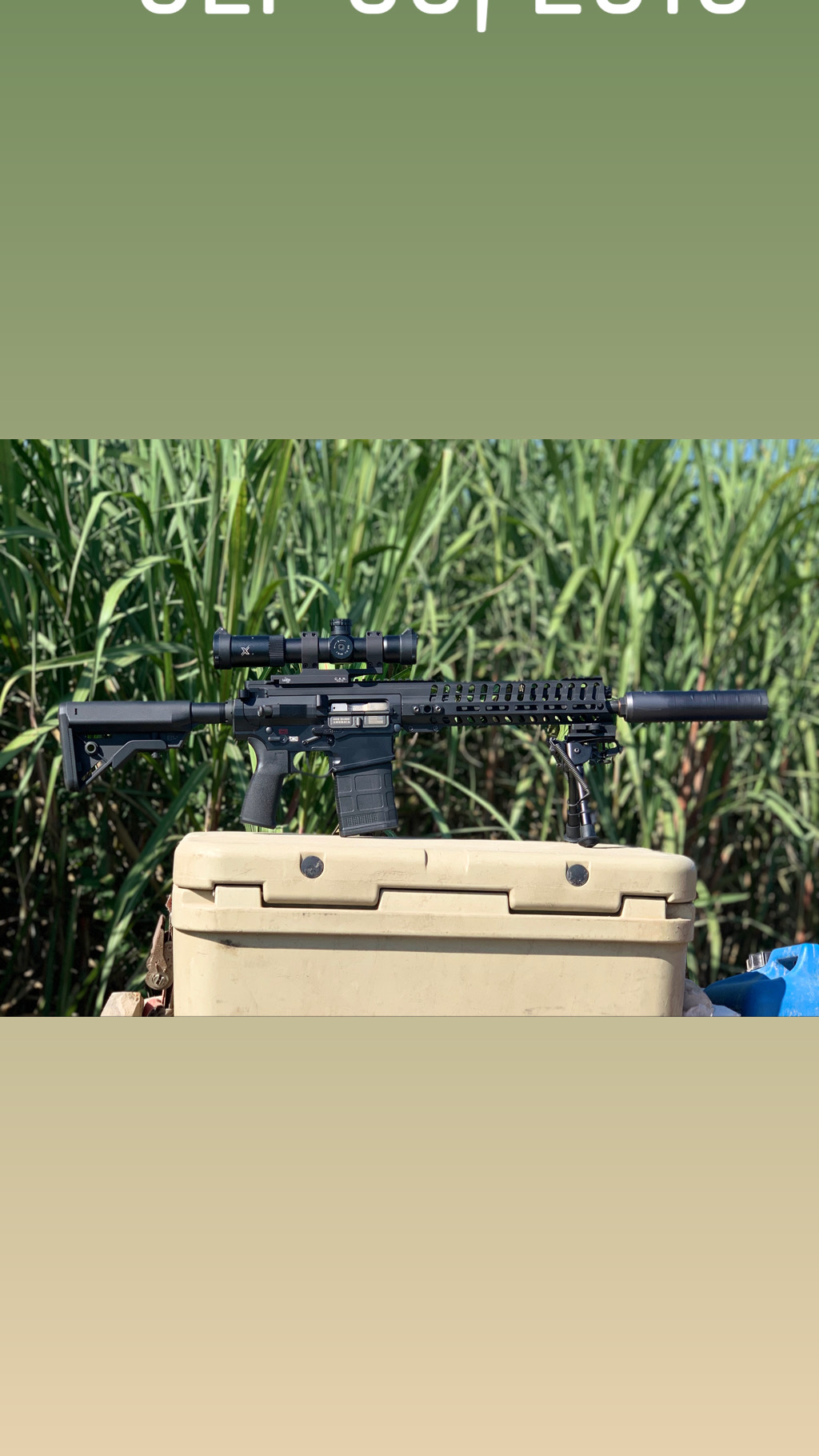

A repeat build of an ultra lightweight 16" .308. 7 LB 2 OZ and sub-MOA capable. Battle Arms Development BAD762 billet receiver set with 15" BAD 762 RigidRail. Proof Research carbine fiber wrapped barrel with optimum intermediate length gas system. JP LMOS bolt carrier group. SLR adjustable gas block. TriggerTech 3.5 LB straight trigger. Geissele 7.62 Super Charging Handle. Every V Seven titanium parts made for the big block guns, to include the excellent 7.62 Furion muzzle brake. Fantastic plastic by Magpul.
The recoil pulse with this thing is amazingly low with 175 grain match ammo. But, this gun is a steady diet of Mk 319 130 grain Barnes TSX destruction. This high pressure load produces LOTS of gas at the muzzle and reduces the recoil to just about nothing... But, is it ever LOUD!!! This ammo produces a simply unbelievable 2830 FPS in this 16" barrel. It runns reliably with the adjustable gas block only half open.
10 LB 2 OZ with full 20-RD magazine and Kahles K16i on Spuhr SP-3026 mount.

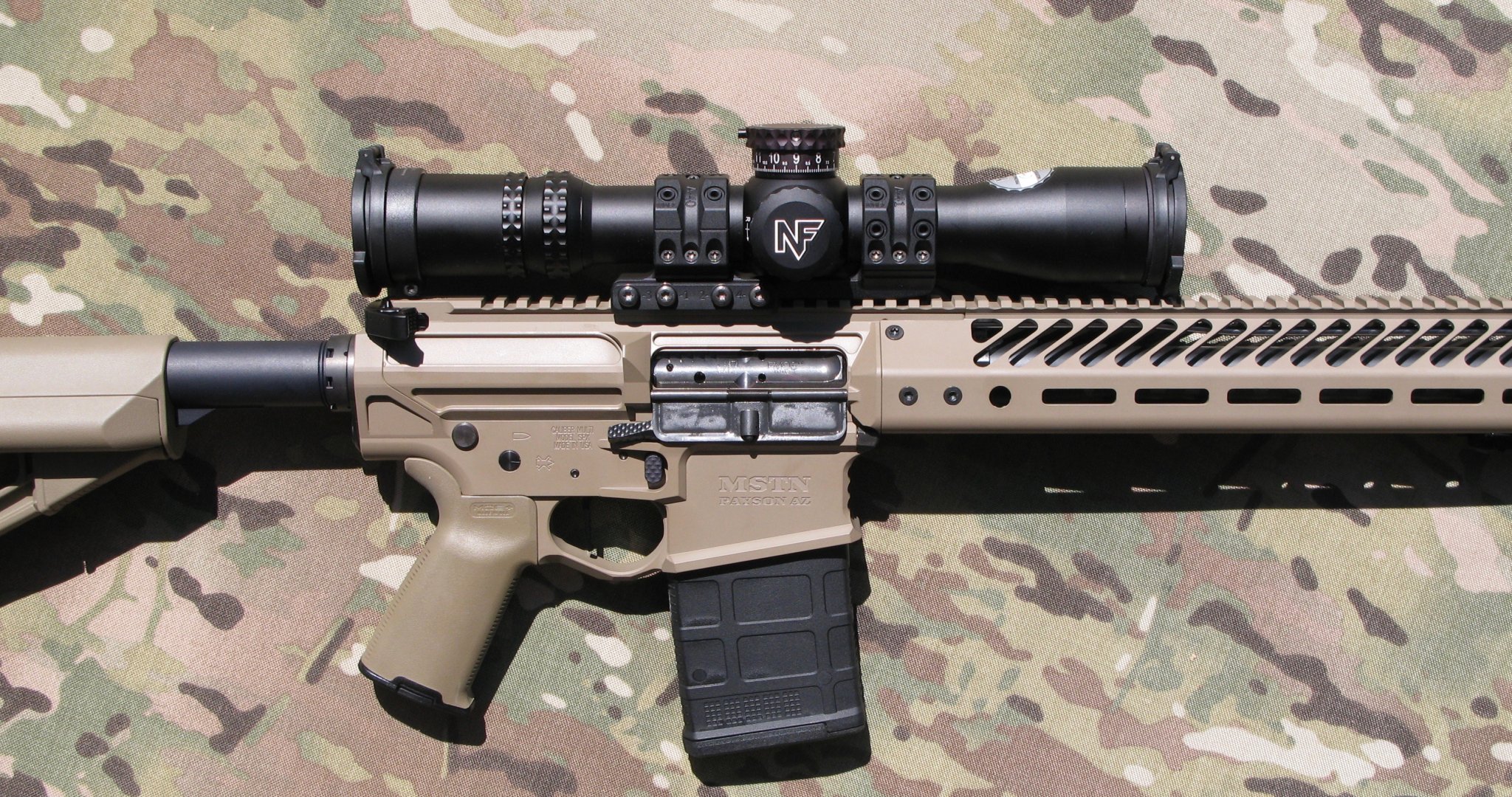

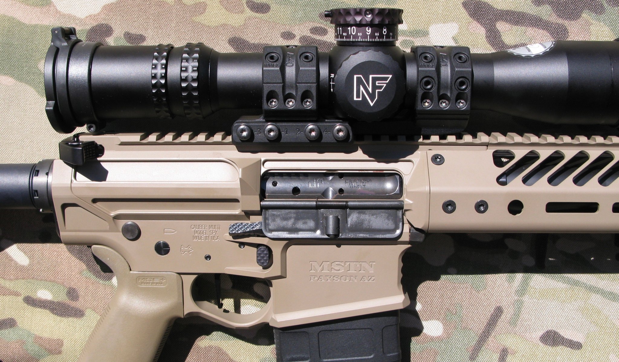

When a customer signs up for his third custom rifle, you know what his expectations are - high. I don't think this will disappoint him: 20" 6.5 CM with Bartelin 1x8 barrel from Craddock Precision. Seekins SP10 Builder's Kit, currently made of Unobtanium. Area 419 brake - both super loud and super effective. Dialing that gas down with the usual SLR adjustable gas block. JP FMOS bolt carrier group with JP High Pressure bolt. Geissele Super Charging Handle. JP SCS in 7.62 H2 weight. Trigger Tech Black Diamond (It's actually RED, you know ....) dialed down to 2.0 LB. Cool plastic stuff by Magpul. Cerakote by We Plead the 2nd. Nightforce ATACR F1 4-16x42 with TreMOR3 reticle in Spuhr SP-4026 mount. Fitted hard case by Patriot Cases. Bare rifle weighs in at 10 LB 2 OZ. With scope and mount plus empty magazine 13 LB 2 OZ. Shot way-sub-MOA with Prime 130's at 100 yards from the start.
