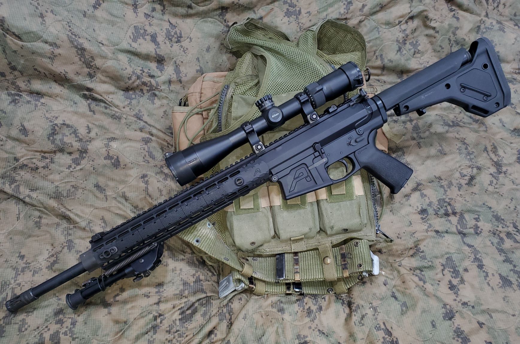

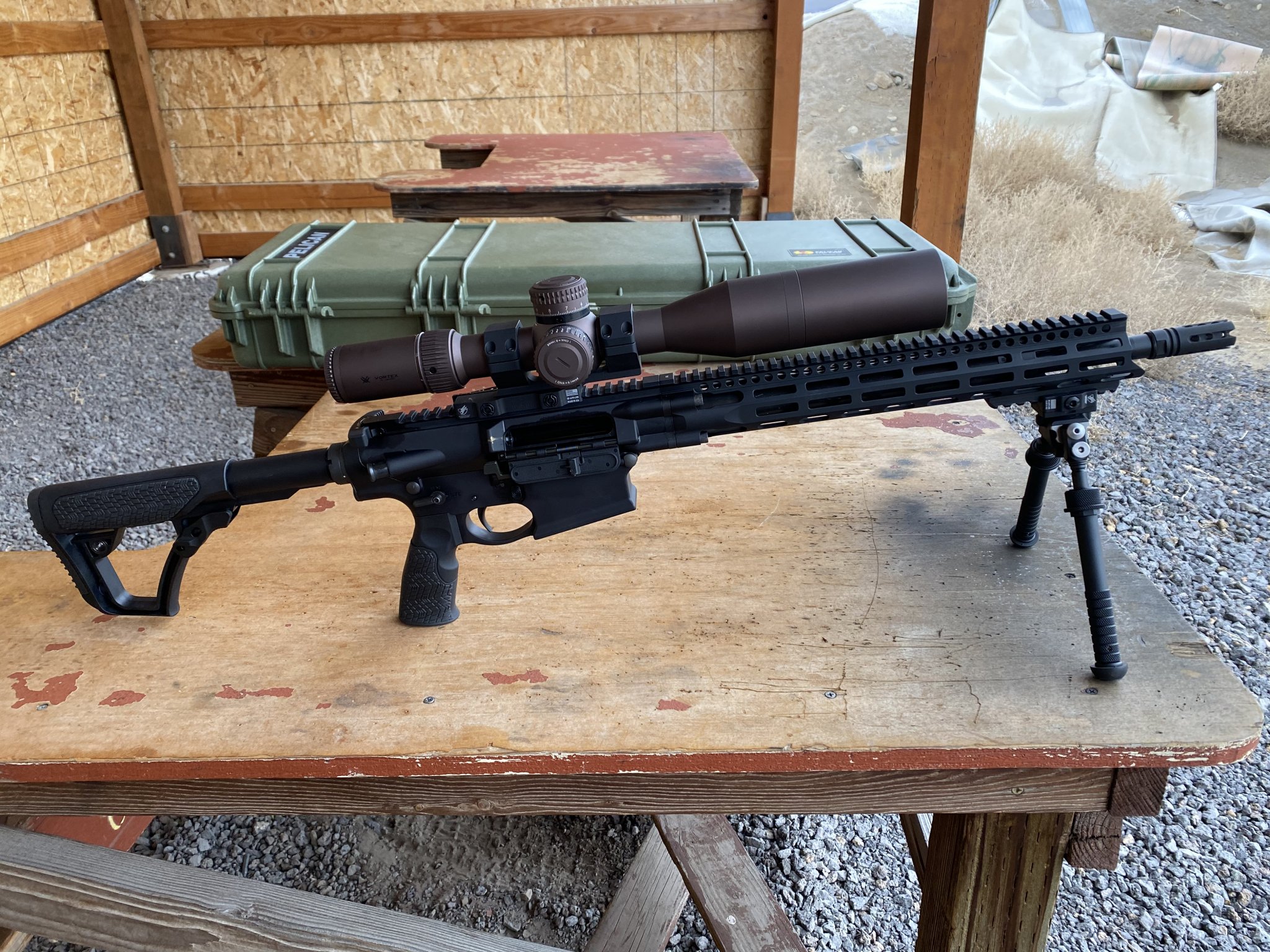

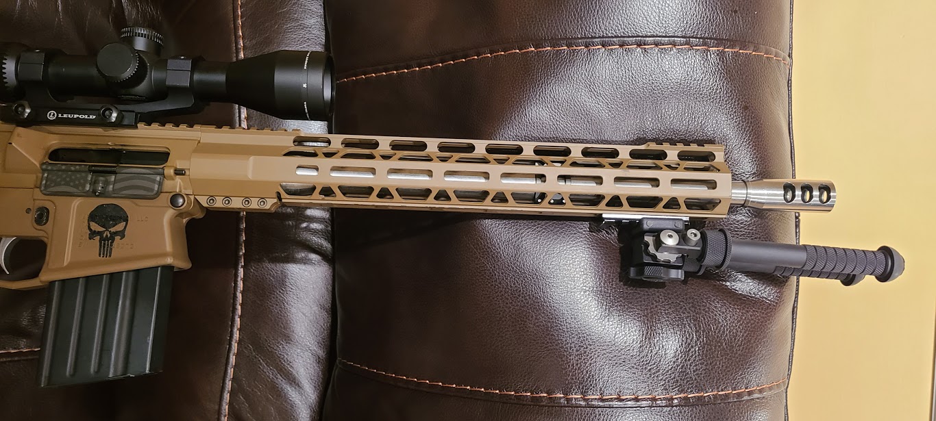

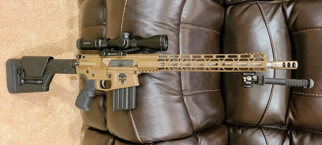

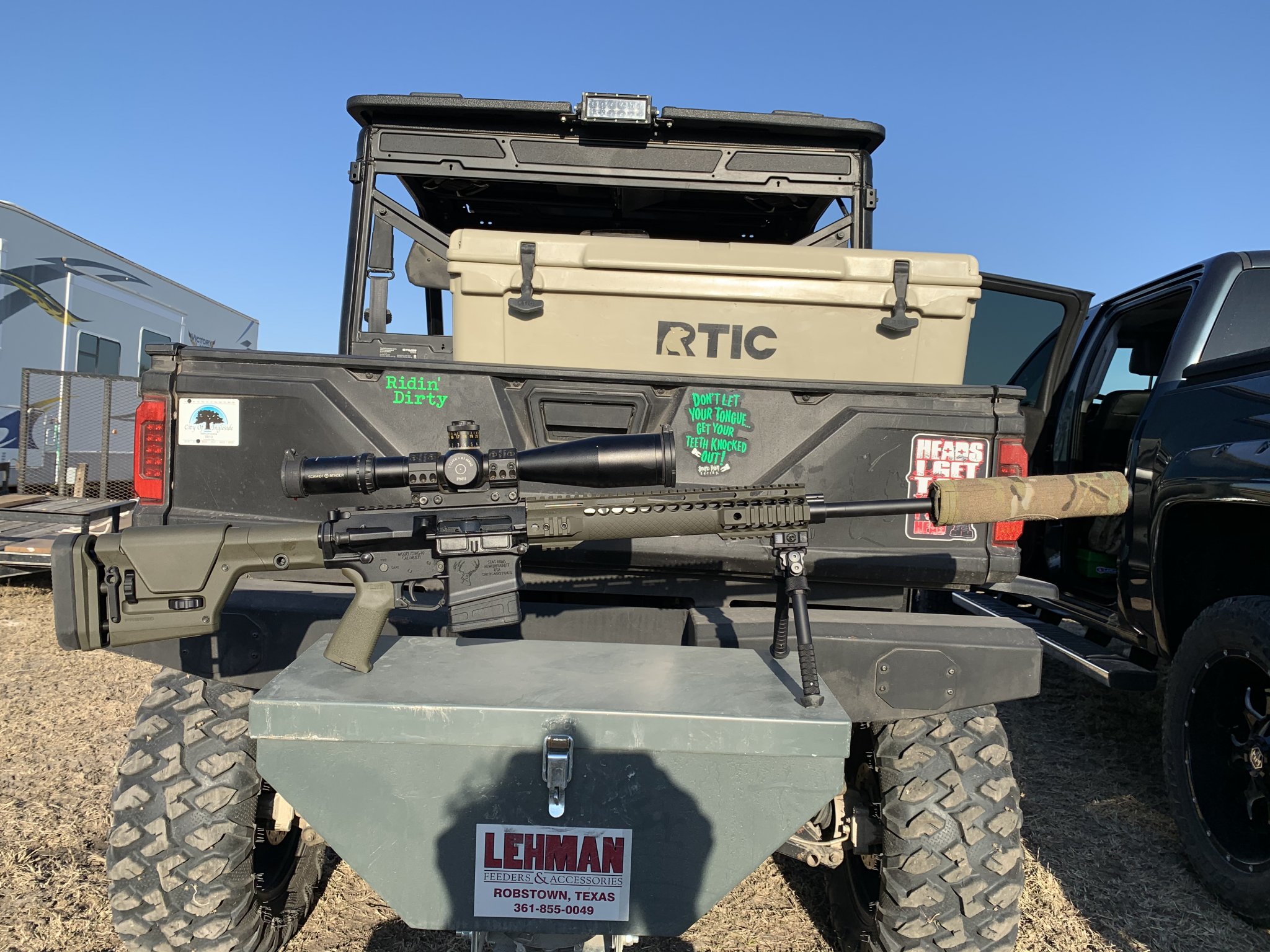

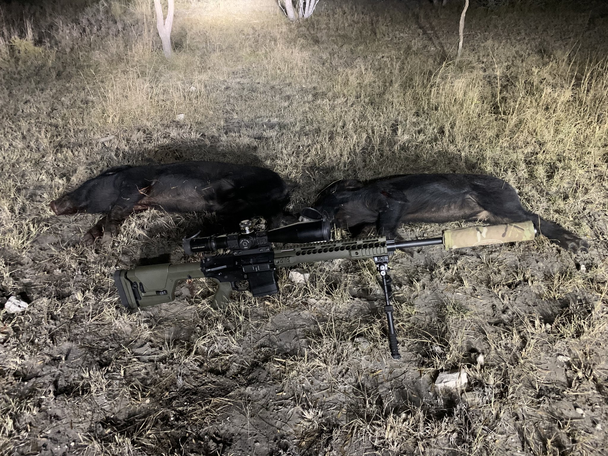

Pretty. Any idea what stock that is? I built my own JP setup with .308 and wish I went 6.5... Is their turn-around really bad right now on barrel kits?
Thanks! The stock is made by Magpul (UBR), I just removed the lid and added the Picatinny for a possible monopod or bad rider.
I don't know about JP's current level. I bought the barrel 2nd hand from a friend who upgraded to a Proof Research.
The Cerakoter did a pretty nice job on it, in my opinion.

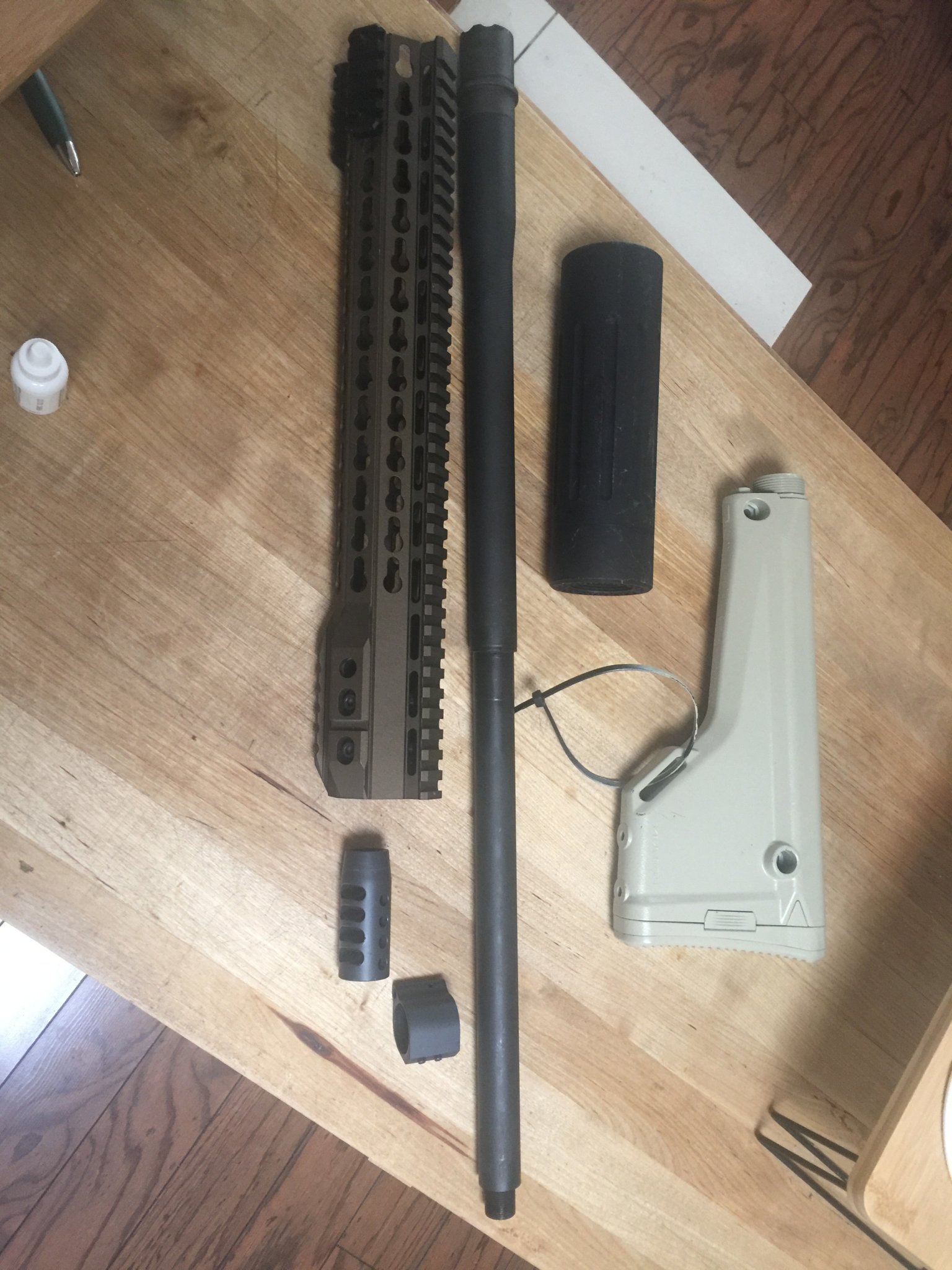

So My buddy handed me a bunch of parts and said have fun building your first AR10. Most of it is no name, The barrel measures 24 inches end to end and only says 308 win 1-10 Made in USA. The stock is MagPul. Any help would be greatly appreciated. I guess I could build a shooter and then modify later with better replacement parts. He told me these are LR 308 parts. I have my bolt gun for long range but something for 100 to 500 yds would be fun. He also gave me a bunch of random 308 ammo to go with it so I have an incentive to build a shooter. Any help is greatly appreciated.

Gonna need A LOT more than just that. And you only have the easy parts. 🤠
Yeah but its gonna be so much fun. My concern is not buying my next items that wont work with the barrel and guard. I think hes right and these parts are LR but with no name I am hesitant to spring for the more expensive items.

Aero M5 or M5e1 for your upper and lowers. Those are great to build on in my experiences. Not crazy expensive, but not cheap. Comfortably in the middle... and especially with the large frame AR's, there is no "mil-spec" and it can be a real logistical headache if you go with Manufacturer A for the upper, and B for the lower.

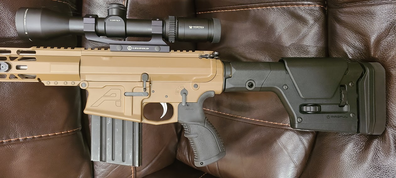

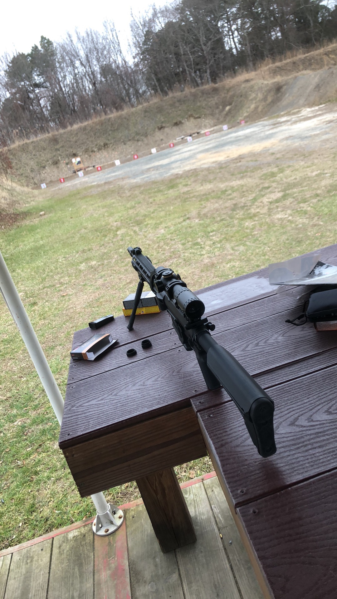

LR10 6.5 18 in. ballistic barrel, Aero upper, SLR gas block, LMT trigger, LuthAR stock, Leopold 4x12 firedot reticle that I put together and my Weatherby 6.5 DU rifle of the year that I won with a 3x9 Leopold that I got sighted in this past weekend.

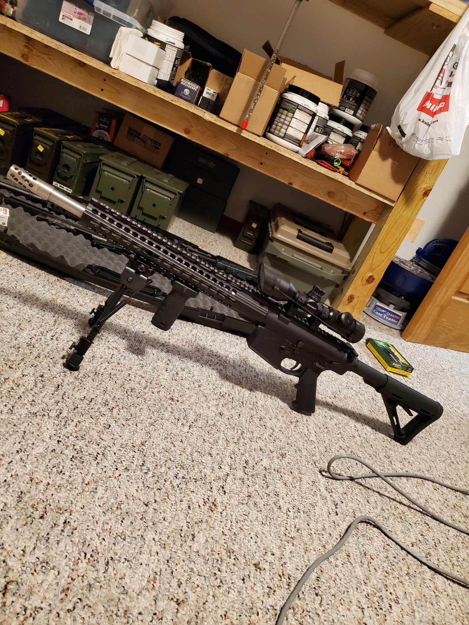

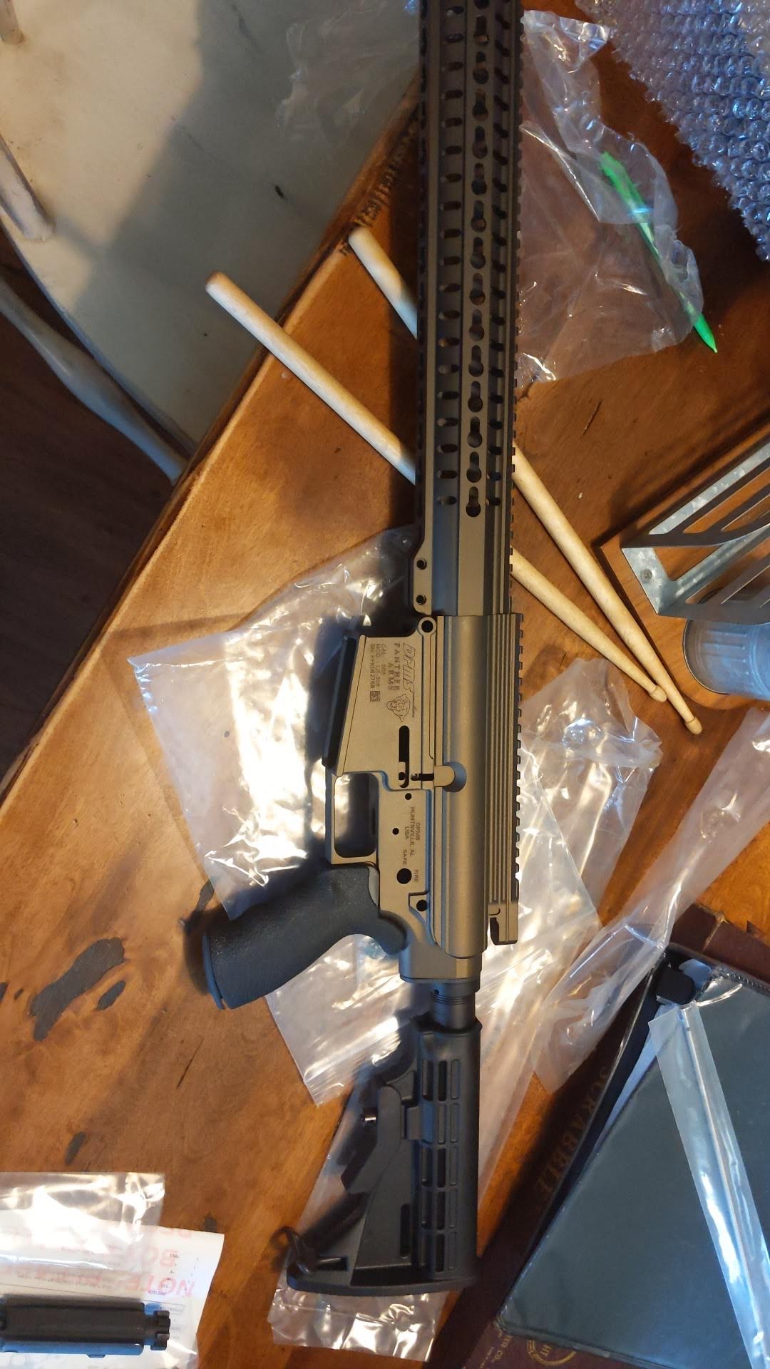

Between a little bit of rathole money and a 14 day quarantine, I decided to see what I could throw together for cheap. I have an abundance of 308 ammo and components, and nothing I enjoyed shooting them through. When I saw that CDNN had some random DPMS/Remington/Bushmaster parts floating around, a plan began to formulate.
As it is, I have ordered the following;
DPMS Midnight Bronze Kit with High Rise receiver, lower, CMMG 15" rail and Bushmaster BCG
Bear Creek 20" rifle length 10 twist stainless barrel
Larue MBT2S Straight Bow trigger
Larue RAT Stock and Grip
With all the miscellaneous parts needed to finish it, and a Bushnell Nitro 2.5-10x44 FFP to top it off, I will be into the rifle for less than $1100. Its not a top notch build, and I expect to have some teething issues, but it was intended to be a project. I am not super pumped about a couple of the parts, but they were available and cheap. If it will kill steel and a few pigs, I will be happy.

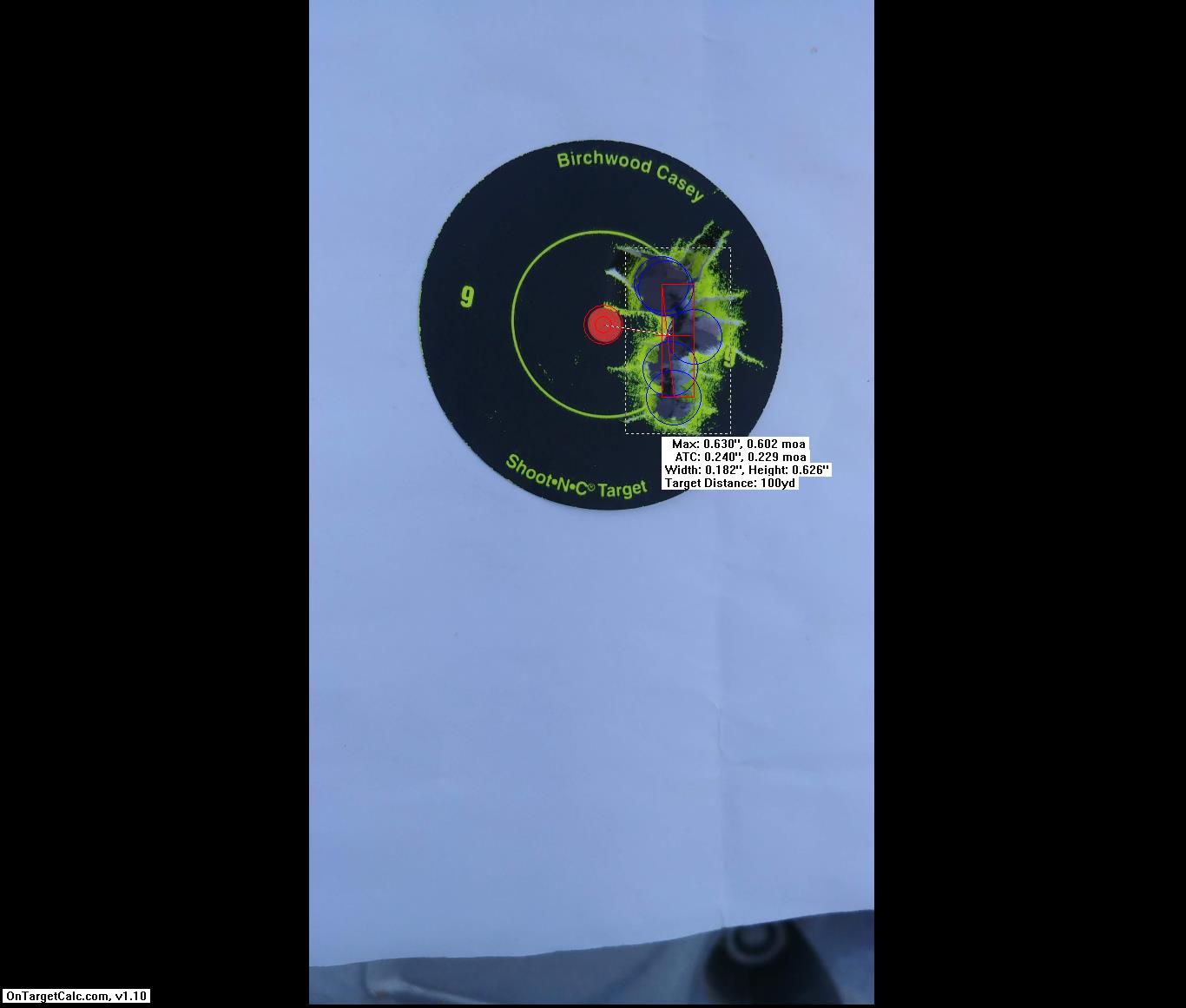

Finished it just in time to realize I don't like Semi-Auto precision shooting. Worked up a good load with 41.3 gr H4350 and Lapua brass that shoots 1/2 MOA on new brass. Worked up another promising with 42.3gr N555 on Hornady brass that probably needs a bit of leaning out. I am about to put it up for sale - I can't justify having this when I like shooting my 308 bolt more.

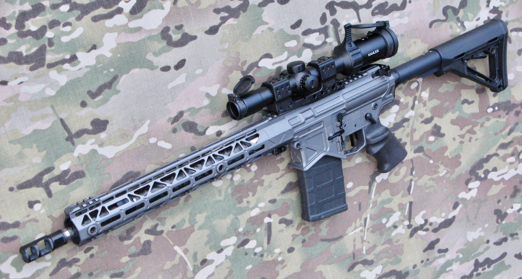

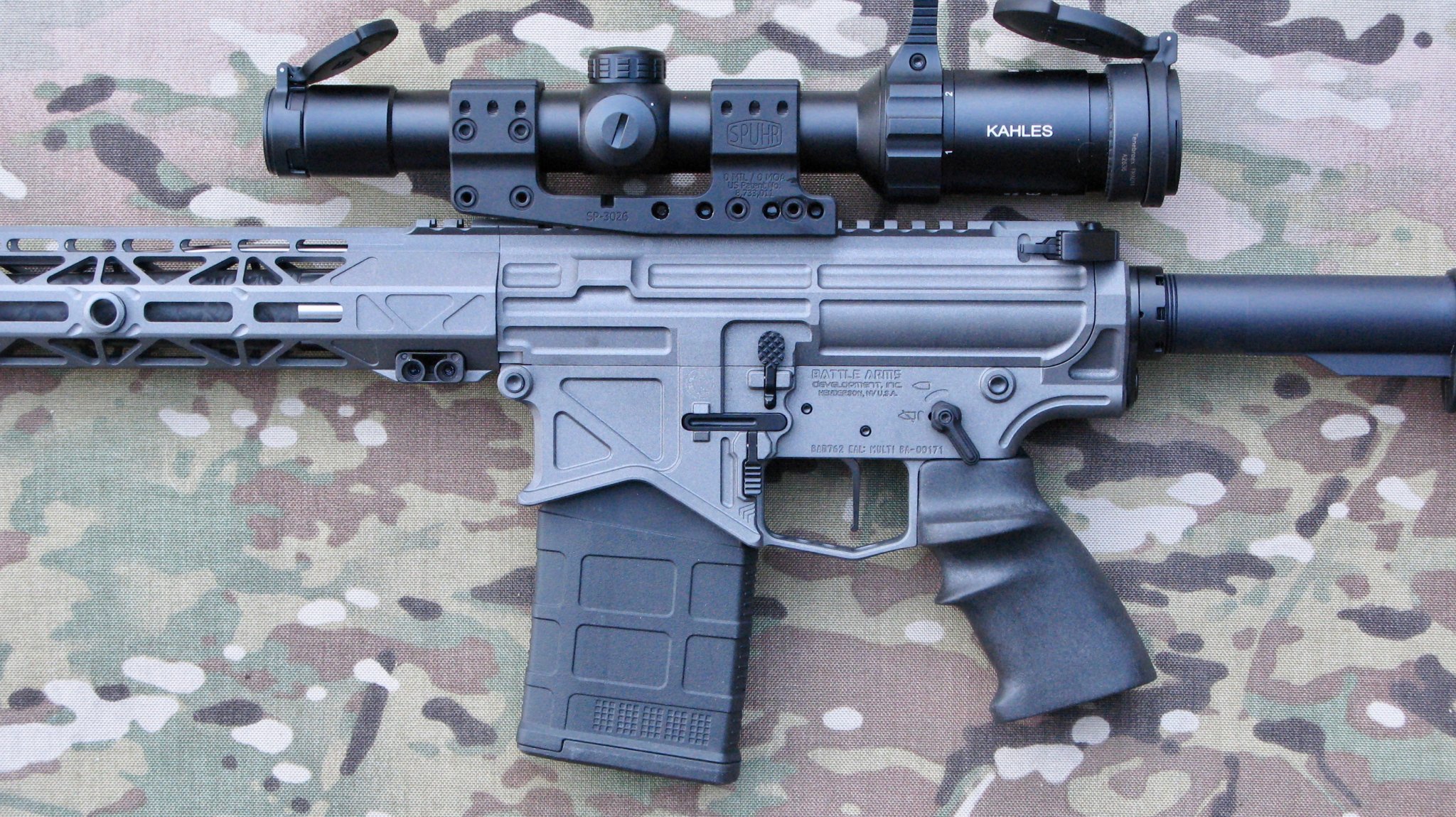

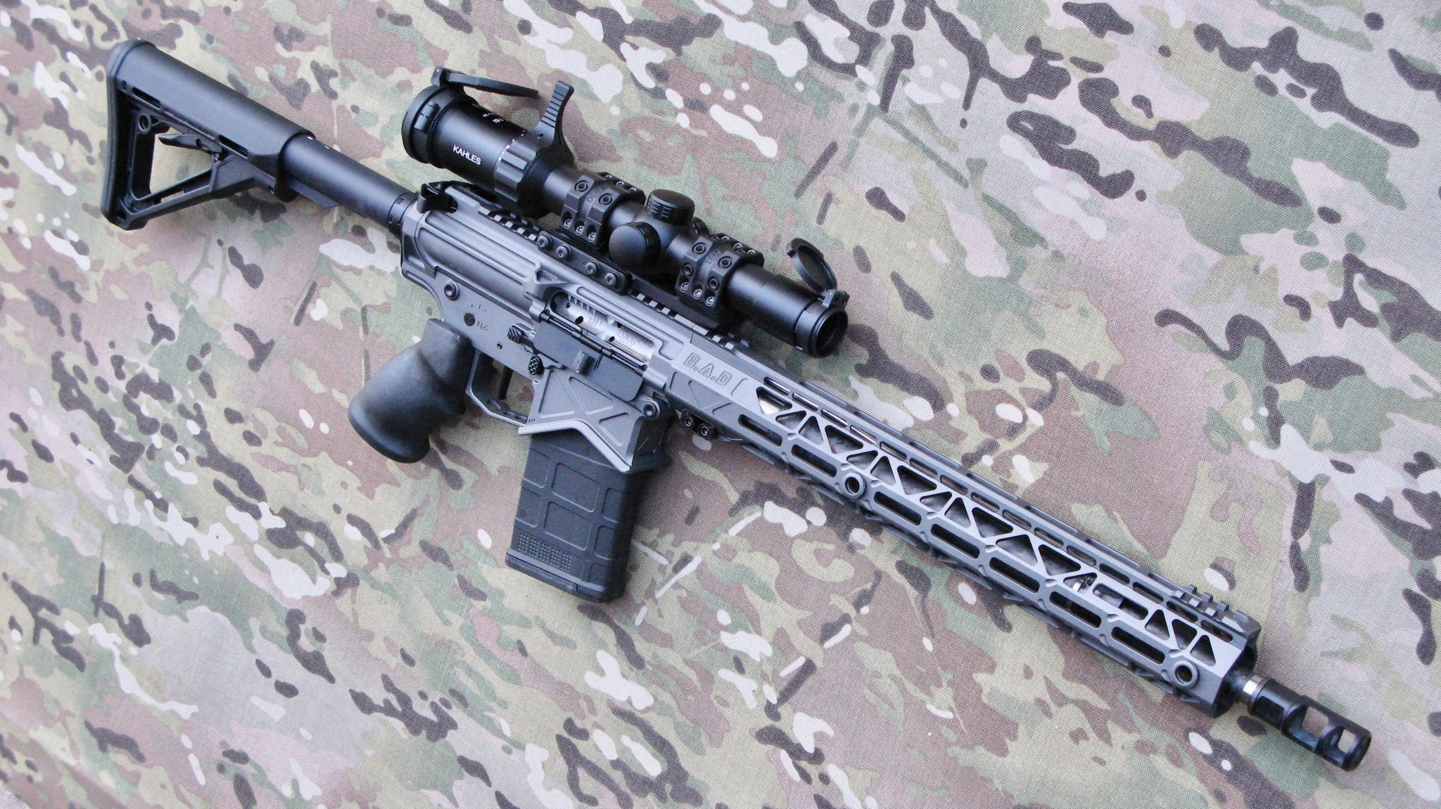

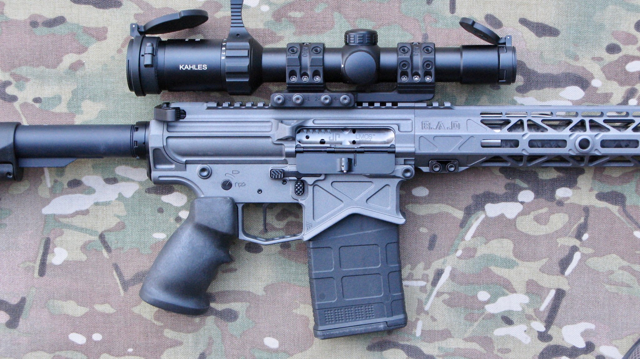

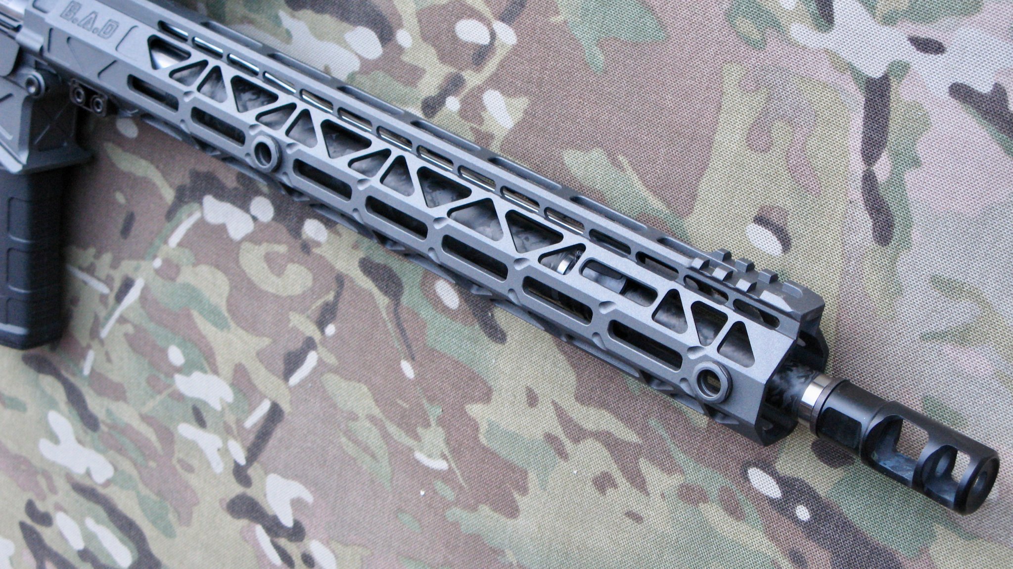

BAD 762 billet receiver set and 15" rail, all done in Titanium Cerakote; Proof Research 16" CFW barrel with intermediate length gas; SLR adjustable gas block; V Seven titanium Furion brake, push pins, receiver end plate, tube nut, grip screw, buffer stop, safety, mag release, fire control pins, etc.; V Seven S7 tool steel bolt catch; Trigger Tech Adaptable adjustable trigger set to 2.75 LB; Vltor A5 lower receiver extension with correct weight .308 spring and recoil buffer; JP LMOS bolt carrier group; SPR pistol grip; Magpul CTR stock and
25-Rd magazine; Kahles K18i in Spuhr SP-3026 mount. Base rifle comes in at 6 LB 14 OZ. Doesn't kick at all. Shoots great.

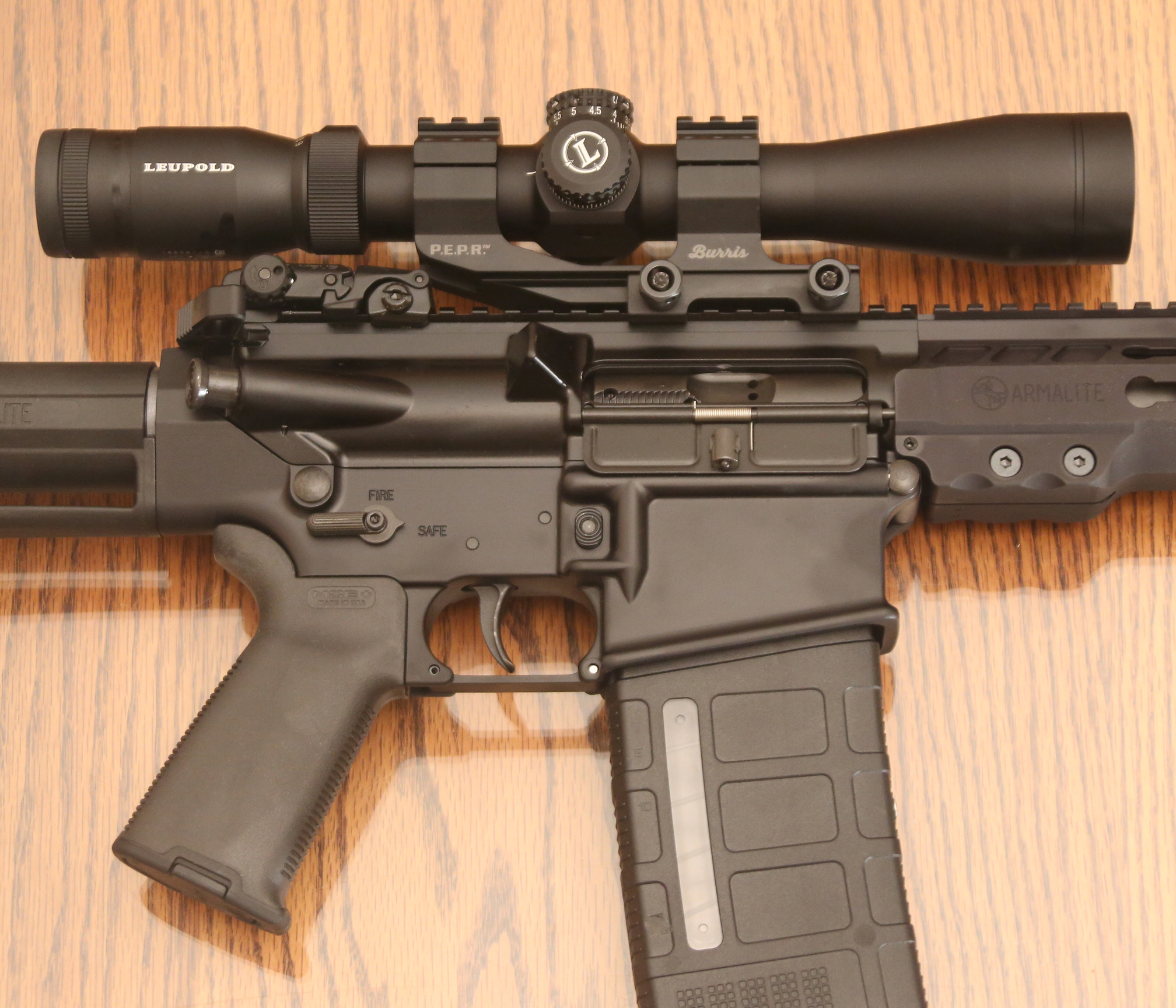

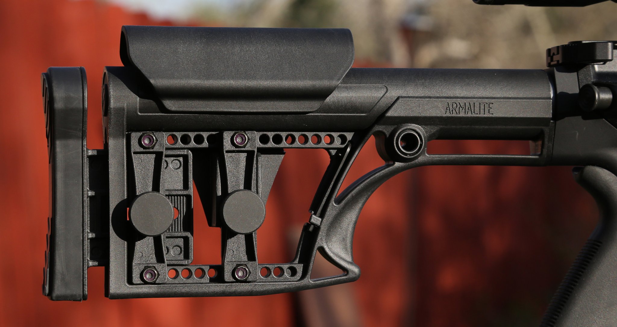

This is my Armalite AR10TAC20. It's nearly stock. I just added a Wilson 2-stage trigger. Initially, I threw a Leopold 3-9 scope on it, then later wanted to try to wring a best 5-shot group out of it, so I put a Vortex Gen 2 Razor on it for a while till I got a lucky group or two. Now it has a Vortex Viper 5-25 Gen 2.

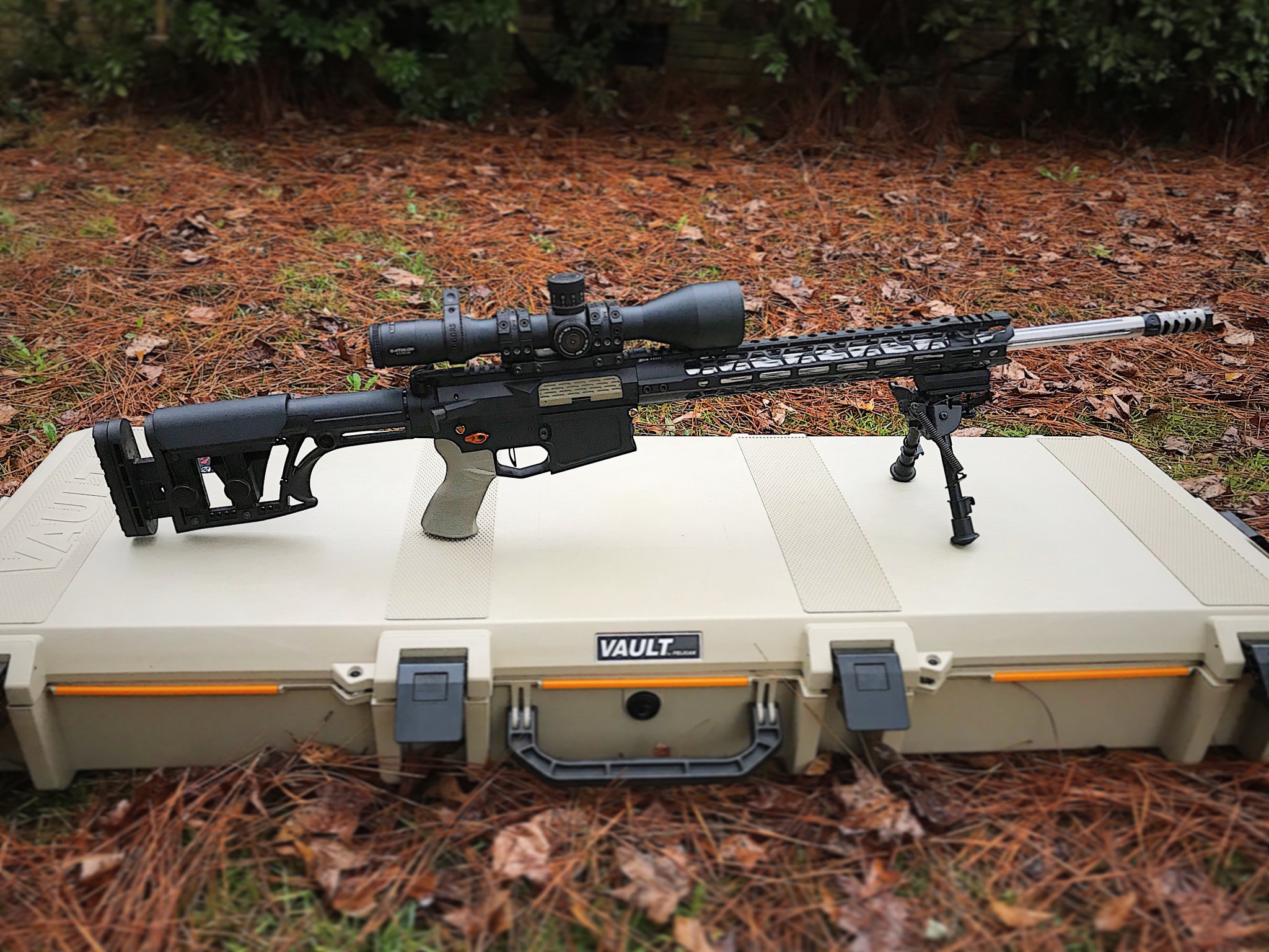

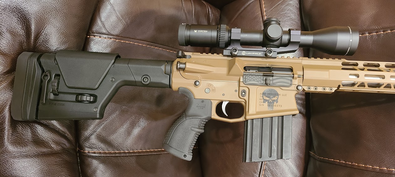

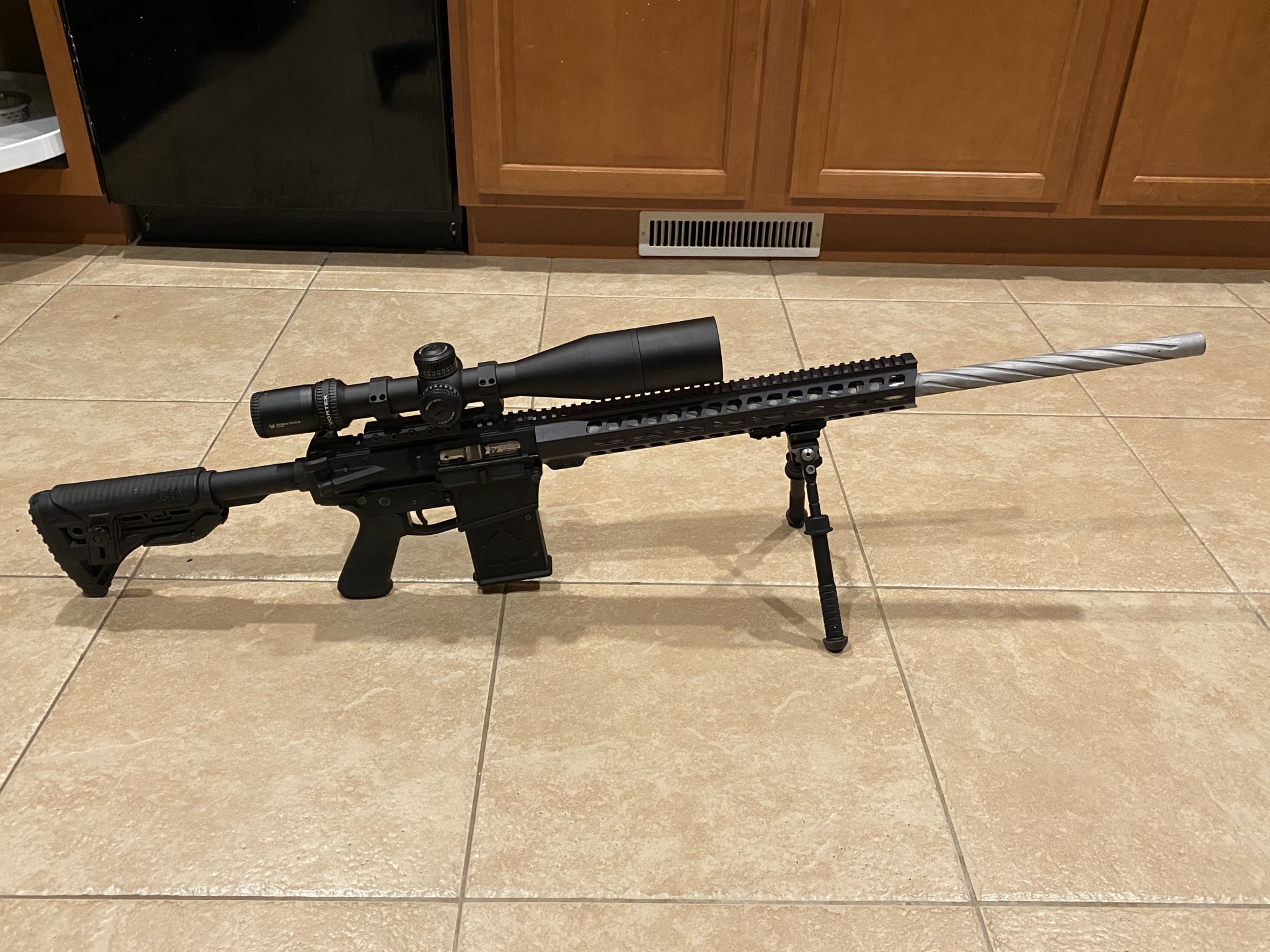

Receiver set: New Frontier Armory c10
Barrel: 22” Bear Creek Arsenal 6.5 creedmoor
Gas block: Odin Works adjustable gas block
Muzzle break: Odin Works atlas 6.5
Rail: Odin Works 15.5” O2 Lite AR10 M-LOK Forend
Bipod: Harris Bipod hbrms
Trigger: Larue Tactical mtb-2s
Grip: Larue Tactical ergo grip
Scope mount: Spuhr sp-4901 (replacing with a sp-4902)
Optic: Athlon Cronus 4.5-29x56
Buttstock: LuthAr MBA-3 308
Buffer: Kynshot Marksman Recoil Buffer
Charging handle: Trybe Defense
Bcg: Trybe Defense nickel boron .308

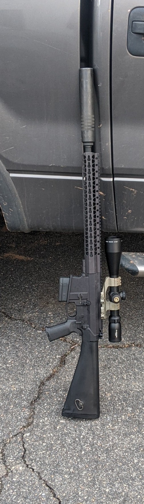

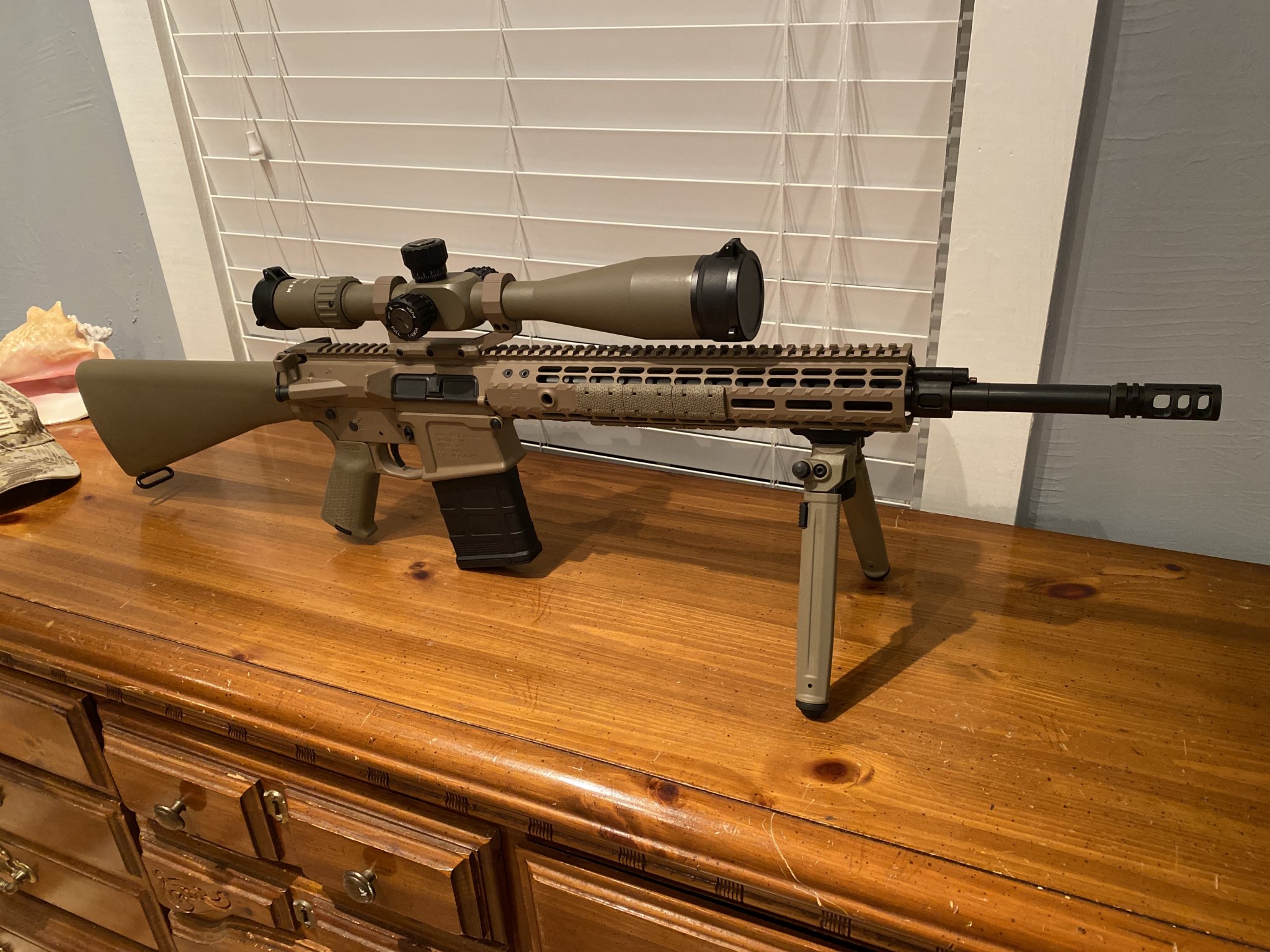

So much AR10 porn in this thread. I love 'em! Here's mine, I guess it's more of a poor's AR10, but I'm super happy with it. I assembled it with all Aero Precision parts, adjustable gas block, A2 stock, Magpul bipod, and super cheap scope. Maybe one day my form1 will finally be approved and I'll switch out the muzzle device for something more QD for a can.

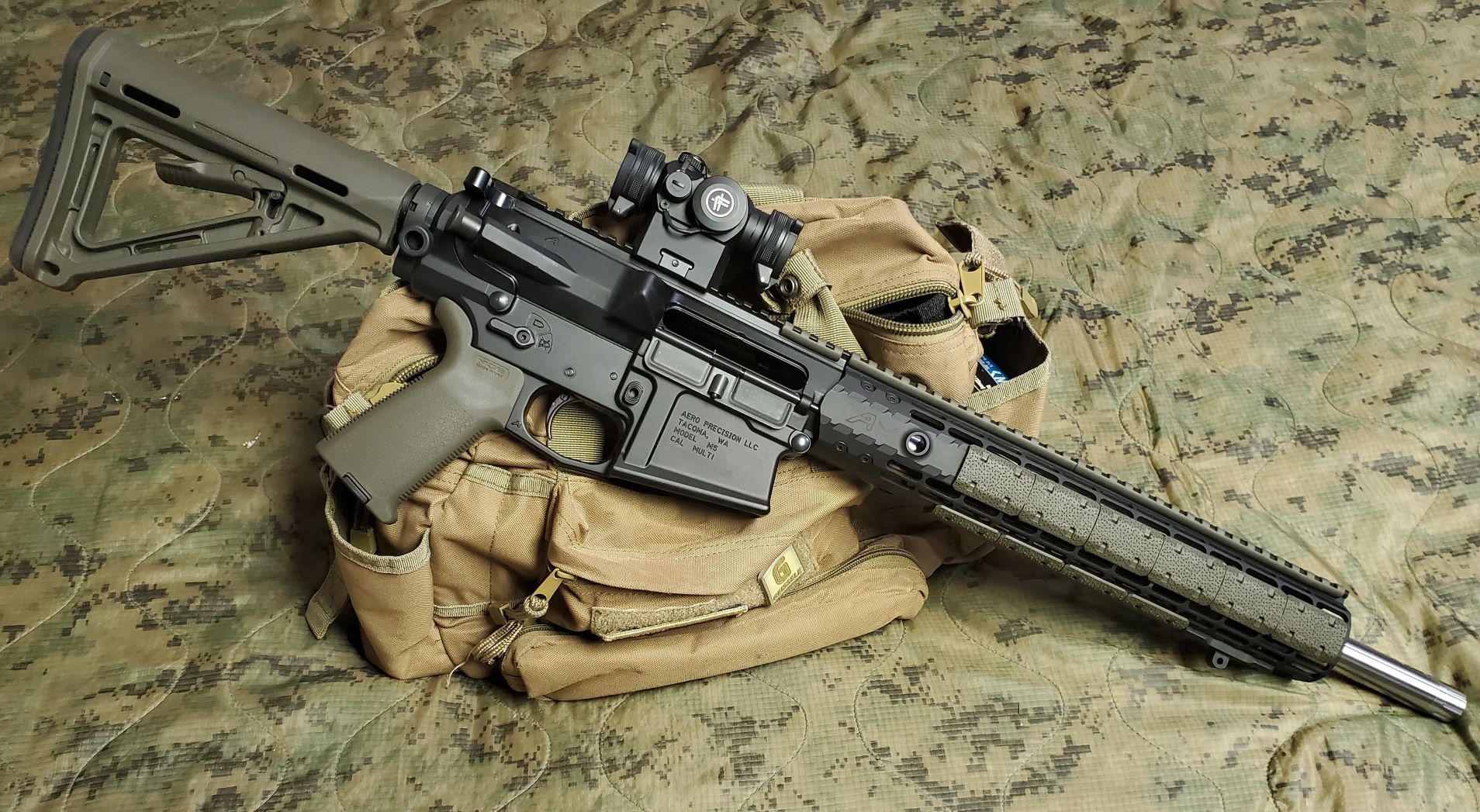

New to the site, appreciate the membership and the wealth of knowledge. Retired Marine, live in Northern VA, and frequent the ranges at Quantico. Built three LR rifles - .243 Win, .308 Win, and 45 Raptor. All use Aero Precision receivers and handguards, Geissele triggers, and Magpul furniture.
LR243:
-AP M5E upper and lower receivers
-X-Caliber 24" chromoly barrel, .243 Win, 8:1 twist, AR-10 HBAR profile, rear fluting, .0935" gas port, rifle-length gas tube
-AP BCG
-SLR Rifleworks .750" steel adjustable gas block
-Rifle length buffer with tungsten weights (8.85 oz)
-Mil-spec charging handle with Badger Ordnance Tactical Latch installed
-AR-Stoner Precision (3-port) muzzle brake, 5/8-24 thread
-Geissele SSA-E trigger
-Timney 45/90 ambidextrous safety
-15" AP M5E Gen 2 M-Lok handguard
-Magpul PRS 308 Gen 2 stock, MOE grip
-Vortex PST 6-24X scope (MOA), Nightforce 20 MOA base/rings
LR308:
-Ballistic Advantage 18" chromoly barrel, .308 Win, 10:1 twist, low profile gas block, rifle-length gas tube, birdcage muzzle compensator
-AP BCG
-Carbine length buffer (3.80 oz) (intend to swap to heavier buffer)
-Geissele SSA trigger
-Mil-spec safety
-12" AP M5E Gen 2 M-Lok handguard
-Magpul UBR Gen 2 stock, MOE grip
-Nikon P-308 4-16X scope, Nightforce Ultralight rings
-Magpul MBus Pro Offset steel sights
LR45:
-AP M5 upper and lower receivers
-X-Caliber 16" stainless barrel, .45 Raptor, AR-10 Heavy profile, 20:1 twist, .0935" gas port, mid-length gas tube, thread protector
-Brownells LR308 Nitride BCG
-Mil-spec charging handle with gun show tactical latch installed
-SLR Rifleworks .875" titanium adjustable gas block
-Geissele G2S trigger
-Magpul MOE Carbine stock, MOE grip
-Vortex SPARC II red dot sight

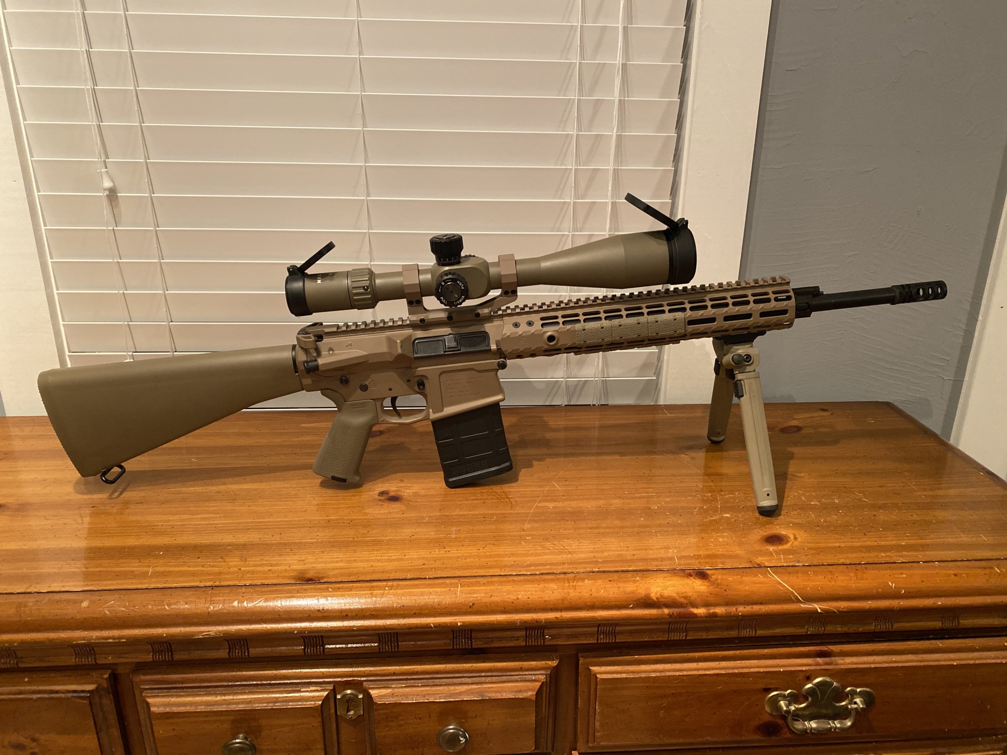

decided to build another 308 so have all aero parts except using an A1 stock and bought the centurion cmr 308 rail. Will post pics after this weekend as I put it together when I get some time.

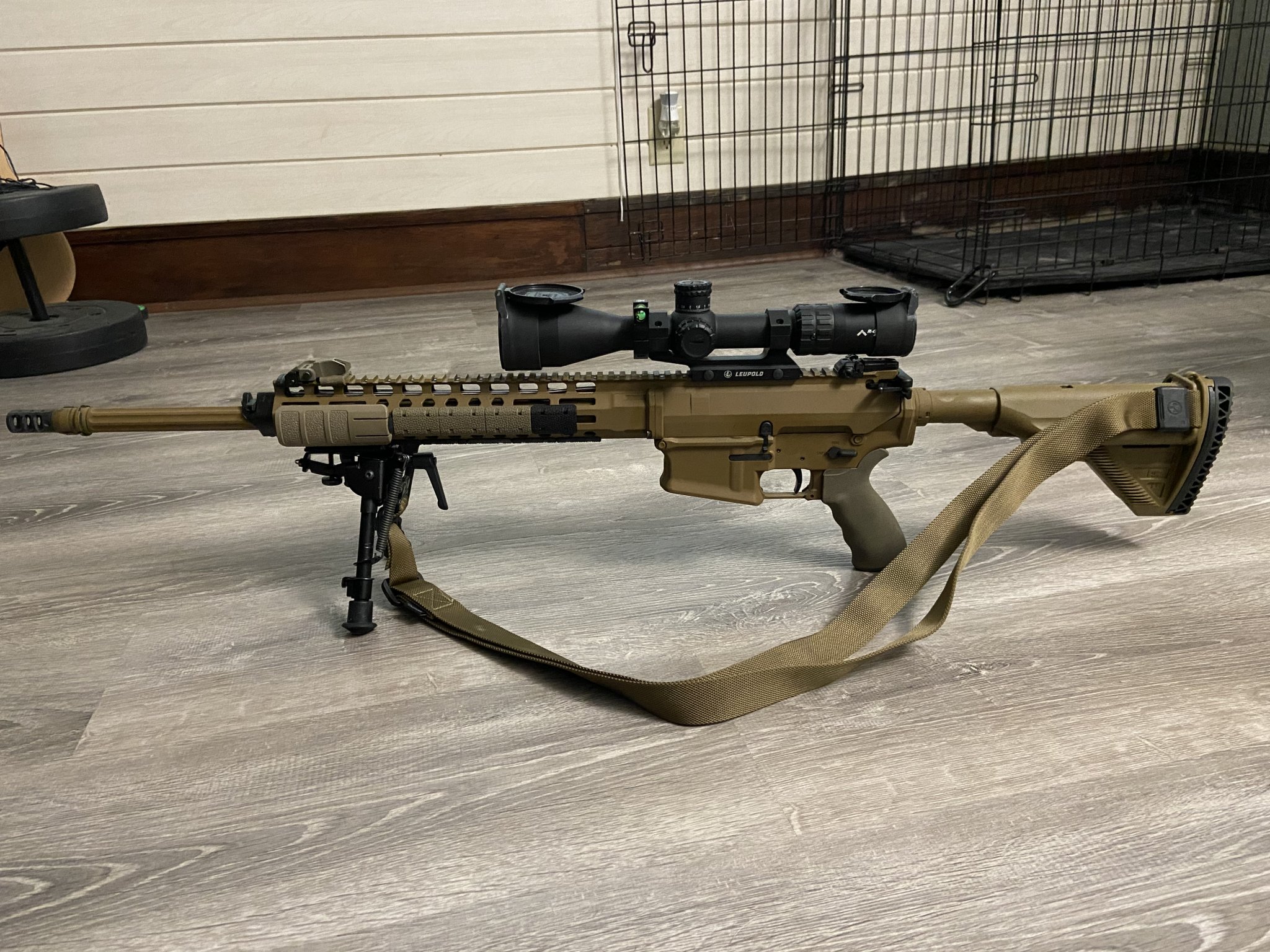

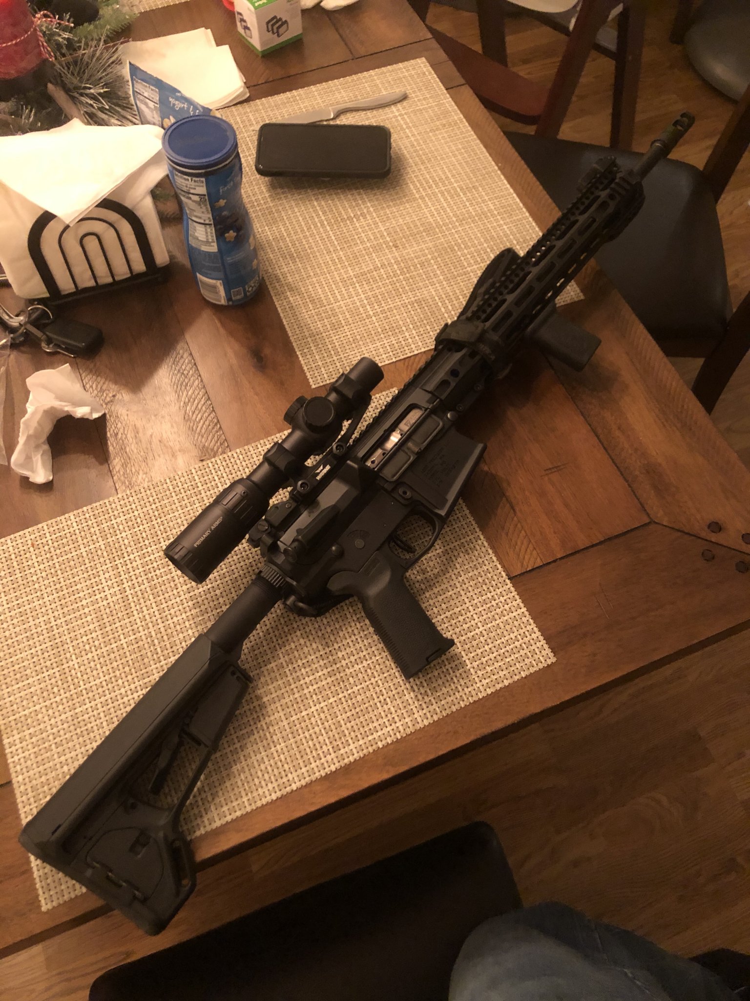

nothing special but damn does it work. 18”Aero build with FailZero BCG, JP SCS, PA Raptor 1-6, Larue MBT, Magpul furniture and a Socom brake. Did a 50yd zero and I’m calling it good for what it is until I have time to shoot it past the LabRadar and get to a longer range than the 100 I have near me.
