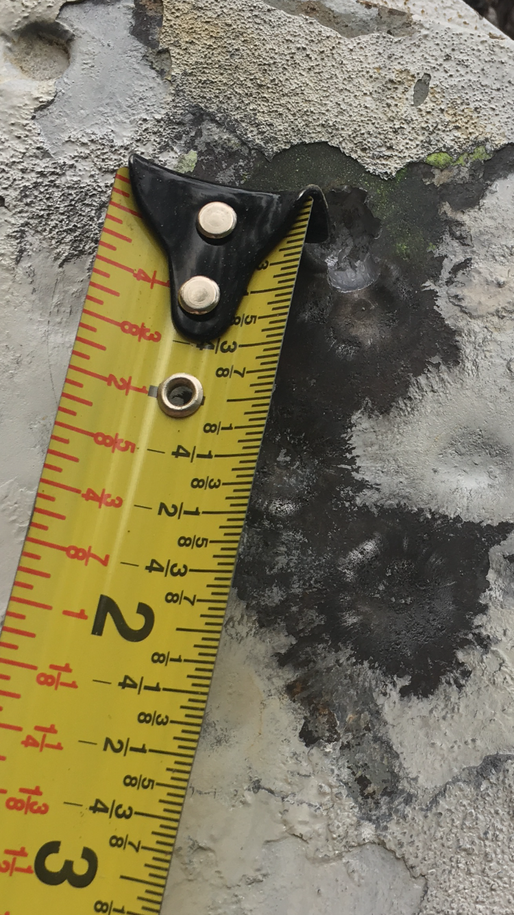

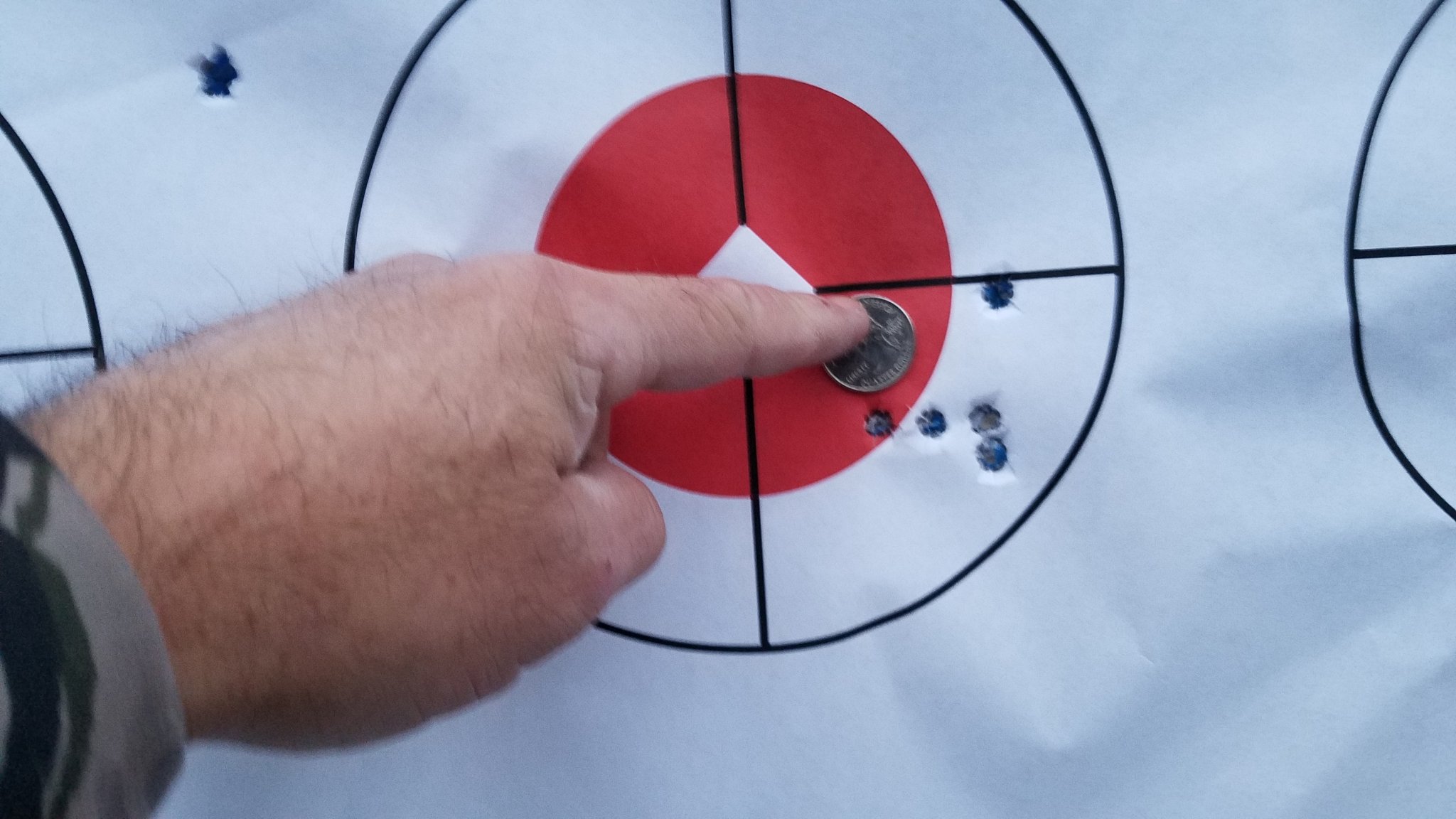

I loaded up some using 42.5 gr IMR 4064 for the first time to be fired in my new Krieger 24" barrel I installed on my RPR. Then I went out yesterday to see how they do and was very happy with the results as got a 5 round group measuring .326 MOA. After that I fired at a series of 1/2" dots (9 in total) and hit all but one at 100 yrds (wish I had taken a picture to share). I didn't chrono any as I didn't want to mount my Magnetospeed, so I guess I'll have to do that the next time out.
Info on cartridges:
175 SMK's seated at .020 off lands (COAL: 2.850); bearing surface length at .369 (yes, I sort by bearing surface length to get consistent seating depth :cool:)
2X fired Federal brass, neck sized, shoulder bumped .002, trimmed to 2.007, necks shaved to a uniform .0138, primer pockets uniformed to .013 and flash holes deburred.
QuickLoad app estimates MV to be around 2689 fps
Glass is a Vortex Viper PST 4-16x50 zeroed at 100 yds.
Reactions: Aimsmall55

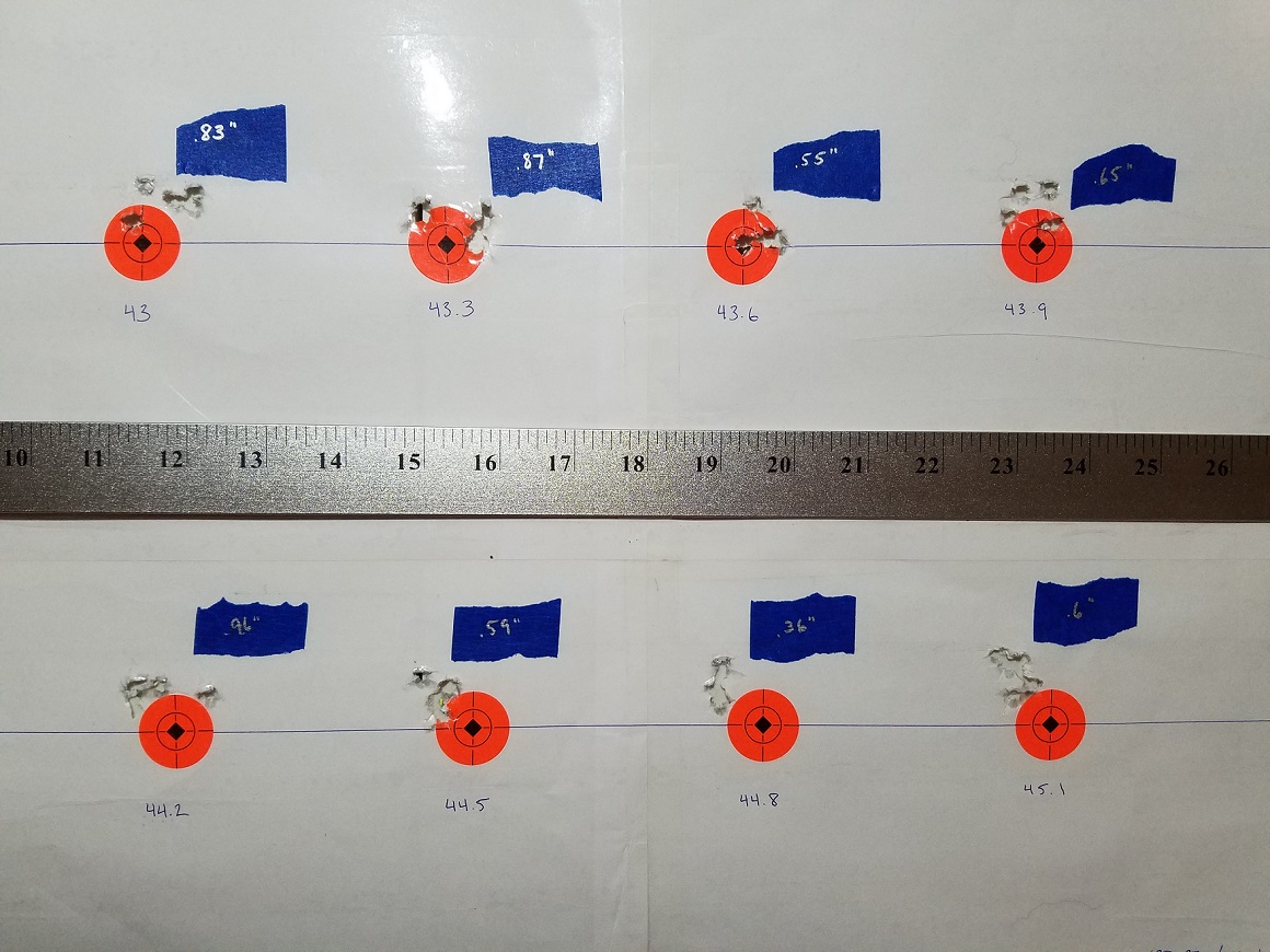

.308 Win, 178gr Hornady HPBT
LC12 Full Length Resize 1x Fired
2.0" Trim Length
CCI200
Varget 43-45.1 grain. (Hornady Book Max Load is 43.2)
2.806 COAL
24" M24 Profile K&P Barrel
LRI cleaned up Remington 700 SA
Slightly cratered primers from the start, but still rounded on the edges. Slightly stiffer bolt lift on the 45.1gr charge, noticeable but ever so slight.
Threw one shot on the 43 grain charge group when my neighbor popped off a braked 7mm RUM and rattled my fillings loose as I broke my shot.
Looks like your powder node is around 44.8. What did you decide to use to work up your seating depth?

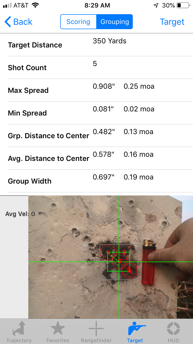

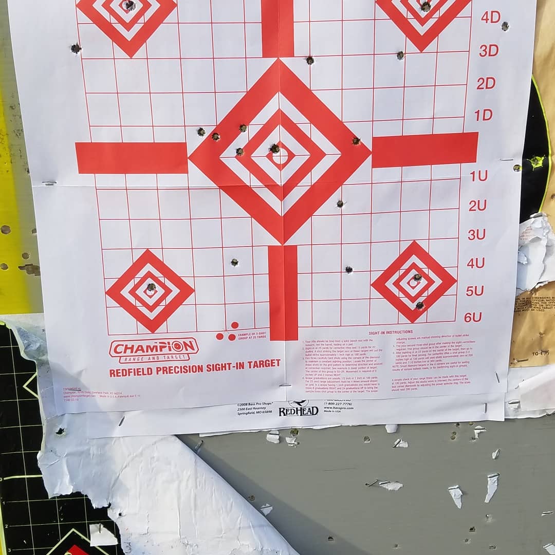

Finally got out to the range today and it turned out to be a good trip. New rifle new magneto speed new brass and I think I've got a load! ?
Temp 81. Pressure 28.5 DA 3290 ELE 1978' Wind was 10-15 from 7 oclock
All shooting was prone of a concrete pad w/ Harris bi-pod and rear bag. With the Magneto speed mounted.
Bergara B14 HMR .308 20" 1:10 twist
Virgin Lapua brass
CCI BR2
44.1gr Varget
178gr ELDM
. 005 to the lands @ 2.835 COL
to feed reliably. Don't have my log in front of me but 2.213 BTO is stuck in my head.
HI 2716
LOW 2708
SD. 3
ES. 8
2708
2713
2716
2714
2711
No pressure signs and I had a shooter I trust look as well. Befor any one flames me I understand this load is over the Hornady book max and their was a very light crunch when seating. I'll get a drop tube befor I load up the next batch and see if that helps.
5 shot group was 1.02 outside to outside. -.308 = .71 moa. This puts the round count @ 130 on this rifle. And on an average day I'm capable of .6-.8 So this should work for me.
I've got another 25 rounds of virgin Lapua brass primed up ready to load , so I'll do those up @ 44.1 shoot 10 over the MS and 3 5rnd groups to verify. Over all no spontaneous rapid rifle disassembly all fingers and eyes intact and good #'s ... A good day!

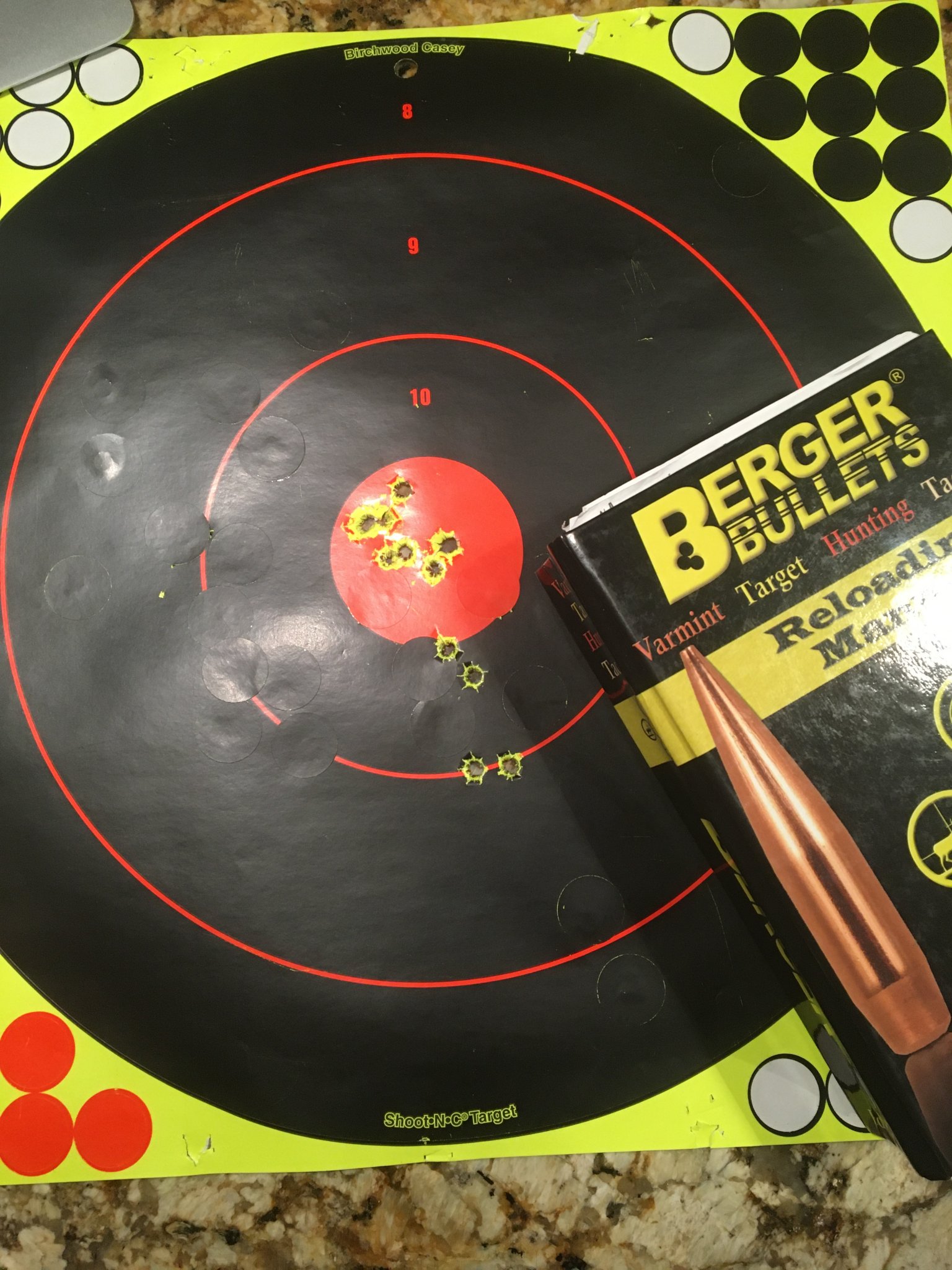

Am still getting good results with 42.5 gr of IMR 4064. Yesterday I played with seating depth's running from .003 off at .003 increments to .015 off. None of them did as well or any better than being .003 off. The 42.5 grs gave me a 5 round group of .372". And with an average MV that I've measured with my MagnetoSpeed V3 of 2676 fps, I feel this is the 4064 load I'll be sticking with.
Though I have a jug of AR-Comp and ran a previous load that I developed for my old barrel, which was 39.6 grs set with the same specs, I tried it with this new barrel and got pretty good results (again) with it. 5 round group was at .263" and firing 10 rounds to get chrono numbers I got an ES of 26, an SD of 7.5. and the MV average was 2603 fps. These were loaded in full length sized Peterson brass. I tend to get better groupings with neck sized only brass than I do with FL, so I'm gong to see if that holds true with this load.

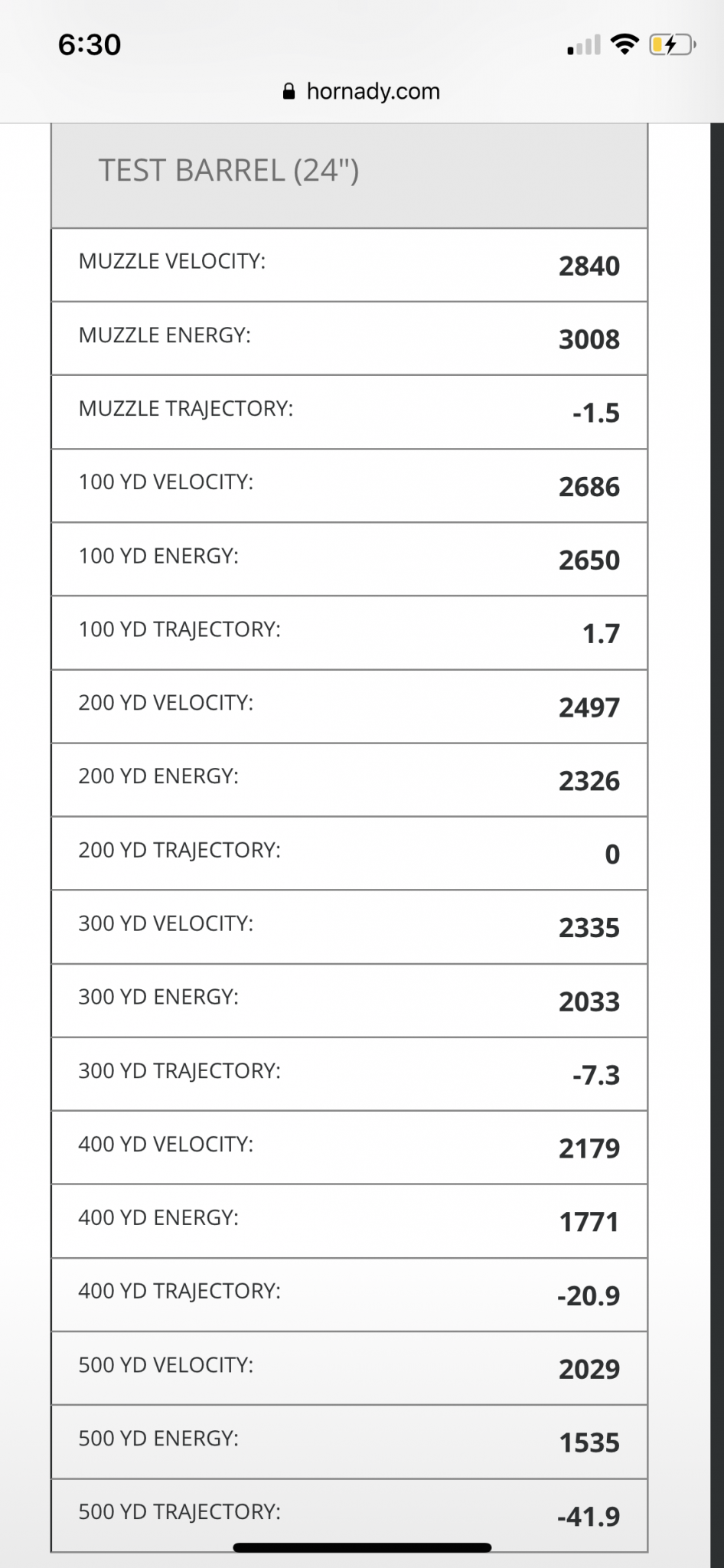

If you guys wanted to set a barrel and load up for Max velocity out of 168 ELD-M’s, what would be your reamer/powder/etc... choices?
ETA: would 2850 FPS be a realistic expectation from a 24” barrel?
I guess basically what I’m asking is would it be that easy to squeeze much more velocity out of a 168 by hand loading than this loaded ammo is getting?

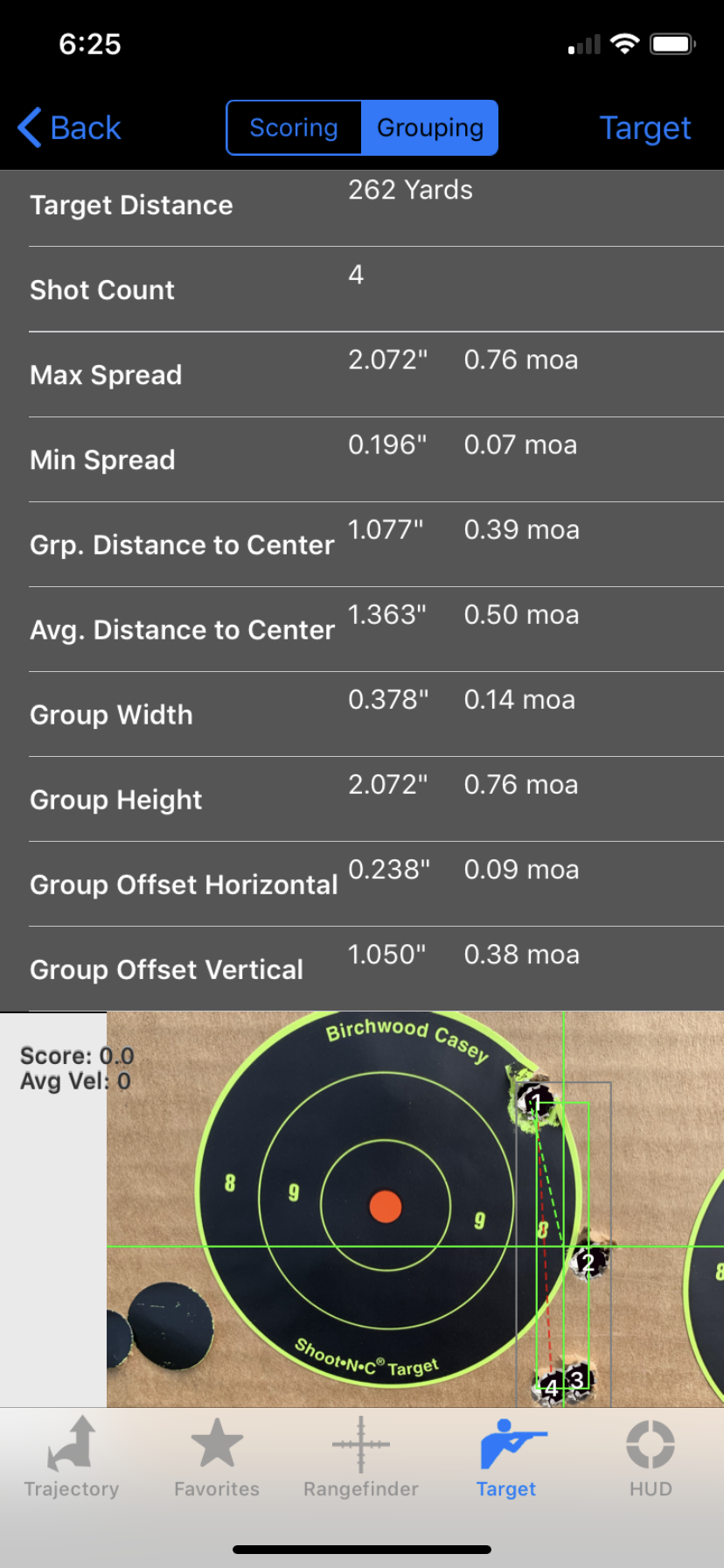

Loaded up 40 rounds yesterday with 43 grains of imr4064. Gun seems to like this load. The nosler brass on the other hand is junk, 3 firing on it and I’m getting loose primer pockets, time to switch to lapua.
Had trouble with inconsistency on the ogive of the hornady bthp also, will switch to 178 eldm once I’m out of them.
Nosler brass trimmed to 2.005
Hornady 178 bthp
43g imr4064
Seated 2.180 ogive
Wlr primer
Velocity 2520
Sd 14
Es 25

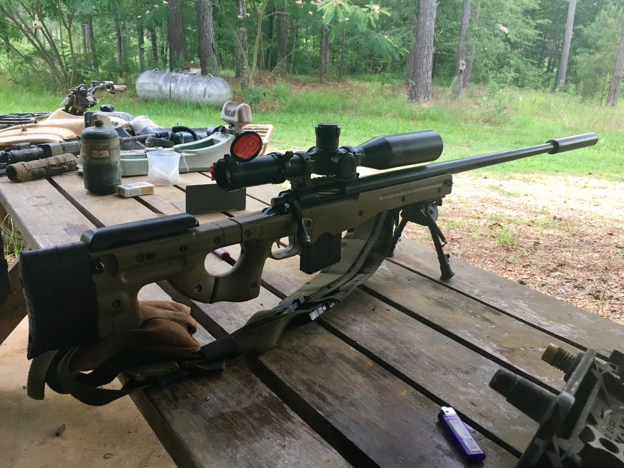

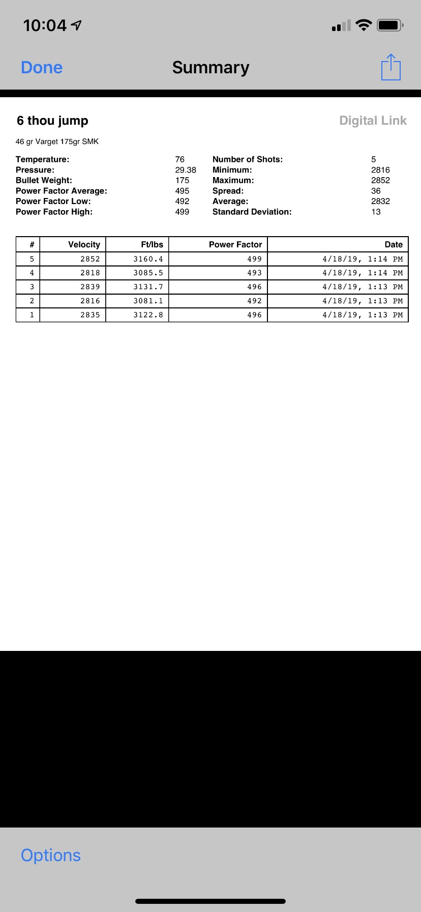

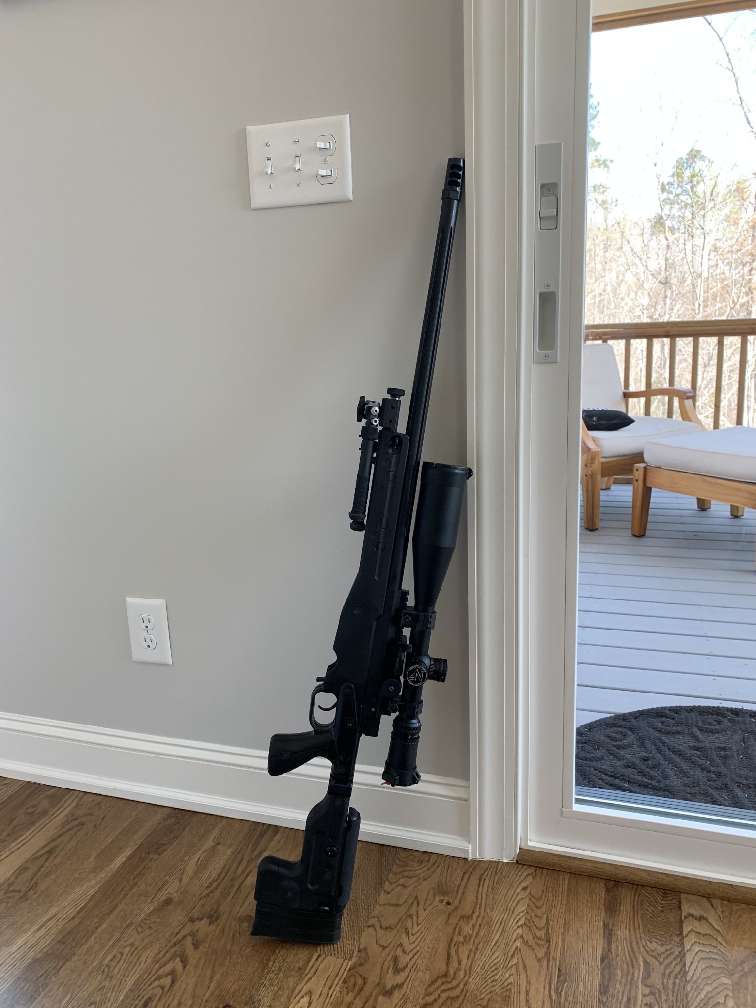

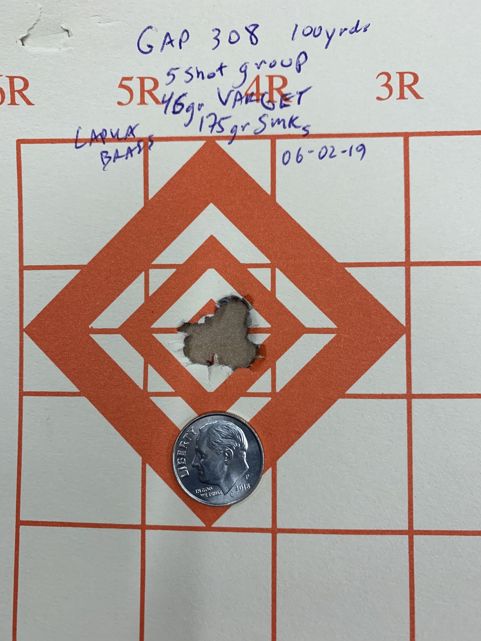

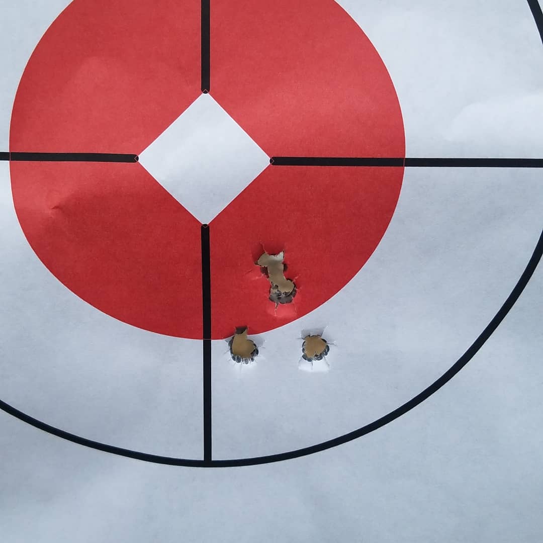

Lapua brass
46 gr Varget
Federal large primer
175 gr SMKs
0.006” jump
5 shot cold bore group at 100 yards
GA Precision 308
Badger 2008 action
Bartlein 24” barrel 1300 rounds
11.25 twist
AIAW Chasis
Little Bastard Brake
NSX 5.5-22x56
Atlas Bi-pod

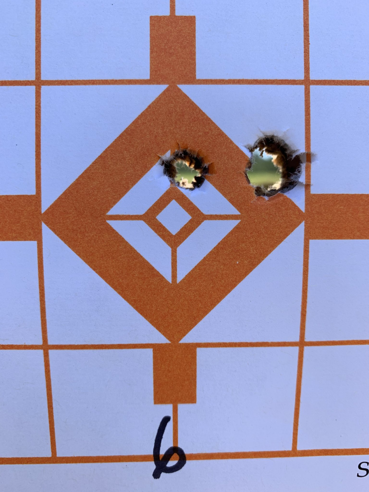

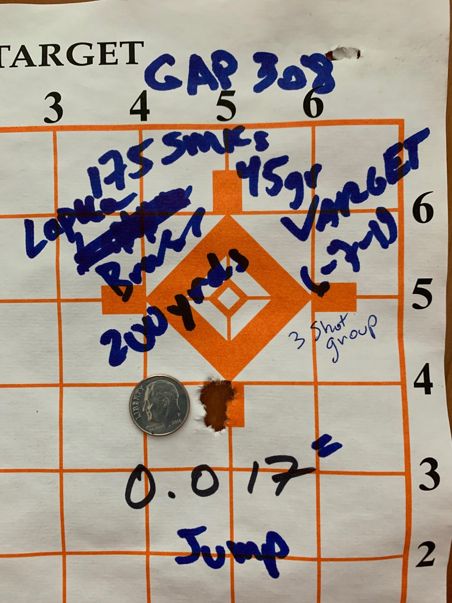

Went back out to range today to do a bullet seating depth test and found 0.017" Jump works best:
175 Berger OTM
VarGet 5 ea 42.9 @ 0.040" off and 43.3 @ 0.030" off.

175gr nosler custom competition
42.0gr IMR 4064
FED 210 primer
Lapua brass full length sized
2.850 COAL
2661 avg..

New caliber to me, so not much down the tube. Both combo's 1/2 moa at 100y.
Small sample size. Still doin OCW's on several powders and bullet combo's.
Savage 10FCP-SR 24" barrel, 4 port brake
Bushnell engage 4-16x44
Sinclair F-Class front bipod
Precision underground rear bag.
Rl 15 43.1 weighed after Lock and load drop. +/- 2 kernels of powder
CCI 200
Lapua once fired fl sized with RCBS die neck honed for .002 neck tension(worth it)
168 smk COAL 2.820 .135 off the lands
2643fps SD 2 es 7 over 10 shots
First group is cold clean bore. First shot middle right then the next 4 are high as it shoots in. Adjusted .1 mil down and drilled the hole
Second was a target at 200 that had no holes near the bullseyes. I did a five shot dot drill using my splits app in 18 seconds and some change from a loaded chamber finger on the bang switch. Add 1-2 seconds for inserting a mag is my good day run
Third is a 5 shot 300yd had some issues with mirage. This is from a heated shoot house and I sit right next to it because it is the 300yd lane. I don't turn it on because of the mirage but others do
The other 2 are Fgmm I pulled the high shot in the bottom and The 2nd from bottom I went up.2 and right instead of left. Moved .4 left then down.1 and right .1 for the 3.
This rifle shoots box ammo really well. I have faster 175grn loads that shoot tighter than the FGMM. The smk and eldm use the same 0 so in a pinch or letting someone shoot it/class etc the box ammo is not the cuprit of a poor group.
