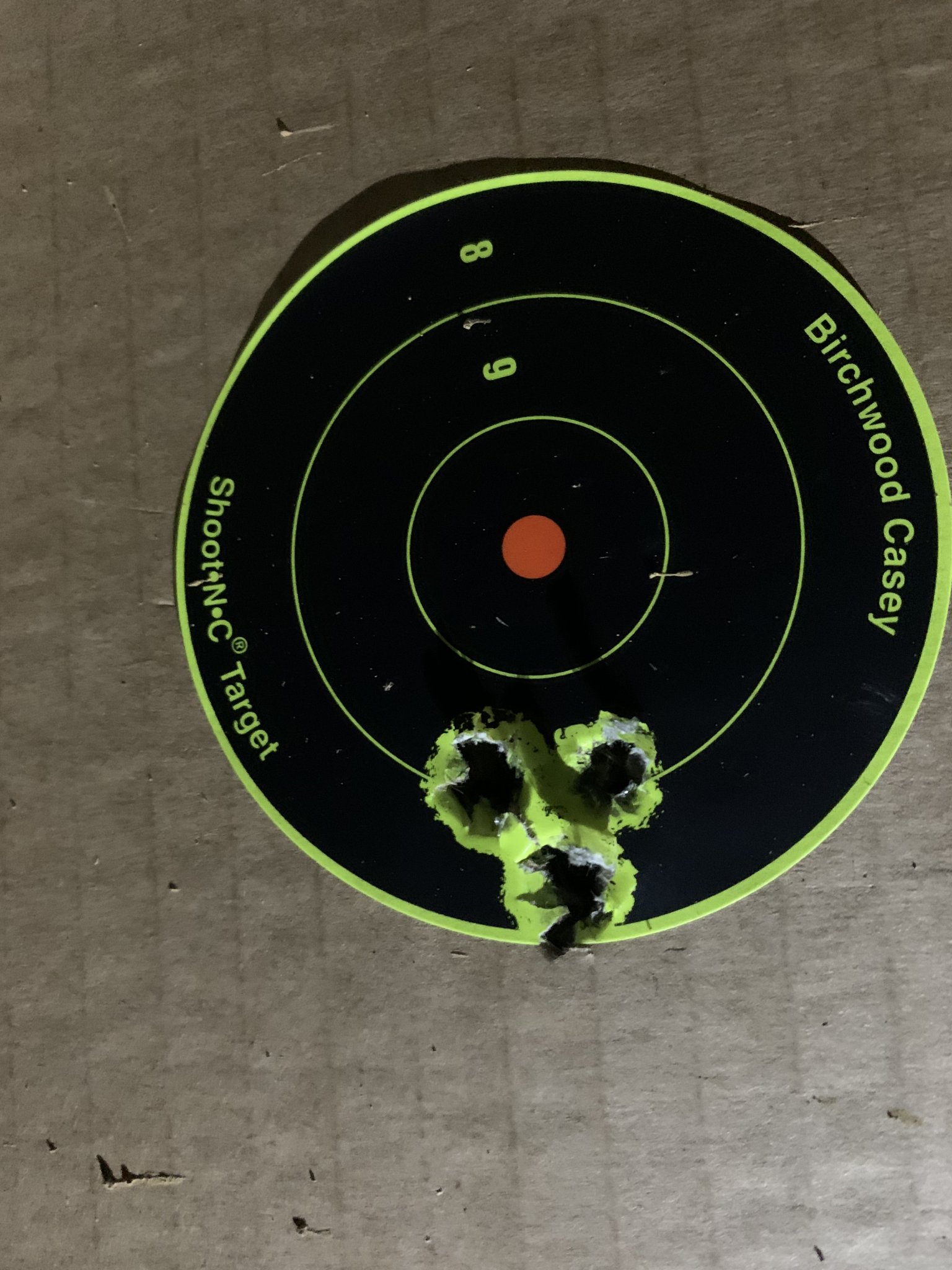

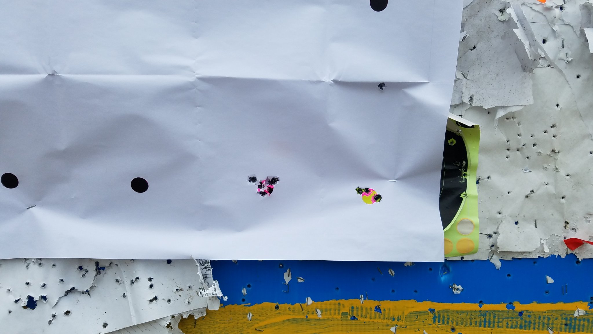

I'm at 2840 with a berger 168 using both varget and Rl15. I'm at 2708 with the 195tmk with CFE 223 COAL 2.940 single feed in my gun.
This 3 shot is at 300. It's 1 mil left of the bull to the right. The stripe is the waterline of the bull. This is touching and it has always shot left of the 150-178 sized bullets .120+ off the lands. I saw it after the first shot and just held the same poa for the group.

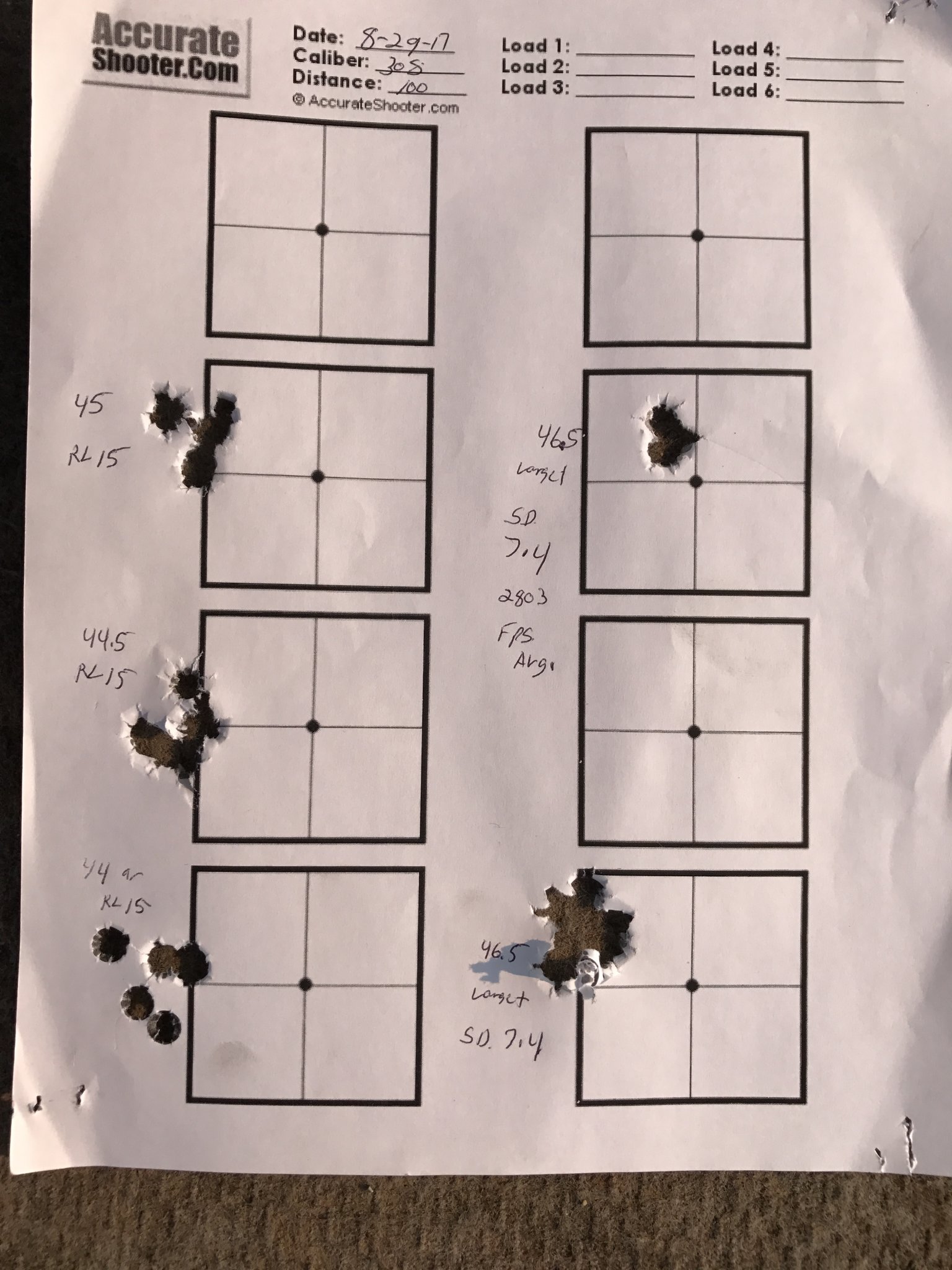

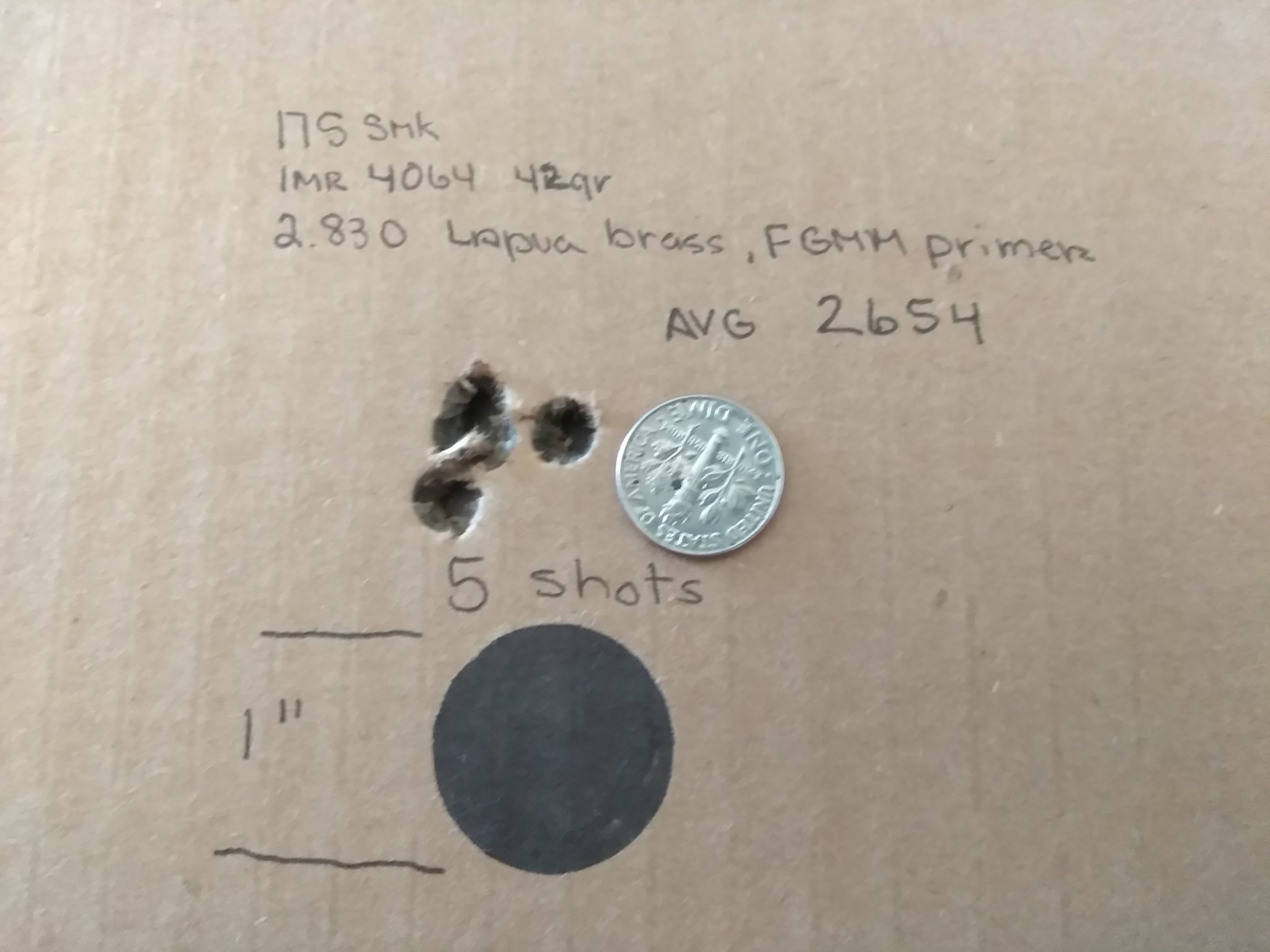

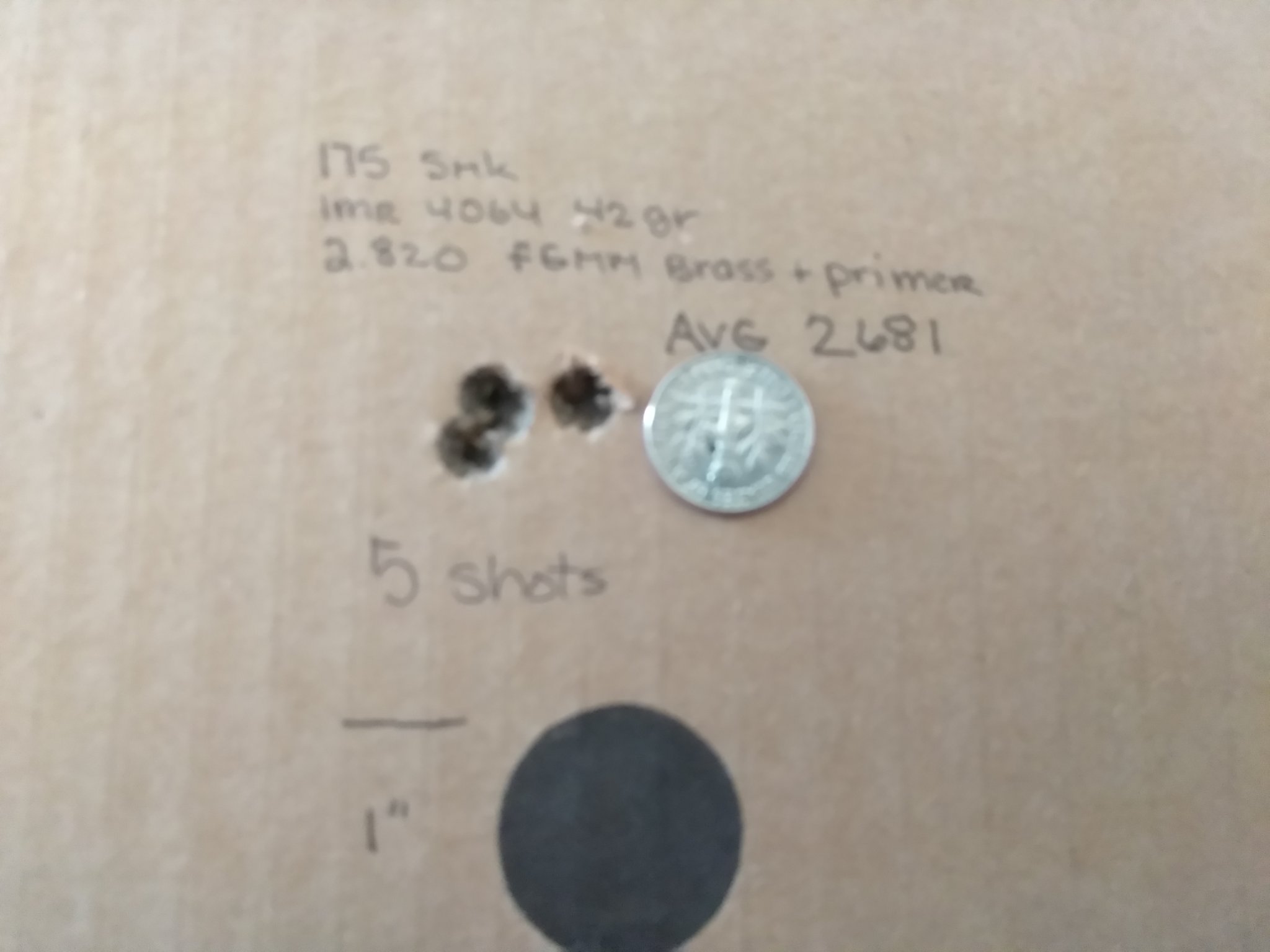

10 shot group 168 speer hpbt with imr 4064 @42gr
3 shot group AR comp same bullet 39.9 gr
I pulled the 9th shot and was so pissed, I pulled #10 worse. Black dot is 3/4"
Cheap get it done quick load
pull down M118 lr brass right from the bag it came in they still have live primers
168 speer match 22ish a box of 100
43.3 RL 15
COAL 2.820

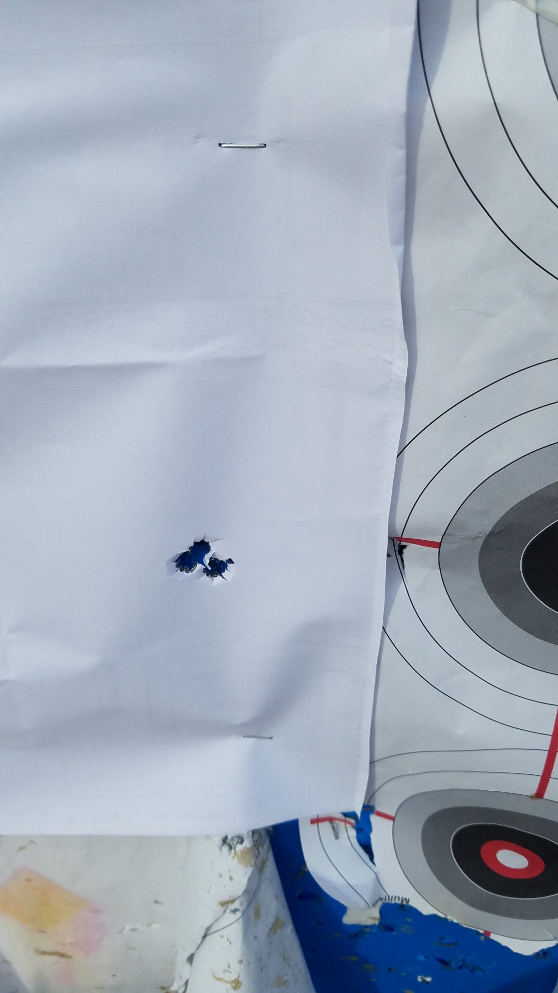

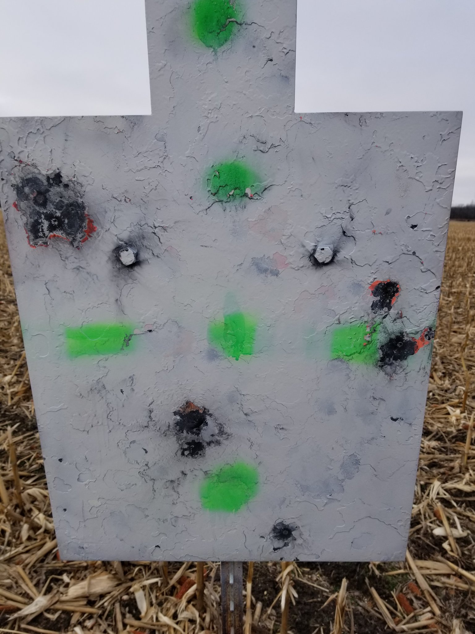

Sometimes you just need to listen to people. Was trying 185 class bullets and wasn't having alot of luck (.5+ moa). Went back to 175 OTMs and problem solved. 3, 5 shot groups at 575 plus 1 to check dope before groups. 44 gr Varget, 175 OTMs, Federal GM brass, Fed 210M. Seated to same as factory Federal GM 175s. 2720 fps, 26" 5R.

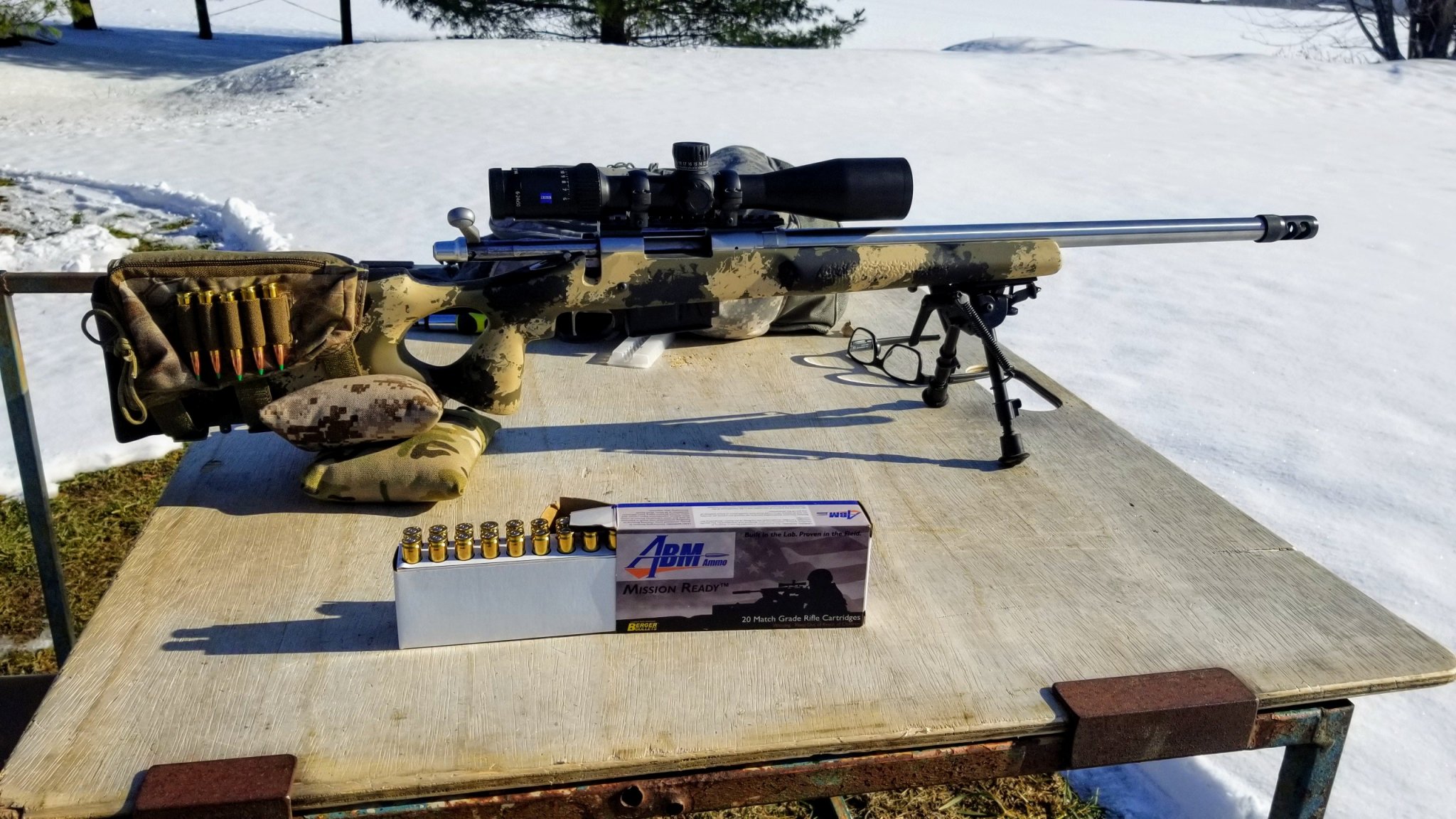

Shot my FN SPR A1 today with some reloads.
Federal 1x brass trimmed to 2.005
Berger 175 vld hunters coal 2.840
Cci 200 primers
42 grain of Varget
Velocity was 2597 over 5 shots with a sd of 5 and Es of 12.
From what I have seen on here with Varget this seems like a low node. I will try going up in powder charge. The FN has been an amazing shooting rifle.
5 shot group at 100 yards
Reactions: Snuby642

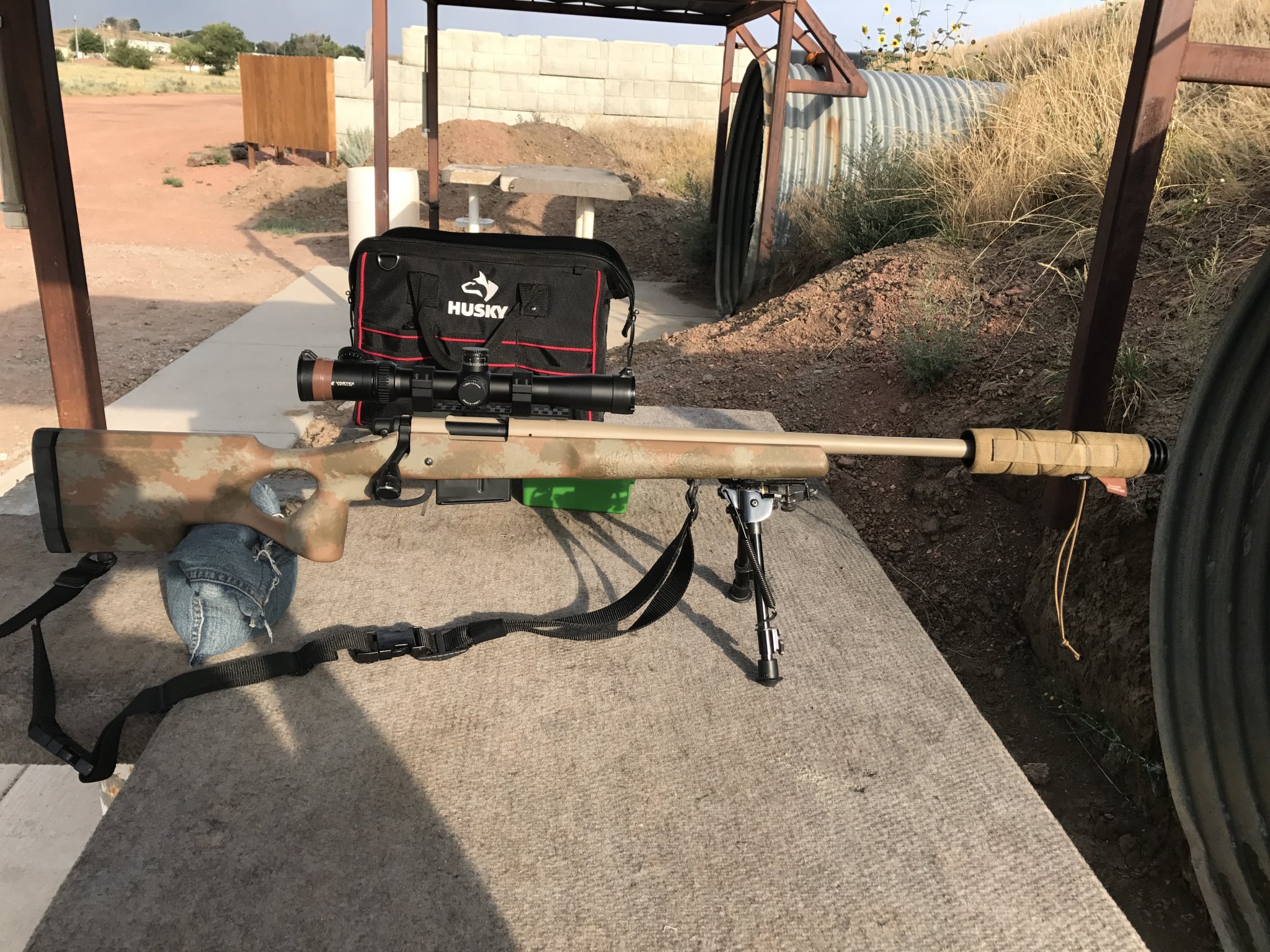

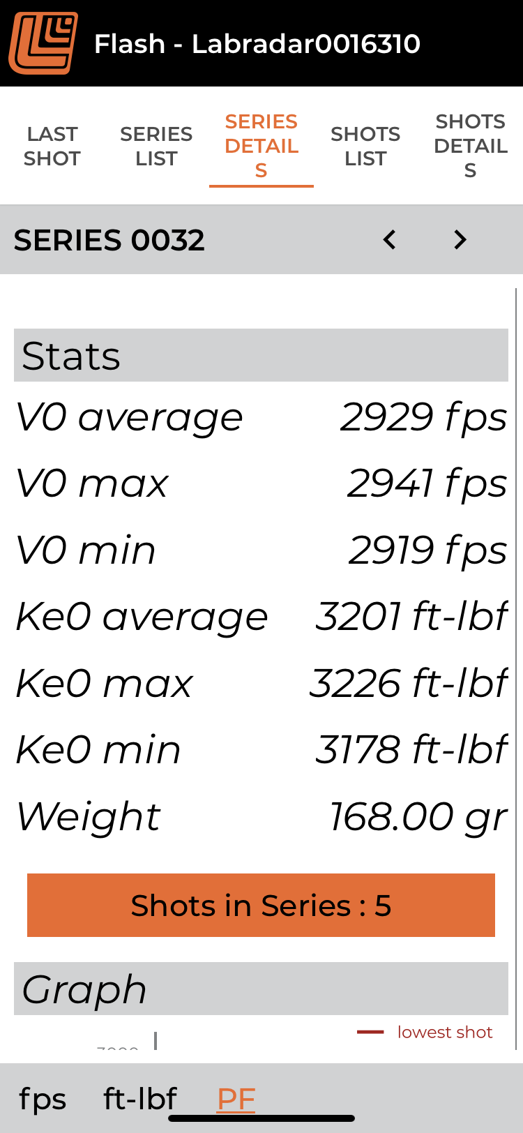

I’m liking cfe 223 & 168 eldm. In my 24in 5r 308 I hit 2900 FPS with 49gr cfe, br2 primer, lapua brass, oal 2.91in, .017in off the lands, with 8fps sd, & grouping well. Winchester brass was 75fps slower than lapua with the same load at 49gr of cfe 168 eld. At 49.3gr to 50gr exhibited pressure & was only 25fps faster. I’m going to try rl15 & see how it does vs cfe. I also want to see what temp stable powders do best. I have h4895 & varget, are there any other temp stable powders I should try for the 168 eldm
I was going back over my results & found 49.5gr of cfe also produced very good results with 2930 FPS in lapua brass in my 24in 5r 308 168gr eldm. SlightLy flattened primers but not too bad. Forster bench rest full length sized, br2, 2.91 oal, .017 off the lands, sea level, & 50 deg weather. Very good half moa groups but I’m not sure the cfe will do well when summer comes around in the cal dessert but I always shoot early before it gets too hot

Hmmm??? Interesting. When I plug those number's into QuickLoad it calculates MV at 2769 fps. I've never seen my QL's calculations that far off before (~ 160 fps). And it shows the pressure at 56,143, which is not particularly high to show any pressure signs. I wonder if there's something unique about the chamber the would produce higher pressure???
I also checked it on my pro chrono & my friends chrony and they were consistent within 10 FPS of each other. I thought the same thing you did, it seems high. I also loaded Winchester brass with 50gr cfe that only got 2900 FPS. I ran the ballistics in my strelok & shot at 550 & 900 yards & it’s was dead on accurate with 2930 FPS plugged in. Hodgdons site said 49gr would produce 2830 I think so I was expecting around the same for my 49gr but I was getting 2900fps & with 49.5gr 2930 FPS with lapua. Winchester brass was almost dead on with hodgdon site 49gr at 2835 & 50gr at 2900 FPS but lapua brass was running faster with less powder & less pressure signs. The sd in lapua was better too around 8 FPS where the Winchester was 15-20 FPS
