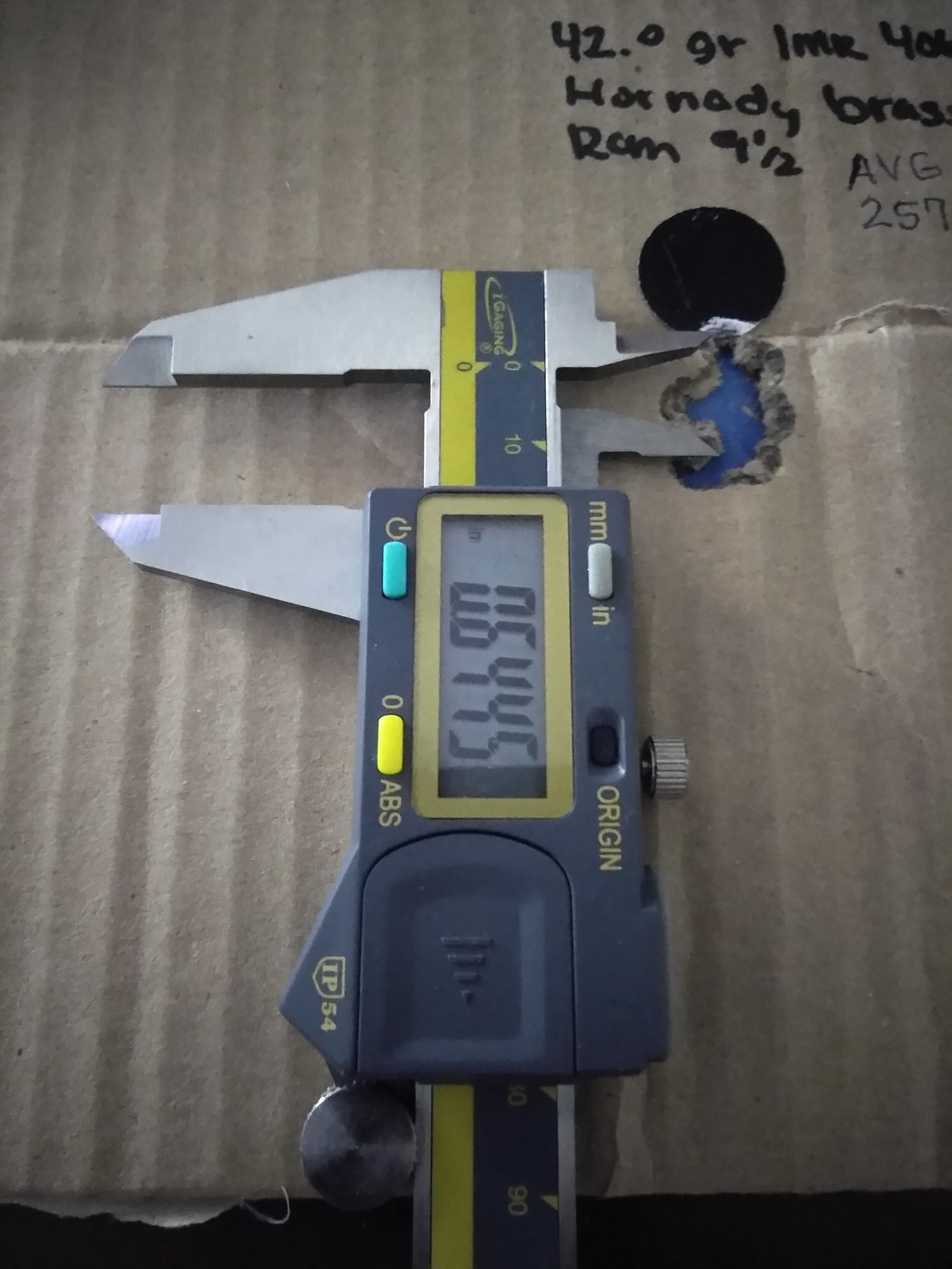

Little load development in my rebarreled M70 with a Remington 700 5R 20" barrel.
10 rds at 100yds.
42gr Imr 4064
Hornady brass
Rem 9 1/2 primers
175 SMK 2.820
Avg 2579 fps

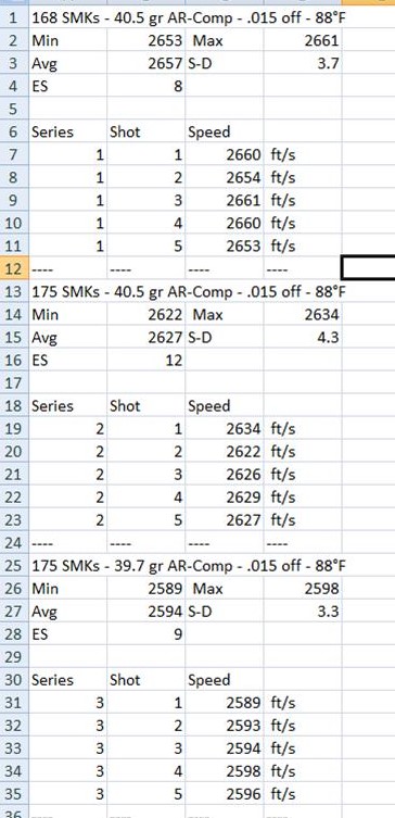

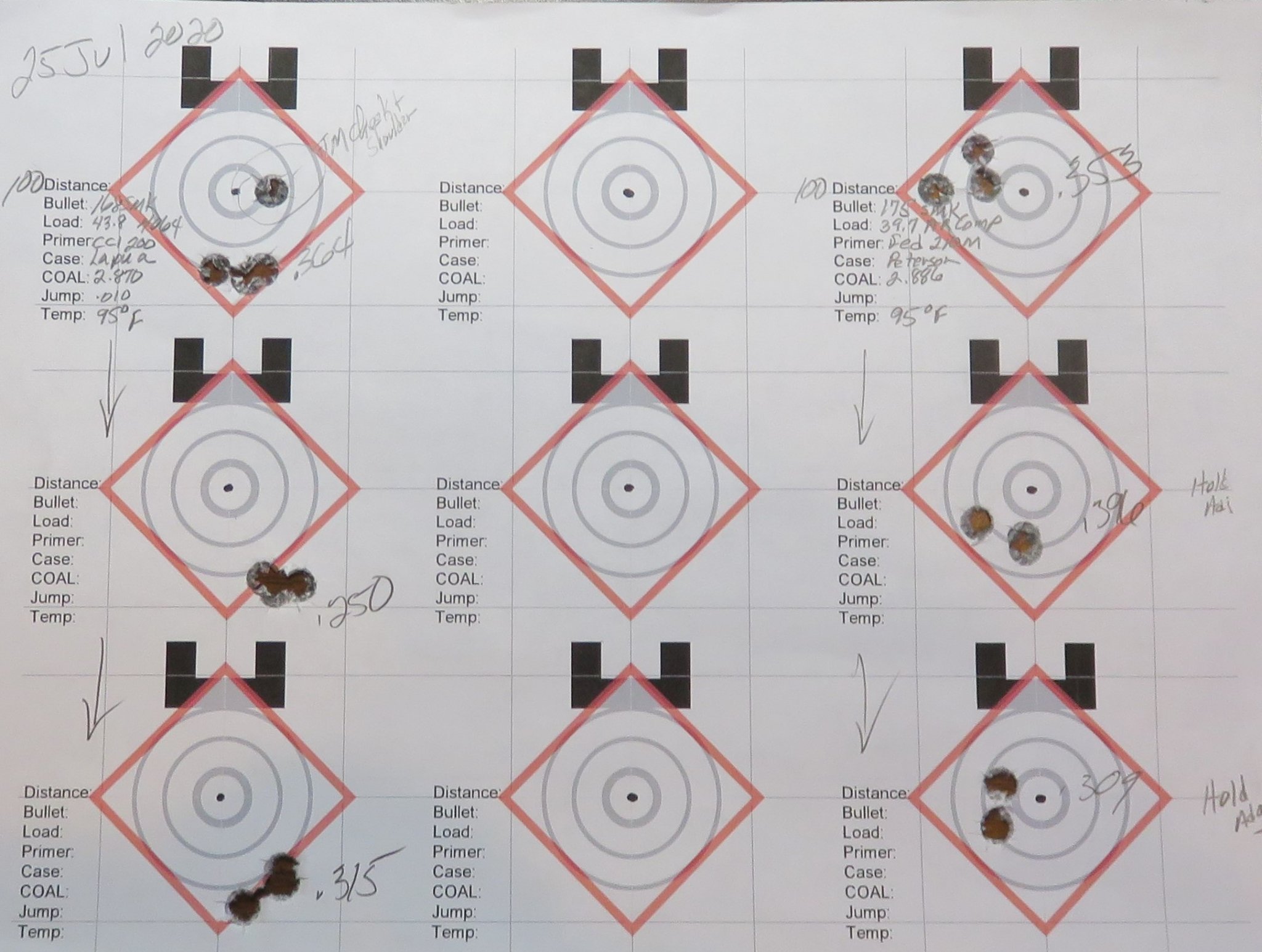

I've got a 24" Krieger barrel on my .308 RPR now and thought I'd try out a Harrell tuner. So, though it's been 380 rounds since I cleaned the barrel, I went out yesterday to see if I could get the tuner to tighten up my groups some for the loads I've been recently firing and was pleased with the result . They're only 3 shot groups, but all under .4 MOA and tell me what I wanted to know. MV for the 4064 load on the left is at 2736 fps and 2607 fps for the AR Comp on the right.

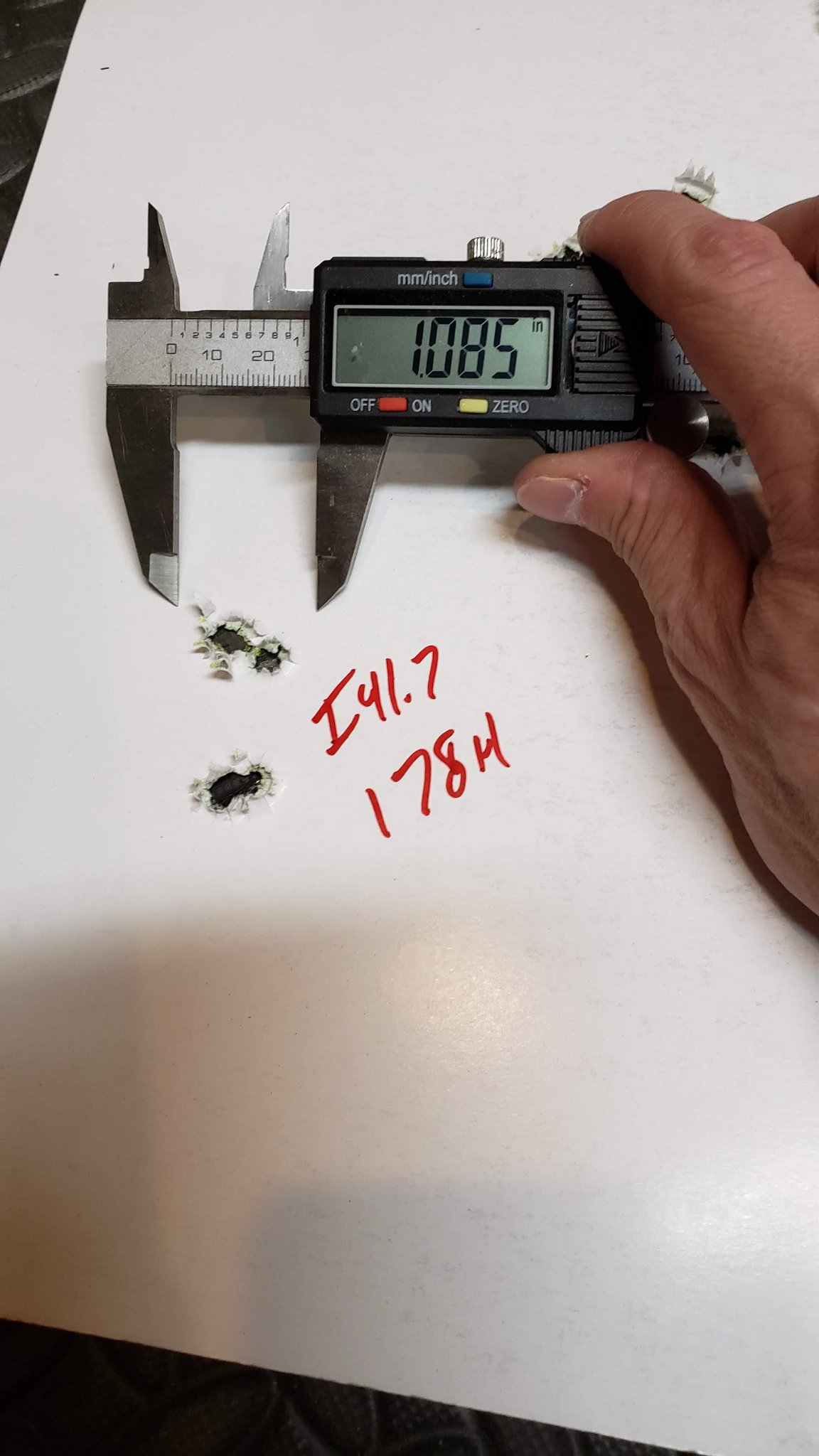

My current 308 load
* Starline Small Rifle Primer Brass
* 41.7gr IMR 4064
* 178gr Hornady ELD Match loaded to 2.810
* Fiocchi Lead Free Small Rifle Primer
Shooting out of my 16" Windham SRC AR10 I get a MV of 2339 and an SD of 9.2. I won't claim to be the best AR10 shooter out there but if I focus (much more so than on my AR15) I can squeeze just under MOA out of it.
Alternatively I also have a nice reduced load of 34gr H4895 with a 168gr SMK that shoots very well with manageable recoil for newbies.

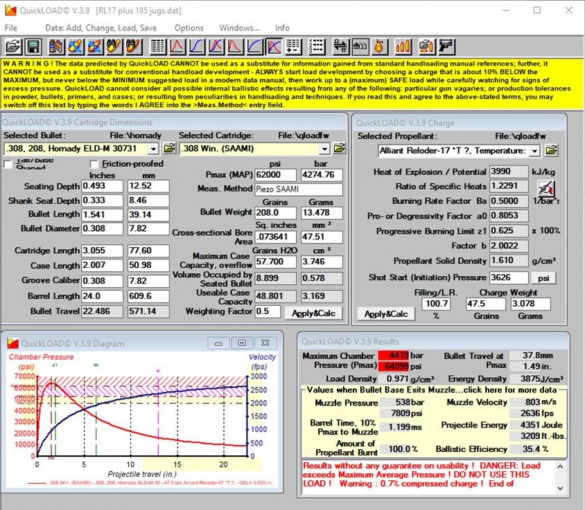

I’ve been running the 208 eldm lately. Last time out I tried lapua brass 3.055 oal, 46.7gr of rl17, .010 off the lands & it was the best group & sd I’ve had yet with the 208gr at 2630 FPS & 5 sd with under .5moa at 100 & just slightly over .5moa at 560. At 560 yards it only used 3.2 mils elevation & .5 mil windage with 10 mph winds 85* weather. At 900 yards used 7 mils elevation & 1 mil windage, group was 6 in. This is the best bullet I’ve tried yet, bucks the wind like no other 308 bullet. In the Winchester brass rl17 47.5gr made 2600 FPS & 46.5gr in lapua made 2600. If I go to 47.7gr in Winchester brass do you think it will go to 2630 FPS like the lapua? What about the pressure in lapua 46.5-46.7gr & Winchester 47.5-47.7gr RL17? Only 1 or 2 cases out of 100 had a slight swipe mark with no other signs.

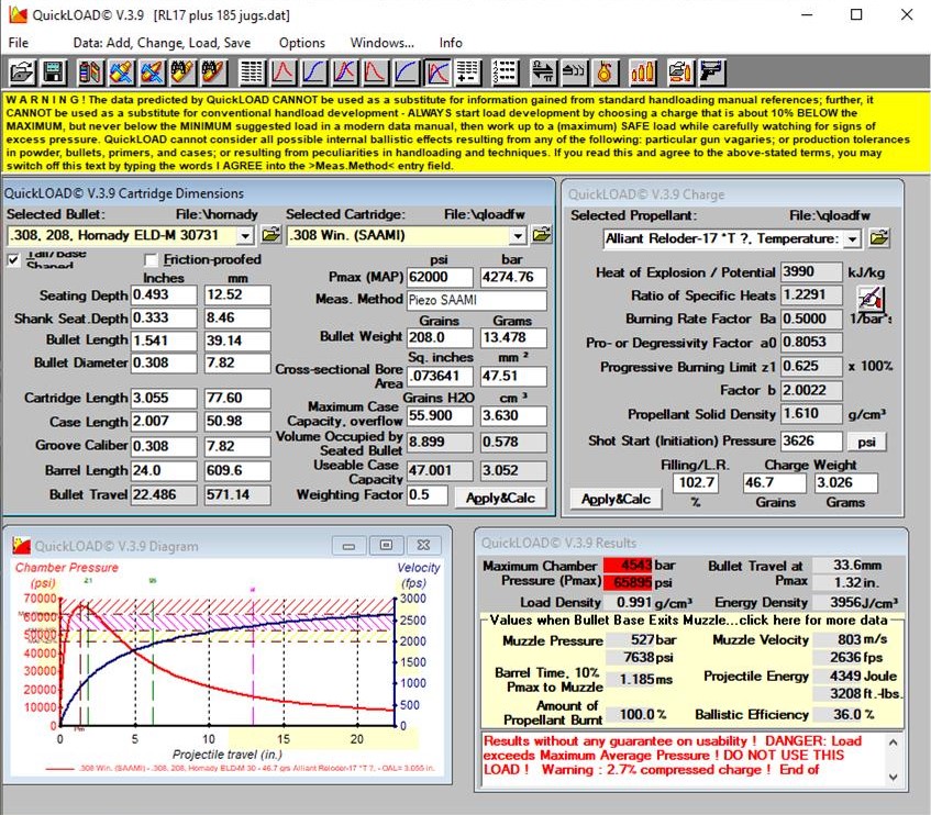

According to QuickLoad, it looks pretty very close, and yes, pressure is high. Take a look at what I'm seeing:

Looks like rl17 46.7 & 47.7 are little over pressure but not too bad. I might try 46.5 & 47.5 again & see how they compare with sd/es & group size to 46.7 & 47.7. A couple thousand psi over sammi is not too bad & I’m not seeing any signs brass wise so I will see how many reloads I get & how the brass holds up. I felt like I was near max but not too far past what’s acceptable. My rock creek 24in 5r is grouping well with the rl17 & 208eldm. This combo is bucking the wind better than 178 eldm or 185 jug that I’ve tried. I’m going to have to try it out around 1200-1500 yards. I wish my range went past 900 because I have to travel farther to good blm land to shoot at longer distances. Tks for the help with the quickload, I wish I could use it but I only have the iPad & iPhone now. I might have to get a windows laptop just for quickload

I worked up the precision to 41.5 and 42 over the weekend but the groups seemed to loosen a bit.
I loaded five rounds at 43gr and five at 44gr tonight to try out this weekend but I'm getting a bit skittish of approaching the max load with magnum primers. Shooters world suggests a max load of 45gr with the match king.
this is kinda odd. did you change your "burning rate factor ba"?? mine is saying 0.4700 for reloader 17 i ran the exact numbers you did and i'm getting quite a lower pressure and fps than what you're showing. when i change it to 0.5000 its obviously identical. just weird that i would have a different default than you. not question you, i'm questioning the program.
also. i trim my .308 lapua brass to 2.014 and my h2o case fill is 55.4. so his load may be even hotter than that.

Anyways, I managed to cobble up a round that printed decent today. It's a starting point I know but it made me happy that it printed at all.
These were fired brass, 41gr of Shooters World Precision, 168 Match King and Federal 215 magnum primers (the only thing I can get right now) from a 16" barrel bolt gun.
I loaded up some more 41gr to make sure that it wasn't me (it was probably me), 41.5 and 42 for tomorrow. Pretty sure they're all well within spec and possibly a bit low by everything I've found.
if you dont have one, get yourself a chronograph. i started with the magnettospeed sporter and that thing works great. ive since bought the upgraded V3 bayonet now that i have suppressor's and i started doing more AR platform load development. but if you have a standard barrel the sporter is the way to go in my opinion.
If i would have known the amount of information i would get out of my hand loads by using a chronograph it would have been the first thing i bought after my first press and dies. its much easier to work up a load when you know how fast the are going and how consistent they are.
pre chronograph i would go to the book and start middle of the road and go up .3 watching for pressure signs along the way until i shot a good 5 shot group and thought "cool that's my load".
now, ill shoot 1 round at a coal .010 less than mag length going up in .2 or .3 grains of powder until i get the safe FPS i want. once i get there i start shrinking seating depth to find out how far that bullet likes to jump.
I look back and think of all the powder, bullets and primers i went through trying to find what i thought was a good load and it makes me sad lol.
also i was a big fan of ar-comp and imr4064 when i was shooting 168's. ar comp is hard to come by at the moment but it was very consistent in my gun.
Yes, I did change my burn rate to .5000, which I always do to get something that better represents a burn rate base on my chrono data. I've done this many times and compared chrono data with what other's have posted and often am pretty close to what they got. That's not to say that everyone's powder burns at the same rate as we know that the burn rate for a particular powder most often varies from lot to lot. And I've found in my experience with only a few popular powders that QL's default burn rate tends to be on the low side.
As far as your H2O of 55.4 grs. . . that's pretty much the measurement I get with virgin Lapua brass and with full length sized brass. But, when they're fired, the volume is more and I typically get ~ 55.9 grs. And QL instructions are to use the case volume of fired brass rather than the volume of sized brass. So, I assume there's good reason for this instruction, as if probably has something to do with the way the formulas work.

Went to the range this afternoon, top left was cold barrel 168 match king over 41gr Precision. Top right was the same with 43gr and the middle was 44gr.
Bottom target was my terrible tumbling subs... 168 speer over ten grains of trail boss, they need a ton of work.
I'm pretty happy with the supers at 41gr but the chronograph will definitely help with the subs and dialing in the supers a bit more.
