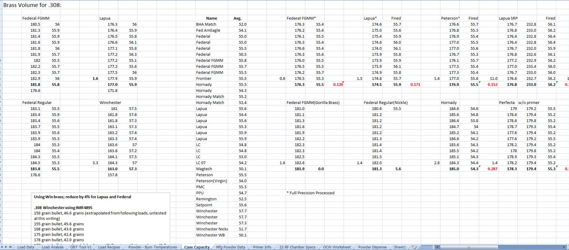

Is there any list that shows the volume of the different brands of brass ? Lapua, FGMM, Winchester, Winchester Match, Black Hills Match, LC LR, LC, and any others .
I'm not aware of any such list other than my own that I've put together over time. I keep it on a spreadsheet with my own load history and other loading information, see here (but be aware of difference between volume of a sized vs fired brass):

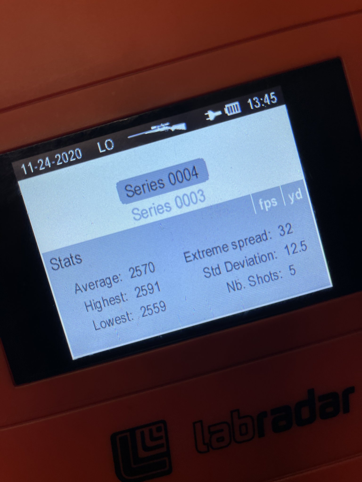

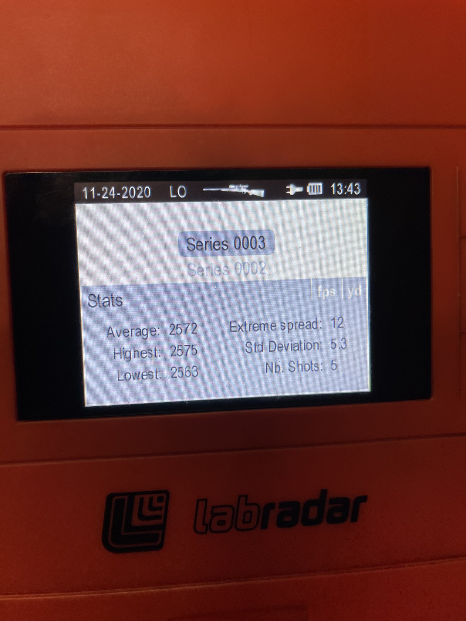

Settled on load today with 175 Berger otm. 16 inch barrel. 44.8gr ADI2208 (varget). Lapua brass. BR4s 2600fps. ES 9 SD 4. Just over .5 inch at 200 metres. Loaded 2.245” CBTO (30thou jump). Cheers.

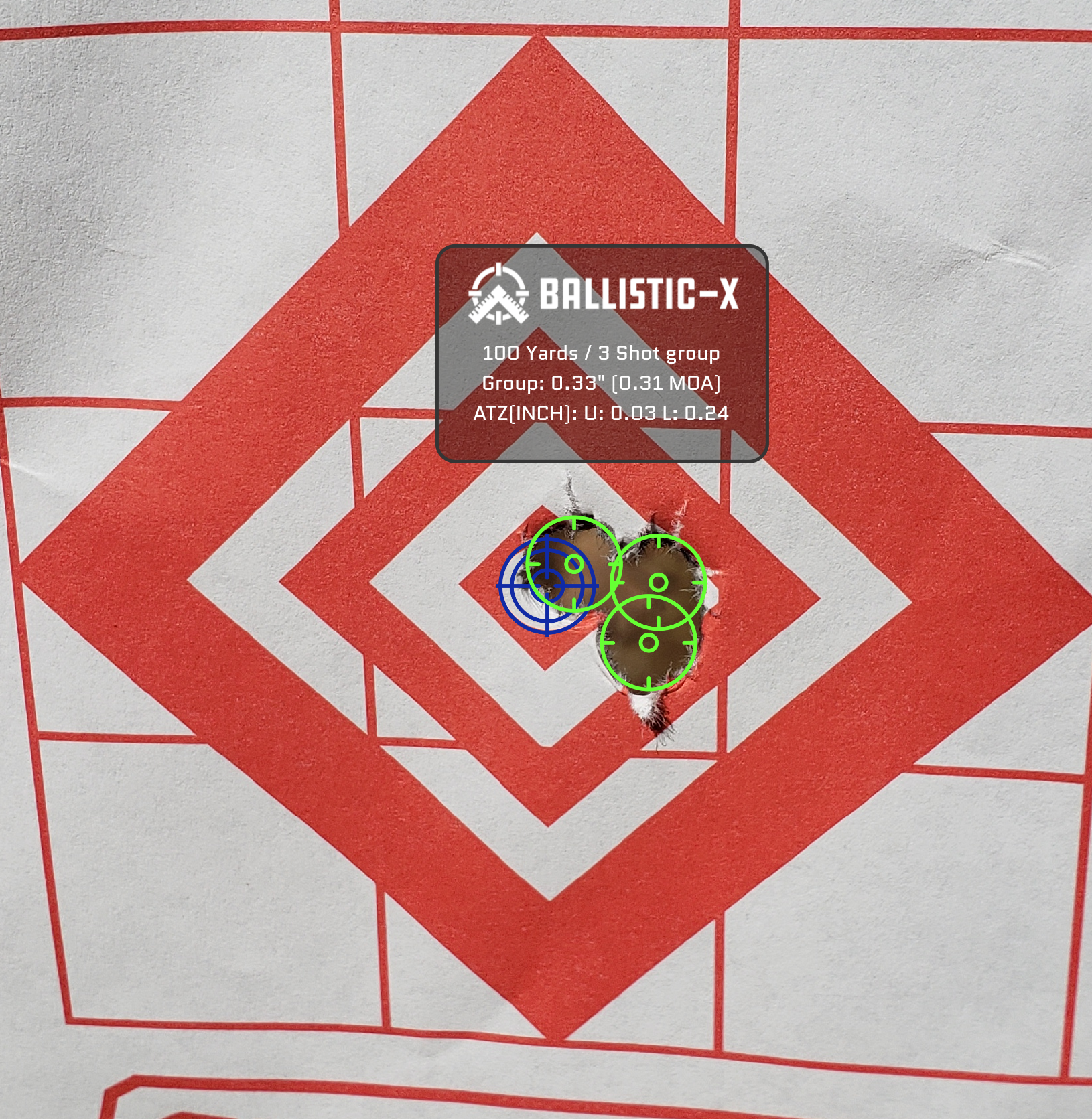

175 SMK over 44.3gr Varget .020 off the lands.
Avg 2755 fps
SD 6
ES 16
Shot from a Tikka T3X w/ 26", 10tw, Solid Accuracy Criterion prefit.

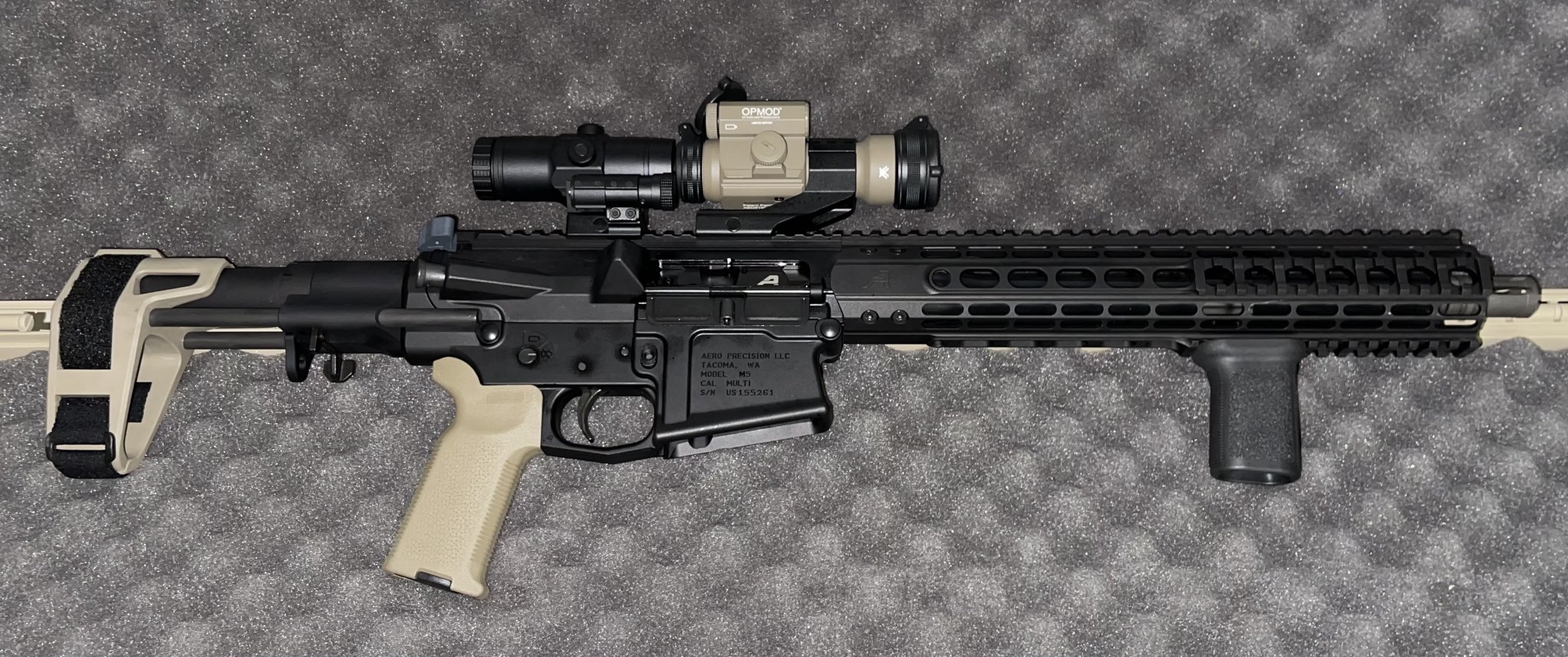

I am about to start working up a load for a 12.5” 308 AR Pistol.
