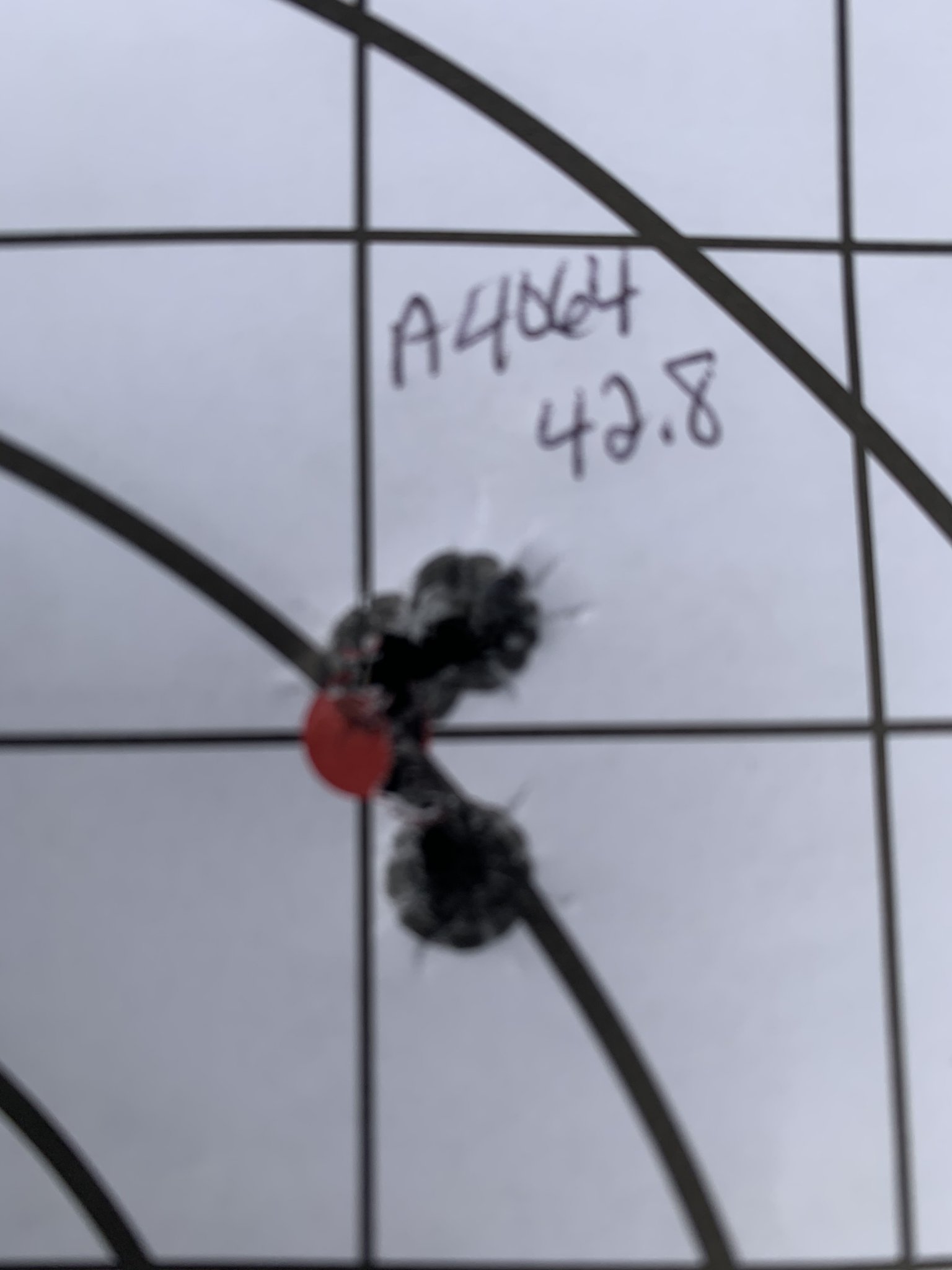

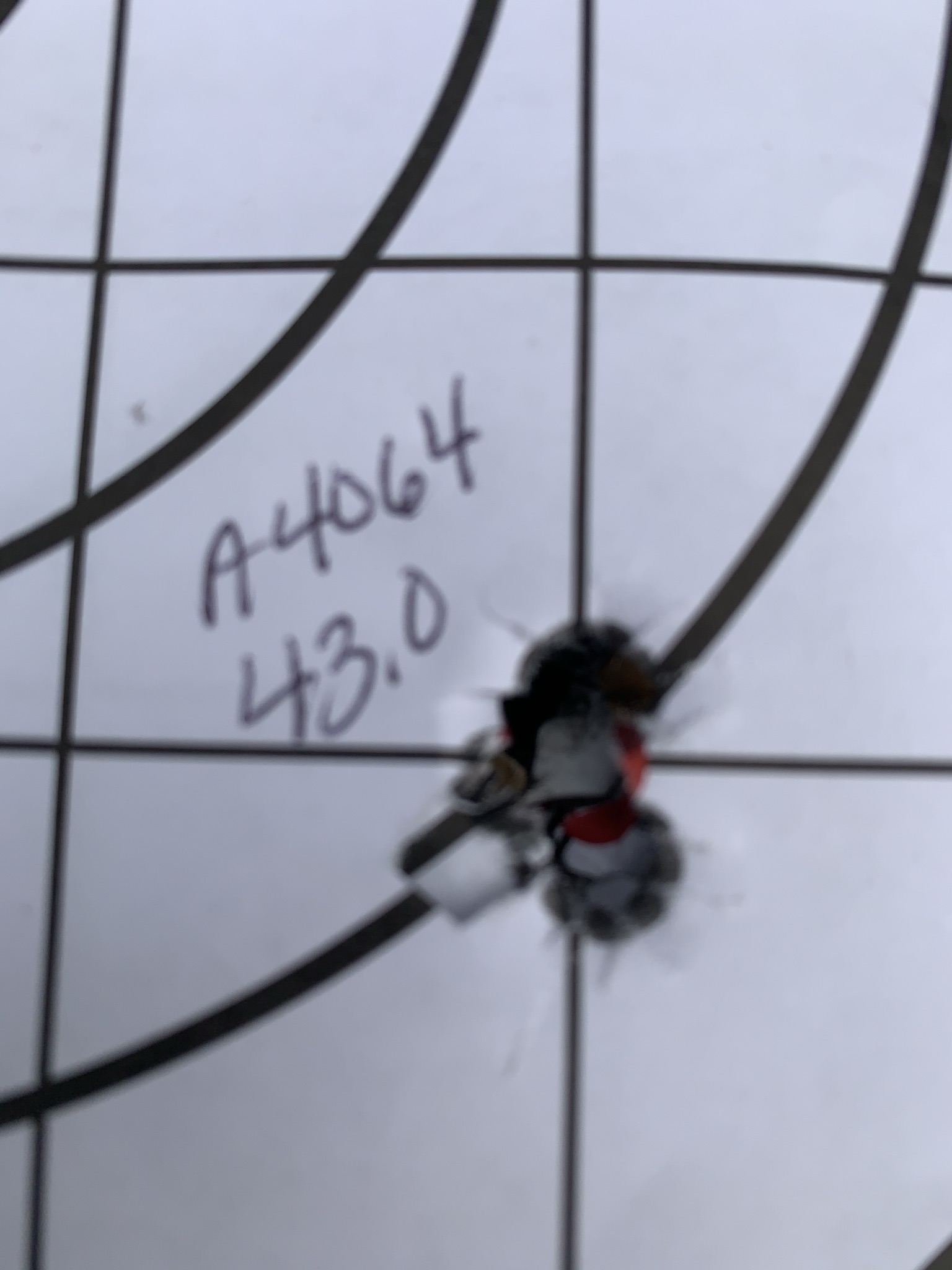

I had Larry Racine cut me a 28” Brux Hvy Palma for my Impact. I had 5lbs of Accurate 4064 sitting and wanted to try it. Ran 175 SMKs over 42.6, 42.8 and 43.0 grains .020 off the lands in 1x Lapua brass and BR2s. Broke bbl in w/ 30 rnds and then shot these today at 100. Dot is 1/4“. Shows potential :)

Nice! Looks like a little seating depth adjustment might take away a little of that vertical for the 42.6 gr???
I happened to recently buy 2 lbs of Accurate 4064 (this lot no included in the recall) to see how it might compare to my IMR-4064, which I've been using a lot of lately. Since I haven't been shooting much beyond 200 yds lately, I've been shooting 168 SMK's. So this last weekend I ran a ladder and found a good node this Accurate powder from 44.8 to 45.2 grs (was running .02 gr increments). Was getting groups in the 3's and under and with a little tuning, I think it'll do a lot better. I had them loaded to 2.870 COAL where the case was just shy of 100% full putting me at .048 off the lands. 45.0 grs was pushing my 168 SMK's to 2739 fps average out of my 24" barrel. And these were loaded the FC brass with Federal 210 LR primers. My IMR-4640 logs don't allow me to get enough powder into the case at that COAL to get that average velocity even though its burn rate is higher. It would take almost 102% of case capacity for the IMR-4064 to get to that speed. It's doable, but I try to stay away from compressed loads as there can be substantial temperature change in a day here in Arizona. A little more testing this Accurate powder to see what load can give me good consistency.
Honestly I’m happy with 42.6. This bbl only has 30 rnds on it. After I get 100-150 on it I’ll repeat this test at 300 and pick one. I have 185 Berger Juggs up next to test.

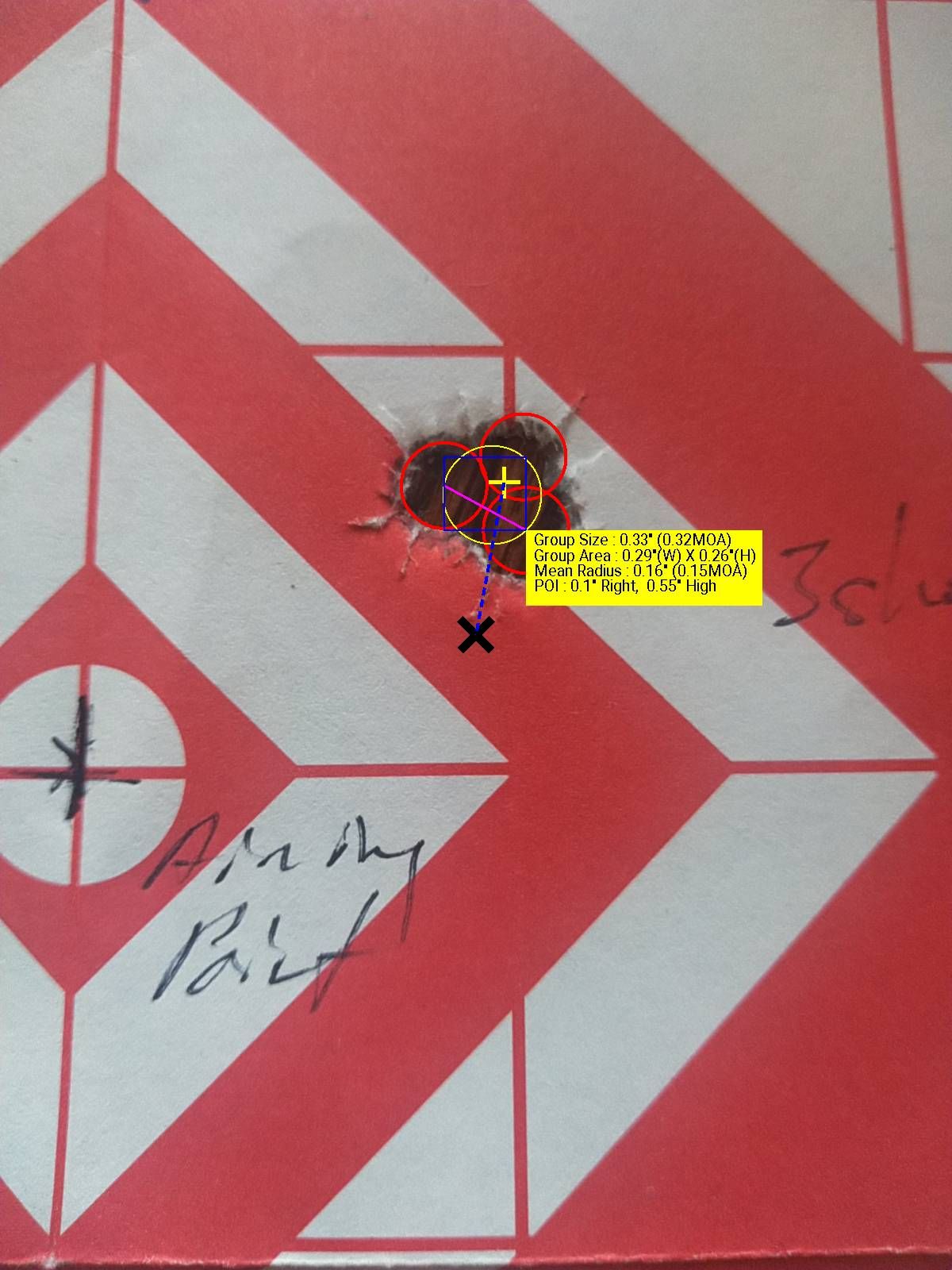

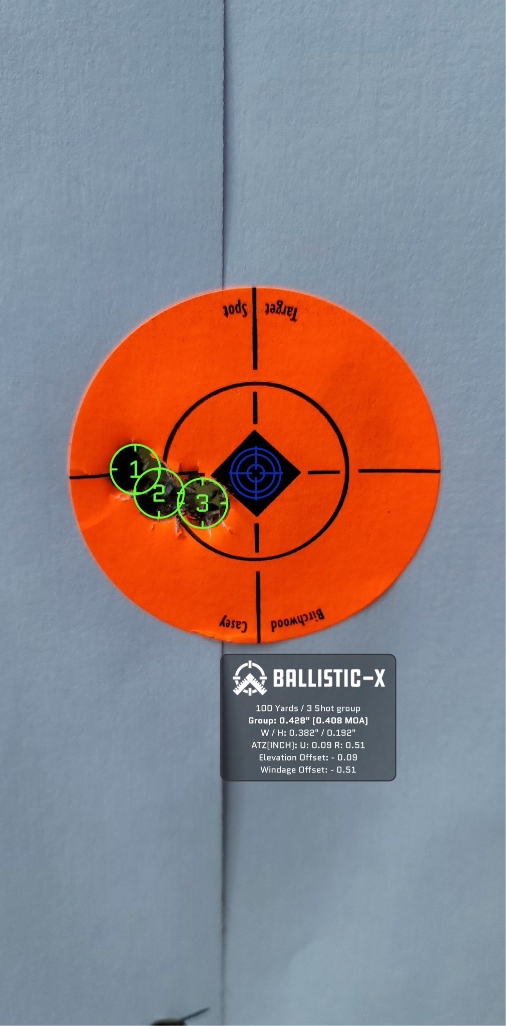

Brand new to this reloading gig (first reloaded round was in February), so I don't have a chrono yet. Ladder test at 300yd for visual velocity changes, then 3 shot groups for refining the load.
Ballistic-X-Export-2021-06-07 16:28:44.965928.png
Reactions: Balor

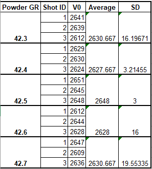

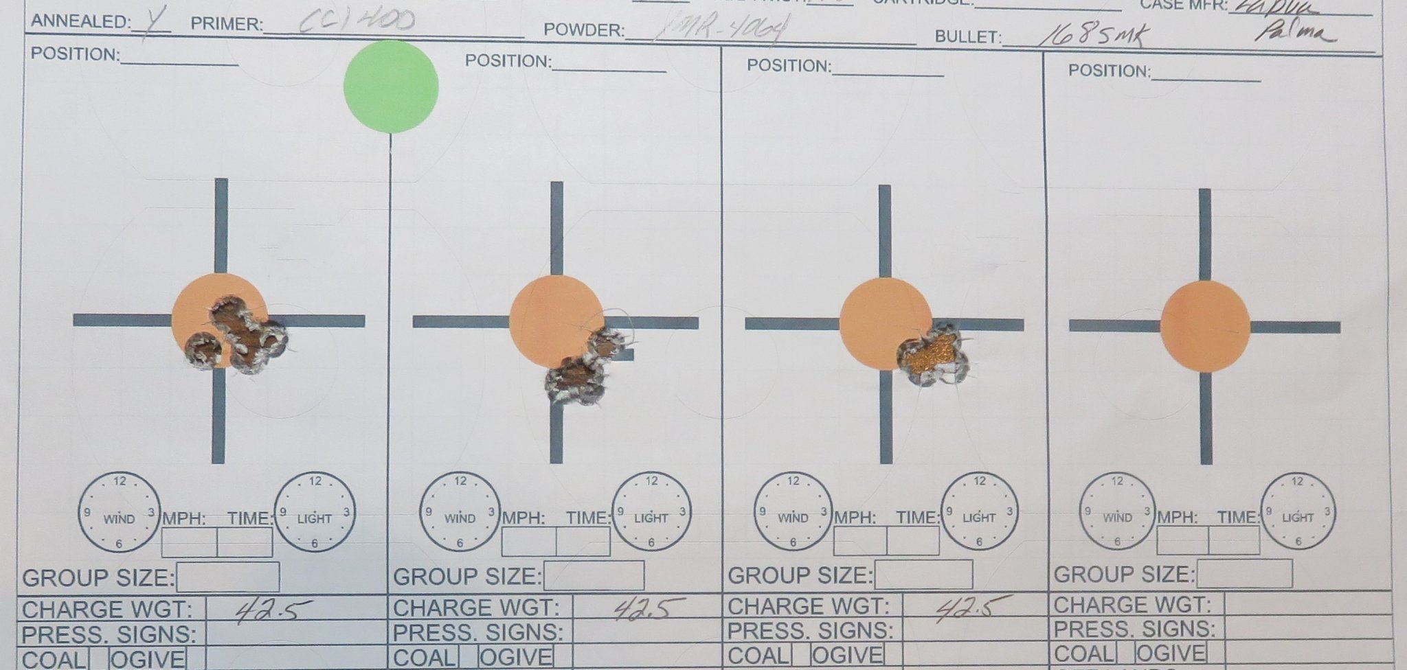

A lot depends on the particular bullets and powder you have. If you happen to have some IMR-4064, and some 168 SMK's (or even Nosler 168CC's), you might consider 41-42.5 grs of it for these bullets.
42.5 of it works well for me last weekend in a cartridge loaded to an COAL of 2.856.
Reactions: TommyD11730

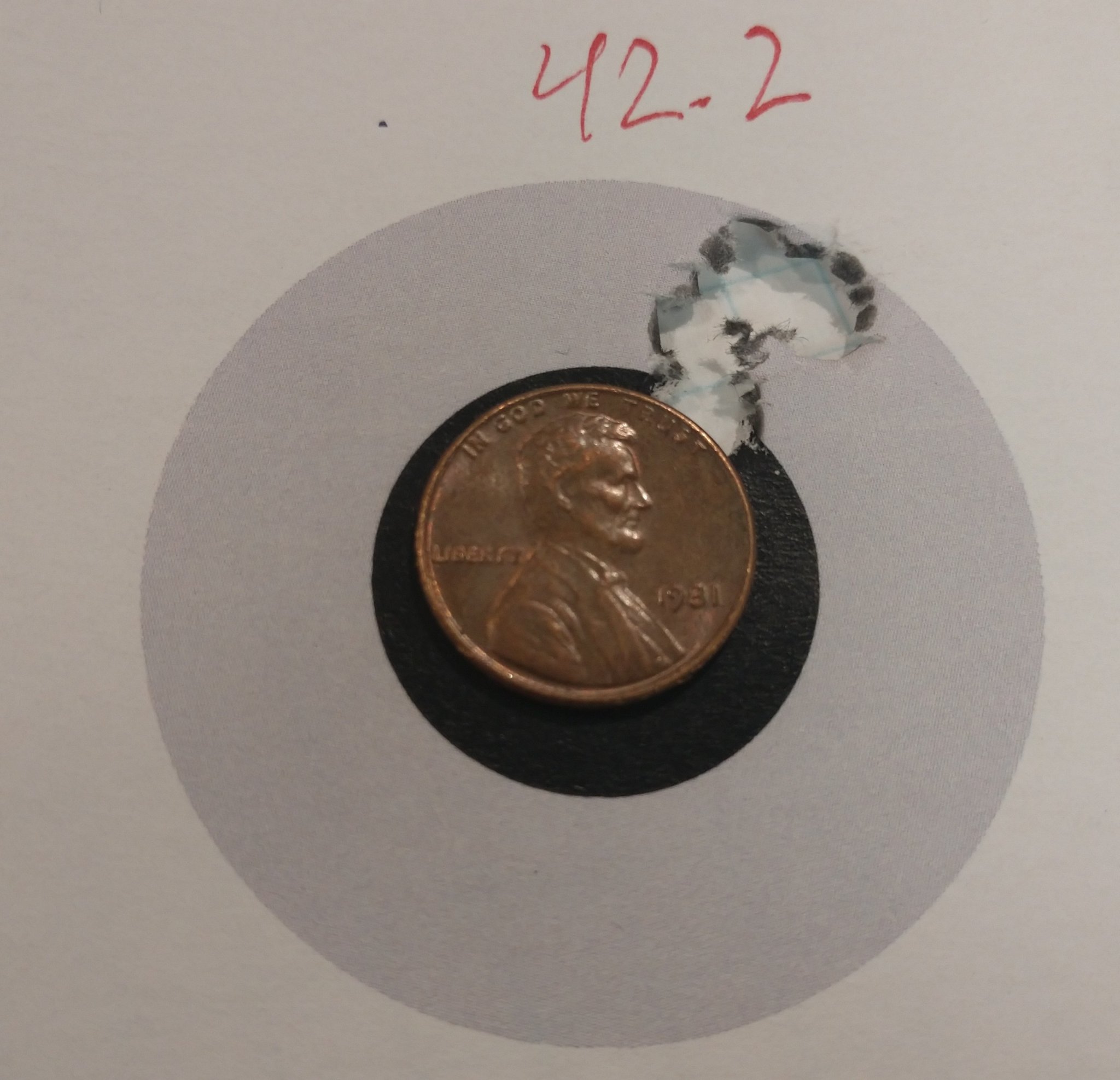

So I just picked up some 185 Berger hybrids. After how well my FGMM with 185 juggernauts shot I wanted to try these boolits.
With my experience reloading for 6 dasher the past 8 years, I started at book max (41.0-gr) of IMR-4166. My manual doesn't list this powder but my burn-rate chart puts it right with 4064 so that was my reference in the manual.
Anyway, I loaded 41.0, 41.4, 41.8 and 42.2 gr. The 42.4 load was by far the best grouping. I got no ejector marks or hard bolt lift.

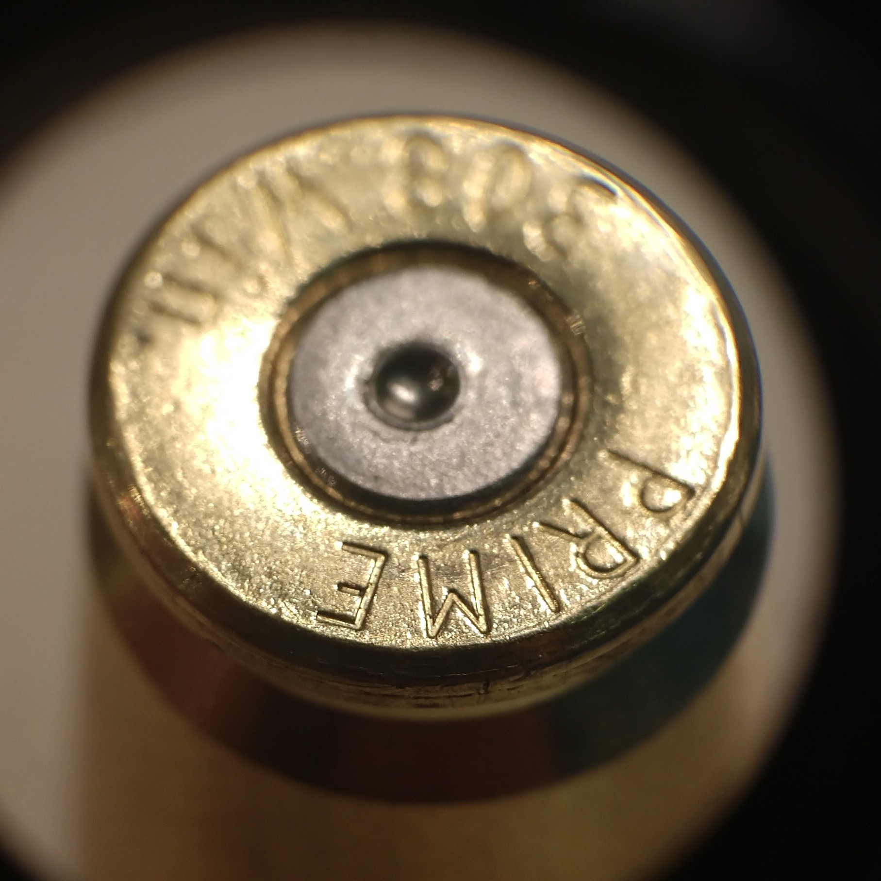

Since this was the max load for me and 1.2-gr > book max, do these primers look flattened? Average velocity was only 2,649-fps measured with a Lab Radar.
What's a typical expected speed for 185's from a .308 10-twist 24" barrel?
primer cratering I do believe. It is my understanding may or may not be a sign of high pressure. Myself, I back off when I get this.

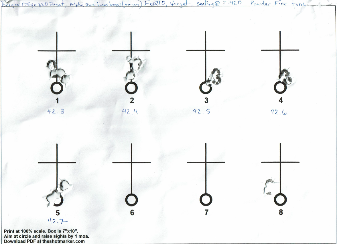

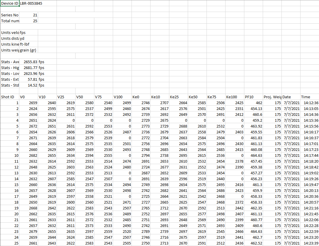

Fine tuning a load last month. I shot this on the 7th of July. Unfortunately, this ended my 175gr Berger VLD Target bullets. I can not find them anywhere.
Rifle: Prison Sex, KRG X-Ray chassis Gen III FDE
Barrel: Bartlein 22" SS 0.308/0.300 5R 1/10 D058929 -10-
Action: Big Horn Arms TL3 Remington 700 SA
Scope: Nightforce ATACR 5-25x56mm F1 T3 SPHUR 4001 mount
Trigger: CMC Remington 700 adjustable ultra precision - flat bow 2.5lbs
Varget, FED 210, Berger 175gr VLD Targets, Alpha munitions virgin brass
Weather: Temp - 62.7, P - 28.42, H - 78.7. DA - 2227
Powder fine tune:
Seating depth fine tune:
Final load information:
Berger 175gr VLD/Varget/FED 210
Jam (BTO)
2.1830​
Jam -0.020k (BTO)
2.1630​
Powder ES/SD Node 42.4gr 6/3.21
Seating Depth Node
2.1450​
Longest -0.001
2.1440​

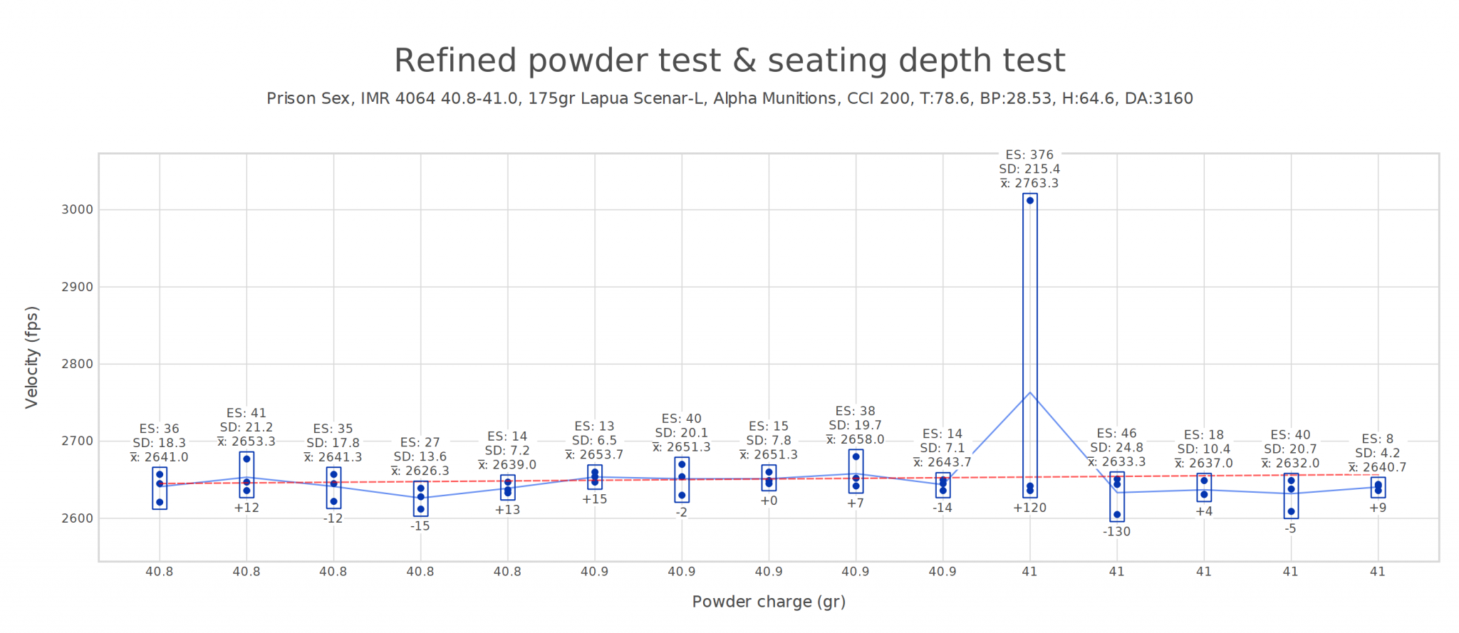

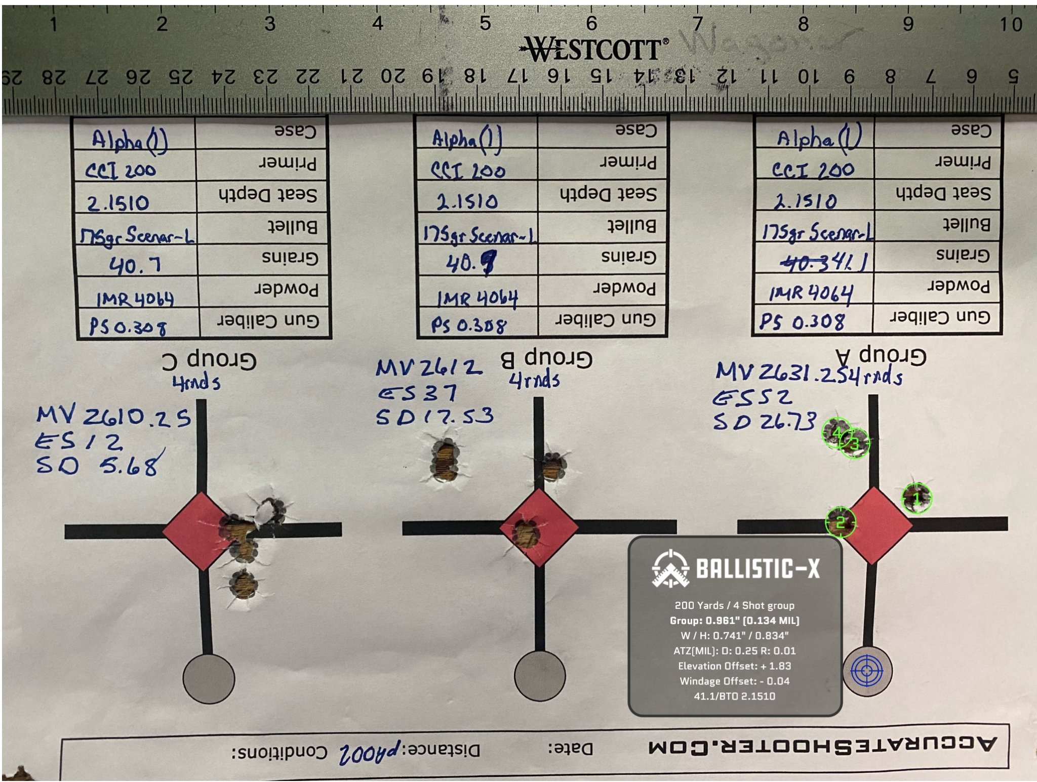

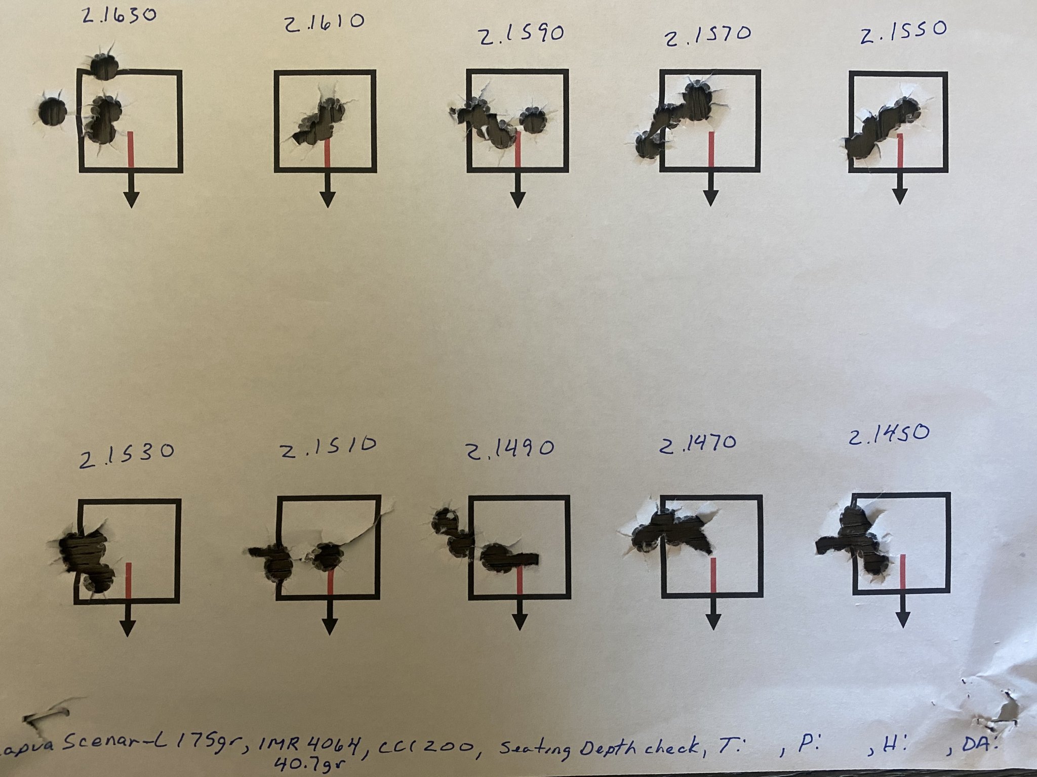

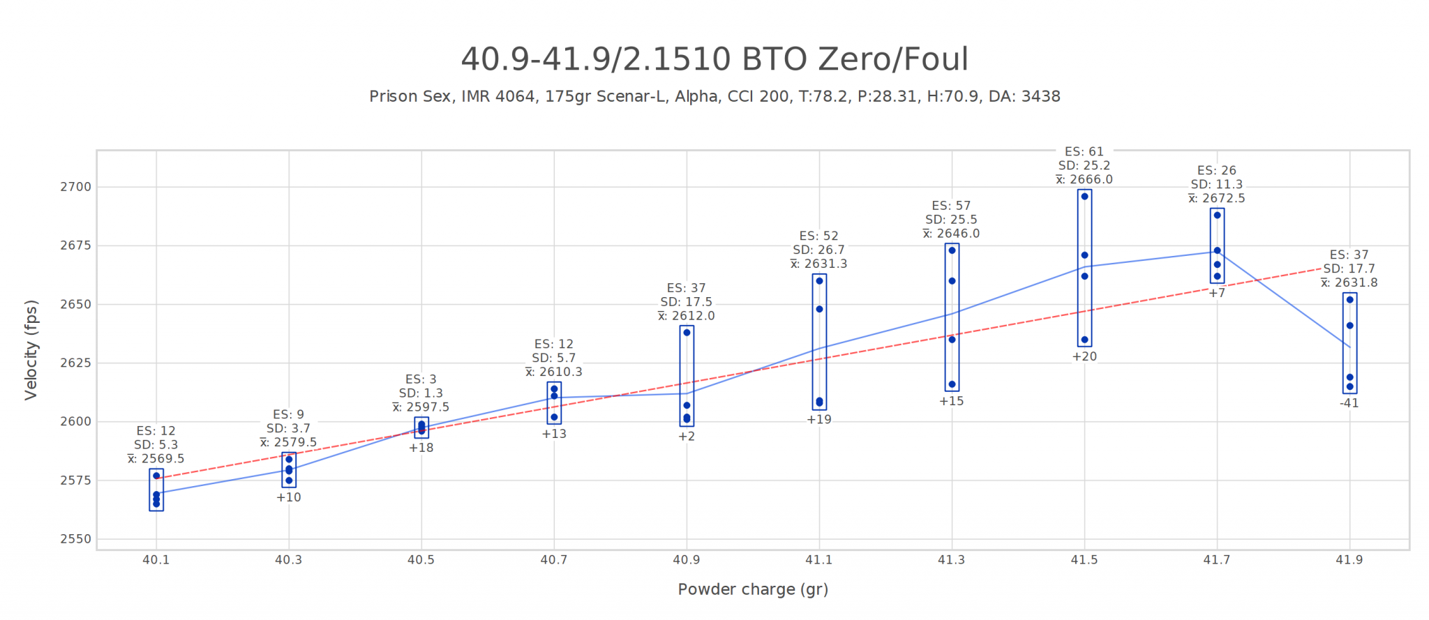

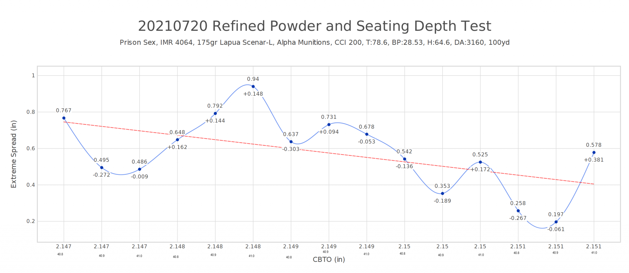

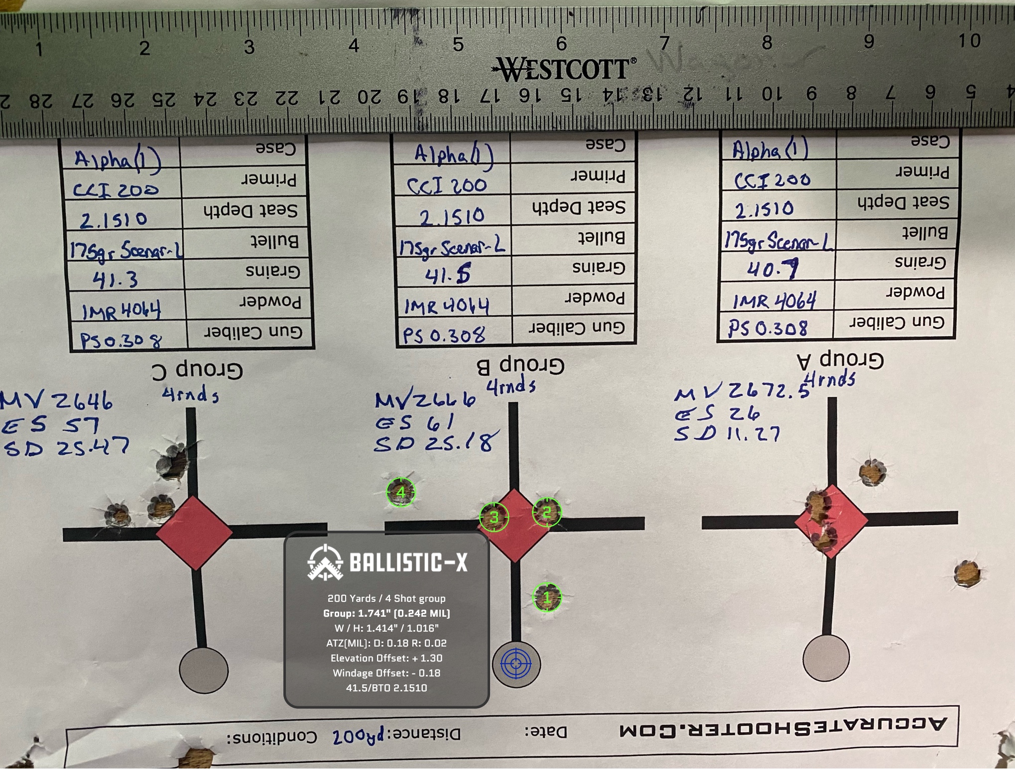

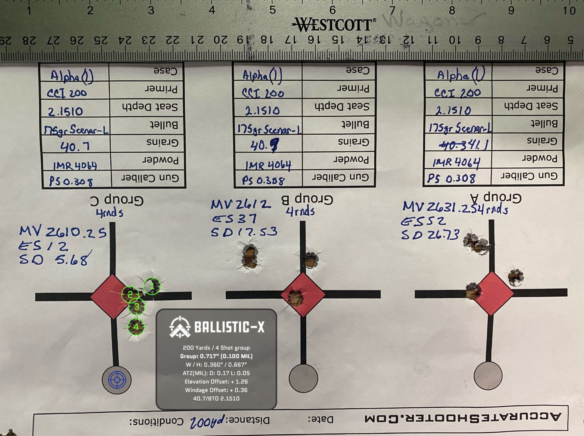

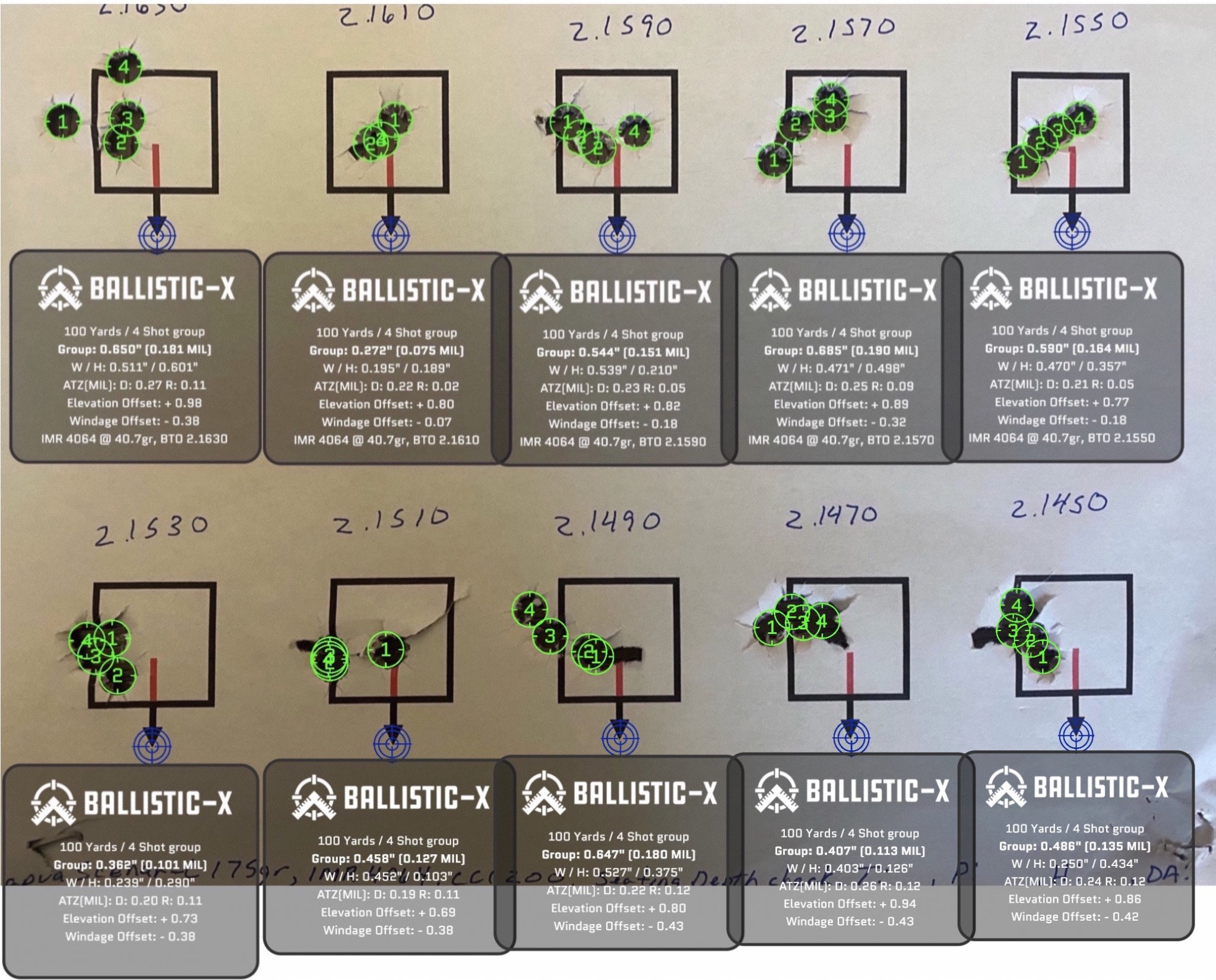

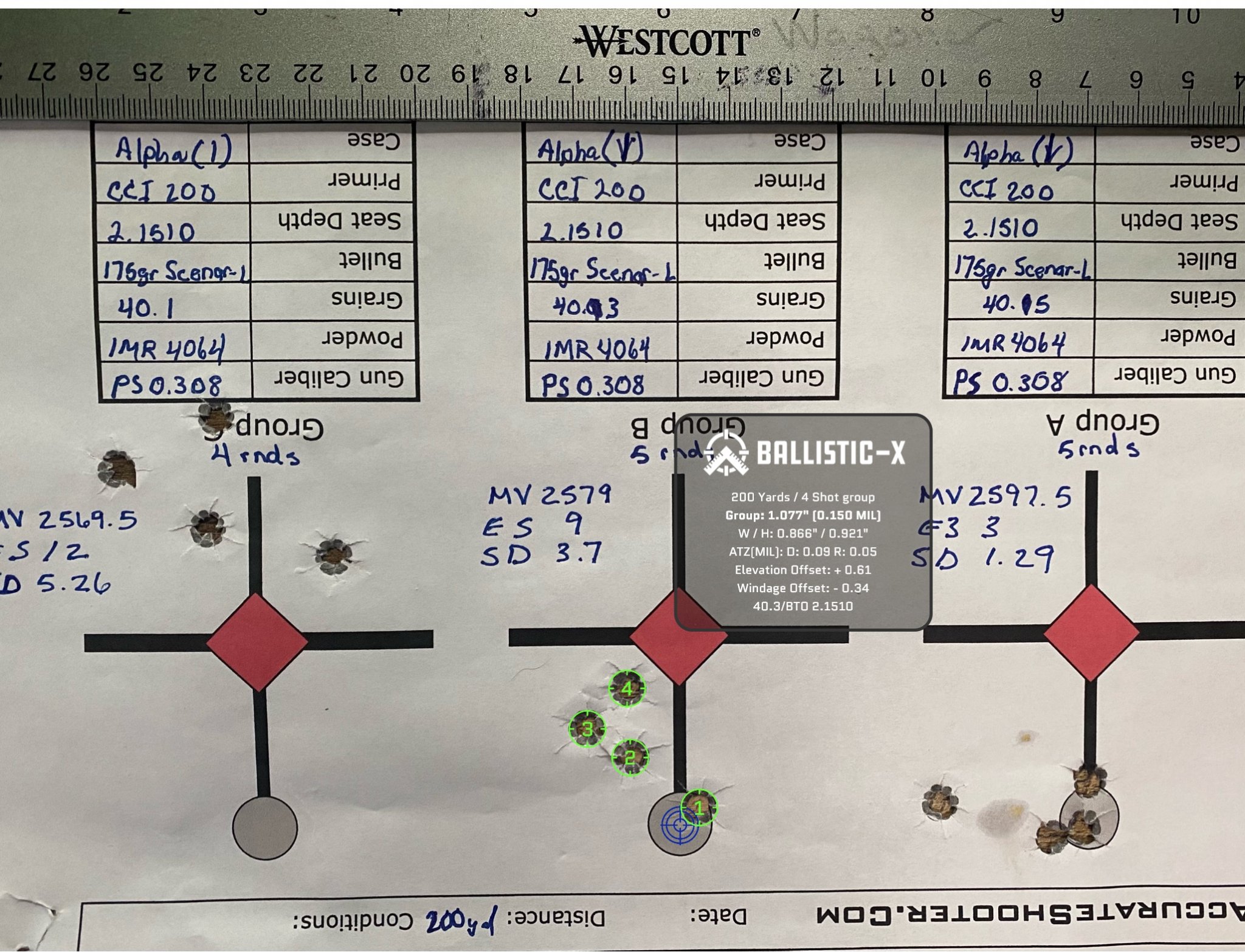

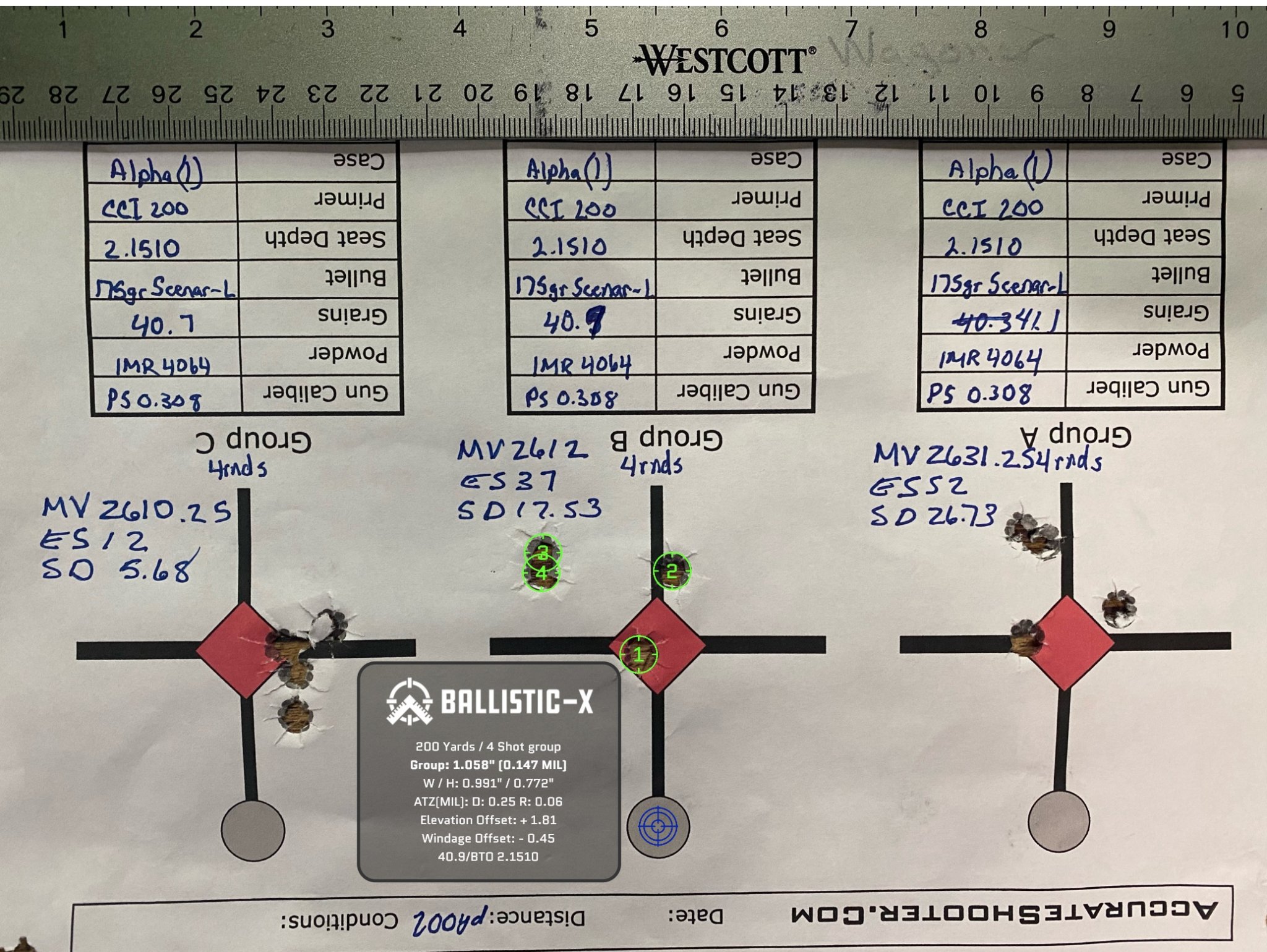

IMR 4064 Powder and seating refinement:
IMR 4064, CCI 200, Lapua Scenar-L 175gr OTM, Alpha munitions virgin brass
Weather: Temp - 78.6, P - 28.53, H - 64.6. DA - 3160

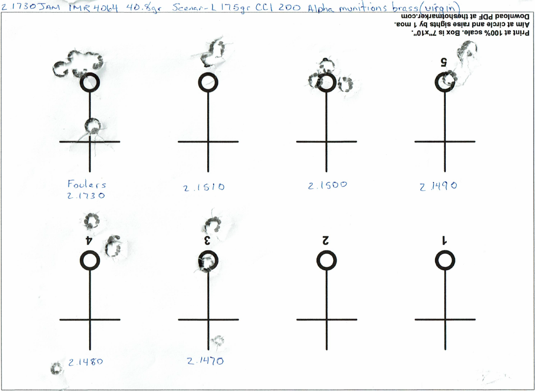

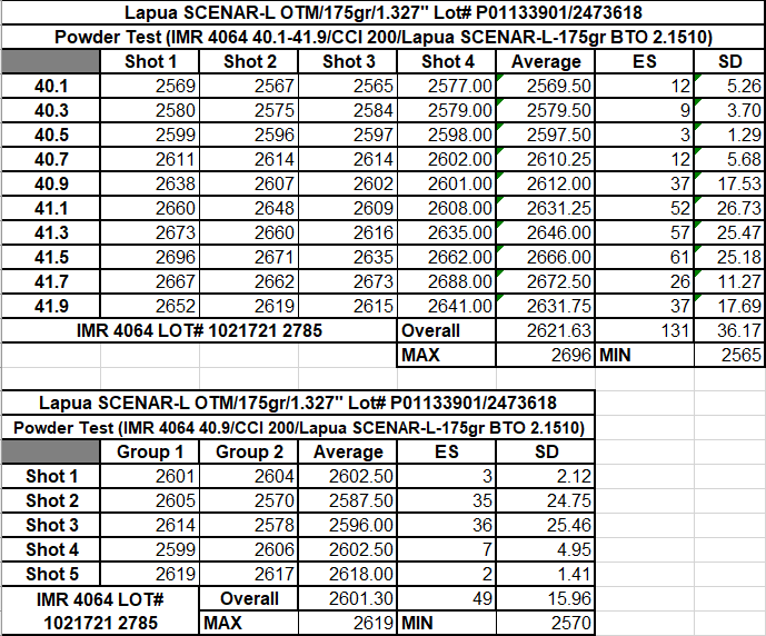

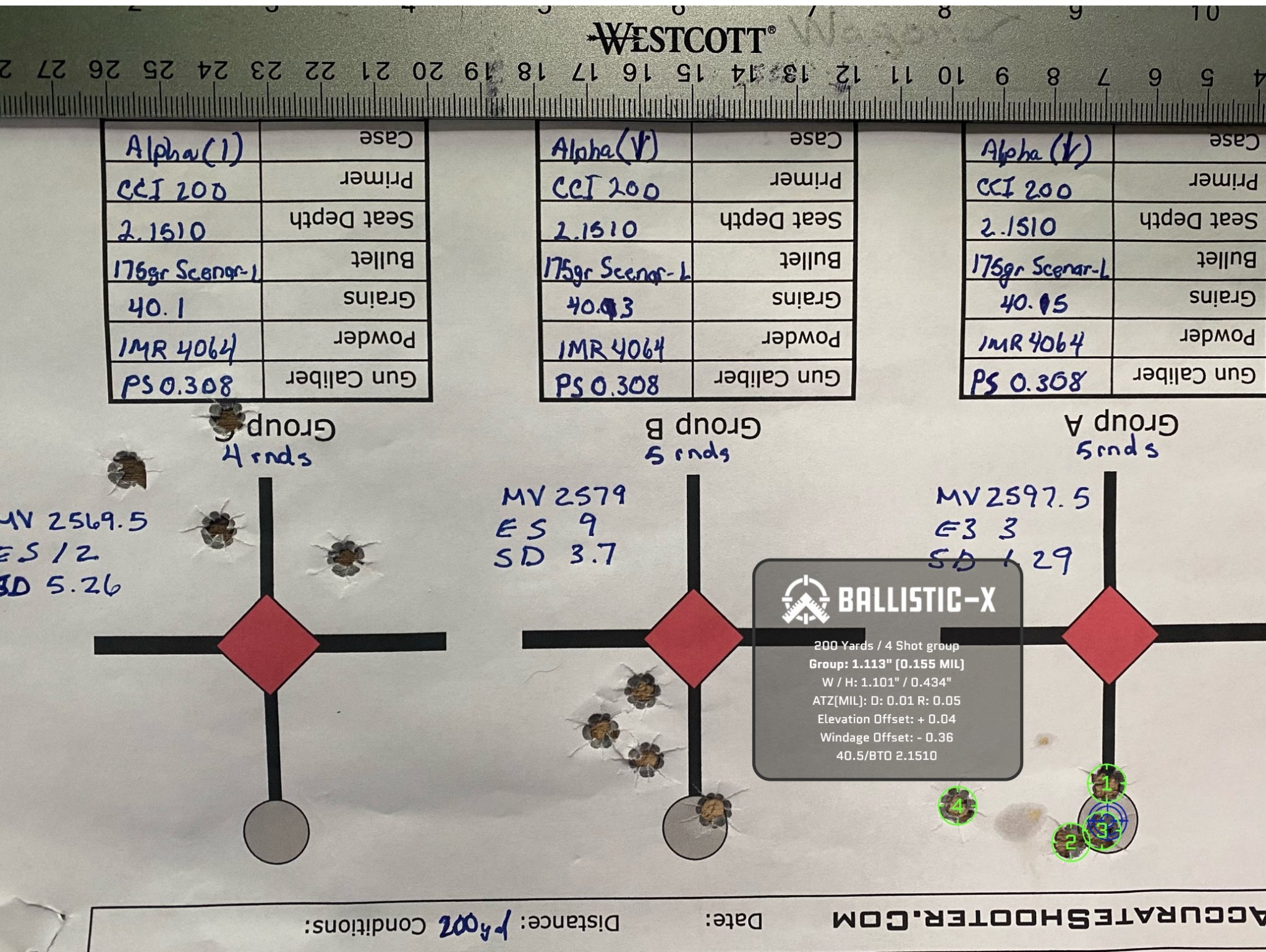

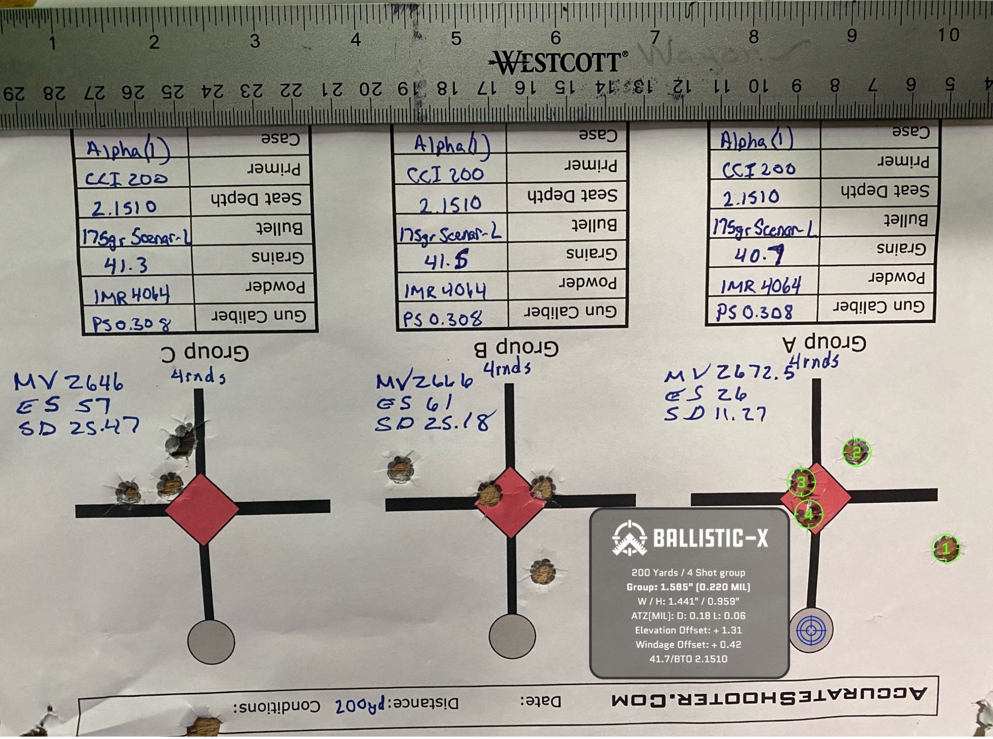

Final results:
Lapua 175gr SCENAR-L/IMR 4064/CCI 200
Jam (BTO)
2.1830
Jam -0.010k (BTO)2.1730
Powder ES/SD Node40.9gr/2.65
Seating Depth Node2.1520
Longest -0.0012.1510

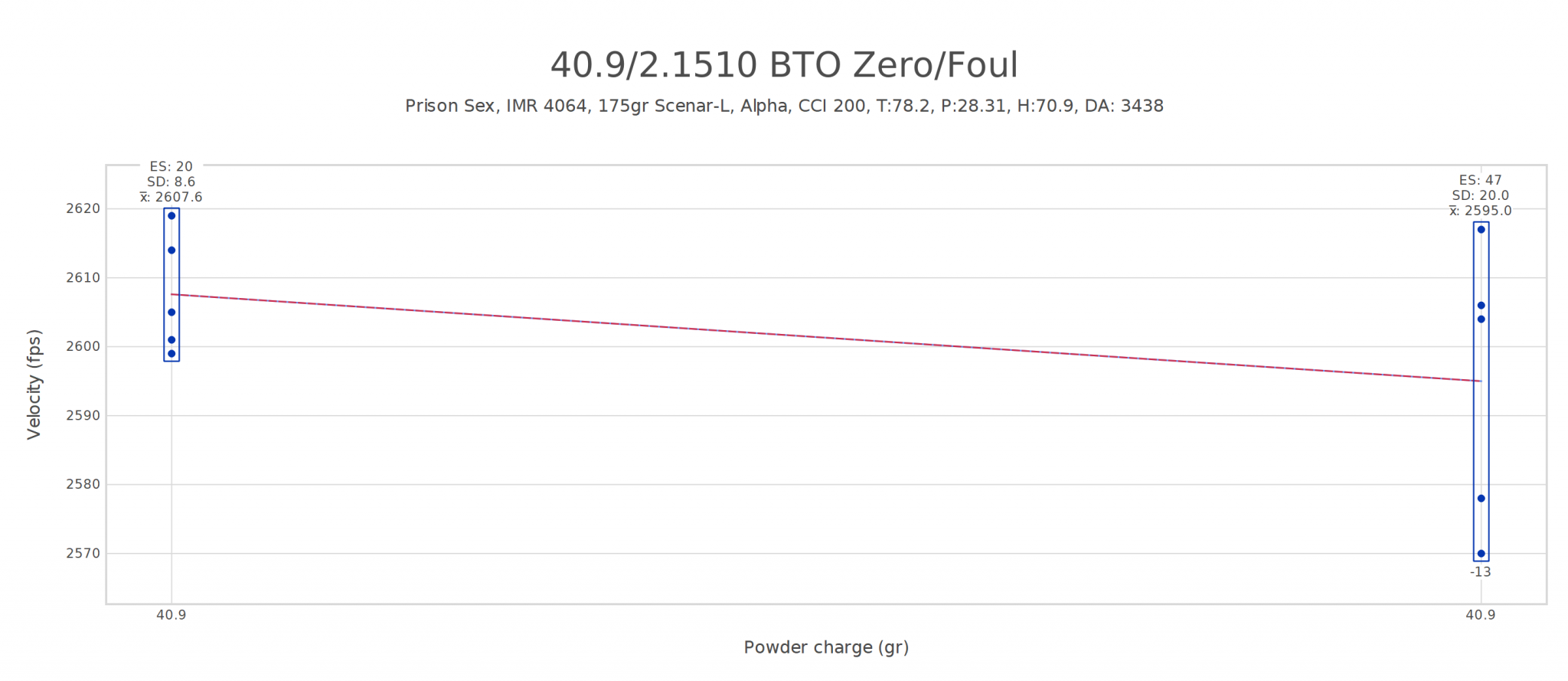

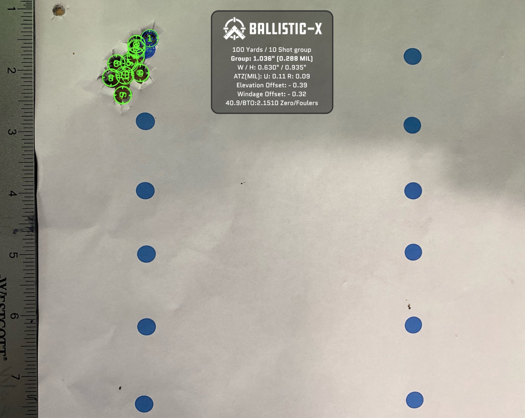

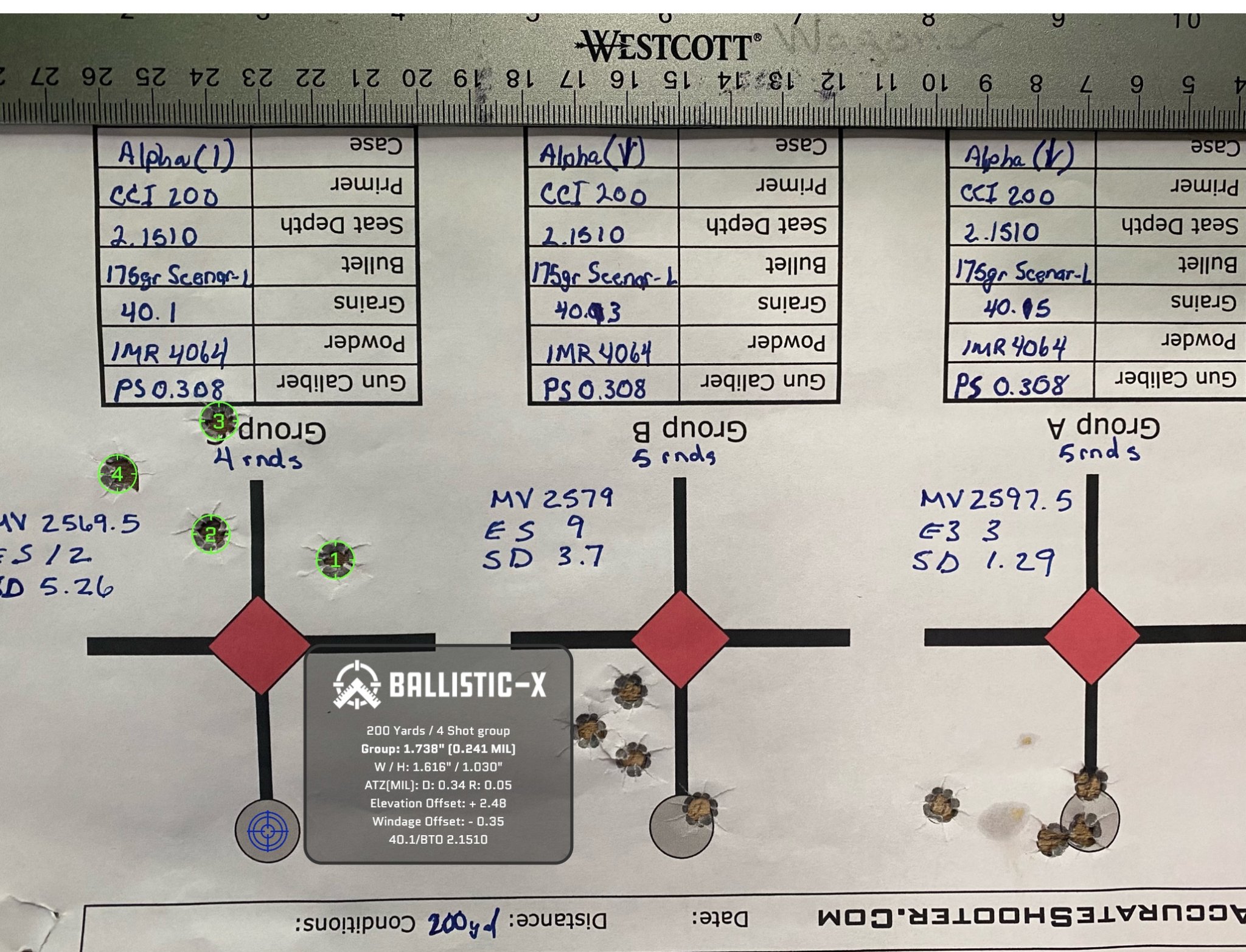

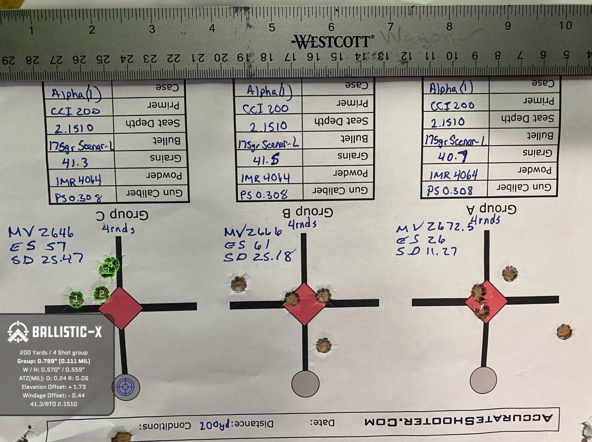

Being new to reloading I tend to go down some rabbit holes. All in an effort to understand my new addiction, I mean hobby. So here we go, I have been shooting virgin Alpha Munitions brass. I have conducted my load development on virgin brass. I am/have learned a lot during this process and decided to load 50 rounds of once fired brass. 10 rounds at my load (40.9gr/BTO 2.1510) for zero/fouler) 4 rounds each starting at 40.1 and ending at 41.9 in .2 increments, seated at 2.1510. This was to see how much my load development would change since I did it on virgin brass. This is picture heavy cause words are hard.
Here are the details:
Rifle:
Weather:
T: 78.2F, BP: 28.31, H:70.9, DA: 3438
10 Rounds @ 100yds:
Once fired powder check, shot @ 200yds, 4 rounds for each charge weight:
40.1 -
40.3 -
40.5 -
40.7 -
40.9 -
41.1 -
41.3 -
41.5 -
41.7 -
41.9 -
MV, ES & SDs:
Group size:
Nice graph:
Putting it all together:
Groups 41.7 & 41.9, I lost my focus. The angles of the bench and shooting through a tube had my rifle barely on the bench. You can correlate the higher MV with the elevation differences in the groups. The left and right variances are on me as I did not account for wind at all.
I have a pretty stable node from 40.5 - 40.9, consideration paid to the 2638 mv on the first round of the 40.9. This node has been consistent throughout my testing. I am debating testing any more on seating depth. 2.1510 seems to be working. I may do another 50 rounds dancing around 2.1510 @ 40.7gr. Starting at 2.1630 - 2.1450, 5 rounds per depth. I am being anal or in depth or whatever you want to call it, due to learning and refining my reloading etc. Plus its fun. I mean neat graphs and all.
Interesting to see the groups go from vertical to round and then horizontal dispersion in just 0.003 increments.
My 0.3 grain powder tests show the same pattern in several calibers.
Guess I will have to fork up for the micrometer seating dies because 0.003 increments in a standard die is a pita.
Good shooting btw
I never got my varget load to come togeather because I was using the wrong bullets. His gun doesn't like hornady bullets.
Burnt up a lot of varget trying.
As soon as I went to smk's life got easy. The varget I have left is unsustainable so waiting on that.
