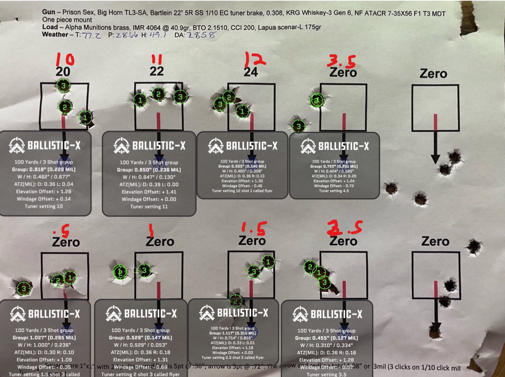

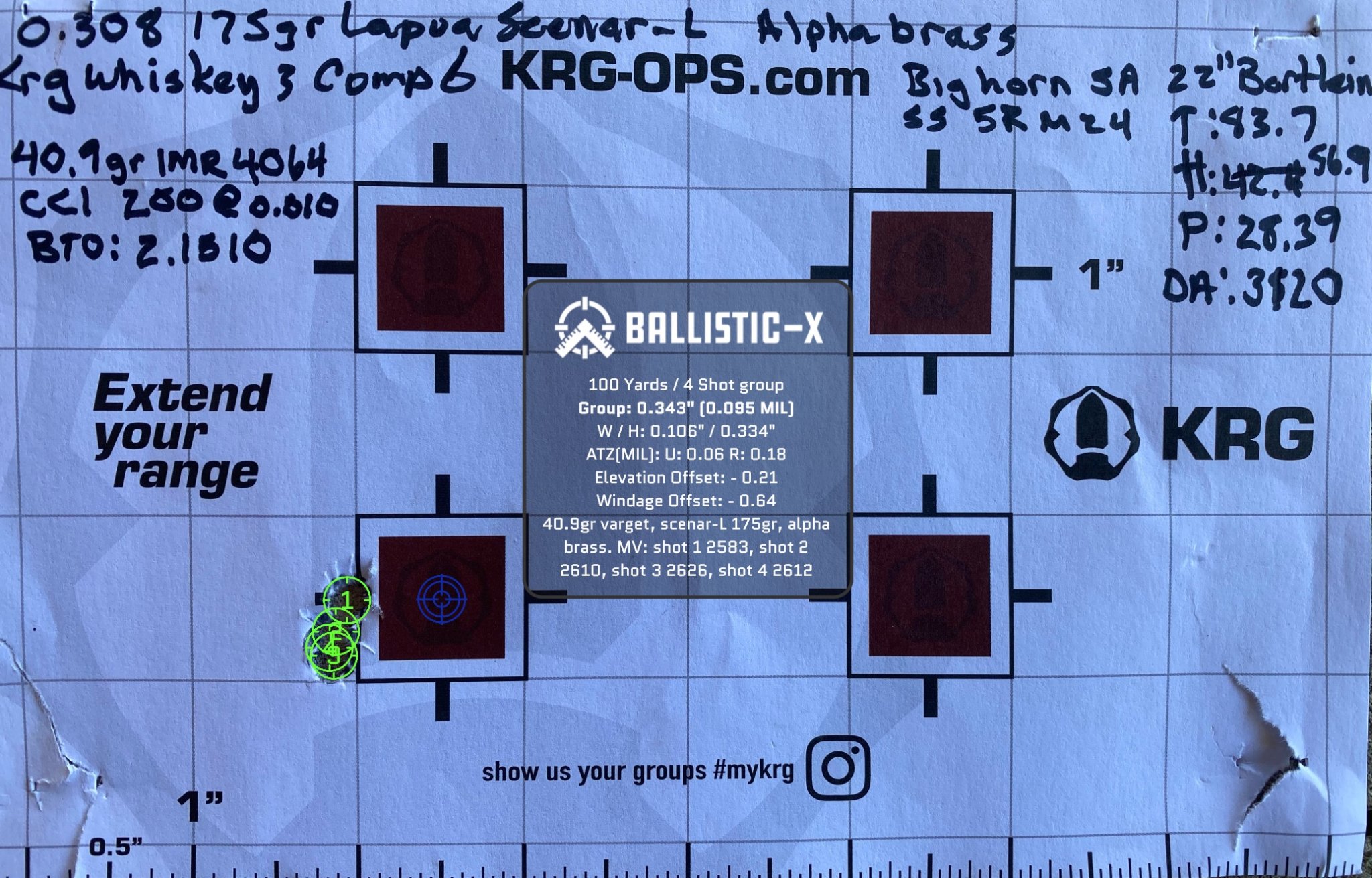

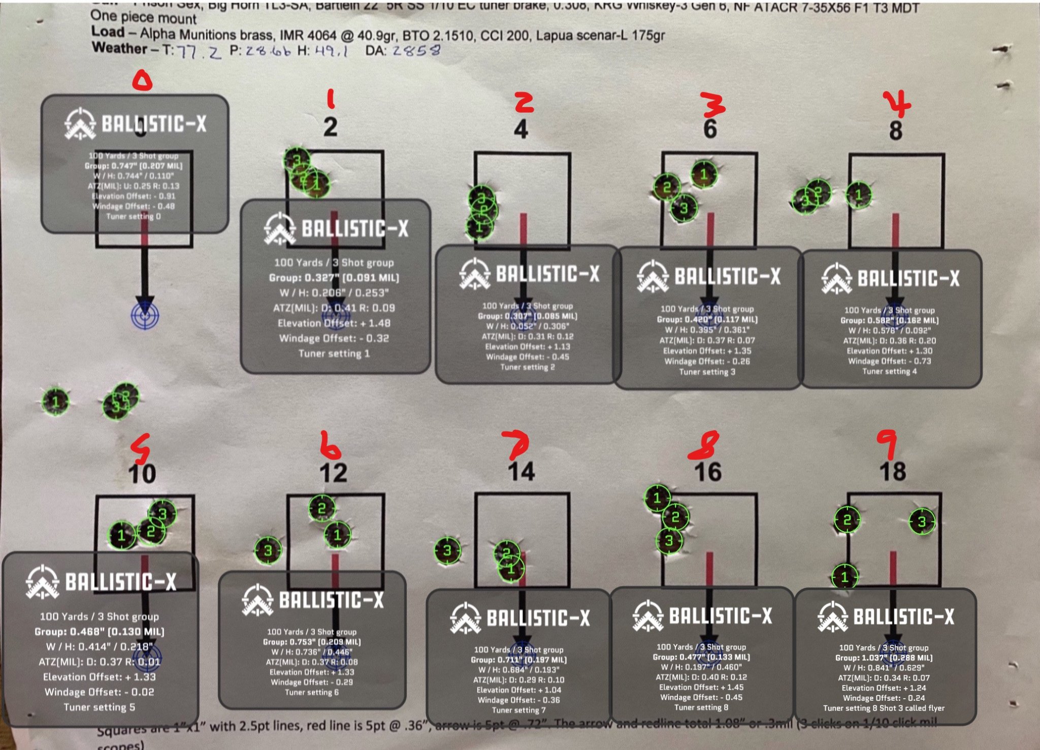

I tested my EC tuner brake last week. Here are the results at 100yds and 300yds. Of note this is shot with 40.9gr of IMR 4064 at a BTO of 2.1510 with 175gr scenar-l.
100yds:

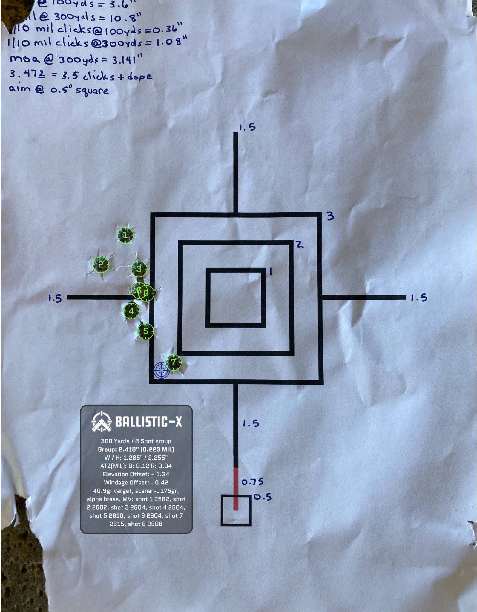

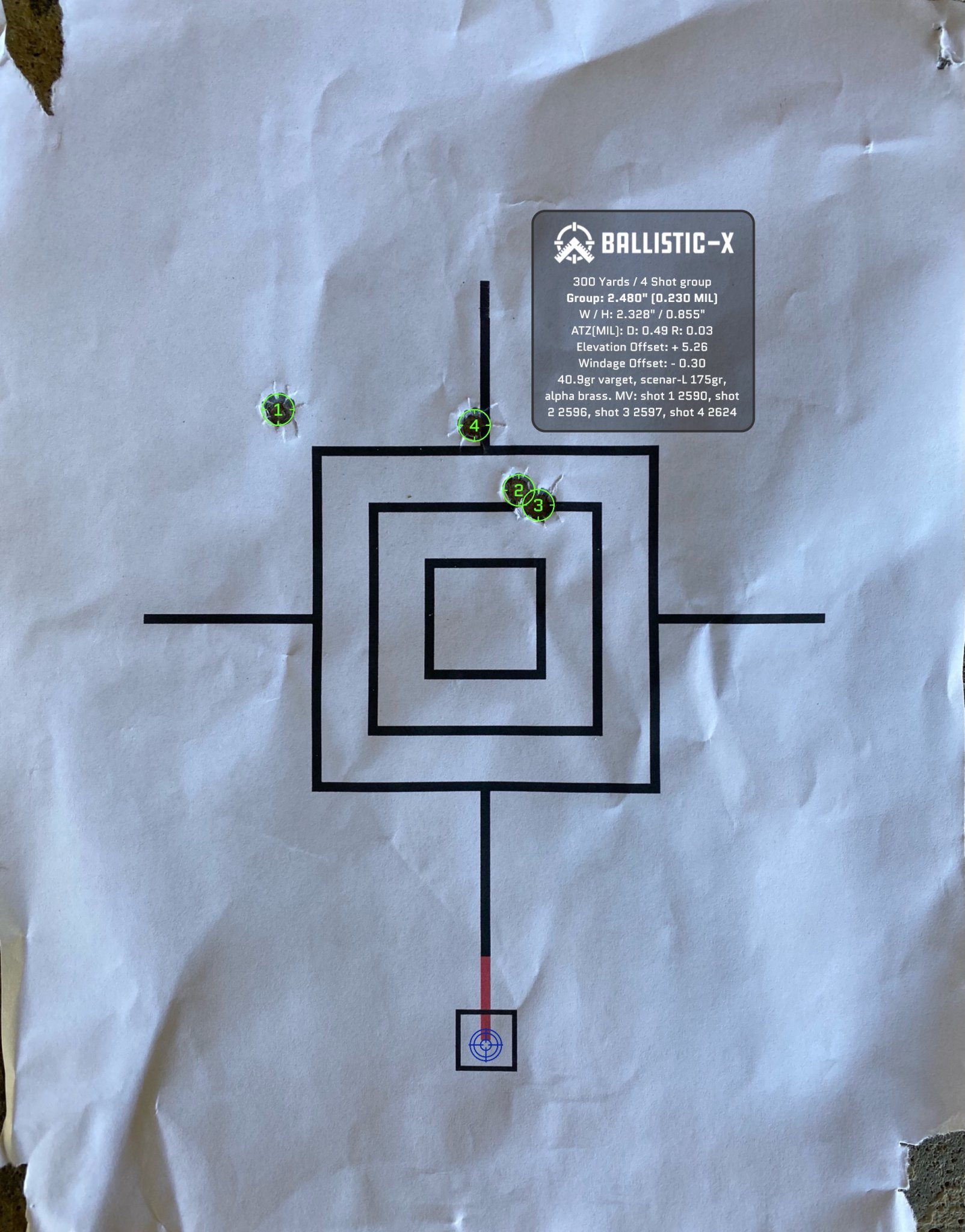

300yds:
First is just a 100yds confirmation
I did not account for any wind whatsoever. While I am happy with the results, I would like my groups to be tighter. There were no flyers at 300yds. I did my best to account for the flyers at 100yds. While I was shooting the 100yds I would take a shot get up and let my daughter see. Then I would sight in get up let me daughter see etc so she could understand POA/POI and follow through and recoil management. As I have only been reloading for less than a year, I am still learning and refining everything. My actual powder weight is 40.7grs of IMR 4064 which nets me 2605MV. Not much difference between 40.9grs. The node is from 40.5-40.9 muzzle velocities are within 20fps in this range.
As for the writing on the targets, I was teaching my daughter some things and why I was using those targets etc. She has a very accurate ruger precision 22lr that she smokes steel with.

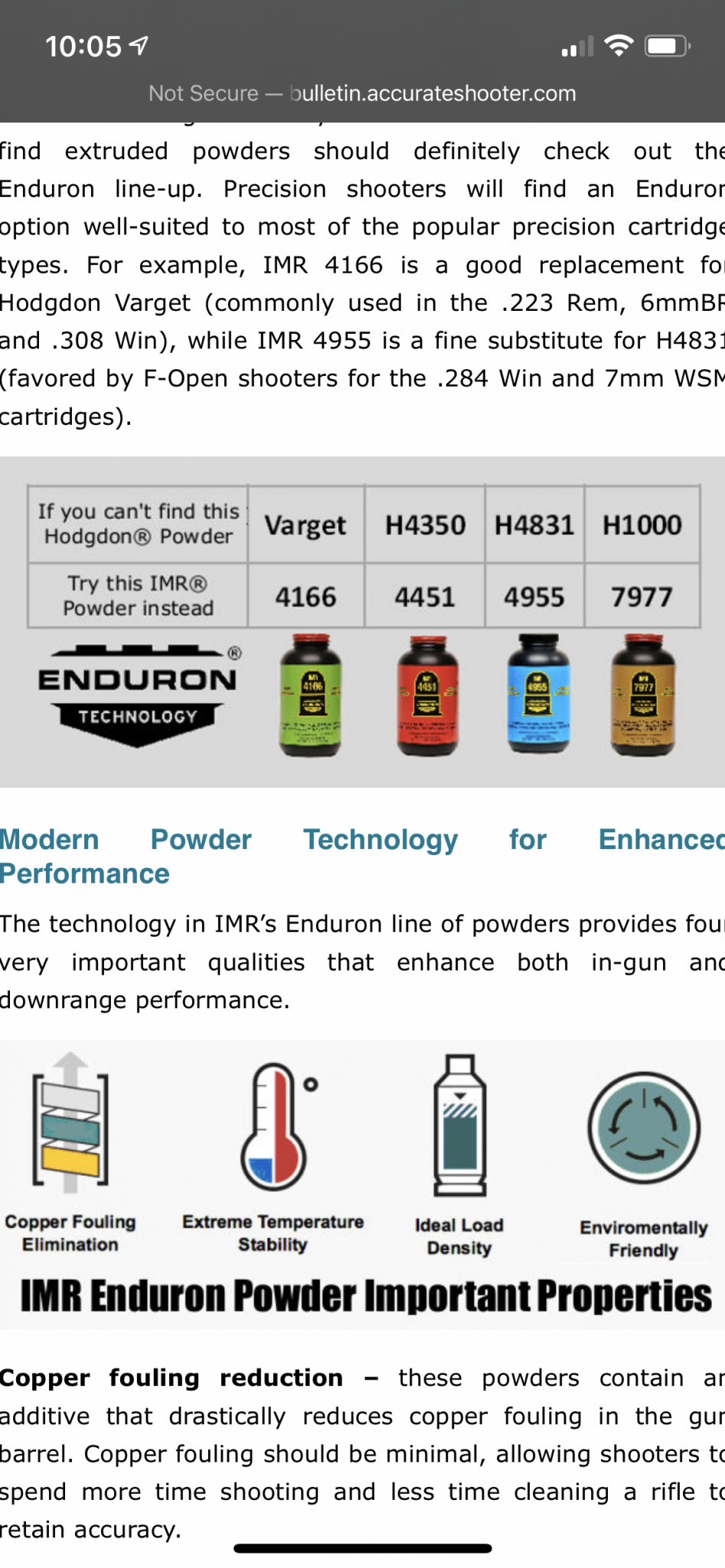

Hey guys, getting low on IMR 4064. I do see IMR 4166 for sale vs 4064. They are right next to each other on the burn rate scale.
Anyone messing with it?
Thanks
I've used 4064. I actually tried for a while with it but could never get it quite where it needed to be. I have had much better luck with Accurate 2520 and TAC for my 223 load

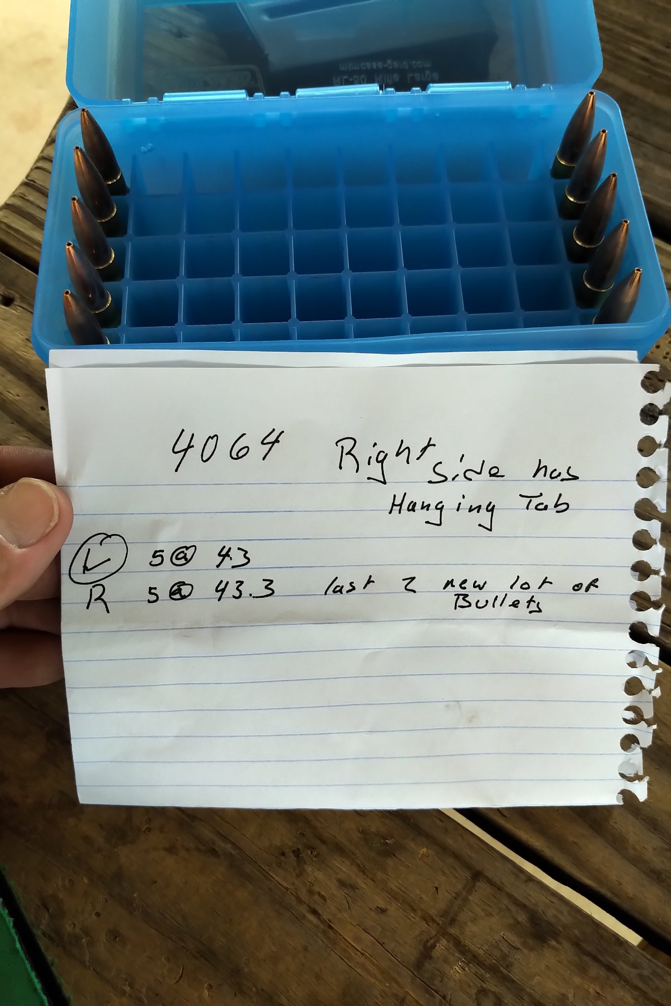

I have one (that I didn't choose to continue) but it was ok. Let me see if I can find the weight

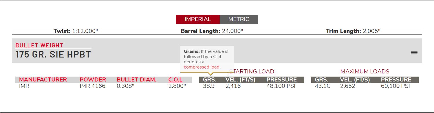

Anyone pickup Sierras latest manual? Wondering what they list for 4166 Enduron on the 175SMKs.

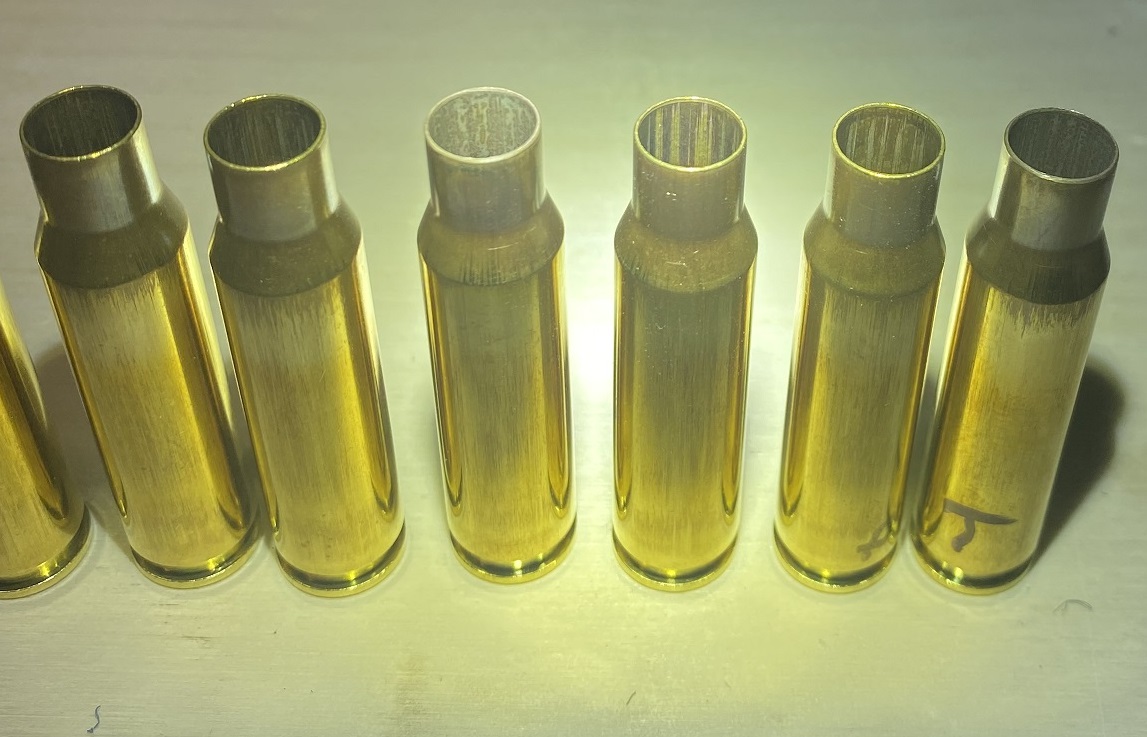

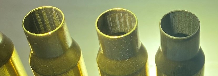

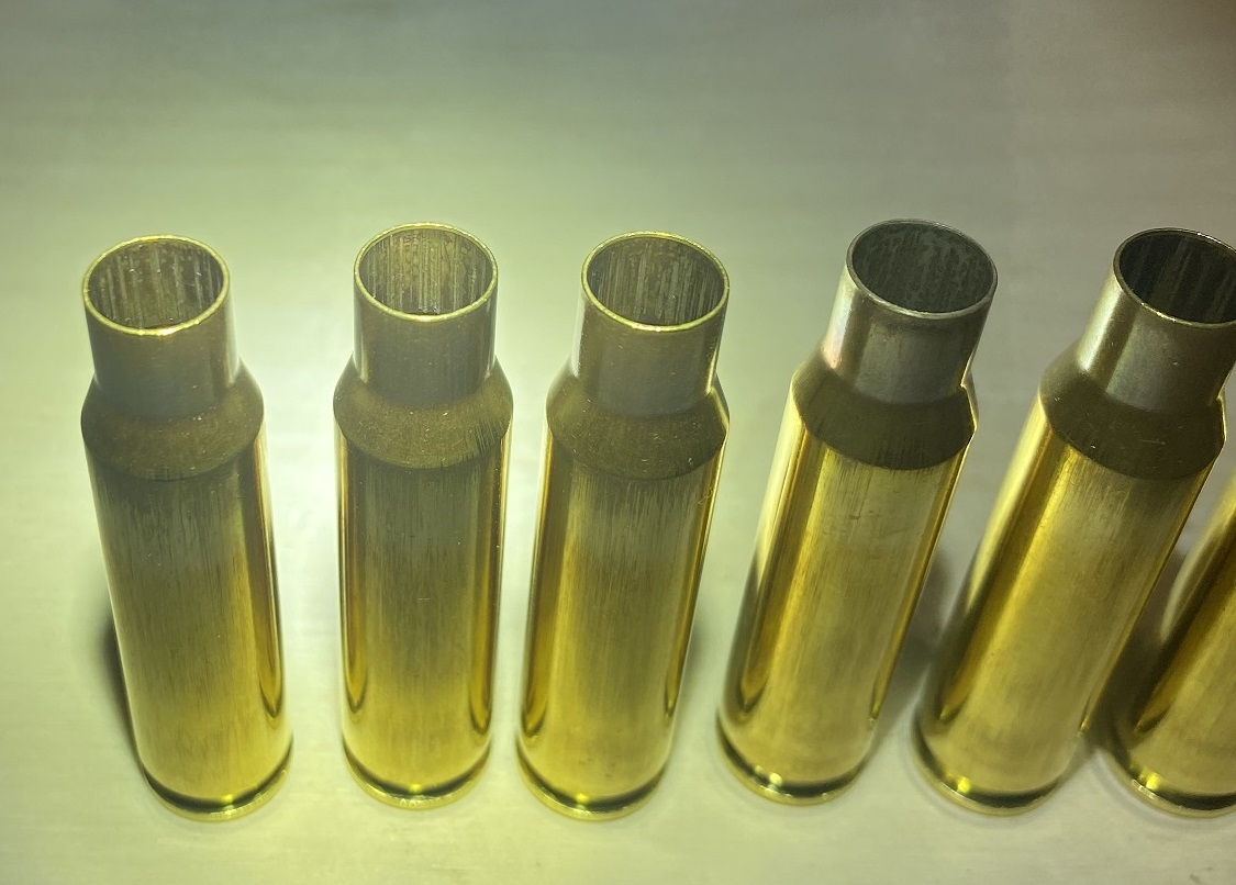

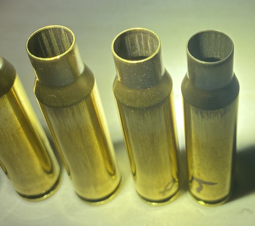

You can see the bullet marks. Sign of too much neck tension? This is right before I tumbled them. Still visible after tumbling.
Tell us more about the brass . . .
How many times fired, or is it virgin brass that's just been fired once?
What brand of brass?
Neck tension could certainly be a factor, but not necessarily the only factor that could lead to this. For example, it could be an issue having to do with the chamfering where tool is a bit dull and leaving it own little burr inside or the angle might not be steep enough. Or cases that have several firings and have never been annealed where the neck tension is producing a lot of grip. And, having very clean necks and not using any lube can easily result in this.
alpha munitions, annealed, first firing. .335 neck bushing with a .306 mandrel. Seating went with no abnormalities.
So, this is virgin brass that's been fired for the 1st time and you've sized the cases or at the least, neck sized them. You didn't say whether you lubed the necks with sizing or when seating. To me, it looks like what I've seen with virgin brass that was squeaky clean and not lube was used to seat the bullets. In addition at looking close to your picture below, it appears some of the mouths edges have been rolled a little, which would cause a little scraping of bullet as its being seating. I'm guessing with limited information.
I did not not neck size them as they are at .335 from alpha. Just ran a .306 mandrel with imperial graphite applied by dipping the necks. It does appear that the mouth edges look rolled. I did not use lube to seat the rounds
Hmmm??? OK, you used an Expander Mandrel and that's good to make sure necks are round and that you get the neck tension you want. But, you didn't say WHEN you used the Imperial Dry Lube; like before you ran the mandrel, before you charged them with powder, or both . . .??? Usually, giving the neck some of that dry lube before charging will help a lot in avoiding such scrapes. though it won't help much having rolled case mouths. On virgin brass, is usually helps to run the cases in a chamfering tool. My best results have been from running my virgin brass through my Lee Collet Die as it tends to take care of it all.
Used prior to the mandrel. Don’t use lube when seating. I did debur and chamfer the cases. I never noticed marks that prominent before this batch. I dont know if that rolled appearance is from the light I was holding reflecting weird or what. I’m not that hard on my brass. I’ll look into the lee collet die. I great appreciate the help and your time, thank you
On virgin brass or wet tumbled brass where the necks are very clean, I found I got results like you got. And where you're only lubing the case for the mandrel, there's probably not enough of the lube left to do much lubing. For brass that is virgin or real clean, like after wet tumbling, I always dry lube case a neck just before seating the bullet using a q-tip to swab the inside. The little cup of dry lube sits next to my arbor press when I'm doing the seating. :D It really helps reduce the seating resistance and eliminates or at least minimizes those kinds of scratches.
When I used to do just the expander mandrel for virgin brass, I would still have heavy resistance when seating, even though the neck tension was right were it was supposed to be and using dry lube. The use of the collet die really helped with getting easier seating and more consistent seating with virgin brass.
Hope it all solves your problem there. Good Luck.
if it matters, i use lee collet and have similar marks. i don't worry about them as im getting single digit SDs and my groups meet my needs. i'm seating with 1.5 thou tension.

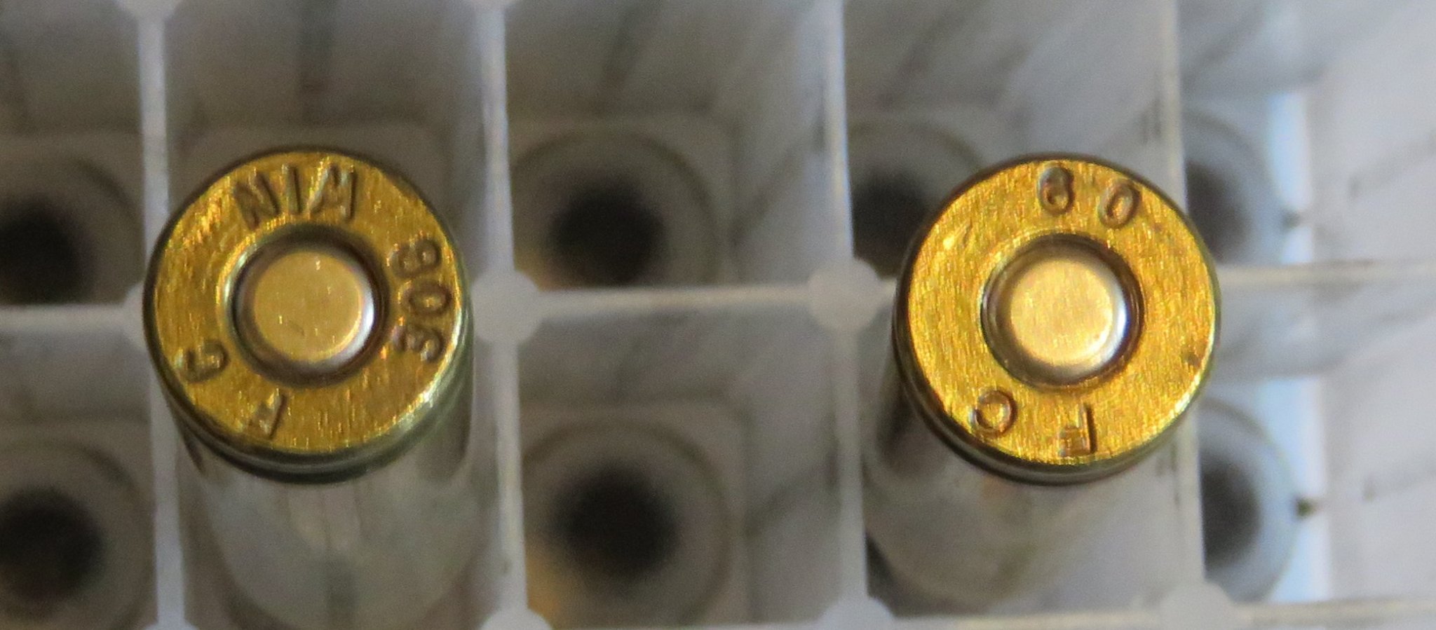

Are these tight fitting for everyone or just me?
Was tough with my hand primer just for a batch of 50.
Dang near stopped to set up press.
FC Brass Federal 210 primers.
Not all .308 FC brass is the same. For example, in my pic below the primers seat much easier into the cases like those on the left than those on the right. So, which is it for you?
Reactions: Snuby642
The ones on the left, all first fired FGMM
I'm thinking the ones on the right are crimped .mil ?
I did use my pocket gauge to make Shure, still tight.
On other brass / calibers my go to is CCI.
My sons gun loves FGMM 168 and since out of Varget tweaking cfe223 48gr seating depth.
I've reloaded a great many of them and not found any them particularly hard seating; certainly not like get with Lapua or Peterson brass. So, can't tell if you're dealing with a one off issue or otherwise there might be something going on with your seating tool??? Though I use my Co-Ax press to seat my primers, I can still tell if their seating tight or not.
Correct, the right one's were "crimped .mil". Even when I removed the crimp (using a deburring tool), they still seated tight after uniforming.
LRP CCI's are .0002 - .0003" larger in diameter than Federal. . . so???
For sure though, those FC pockets will loosen up after a few firings. ;)
Found it. Sorry it took a while. Somewhere in that range or a little more was pretty decent but not a keeper for me. @BigKev72
