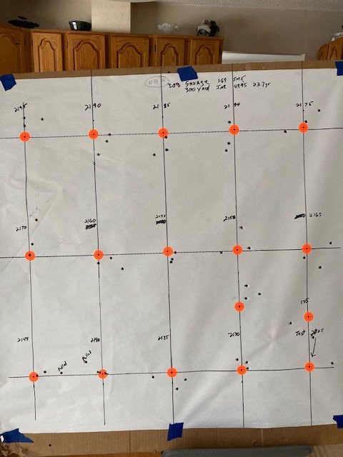

Well it finally got above 0 up here and I was able to get out and do a seating depth test of the SMK 169. I started .015 out of jam and in .005 increments went out to .085 out of jam. I shot 3 shot groups at 300 yards. For my gun this bullet likes to jump .080 and .055 and I have to re-shoot the .070 as I pulled one shot. This was shot with 43.7 g. IMR 4895. Next I'll do a 600 yard ladder test of these three seating depths.

I've worked up a very similar load for my rifle.
4895 43.2
I started my seating depth .020 off and went at .003 increments to .060 off
I had great results at
026 off and .032 off
Using a comparator at Ogive 2.248 oal hammered, consistent quarter inch groups
I posted a picture in my post a couple down from this post
I'm loving the new 169smk. My range has targets to 950y.
With load listed above hit 7 of 10 in final string

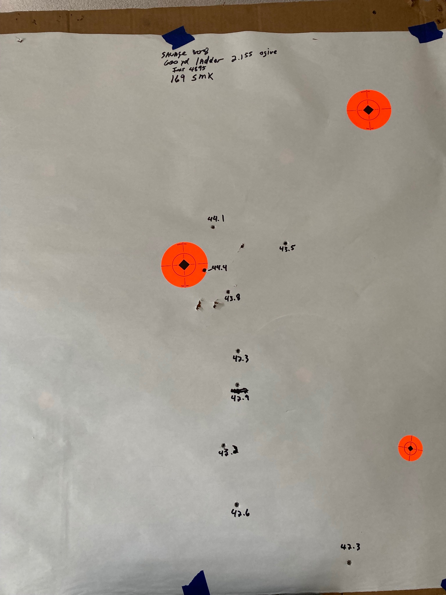

43.7 I 4895, any pressure signs specially with the .055 and shorter jumps ? Any special chambering ; ie; Palma, M 118,FR-R ?
Thank you
No pressure signs and it’s just a Savage chamber that I throated .030 extra. Today I did a ladder test and the last load was 44.4 and the primer was pretty flat but no hard bolt lift. Keep in mind I’m shooting in cold weather here in Alaska. Those groups were shot at 19 degrees.
Here’s my ladder test at 600 yards.
IMR 4895 42.2-44.4 in 3/10 gr. Increments
Ogive 2.155
Moa adjustment from 100 yd. zero +13.75
Temperature 18 f
I’m open to suggestions on this one. LOL
Stock Savage model 10 fcp 20" barrel.
4895 43.2
LC brass
Russian primer
2.248 OG
169 SMK
2610 fps
ES 17
SD 8 (10 shot string)
Consistent 1/4" groups at 100
Group in picture at 200 y
