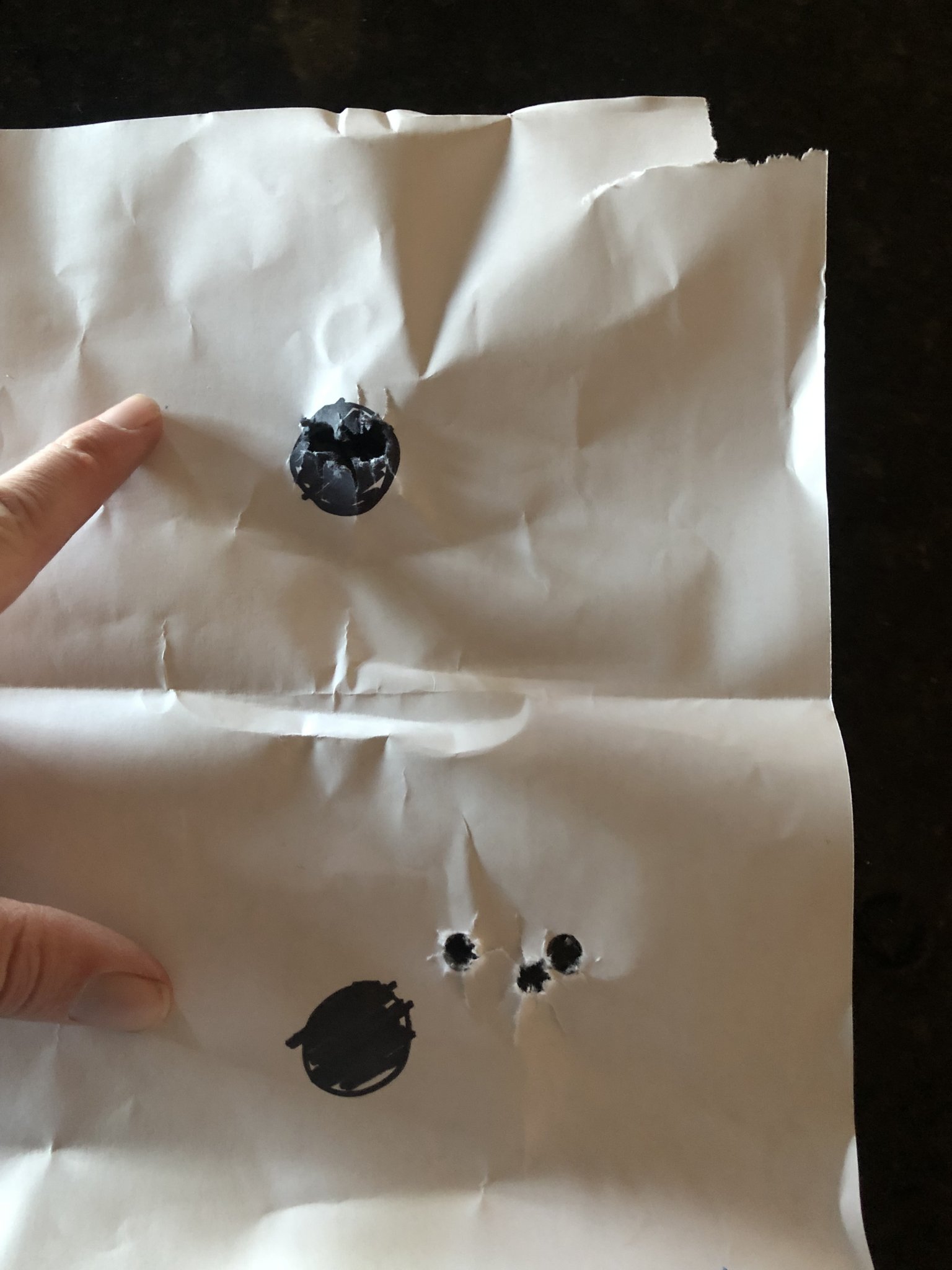

Back again with another question. I am competing in a 1000 yard 1MOA prone match next week...my first....with my 26" 308. Using info from this site my load development ended up with Nosler case, 43.5 Varget, 178 ELDX at 2720 fps and SD of 7.3. My question is that my AB shows a elevation of 9.7 mils. Most other comments I see are in the 11 to 12 mil range. I have tested the load to 448 yards (2.4 mil) but don't want to show up as the new guy 2 or 3 mil low. Velocity is with Magnetospeed V3. Oh, 100 yard five shot group.

Therein lies the rub. No sightseers and on a 10 inch steel plate. As it is a "fun match" fashioned after the recent YouTube Texas 1000 yard 1moa challenge, I am not too concerned, but want to show up prepared.
9.5mils sounds about right. My 18" was 12 and it was 200fps slower.

I cleaned and foiled my barrel, dope is good to 500. The 1k range is restricted to ROs and matched. I have my request in to become a 1k range RO, but not happening before the match.

If you know the actual velocity and BC, JBM will get you on paper at 1K, I've done it many times

Exactly. I have too and had to do that years back when i only had a 400 yard range and going to matches that shot out to 1000+. Today you get really close with good numbers and a good ballistic program. Actually shooting at 1000is nice but not needed.
I will report back on my success or failure. Supposed to be in the teens for the match. Thank you for a the advice and critique. I am going to try my first PRS match next month, so hoping this will deliver some good data.

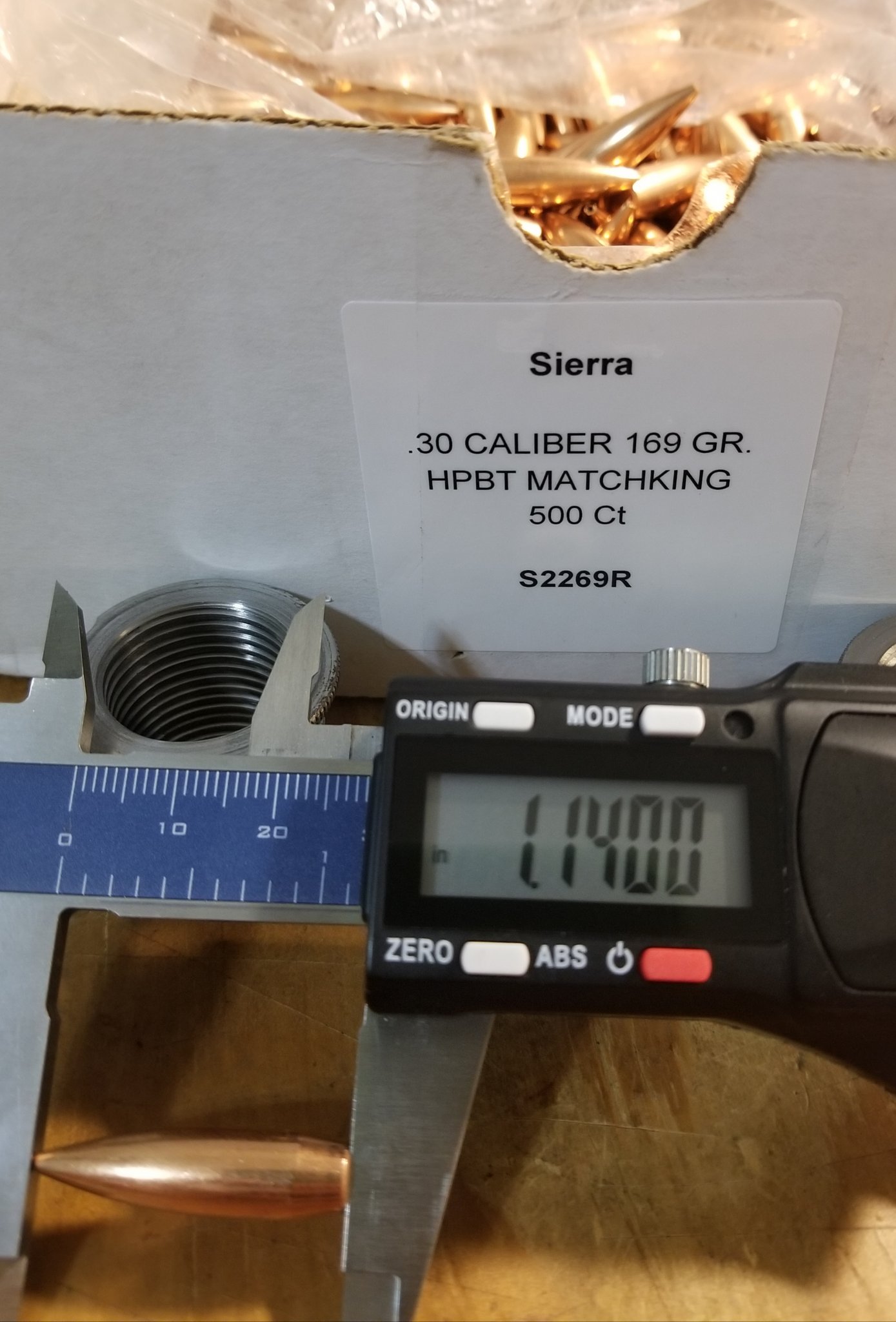

Hello all, I have a quick question hopefully someone could help me with. I just recently received an order from Creedmoor Sports for these bullets, (.308 169gr. SMK). From what I've read, I was expecting the O.A.L. to be longer than the measurement I am getting of 1.140. Does this seem correct or do I have incorrect bullets?
Wrong bullet I suspect. I just checked and got @ 1.3" on a loose 169smk...

That kind of looks like a 168. What’s it weigh?
You should weigh them to see if they're actually the 169 SMK's or the 168 SMK's. That 1.140 OAL is what my 168 SMK's tend to be. I've got ~2,000 rounds of 169 SMK's from a couple different lots and they measure from 1.296 to 1.316.
You should weigh them to see if they're actually the 169 SMK's or the 169 SMK's. That 1.140 OAL is what my 168 SMK's tend to be. I've got ~2,000 rounds of 169 SMK's from a couple different lots and they measure from 1.296 to 1.316.
Rob01 also suggested I weigh them and a few post up I responded that they weigh 155gr. If in fact they even are Sierra bullets, then the Sierra website has two options in .308 that weigh 155gr. One is HPBT and the other is a HPBT-Palma. I would need to call Sierra or unless possibly someone in the know, could post the differences between these two projectile specs?

Well I went to the match. While I was not competitive with the top shooters, the 12 degree temps and twitchy winds created issues for everyone. I only managed 7 hits on 40 tries. The top three scores (guys shooting much more dedicated guns and vastly more experience and way younger were 24, 22 and 18 hits) there were a handful who shot worse than me and despite a 7, I was only 3 points out of third so it was a rough match. The 308 was ballistically correct as with the low temps I calculated 10.2 mils, when it warmed to 18, I dropped out 2 tenths. Dug dirt all around the target but my 66 yo eyes just couldn't make the correction. Thanks for all your help guys.

Check the zero on your caliper??? Looks like it's showing more than 1.14" on the ruler portion.
Did you weigh them?

Yep, checked also on digital calipers and had same the measurement. I did weigh them and they actually weigh 155gr., not the 169gr. that they should. And by no means are these insulting questions.🙂👍
Well just wanted to give an update. Firstly I want thank you to everyone for there input and suggestions and helping me figure this out. After talking to Creedmore Sports we figured out the box was mislabeled and I was sent a box of 155gr.SMK's #2155 instead the 169gr.SMK's that I ordered. When I called them they had great customers service and are resending the correct bullets out asap.
They do. There was the 'original 155gn Sierra MatchKing 'Palma', aka model # 2155, for a very long time. Decent enough bullet, but had the BC of a whiffle-ball and the general tug-boat shape (short-n-stubby) like the S168MK. Didn't have the f'd up boat-tail angle of the 168, though. IIRC (this part is before my time) the bullet was brought out for the 1992 World LR championships for the US Palma team, as that was (I believe) the first time where the competing countries were able to use their own ammo at international events - previously everybody shot ammo provided by the host country.
Eventually, when Berger moved up from a small boutique bullet maker to something more serious, and first got Litz involved (way back when, before anyone had ever heard of him) they (Berger) came out with a 155.5gn 'Fullbore' bullet. Couldn't call it 'Palma', because Sierra had the trademark on that name locked up tight. But the 155.5 aka 'Triple Nickel' had a *very* long and sleek nose cone, and a *very* short bearing surface. Very successful bullet, right out of the gate. The US FTR rifle team used them pretty successfully at the 2009 F-Class World Championship in England, and the 2011 Creedmoor Cup in Ireland.
Why is that relevant? Because eventually even the sling shooters started realizing that using the good ol' Sierra 2155 was like leaving points on the table, given the difference in BC. After some pressure from the US Palma rifle team, Sierra rolled out the 2156 design - which looked *very* much like the B155.5BT, with the addition of being factory pointed. They didn't completely get rid of the 2155 - it was still a good, if dated, design and met a lot of people's needs. But the crown jewel 'Palma' designation got rolled to the 2156 instead. If you ever see either of these listed with the 'C' designation, that's just the bulk pack i.e. 500 count box vs. 100.
The S169MK looks like (haven't had any in hand yet) someone went back and updated the S168MK to the standards of the 2156 design. In my opinion.
Probably more than you wanted to know, but there you have it.
