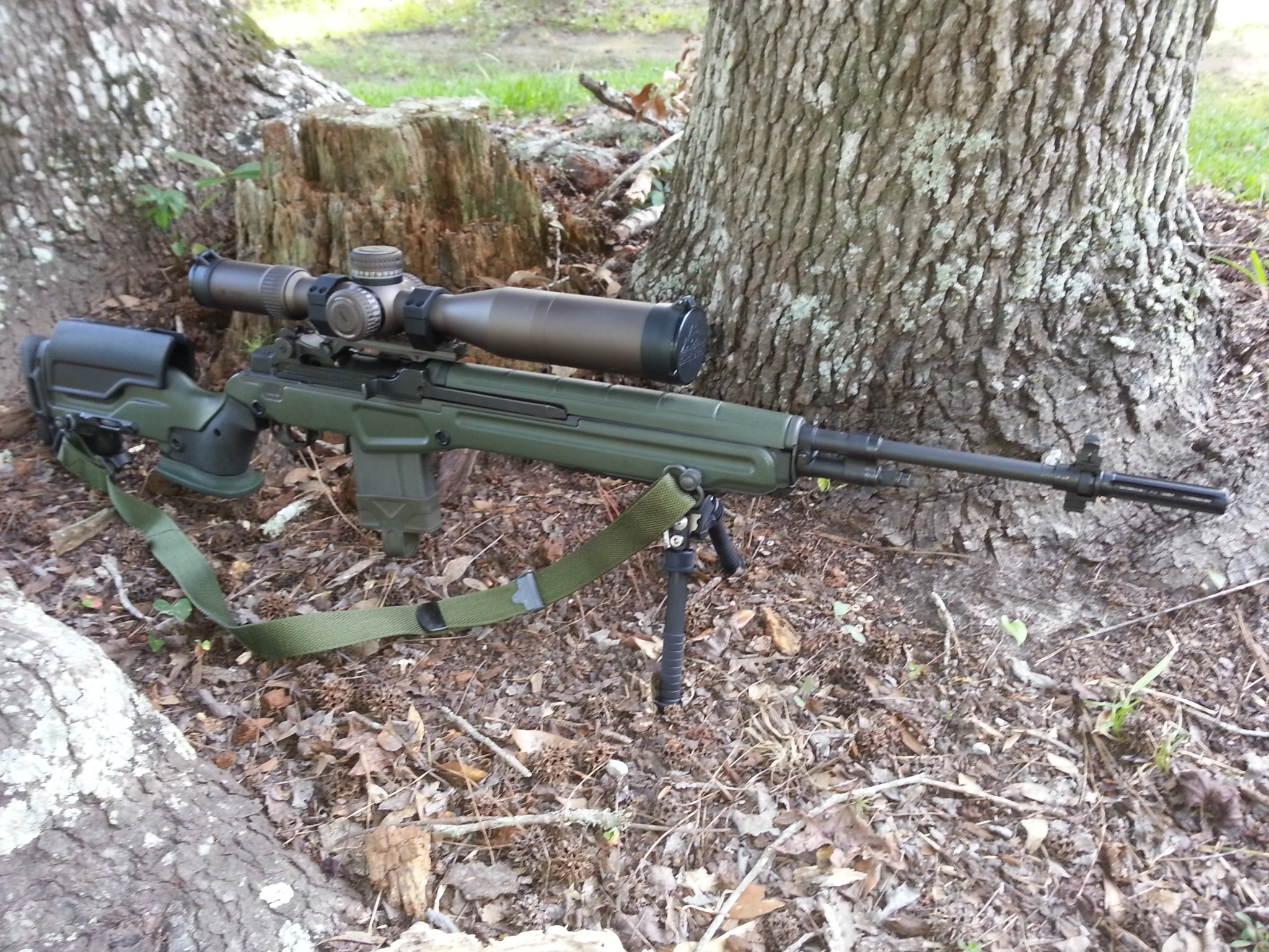

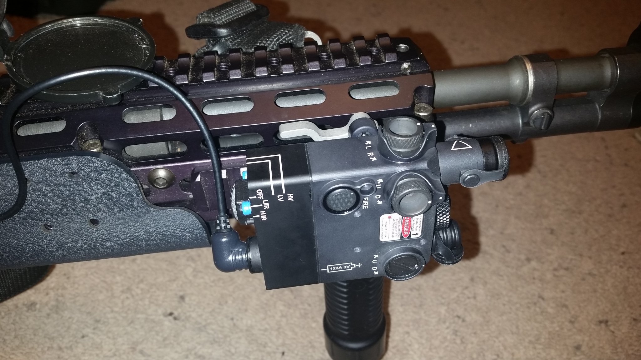

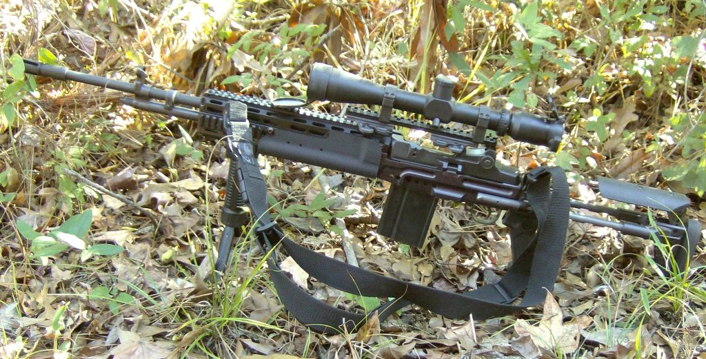

I'm about the same way, a dozen or so M14/M1As , a single AR10, and just one 308 with a bolt. Most of my bolt guns are of 300wm variety or 30-06.
I stick to the traditional powders in the so called safe burn rate(s) (4895, 3031, 4064, TAC, 8208, BLC-2, 2000MR,etc.) for a M14/AR10 gas gun but i have run some pretty hot loads through my M14s. I run a lot of 175 Nos CC and 185 Jugs out of my M14 rifles setup for long range. I even rolled a 338 Federal barrel for one of my M14s and push .338 225gr SST just under at 2600 if anyone was going to fold up an oprod I would have done by now.
The point is you can push a M14/M1a action pretty hard, Alliant 2000 MR will produce some fast velocities with heavy bullets but is temperature sensitive especially on the edge of too hot. I'm a RSO at a public range I see people show up with hunting ammo and beat the snot out of their M1As with it. It cycles the rifle(s) but might not throw it in the more typical 1-2 o'clock pattern.

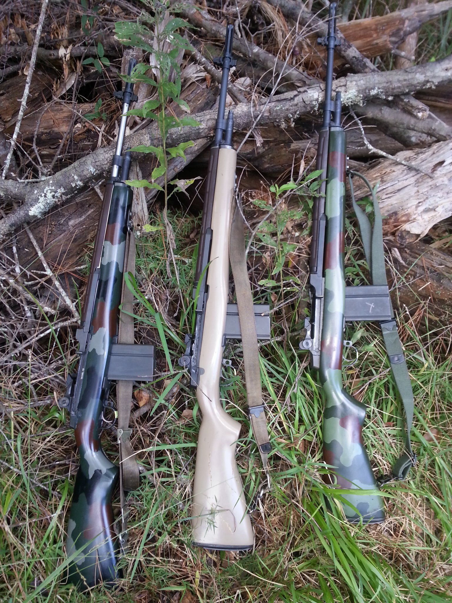

These are my XTC competition rifles, all of them are capable of 1 moa accuracy supported but with a GI sling as your only friend well you're lucky to hold 2moa. I was the last M14 shooter on the line in our group, I'm running a mouse gun now but still drag out these whenever I get the chance,

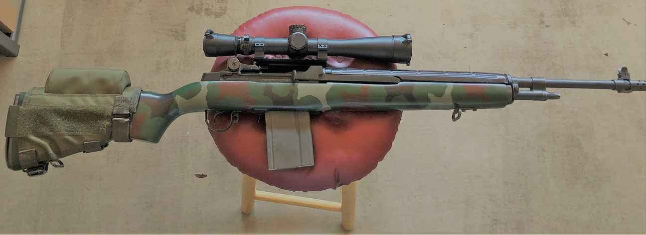

I had one like on the right, same stock, medium saco lowell barrel, bassett mount, leupold m3 scope. Shot great. Would like to get another one but can't swing it right now.
H4895 is my favorite 308 powder, it's not the highest velocity but really consistent and easy shooting in semis and bolt actions. 41.5 in FC brass with a 175smk shoots well in everything.
Reactions: canman

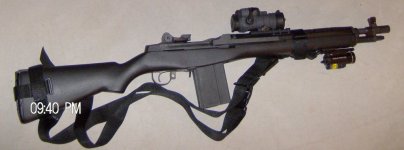

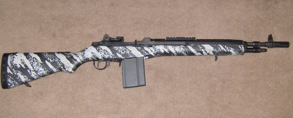

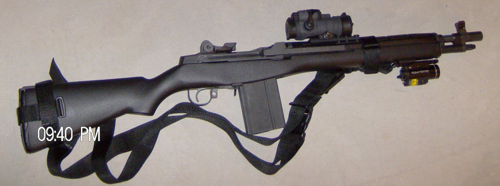

I have them in many flavors, all my M14s are my Hallmark rifles (When you care to send the very best, only 7.62x51mm will do) I like the Sadlak (Brookfield) mount the best, on the JAE, but have a CASM mount on my .338Fed M14, a custom mount on the Sage EBR , use the Scout mount on the Socom and the balance are still iron sights. Oh I have an IR laser on the EBR too, it's an interesting setup on the side pic rail, lines up parallel to the barrel I have it set at about a 200 yd convergence. The Socom has a M3/COO first 3 setting for use with NVG.

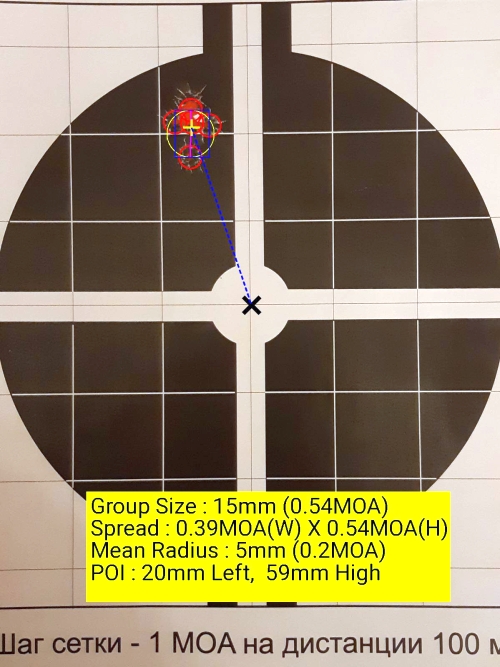

Over a year ago, I posted information about my beginnings in ammunition reloading - I started with a Lee loader and a hammer, and I even received a little praise for a quite good result gained with a hammer :) - 5-shots group of size 0,85 MOA at 100m, but the general advice was this:
I would say that getting a single stage press would be the best way for you to reach your goal and give you more control over how you load each cartridge.
With some delay eventually I followed this advice ( bought the simplest Lee Breech Lock Reloader ) and after one year I can present my progress :
5 shots, 100 m, rifle : Record-1-308, scope PS-07 ( x7 ), bullet : Nosler CC HPBT 168gr, powder : Lovex 73.6 - 43 gr, primer : Fiocchi LR, case : S&B [ I did not change settings of the scope - they were from the previous shooting at 200 m with a factory ammo GGG 168 gr Nosler HPBT - that's why the POI is 2 MOA higher than POA ].
So I think the Nosler CC 168gr HPBT is my sweet bullet ( for both - factory and reload ammo ). I do not know my sweet load yet - I just reloaded only 5 cartridges based on the calculations of the GRT program with a charge of -15% from the maximum pressure.
