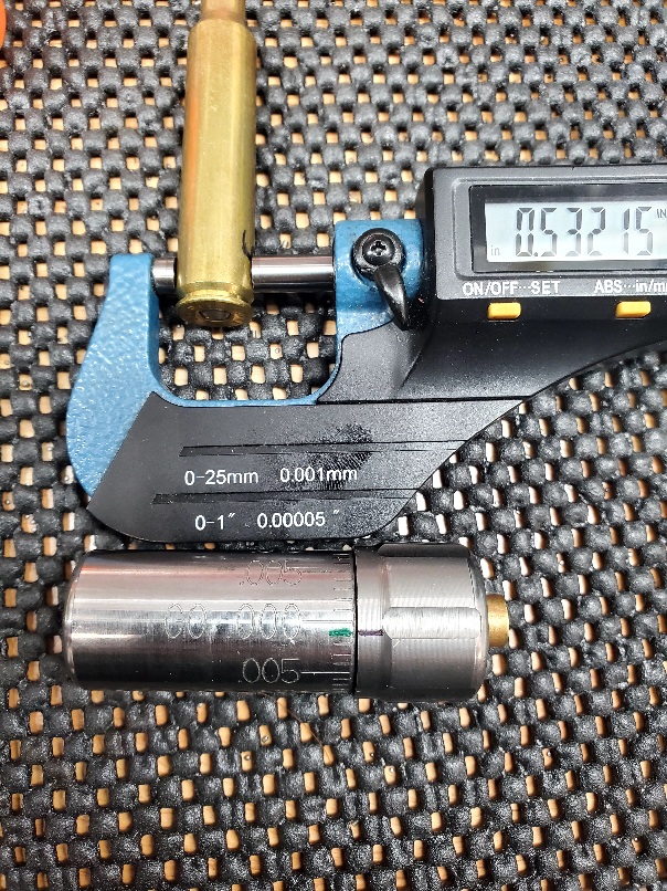

Necro thread alert! I've got .532 at .200 up from the base on my sized brass. The brass has 3 firings. The barrel is a Mcgowen remage. I'm going to pull the barrel and open up the chamber. How much does it take? .001 or .002 or more?
Reactions: Jackomason
You should have .002”-.003” of clearance after sizing. So if your cases come out .532” after sizing then your chamber should be cut/polished to .535”

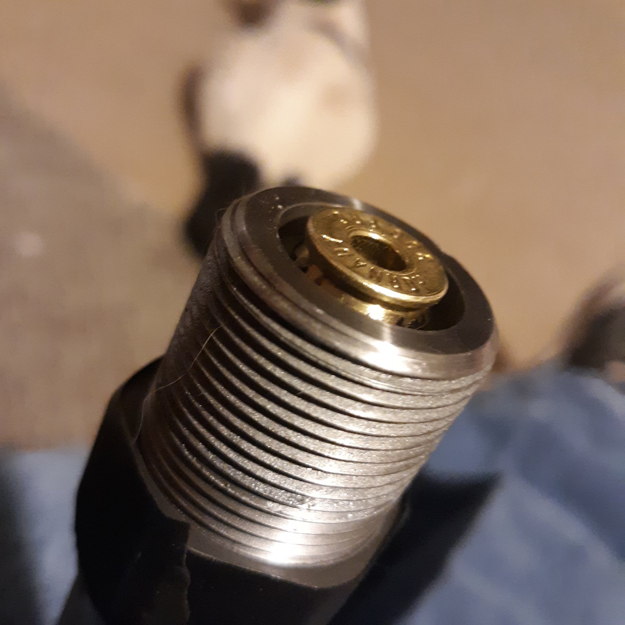

3x fired. Sized.
And the 3 times is sized? I'm assuming yes but you didn't specify like the 2x.
How do you set headspace? How does your fired case headspace compare to saami? Being a barrel nut setup do you consider how you set the headspace has an effect on fired case size?

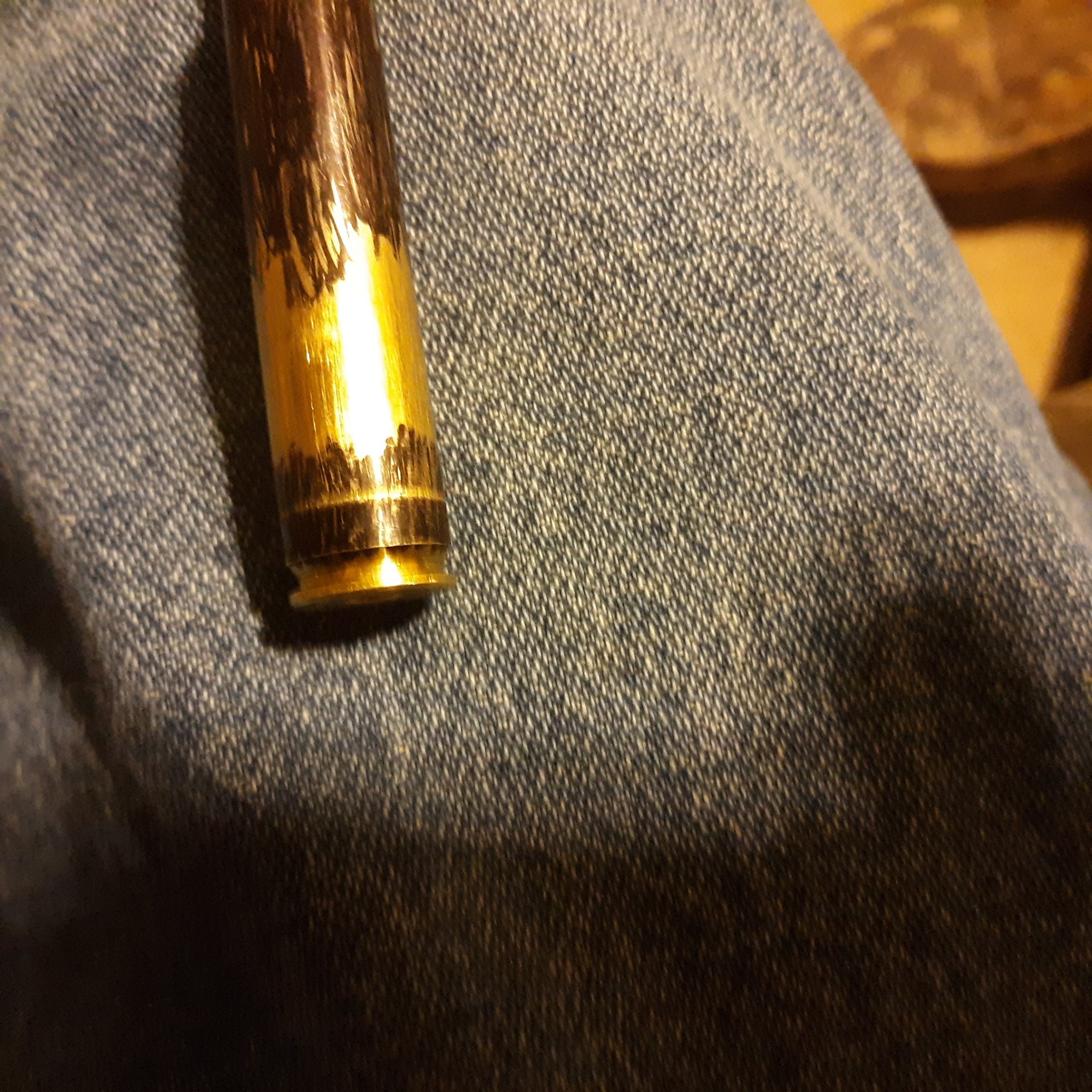

I set the head space with go no go gauges. I took a 1x fired case and sized it bumping the shoulder back until the bolt would drop closed by itself. The 3x is sized. I edited that post. I also took the sized 3x case and sharpied the base and web. There is a nice clean ring around the case at the .200 mark.

Just for reference. My sized brass also measures .532 and my headspace using the Hornady comparator D400 is 2.2065( 2.2085 fired) -.001 using a whidden case guage.

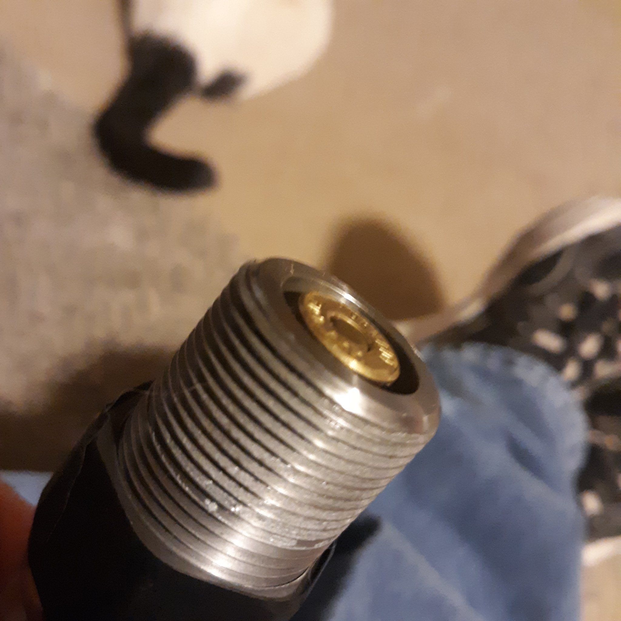

Update on 3x fired and sized brass. It will chamber in a X Calibre barrel that was headspaced with the same go no go gauges that were used for the McGowen barrel.

I picked up a redding type s bushing full length die and it's noticeably tighter in the .2 case web area. Initial testing with a couple rounds I think I might have my issue solved. My redding die is getting ADG brass down to .528" at the .2 measurement. For reference my hornady die was only able to do .5295".
Edit: My fired cases are .531"
