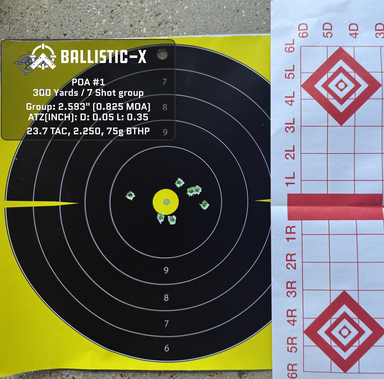

I finished load development with.223/5.56 77 SMK and AR-Comp a week ago on my 14.5" AR-15 with an Aimpoint red dot sight. I strongly advise using a chronograph to compare to a known load, such as MK 262 Mod 1, as you progress up the ladder. I backed down around 0.6 grain and got the following results from 20 shots at 100 yards. If I can attain this accuracy at 100 yards with a 14.5" barrel and red dot, I believe I'm ready for anything I plan to use the SBR for in the future. The next stage will be to shoot these through another of my ARs, a 14.5 SBR with a 1-6x variable scope, to do a more critical accuracy assessment.
I love AR-Comp but ive been avoiding doing load development recently with Alliant powders since they will practically be unobtainable in the US pretty soon. Im switching to mainly VV (N140) for its excellent price & performance…also doing some with AA 2520 and TAC for mk262 clone loads. TAC kicks ass as a cheap all around easy metering powder to have on hand.
Love TAC. Performs even better when you load it on the hotter end of the range.
I just shot some 77 smk’s in LC 556 brass @2.246” with 25.0gr TAC with zero burrs etc on the brass and primers were fine. Avg speed out of a 16” Wylde barrel was 2806. Black Hills 77 otm in same barrel is 2692. 2806 is pretty smoking fast for those 77gr pills. Love it!!

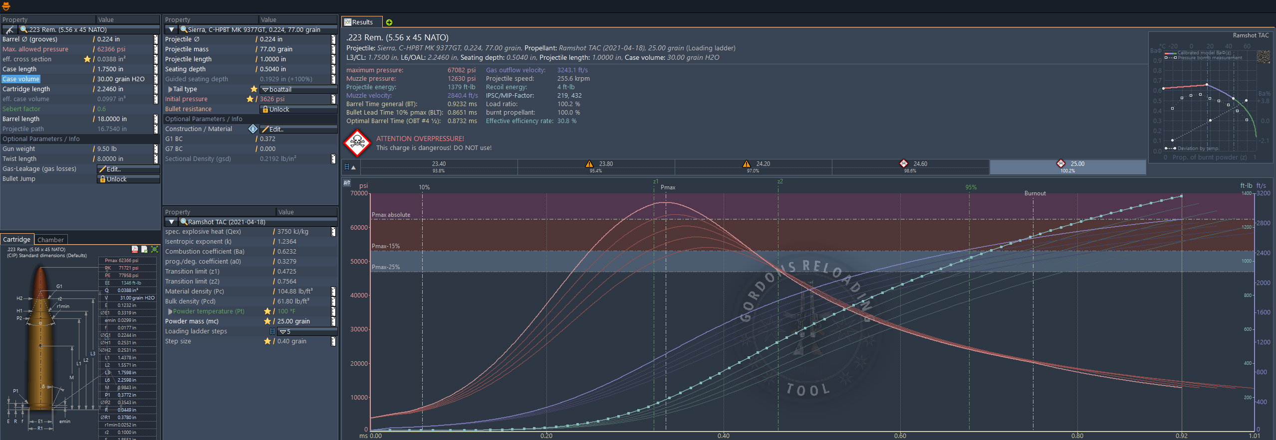

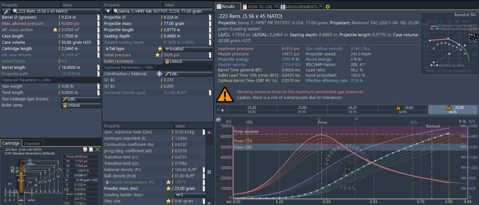

I tried to duplicate it in Gordon's reloading tool and it took me a while to match your pressure results. The difference I found was the brass I'm reloading measured case volume (h20 on scale) at 30.00gr for LC '95 brass where yours is 30.88gr. That difference in case volume gives me 67k psi to your 61k. I've been using random year LC and still getting some pressure signs with that load, but I'm ok with it for the small number of these rounds I use.
Yeah case volume seems to be a very sensitive input, even changing it by hundredths of a grain will swing chamber pressure by a few hundred psi. My measurements were actually closer to 31 grains on avg but I errored on the side of caution and used the smaller of my numbers when I saw how much slight differences could swing chamber pressure.

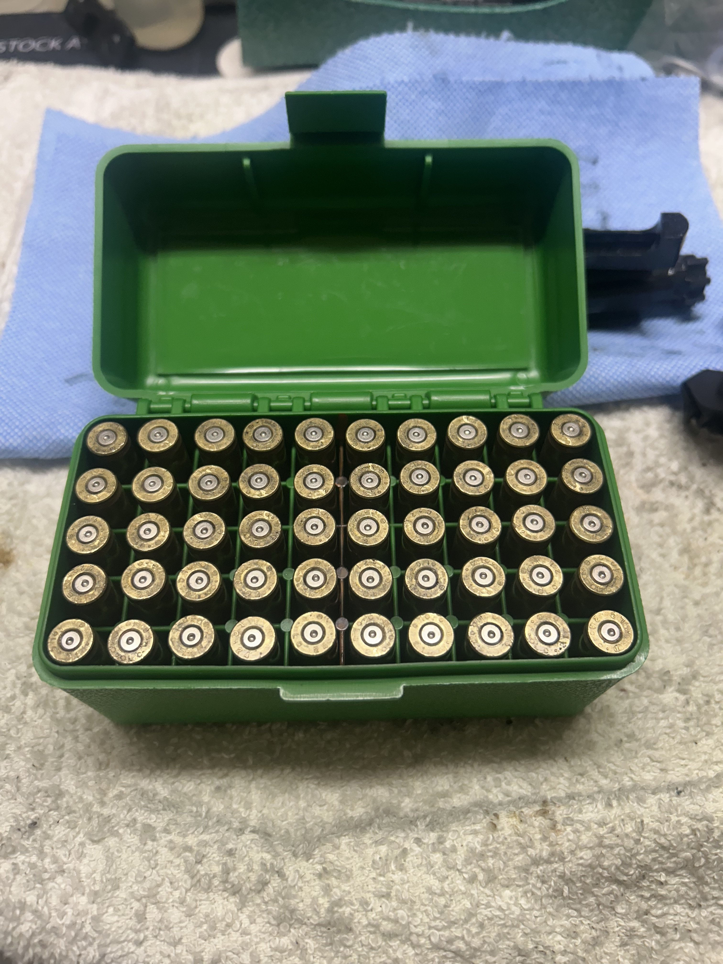

Here’s a pic of the brass. The row furthest from camera was the 25.0gr load, there were definitely some swipes but no burrs (I also just installed a fresh sprinco ejector spring in my bcm bolt):

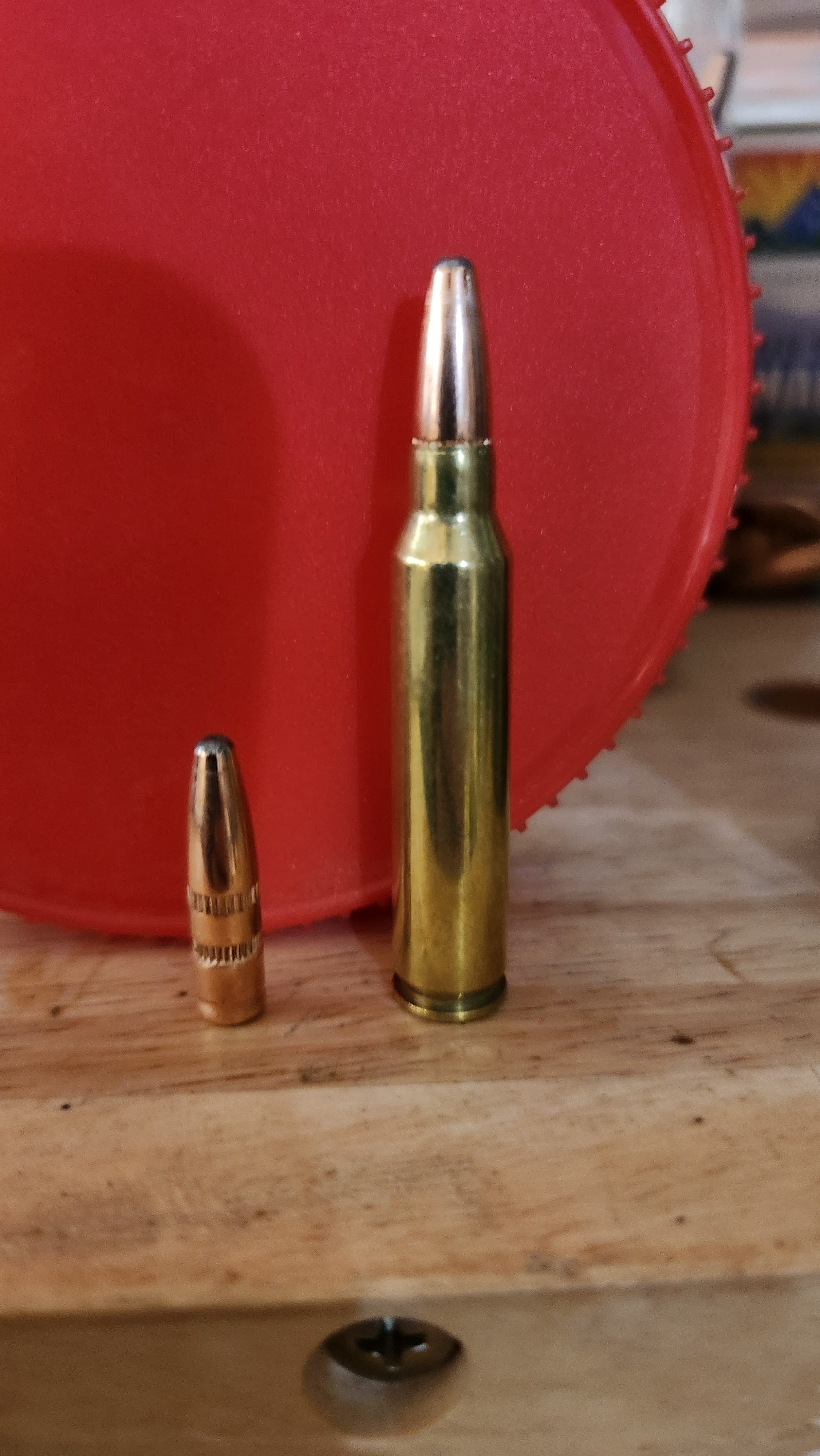

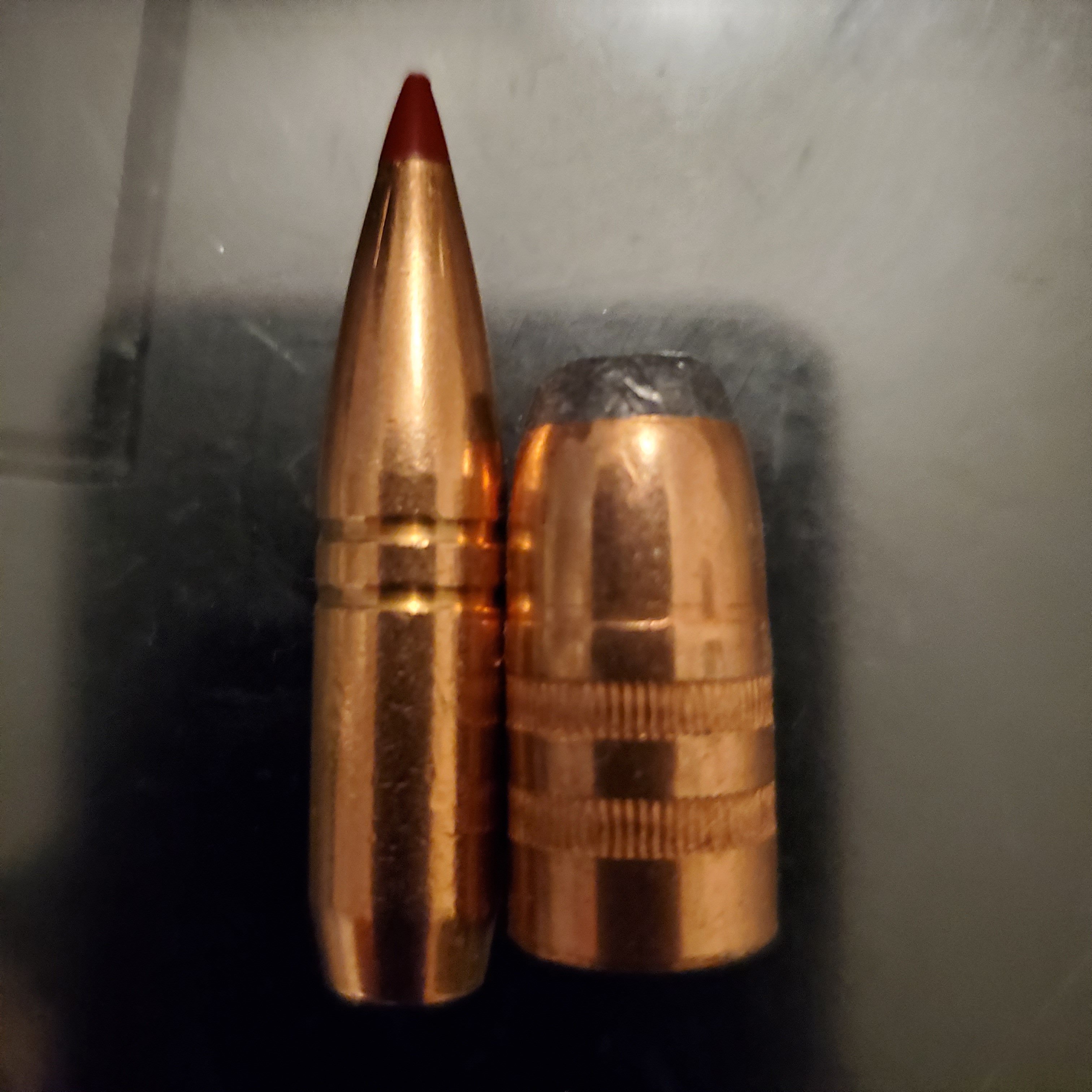

Right now I am working on loads for these Hornady 75gr Boat Tail Soft Points. I have tried Power Pro 2000mr, and Benchmark, neither were impressive with the lowest velocities showing the best accuracy (2moa ish). I slapped together a ladder using Varget and plan to try it tomorrow.
Reactions: Balor
^Double cannelure? I've never seen that before. How odd
It's fairly common to have a double cannelure on bullets.
Reason is for different cartridge overall lengths to fit common actions the bullet might be used in single shot, or lever action...or limited by magazines of a common factory rifle and cartridge it might be chambered in, like maybe 338 Federal and 338 Win Mag using the same bullet but need a different area crimped to meet COAL for each common cartridge the factory intends to load this bullet.

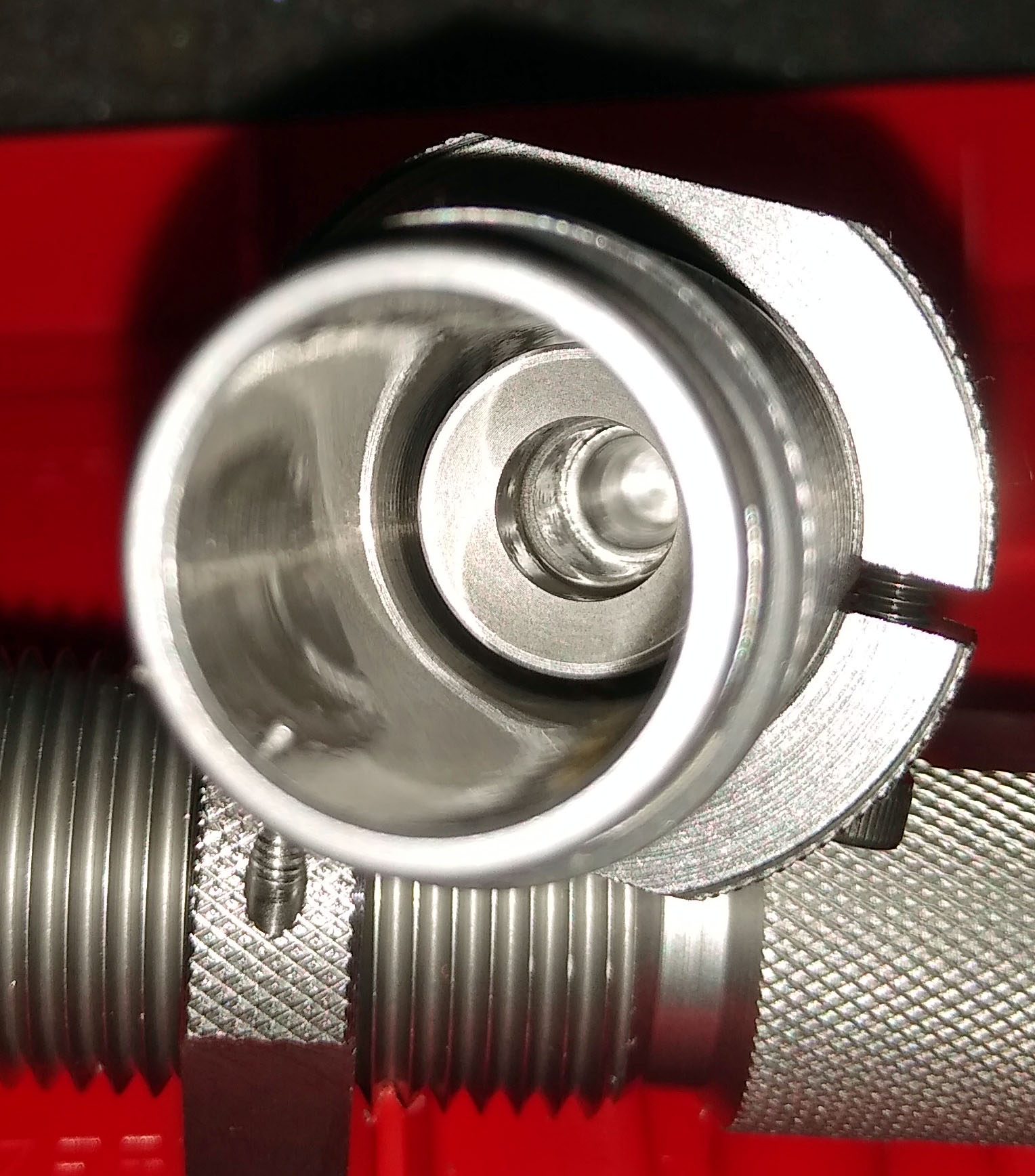

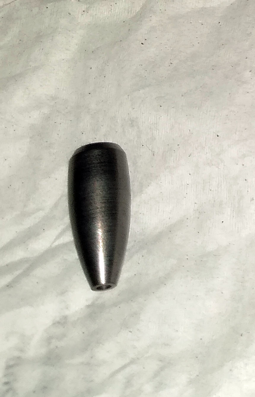

Yep. This is why I use expander mandrels (either separately or in the FL die). I dont fuck with bushings
I turn down the expanders in my fld's so they straiten case mouths and pre-expand far under size on the neck.
And separately bring them to size with the mandrell die.
Something about that procedure dropped groups 20% and some loads a little less some more but every load improved enough to see results.
Brass also runs better in the fld's .
Get the necks " straitened out" and other things fall into place / results of changes are easier to measure.
Not an expensive tool just another step, well worth it to me.

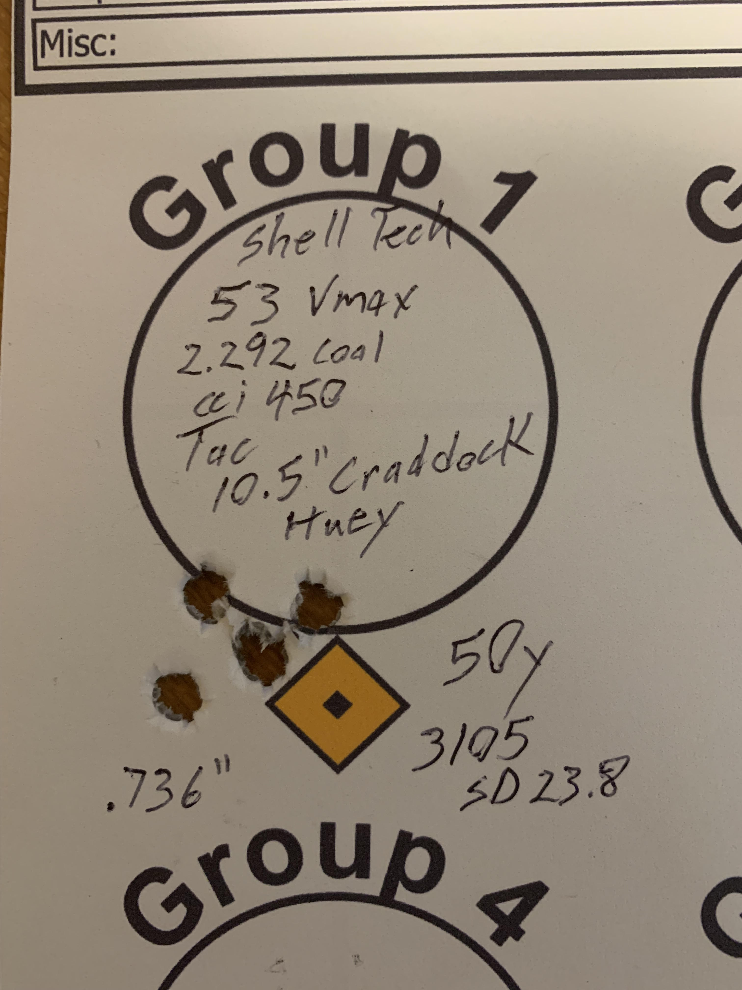

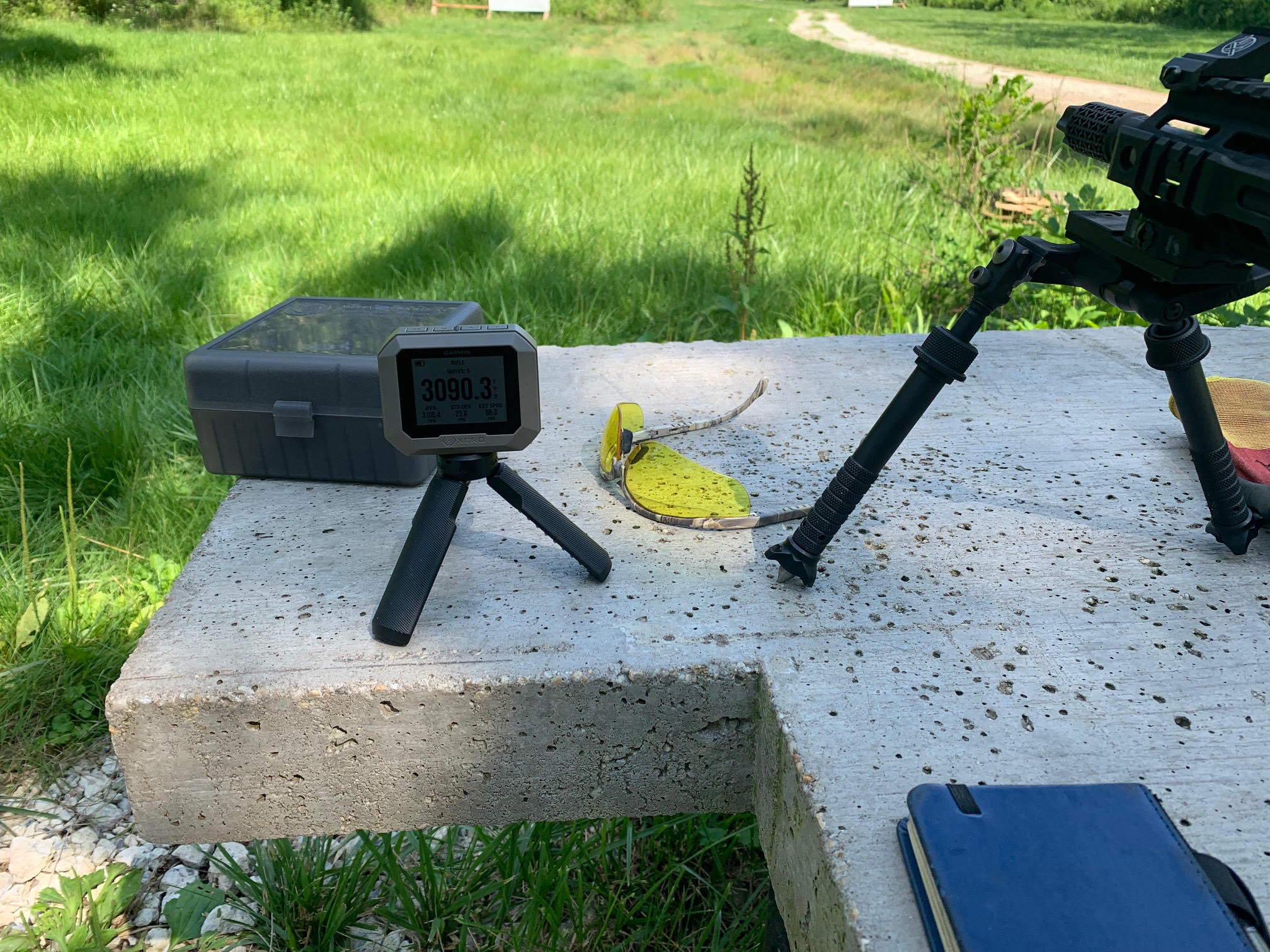

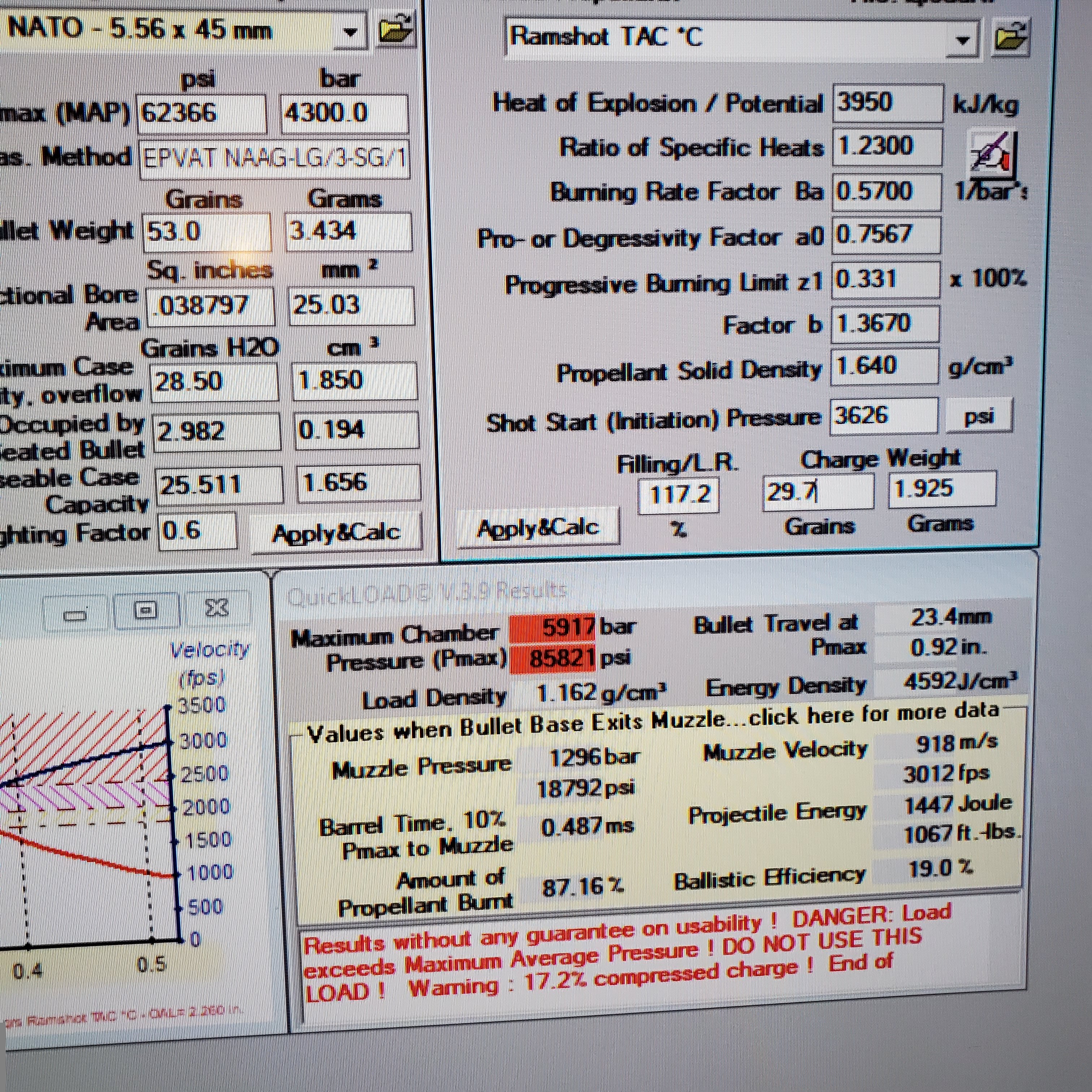

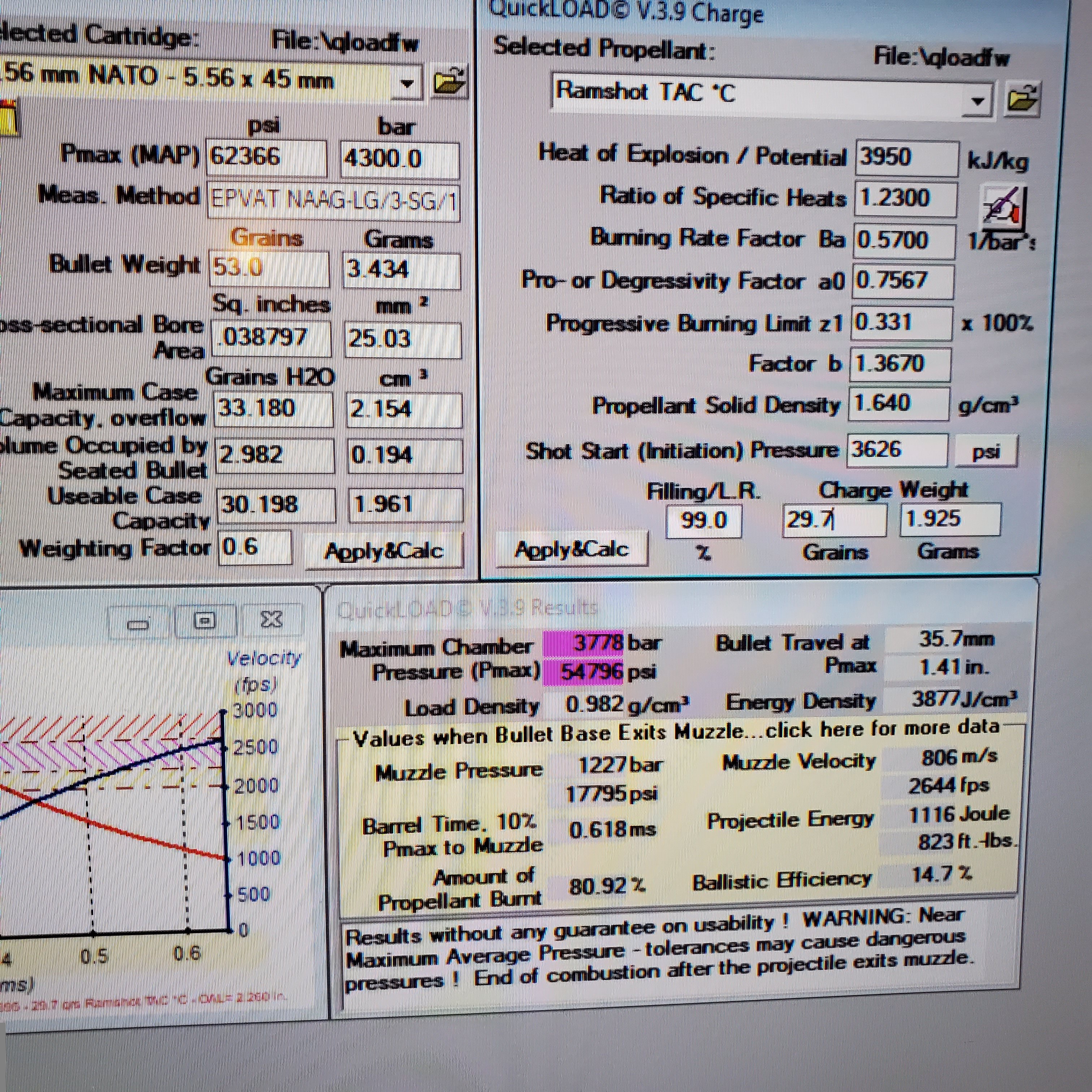

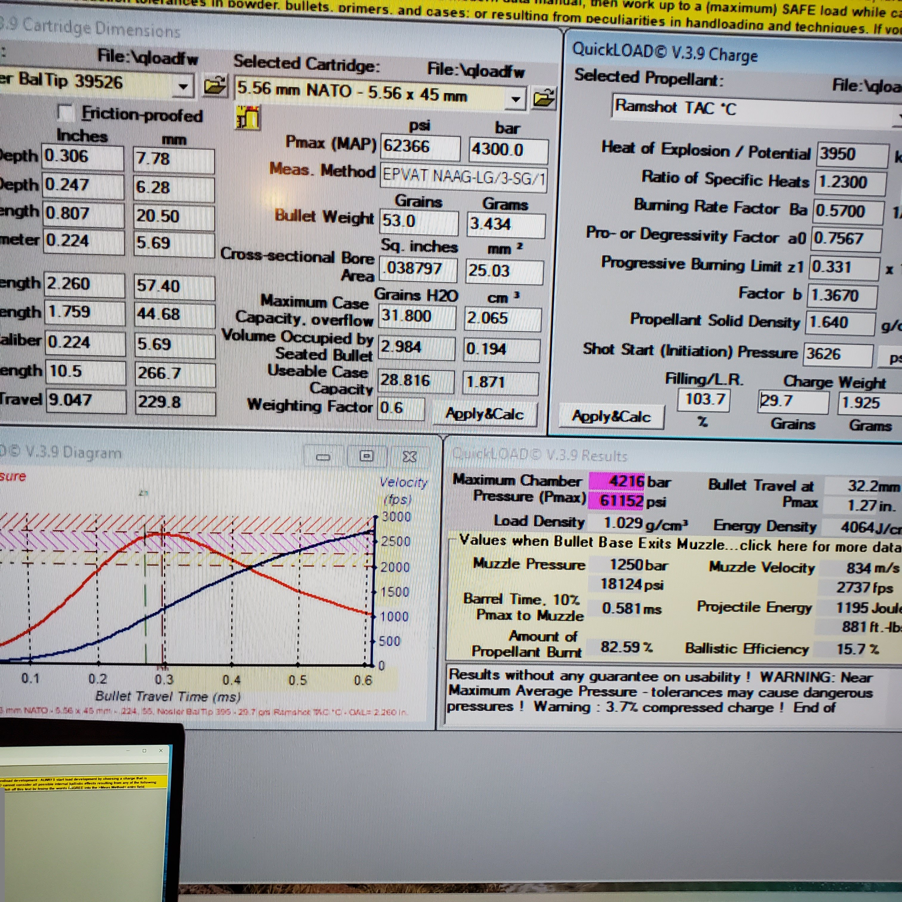

For science! Not giving powder charge. If your savvy with Gordon's you'll be able to figure it out.
Shell Tech NAS3 cases 31.8gr H2o virgin capacity - 33.14gr H20 fired weighed on FX120
53gr Vmax
COAL: 2.292
cci 450
A lot of TAC
3105fps SD 23.8
.750" @ 50y
Huey G2 Red dot with 3 x magnifier
Barrel is Craddock 8T 223W 10.5" Carbine Gas length with adj block.
Precision Armament Efab
I couldn't tell if it had much muzzle flash because I momentarily Blacked out from the concussion every shot.
That's an exaggeration, but It's obnoxiously loud.
Also shot some 60gr Vmax. but they didn't group as well. 1.128" at 50y still not terrible for a shorty. Both the 53 & 60's shot the tightest at the upper end of the ladder. 60 vmax were 3021fps & SD 26.8
The magnum primers didn't have any cratering, but good grief this speed is what I'd expect from 5 or 6 inches more barrel.
Per Gordon's this should be 59,868psi Also per Gordon's it shouldn't be going nearly this fast. That said Gordon's is very close with N540, N550, AA2520 in brass cases, but under estimates speed across the board for the NAS3 cases. From 10.5" - 26" doesn't matter.

Good grief what are these cases rated for?
You're running over 80,000 psi with 33.18 H20 capacity in a gun that can take 65,000 psi fairly regularly with short case life.
Probably about 34.5 grs of TAC, for a 10.5" barrel is my guess. But no one should run that in an AR 15.
Ya might get away with 32.3 with long seating of 2.292 and 2800 fps for the 53 gr.in fired cases, and this would be max magnum pressure, above the operating pressure of the 223.
Ya lose about 680 fps between 10.5 and 26" barrel...even more velocity loss as the pressure climbs to 80k and beyond.
Not all the powder is burned inside the case so barrel length definitely makes a difference in most any firearm.

You must pay attention to case volume.
Fired, new, different brands and different designs.
Here is an example
53 gr
Same load of Tac powder.
3 different cases.
10.5" Nato chamber 2.260"
Nato case 28.xx gr H2O
New Shell shock 31.8 gr H2O
Fired Shell shock 33.1 gr H2O
So beware ...a small change in case capacity and seating depth makes a huge difference in pressure and therefore velocity.
I load lots of hybrid cases rated at 80,000 psi but do not run them that high in bolt guns...and only run them under 65,000 psi in any AR, which is the limit for magnum cartridges in bolt guns.
So becareful here, changing bullet composition, seating depth, case capacity can lead to excessive pressure in a hurry.
If these Shell Shok cases can not be reloaded you must use the pre fired case capacity for your loads like 31.8 gr of H2O has been reported...but you must weigh the capacity of the cases, if you're going to increase powder charge above reloading manuals recommendations, with your extra capacity cases.

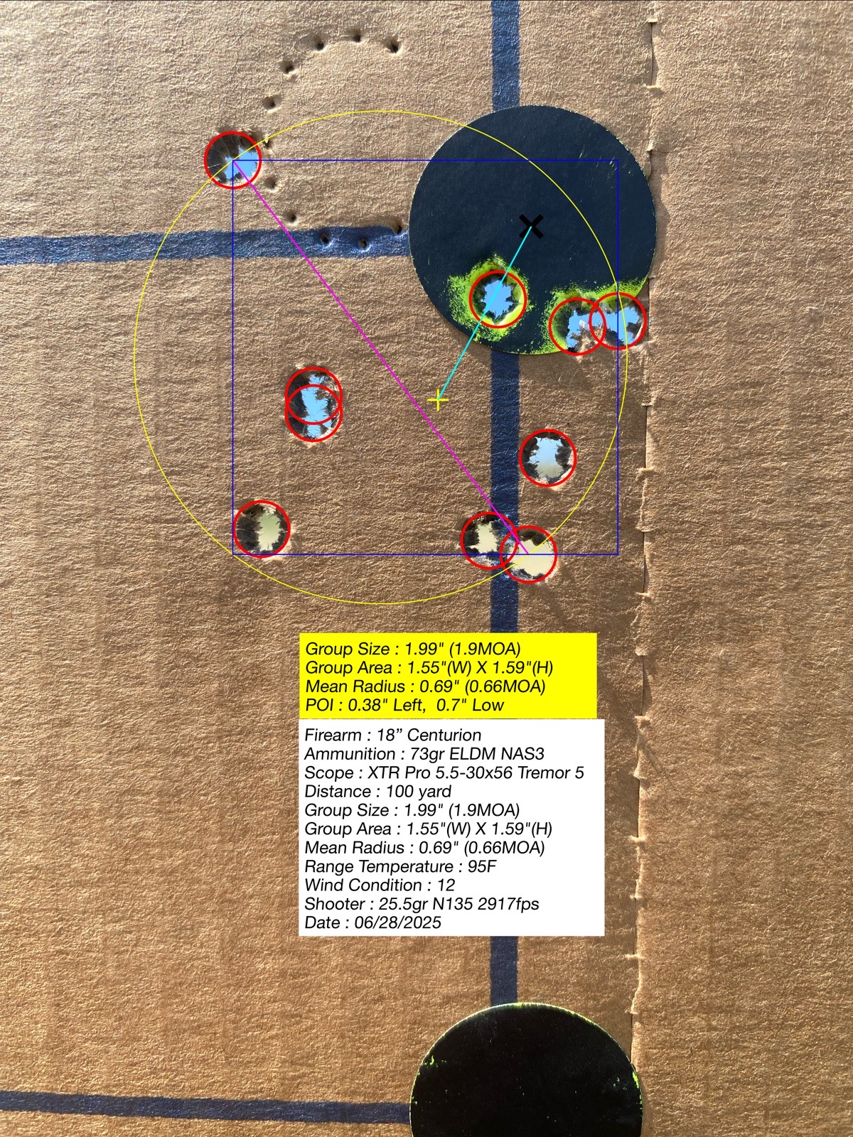

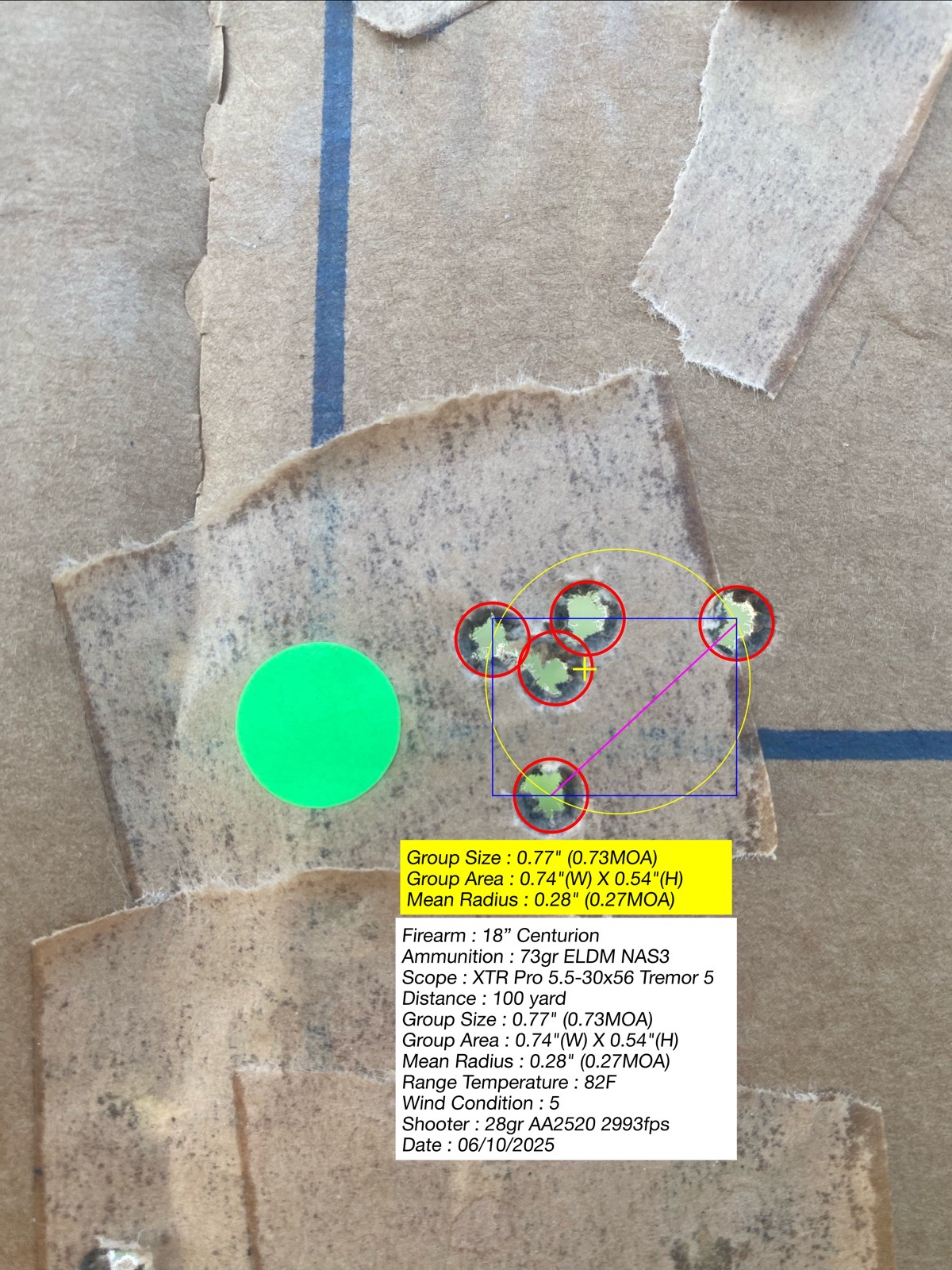

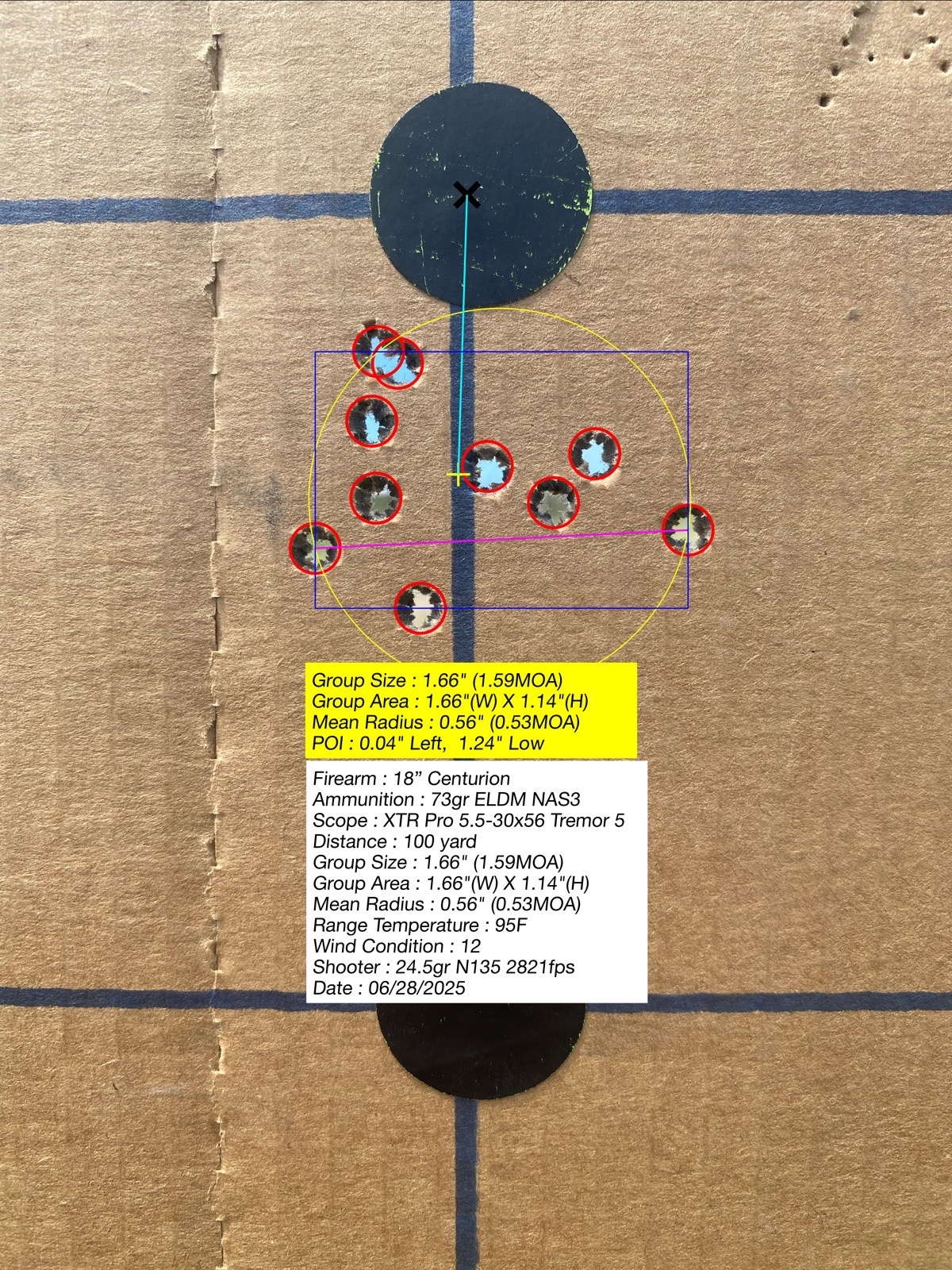

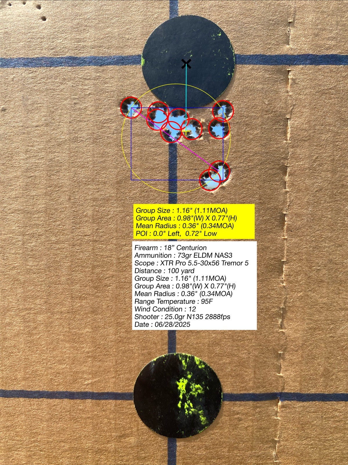

Some of my recent 73gr ELDM trys with NAS3. I'll try to post pics of the groups when I log in on my phone in a minute.
Projectile: 73gr ELDM
Primer: CCI 450
Powder: 28gr AA2520
Case: Shell Shock Tech NAS3
COAL: 2.245"
Barrel: 18" Centurion Mk12
Suppressor: Surefire SOCOM RC2
Optic: Burris XTR Pro 5.5-30x56 Tremor 5
Velocity: 2993fps
SD: 17.5
Accuracy: .73moa for 5 shots
Primer: CCI 450
Powder: 24.5gr N135
COAL: 2.245"
Velocity: 2821fps
SD: 17.2
Accuracy: 1.59moa for 10 shots
Primer: CCI 450
Powder: 25.0gr N135
COAL: 2.245"
Velocity: 2888fps
SD: 13.3
Accuracy: 1.11moa for 10 shots
Primer: CCI 450
Powder: 25.5gr N135
COAL: 2.245"
Velocity: 2917fps
SD: 17.3
Accuracy: 1.9moa for 10 shots
I'm going to revisit the 25.0gr N135 load and also try 26.0gr N135 next time.

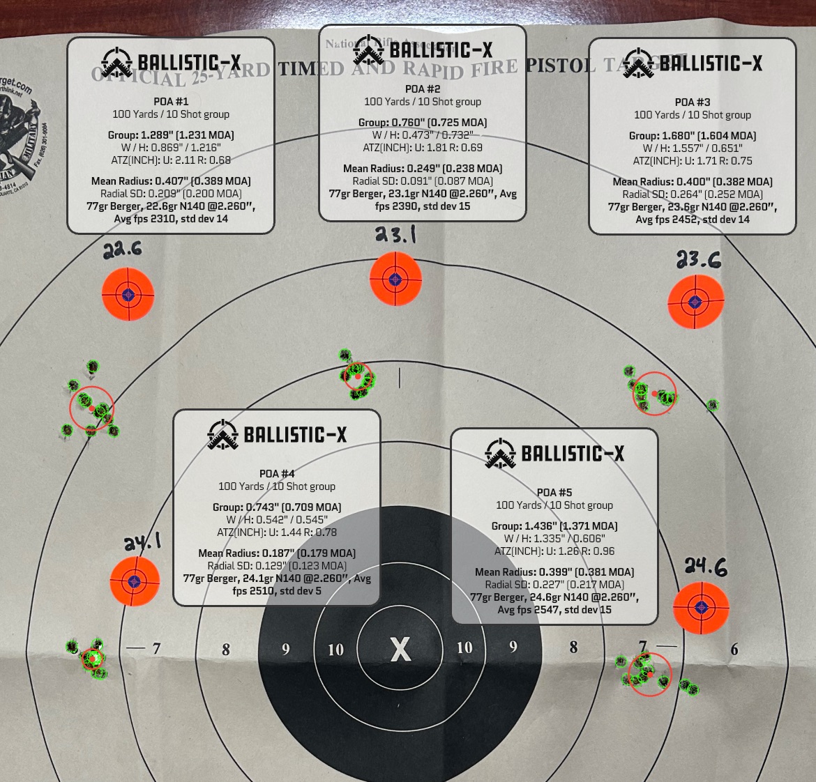

This is what I’ve settled on. 24.1 grains of N140 under 77 SMK in Lake City cases shot extremely well. I need to chrono it. I load up 77 grain SMK “seconds” with 23.8 grains of TAC in bulk cases for blasting ammo. Haven’t chrono’d those yet either. I will shortly.
After getting my short stroking issue sorted out I went to the range today to test some accuracy loads with 77gr Berger OTM’s with N140, LC 5.56 brass (mix yrs), and fed 205 primers @2.260”
Upper: 14.5” super duty mid length
Temp: 40 deg F
I need to further explore 23.1 to 24.1 but looking good!
That 24.1 load is exactly where I wound up and on a few guns. Mind if I ask what seating die you used? I used an SAC and Forster micrometer but got up to .007 bullet runout so I’m assuming they won’t perform at distance. Tried a couple different brands of brass too with the same result.
Reactions: WeR0206 and 232593
I use a forster standard full length sizing die with the neck honed to 0.242” (along with the included decap/expander ball attached) and a hornady custom grade seating die with micrometer adjuster. Not sure if you use them or not but It seems people have less runout when they use non bushing/standard FL dies.
Pretty sure the difference between the two is the least of your accuracy worries with ammo getting shucked from a magazine and violently jammed into the generous chamber by an AR gas operating system.
Reactions: slodsm
Going to put a wag up for consideration. I don't run 77's
Were the stems in your seating die made for a 77g bullets profile?
Just rocking the tip and not pushing on the ogive?
On my hornady seating die I swapped out the stock one for the 75/80gr ELD-M stem and I pretty much use it for all my ar loads but I almost exclusively load heavies (70+ grains)

First time do proper brass prep and FL resize from there on ,NO need for neck sizing . Just be sure YOUR ex-pander measures what YOU choose it too ,NOT what's Std. and do as I have in getting it BAM coated . Twice as slick as PTFE near Diamond hardness is a Winning combination for Ex-Pander balls .
Reactions: 232593
Where do you get the coating done ?
Reactions: Wormydog1724
The stem in the Forster seating die sure worked for lots of other rounds loaded. I tried both stems in the SAC die and had the same result with both.
Generally where PVD services are conducted ( provided they are equipped to use BAM ) . Not being purposely evasive West Coast ,East Coast ,TX. ? Where it's convenient and relatively close to the customer .
Mine were done in the original formulation Lab and they're NO longer fooling with MY experiments . They promote using other Companies who are commercially viable for trade .
Fyi : You can always get a DLC , TiN, TiCN, or AlTiN compounds IF BAM isn't available or simply Ask them Who does it ,if they don't .
Multiple small parts for external coating is doable ,inside small cylinder unfortunately ISN'T doable at this point in time ; To the best of MY knowledge anyway .

A little more Tac love.
I’ve been shooting a TON of 5.56 lately, put together a nice WOA 20” AR with a TT diamond and some other goodies because it’s just less abuse to my 6CM or 6 Dasher.
I decided to just wing it with some Hornady 75g BTHP match, they cost me 21 bucks per 100 on mondays from BPS/Cabelas so why not right?
1x fired starline brass.
Annealed
23.7gr of Tac
CCI 400’s
2.250 (I never bother with CBTO measurements on AR’s, mag length is the limiter so I just load to that)
No crimp, .003 neck tension
SD 6.x, ES 14.x is about normal.
2865fps using Garmin.
Shoots .7/.8 at 100. I have a 5” gong sitting at 350 which is absolutely boring to shoot. Gonna take it up to Gravestone this weekend and shoot the Gas Gun Show. Never shot a match with a non bolt gun so it’ll be interesting lol, should come in somewhere in the bottom 3, maybe bottom 4 if I’m lucky 🤣🤣
This was a 300yard group yesterday, wind was meh, just enough to make a spectacular ground a decent group but this is the best shooting AR I’ve had I’m pretty sure so not complaining.
