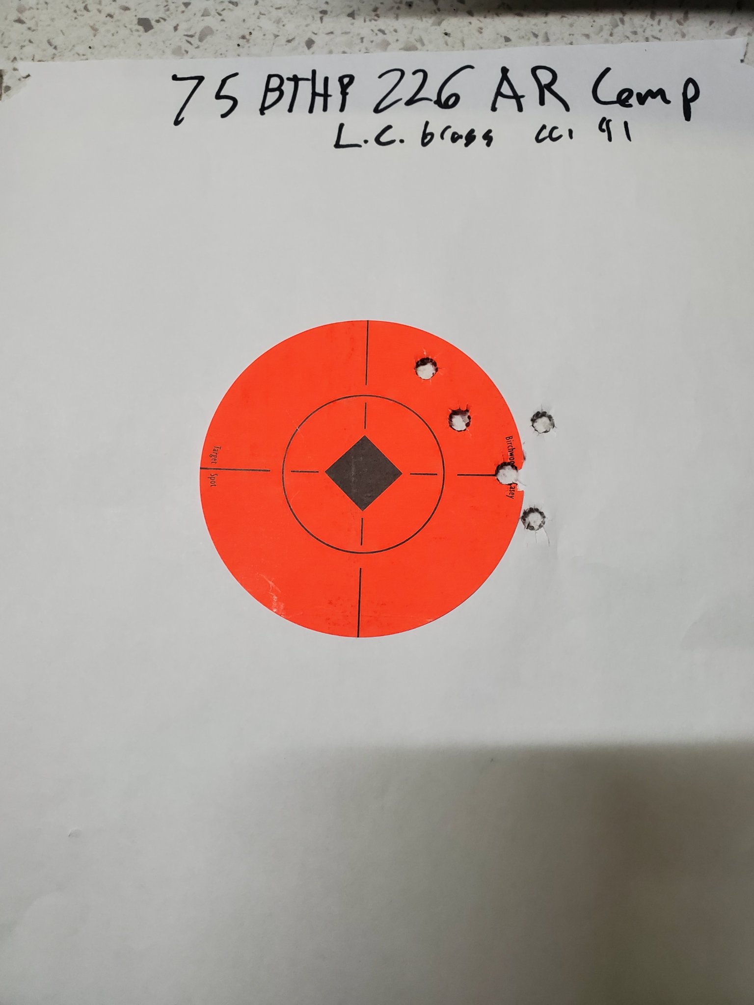

With 77gr? I couldn't get 24.5gr in LC cases and 77's without severe powder compression. That might be your issue.
I actually just loaded a ladder of 69’s in LC brass to test tomorrow with Tac, 24-25 grains at .02 increments- no compression. Sierra manual has max below that bit out of a 20” barrel - I’m guessing 24.6-25 will find the sweet spot out of a 16” - hopefully at least

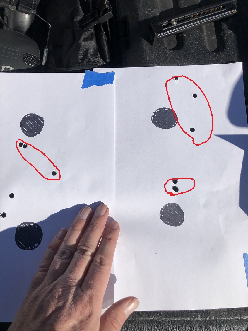

Not really sure what to make of this, 23.5 was 2 touching and one an inch and a half away, 24 they are all touching, 24.5 crazy vertical stringing. All fired from a sled. All TAC and 69gr bullets. Finicky barrel I guess.
My white oak barrel is the same way. Anything over 24.2 with 73-77gr it looks like a shotgun blast even though the brass isn’t smearing with LC. Luckily 24.0 is when I get 2700-2720 with 16 inch barrel. With the 73gr 24.2 gets me 2750. I’m using CCI 450’s with tac in LC brass and a 2.250 seating depth

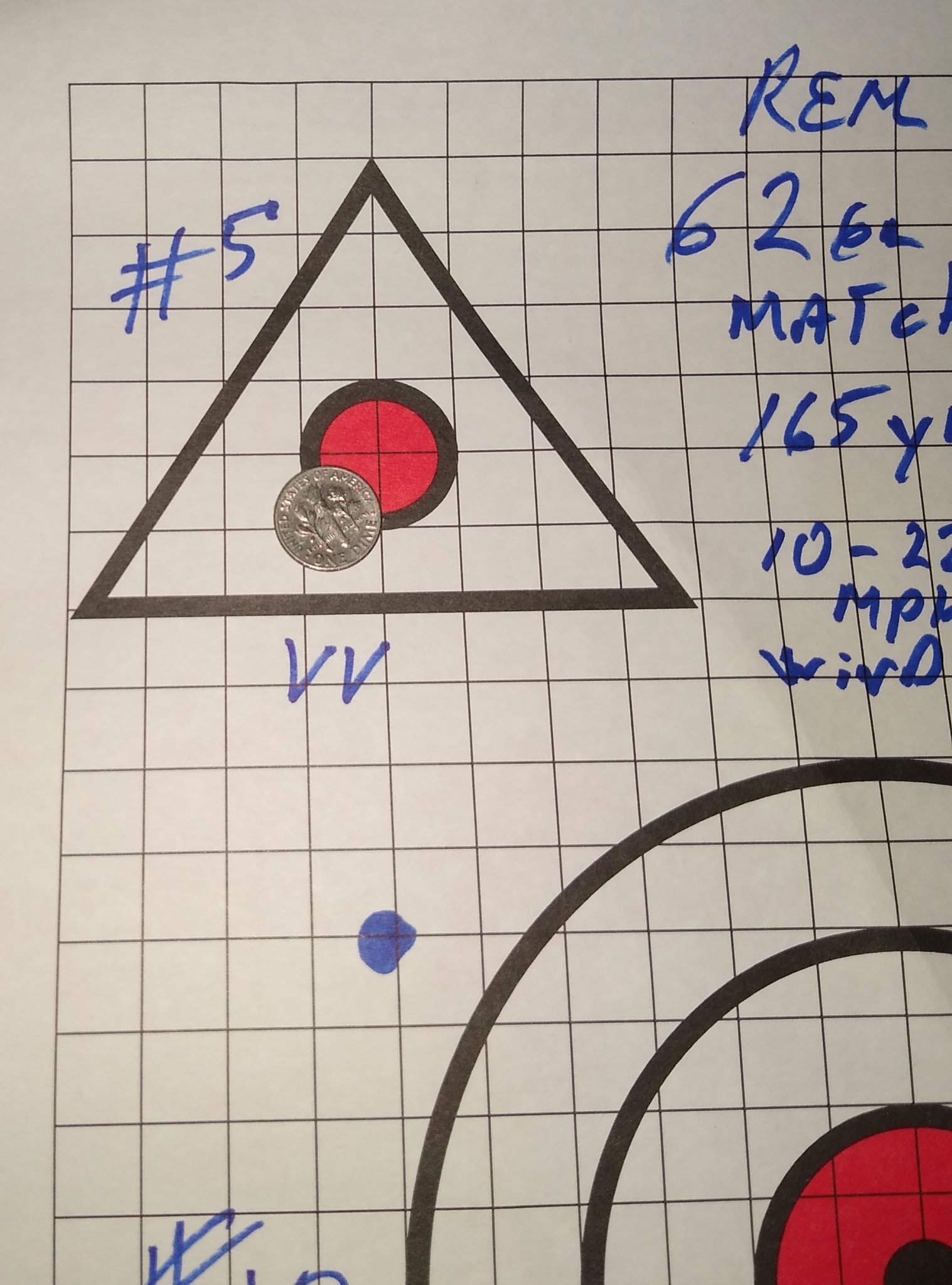

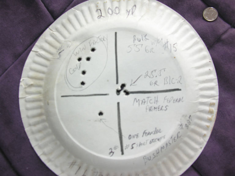

The 6.5CM target shows differences of powder choices a little better . I generally shoot off a Bag or sand bags and use a dime to cover a group of shots . IF the dime covers #5 or more I'm happy .
Paper plate was done 29 years ago off the ground at a Sheriff's Dept. exhibition shoot ,where I demonstrated the proficiency of handloading out of a bone stock XM15 A2 20" Bushmaster . Winchester bulk 55 gr. bullets 25.5 BlC-2 powder . Vertical string Winchester white box crap . Got #15 under the dime at 200 Yd. using a Nikon Monarch 3 ,3X12X42 scope . Still have that setup and is one of the most accurate 5.56X45mm units I've ever owned . Go figure chrome lined bore no less ;)

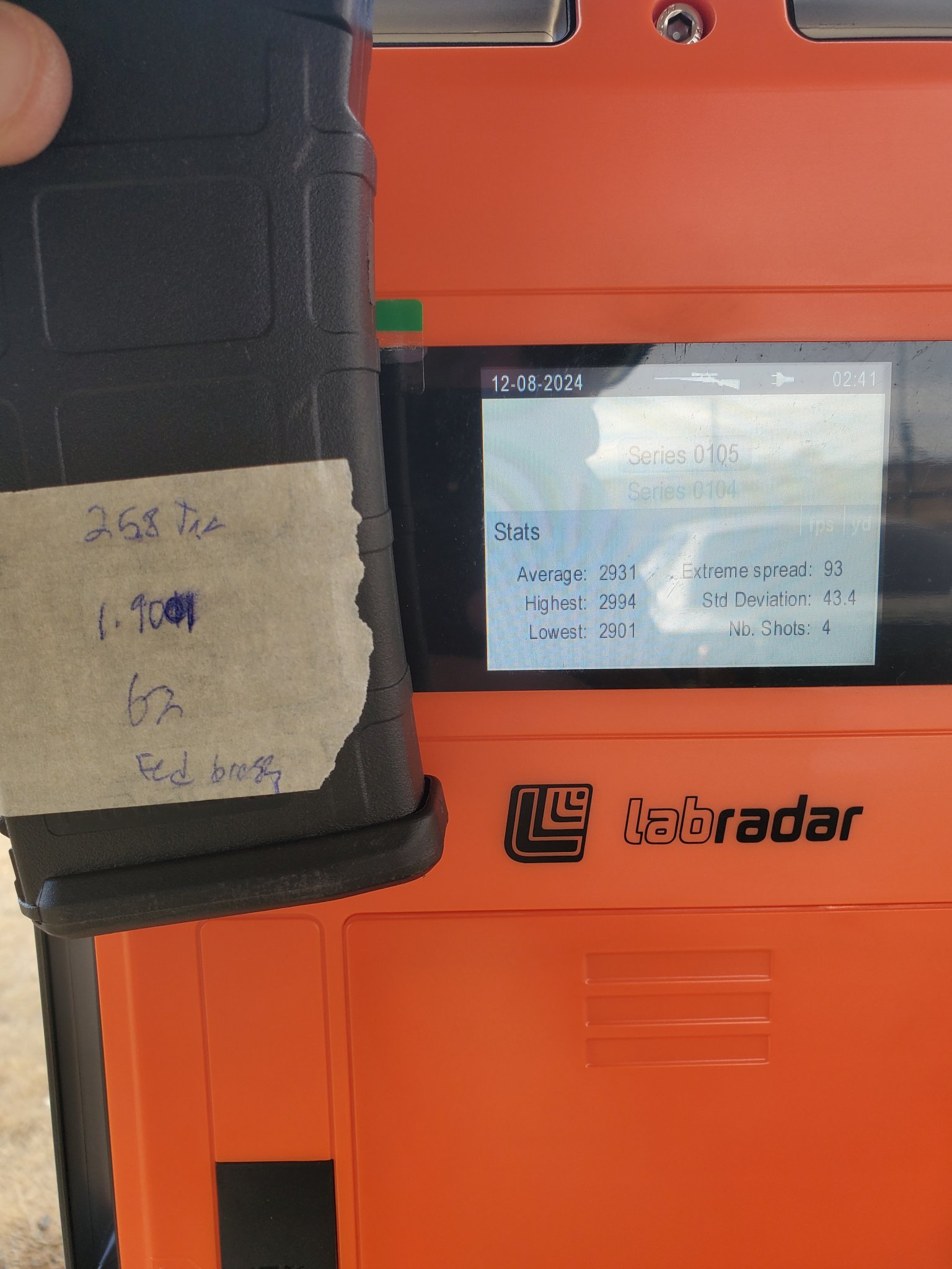

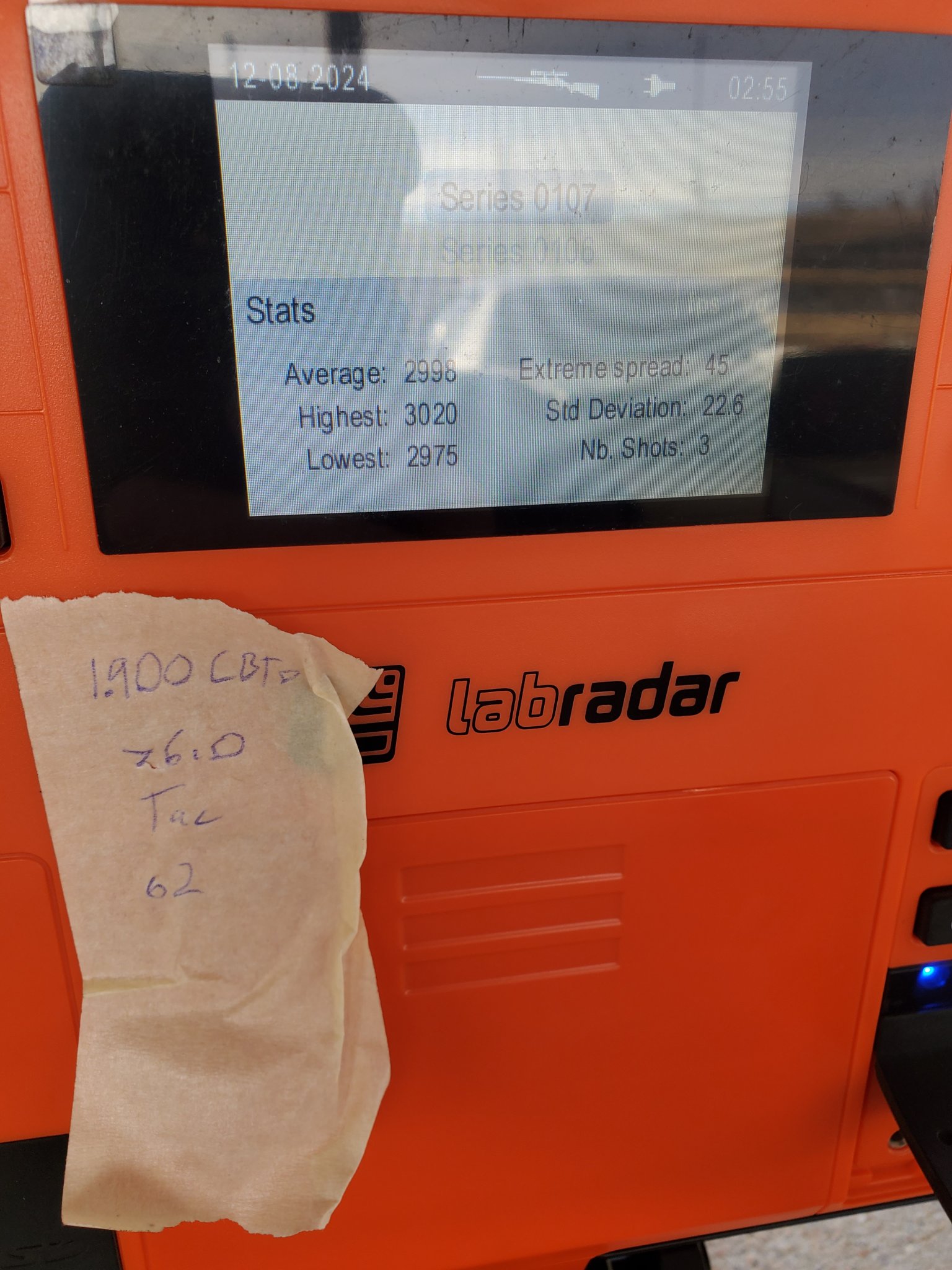

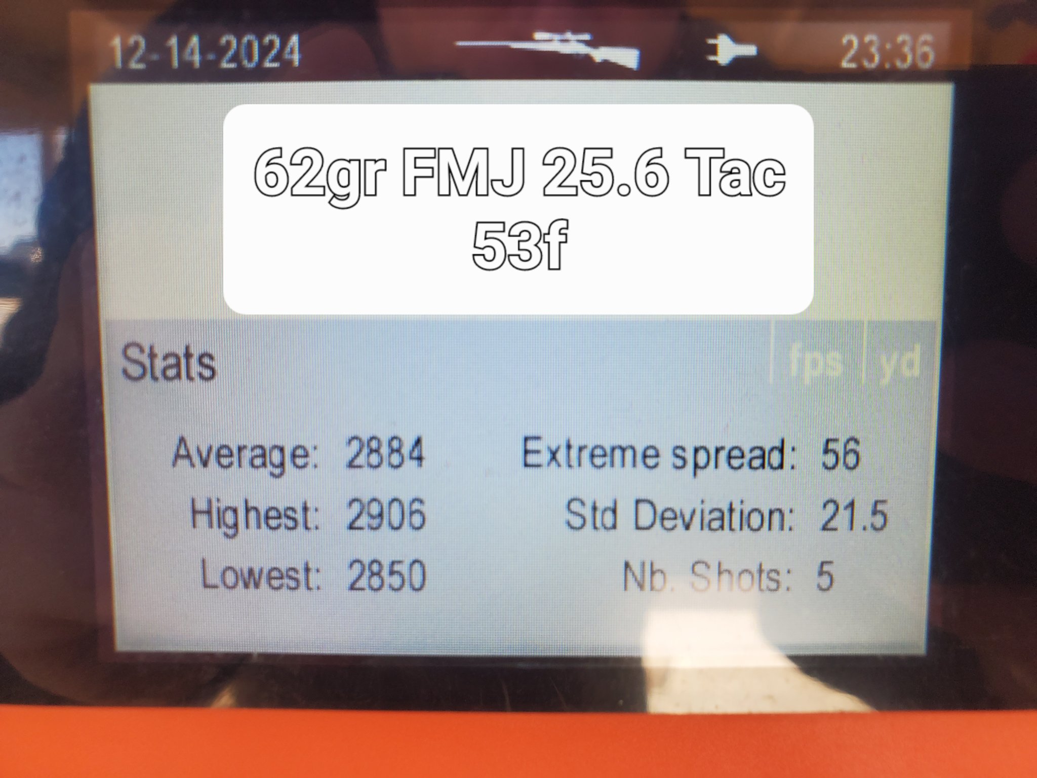

Try 24.5gr TAC with the lighter bullets 55-62 someone suggested it to me and it shot well out of all my rifles with 55vmax and 62gr cannelure bullets (COAL = wherever cannelure was)
I believe I have. Pretty much all charges shot almost exactly the same. I want to try something more than a 4x optic with a 2 moa dot. They all shoot right around 2 moa at 100y.

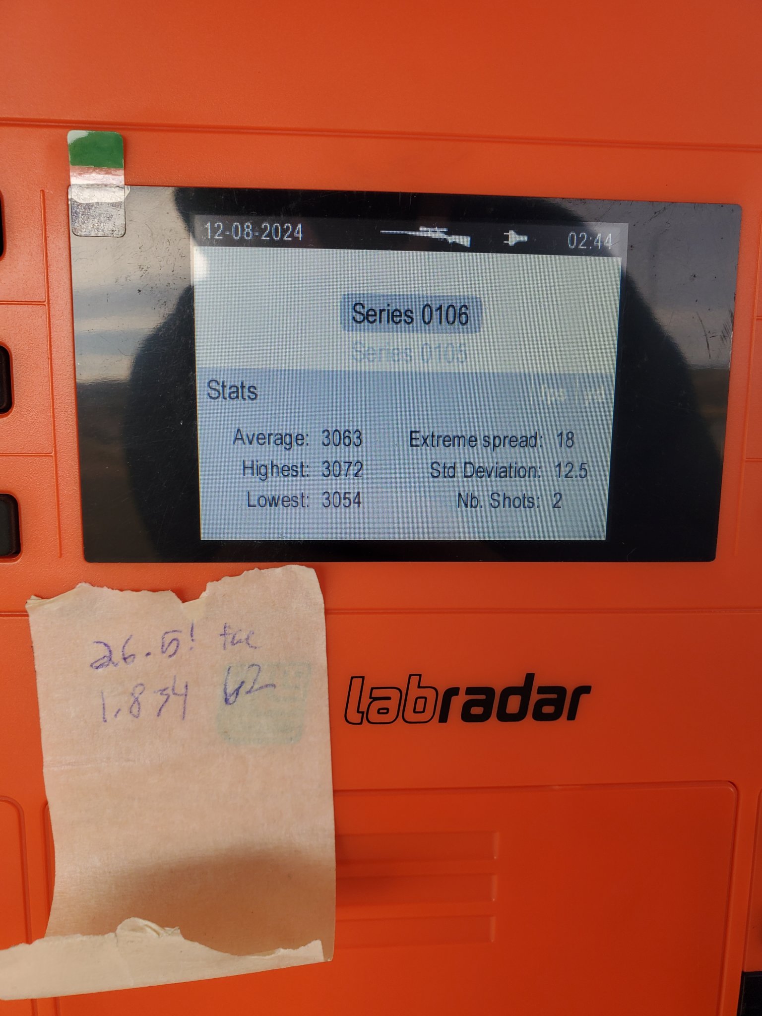

Lorenzo, those velocities are fast for a 16" barrel. Nay have to give TAC a try with Hornady 62g El VTs.
Brass looked good, primers were just barely starting to flatten at the top end. Based on the feel of the primer pockets of the Fed brass I am using, I could see 3-4 firings on it at least.

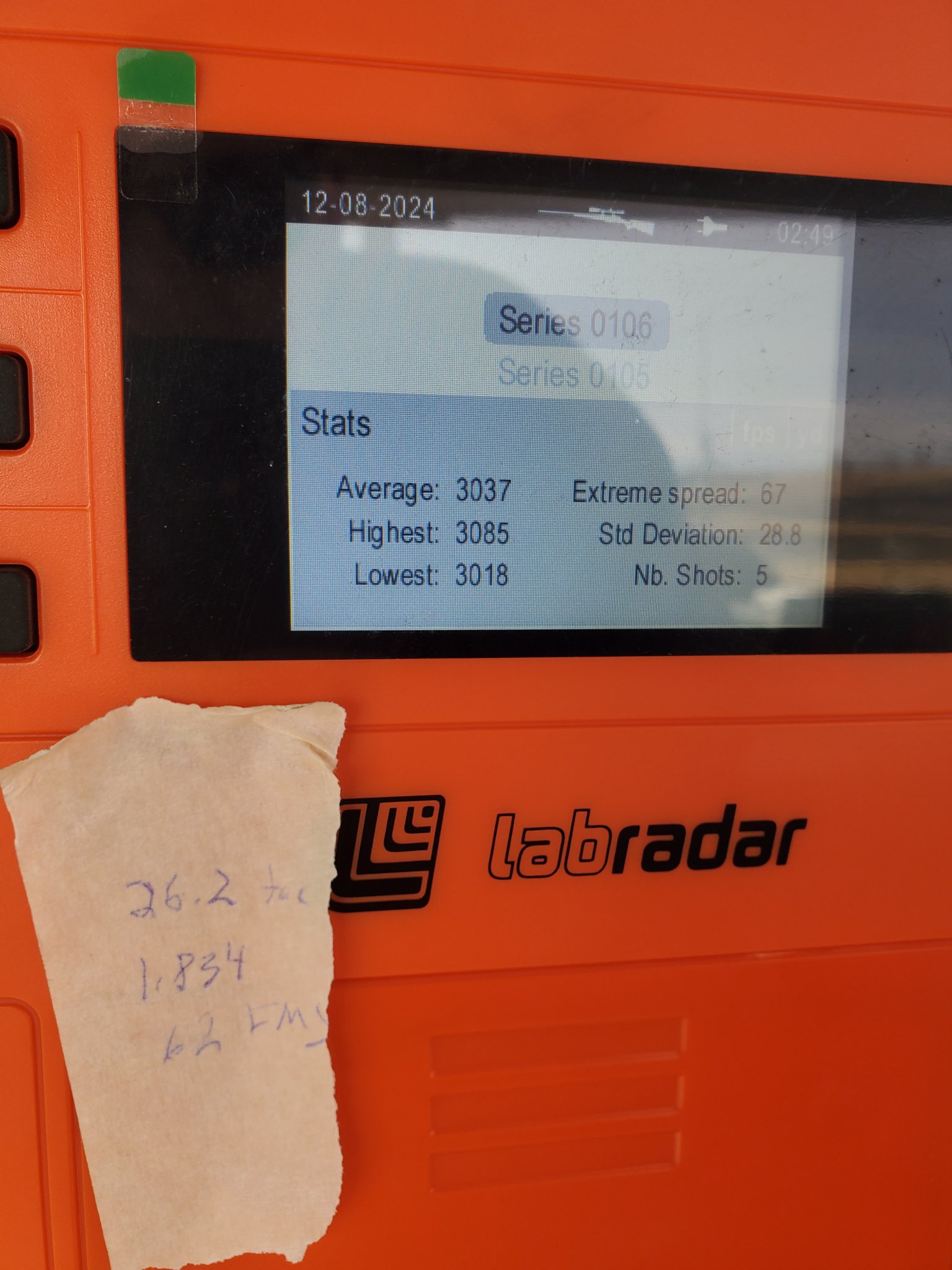

Another trip out with the 16" ballistic advantage stainless SPR barrel, 1/8 midlength gas.
Gusty L-R 8 - 15 mph
4x optic with 2 moa center dot
101y 53 degrees F
Orange dots are 3"
Gonna play with seating depth on the 62 fmj on a calmer day, seems to shoot about the same no matter the powder charge. Could be the 4x optic with 2 moa dot too. Not the best for precision.
101y 53 degrees F
Orange dots are 3"

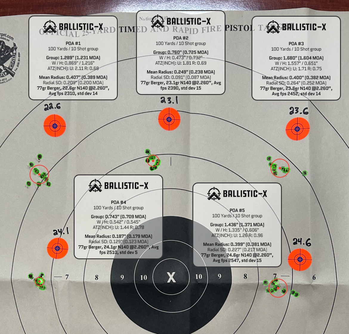

After getting my short stroking issue sorted out I went to the range today to test some accuracy loads with 77gr Berger OTM’s with N140, LC 5.56 brass (mix yrs), and fed 205 primers @2.260”
Upper: 14.5” super duty mid length
Temp: 40 deg F
I need to further explore 23.1 to 24.1 but looking good!

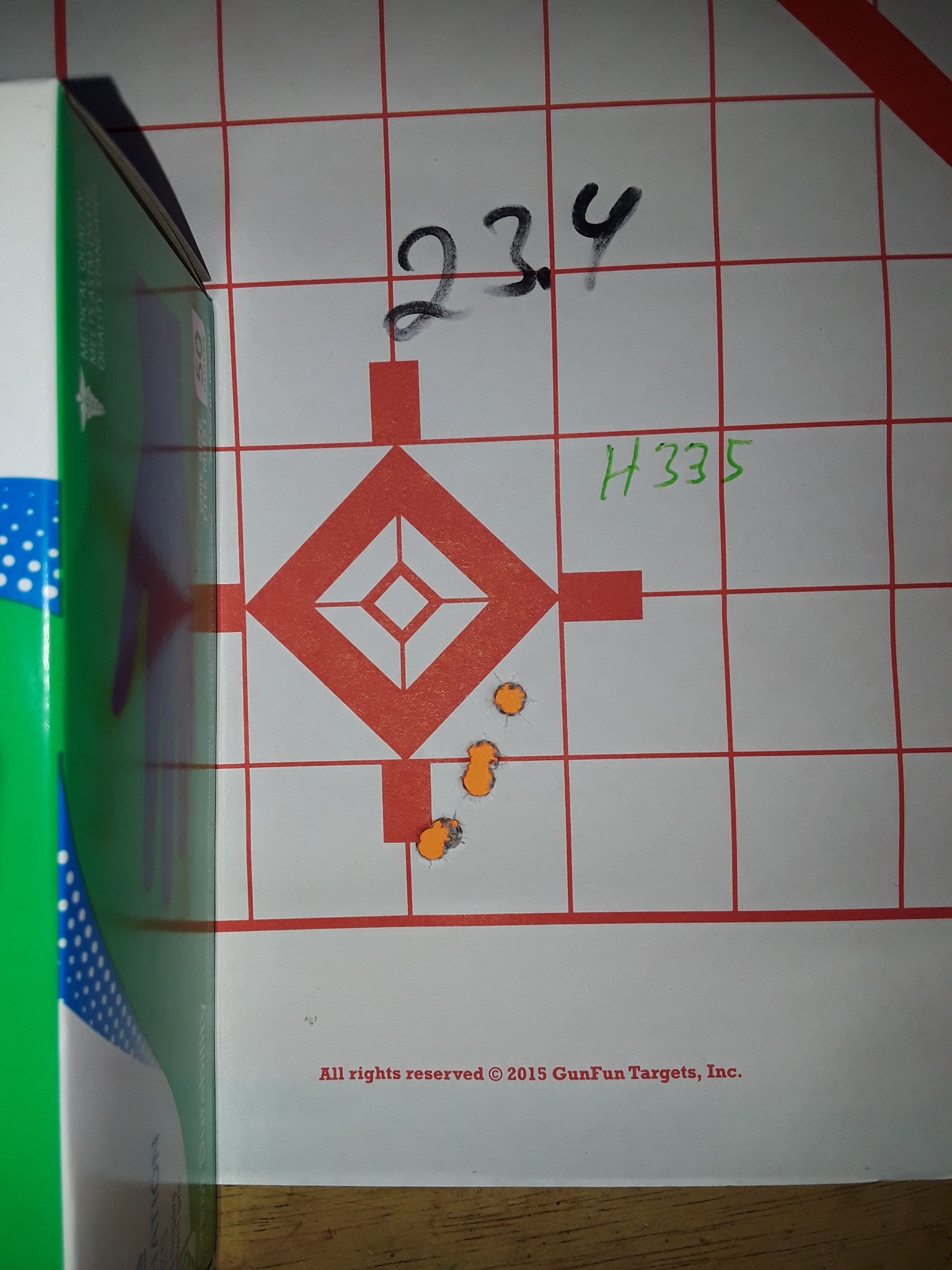

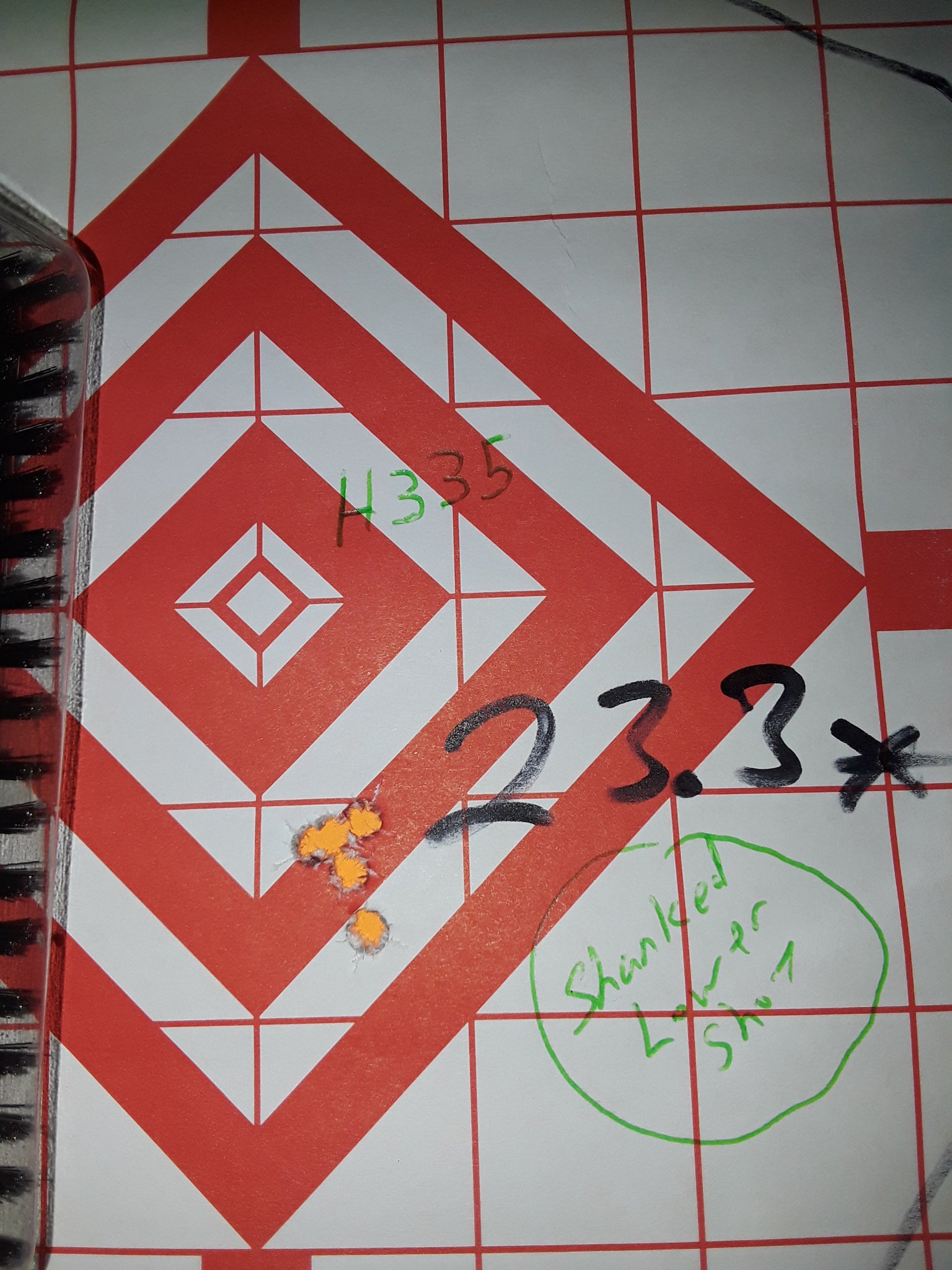

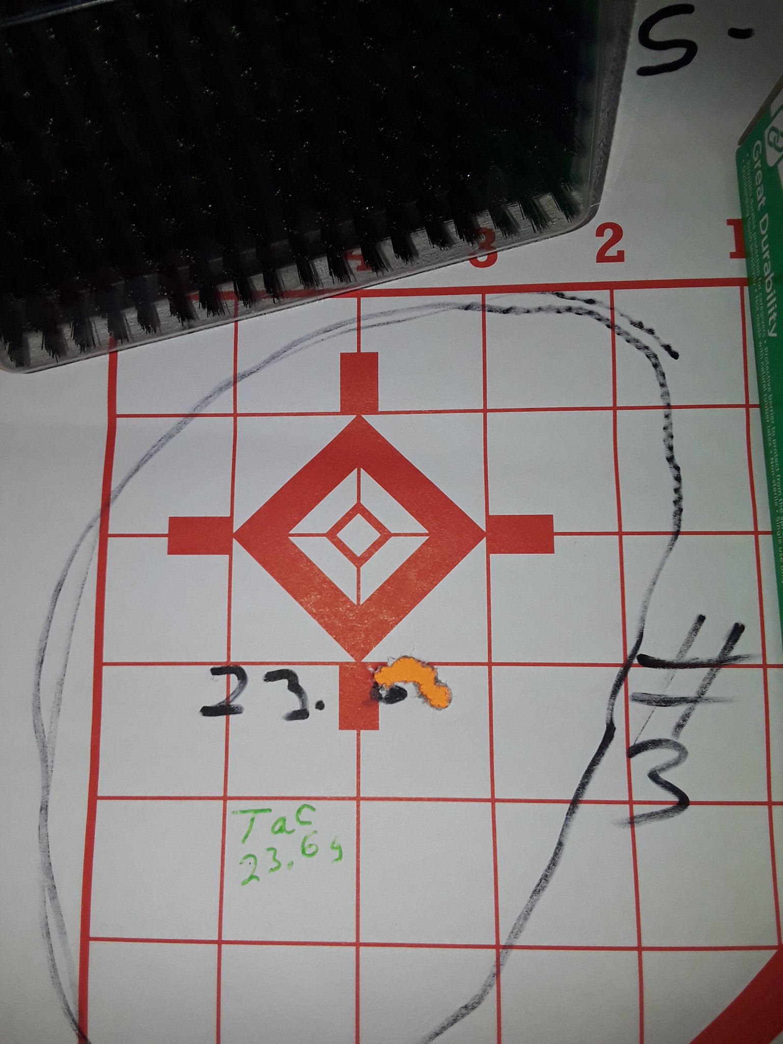

So I finally got to try out my "final" ladder tests on the 69g Sierra bullets.
50 yard test due to conditions and range needing moved due to floods messing it up. I do most preliminary testing at 50 to save driving time untill I get things worked out. Our family range is an hour and ten minutes at 75 mph, the short range is 10 minutes at 30 mph.
20 inch upper sorted range brass.
Shanked that low one but not by much on the 23.3 load of tac.
Left the 23.4 load on there to show the vertical stringing with 0.1g more powder.
A little horizontal stringing on the 23.6g tac but they touch so I think it will " tune " out ok.
Adjust your OAL ,using same load of TAC and see where that gets You (y)
Yes, this is the second attempt with the 69g projectiles in general.
First time I was in the lands.
Data from a couple reliable sources got me there.
Found my lands and started over.
I may be still a little closer than I prefer but I had read that the 69's like a small jump. At about 0.006 but that gives only one direction to go. Lol
If I'm lucky I can get those groups a little rounder but at least I won't be wasting gas and travel on something like my last attempts.
That 50 yard range saves me so much money.

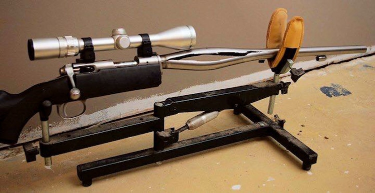

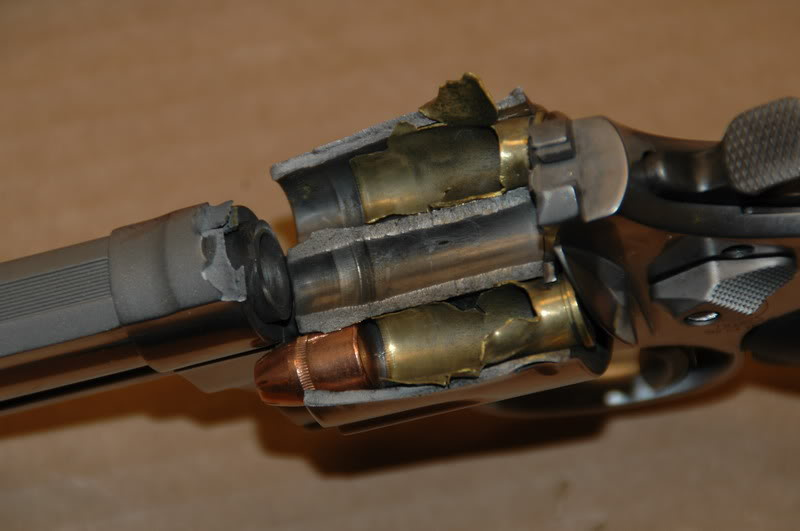

I've witnessed up close and personal aside from VN ,two deaths relating to firearms reloading errors and it's never pretty !. Especially when a fellow shooter dies from the operators faulty load . It's not always the shooter in the real world ,which pays the ultimate price .
These photos are Not directed at anyone of you ,it's simply a reminder we all need to be really careful reloading .
This pistol I do know what actually happened and it wasn't an overload but rather an underload of wrong powder .
Also known as a flash over detonation and exploded ripping the cylinder top half off ,as well as exposing powder within ripped cases which burned . The far right case's bullet was on the shooting bench ,the case's bullet closest ,obviously never ignited
I personally have NO idea as to what went wrong with this rifle but serves as a reminder too us all be real careful .

My mistake was not questioning / verifying manufacturers data. A couple of the major players we all use.
I was using a 68g bullet and it could be loaded to 2.25 in my "standard" wylde chambers.
Didn't like them and changed to the 69g and the loads showed mag length coal on the bullet site and powder # 1 site.
I figured them to be gtg with that data. Nope the distance for the ogive in relation to the tip of the bullet moved forward 0.040 thousands. Not far enough in to notice while slingshoting a carrier into battery.
I only load 5 shots per 0.3g increments and as a general rule don't have to stop and unload on days I shoot at a membership range during " grampa hours" no stupid around at those times mostly.

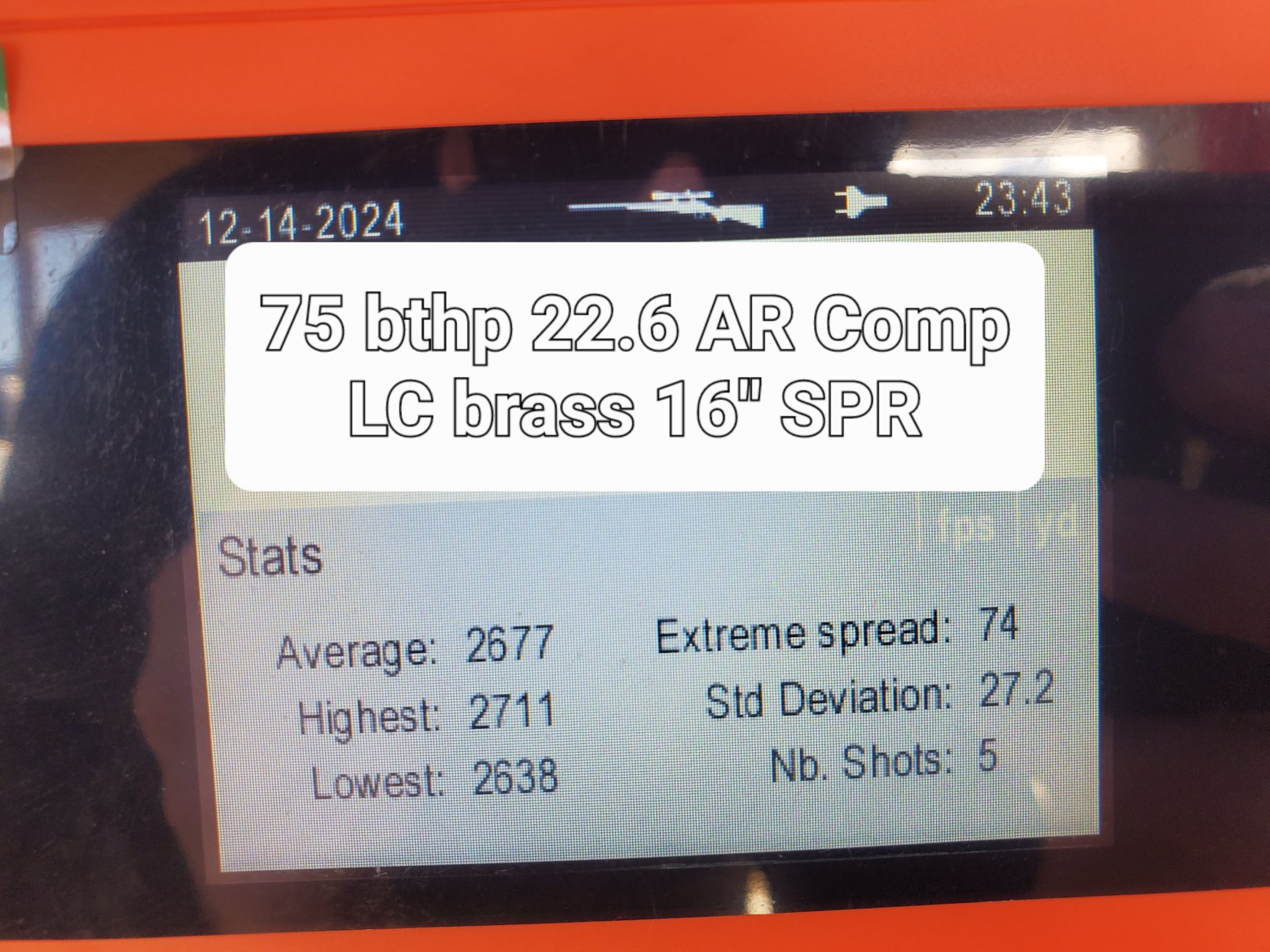

I finished load development with.223/5.56 77 SMK and AR-Comp a week ago on my 14.5" AR-15 with an Aimpoint red dot sight. I strongly advise using a chronograph to compare to a known load, such as MK 262 Mod 1, as you progress up the ladder. I backed down around 0.6 grain and got the following results from 20 shots at 100 yards. If I can attain this accuracy at 100 yards with a 14.5" barrel and red dot, I believe I'm ready for anything I plan to use the SBR for in the future. The next stage will be to shoot these through another of my ARs, a 14.5 SBR with a 1-6x variable scope, to do a more critical accuracy assessment.
