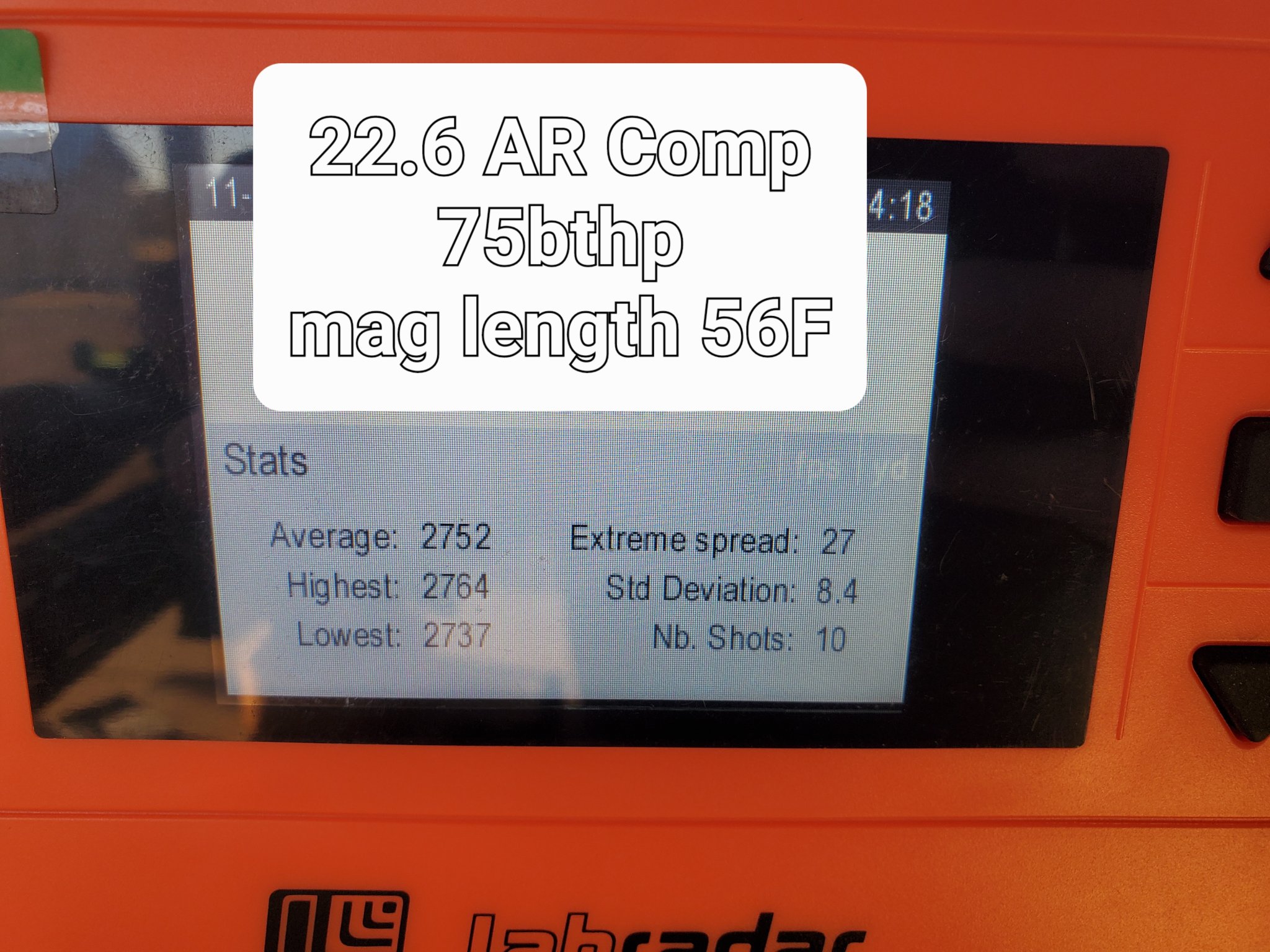

I can second chasing my tail with a WOA barrel. I have probably a few hundred on it now and finally found a load that shot with 75gr bthp and AR Comp. 77s shot pretty well too but not just any load, I had to do some load dev for sure. I would say stop removing the copper for a bit if you are when cleaning.

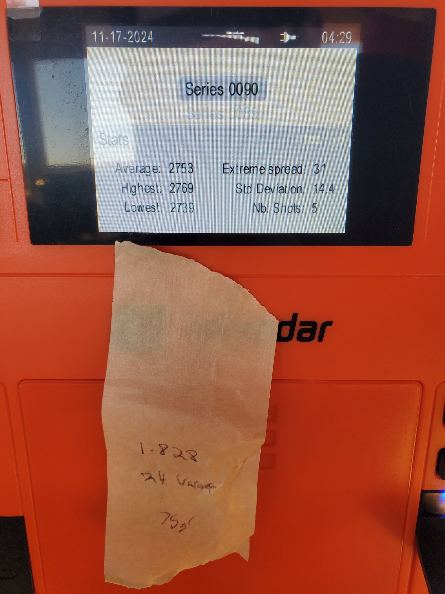

Tested out some Varget/Hornady 75gr bthps with the 18" White Oak. 24grs, varying seating depths. Apparently seating depth matters with my barrel. Was getting some crunch with 24.0grs which was a little odd but maybe I need to shake the case a bit when throwing powder. Shoots nice though and being single base the barrel stays significantly cooler vs. AR Comp I notice. 24grs of Varget gets me about the same velocity at 22.7gr of AR Comp. AR Comp measures better, less bridging. Trade offs
