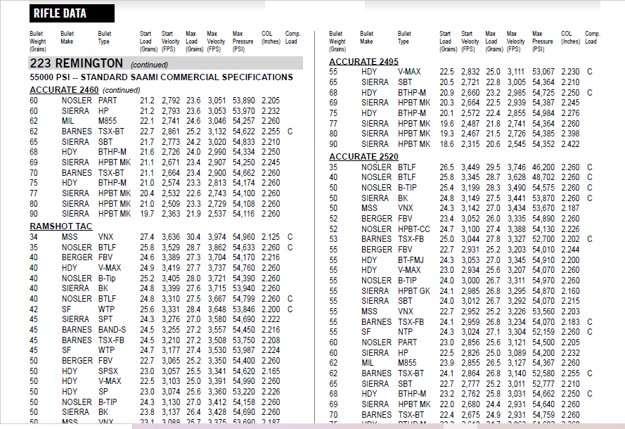

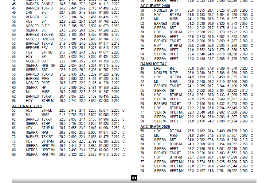

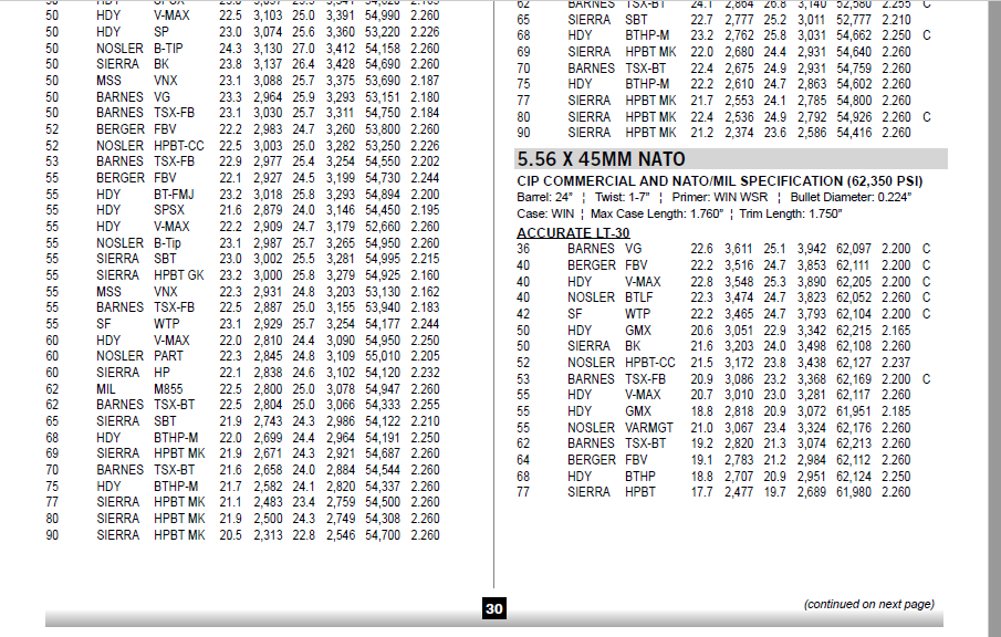

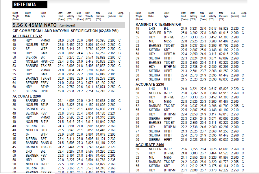

It seams the TAC users are crowding the 24.8 gn. MAX of 62,000 psi according to the Western Powder Co. data
Sounds like a cool gun. Ive never loaded any AA powder but have been eyeing it since its been available here and there. Best thing to do is grab some Sierra Matchkings and try it. Ive just started experimenting with TAC myself. Good velocity so far. Any idea if your chamber is 223, 556 or 223 wylde? What twist?
...from the Western Load Guide, circa 2014..

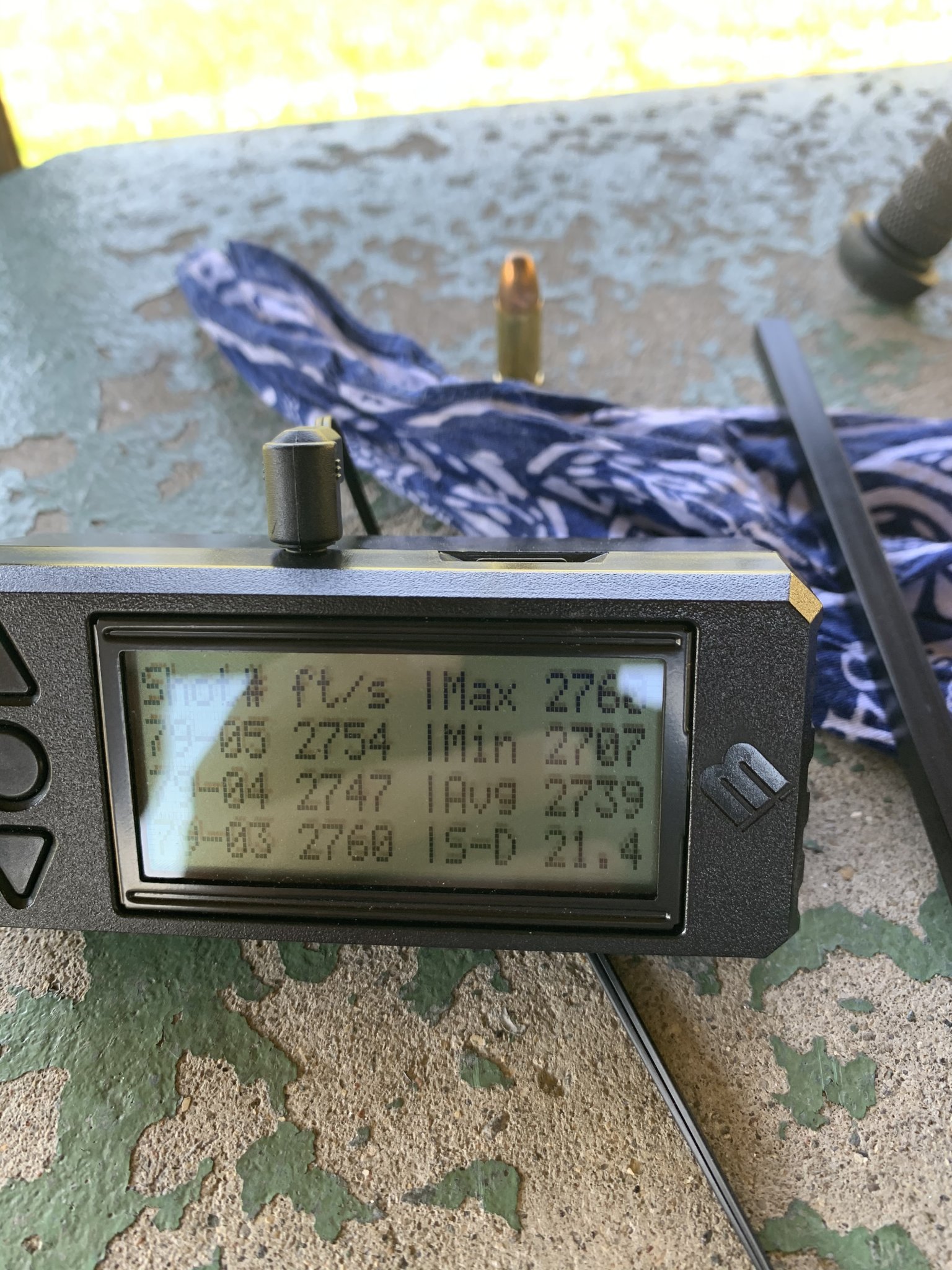

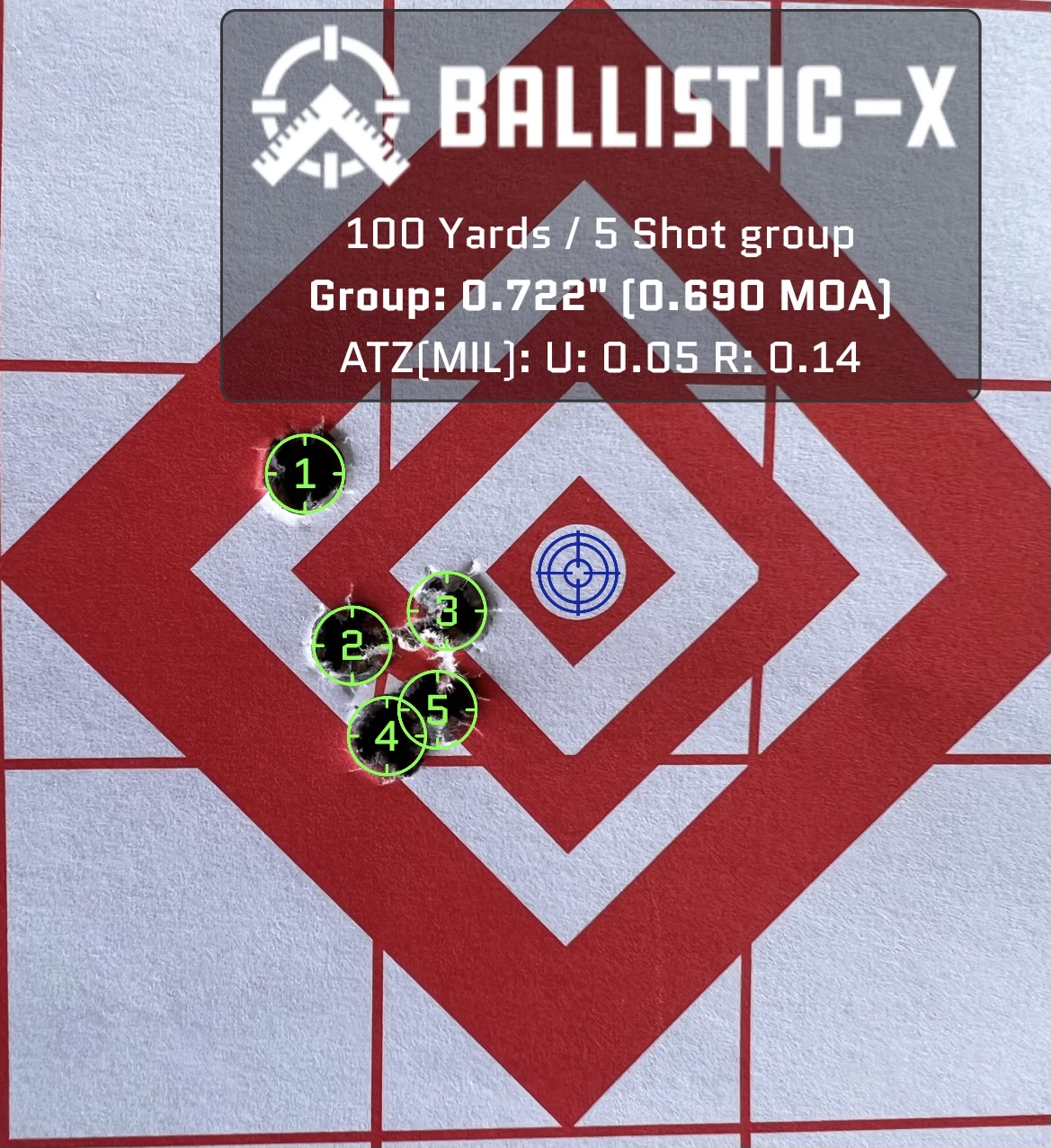

This is a load post with some follow up questions as I’ve never really loaded for an semi auto gun:
Brass: Lapua 223 Match
Powder: 8208 XBR @ 23.3 gr.
Bullet: Berger 77 OTM
Primer: CCI BR4
Vel. - 2,666
SD - 10.2
First test group came in at .690 MOA, and subsequently produced 3 sub 1/2 MOA 5 shot groups. I’ll try and include a few pics.
Barrel is a 15.1” 1:7 mid-gas Douglas spun up by Frank at Compass Lake with their CLE chamber. Colt BCG.

77gr bthp noslers
24.2 varget
2671 FPS out of a 14.5” barrel
Seems hot to me but maybe ok?

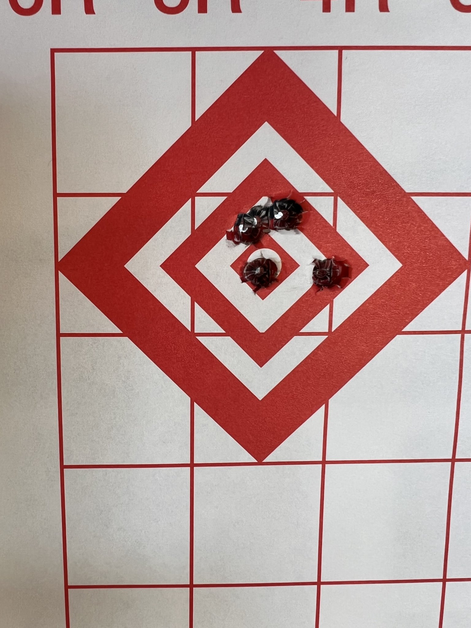

Here's some recent load development in my WOA Bartlein 20" 1-7 AR with American Reloading powder (N133) and their 52SMK....
14.3 cents per bullet if you buy 30,000..... 15.1cents if you buy 1000
You want extremely accurate bullets at the price of bulk plinking trash?? Isnt a better deal out there than American Reloading's 55 SMK's @ 13.2cents per bullet per 500....And they shoot lights out too. Im loading them with bulk military powder from American reloading as well.... They have 8lb jugs of powder, free shipping and free hazmat, same goes for primers... Hard to beat for plinking ammo that is very accurate. Want to step it up, they have 69 SMK for 13.9 cents per bullet per 500... Ive been shooting these for years from them, some are mixed lots, some are pulls, but the target cant tell for me.
