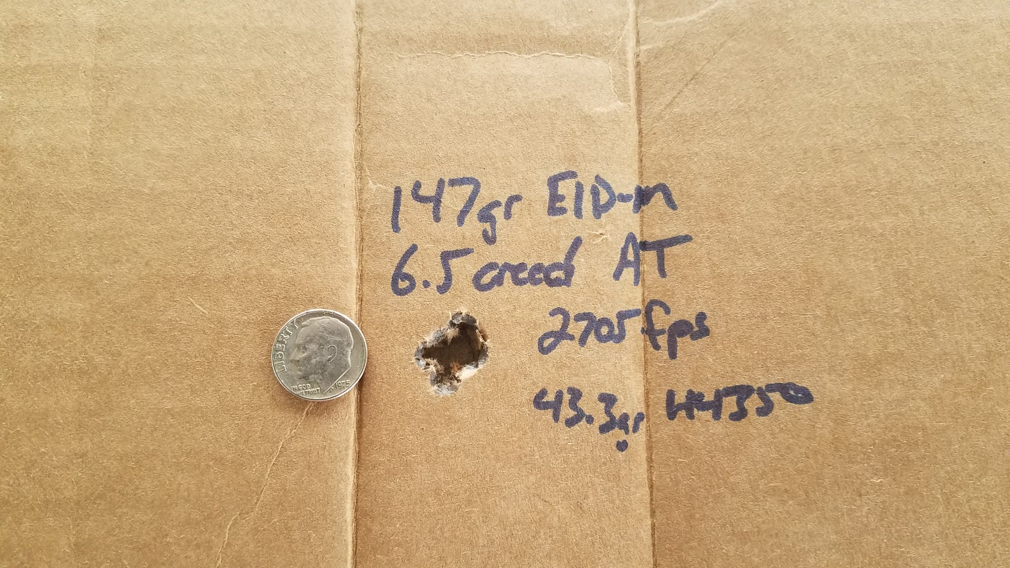

Im playing with the rl16 instead of rl26, the bigger bulelts seem to like it more and im getting the same speed. 42.8 gr is giving me 2752 with .010 off the lands
42.8 of R16 and Federal 210m primers and either Prine or Hornady brass works in 3 different rifles with 24" barrels: Sierra 130 TMK, Berger 130 Hybrid, Norma 130 Golden Target. Lapua SRP brass is 42gr. If using H4350, add 0.2gr.
2850-2925 depending on the rifle.

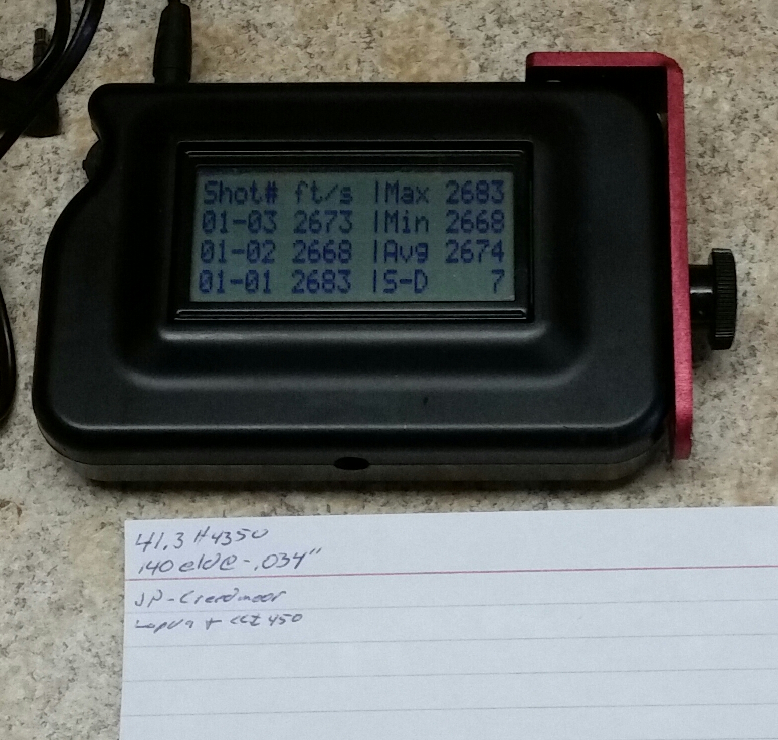

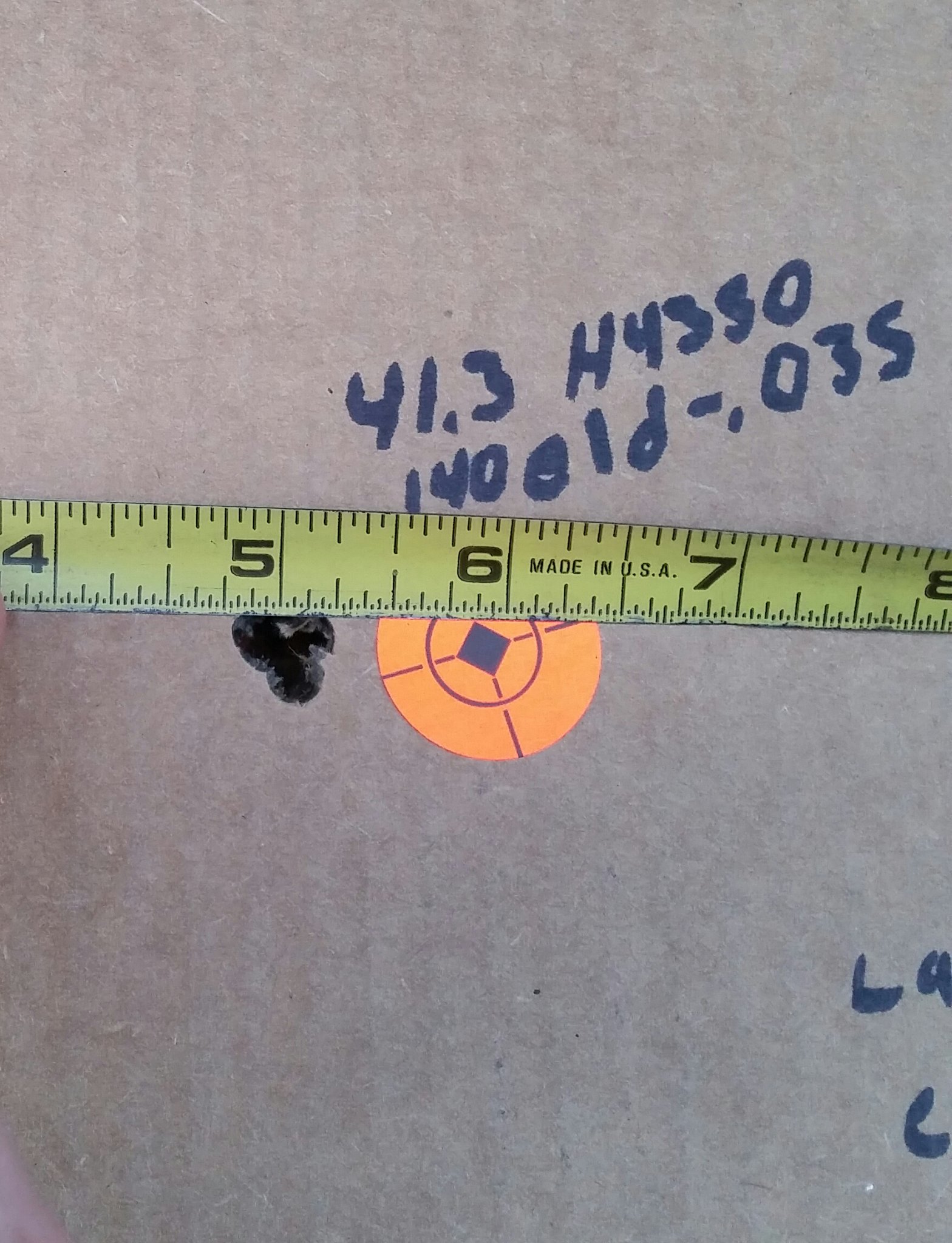

41.3 H4350 in Lapua brass and cci 450's propelling a 140 ELD seated .035" off the lands of my JP Enterprise barreled mega maten build... 5 @ 100, best group yet for this rifle.
Yep, both of my JP 6.5's have a node around 41.5 gr 4350 with Hornady brass and the 140's. They fly eerily close to the factory 140 load.

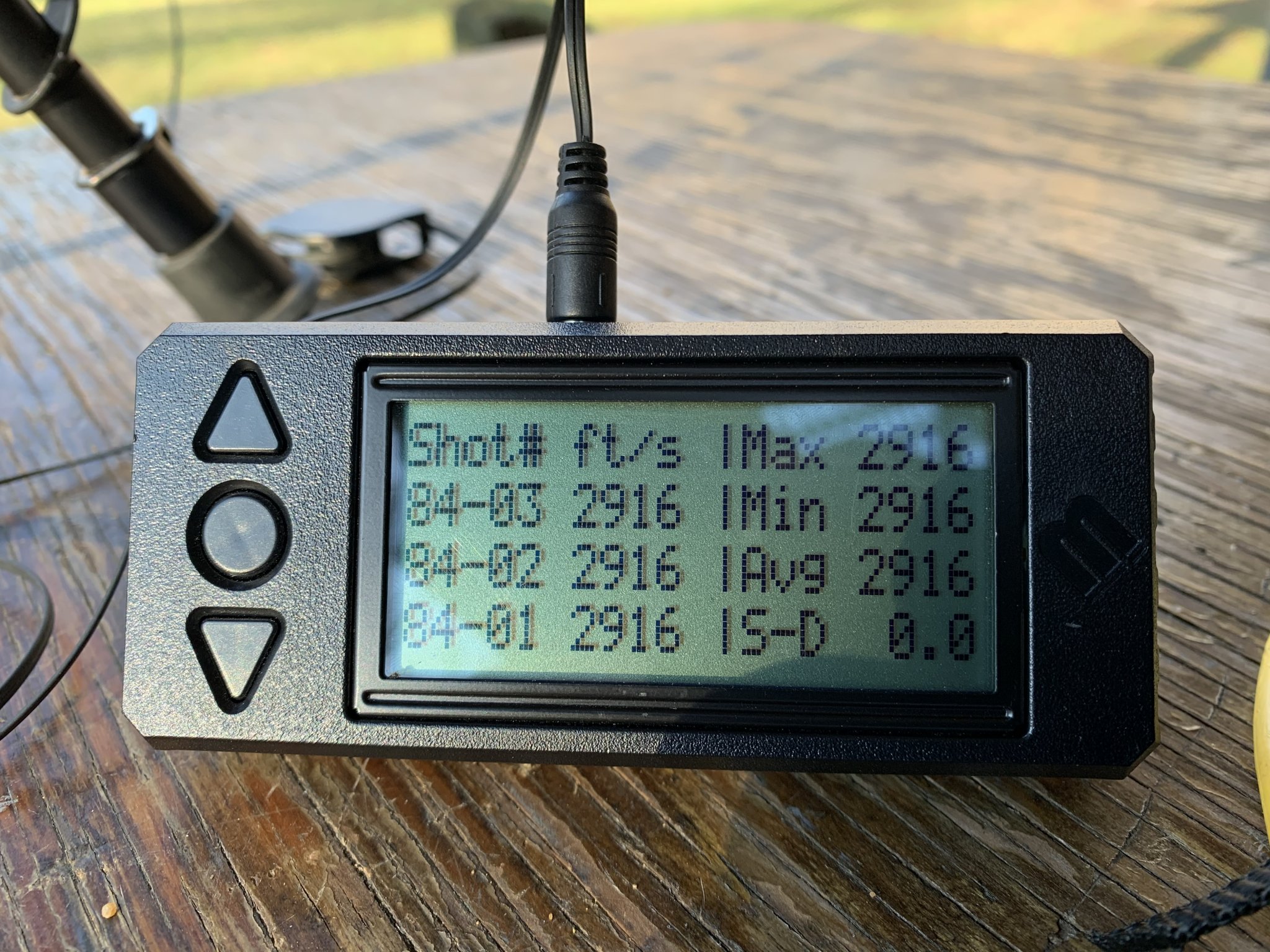

I loaded up a few of the new Berger 144 Hybrids this past weekend using the same load for my 140 Berger Hybrids which are @2884 FPS. I am seeing some slight cratering on the primers and had a couple sticky bolts. It surprised me at the jump in velocity (expected it to go down). Seems really hot to me.
I plan on starting low again (40.5) and working up.
Lapua Brass
CCI 450
42.0 gr. H4350
Velocity 2916 FPS
.020 off lands (29" Shilen Match Select)
SD = 0 for my first 3 shots
SD over next 3 shots was 2.4 - I stopped there due to a couple of sticky bolts.
First 3 shot group was .361", second group was .496".

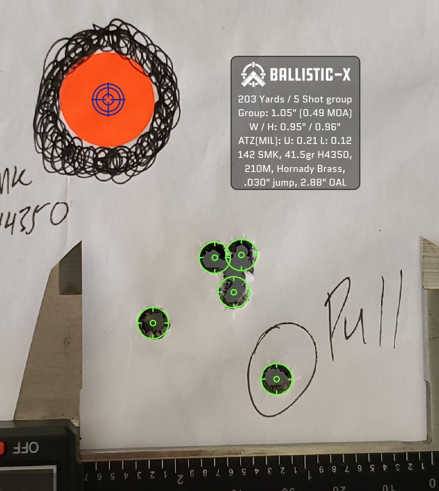

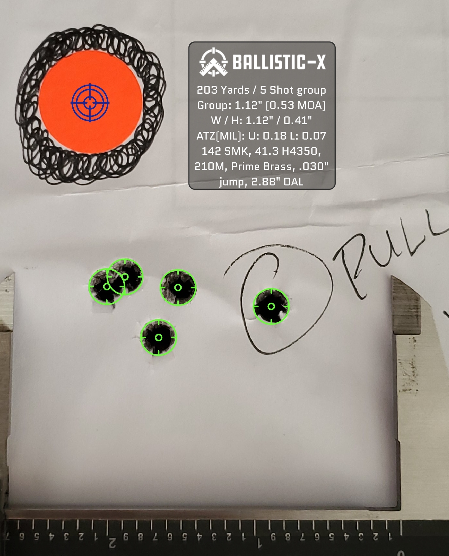

Rifle: Tikka T3x Tac A1, stock configuration
Load:
Prime Brass
FED 210M primer
Sierra 142 Matchking 1.37 length, G7 .303
RELODER 26 @ 46.95-47 grains.
JUMP: 0.100.... yes 100 thousandths, 1 tenth of an inch. OAL is 2.815 or SAAMI length.
2830 FPS, SD 5, ES 20. Rounds touching during zero and velocity trued out during a match LOL.
