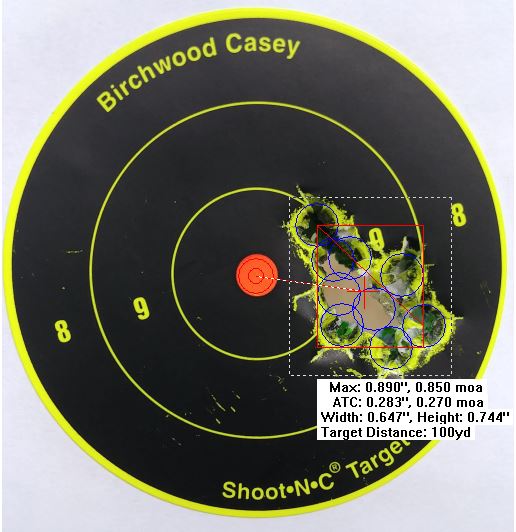

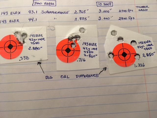

Shot these 143gr ELD-X yesterday testing OAL and my good IMR4350 node. Comes in with the Magnetospeed at 2723fps. These were at 100 yards. Going out to 300 yards with a little more tinkering with the OAL. The 2.880" is -020 off the lands of my Howa HCR.

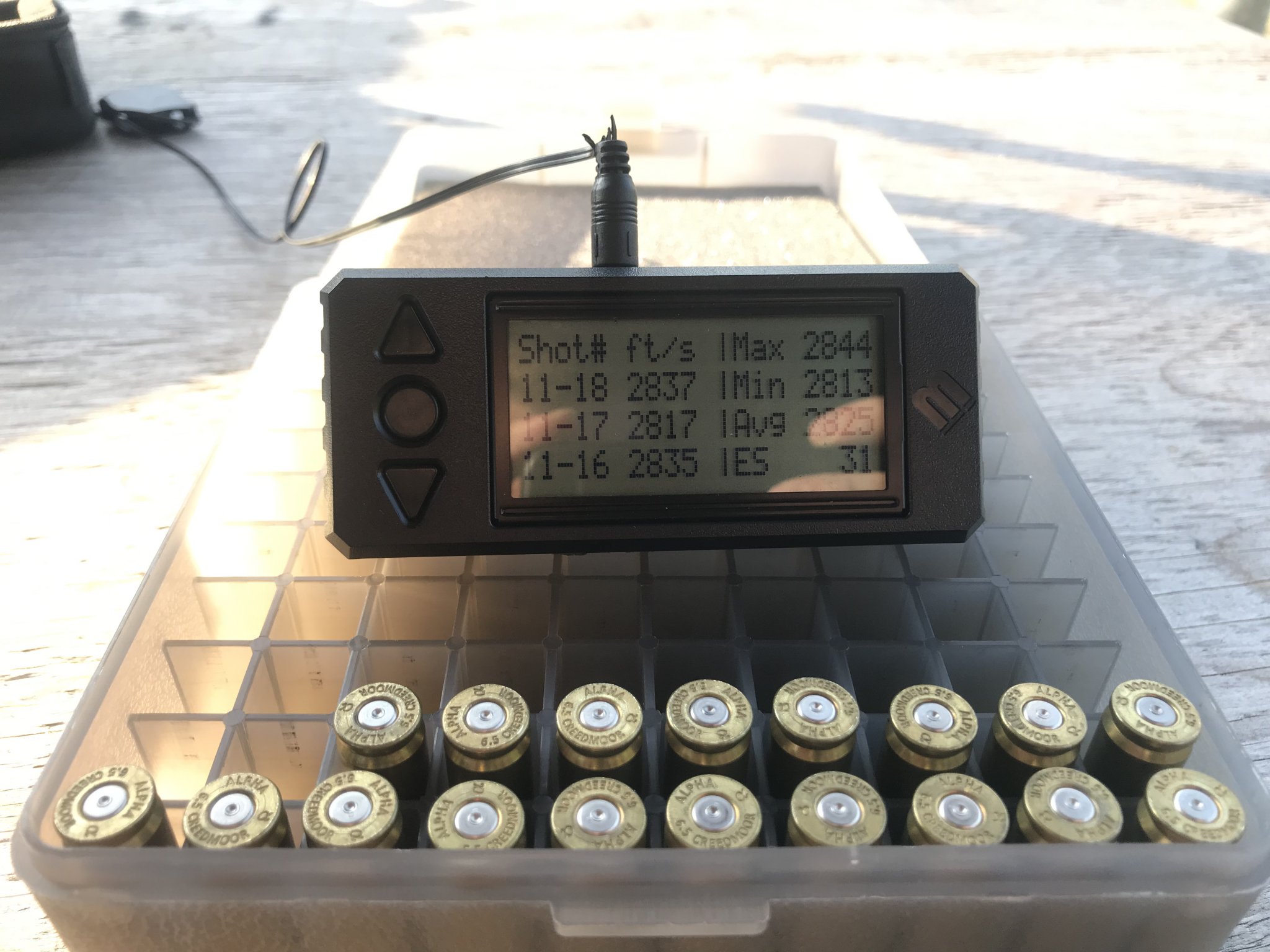

Would you guys be satisfied with this or should I search for something with a tighter spread?
147gr ELD-M in Alpha LRP brass over 42.6gr of RL-16. 18 shot string.

Whats your SD and is this a 24 inch barrel?
I’ll check the SD in a sec. 24” barrel.

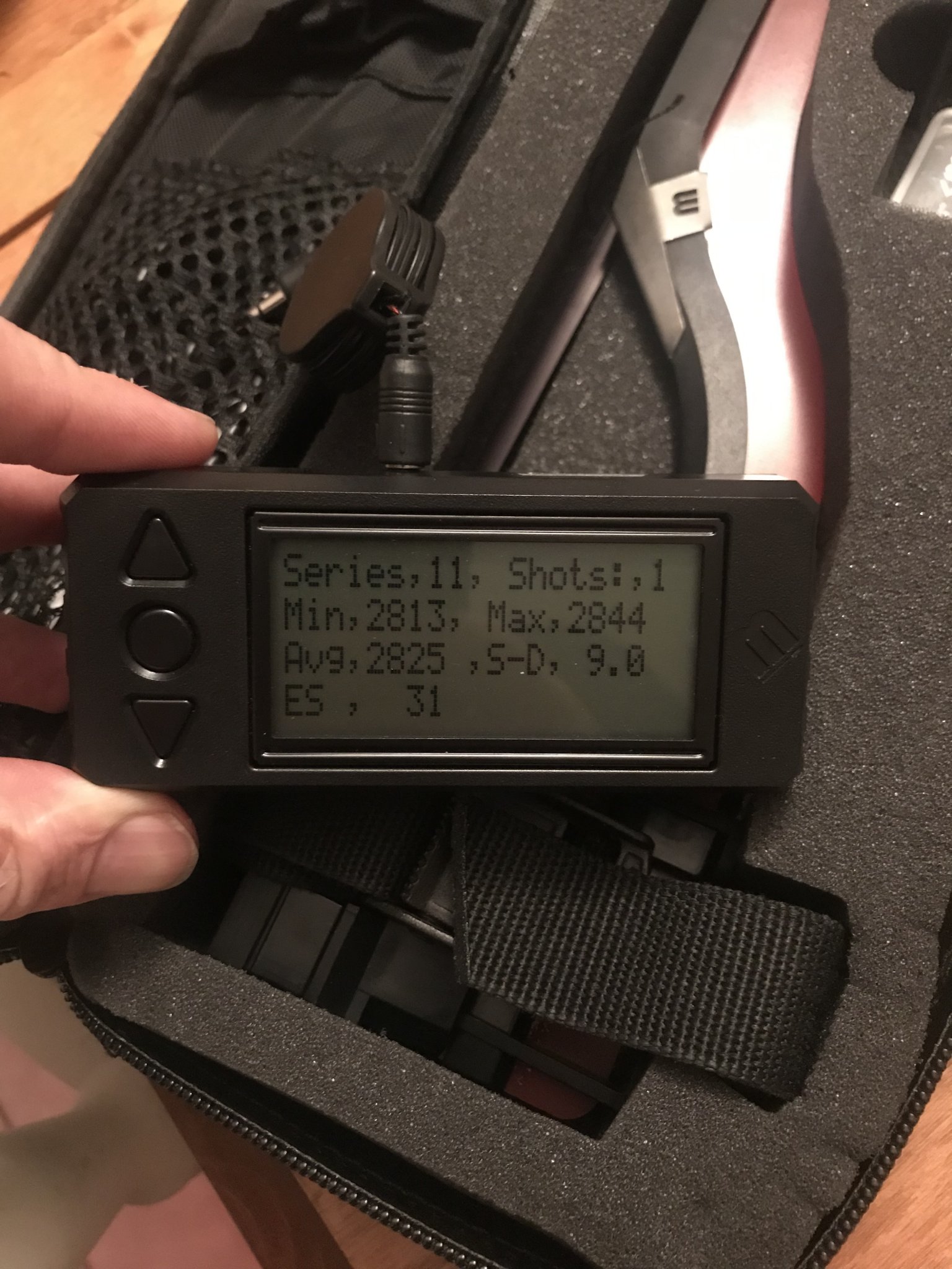

Use of a Sinclair Mandrel die, neck turning, bullet sorting, and the use of an accurate scale got my SD down to the 3-9 fps range. A serious case of ‘diminishing returns’, a lot of work for a small but real and observable benefit. Probably was not needed.

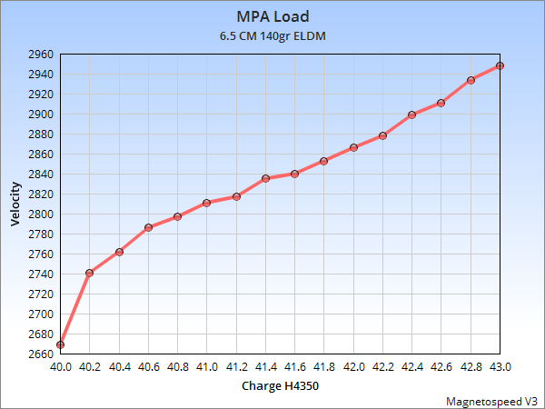

Is this looking like 41.5gr to you guys as well? It's not as flat as I would like it, but it seems to be fairly obvious.
Oh, and yeah I went up to 2960 fps. Ruined that piece of brass. Oops!
