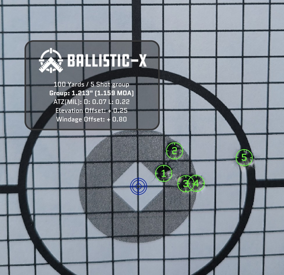

6.5 Creedmoor

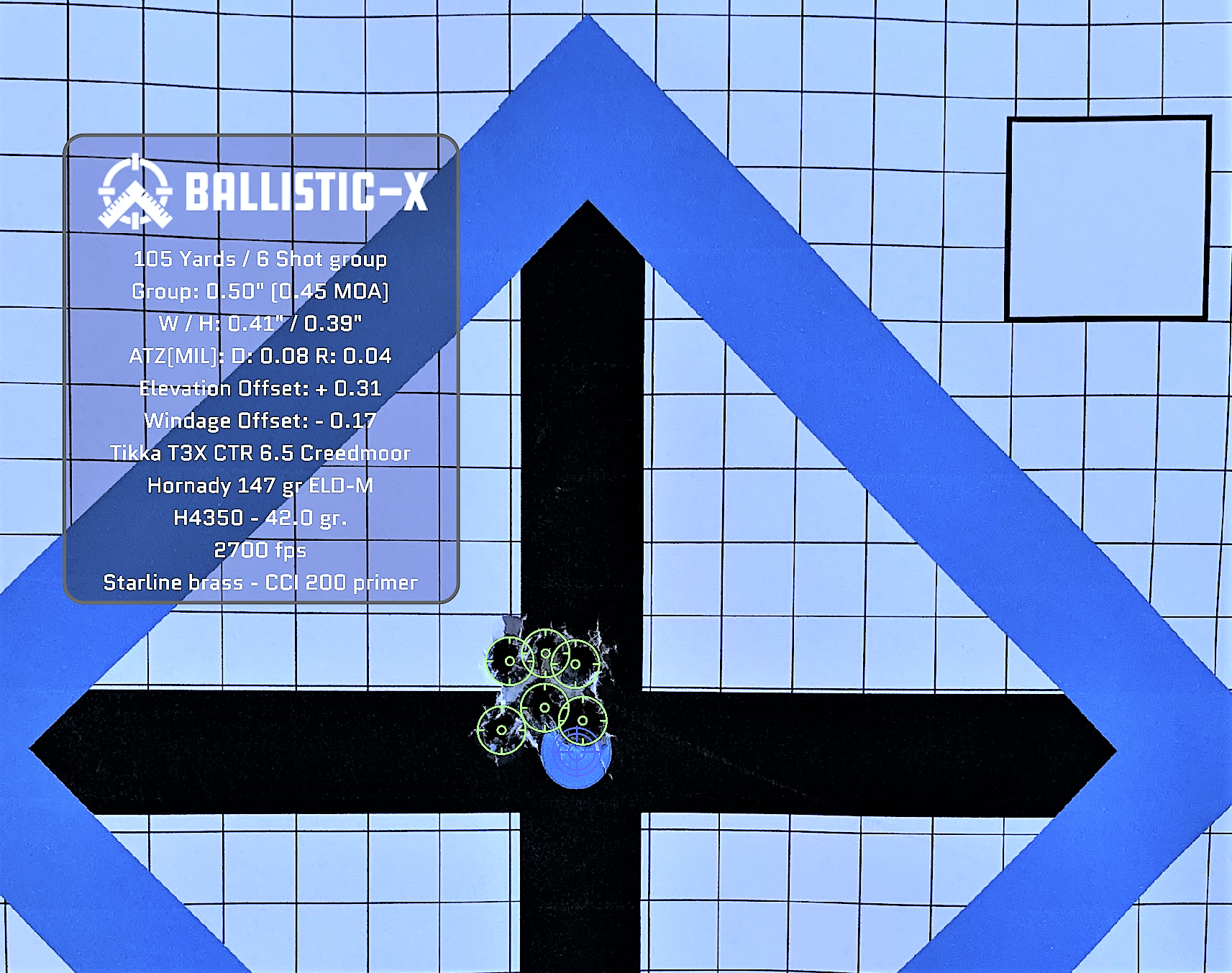

100 yds, 8 shots, finishing off the box. 26” Benchmark, 45gr Reloder 26, 147 ELD-M, Starline brass, 2802 FPS.
Eldms look like they worked great have you tried them on deer?
Nope, and not planning to. I would kinda feel sorry for bucks that run off and slowly go die over the next ridge. Not saying that would happen, and maybe i swallow the bullet expansion marketing hype too easily... but i prefer to use the best available hunting bullets on critters i intend to eat. Feral hogs are in the vermin category.
Just sayin!
Reactions: Marksman_92
6 rds. My Tikka loves the 147's.
Lovely group! That Tikka CTR is a good looking rifle, and the one i have shot was pretty accurate too.
I did notice that factory 6.5 Creedmoor ammo like Hornady and Berger was around 60 fps slower in that rifle, compared to what was printed on the box, but it was new, so did not think much about it, expecting it will speed up later.
I see you used 42.0 gn of H4350 to get 2,700 fps, which is a little slow. Presume that is a 26” barrel? How many rounds through the rifle so far?

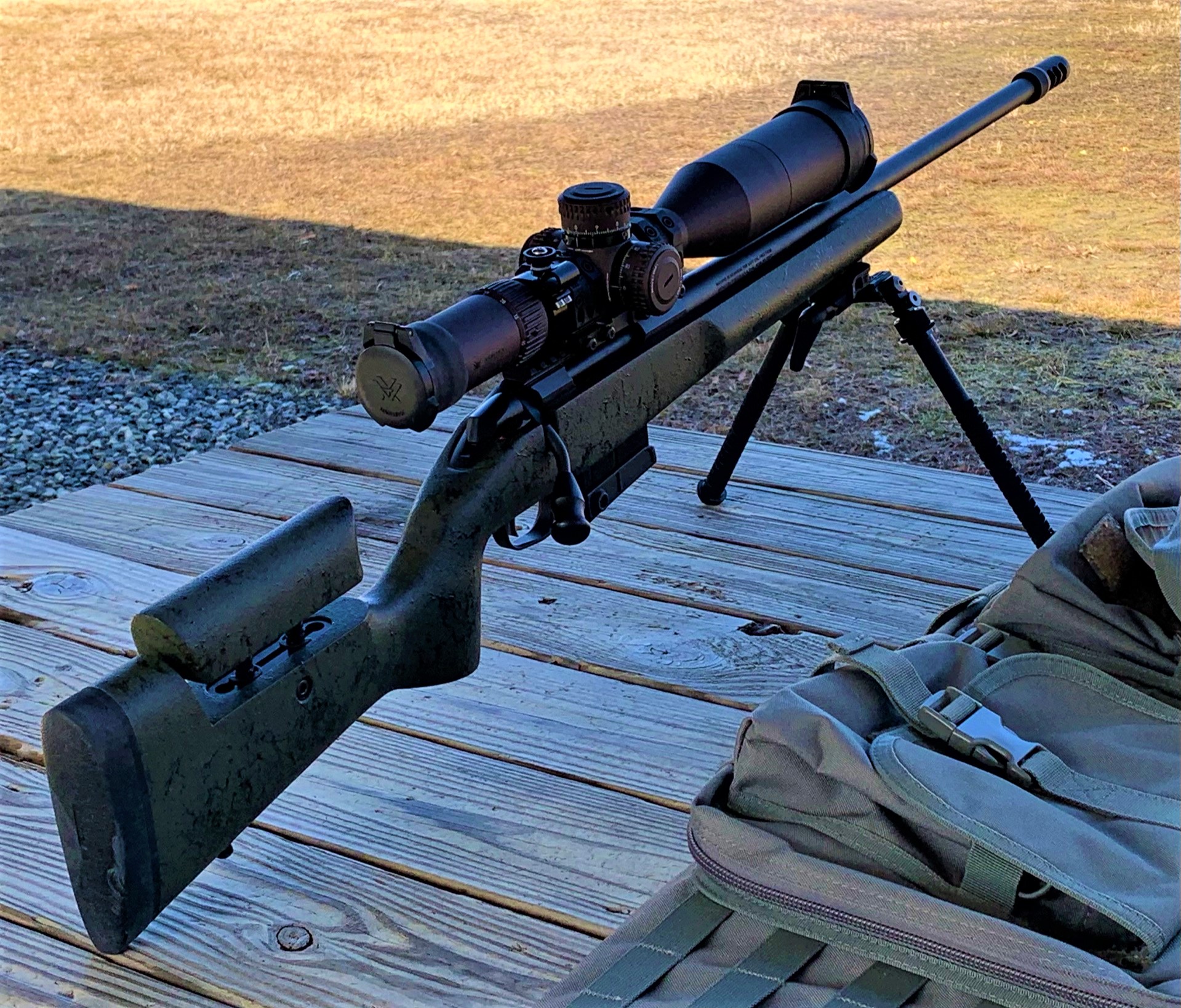

Spartan Precision R700 6.5 CM
25.5" 1/8.5 5R Bartlein M40 #14
APA little bastard break
McMillan A3-5
Phantom finish Cerakote in Coyote Tan

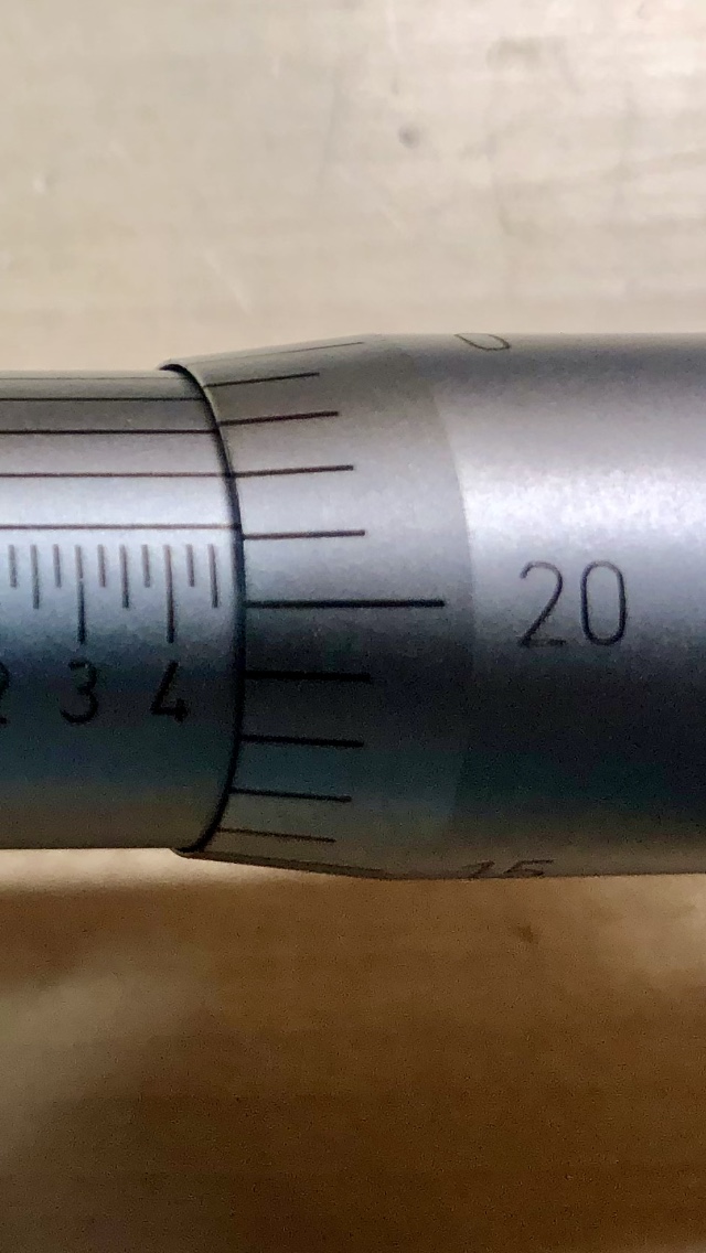

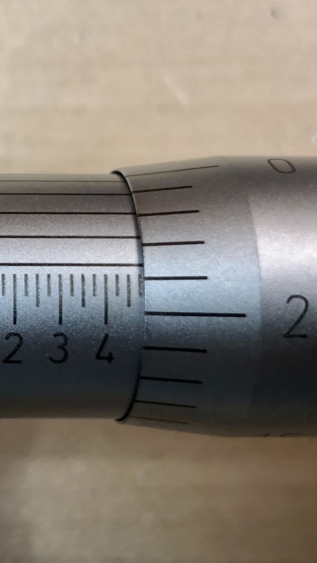

If you have access to a $40 plus micrometer (don’t use calipers for this), then a more reliable way to check for over pressure is to measure the diameter of the case at the web area and compare with a new unfired round. Take an average of at least 3. It should not expand a measurable amount in one firing. You can keep track of this measurment every 5 or so firings and you will see small gradual movement - assuming the load is not over pressure. SRP brass moves very slowly, about 3x slower than LRP brass. Compare with a discarded / retired round where the primer already tends to fall out. If there is suddenly a lot of movement in the last firing, then something bad caused high pressure to occur. Could be that the ambient temp was high, or the rounds were loaded longer than before and caused a jam, or the rounds sat for a while baking in the hot sun, or you switched to a new batch of powder that is hotter than before. Or perhaps all of the above!

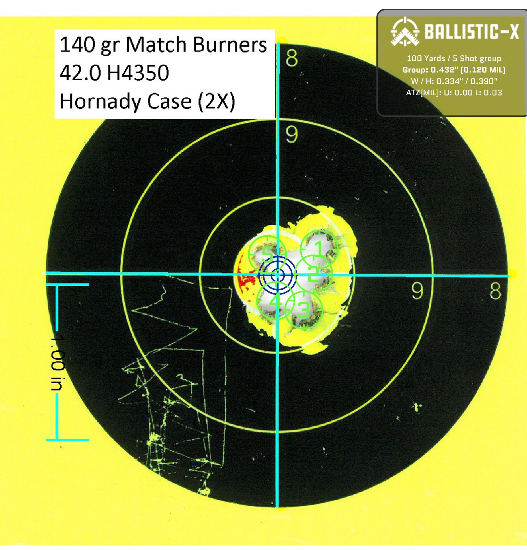

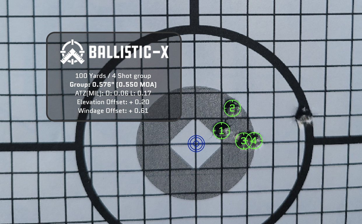

Been working on a load for the Barnes 140 gr Match Burners, since they are cheap, available and 140 gr ELDMs have become difficult to obtain. After testing, I settled on basically the same load I've been using for the ELDMs:
42.0 gr H4350
Federal 210
Hornady LRP brass
+/-0.050" jump (2.197" CTBO)
26" Criterion
Average MV: 2,771 FPS
ES: 18
SD: 7
Grouped well at 100. I have not have not tested at distance yet.
41.5 gr H4350 also worked well - 2,743 FPS, ES 15, SD 6.

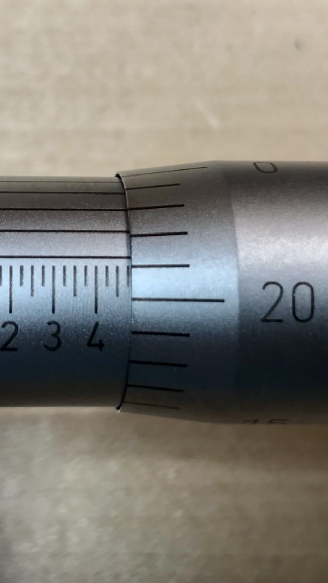

If you have access to a $40 plus micrometer (don’t use calipers for this), then a more reliable way to check for over pressure is to measure the diameter of the case at the web area and compare with a new unfired round. Take an average of at least 3. It should not expand a measurable amount in one firing. You can keep track of this measurment every 5 shots.

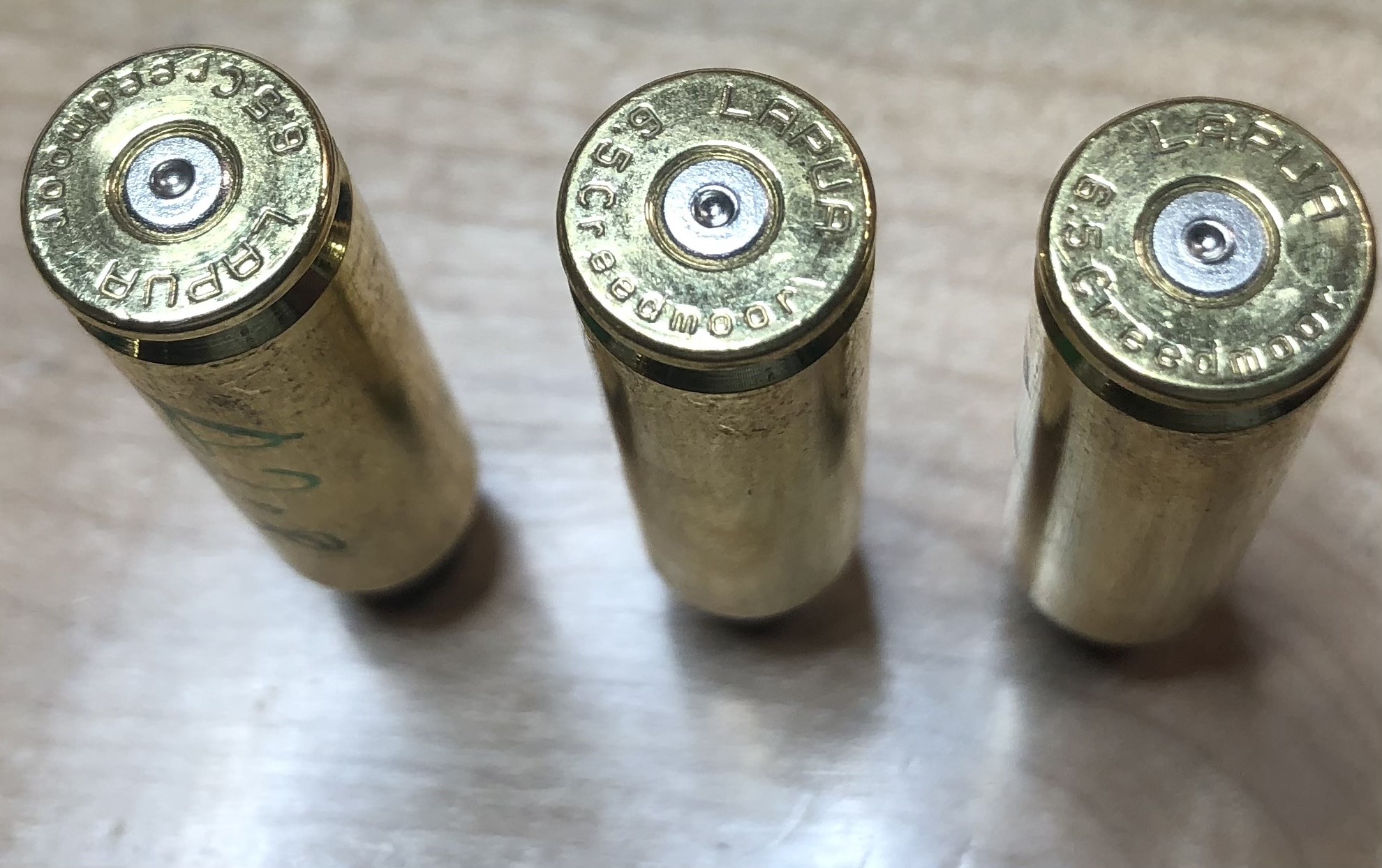

Just to add a few pics to illustrate the point: Did a pressure test yesterday and took a micrometer with me to the range. Below is a low pressure round (on the left) that was 2 grain below max, with no pressure signs. Case base diameter did not change, while the over-pressure case on the right with the full circle ejector mark expanded its base by 0.0002” (0.2 thou).
In contrast, the mild pressure case (center below) with the half moon ejector mark was about 0.1 thou larger than before firing, just barely big enough so that you can pick up with a descent micrometer.
The three Lapua cases are below: Left most case was exposed to a safe pressure, middle is the half moon example (over pressure), right is excessive pressure and a full moon ejector mark. Ejector marks are all at the 3 o’clock position. Also note the difference in primer craters.
Below is the low/no pressure example, see pic. Case diameter is essentially the same before and after firing. So no discernible movement, BUT there probably is a tiny amount of expansion, but it is less than what my $40 micrometer can pick up.
Below is the micrometer measurement for the Mild Pressure case, the case with the faint half moon ejector mark at 3 o’clock shown above. Case diameter (at the base) expanded by a barely detectable 0.1 thou:
Below is the measurement for the Over Pressure example(with a bright full moon mark at 3 o’clock), and clearly the case expanded by 0.2 thou, which is a lot:
In my experience, the first (low pressure) example might have brass life of 25-35 shots. The second example (moderately over pressure) i expect the primer pocket will open up fairly quickly, likely in 10 - 12 shots.
Next step: Cleaned all three primer pockets and seated a fresh primer, and the full moon case needed less seating force, still ok but not as tight as before. The other two felt about the same, still tight.
Of course, the full moon situation should be avoided, as it is eating into the safety margin of the Lapua case design (which is stronger than other brands). You can expect maybe 3-5 shots before primers will fall out, so this load will be very hard on the brass.

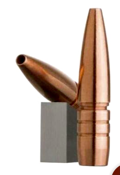

You may want to take a look at the Barnes 145gr Match Burners as well. They seem to be relatively available/cheap and G7 BC .350

There are some reports about ELDM and A-tip bullets blowing up in competition, and these folks are going back to Berger. I do think there are some bad batches out there... but most batches are ok. I have not had any problems so far with them, or at least so i believe! Shoot mostly Berger bullets these days.
IMHO the Bergers are worth the extra $20 for what i do, because of their BC consistency and superior jacket quality.
Litz wrote about this in his latest book: All jackets are a tiny amount non-concentric, but the group size difference between a Sierra with 0.5 thou “error” and a Berger (J4 jacket) with 0.2 thou is only significant at longer ranges and in BR competitions where folks are shooting super impressive tiny groups. I am not convinced it matters that much in PRS, but some folks pay to have their bullets “spun” in a special machine and sorted based on imbalance. I kid you not!

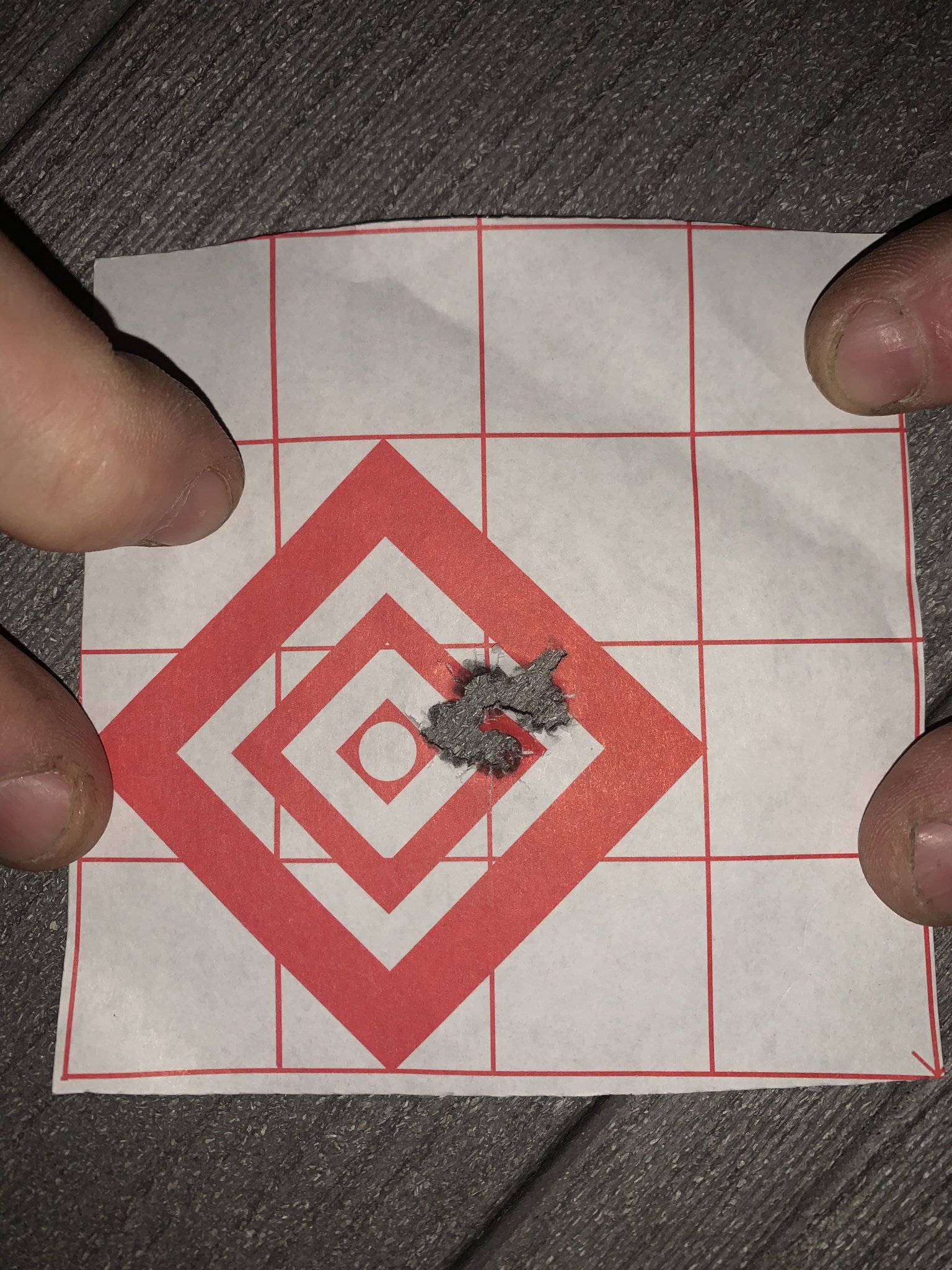

Funny story: i (only once) shot a 0.05” three shot group at 100, as best i could measure, it was one tiny perfectly round hole, not even slightly oval. Proudly took a photo, and showed it to my buddies. One wisely remarked “are you sure two of your bullets did not perhaps blow up on their way to the target?”... Guess that is entirely possible, but would have expected something approximating a shotgun pattern on the paper. I do realize it might just be dumb luck and that a 10 shot group would have looked way bigger. But the gun was shooting multiple 0.15” and 0.2” groups that day, a honey hole of a shooting range in the piney woods of East Texas, with almost no wind. To this day i wonder about my “record group”...

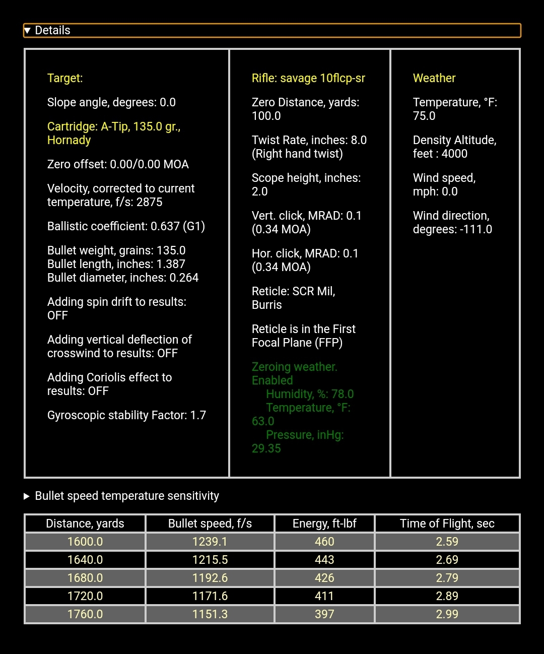

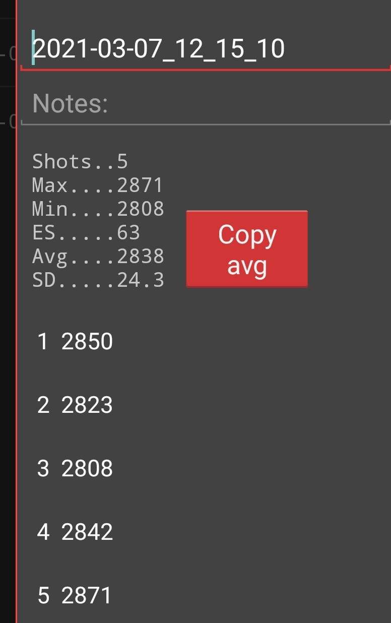

135 atip 43.8 rl16 2.950col
First time using my magnetospeed messed up on the 10 shot string for velocity so I shot 5 to get an idea. Still supersonic at a mile
Really pulled that 5th shot, twitched the rear bag right as I broke the shot would've been an awesome group
ES of 63 seems high. Have you tried a lower charge somewhere between 41.5 to 42.5? I’ve used RL16 for a while in 6.5 and I always get ES <15.

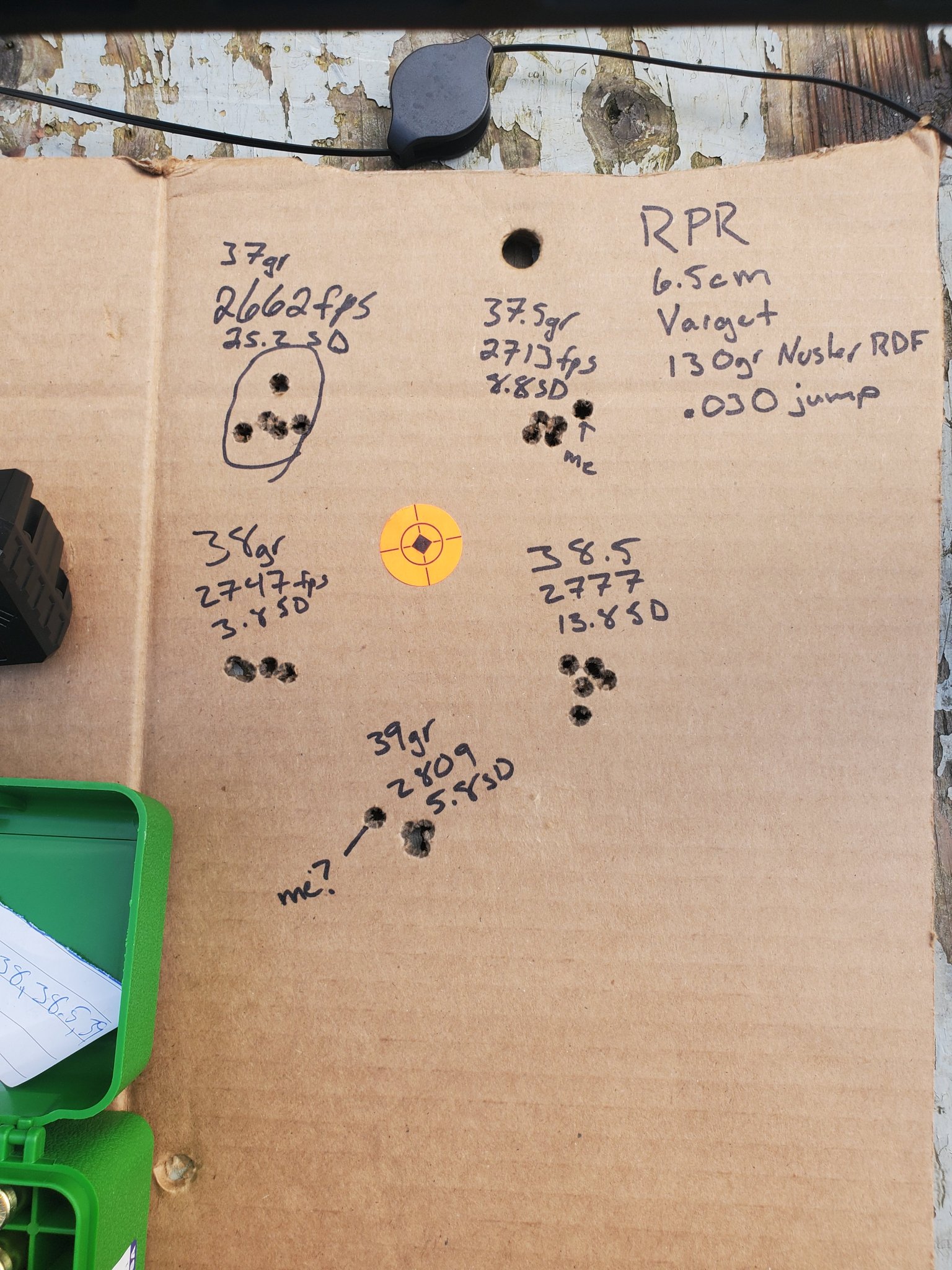

Loading for my kids Ruger Precision Rifle.
I bought a bunch of Nosler RDF because it was what I could find. And using Varget to save what little H4350 for my gun.
Nosler 130gr RDF with a .030" jump
Varget 37, 37.5, 38, 38.5, and 39gr 5 of each.
I pulled 1 out of my 37.5gr group and I think 1 out of my 39gr group. Pretty happy with the ES numbers.
I started getting the slightest brass swipe at 39gr.
I plan on going back and working 37.5-38 a little more.
Reactions: DubfromGA

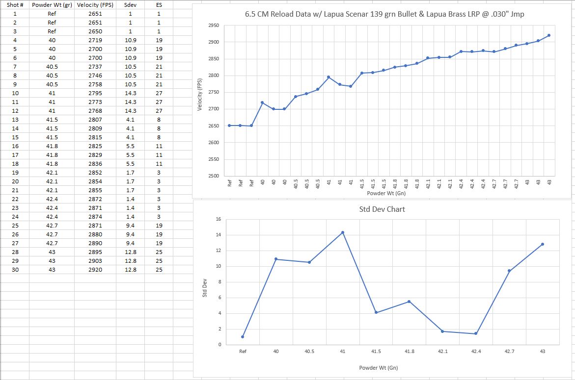

Hello Gents! I am a newbie to reloading and have a question for you experts. I did my first hand load and tested them this past weekend. I started with 40 grains and worked up to 43 grains in small increments of .5 and .3 grains. Total of 10 weight groups with 3 rounds per group. Bullet jump was set @ .030". Based off of my results it shows that 42.1 and 42.4 grains are my best nodes, 1.7 and 1.4 StdDev respectively. The ES was 3 fps for both weights. My question is, how do you determine which node to use? Do you look at your bullet groupings for each of those nodes? Or the velocity? The 42.1 had an avg speed of 2854 fps and the 42.4 grain ammo had 2873 fps. No pressure signs observed up to 43 grains. The ref rounds you see in the chart is live ammo that was bought online from Freedom Munitions. Just wanted to get a baseline. Magnetospeed chronograph was used for measuring velocity.
My next step is to test for bullet jump once I commit to a powder charge. Any help would be greatly appreciated.
Rifle: MPA BA6.5 CM with 26" barrel (new with 36 rounds through barrel prior to testing)
Materials used:
New Lapua brass
Lapua scenar 139gr bullets
Hodgdon H4350 powder
Federal 210 primers
Materials used:
New Lapua brass
Federal 210 primers
My load changed a little from virgin brass to 1x fired. I would suggest trying those two loads with 1x fired brass and see how they do.

I also run an MPA 6.5BA, great rifle and comp ready. You will like it!
There is a small section in the MPA manual explaining that the chamber was cut with a non-standard reamer to produce a “Match Chamber”, with freebore optimized for the Hornady 140 ELDM Match factory ammo. My measurements show that it is close to a min spec chamber, which is a good thing if you intend to shoot 140 gn ELDM Hornady factory ammo. The freebore (when new, so no throat erosion yet) is not suitable for the 147 ELDM factory ammo. At around 1,500 to 2,000 rounds you will likely have enough throat erosion to try the longer heavier bullets including the 153/156 gn bullets in hand loads, without the bullet sitting too deep in the case (and eating up powder capacity).
My testing showed that the rifle responds well with a jump of around 20 thou. It did not produce accurate results with a jammed bullet. Also got good result with very long jump (magazine length rounds especially with the long Berger 144 bullet). Bullets tested include the 130 Atip, 140 ELDM, 140 Berger Hybrid and the newer 144 Berger Hybrid. All shot well. The Atips performed the best, and occasionally produced successive five shot groups below 0.2”. That was very satisfying, but this bullet is double the price. And you cannot find it anymore due to the latest ammo shortage.
Because of the min spec chamber you will likely find that you get more speed at any specific powder load than what the reloading handbooks show. Also pressure signs show up a grain or so earlier than in a standard SAAMI chamber, at least in my rifle. Your speed for a 140 bullet driven by H4350 is a little on the high side. Some barrels are faster than others, so not saying your load is over max pressure, but worth double checking for pressure signs.
Most folks would pick the middle of the widest node they find. I would aim for the slower side of your node, to get longer brass life and perhaps also to get slightly better barrel life. Chasing that last 100 fps of speed gains you very little in terms of wind drift. A wide node like you found is good, but a fast load is more expensive in terms of barrel life. Maybe recheck the wide node (41.8 to 42.8 gn) in smaller increments like 0.2 gn (if you have a good scale). If you have a flat spot in the speed graph AND the SDs are below 8 for multiple charge weights, you have found a real node. Then optimize seating depth to minimize group size. You should get below 0.35”. Try 5-30 thou jumps in 5 thou increments, but also try very long jump (30-150 in 20 or 30 thou increments).
Also your barrel will likely speed up significantly somewhere between 50 and 200 rounds and you will then need to redevelop a new load.
Hope this helps!

Thank you for your response. This is really good info, especially about the heavier bullets for this rifle. I found some ELDM bullets 140gn but waiting for USPS to deliver them this week. Bad timing on my part getting into reloading, lol.
What would be the ideal speed for this barrel/cartridge? Maybe 2700 - 2800 fps?
Yes, i found a node at 2730 fps using a 140 ELDM bullet and H4350. Berger 140 Hybrid factory ammo did 2820 fps (different powder of course).
