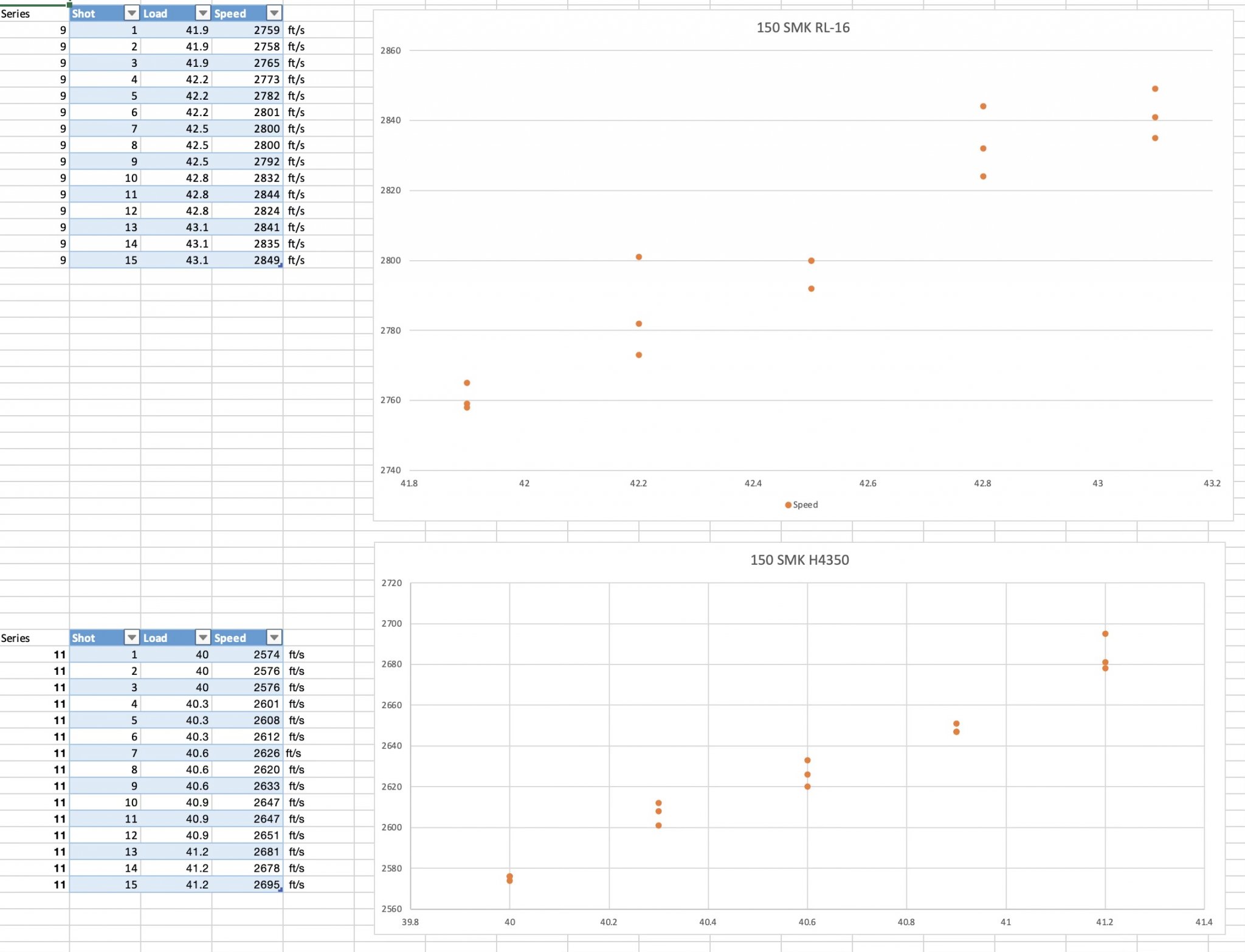

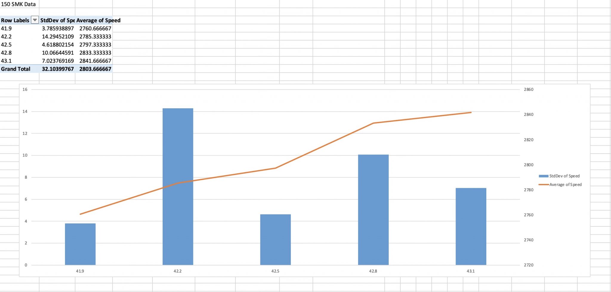

Sorry y’all, so my barrel is a 26” MTU profile w a 7.5. tw. I’m loading w either 6.5 StayBall, h4350 or RL16.
So far I’ve loaded up a few test rounds w the 150s that I haven’t had a chance to test yet due to life. But I worked them up from 41.9 to 43.1 w RL16. Hopefully I can get out to the range this week and fire them off… that said the 43.1 is somewhat compressed so we’ll see if I get to them wo pressure signs…..

Good! Your twist rate is fine for the 150 SMK, and i would expect them to shoot well.
Would recommend H4350 and RL-16, which previously gave me adequate speed and superb accuracy. Staball is likely fine for a plinking round, especially if you want to use a powder measure (well away from max pressure), but not ideal for long range work.

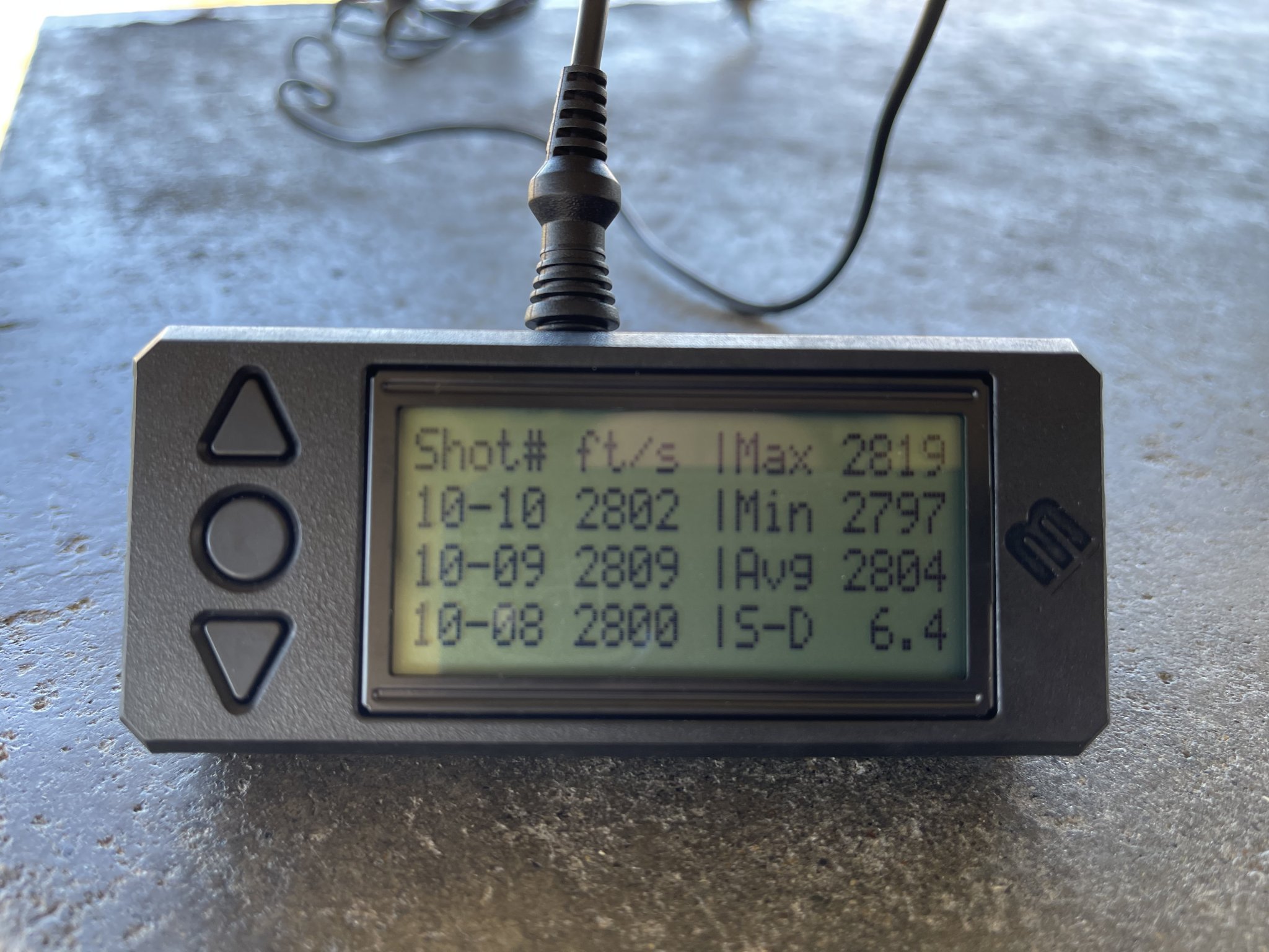

Well, I have my StaBall complaints for sure, but it does shoot sub moa at 1,000 for me, and sub 0.5 moa at 100 when I do my part.
I've had good luck with StaBall. Using 140 ELDms, I had single digit SDs in multiple places in a ladder test. I settled at 42.2 grains, with SD of 8.6 and velocity of 2775.
I also had single SDs at 43.4 and 44 grains, running 2875 and 2900 fps respectively. I settled on the 42.2 load cause the speed is fast enough and its consistent. It's easily a sub 1/2 minute load.
Gun is a 26" Proof research barrel.

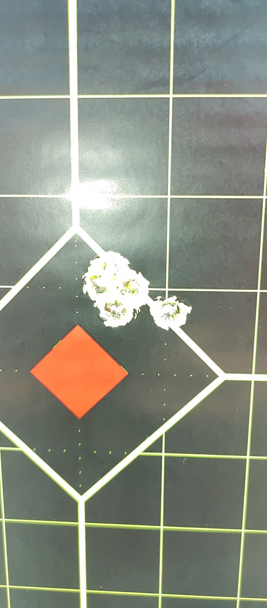

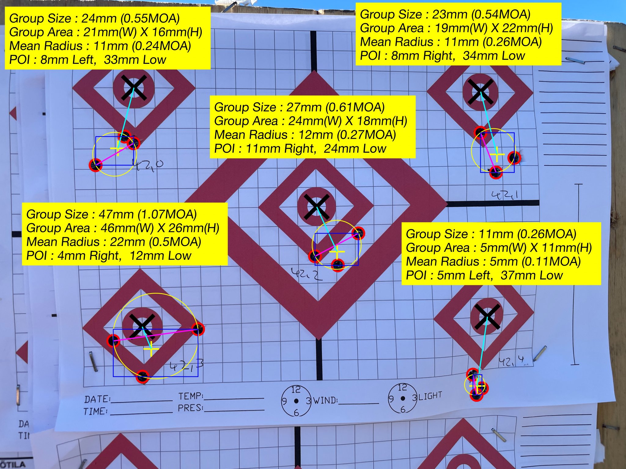

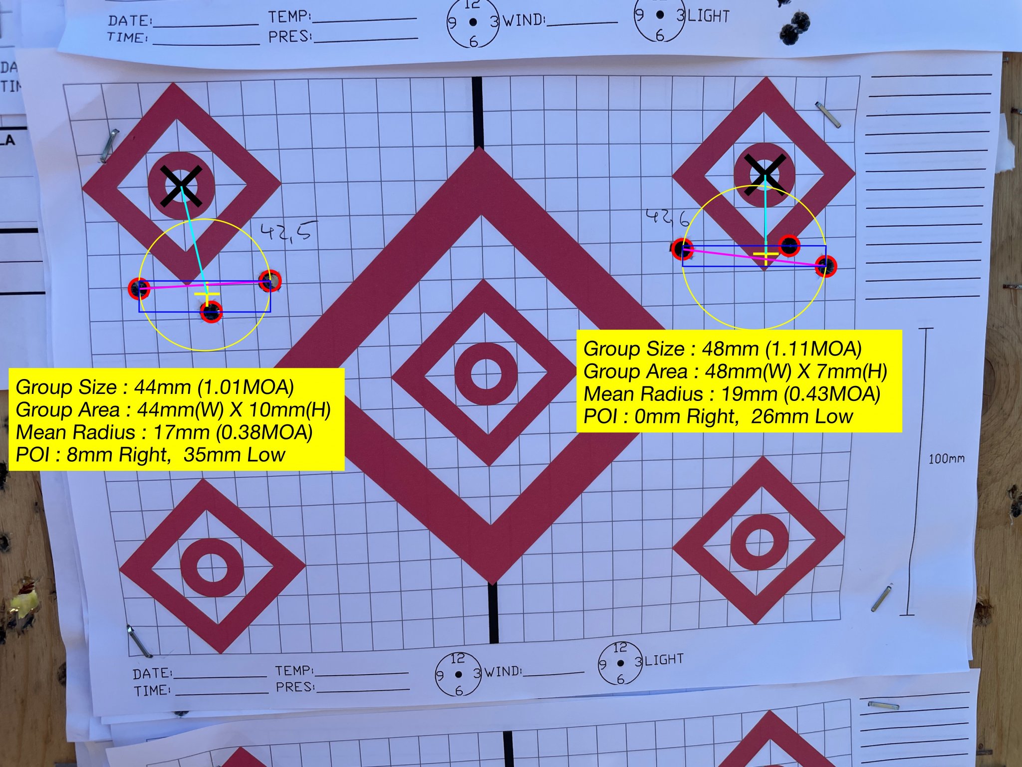

Hi,
I've been working load to my Tikka T3x action, Shilen selected match barrel 26".
VV N555 (others are hard to find in Europe)
ELD-M 147gr
210M
Sako brass, full sizing, bumping shoulder 0,002"
0,020" jump.
Caldwell chrono.
So i have tuner, but not sure what to select to tune, here are numbers:
CWAVGSDESGroup (MOA)
42,0276118360,55
42,1280822430,54
42,2279618360,61
42,3277719361,07
42,428145100,26
42,52771231,01
42,628087131,11
3 shot groups, i think that 42,1 and 42,2 are best to next stage, tuner test based on group shape. But other hand data show low sd's 42,4 - 42,6. But groups are really wide. Except 42,4
Distance was 150m.
What you guys think?

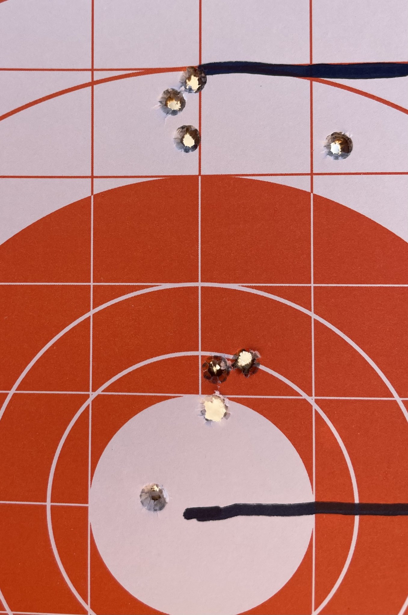

SIG CROSS 6.5 Creedmoor w/PVA ultralight MB
New Alpha brass
Fed 210M
Hodgdon H4350
PVA Cayuga 121gr
2.850 COAL
Charged on AnD fx120i auto throw
One shot fired each for velocity reference
42.0- 2703
42.3-skipped because initial velocity to low
42.6-2781
42.9-2805
43.2-2814
43.5-2843
43.8-2864
44.2-FTR
44.5-2889 (flat primer, pressure signs)
I’m going to try the 42.9/43.1/43.3 for load development today. I was hoping to be over 2800fps and that looks safe to me
Update:
Either I don’t like shot #4 or this barrel doesn’t like to shoot hot.
150yd 4 shot groups. Squares are 1”

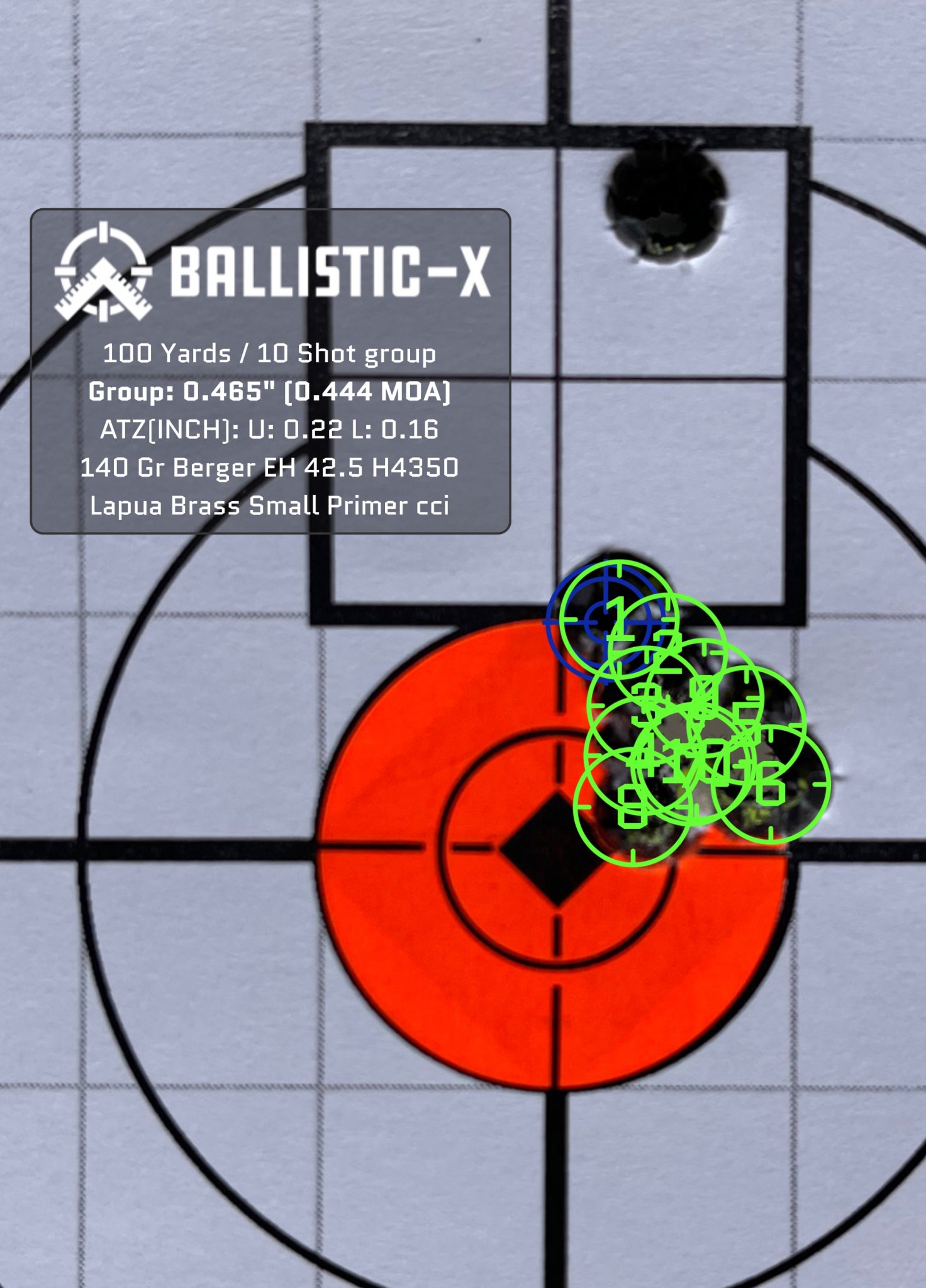

Patriot valley arms monolithic 6.5cm
So I’m a convert to the small rifle primer gang….
42.5 H4350
140gr Berger Elite Hunter
Lapua brass
CCI small rifle magnum primers
The best 10 shot group I’ve ever shot.

Hi,
ELD-M 147gr
210M
0,020" jump.
Caldwell chrono.
42,0276118360,55
42,1280822430,54
42,2279618360,61
42,3277719361,07
42,428145100,26
42,52771231,01
42,628087131,11
Distance was 150m.
Well you seem to have a flat spot/speed node that is 0.5 gn wide, which is good for the smaller calibers. Pick the powder charge with the smallest SD (ignore ES, unreliable statistic). So i would pick 42.5 as well, assuming it repeats.
But do go shoot 10 more rounds to make sure it was not blind luck. 😊 If need be, try 42.4 gn next.
Then dial the tumer to shrink the group even more. You are on the right track.
I shot 10 shots that load, AVG 2875, SD 19 ES 53. Group was 0,6 MOA.

I managed to tune 42.5 gr groups to 0,4 MOA and for now i'm happy with it.

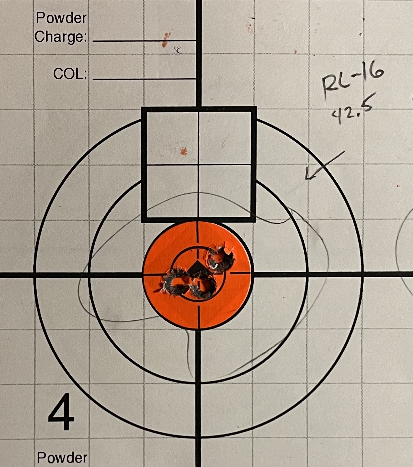

Not sure if anyone is interested but I was going to follow up on my experience and experiments w the SMK 150 high bc bullets.
Setup: tikka action, chambered in 6.5 CM, PVA Osprey barrel 26” w a 1:7.5 tw.
Brass / Primers: Lapua small primer pocket and CCI 450 small mag primers.
Ok so I tried both H4350 and RL-16 and ran initial ladder tests to find any nodes. I typically run 3 shots per load and start about in the middle of rec load spec and work up and slightly past max from the book. I also found some data online as well that I used as a benchmark.
Note: my normal load is the 140 Berger EH or LR depending on what I can get w same brass and primers as above. I use H4350 and hover around 42.5 Gr. I see speeds just around 2800 fts with this load w very tight SDs and low ESs. Recently shot a 10 string group at .44 MOA w an SD of 6. Not bad for 6.5 CM…. At least I think so :)
Anyways…. Here are the initial results. H4350 from the loads I tested seemed slower than what I would have liked but did have some “soso” nodes. I need need to test it a little hotter though.
RL-16 however from my run seemed very positive. A nice nice node around the 42.5 mark w speeds around 2800 and low SDs (for 3 shots which isnt very informational statistically, I know!) Temp outside for these tests was around mid 70s.
I went back however earlier in the am to validate and RL16, 3 shot groups .1 grain below, same and above. And got more distribution than I would have liked… decent groups though as shown in the pic…. Anyway…
Need to test hotter h4350, and figure out what hell is up w the RL16 apparent temp issue….
To be continued!
