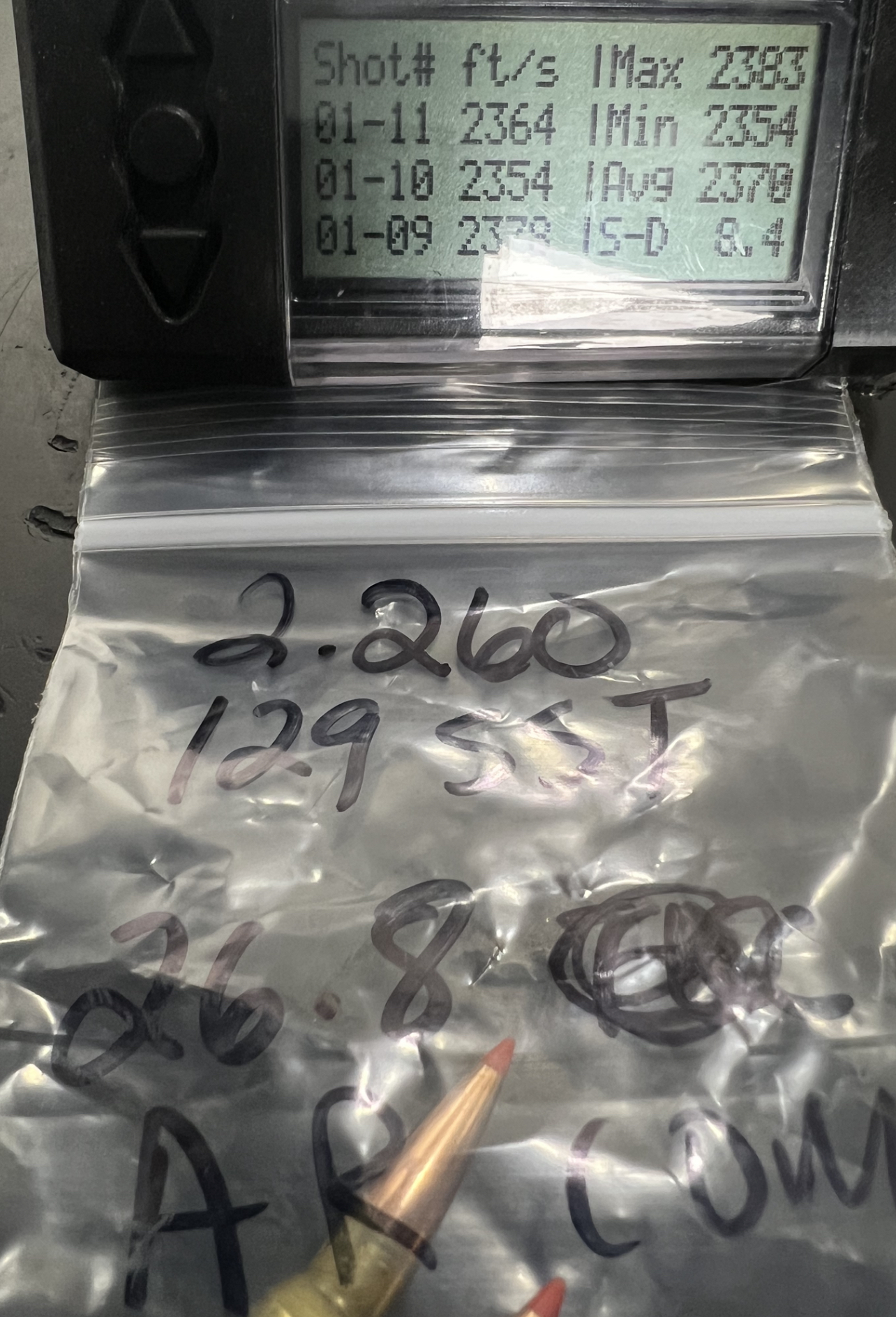

26.8 ARComp
Starline or Barnes Brass
129 Hornady SST
(Didn’t work with 129 ABLR- ejector swipes)
2.260
BCA 18 inch barrel
Submoa on 11 shots.

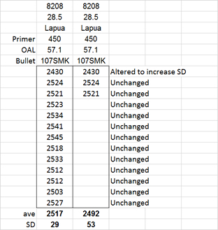

Here's an example of how your SD can shrink by firing more rounds. It highlights the random nature of shots in a string. If we delete all but the first three rounds and look at the SD it is now larger at, '20'. My point is, firing three rounds does not tell us the real picture, and certainly no reason to quit.

BTW, my example above was not manufactured for this thread. Every muzzle velocity is real and in the order they were shot. And it was the first column I saw when opening my records. The idea an SD drops the more shots are fired can also validated by doing the same to your own records. Use the first string you see and do a SD calculation for the first three rounds, and then all the rounds.

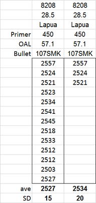

Here's the same string above with the first shot altered to increase the SD of first three shots to be the same as Basic's 53. You are saying that 53 is so extreme as to be meaningful in some way. But when we keep shooting the SD drops to 29. In this case, one unusual shot can blow out the SD when there are only two other shots, but more shots reveals the truer picture.
If one absolutely trusts every step along the reloading and data generation process, a 3 shot group with an unacceptable ES is probably sufficient to move on. As Yonderling says, it’s not getting better. But, if there is fault to be found in any step along the way, grounds may be found- through further testing- to ignore a questionable reading. Using the example I posted above, 9 of 10 measurements fall within 25 fps, with a single outlier over 100 fps outside of that range. Yes, it is hypothetical data. But, it is an entirely possible dataset as well- especially with a human in the reloading process. Maybe I bumped the scale and dumped more powder in that one and didn’t notice. The dataset would arguably be even more plausible if I had made the outlier wildly low.

Ironically, while you deride shooters who rely on statistics too much as being 'nerdy', at the same time you advise Basic to stop because of a statistic. You believe his SD of 53 to be valid and meaningful. My argument is that both of you should ignore it because it is meaningless. Again, ironically, I am the one advising not to rely on statistics in this context.

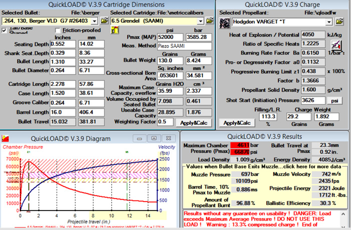

Here's your 29.2gn 4895 load predicted in Quickload out of a 16" barrel...2435fps. Computer predictions never match reality exactly for all sorts of reasons, but they are close.

Too fast for 130’s. Best with lighter weight bullets in Grendel. See attached burn rate reference. You might look at 2520, VV powders, 748, Power Pro Varmint, even old school BLC2. Best to be on the slower side of 335 for sure. You should also check out the 65Grendel site ‘preferred loads’ section for another reference point.
