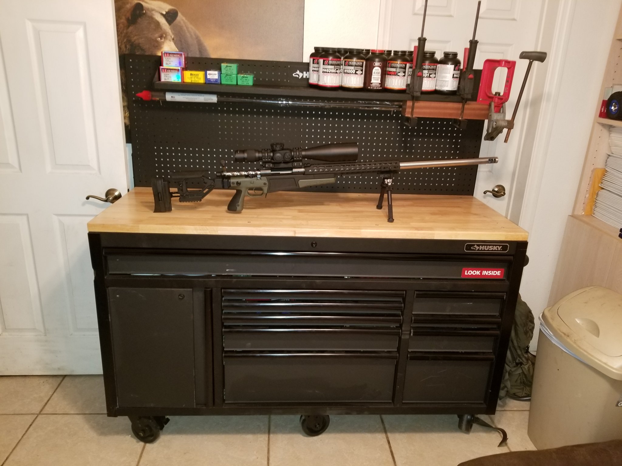

GA Precision Team Rifle
Nightforce
6.5 PRC
Tempest action - 60 degree bolt - super smooth and amazingly fast
Trigger Tech Diamond trigger - 1 lb pull
Bartlein - GAP contour #7 26" 1/8
Fat Bastard Gen 2 brake
Manners Elite Tac MCS-PRS stock
PGS Stealth Floor metal
20 MOA base
Those are the details - I got 1/2 MOA off the hood of the G in a fairly unstable position. Like I said, pleased so far...
My plan is to attend local PRS matches as a prep for hunting in some pretty remote/difficult NM terrain.

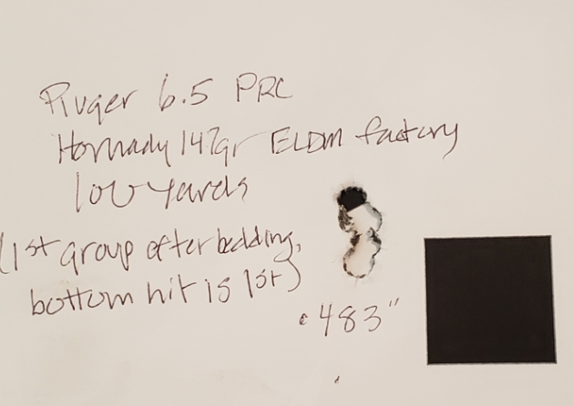

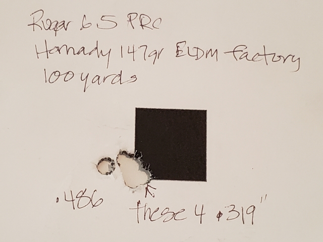

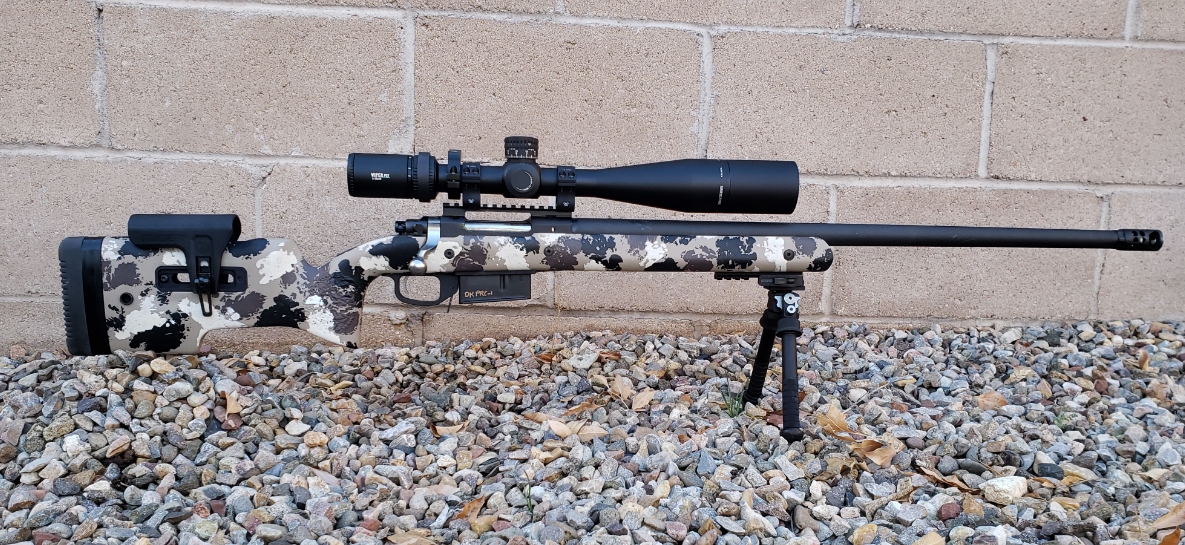

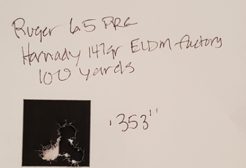

I bought a Ruger Hawkeye Long Range Target Rifle in 6.5 PRC. The stock is nice and adjustable, but it's wood. I machined some pillars and bedded it. I only fired one box of factory ammo prior to bedding, it was grouping on average about .6 - .7 moa.
I gave it a paint job, took to the range, swapped scopes from my Bushnell HDMR to Vortex PST 2 and was zeroing after every 5 shots. These were my best groups
