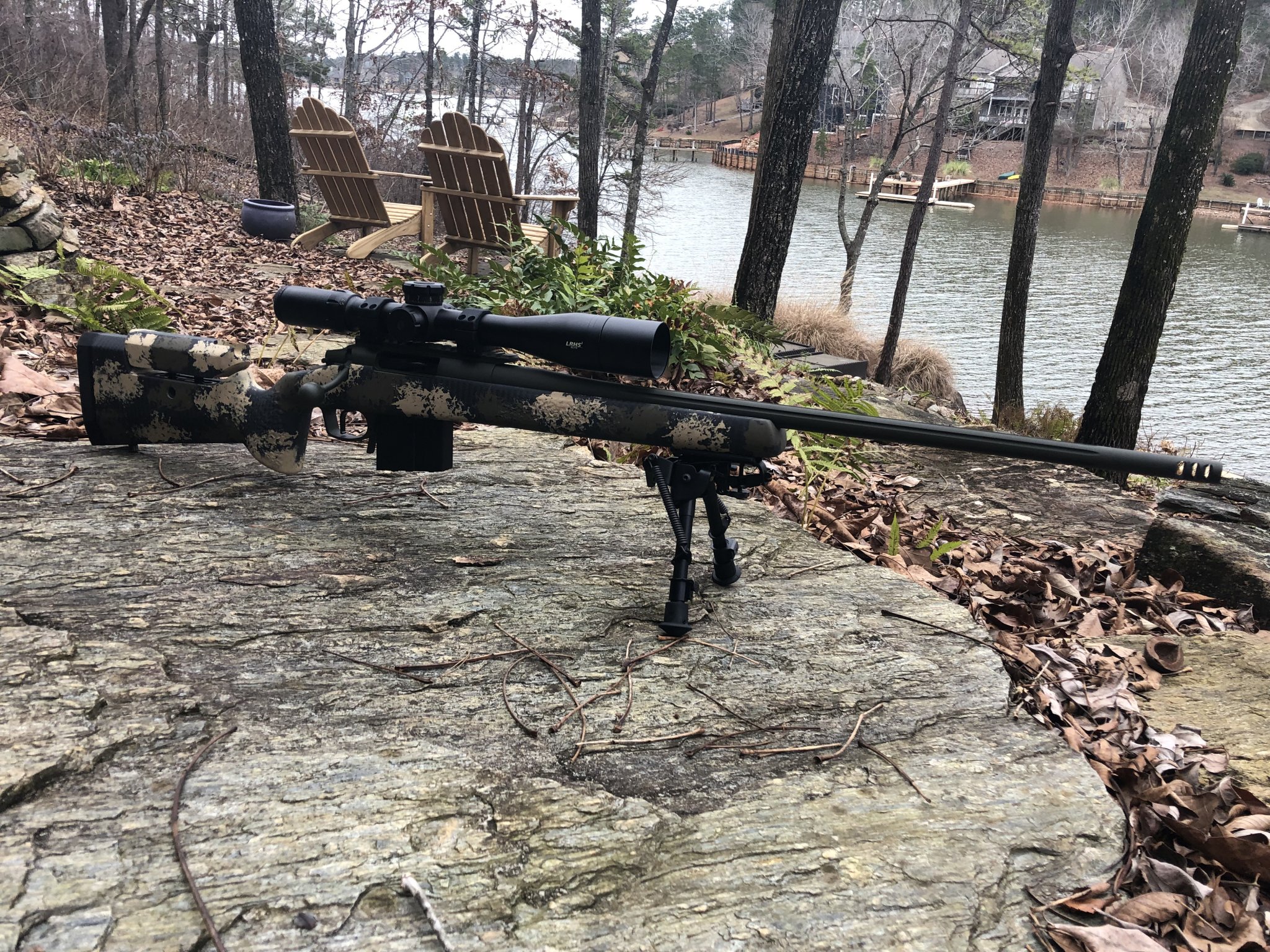

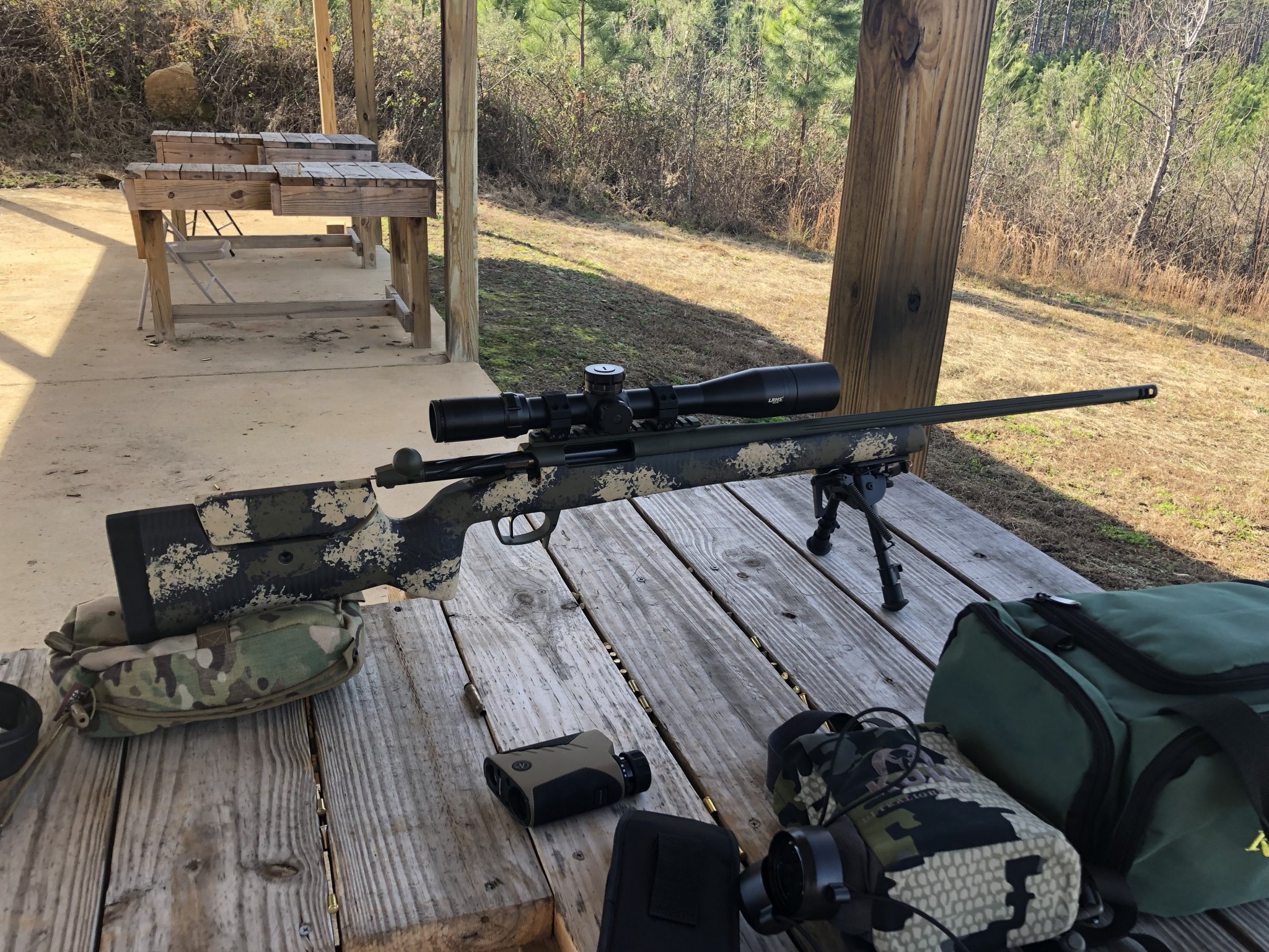

GAP 6.5PRC, I ordered an Xtreme Hunter but made too many changes and it just became a Custom.
24" Bartlein #3 Fluted
APA Micro Bastard
Manners EH-1A
Tempest Action
TT Diamond Flatty @ 1lb
First 20 rounds for zeroing and barrel break-in were with Factory 143 ELD-X. Cleaned between every shot for the first 10 then again after the next 5rds at the 15 and 20 mark.
Avg. 2932
SD 30.2
I ordered some Copper Creek loads to see how they would do and this is what I had, all strings were 5 shots.
CC 143 ELD-X tighter groups than with the factory loads, I'd say around 1/2". I pulled a flier that was all me so I didn't measure the group.
Avg. 3015
SD 12
CC 140 Hybrids - Group opened up pretty good and they were all over the place within a 2" circle.
Avg. 3095
SD 7.9
CC 140 Elite Hunters - Group was larger than 143 group but were vertically perfect. The spread was all horizontal within an 1-1/2".
Avg. 3077
SD 17.6
The Berger groups really opened up, may have been me or could have been the speed but the Factory and CC 143 loads were by far my favorites. I have only put these 35rds through to date so definitely need some more time at the range.

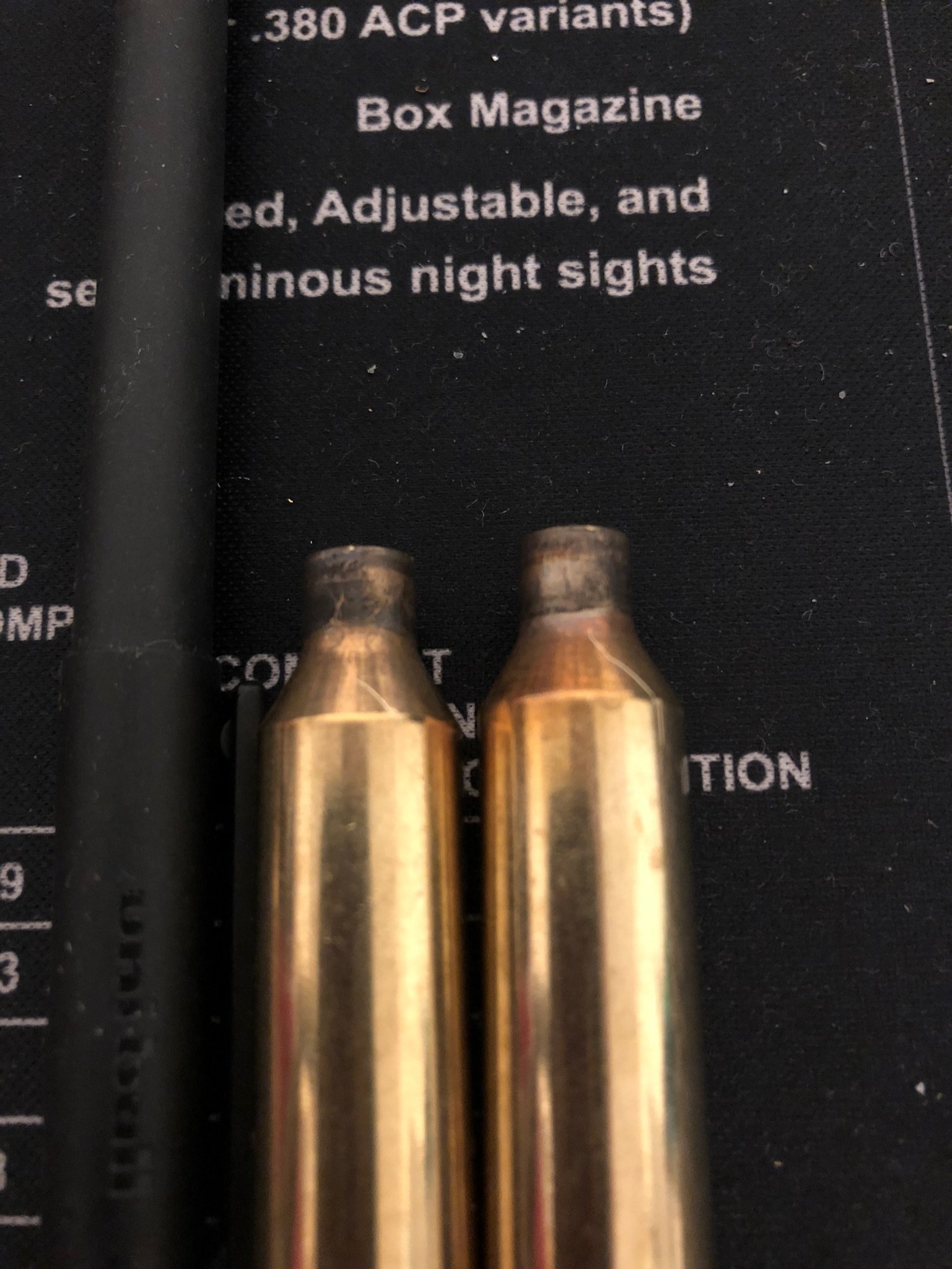

I have a question if that's OK.
I notice that every fired round (only 20 so far) out of my new GAP Crusader in 6.5 PRC has a distinct scratch on the shoulder that starts just below the neck and extends a little ways down the side of the case. It's not very deep - it's mostly cosmetic - but it takes quite a bit of rubbing with 0000 steel wool to remove it. It doesn't happen when I eject an unfired cartridge. I only see it on ejection after firing. I've attached a photo so people can see what I'm talking about. My first thought was maybe there's a tiny burr in the chamber. But I sent the photo to the folks at GAP and asked about it and was told the following:
The scratch on brass is from Ejection, the ejector pushes the casing to the right and it drags the shoulder and neck against the inside of the receiver till it meets the ejection port and flings out of the rifle. It’s normal and every rifle with positive plunger ejection does it and not a big deal it effects nothing in any way.
Based on their response, this appears to be common to rifles with positive plunger ejection. My only other bolt action rifle is a Winchester Model 70 SG in 7mm-08 and I certainly don't see a scratch like this on my fired 7mm-08 brass. But since the GAP Crusader uses the Templar action which I'm pretty sure is based on a Remington action, comparing the two rifles would be like comparing apples to oranges as the saying goes.
Anyway, I was hoping to get some feedback from some of the more experienced shooters here just to be sure this is normal.
Thanks for the help.
Reactions: Yahmus

Seems as ES and SD got lower with a higher charge, however, there were some ejector marks and slight cratering @ 55gr. No Heavy bolt lift, and primers don't look flattened.
Here’s my GAP 8 twist 24” .130FB running new Hor. Brass. ... its a .4-.6” hunting combo when I have my act together beyond 625yds... Im Looking into cooking up a copper load in the LRX variety possibly soon?
