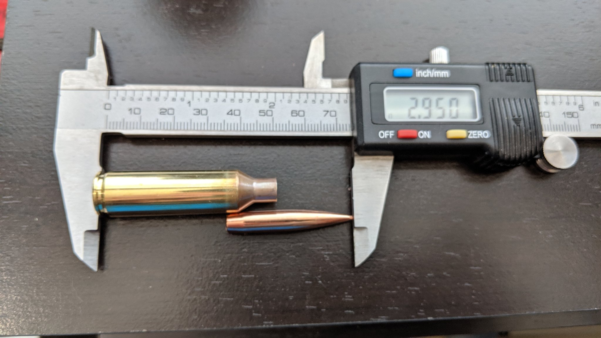

For coal,
I believe factory PRC 147s are loaded to 2.950 and my load with Berger 156 is 3.050
No idea if they would fit or feed in a short mag

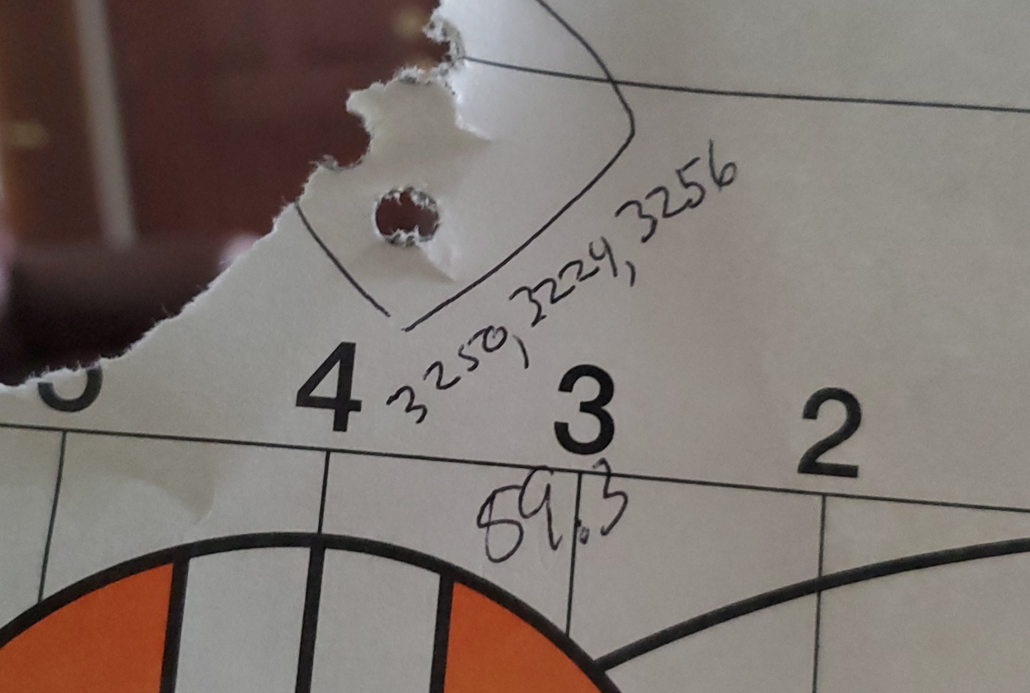

I have a 6.5 prc, 24" cf proof research barrel 1:8 twist built built off of a tikka t3 300wsm action and bolt.
At 59.7 hornady eld 147 h1000, federal primer, hornady brass 3179 fps .20 otl Top picture
At 59.3 barnes lrx 127 h1000, cci primer, hornady brass 3250 fps .20 otl bottom picture. I am working on this one tomorrow

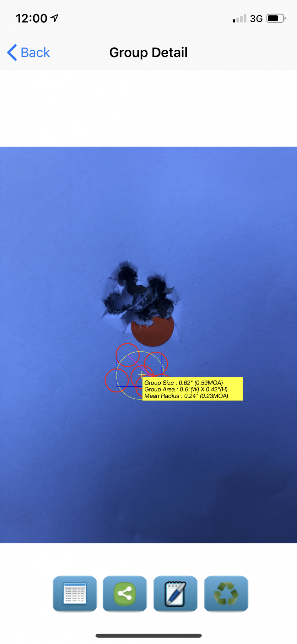

Had another wee play with my prc today. I think I might off lucked out with my barrel as it seems to be a fast one. Tryed 3 slight variations off my load today. All loads was with 147 eld-m. First load was 57.8 grains off h1000 loaded factory length .51 moa 3 shoot group and 3180 FPS. Is a tad warm and getting slight ejector swipe. Federal mag primer
57.6gr .55 moa group and 3150 FPS no pressure sign federal large mag primer
57.8 gr and cci large mag primer .59 moa and slight ejector swipe
So am going to try 5 at 57.5 gr and see how that goes. I’d be happy round 3120 FPS
