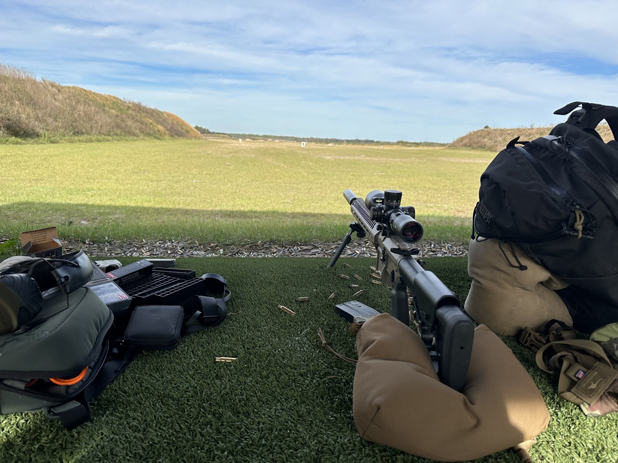

Pretty happy with Gap15 6arc.
100yds with rifle in an RRS Vyce tripod from standing. Hornady 103 eldx factory ammo.

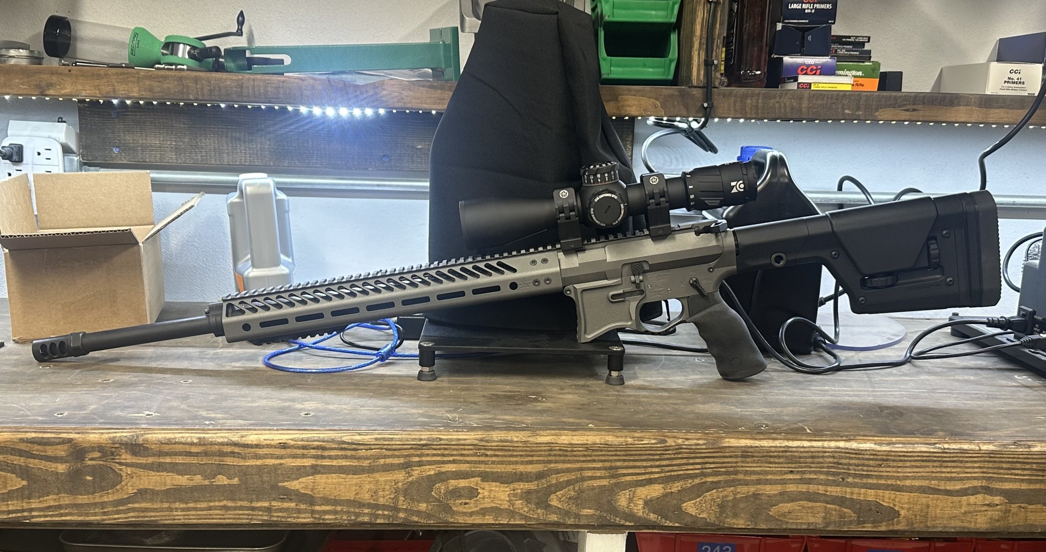

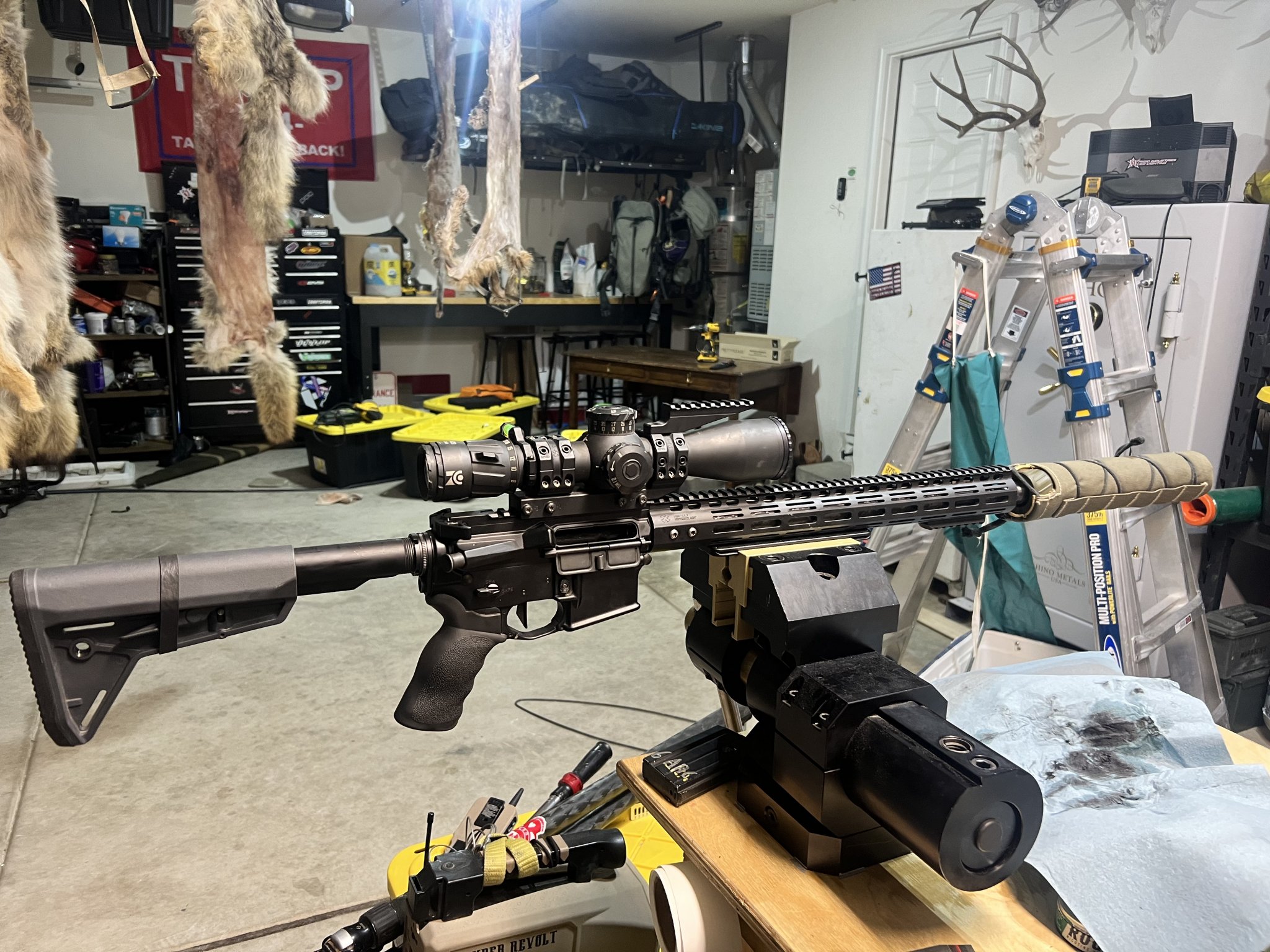

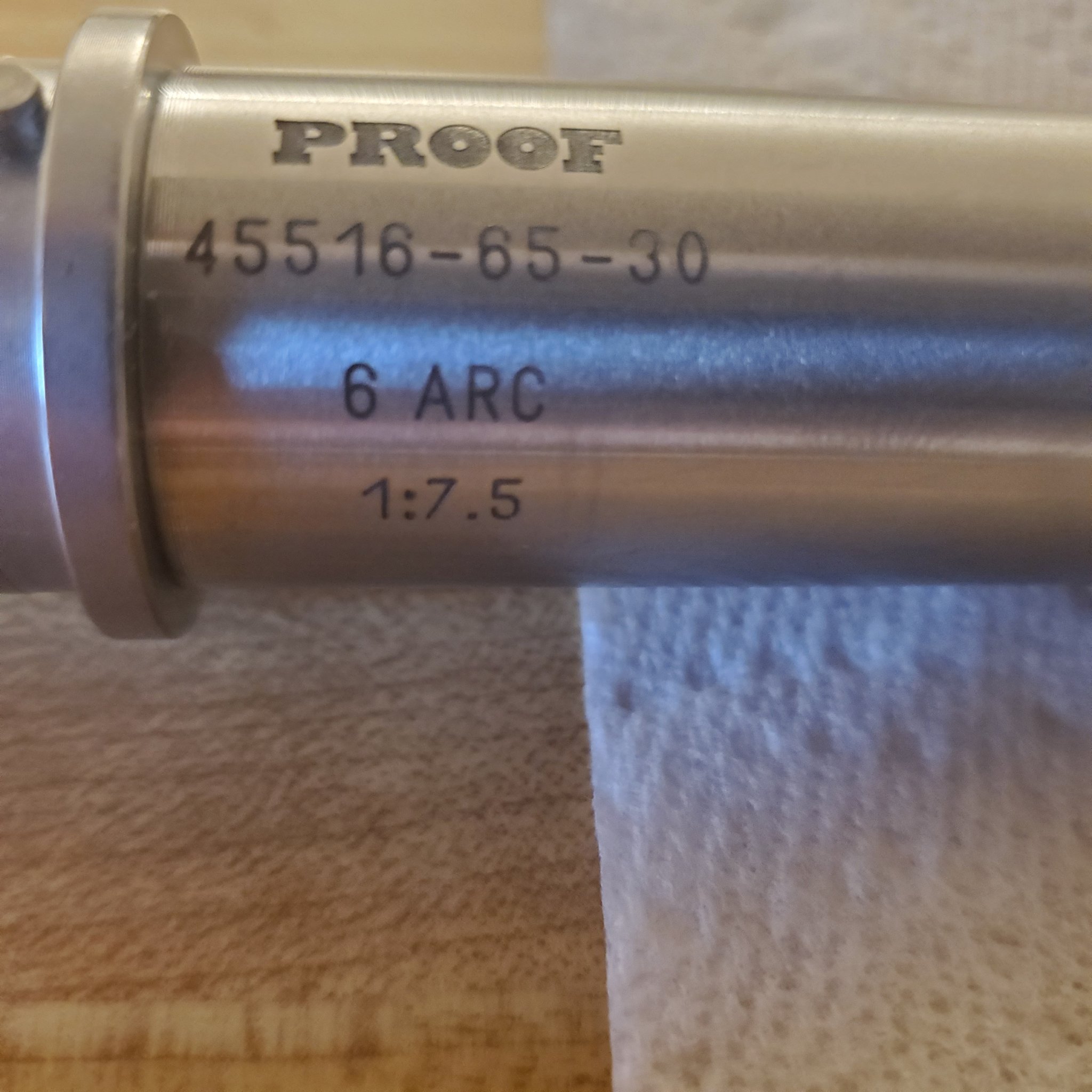

I recently put together a 6 arc for a dedicated coyote rifle. I wanted something that I could get the full potential out of the clip on I run. Kept getting runners or losing dogs with a 223 past 400 yards at night.
Ended up doing a 18" proof on a simple DD upper and lower with a Noveske 16.7" rail.
JP enhanced BCG and silent capture spring.
I wouldn't say I'm disappointed in it. It's anchored coyotes out to 650 at night for me so far, running serria 90 TGKs. I'll take that as a win.

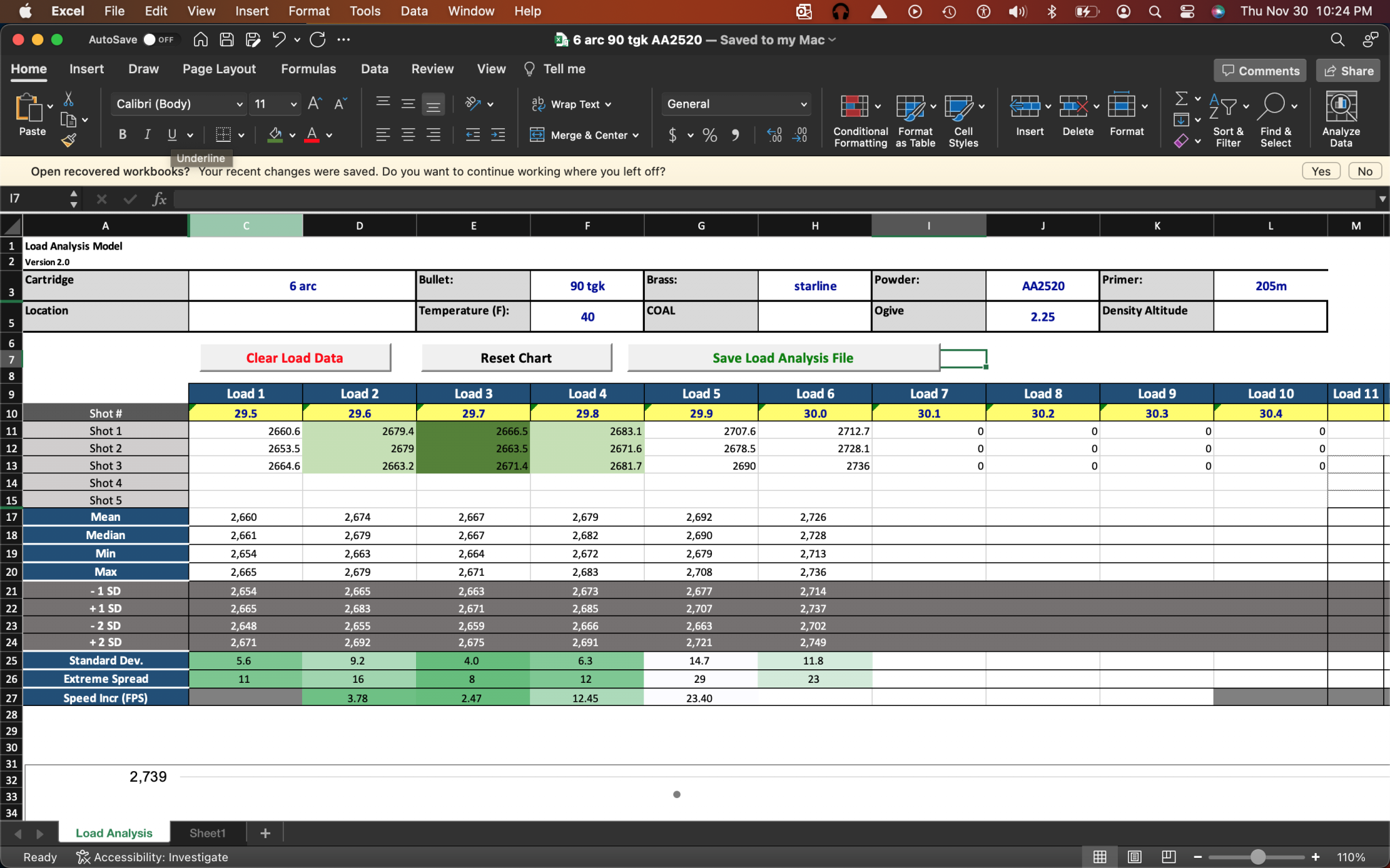

One thing I will say is i am surprised at how slow it is.

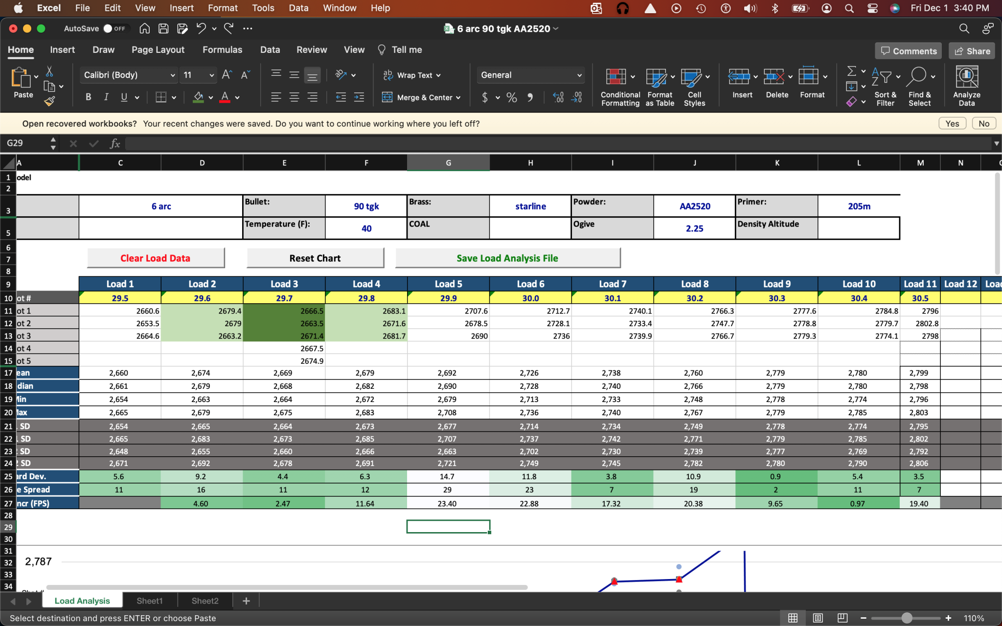

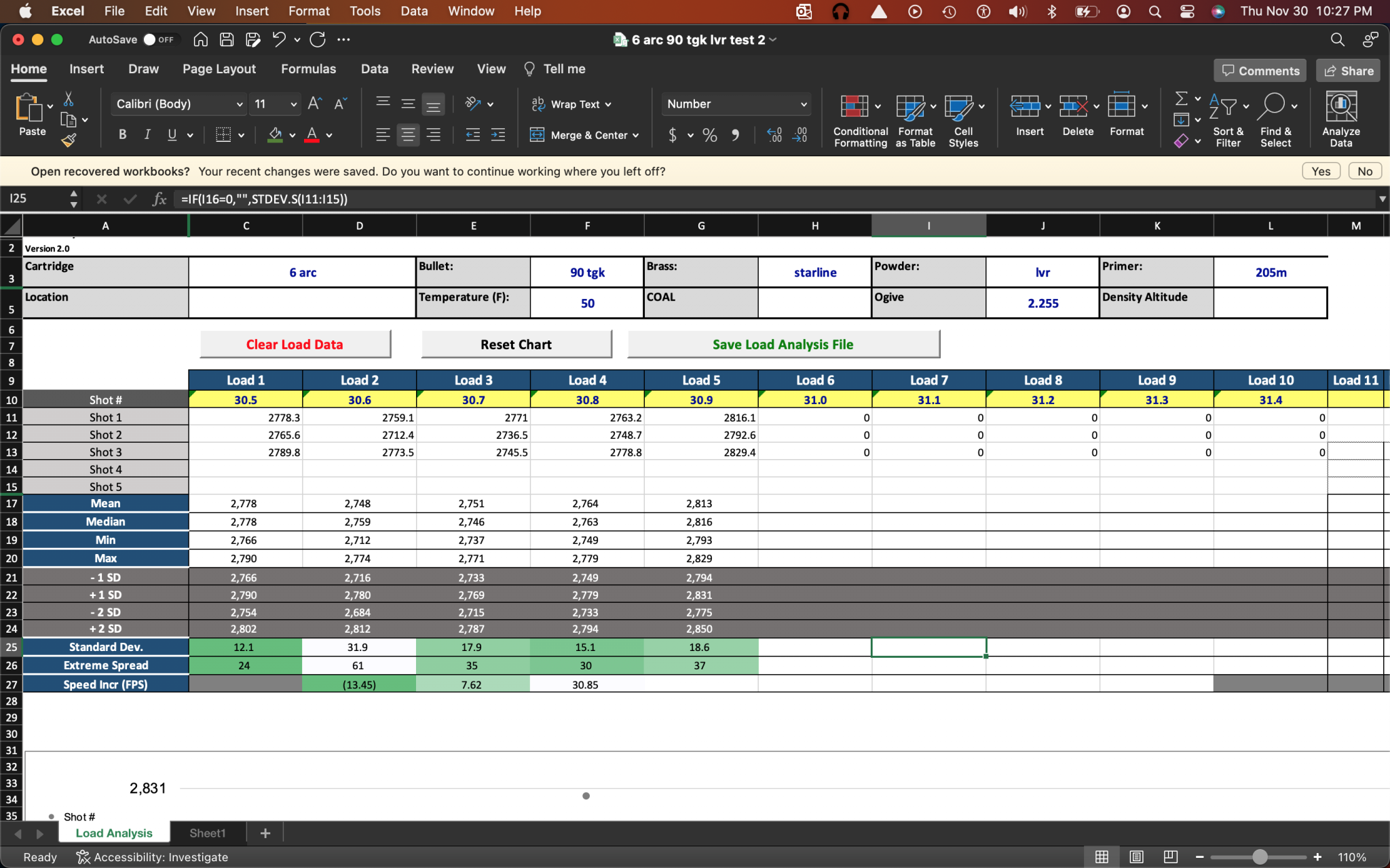

I think part of this is the reduced case capacity on new starline brass. I've tried Leverevolution, cfe, varget, staball match, AA2520, 4895.
LVR was the fastest but ES were insane.(2830) 30 on the low side 60 on the high side. I was able to get 31 grains in there but it was compressed(virgin brass). Still no signs of pressure so I ended up looking at faster powders.
4895 was the best ES/SD and groups but it was slow before pressure. 2600 ish.
Working through AA2520 right now. Seems to be be a good contender so far. ES are good, all under .5MOA easy. 30.1 was (2720)

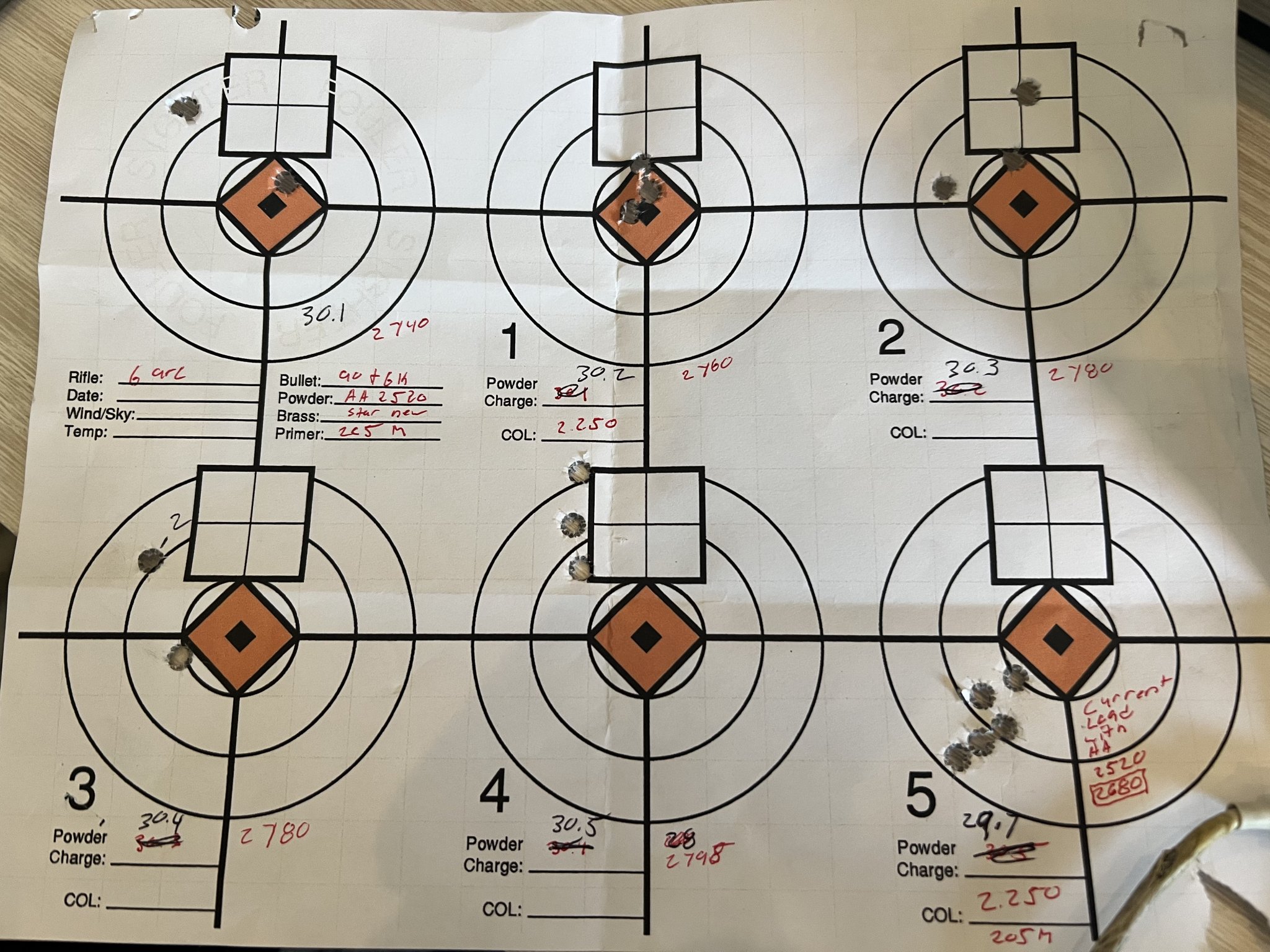

I have some fired brass that I'm headed to shoot tomorrow. I was able to get 30.5 in the virgin brass before it was compressed. Fired fits 31.5 before it compresses. Going to run a pressure test up to that and see where it pressures out at.
Update. Still didnt even come close to pressure on new brass before I ran out of capacity with aa2520. Numbers look promising. Some groups are okay. I think a seating depth test could help with this powder.
29.7 still looks like a solid contender even though its a little slower.
30.2 is a great group but I don't like the groups on either side of it...
30.5 has good numbers and good speeds with no pressure signs still.

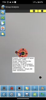

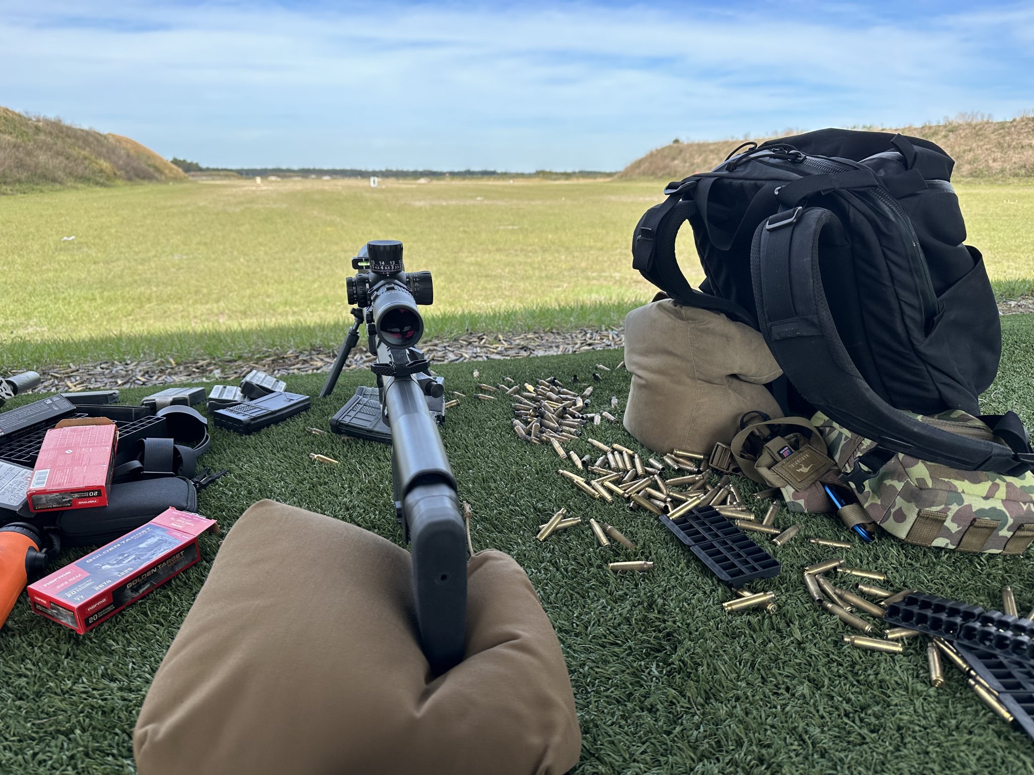

I bought a Seekins 18” 6ARC and after an initial 60 rounds to test some ammo types and get some rounds through it I’m not disappointed so far.
I gave the barrel a light cleaning before shooting it since Seekins shoots a few rounds to tune the gas systems and basically called that the break in. After one sighter I shot a 5 shot group with Hornady black that 3 rounds went through one hole and then two rounds went on both sides but still touching around 1/2moa ish. It also shot great with ELDX but ELDM was around 1MOA.
All but the first 6 rounds were fired suppressed with my TBAC Ultra 7 with no tuning of the gas system and I didn’t find it to be gassy at all. There was very little blow back. I also didn’t find it to be any more dirty than shooting a suppressed 223 with good ammo.
I’ve got a case of ELDX to go stretch it out to distance next week. If that goes as well as I’m hoping it does I’ll be ordering more ammo and also a proof CF barrel to put on my Larue MGU for a lighter weight hunting setup.

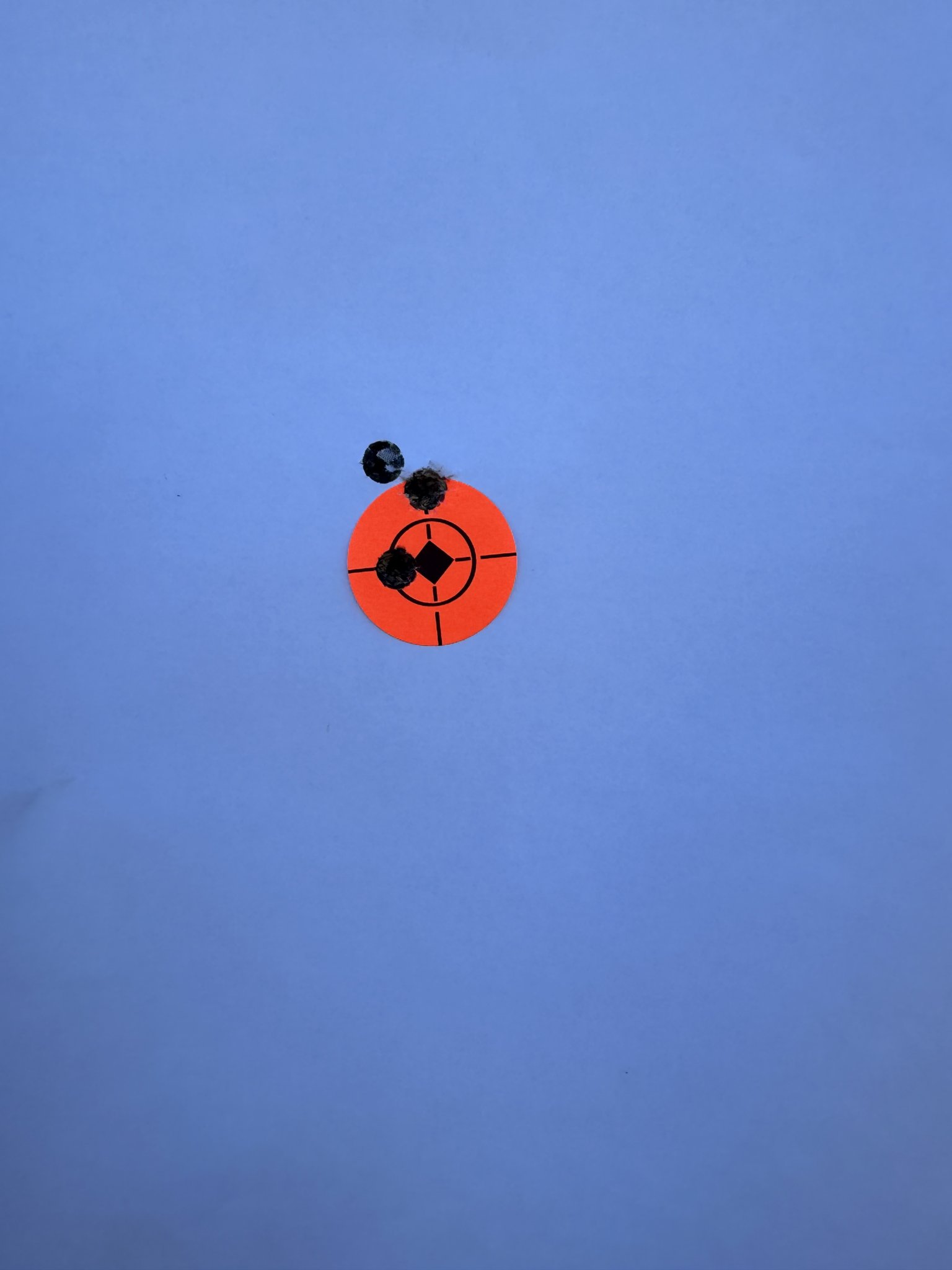

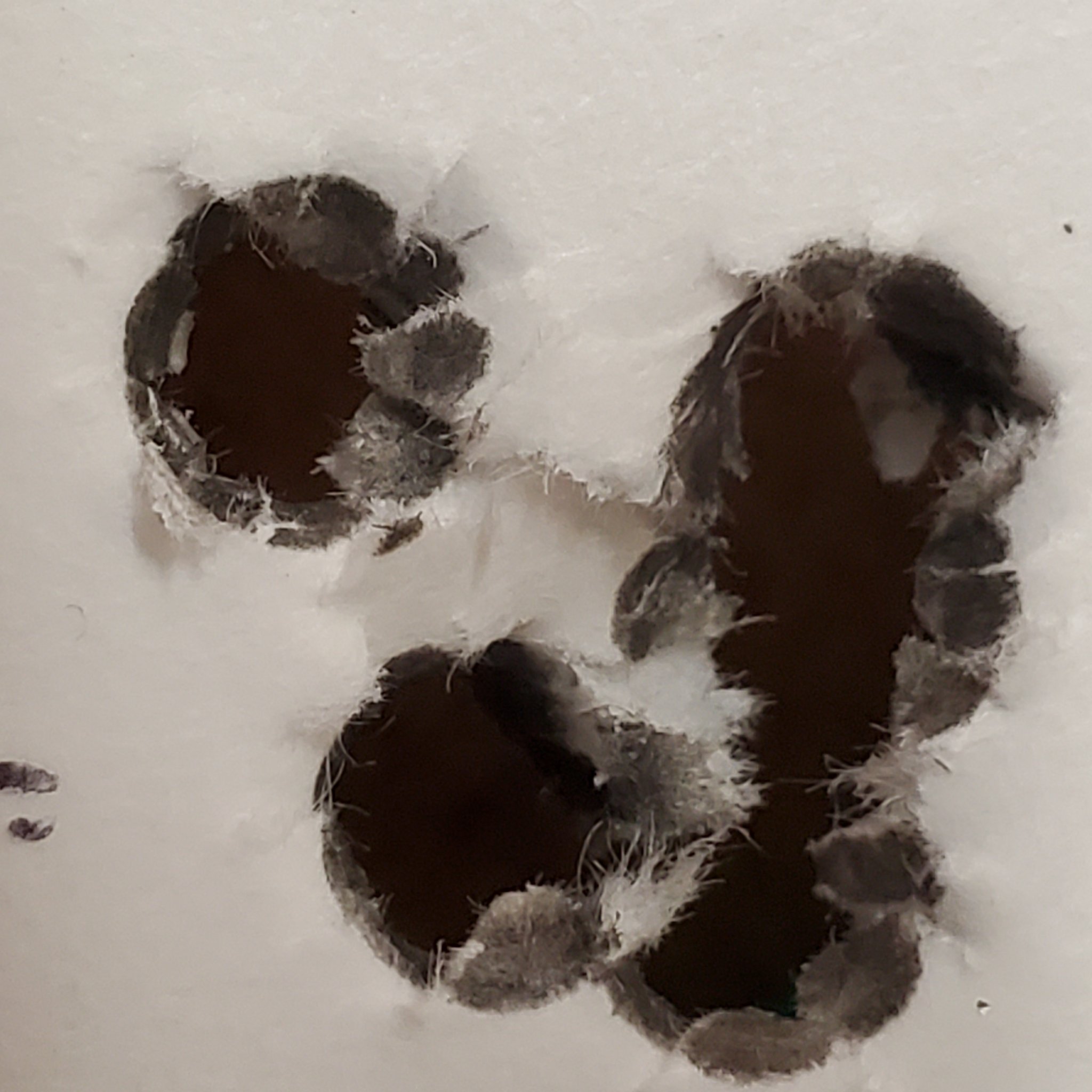

I own a 6mm ARC bolt gun and don't regret it one bit (see below). Matter of fact I love the precision! That said I will most definitely have an upper built for the 22 ARC, no doubt! Will probably have Precision Firearms build me a Neptune MOD8.

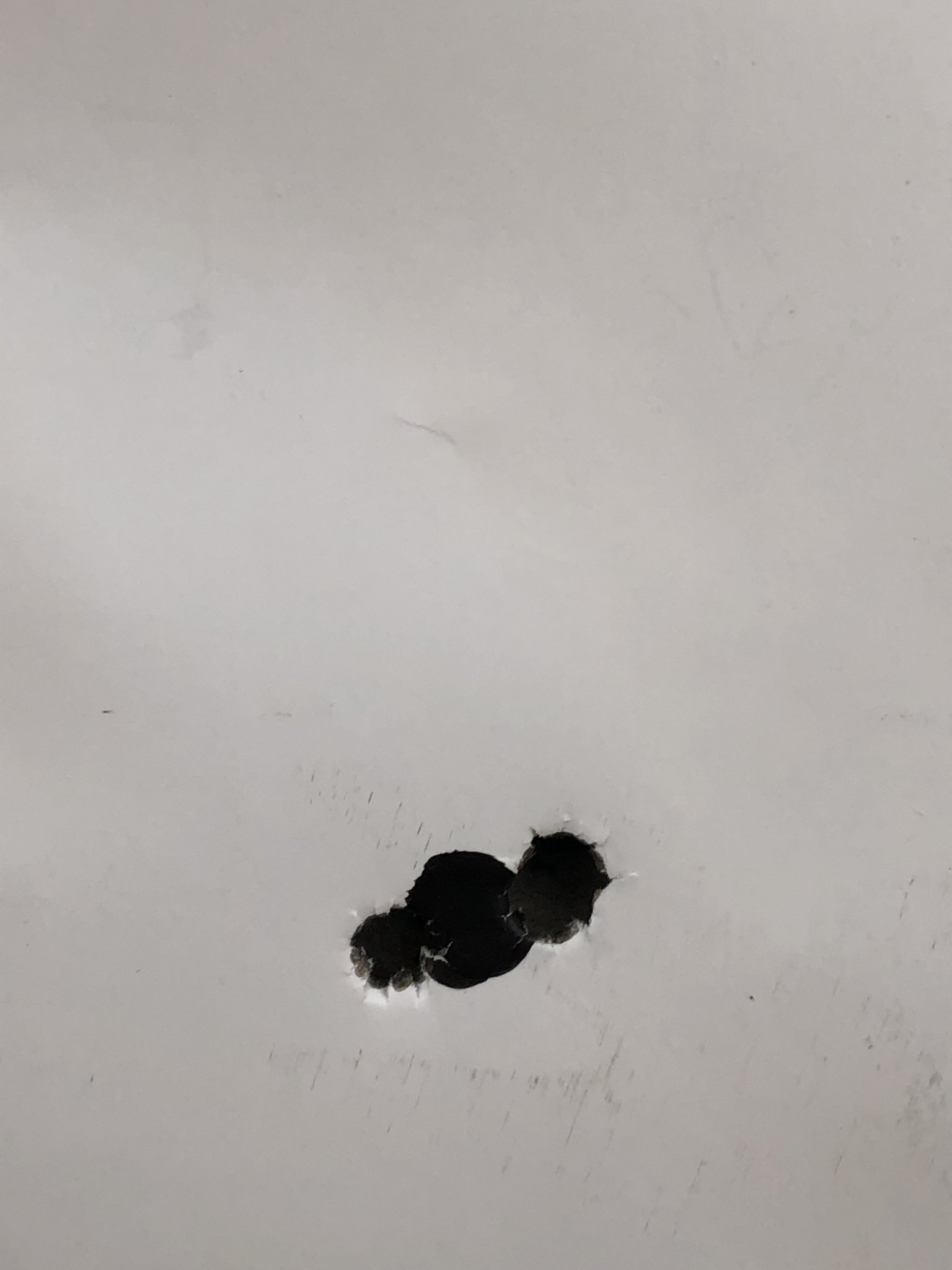

My best 3-shot groups with the 6mm ARC at 106 yards this last Friday WITH - Factory Ammo - (1/4 MOA target). Gotta love those Mean Radius #'s:

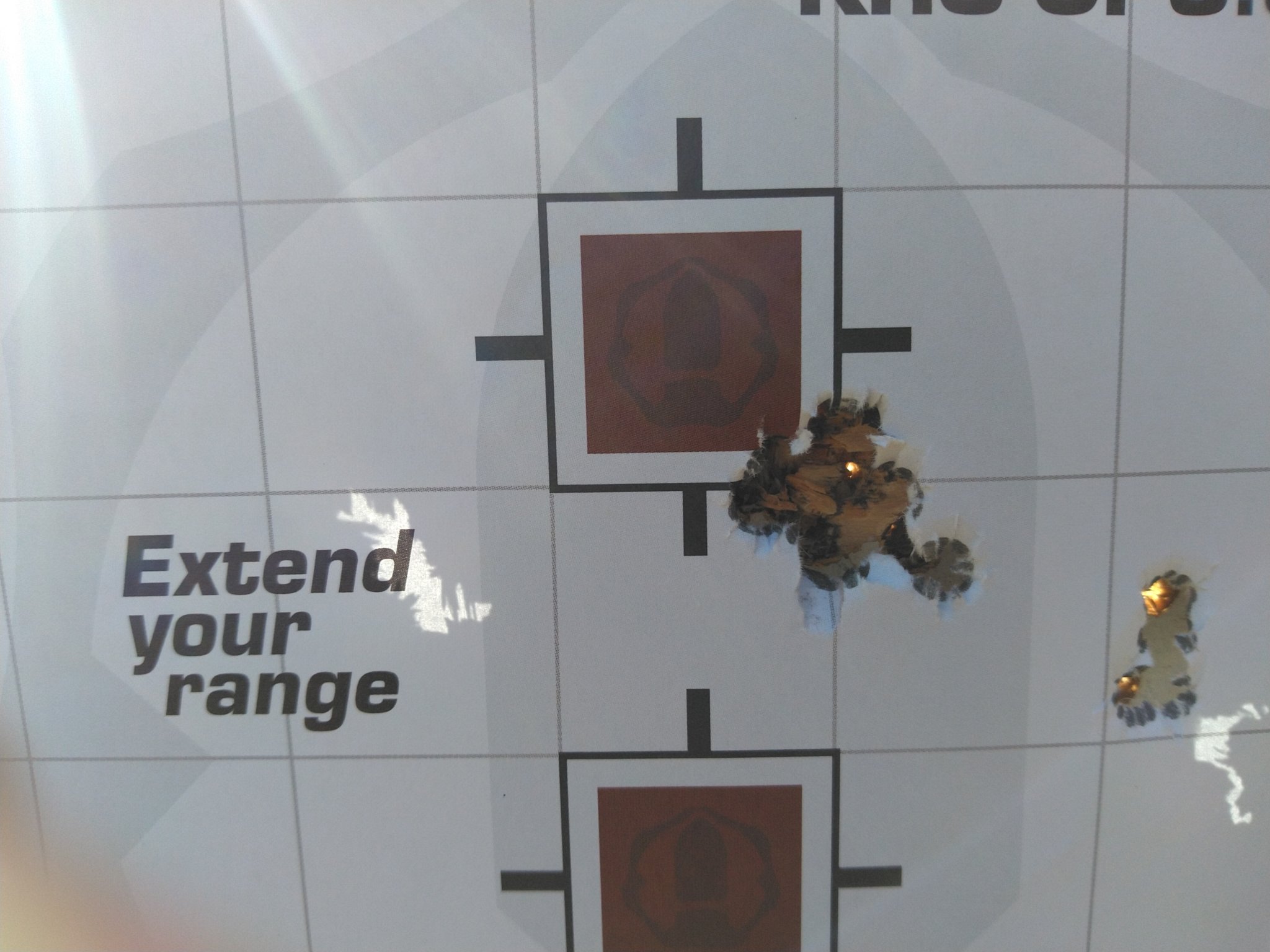

That was the first groups I shot through my 6ARC. I shot a recent lot of Hornady 6ARC and can’t keep it under 1.5”. Seems the ammo wasn’t the most consistent.
What load are you shooting? I just got recent lots of all 3 and the Black and ELDX cut little knots like that picture but the ELDM was .9XX for the best group and 1.1-1.2 for the other 3.

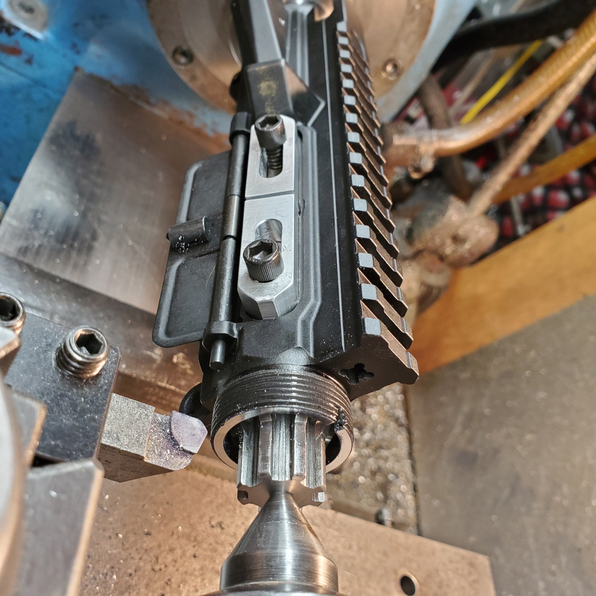

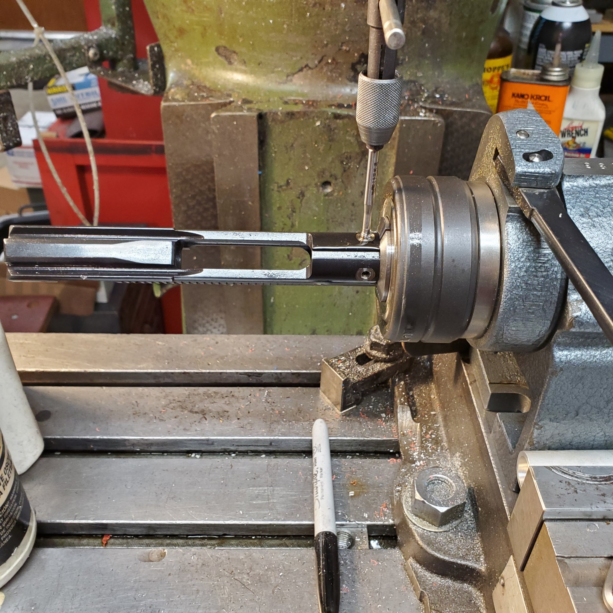

This is part of what I do to make my Proof Research 6mm ARC barrels shoot 5 shot 1/2" groups, or less. Notice this reciever was out of square, center the bolt carrier, glue in with high temp green bearing sleeve loctite. Wax reciever where barrel extension slips in for easier removal of barrel. Tighten barrel nut to 60 ft/lbs, mill slot in barrel for gas tube if necessary, but do not over tighten. Some like 48 ft /lbs. I perfer 55 to 60 ft lbs...maybe this will help, with Proof barrel inaccuracies in AR platform.

I went out the JTAC yesterday with @Mike Casselton and shot it as far as 1200 yards with the ARC. If I had more 108 ELDM’s I would have stretched it further and I bet it would have smacked 1500. I only had one box of ELDM left (only bought 2 to try) and shot it at 400, 800, 1000, and 1200. I went 3/3 at 1200 on annd IPSC (not sure what size) and had 2 hits on a 4” plate at 800 with switching wind so needless to say I was pretty impressed, especially doing it with factory ammo. Assuming the .9-1.1” groups at 100 with the ELDM load the other day wasn’t just a fouled new barrel (entirely possible and pretty likely) I don’t know why they were shooting so well at distance but they were. It was much more consistent than the ELDX and Black and distance both of which shot knots at 100. The 105gr Black shot like ass beyond 400 yards.
The ELDX was pretty much automatic to 800 and it was easy to self spot misses and hits to that distance. At first it kinda sucked beyond 800 yards and I couldn’t get a hit on the 4” at 800… until I took my can off. I don’t know why it started shooting better beyond 800 after that, but it did. Maybe the barrel sped up since I was about 180-200 rounds in at that point and SD’s tightened, maybe it was harmonics, I don’t know. I had 60 rounds of ELDX left I had found in my bag after shooting my 223 so I swapped the optic back over and it was much more consistent at 800+. I got several hits on the 4” at 800and was laying hate consistently on the IPSC at 1000. Sometimes semi rapidish fire. I don’t recall if I tried 1200 again with the ELDX’s or not.
I brought my 223 too which is the identical Seekins rifle (18” DMR) with 100ish rounds of the varget 77gr SMK loads I loaded years ago for another rifle and 40 rounds of Norma. There was a significant difference in how much easier it is to spot hits and misses with the ARC even at 400 yards. I had to swap optics and did a dirty zero on a partial size IPSC at 200 and went to 400, 800, and then 1000. I couldn’t see the 500 and 600 from where I was shooting. My second shot at 800 smacked the 4” and I hit it one or too more times. I went to 1000 and went 4/5 on the IPSC there. The load is subsonic around 850 or so. I tried the 77gr Norma and couldn’t hit shit beyond 400. Not sure what was going on but it was ass.
I didn’t notice any difference in the ARC pushing me off target after a shot than the 223, I call it a wash. I’d even call hit ratio out to 1000 yards basically a wash. The main difference out to 1000 was just how much harder the ARC hits the plate making it easier to call hits and how much more earth it kicks up on a miss.
All in all I was very impressed by its performance and it’s the first Grendel based rifle I’ve had that hasn’t been disappointment. I need to get some more ELDM and do some testing but I’d say this rifle is here to stay. These Seekins rifles are stupid accurate and a value for what they cost.
Thank you. I appreciate the advice.
In this recent case, I used a VLTOR MUR upper. I did not lap the receiver face, at the advice of Chad from SOTAR who told me that if the lapping tool had any resistance inside the upper, it shouldn’t be used as it may risk removing material from the upper interior. In lieu of that, I followed the Joe Carlos method…using steel shim and green loctite to bed the barrel to the upper, then torque wrench install for the barrel nut, muzzle device, etc.
My other proof is significantly better in performance than this one (just not significantly more impressive than other barrels I own that cost a good amount less), however the barrel extension to receiver fit was similarly sloppy…different brand receiver, and I used permatax Indian head gasket shellac (at proof’s advice) to bed the barrel to the upper.
