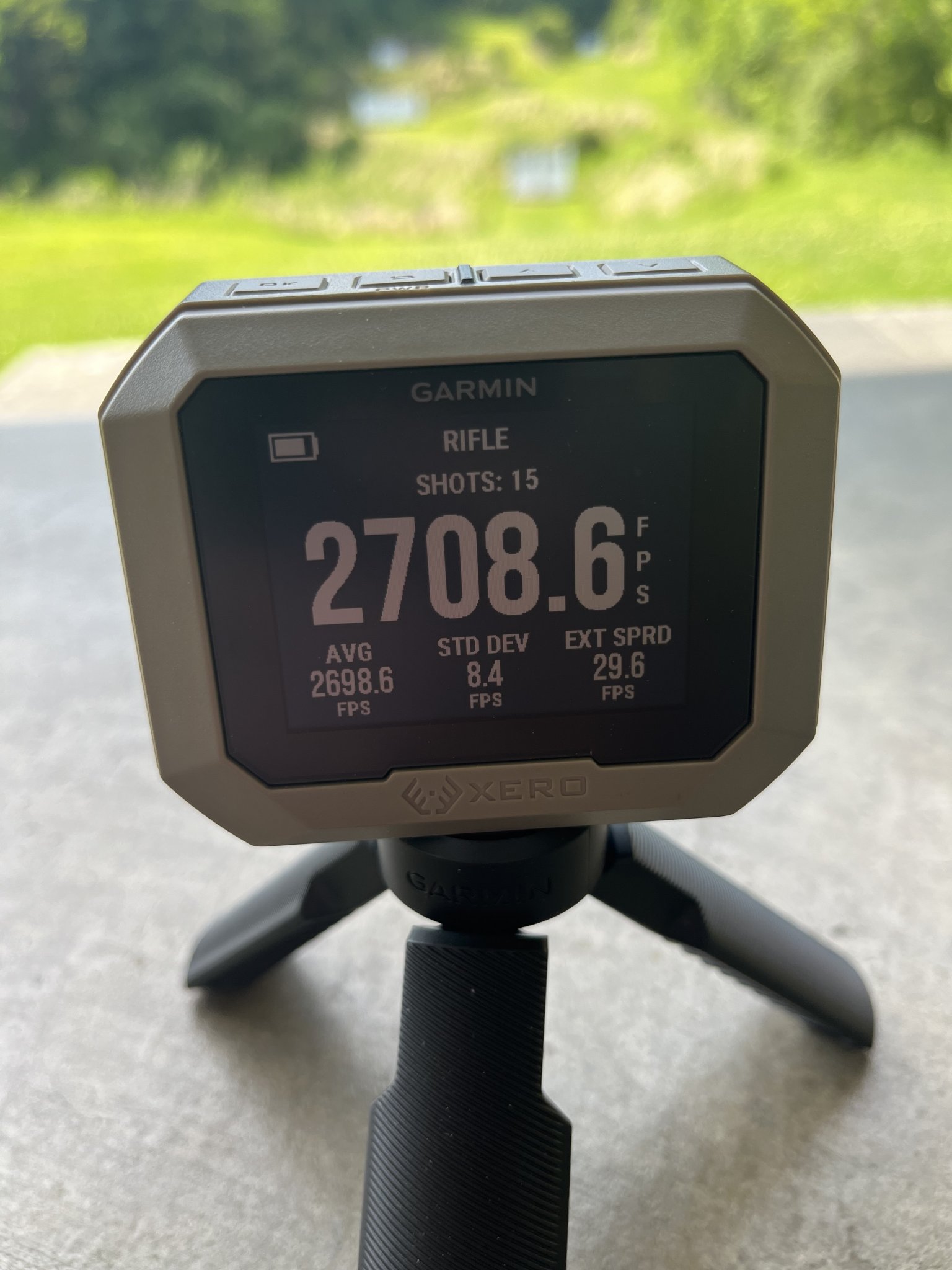

I first noticed something was going on with my 12” and 90gr TNT factory ammo clocking 2698fps avg.

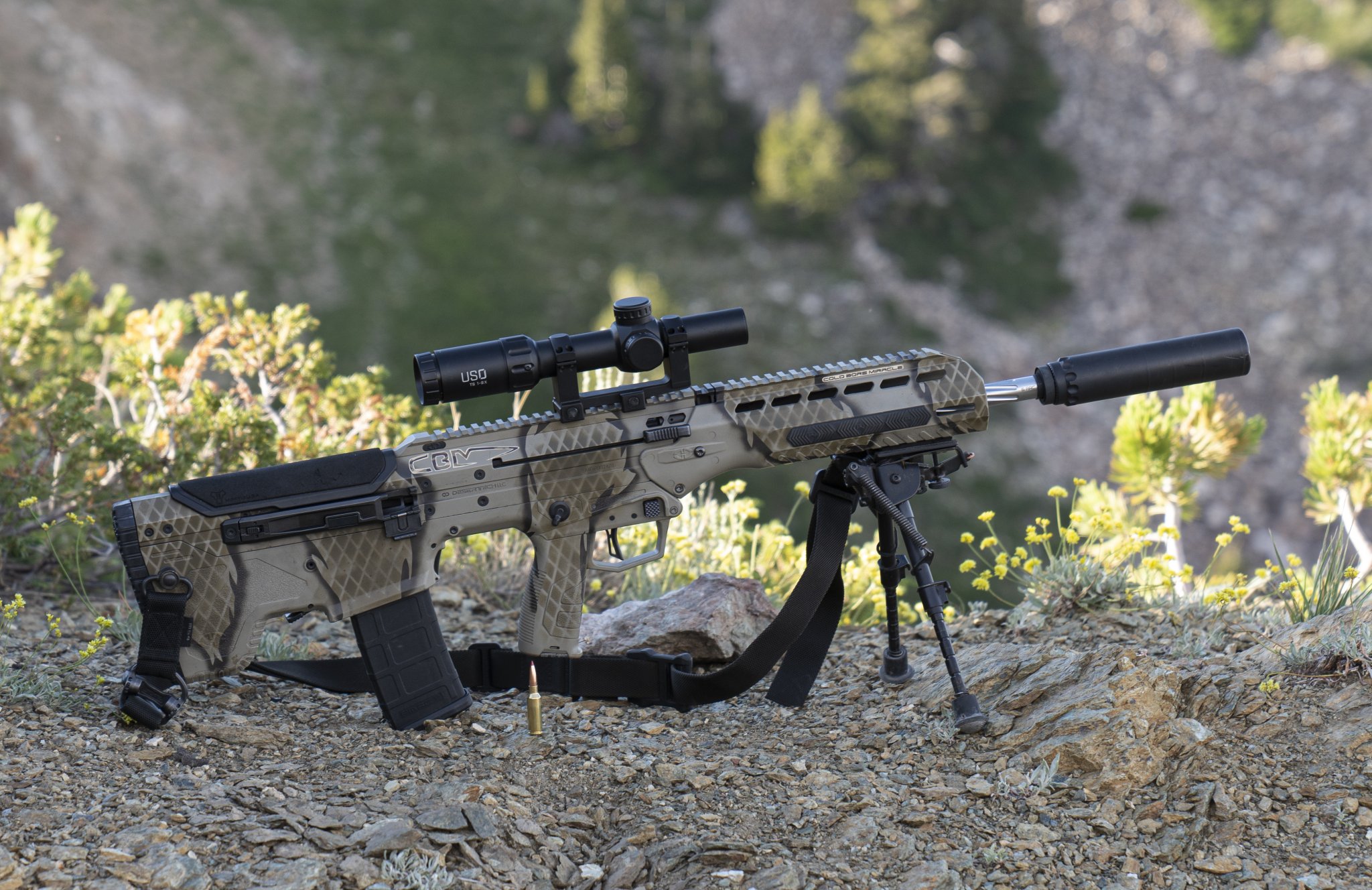

Shooting report from this weekend to compare the 6 ARC and 6.5 Creed gassers.
6 ARC Particulars
  • 18” Proof barrel (Ti suppressor)
  • Mark5 2-10 TMR
  • Factory Hornady 108 ELD M @ 2560fps (likely shoot the 80 ELD VT as they become available)
6.5 Creed Particulars
  • 18” Criterion SS barrel (Sandman S)
  • Mark5 3.6-18 CCH
  • Factory Norma 130 HPBT @ 2650fps
A few days back I took the 6 ARC to 780y in 10-20mph winds and bits were difficult. However, I was shooting off a tripod sitting so not totally a knock on the ARC. Target was a 33% IPSC target, I think I went 1/8 in varying winds (I’m not a master at reading wind by any means). 450y on the 33% IPSC was no problem, I think I went 4/4.
Today I took the 6.5 CM out and the 6 ARC to see how they compared (shooting both off a bipod and bag). Got a first round hit on 12” steel at 780y and more steady 10mph wind with the 6.5 CM. Moved to the 33% IPSC and went 3/5 as the wind was starting to vary (pretty cool to hold 1 MIL and impact, feel wind die and get an impact with a 0.5 MIL hold). Grabbed the ARC and went 2/4 at 780y in the same wind (very similar holds, wind was a little calmer).
After the first day shooting off the tripod, I was a little concerned with the ARC, but today just confirmed for me that I need to do more tripod work at distance. The 6.5 CM gets to 780y with less drop (0.6 MIL, but the ARC has a 50y zero while the Creed has a 100y zero), 20% less wind drift, and 50% more energy. Both were very easy to make impacts with at this distance.
Really liking the 6 ARC for yotes and general distance shooting out to ~750y (as far as I’ve taken it). I’m very curious to find the limits of each system; I’ve not found it for either yet
ETA: I left the “easy button” at home - a Terminus Zeus QC with a 22” 6 CM barrel slinging factory 108’s at 2900fps (Mark8 3.5-25 TMR)

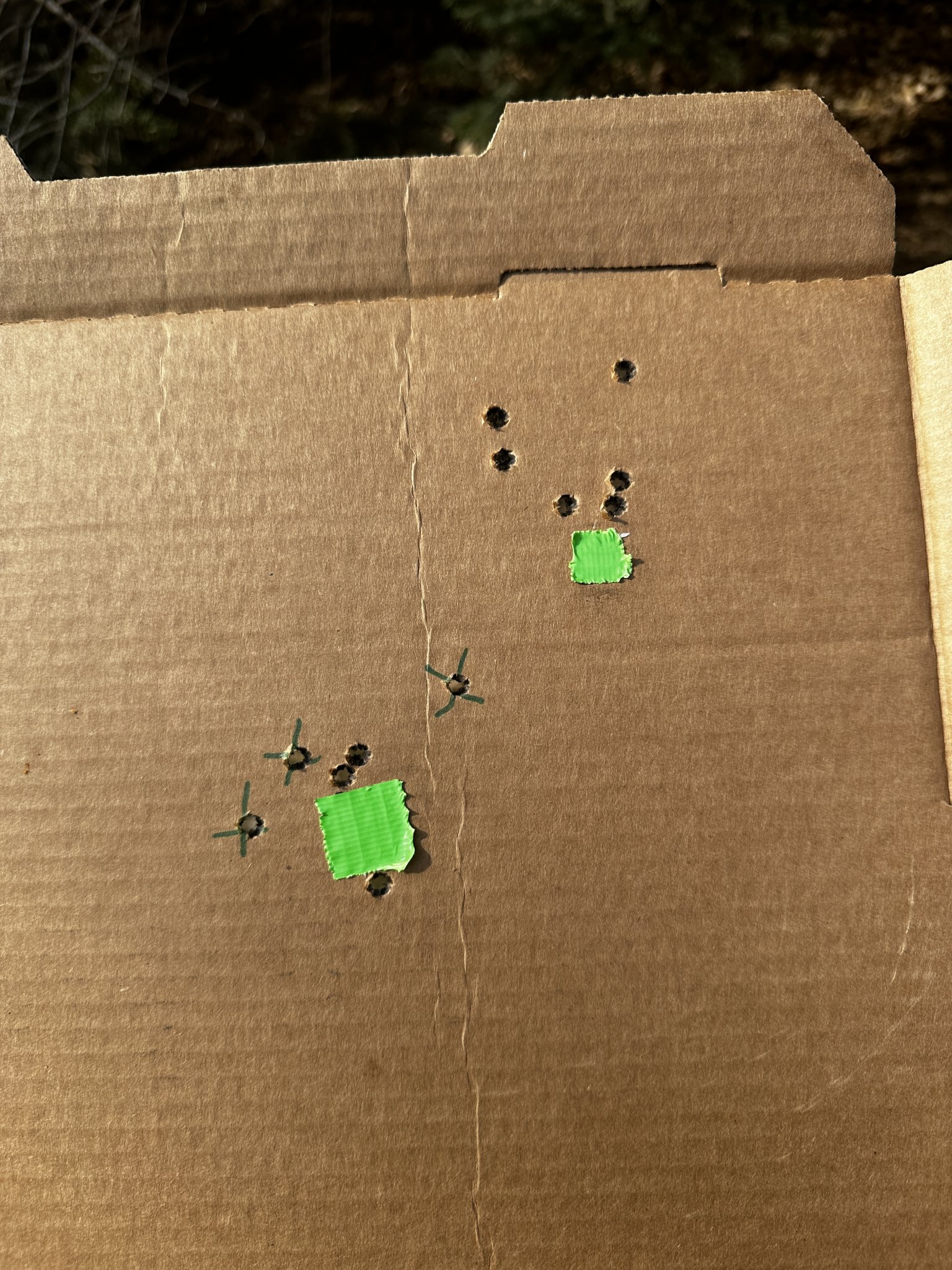

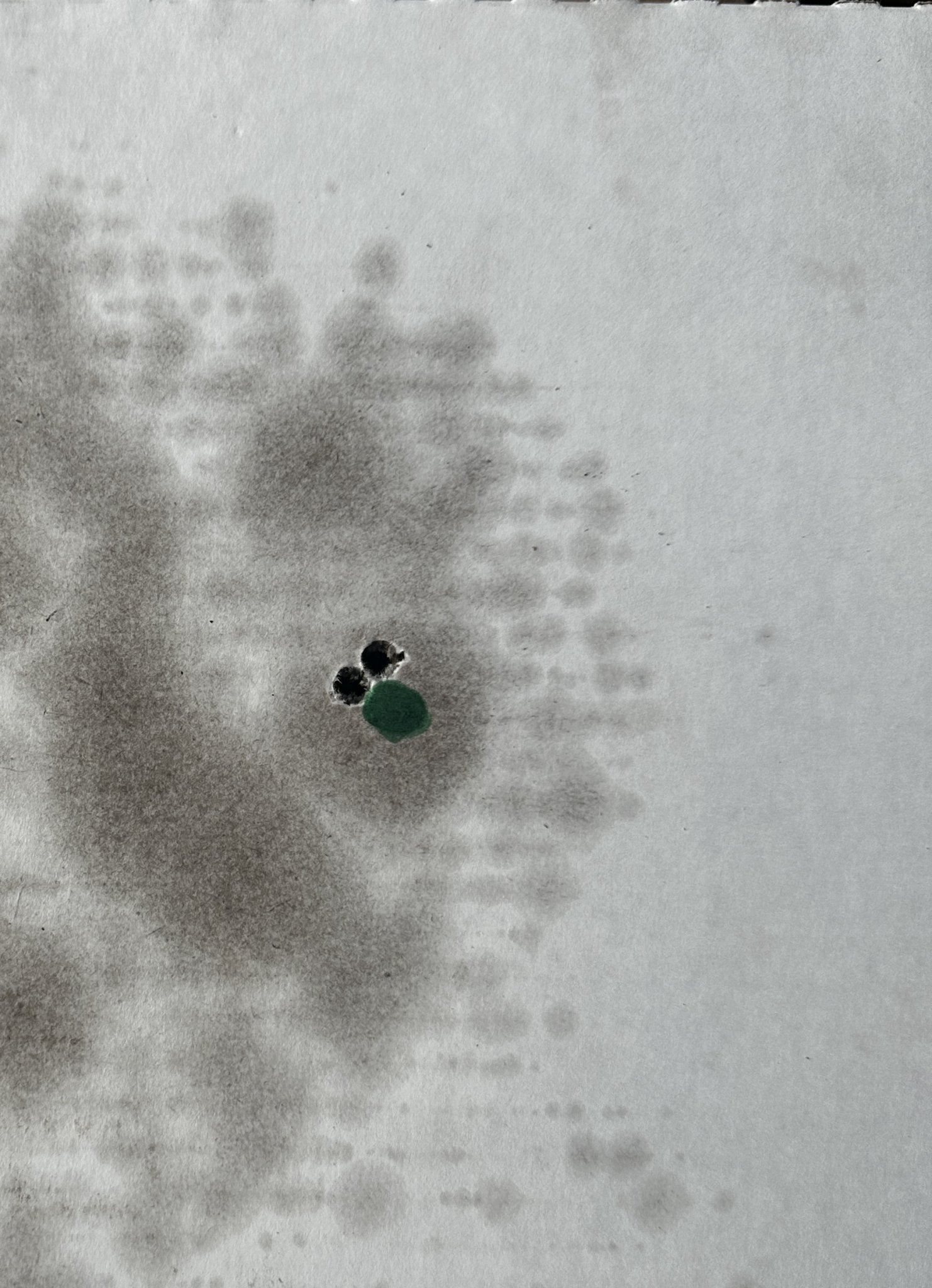

80gr VT's grouped better than expected once suppressed and the rifle ran like a top, no feed or FTE issues, very happy.
Reactions: TonyTheTiger
108’s are right at 1 MOA or better for me but the 80’s were 2-2.5 MOA for me. ES on the 80’s was 70 with an average of 2860 out of my 18” proof SS.
I’ll foul the barrel a little more to see if the 80’s settle in (cleaned after the first 150 today before shooting). The pic below is shots 2-13 after cleaning. Final group was upper right. Followed up with a MOA group of 108’s an hour later (burned the box before I took a pic).
However, the 80’s out of my 22” 6 CM (proof SS) shot awesome; that barrel shoots really well too so I was happy with the 2 stacked 0.1 MIL above POA. 3144 fps on both those shots

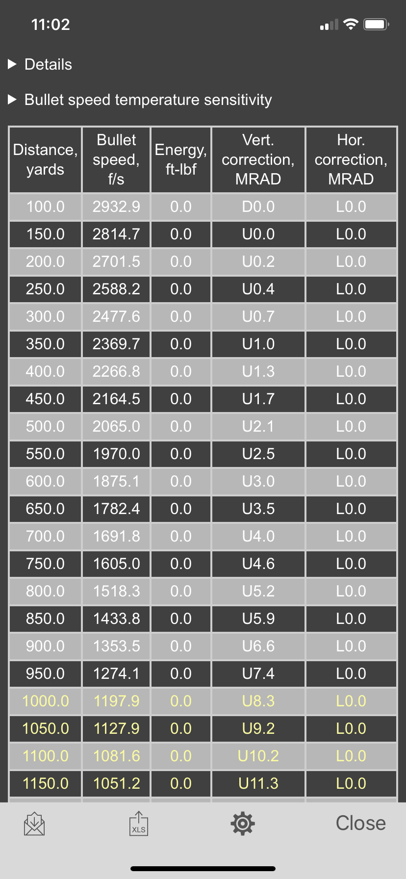

Yes, factory 80 ELD VT's for both 6 ARC and Creed.
The 80's in the Creed are kinda cheating, with a +0.4 MIL zero at 100y I'm 1 MIL hold at 400y and 1.7 MIL at 500y (still over 2000 fps at 500y)
  • Wow
Reactions: Tex68w and 357Max

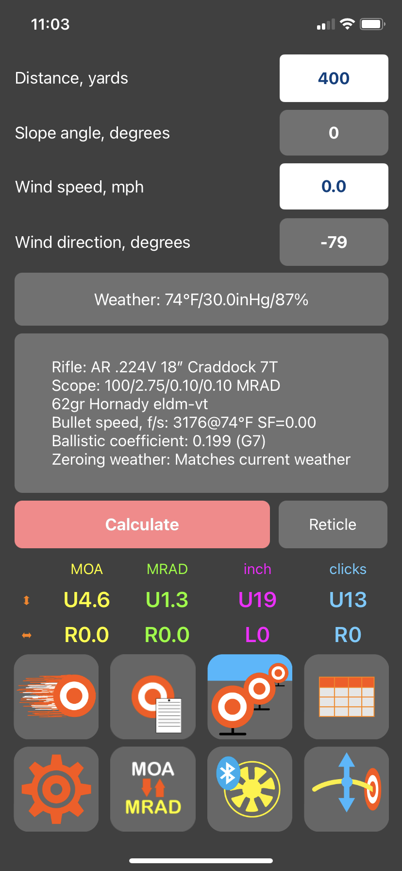

Yep crazy flat. Here's the 18" Valk zeroed @100. 400Y Per Strelok Pro. The 62 is pretty damn impressive.
This shows why I need 3100+ from the 80 vt's in the 6ARC. Hell the barrel is 4" longer & the Valk still might kick it's ass.
62VT = .199 G7
80VT = .206 G7
6ARC needs 3150 to hang with the Valk +-.1 mil to 950 Supersonic.
Reactions: rlsmith1

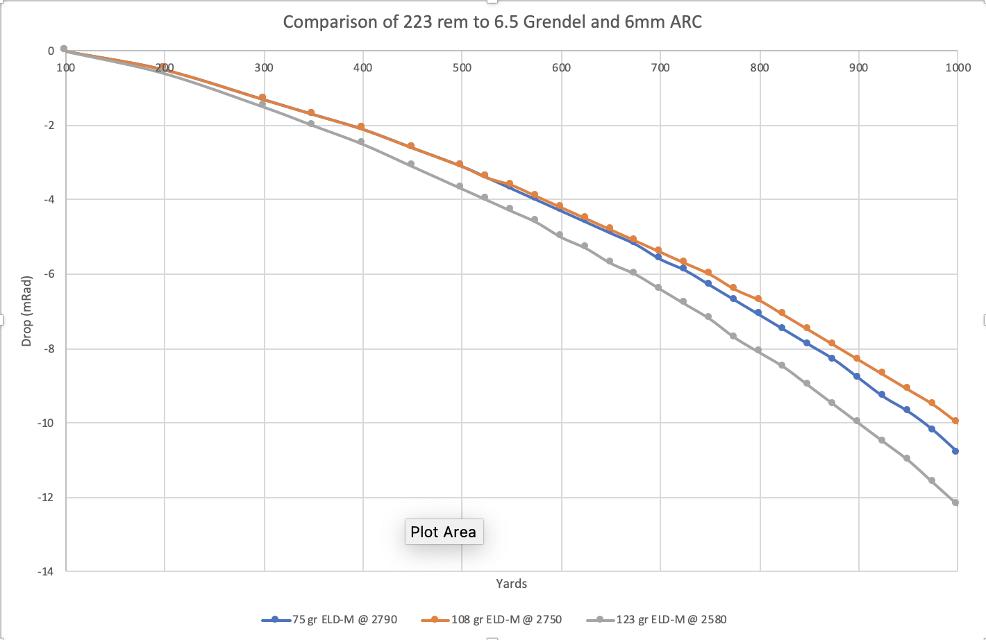

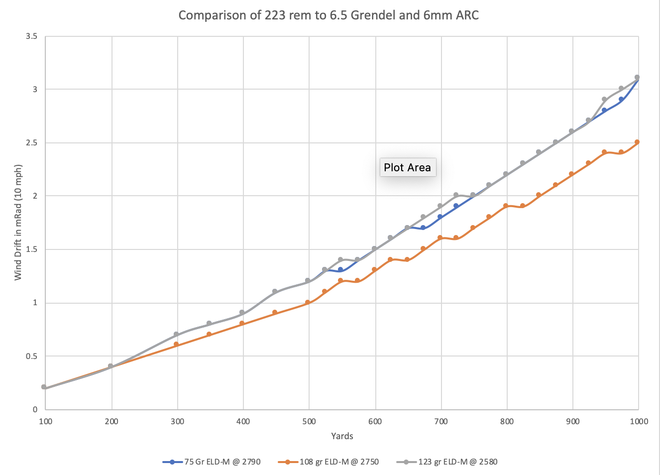

I pretty much completely lost interest in 6ARC when they released the print. 22ARC/Grendel is plainly superior and the handload are cheaper.
Before the release of the 6ARC, the choices for a long(ish) range cartridge in an AR using factory ammunition were 223Rem/5.56Nato and 6.5 Grendel. Forget the wildcats and forget 22 ARC. They don't exist. The advantage of the 6.5 Grendel over the 223 is not in drop or drift, but that it brings 64% more mass (75 gr vs 123 gr) to the party while still having reasonable ballistics. The 6mm ARC has less drop and drift than either the 223 or the 6.5 (comparing the 108 ELD-M), while only being ~12% lighter (comparing 108 to 123).

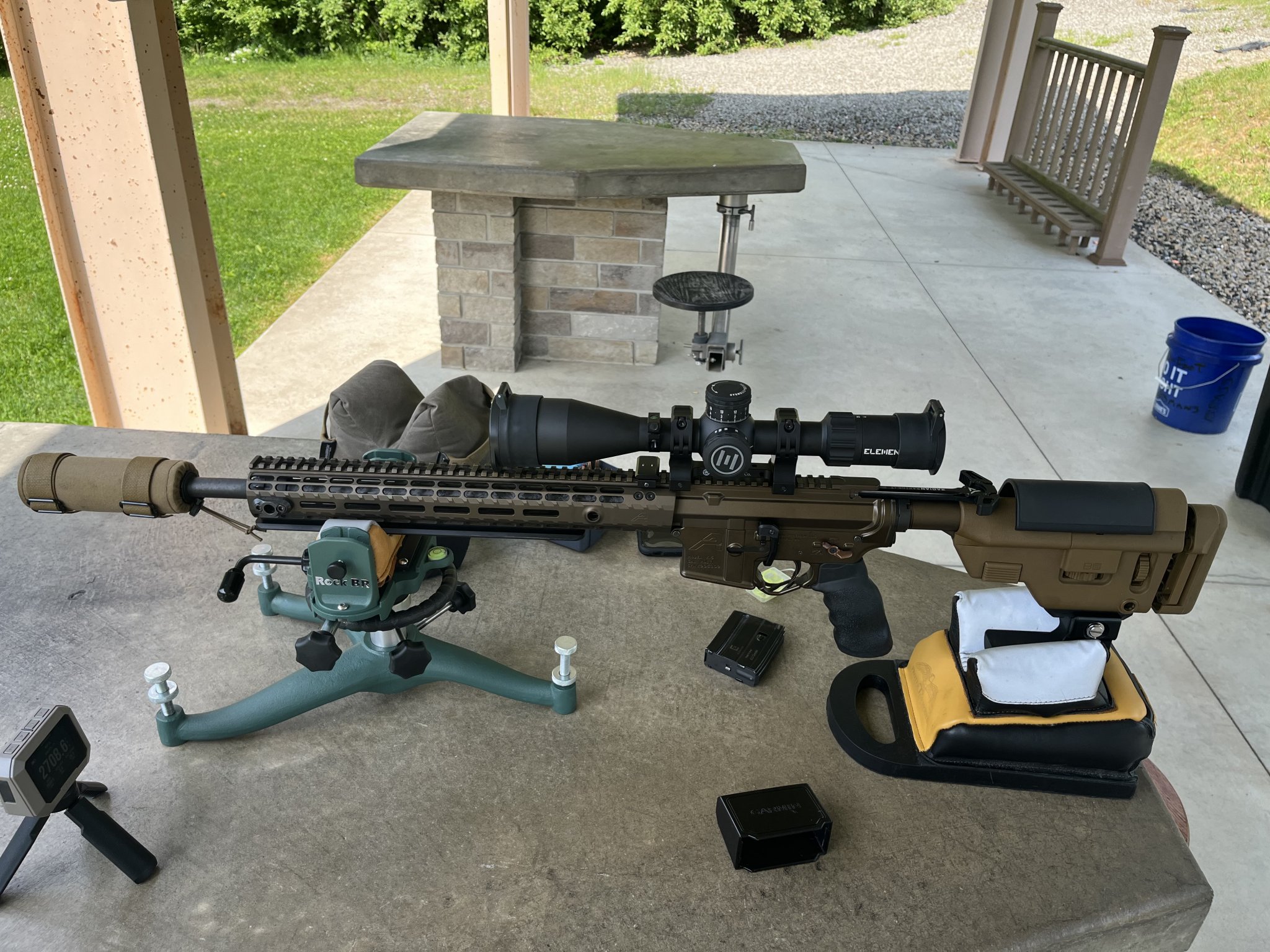

My 6 ARC BA barrel, in a factory Areo upper, was a poor performer with 2" to 2.5" for 5 shots at 100 yds.
I assembled an upper with Proof barrel and a few accuracy techniques and came away with a .5" 5 shot group shooter, at 100yds.
Scrapped the BA barrel and bought another Proof barrel, it too is a .5" shooter too....and sometimes much less.
I've had great success with Proof barrels.

18” Proof barrel abruptly sped up at 250 rounds. Same load - 29 gr of lever, CCI 450 primers, Hornady brass, 108 eldm 50 thou off lands.
85 degree day so that helps some with the lever powered being temp sensitive, but not complaining one bit.
