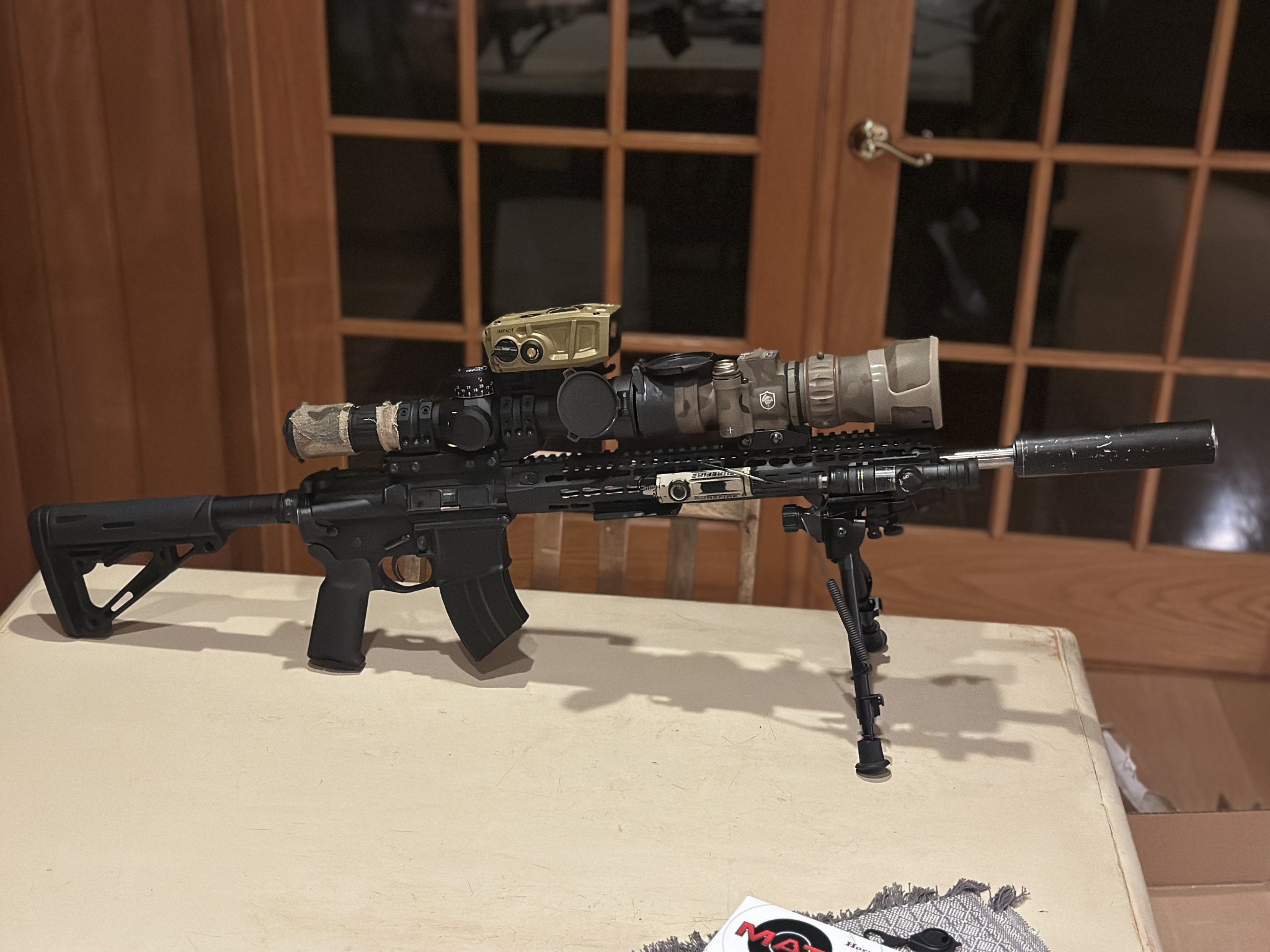

ETA: pics of the rifle!

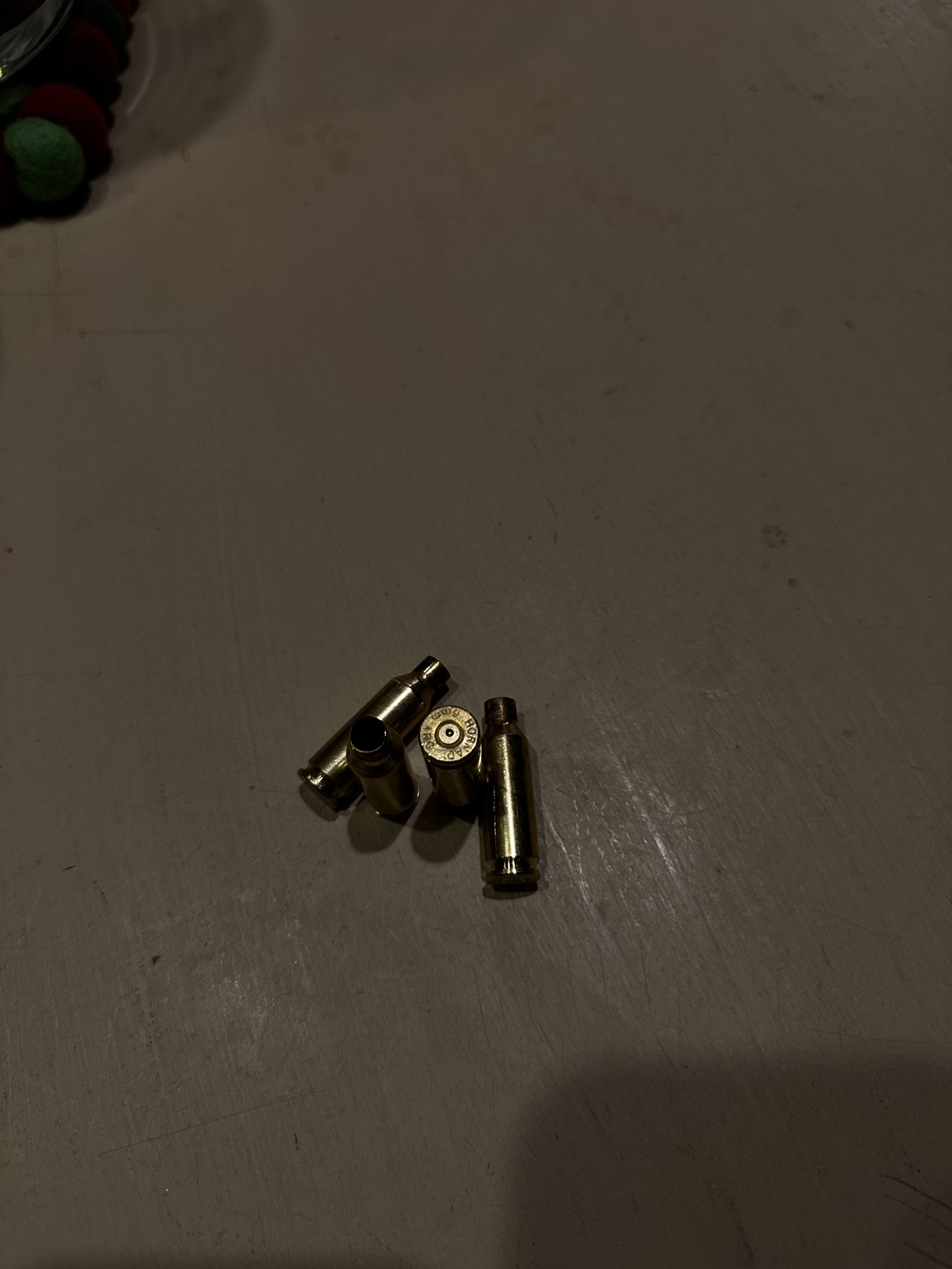

Brass: see attached

There’s nothing that looks odd on the brass that I can see from the picture.

That brass looks kind of rough to me but it's hard tell anything from such a bad picture. I would wonder about pressure since it wiped Y in hornady all the way off the case. A picture of fired and unfired in a well lit area might help. Handloads or factory ammo?

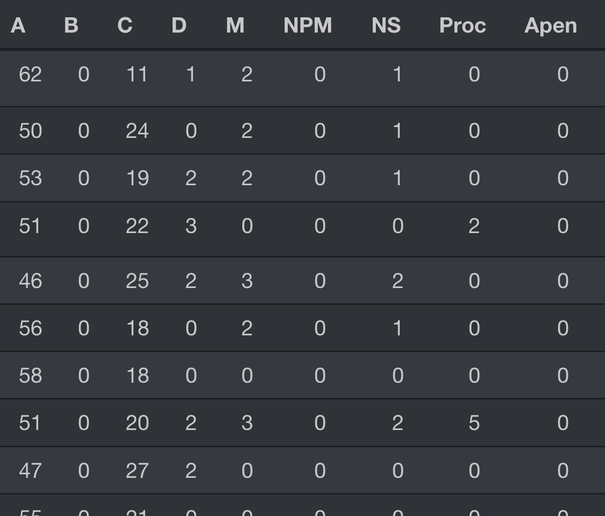

Hey, no offense. USPSA is fun. But, it’s speed shooting at pretty close range. I went to one (my first) a couple of months ago. And, I’m going to hit some more in the new year. You are absolutely correct that the top shooter also made the most hits. And not shooting fast, even when you are making hits will tank your score for sure. Here are the top 9 scores (well the breakdown of their shots). 1 and 2 were the same shooter, open pistol and PCC.
Based on what I see here, I spent too much effort on making good hits. I could have probably placed higher if I had shot closer to the ragged edge of my meager abilities.
There was a youth shooter borrowing a PCC from one of the match organizers. Taping one of the shooter’s targets, the pcc owner said “see how tight this group is? That means you’re not shooting fast enough.”
Fast shooting can most certainly make up for Charlies and a miss.
3 misses, 2 no shoots, and 5 procedurals finished 8th…
Edit- There was also a guy in our squad that was burning down every stage without regard for the target. He actually turned to the RO and said “I’m not shooting at the target” before ripping off the required rounds as fast as possible. He had a reason, but it was some “rules lawyer” stuff that didn’t make sense to me. I was focused on keeping the muzzle pointed down range, not DQing, and making as many A zone hits as I could. I didn’t have anything left for the intricacies of scoring.
