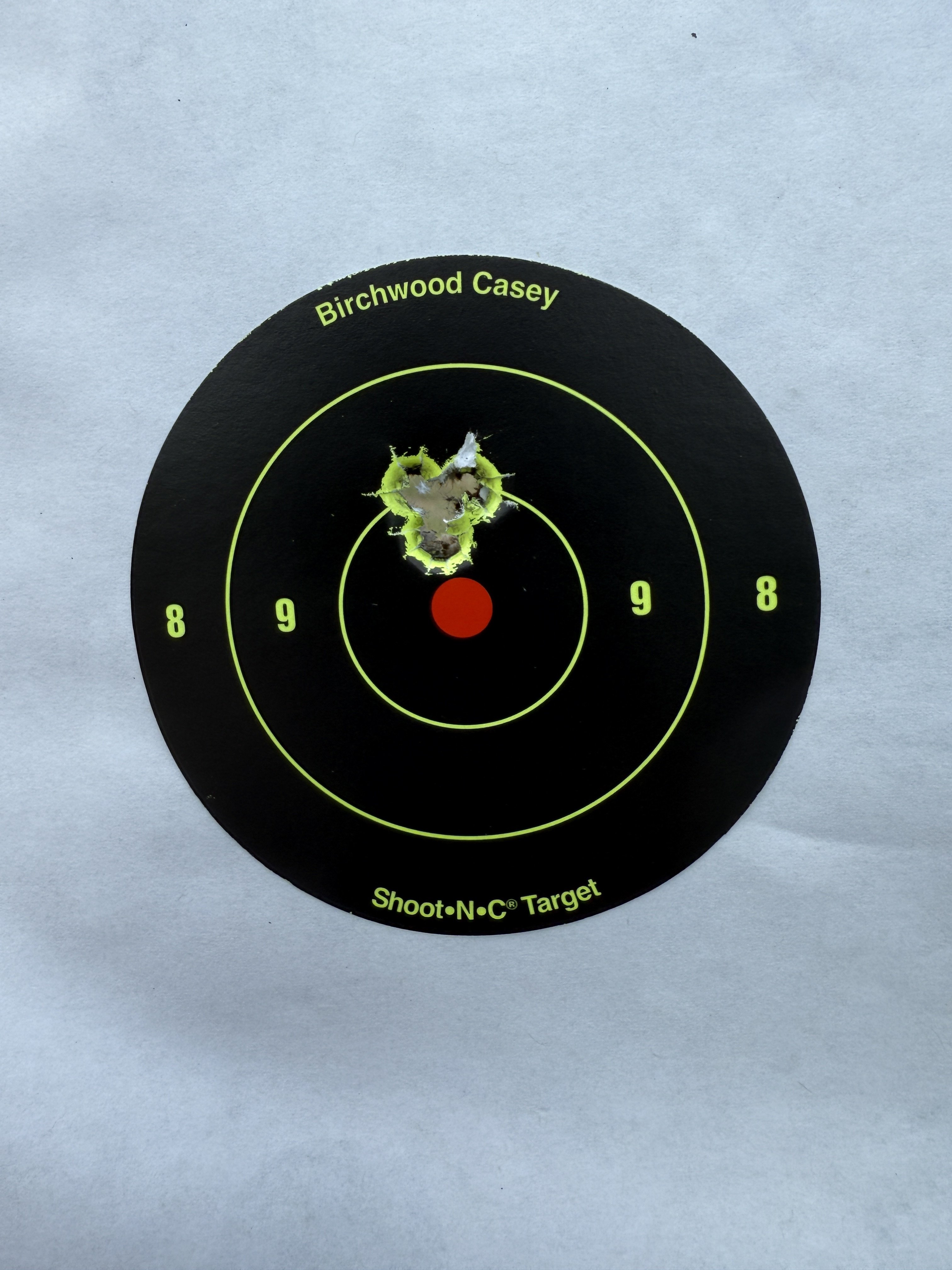

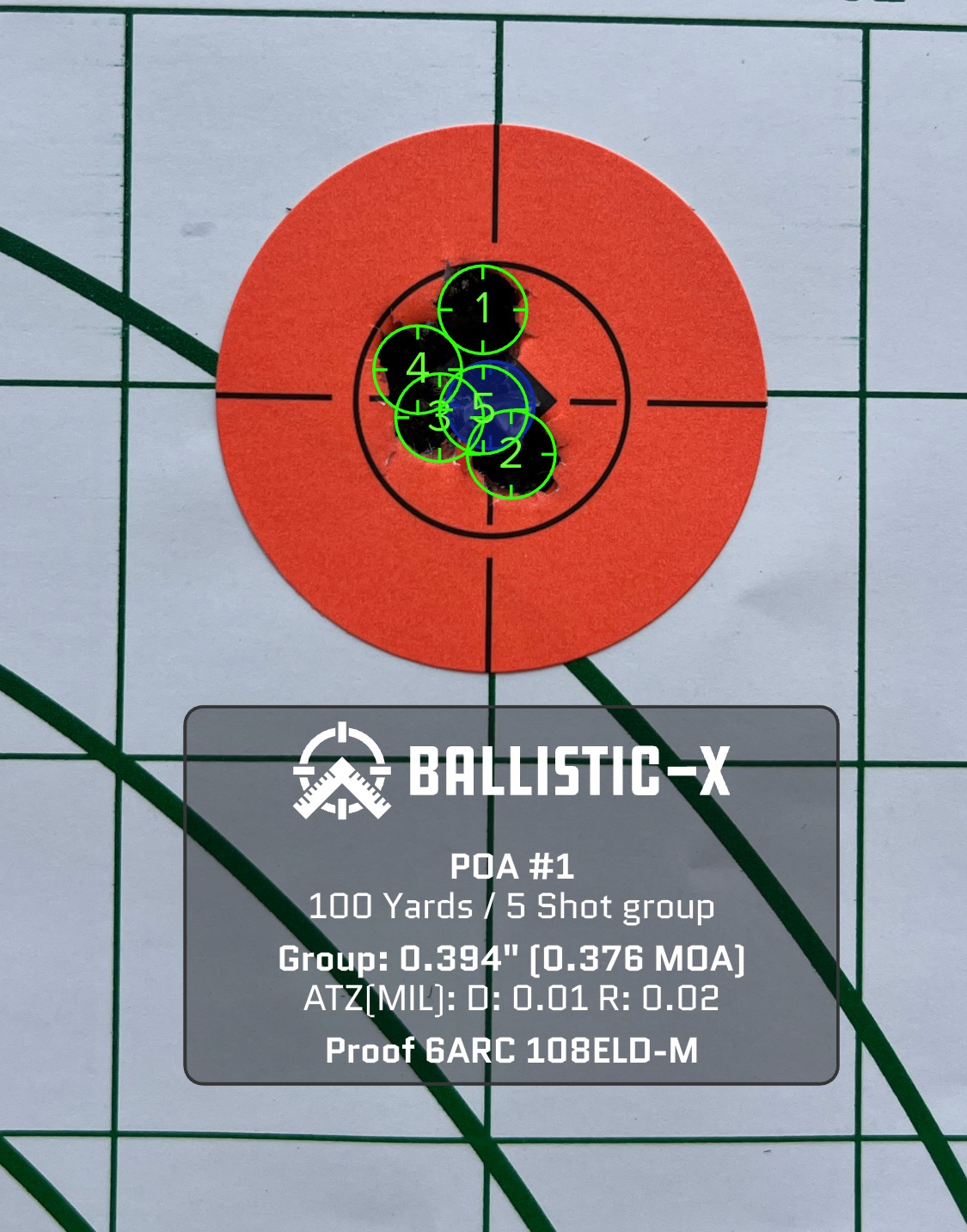

Was out again today trying to get rounds through the rifle so I can see if the barrel speeds up any, I smoked a few prairie dogs and then played with the 103 and 108,
Really good results, Gravity Ballistics to distance and had solid factory numbers

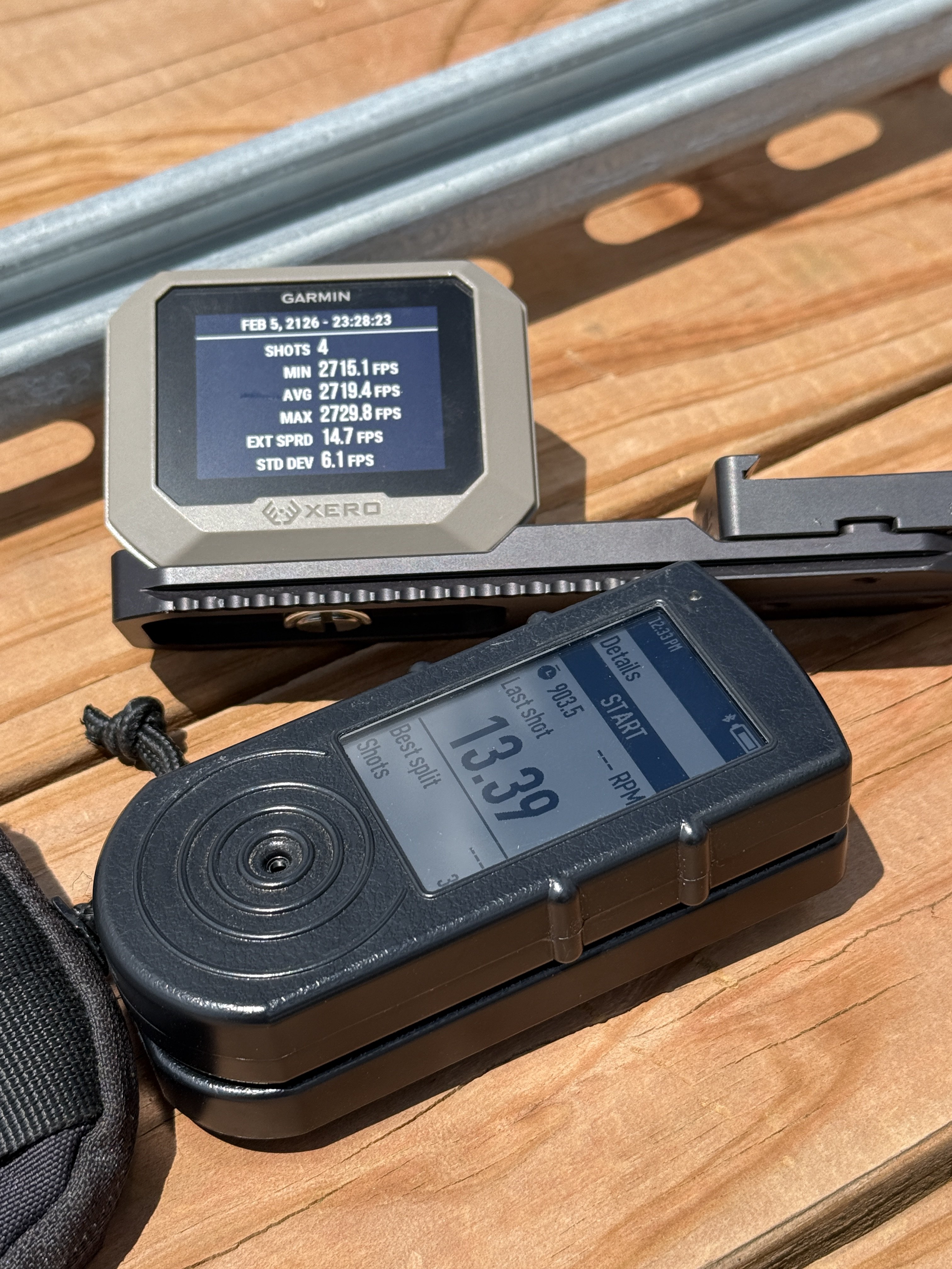

80gr 6ARC Out of my Bear Creek Arsenal 18" is 2885fps, that smacks the plate just as well

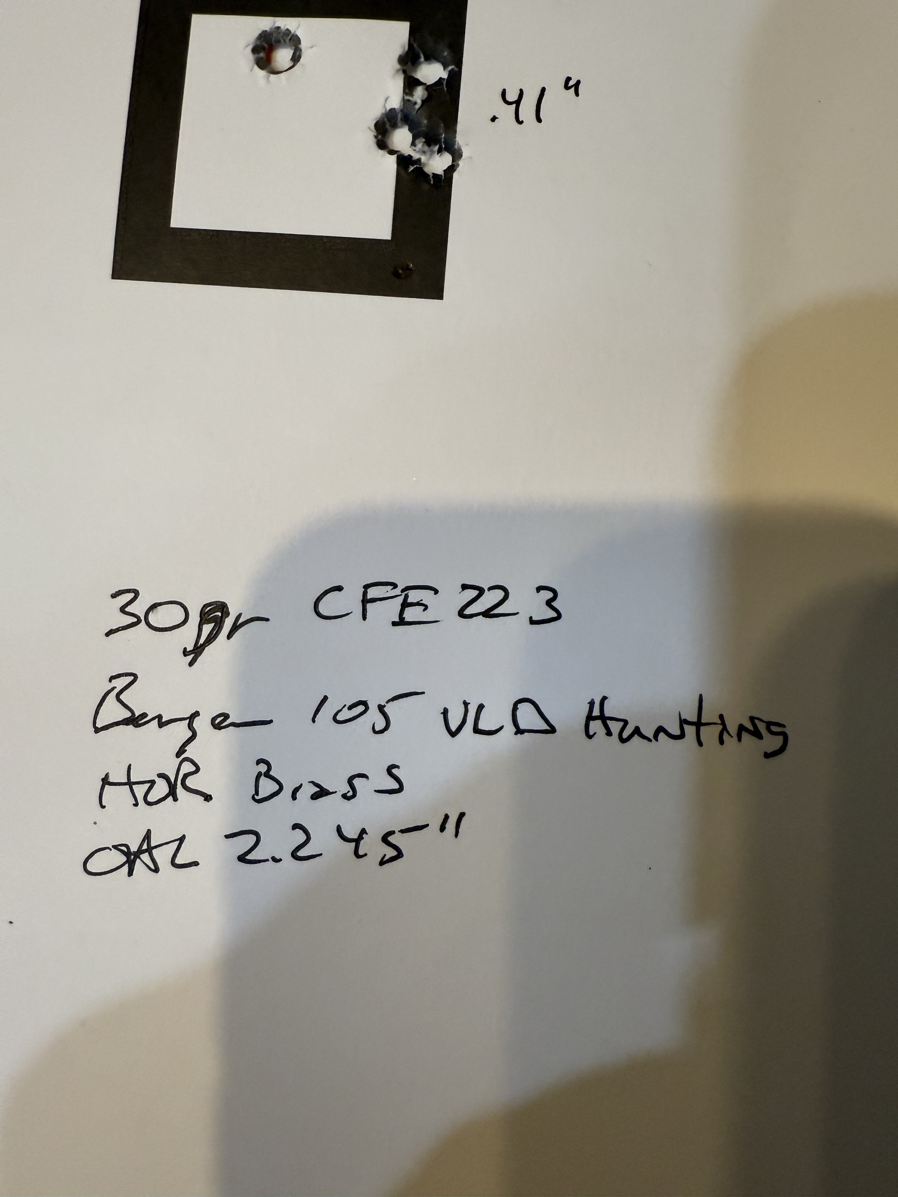

First attempt at reloading for this rifle (only loaded 10 rounds), it doesn't like the factory Hornady (1.2MOA or so), but the handloads seem to be very promising.

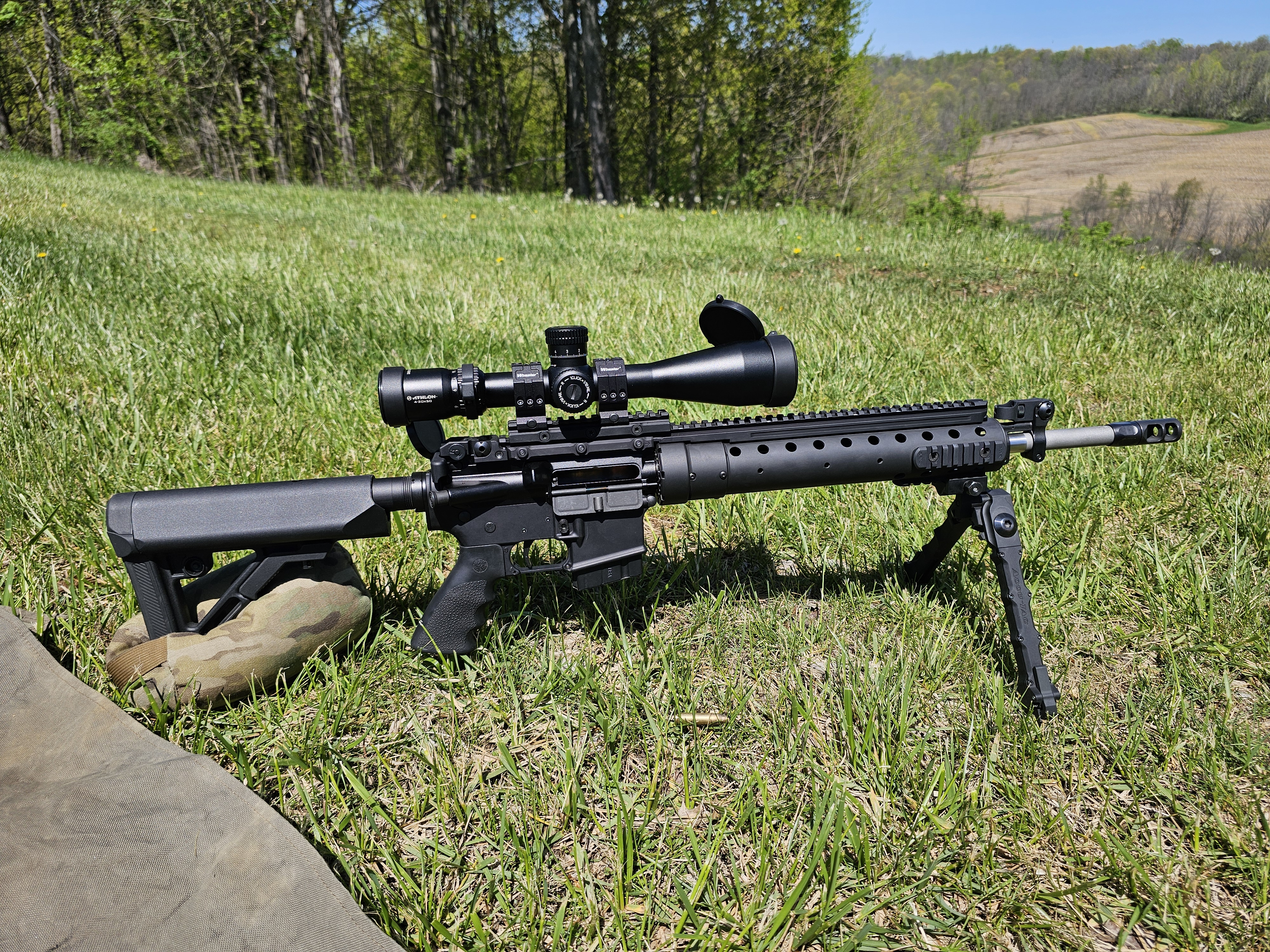

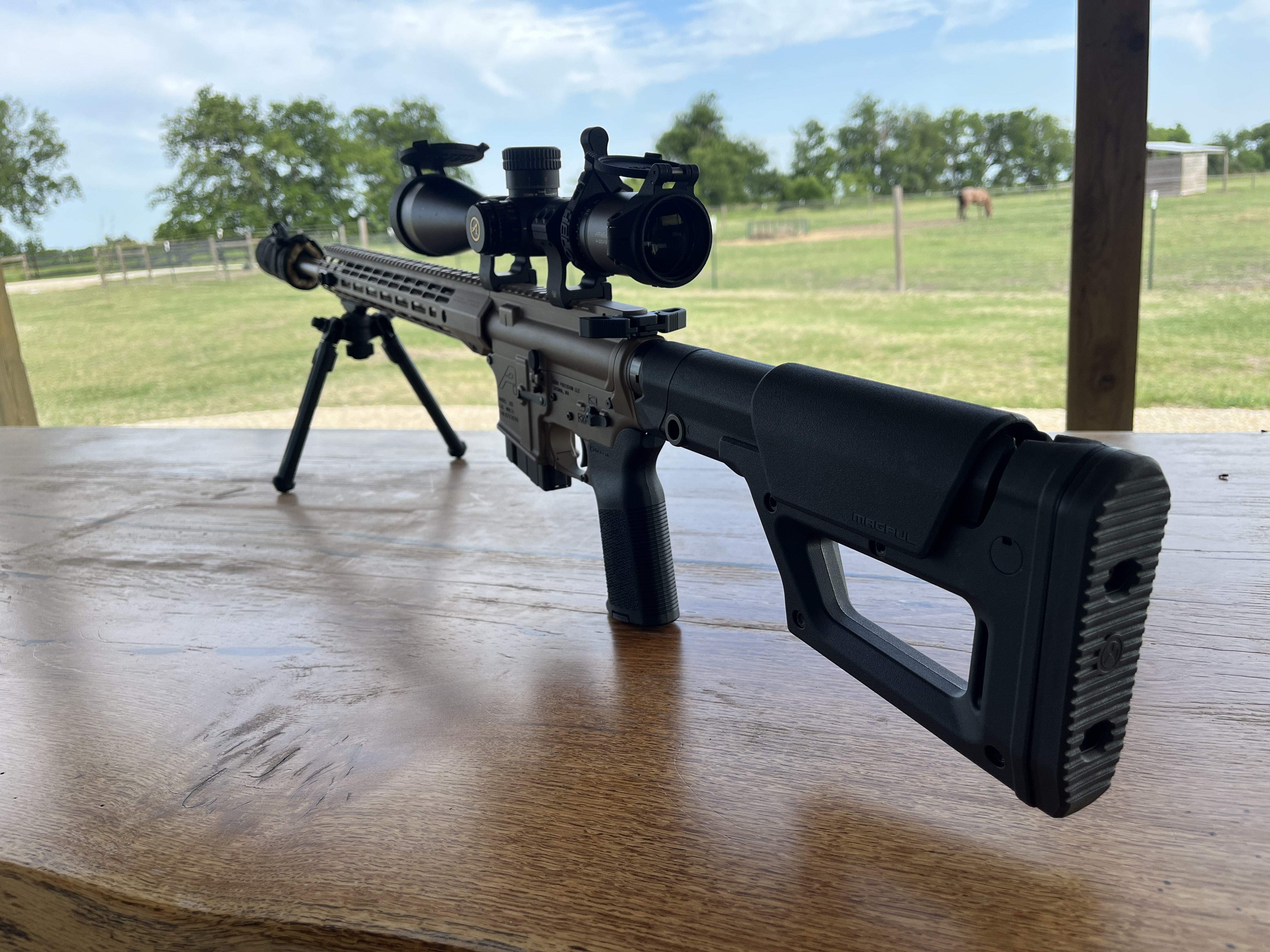

Man, I love my 6 arc. Put some parts together for mk12 feel with a cheap Shaw 18" barrel. It's a hammer.
I can't imagine with the 6 arc performance and such AR saturation in the market that it's going anywhere soon.

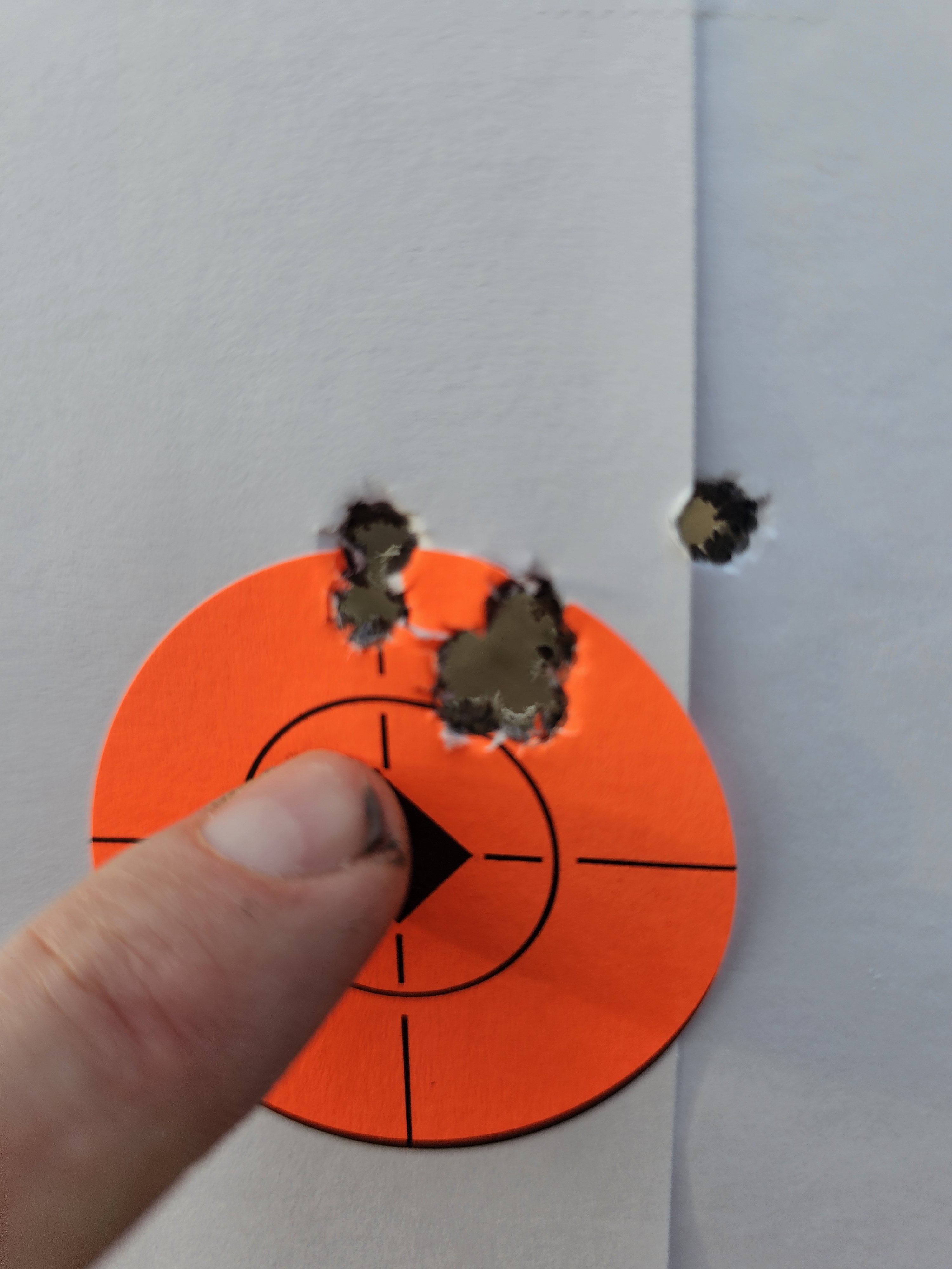

So I have been looking at the 6 arc for a while now and decided on the Q. The best group I got was with the eld match. .57 and .64. these were not consistent though they would jump all over the map. I had always planned to have a load developed for it, as I am not a reloader myself. The reloader states that he really likes to slow because of the SD and ES. He believes that the scope is too low and he really struggled to get behind it, and stated that it was a difficult gun for him to shoot. i’ve ordered some taller, Rings or rather had them do it. The rear cheek weld has to be all the way flat. Also, I had extremely heavy bolt lift with about 10% of my factory ammo, he stated that he also saw this as well as with his hand loads. He believes that polishing the Chamber can resolve this. Can I get some thoughts on this.? He stated that this is more common than you would think. Also, is this a load that y’all feel we should stick with or should I keep striving for better? Once again he states that he really loves this load because of the SD and ES. And yes, they are a strange company. Don’t try to reach out to them for anything cause they’ll just send back some weird response. When I did reach out and ask them what barrel this was, the response was “we really don’t know, it’s a Q barrel”
Anyway, thanks in advance guys just looking for a little direction

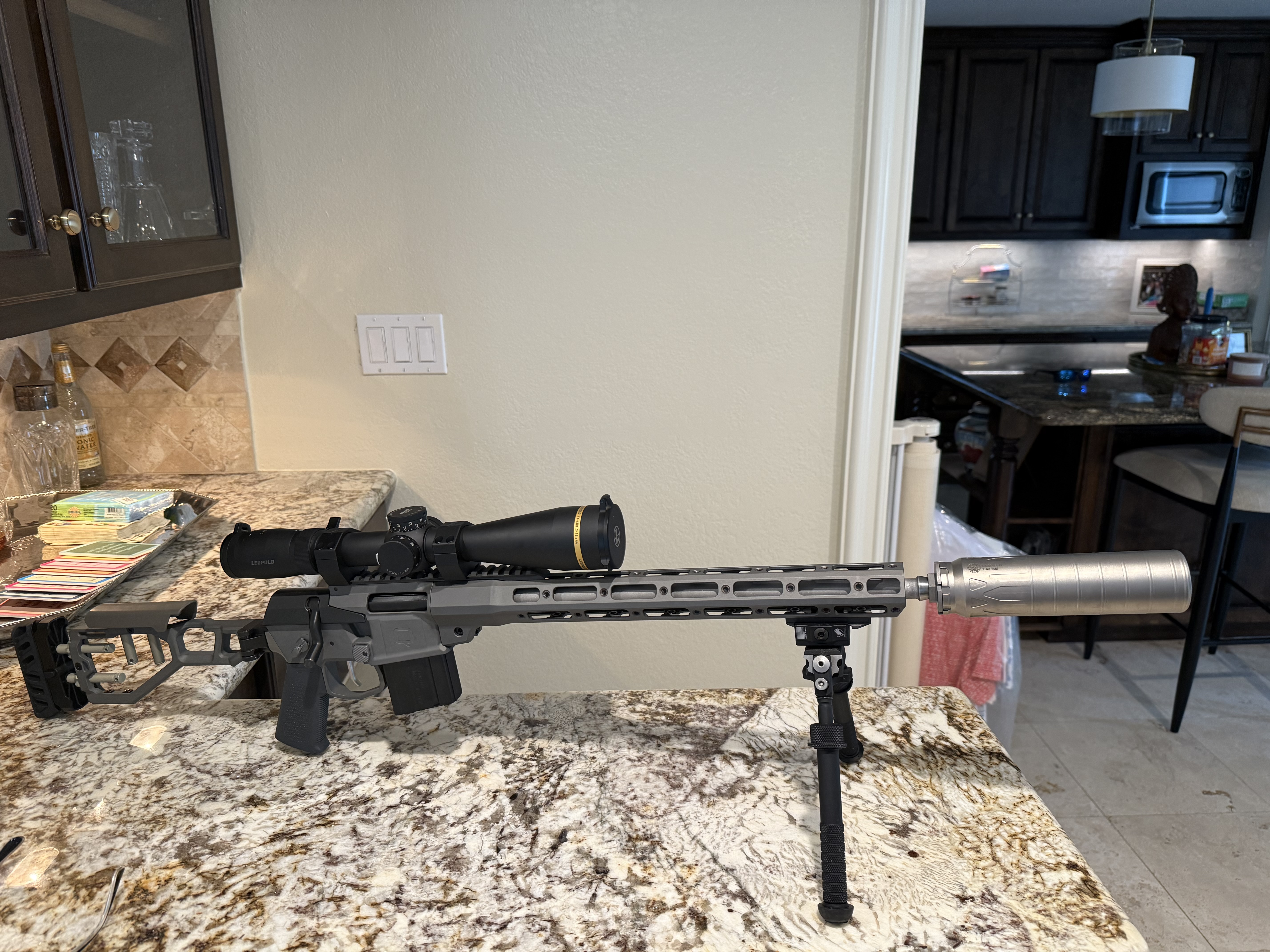

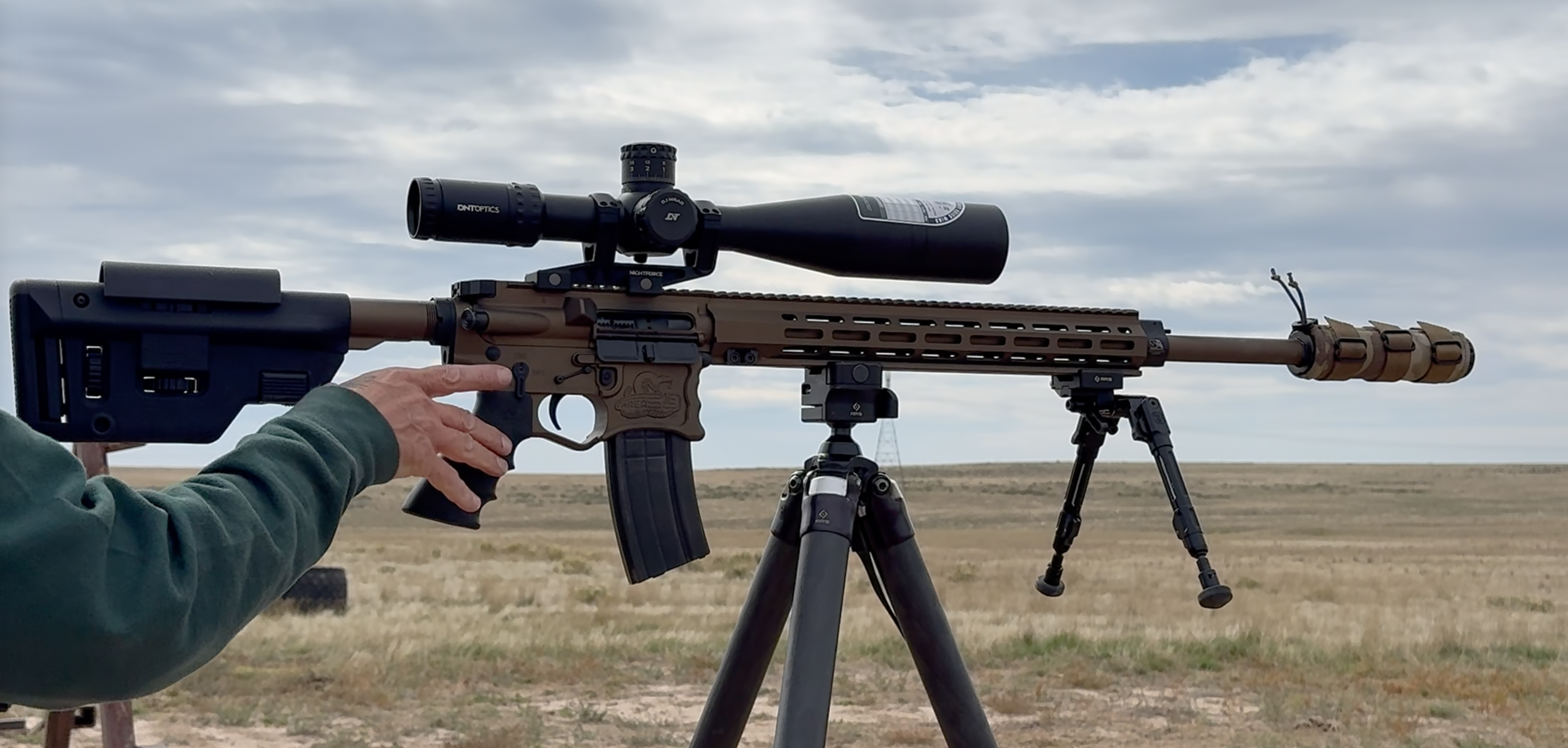

You got to tell me about that bolt gun on this post!!! stock gun manufacturer or what custom work you did and the scope!!! Looks sweet man!!!!
