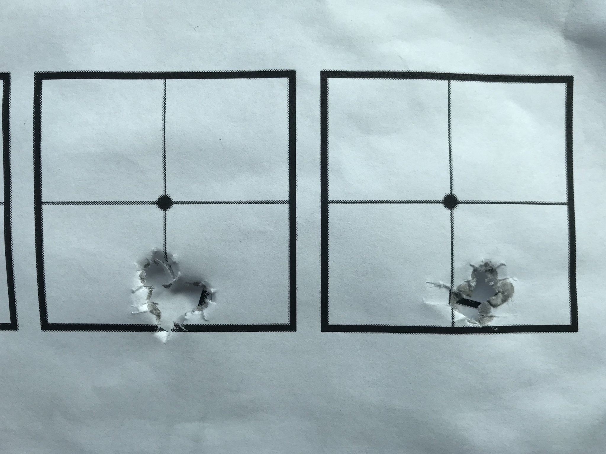

29 grains seems to be doing better groups and believe it or not less recoil I know that might sound funny but .5 Les grains of powder I can actually tell less recoil I might even go down 28.5grains of h4350. 29 grain muzzle velocity is 2920 can't wait to try it out at the further distances might be able to get to three hundred yards. the weather is in the 40s in Ohio it was in the 9° range last week too cold for me. 29.0grns works great fore 115 dtacs last year.
New match rifle. I know, I know: it’s only 3 shots, but it still ain’t bad! 30 rds on the barrel. Not sure of the exact velocity but from everything I’ve read here it should be around 3k. 26” 7.7 twist barrel. GAP reamer (I think it’s .199 freebore).

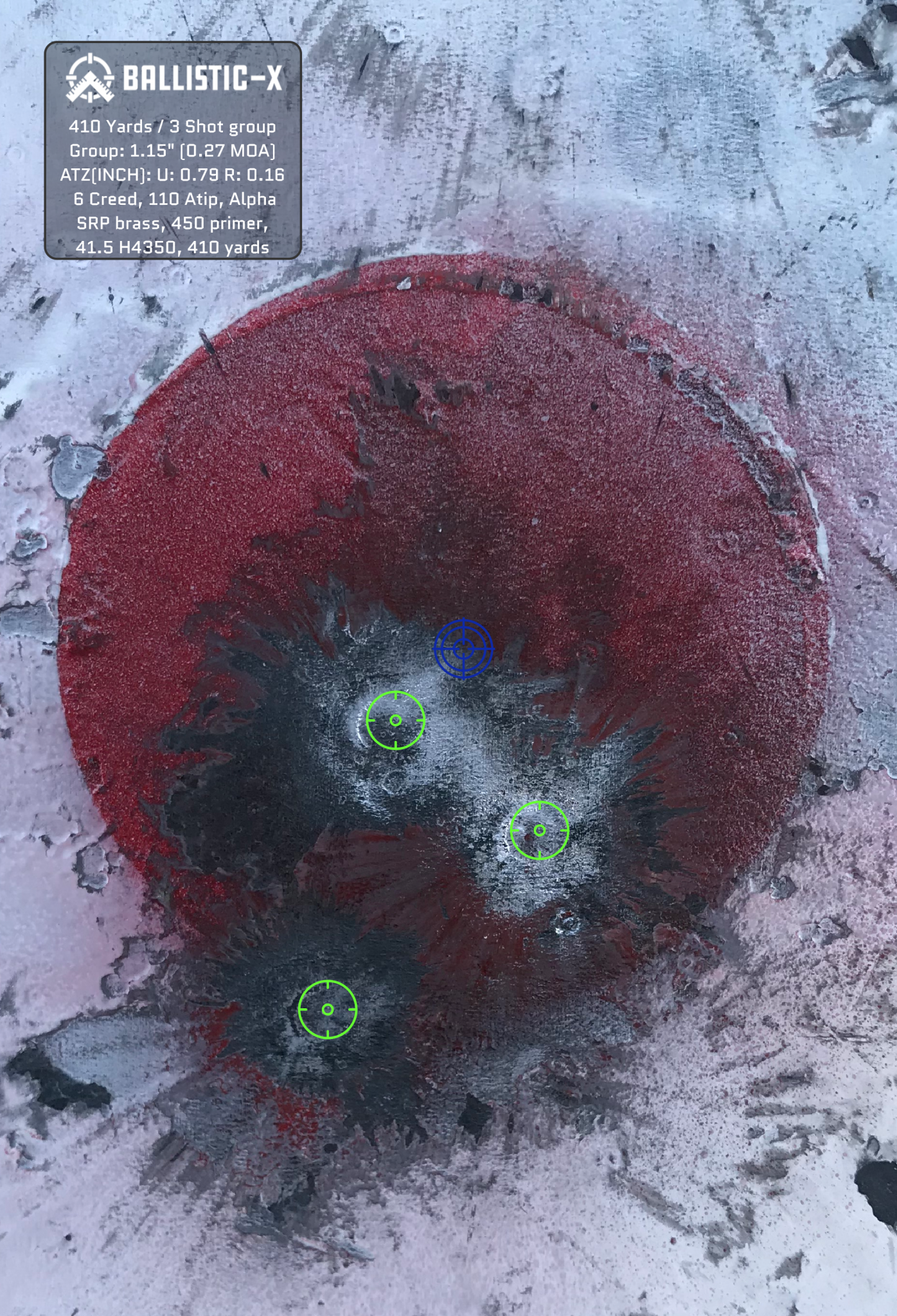

Edit 1.1.20: Alpha SRP virgin brass, 41.5 H4350, CCI 450, 110 Atip, 2960fps, SD: 8. 2.241” bto. 65 rds down the barrel.
UPDATE 03.09.20: 263rds down the barrel. Velocity has settled in at 3055fps average over 10 shots with an SD: 4.4 on 1x fired brass. Still shooting lights out.

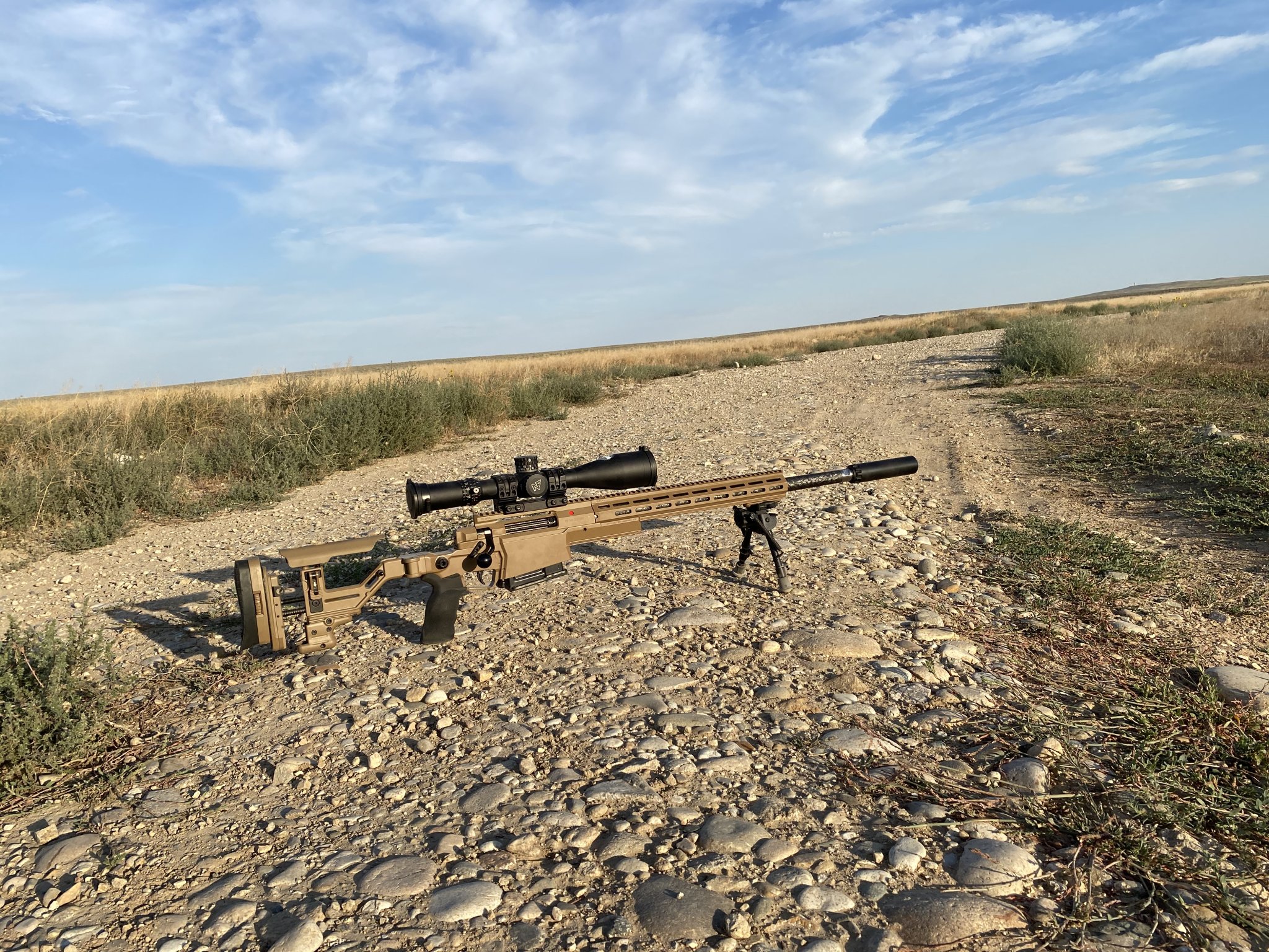

I'm waiting patiently for my 6CM to be finished. Heavy Palma Krieger Barrel, cut down to 28". Building off a 700Rem action. Keystone Tactical Stock. Plan on 87gr and 105gr bullets. It will be fun finding the load that works for it. Maybe by the time its done it will be warm enough to go shoot. Weather has been all over the place here in Eastern Mt. Thanks for all the load info you all posted!!

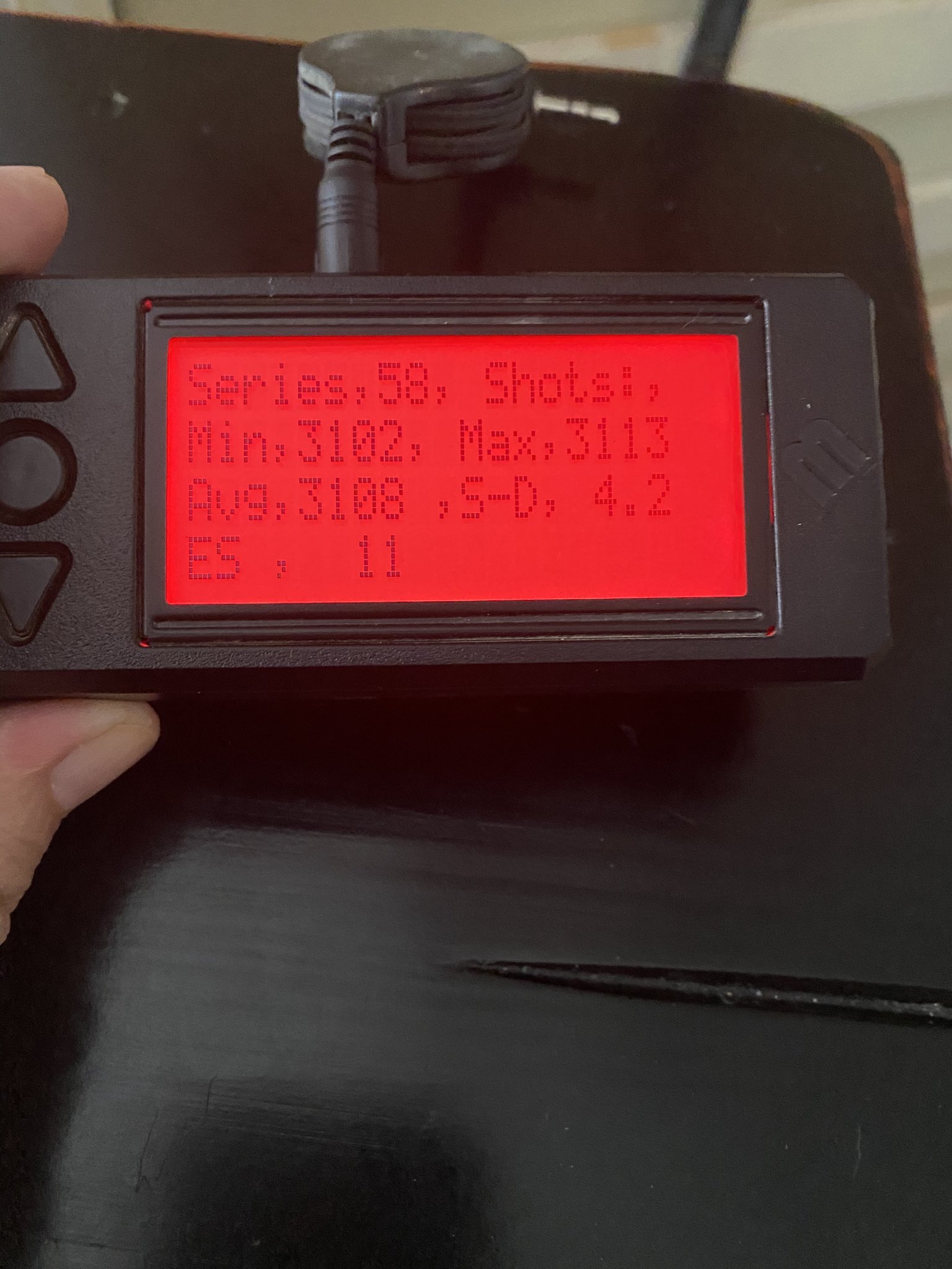

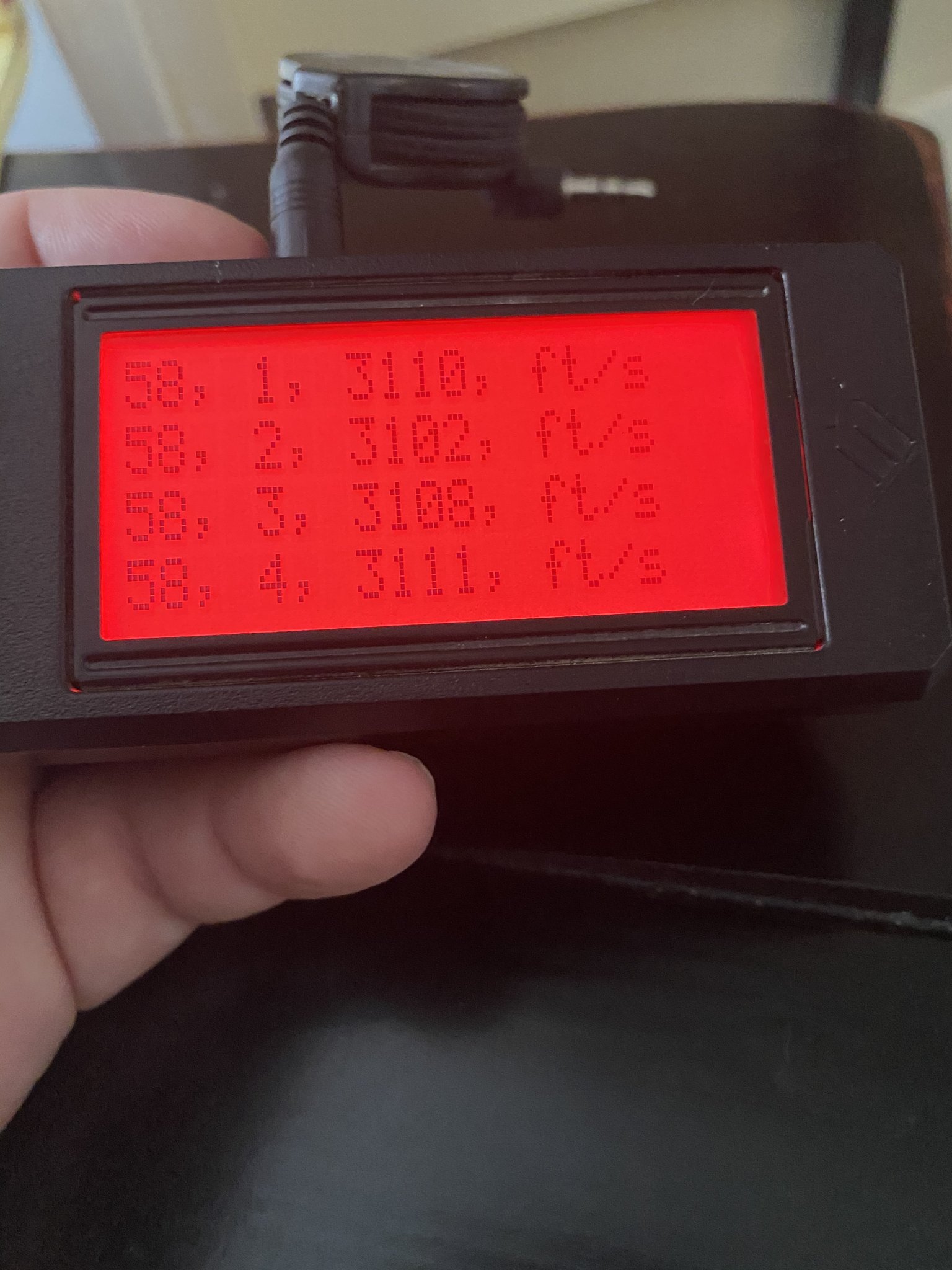

Here is my recent work up:
AI ASR
6MM Creedmoor
Proof carbon 24 inch pre-fit
41.00 RL16
Virgin Lapua SRP brass
CCI 450
Berger 105 Hybrid
COAL 2.806
98 degrees. 2500 FT.
3108 FPS Avg.
SD 4.2
ES 11
.57 MOA @ 108 yards. I backed up to 535 and got a first round dead center of the plate. Love this gun and this cartridge!

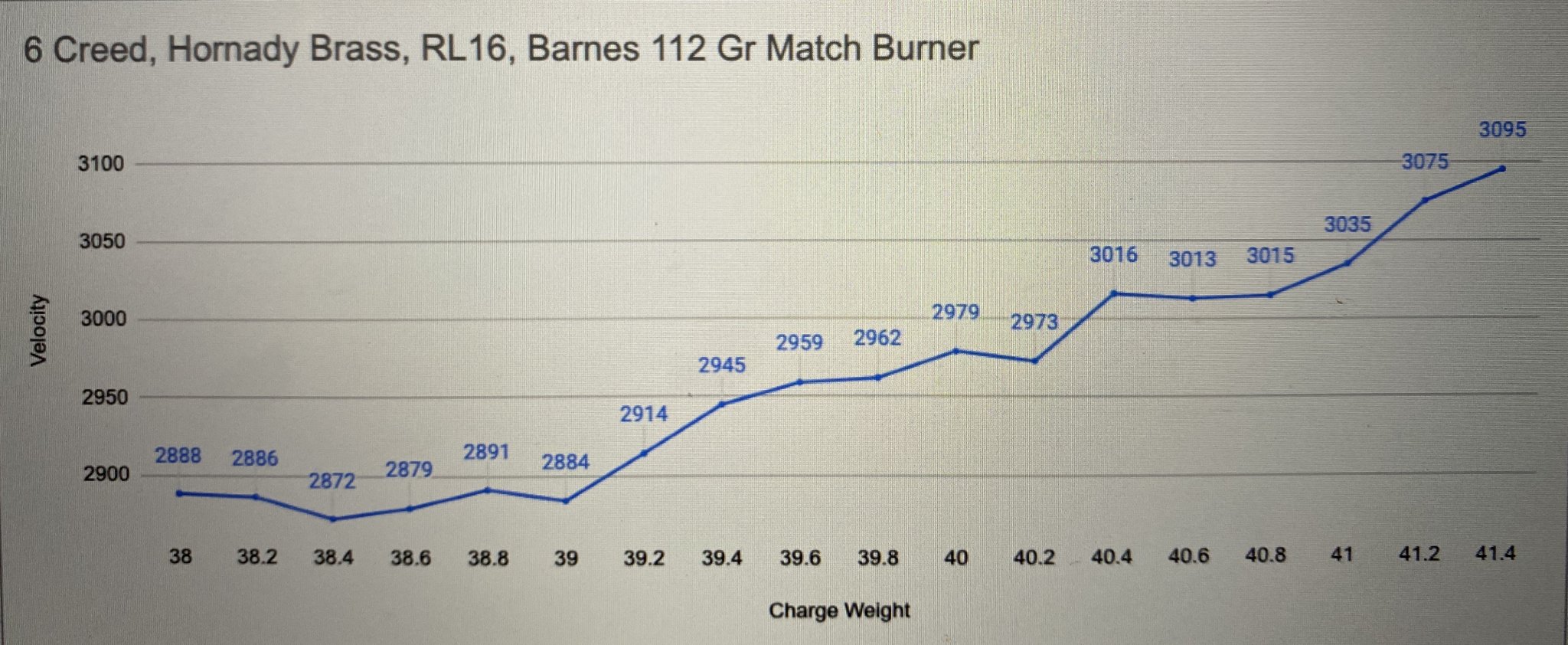

I’m shooting 38.9 grains with a 112 match burner in ADG brass. I find rl-16 is fast. I get 2995 fps. I had it running real hot at 39.9 grains. It was pushing 3080 fps. But I also run into pressure sooner with ADG

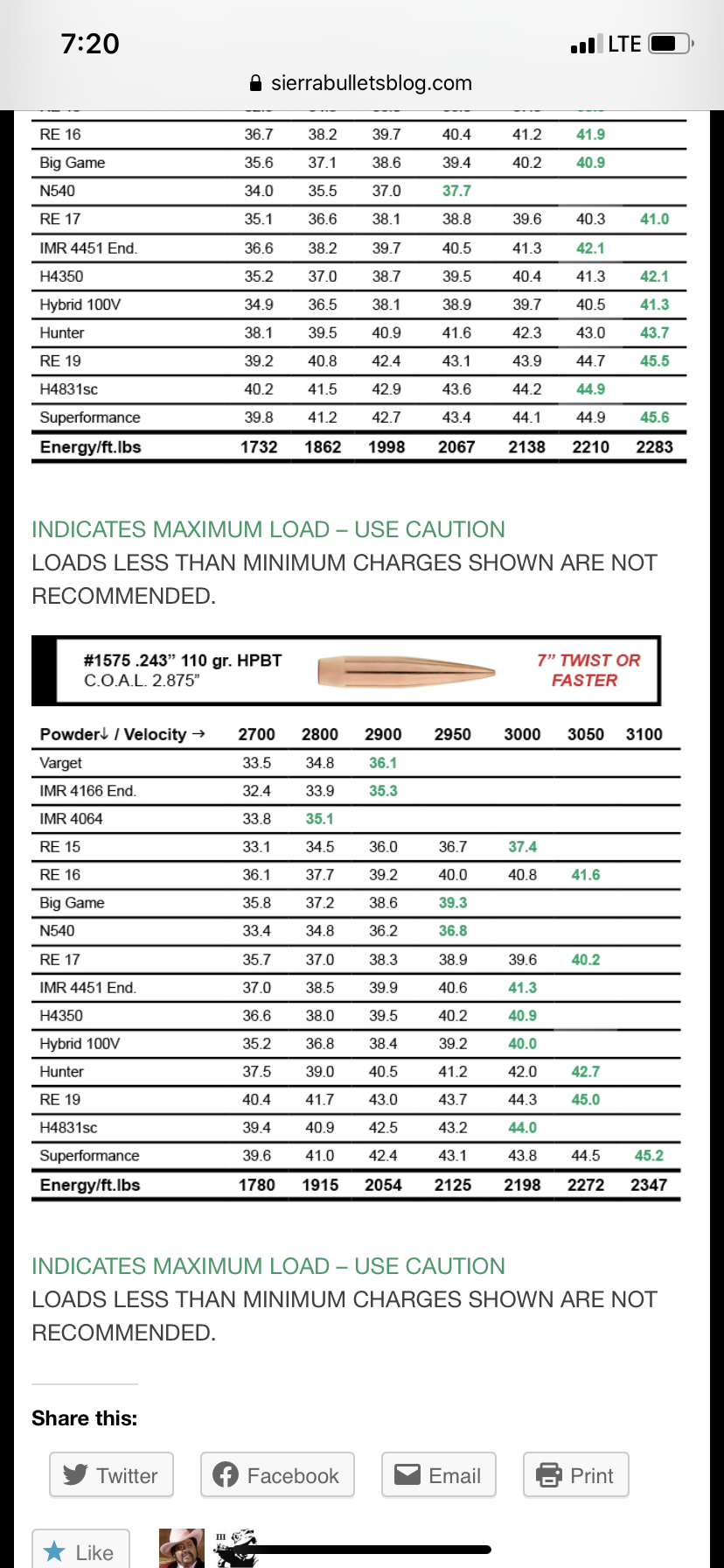

Anyone running Varget with the Sierra 110 SMK, Barnes 112 Gr or 115 DTAC’s?
I think Varget would hit pressure early with those heavies. If you have a low internal capacity case you might be okay?
I was thinking the same. There’s data for the 110 SMK’s with Varget, but nothing for the Barnes 112.
