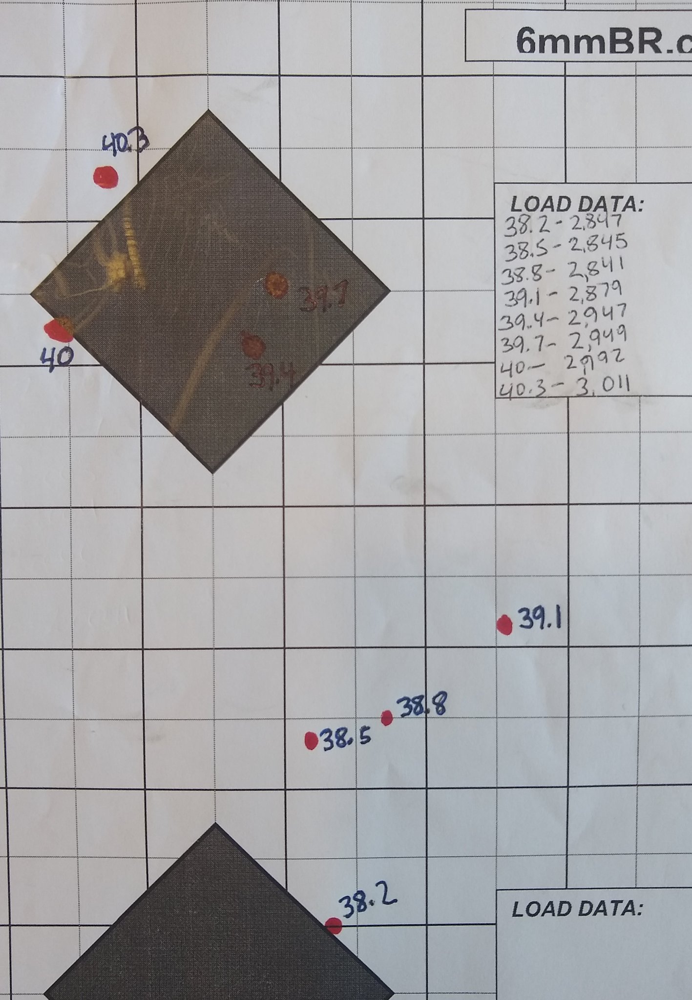

Got my new 6mm GT out yesterday and got some velocities that were a bit higher than I was expecting:
23" barrel, 112gr MatchBurners, 0.070 off jammed, StaBall, Hornady cases,CCI 450s, 80 deg.
38.2 - 2,847 fps
38.5 - 2,845 fps
38.8 - 2,841 fps
39.1 - 2,879 fps
39.4 - 2,947 fps
39.7 - 2,948 fps
40.0 - 2,992 fps
40.3 - 3,011 fps
I was kind of surprised by the big velocity jump between 38.8 and 39.4, and it was accompanied by a pretty significant POI shift. Started seeing some pressure on the cases around 40gr.

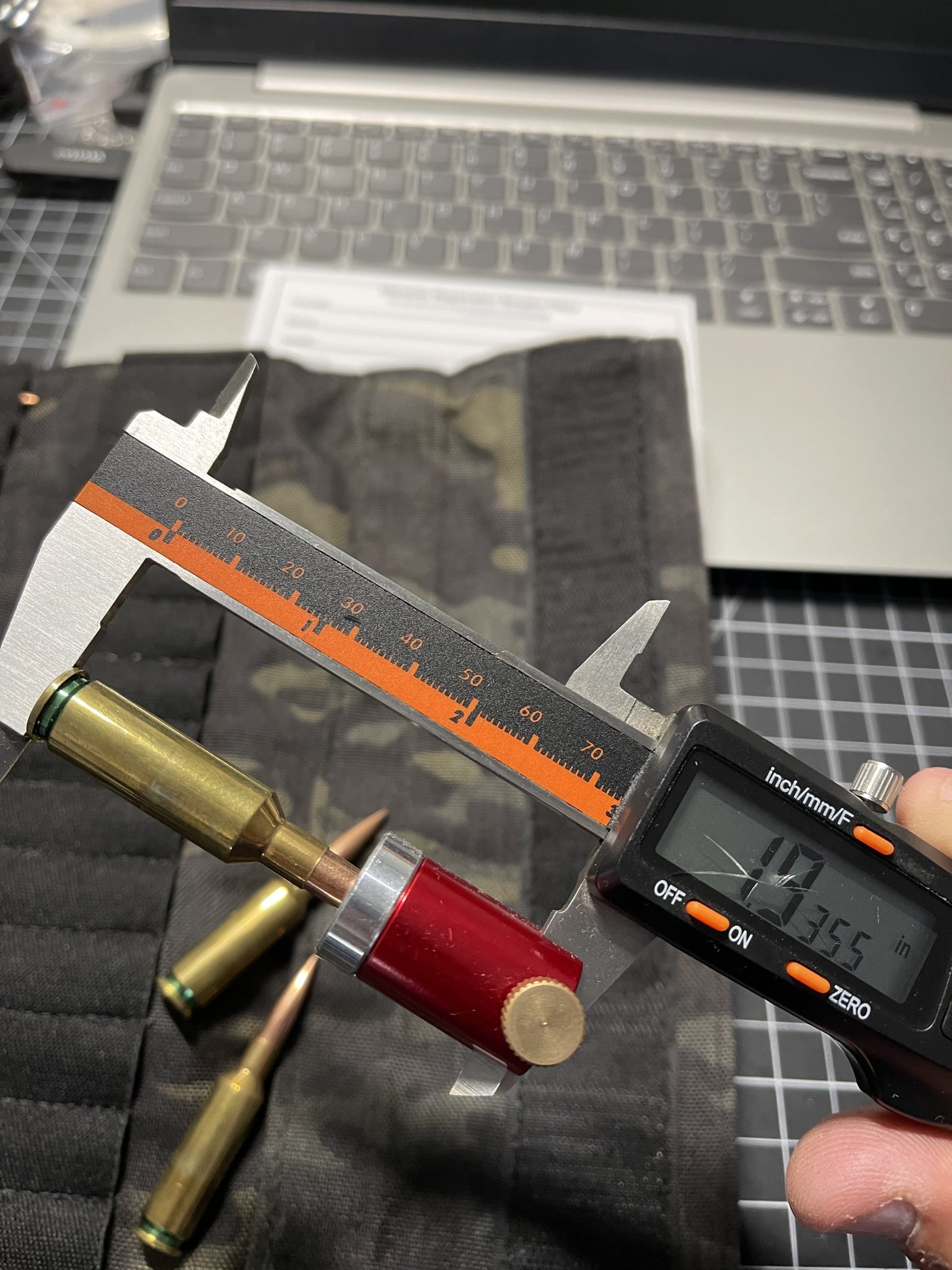

I've been having some strange bullet seating behavior along with inconsistent or very light bullet grip with 112gr Match Burners and GAP branded Hornady cases. I'm using RCBS Matchmaster dies with .266" collet which gives me ~.002" measured neck tension. I'm curious if anyone else has seen these problems, or even if they are really the issue.
I called Josh at PVA to ask about the freebore length on my barrel, and he mentioned that Barnes and to a lesser extent Hornady had had some issues with some bullets having an enlarged what he called a "pressure ring" where the boat tail meets the shank. Josh said bullets with this problem would feel normal during most of the seating process until, at some point resistance sharply dropped off and it felt like the bullet might just drop right into the case.... which perfectly describes the weird feel I've been getting with these loads. In fact, on deeper seating depths, I've been able to push bullets into the case by hand without to much effort even though the ogive should still be well above the case mouth.
I went out and measured some of the 112gr MBs and, admittedly with calipers, the junction of the boat tail and shank does seem to be up to 0.001" larger than the shank itself. I also measured 108gr ELDs, and they have a ring as well, but it seems to be a much smaller difference.
Josh said a large diameter difference was a manufacturing error, I wonder if a smaller .265" collet would help though. Intuitively, it makes sense that a significantly larger ring/bulge being pushed through the case first could act like an expander ball and lead to poor tension on the rest of the bullet once the ring passed the sized portion of the neck.
Anyone else had this problem before? Recommendations, or maybe just go down a collet size and see what happens?

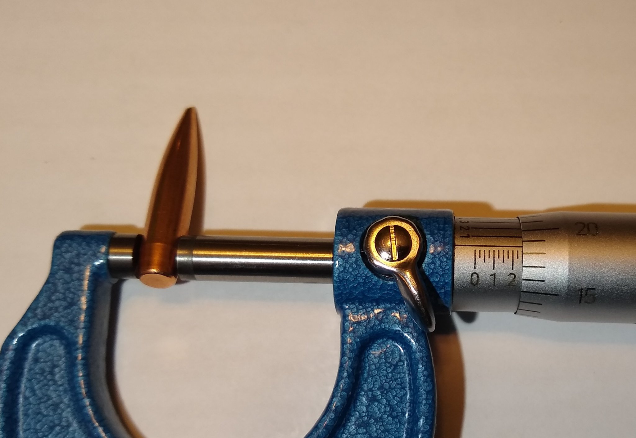

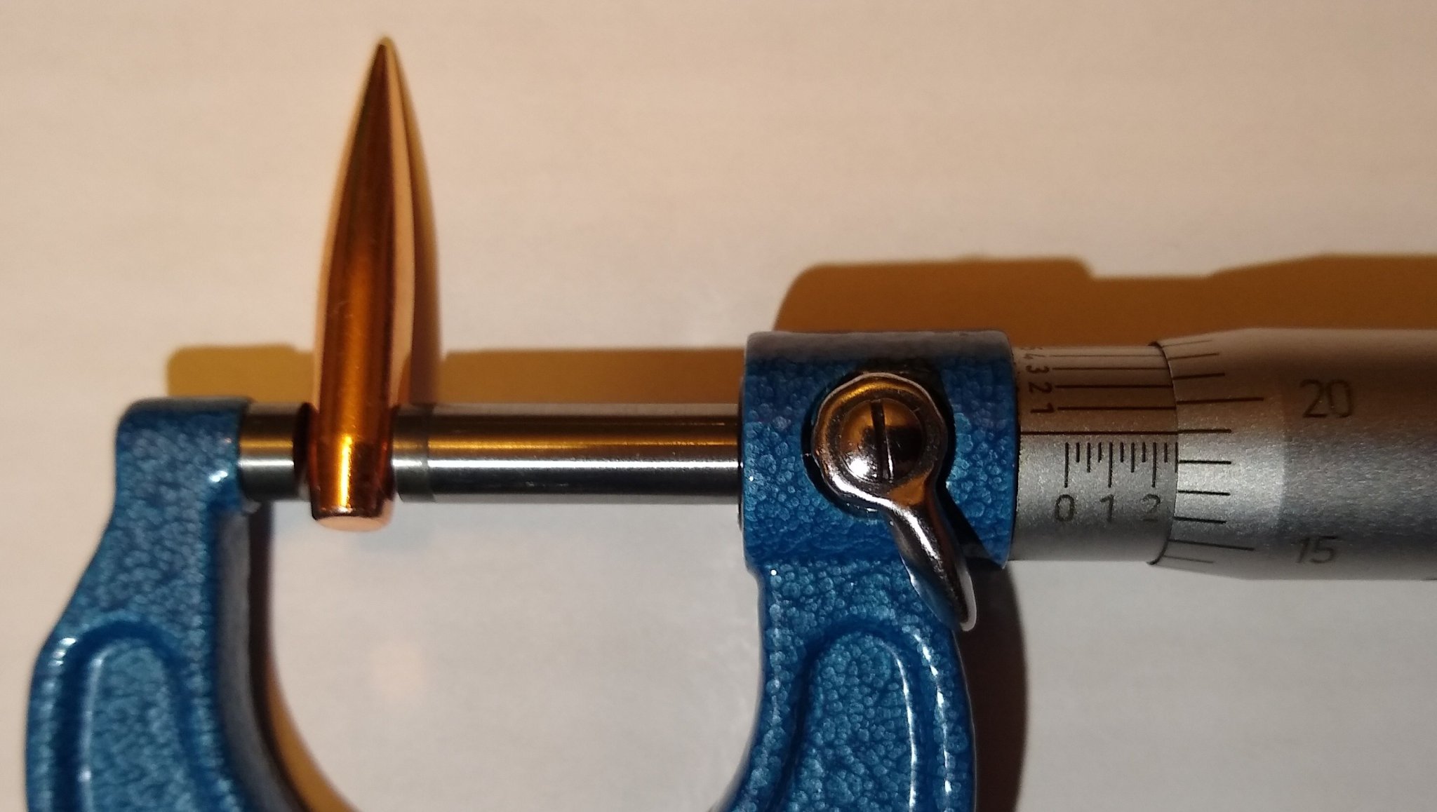

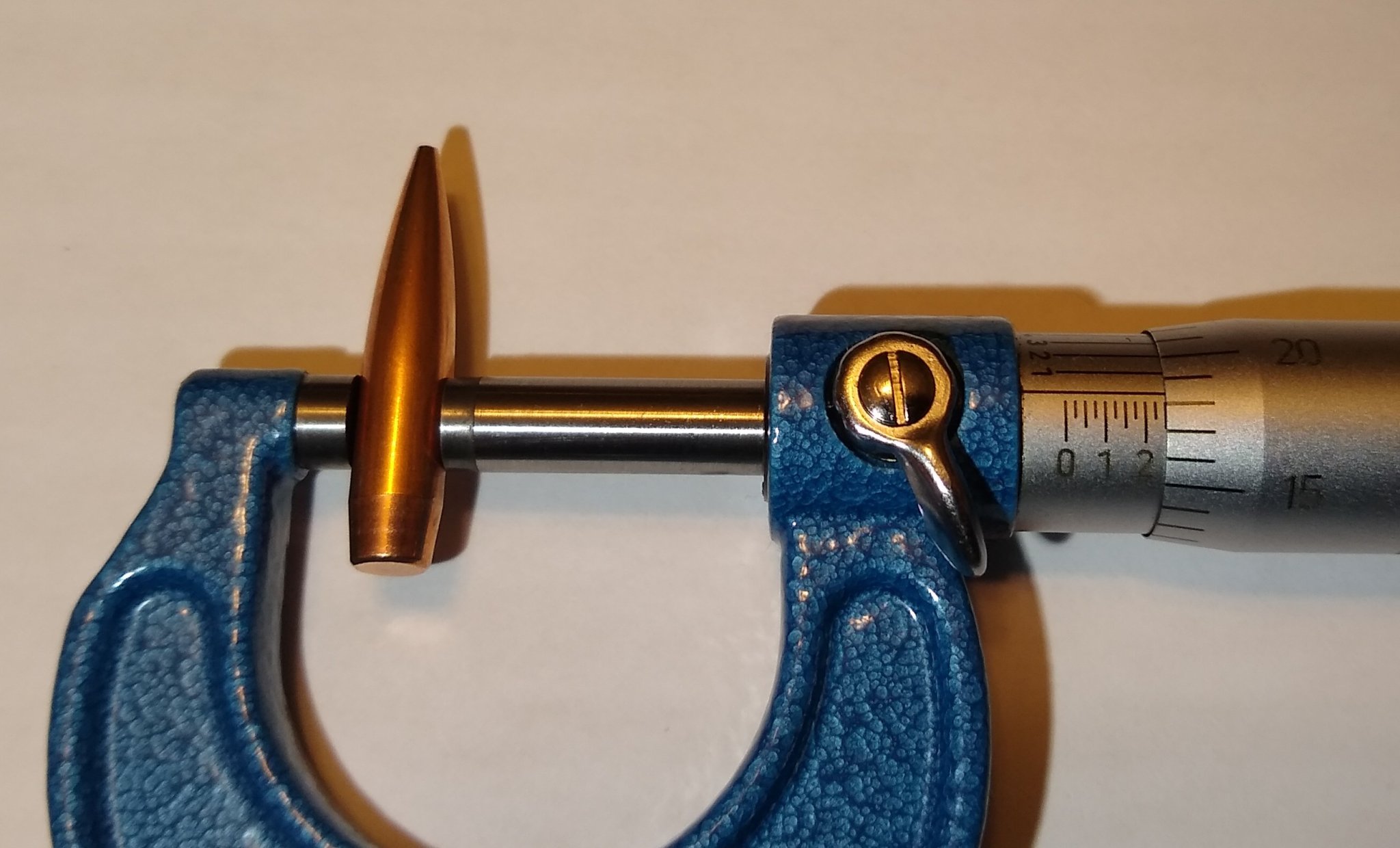

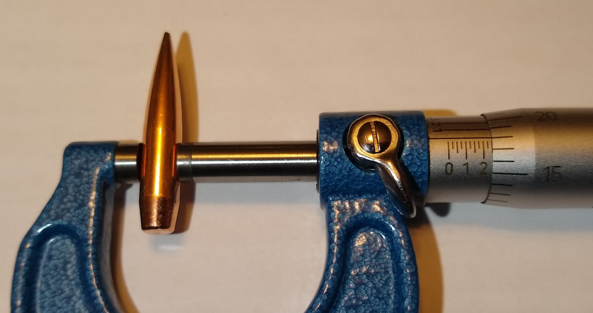

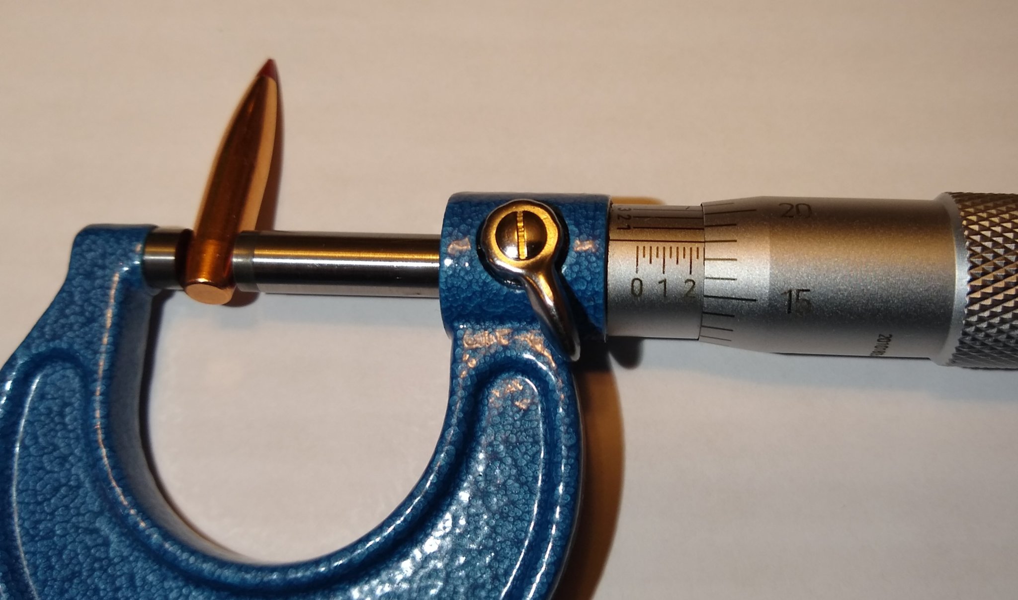

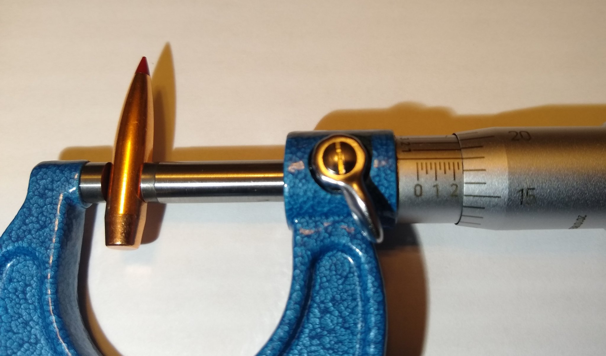

To follow up, I have gotten a micrometer out and measured some of my 112gr Match Burners, 105gr Match Burners and 108gr ELDs, and I think this is the problem:
112gr Match Burners
Shank diameter: 0.2430"
Pressure ring diameter: 0.2439"
108gr ELD
Pressure ring diameter: 0.2430"
105gr Match Burners
Shank diameter: 0.2435"
Pressure ring diameter: 0.2436"
Those numbers are pretty indicative of the few bullets of each type I measured, some of the 105s have a difference of up to 0.003" or so, but only the 112gr are nearly a thou over.
I also played with repeatedly resizing and seating 112gr, 108gr and 105gr, and trying to push them into the case to get an idea of bullet grip. The 112gr is the only one I could consistently push into the case with reasonable effort, by hand with the shorter OALs, and pressing against the table with minimal force at any OAL... 108gr and 105gr did not budge, same cases, same neck collet.
I talked to a Barnes technician on the phone today for a while and they asked for pictures of my lot numbers, so we'll see. For now, I suspect that Josh from PVA was right about the source of my issues, so I'm going to move on and work with the 108gr ELDs next.
