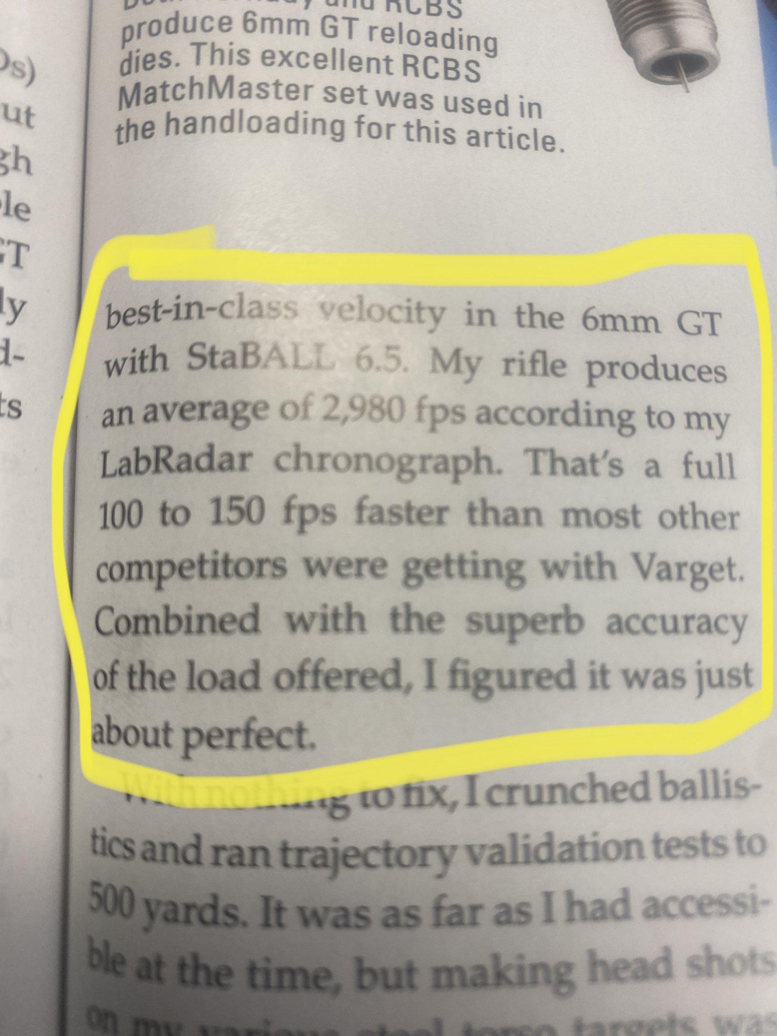

See the contestI tried that initially but had excessive pressure. I think StaBALL is too slow burning for that case size.i also read in PRECISION RILE SHOOTER magazine that they have gotten good results with Winchester 6.5 Staball, 100-150 fps faster

StaBall seems to work better for the heavies like the 115gr Nosler or DTAC

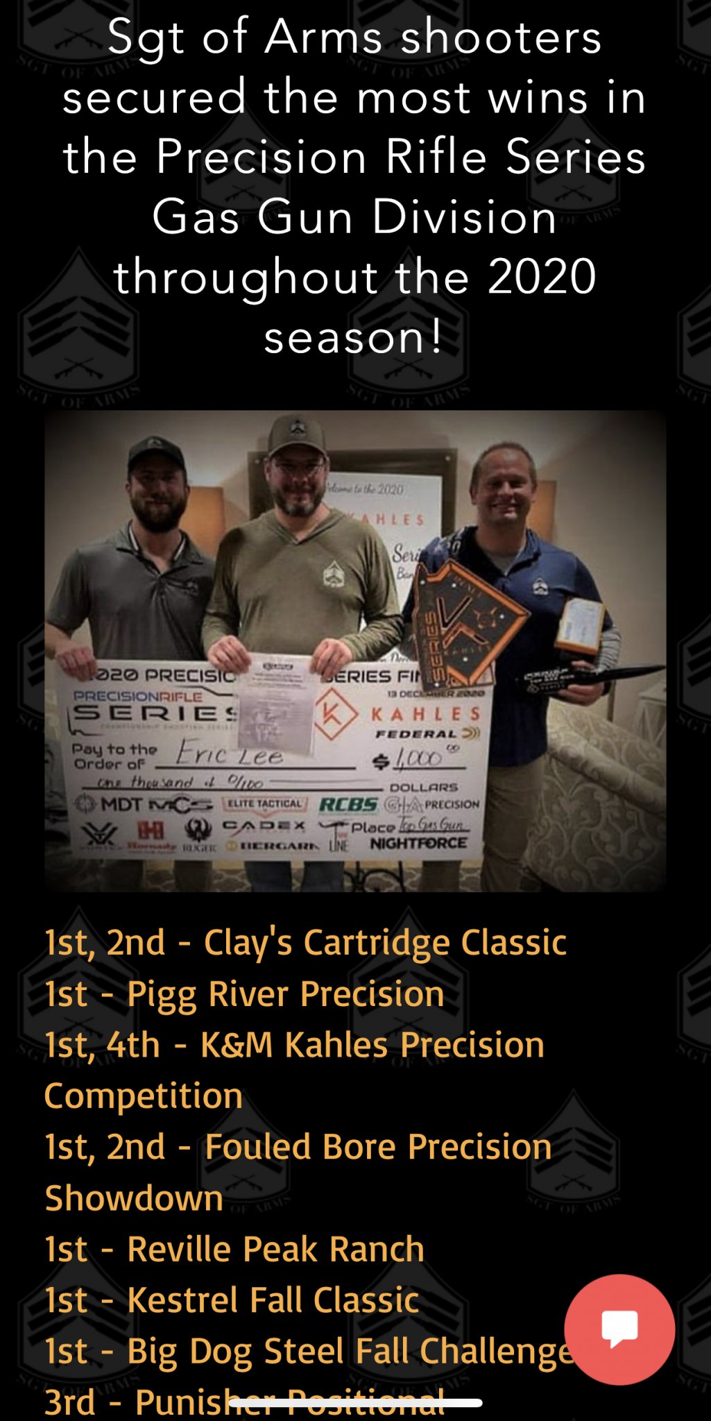

That’s pretty misleading. I can’t speak for the other matches, but at the Pigg River match, there were only 3 gas gun shooters.

There's no competition in the Gas Gun division.
I just ran my match this past weekend, a PRS Pro Series Qualifier. I had multiples in every Classification and Division, but not a single Gas Gun shooter. Wasted $200 on the trophy..
You'd probably have better luck posting in the semi auto section.I don’t know shit about PRS gas guns. I know a few guys back east running their rifles and liking them.
I was really asking if anyone else is running a SgtofArms gasser, and how they like it.

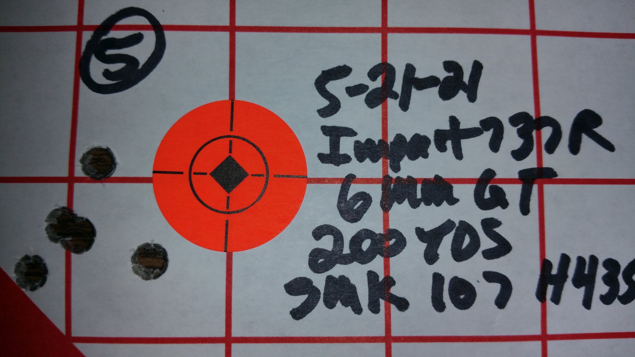

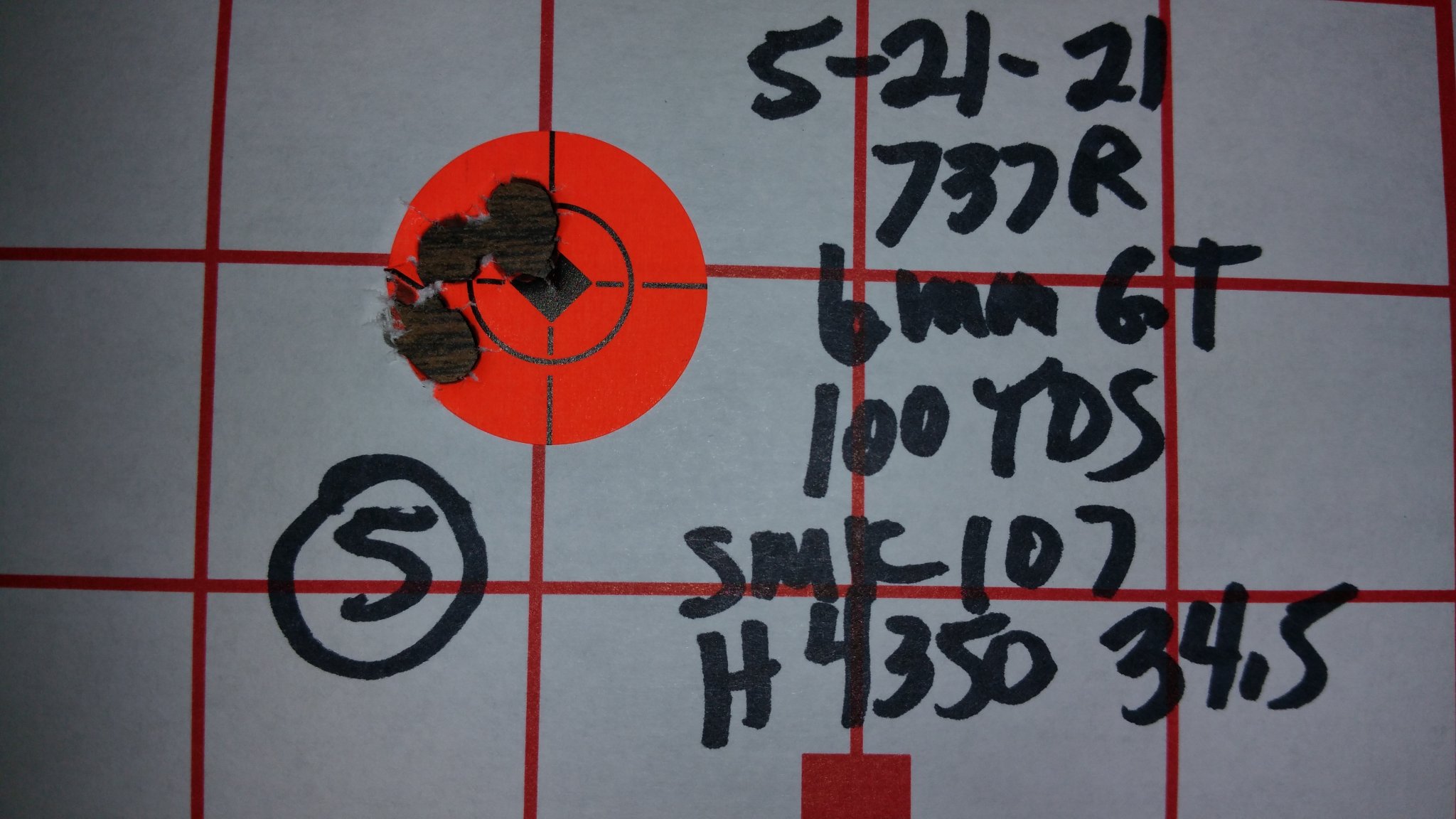

The Second picture has a much better group
Very good ,that is what I am looking for exactly that ,but in the 105’Good break in load for 108ELDM 33.5 Varget, CCI 450, 30 off, Hornady brass, 7.5 twist Bartlein @ 26"
