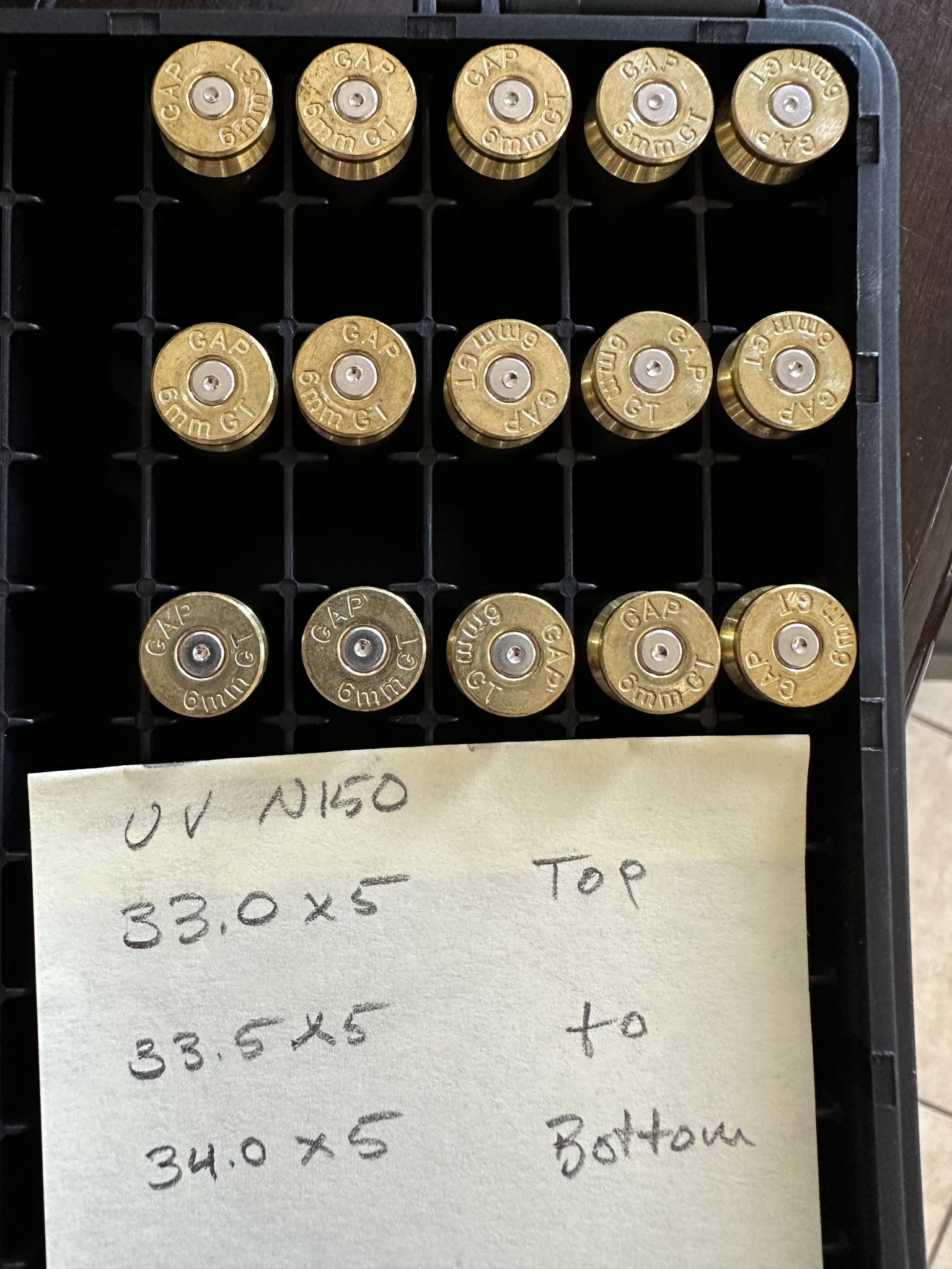

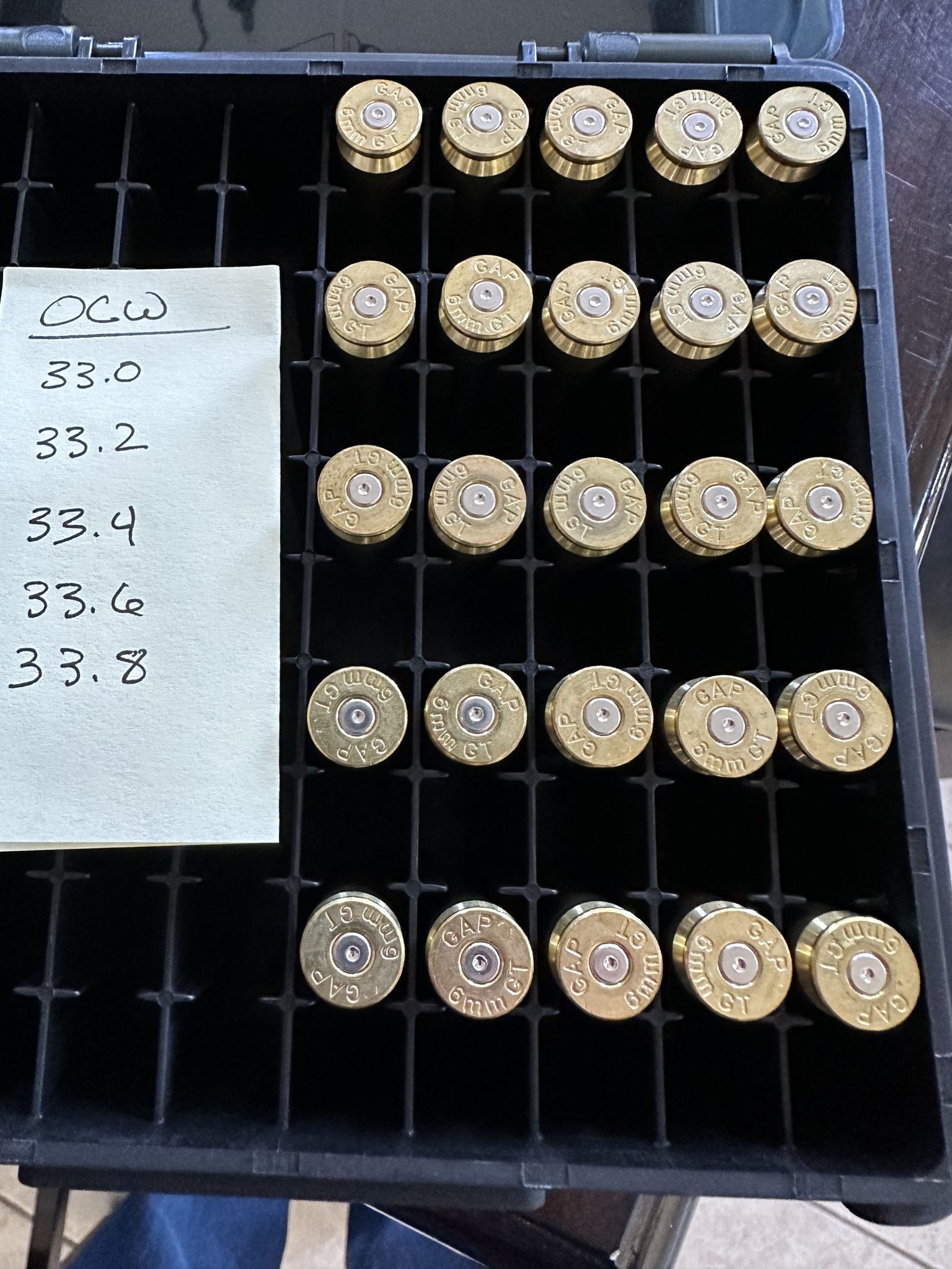

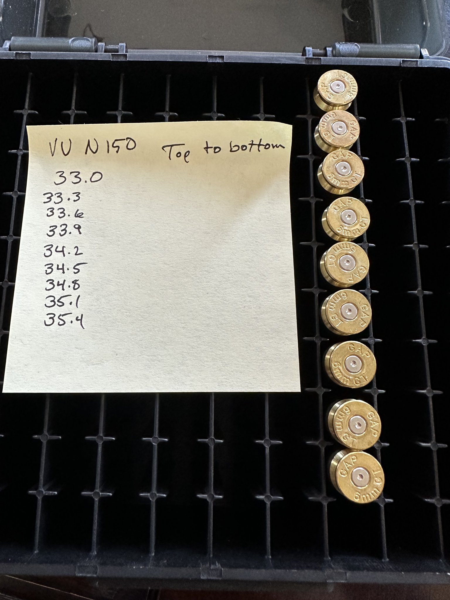

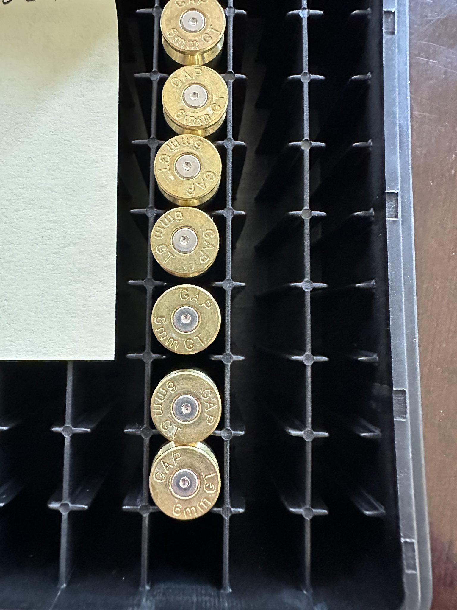

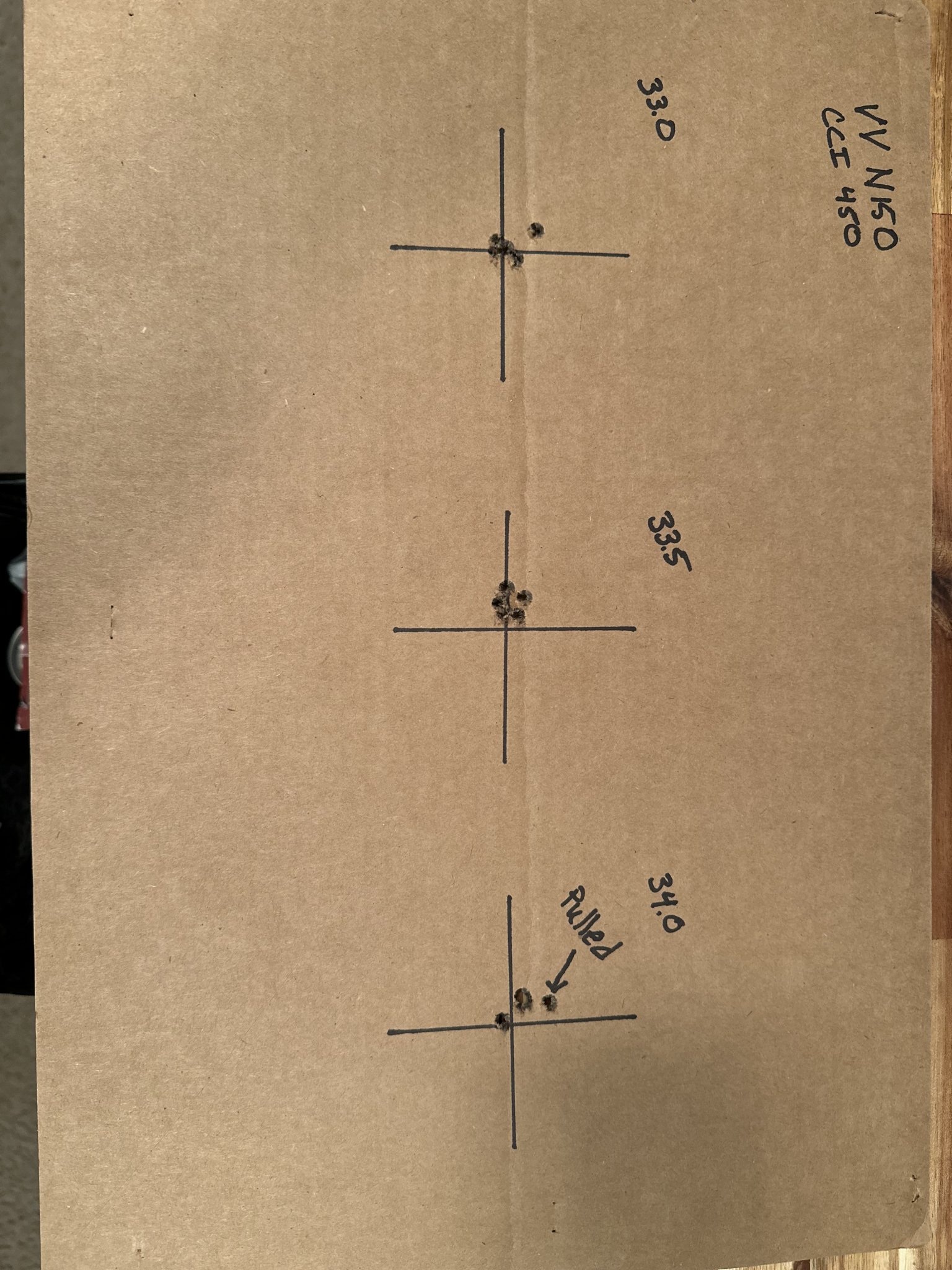

Well, this took a lot longer to get back to than I had hoped. However, I learned a ton.
I redid the ladder test and went higher than I ever plan on running it to try to learn to identify pressure better. The last 3 charges started to have a heavy bolt lift.
Pics of the ladder and the last few charged cases closer up.

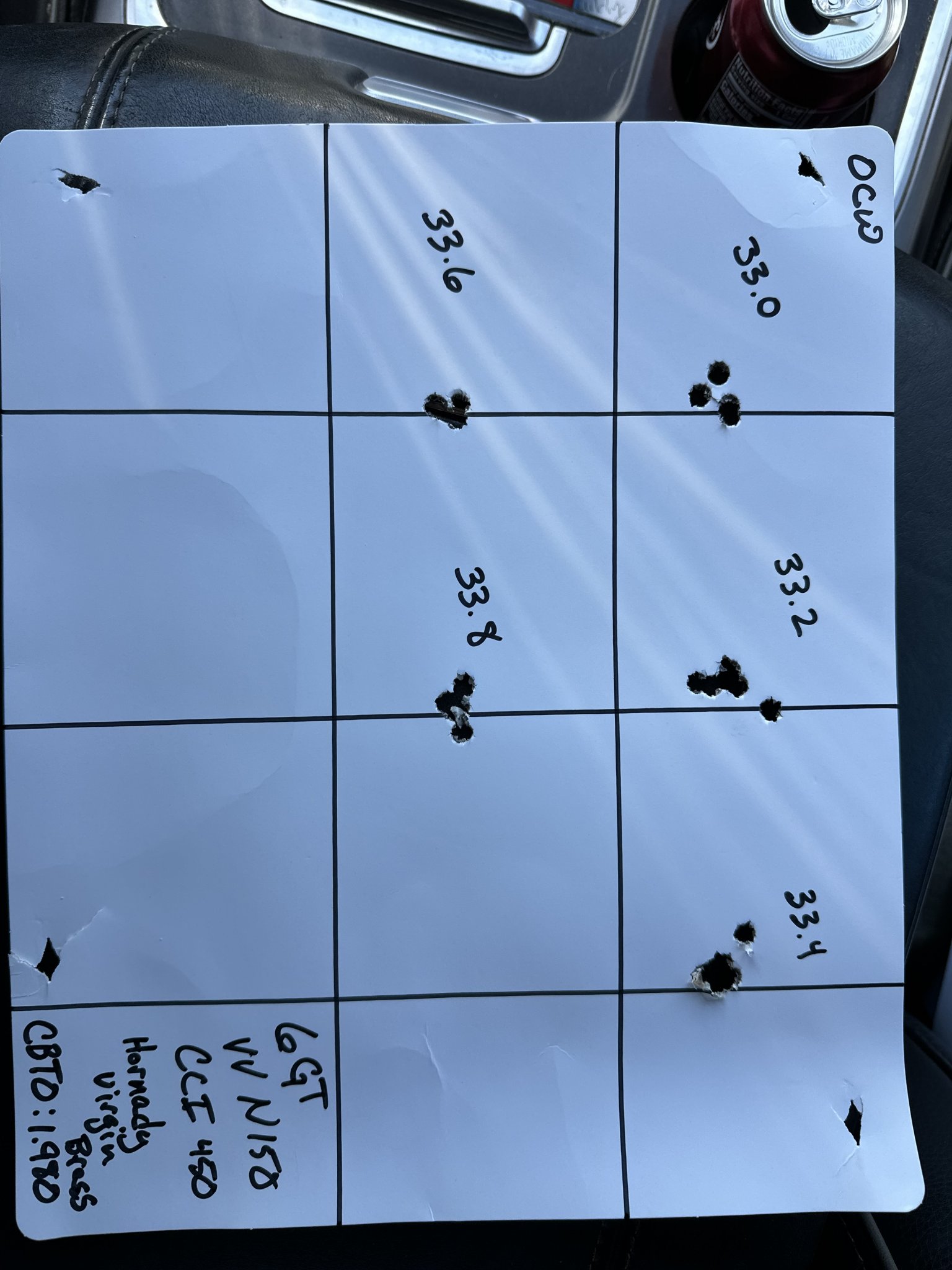

Groups were better than I expected:
I dialed some elevation on the white target so I didn’t chew up the aim point.
I have the chronograph data, but made some mistakes with the OCW sessions, so I have to separate them out correctly. Otherwise I’d put up the pics.
33.0: Avg - 2867
2865
2857
2866
2874
2881
SD 8.3, ES 24
33.5: Avg - 2901
2885
2901
2909
2905
2906
SD 8.6, ES 25
34.0: Avg - 2939
2922
2939
2949
2927
2956
SD 12.7, ES 34
I planned on running the speed around 2800-2850. Thinking I’ll drop the charges down to 32.0-33.0 and retest in that range. Also will need to do a seating depth test at some point. This was just a guess on the seating depth.
Overall, I’m am pretty happy with the results, being the first time I have ever tested my own reloads for groups and beyond just a ladder test. I’d love additional insight from anyone willing to offer it. Thanks a ton for all the help!

What's your purpose? BR, PRS, or just for fun?
If you're doing the latter 2, I wouldn't even bother with seating depth test. You're wasting time and components at that time.
Choose the speed you want, load, and shoot it.
Good question. Latter 2 mostly. Local PRS competitions is primary focus. Something to ring steel with friends secondary.
Although, I would like to try out mid range to 1000 yd f-class at some point as well. More for fun than trying to be serious about it. Also as a way to judge how I do at the reloading bench more than just the hit or miss of prs/steel plinking.

If you have a lot of new brass, you may as well pick one of those loads and shoot it all at once. You'll need to rework your load for the second firing. Expect a 40fps increase and reduction in ES/SD.
Reactions: CK1.0
Yeah, part of what I was doing with the learning to reload process. Figured I would get through the new brass and learn the process, try to learn what matters and how to improve my efficiency. These speeds are faster than I wanted to run, but if the lower speeds produce similar results with groups I’ll probably load the rest and have a good day at the range.
Having loaded less than 100 rounds total, I am probably waaay overdoing the measuring and recording of data. But, I don’t know what I don’t know yet.

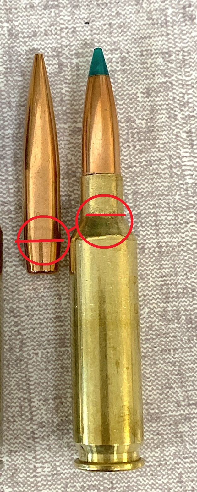

So how do you decide what length to seat the bullet? Just mimic overall length of the commercially loaded bullets and start shooting?
No you get the proper gauges hornady makes them comparator sets and then you adjust based off that most people start 10k off the lands just depends on many variables. Might want to look in the reloading section they have specific threads and step by step guidance

Seat bullet to neck shoulder junction. Check to see if it fits magazine. Check to see if it feeds. Go shoot.
NiteQwill,
What does it mean to seat bullet to neck shoulder junction? It sounds like you are saying to line up the bottom of the bullet with the area where the shoulder becomes the neck? Is so, how do you do that?
I do understand what this means, although I am going to need to watch some Youtube videos of folks doing it and read more here using the search function about which tools to get. I bought the Hornady Lock N Load OAL gauge and the modified case (in 6mm GT) that GA Precision sells. That case is Hornady, but I am loading Alpha. I have not yet bought any comparator sets because I still need to figure out which ones I need to get and how to use them, but that is the very next item on my road to starting reloading (finally, whew! it's a lot to learn).
NiteQwill,

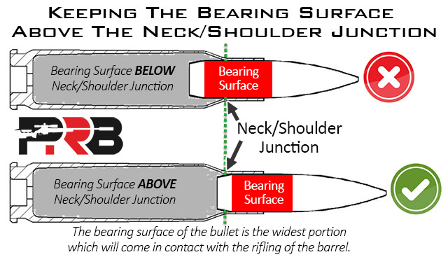

I suggest reading this article to understand a bit: https://precisionrifleblog.com/2020/04/28/bullet-jump-research-and-load-development-tips/
If you want consistent CBTO measurement that can repeatable, I suggest skipping the Hornady comparators, and look into SAC or Area419 instead. Use a good set of Mito calipers.
NiteQwill,
You can quickly figure out a rough idea if your bullet is seated with the bearing surface even with the neck shoulder junction by looking at a loaded cartridge with a bare projectile next to it. I'm attaching a quickly found image *that would be better if the same bullet were used*...but hopefully you get the idea. Some bullets will protrude more or less depending on jump, bullet length, and chamber dimensions.
There are a lot of discussions that revolve around this relationship. I am not trying to enter any...just trying to help you understand what he is talking about.
Also, when you use that Hornady OAL comparator gauge with the special cases it will not make a difference whether your case is Hornady or Alpha. It is taking a measurement from the bottom of the case to the point in the bullet's ogive where it makes contact with the lands in your barrel. Please also understand that you are going to be measuring jam and not touch. I bet you'll find out that you leave your bullet stuck in the barrel more than not with the Hornady gauge.
