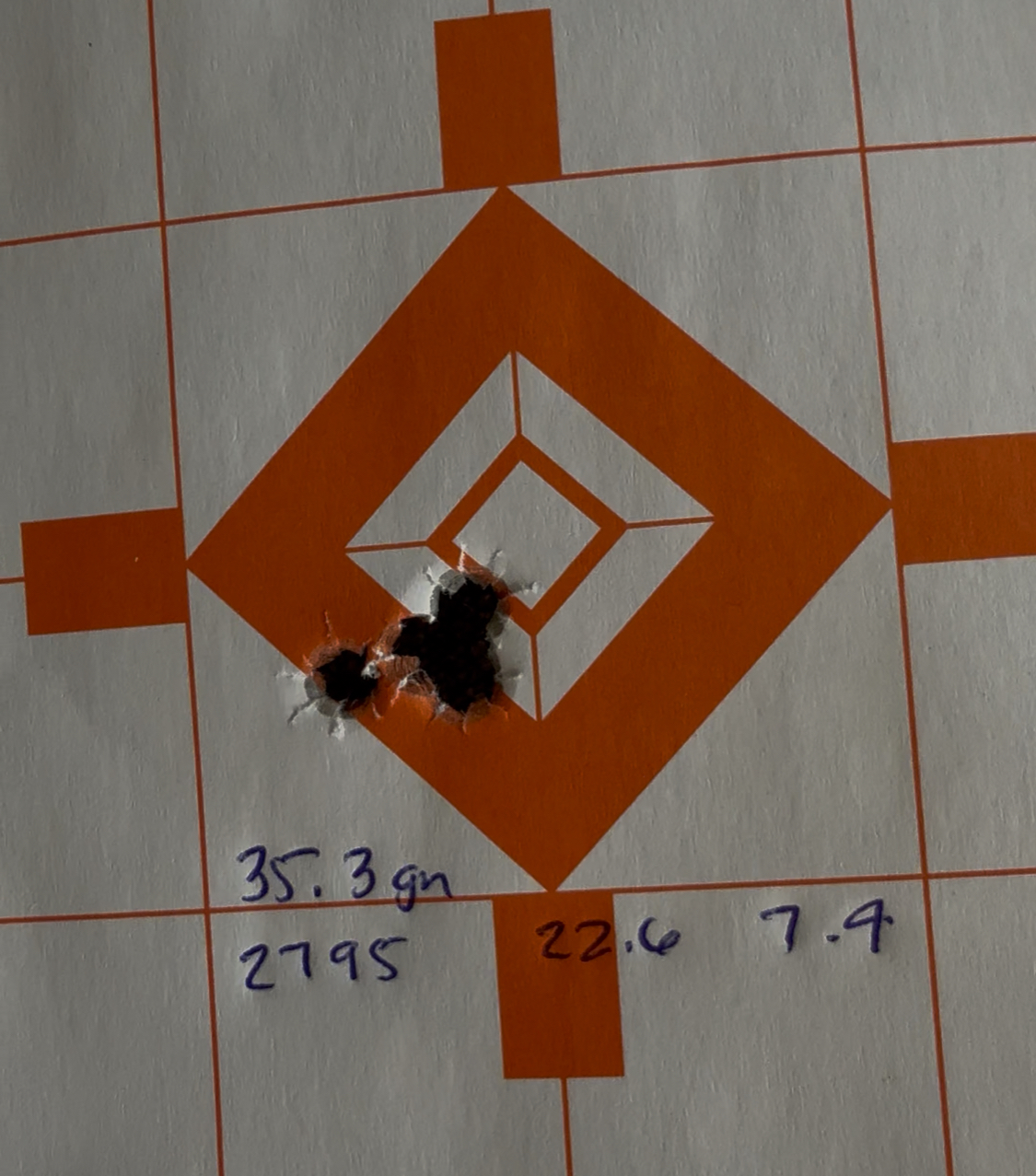

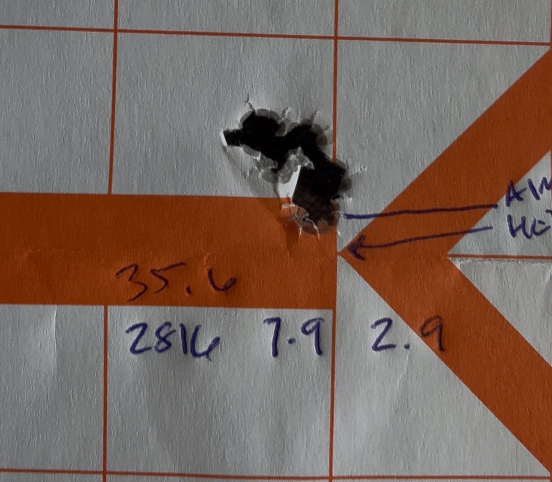

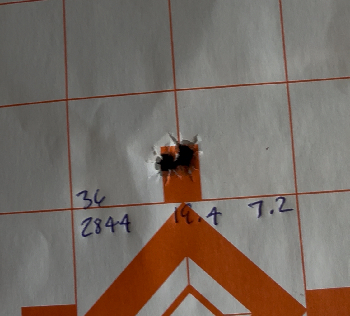

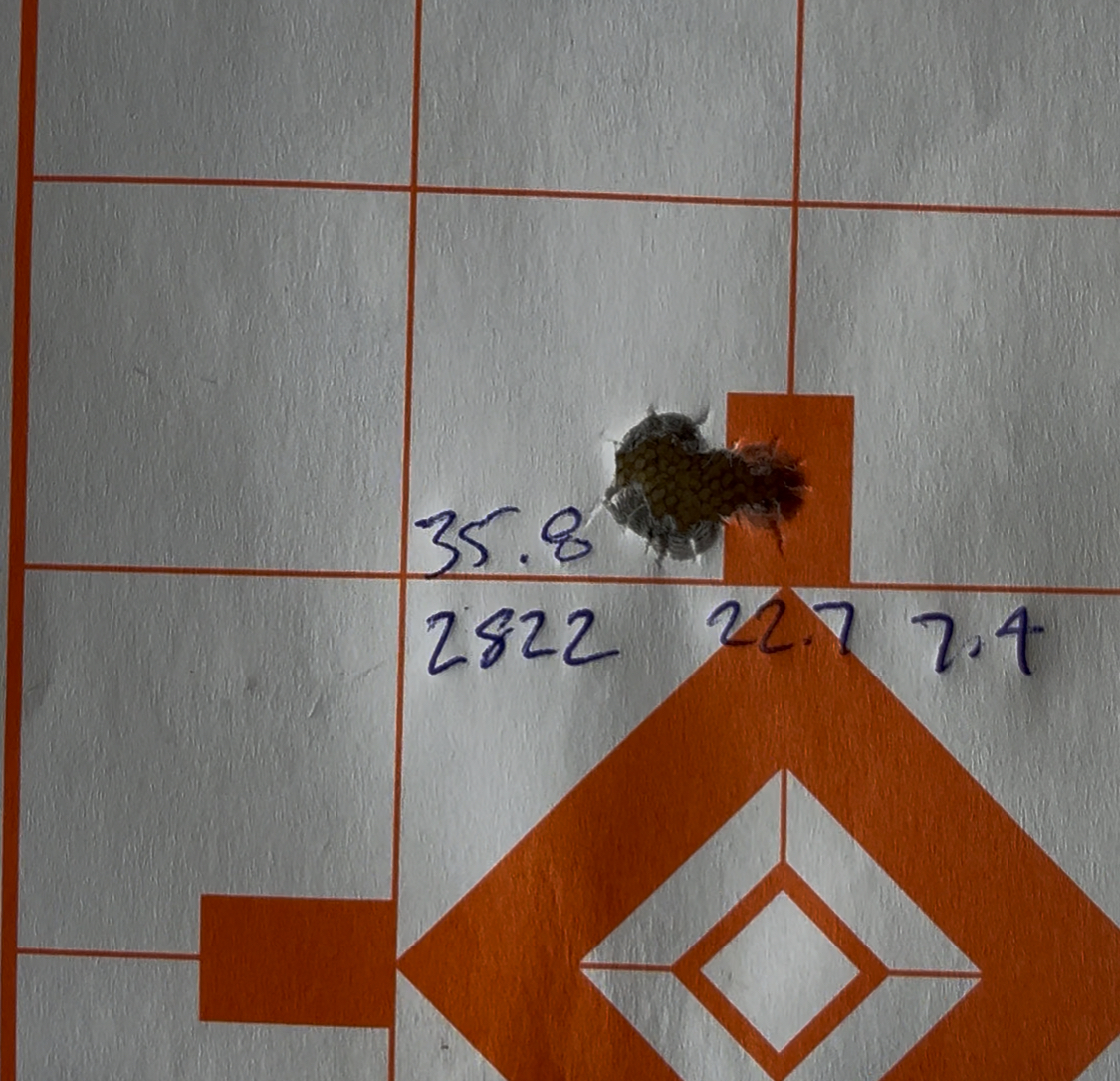

Got to test out my new CRB barrel and H4350 and the 105 Berger. These are the first shot outs of the barrel just seeing what the powder charges will do. All 5 shot groups. started at 35 gn all were loaded 60K off.
