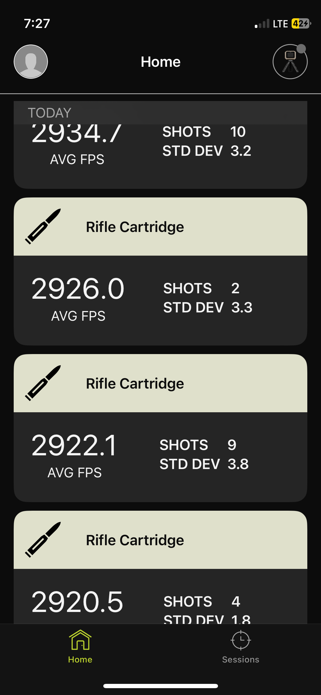

I get sub 4 SDs on a 10-shot string with a freaking $175 Frankfort Arsenal Intellidropper. I think some of you guys are way over thinking this one.If you're going there... I suspect the Lee (or other powder drop) + IP trickler solution will actually be quite a bit faster, FWIW.

Intellidroper and the staball 6.5?I get sub 4 SDs on a 10-shot string with a freaking $175 Frankfort Arsenal Intellidropper. I think some of you guys are way over thinking this one.
Zero prior to match, a string 4 stages into the match, zero check midway through and a stage near the end.View attachment 8686462

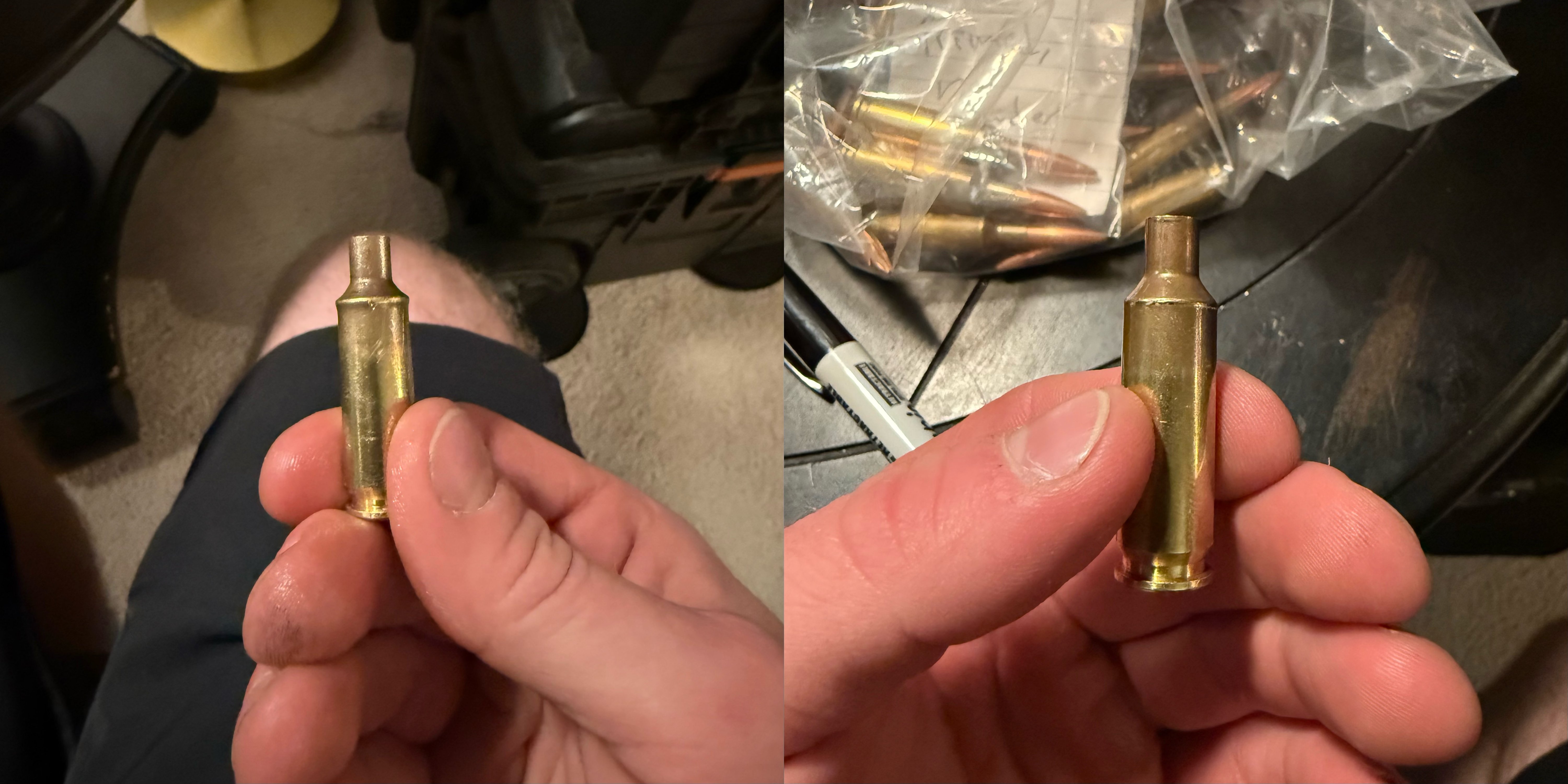

Tumble that brass in media with car polish. Brush the necks with a plastic oversized bore brush. You'll no longer crush the necks.View attachment 8696798
Send it or naw? Hornady brass. I crushed the shoulder during seating. Turns out virgin hornady brass could use a little neck lube. Especially for bullets with a long bearing surface like the hornady BTHP match.
On 2nd firing after a dry tumble with frankford arsenal polish the bullets seated like buttah. Kinda wish i didn’t spend $18 on imperial application media.Tumble that brass in media with car polish. Brush the necks with a plastic oversized bore brush. You'll no longer crush the necks.
