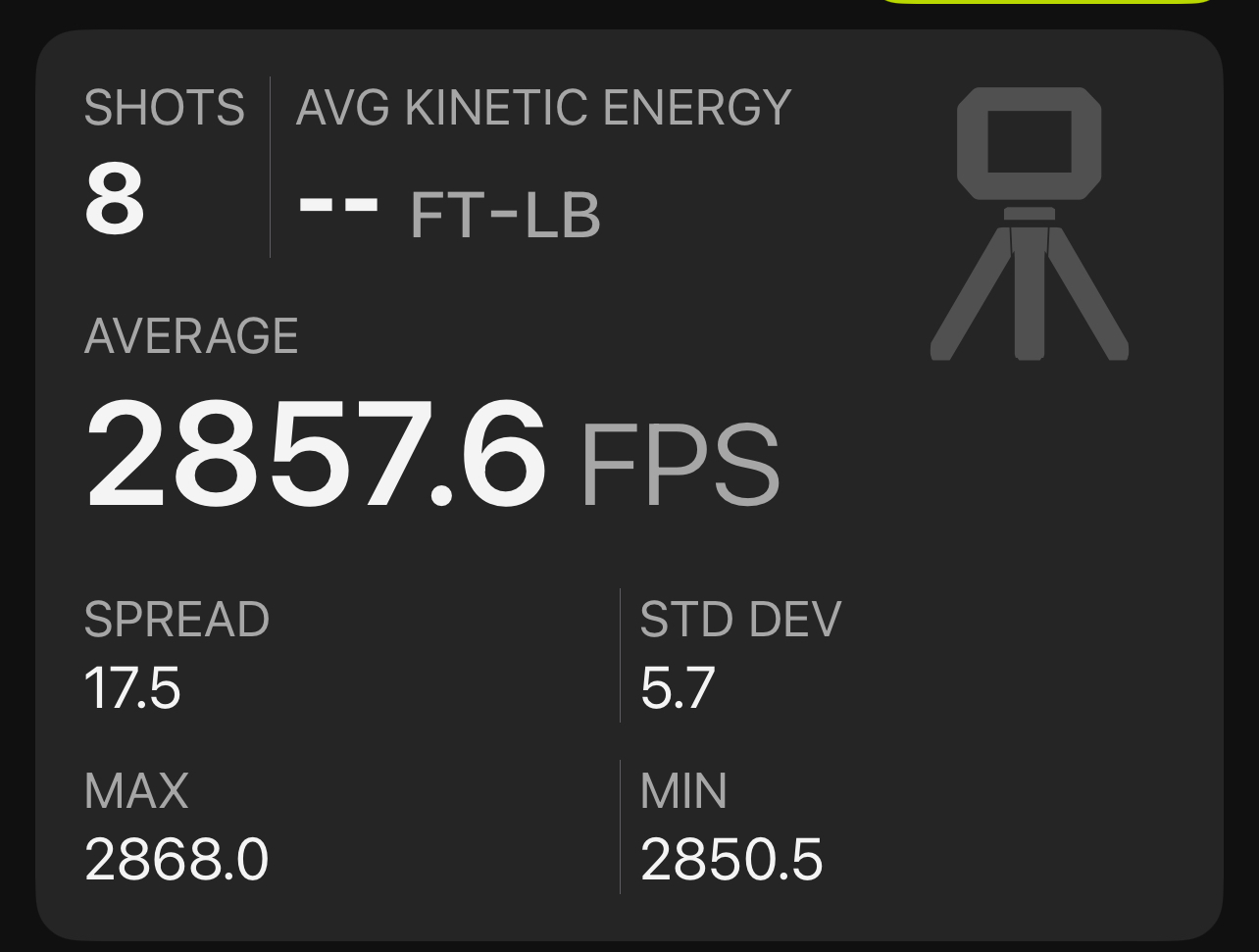

35.5 to 36.5, the GT barrels I've used have been great in that 2830 and 2870 range.
Berger 109’s
.170 freebore 26” CRB
Alpha 1F brass
Cci450
.060 off the lands
Annealed with an Annealeze and sized with SAC die .266 bushing, no mandrel.
36.8g H4350.
