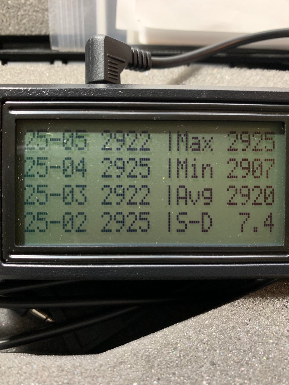

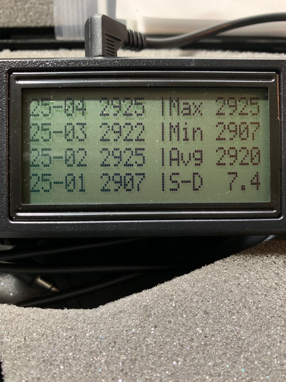

38.6gr = 2920 avg SD 7.4
All velocities were with a Magnetospeed

The 38.6 info above was 5 x over the magneto & first shot was with a cold clean bore.
First shot was a little slow, then it got happy.

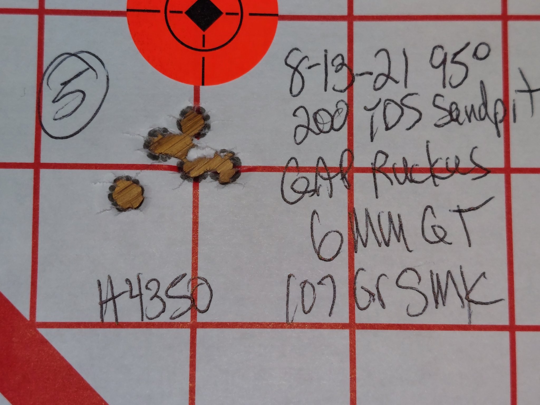

Tried this basic load of h4350 34.5 grains and 107 SMK in two new rifles. Amazing not even worked up and shooting this good. Mirage was horrid, yet still good groups.
13 rounds though this Curtis. Bore sighted, three rounds to hone in on paper then two groups of 5
This Ruckus has 32 rounds through it now. Twenty the other day at a 100 yard indoor range, and 12 yesterday at 200 yards.
