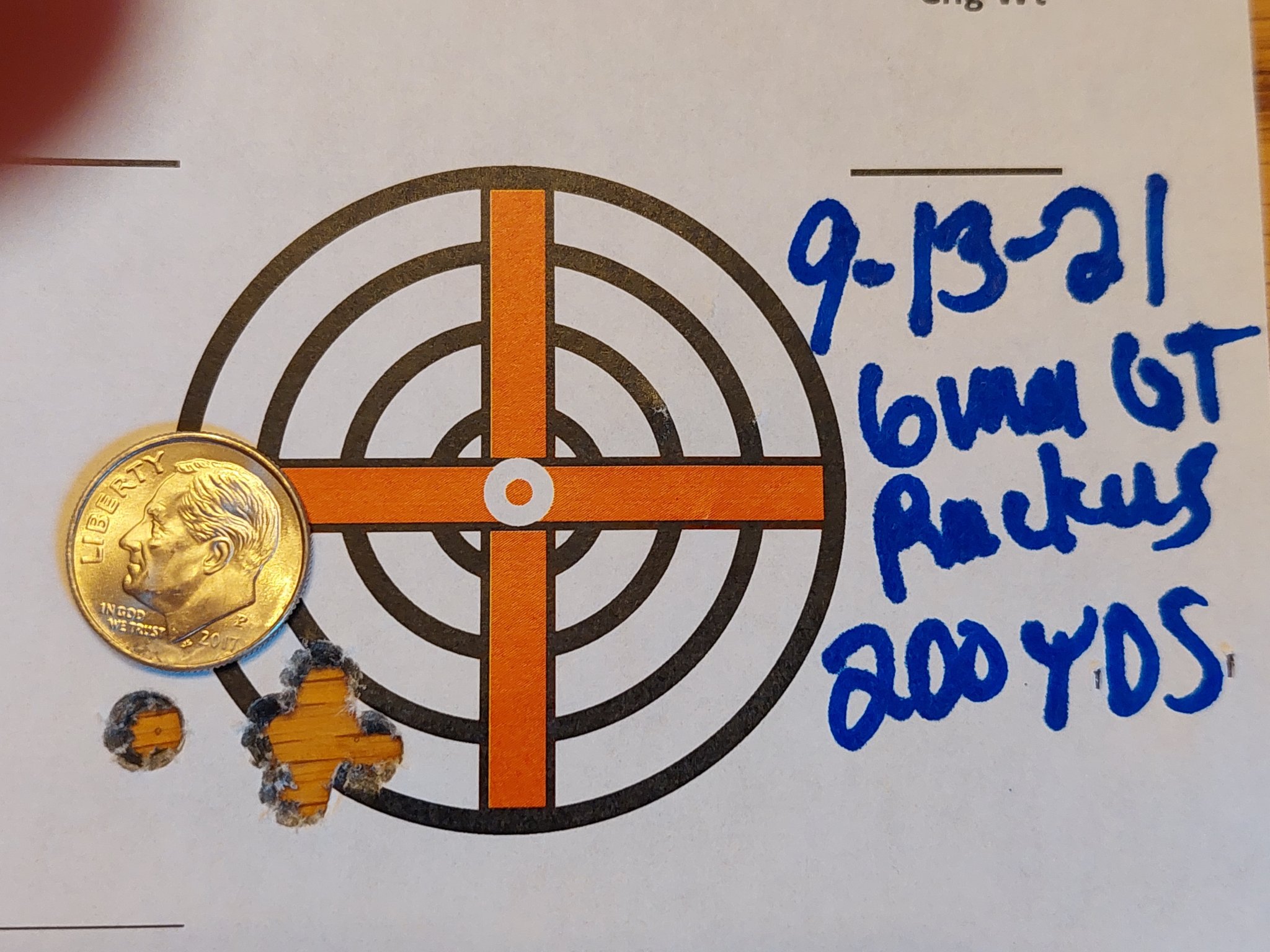

Well now that I have a functioning load in the 6GT I think I'll share it.
A page or two back I listed my struggles in getting this rifle to shoot, while troubleshooting the problem, swapping bullets cleared up my issue. This rifle just didn't like my initial bullet choice. So here's the load I landed on.
115gr DTAC
35.5grs Shooters World Long Rifle
CCI 450 SRP
Hornady brass
2840fps in a 26" Hawk Hill barrel

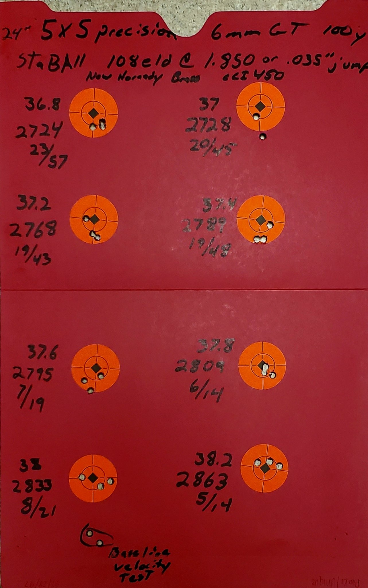

Anyone have some some success with 112 match burners and h4350? Running in 26” barre and looking to run on the slower side. Less than 2900.
FWIW, 36.6 gr of H4350 gave me 2920 out of my 26" Bartlein.
Perfect thank you. My first break in rounds were done slow with low grain bullets so I was thinking that I needed to be I. The 36 grain area. Much appreciated. How did they shoot for you?
Once I figured out the seating depth they shot well. I tried the typical .020 area jump and they were awful, but once I got them to about .065 (i think, around that area anyway) they were good.

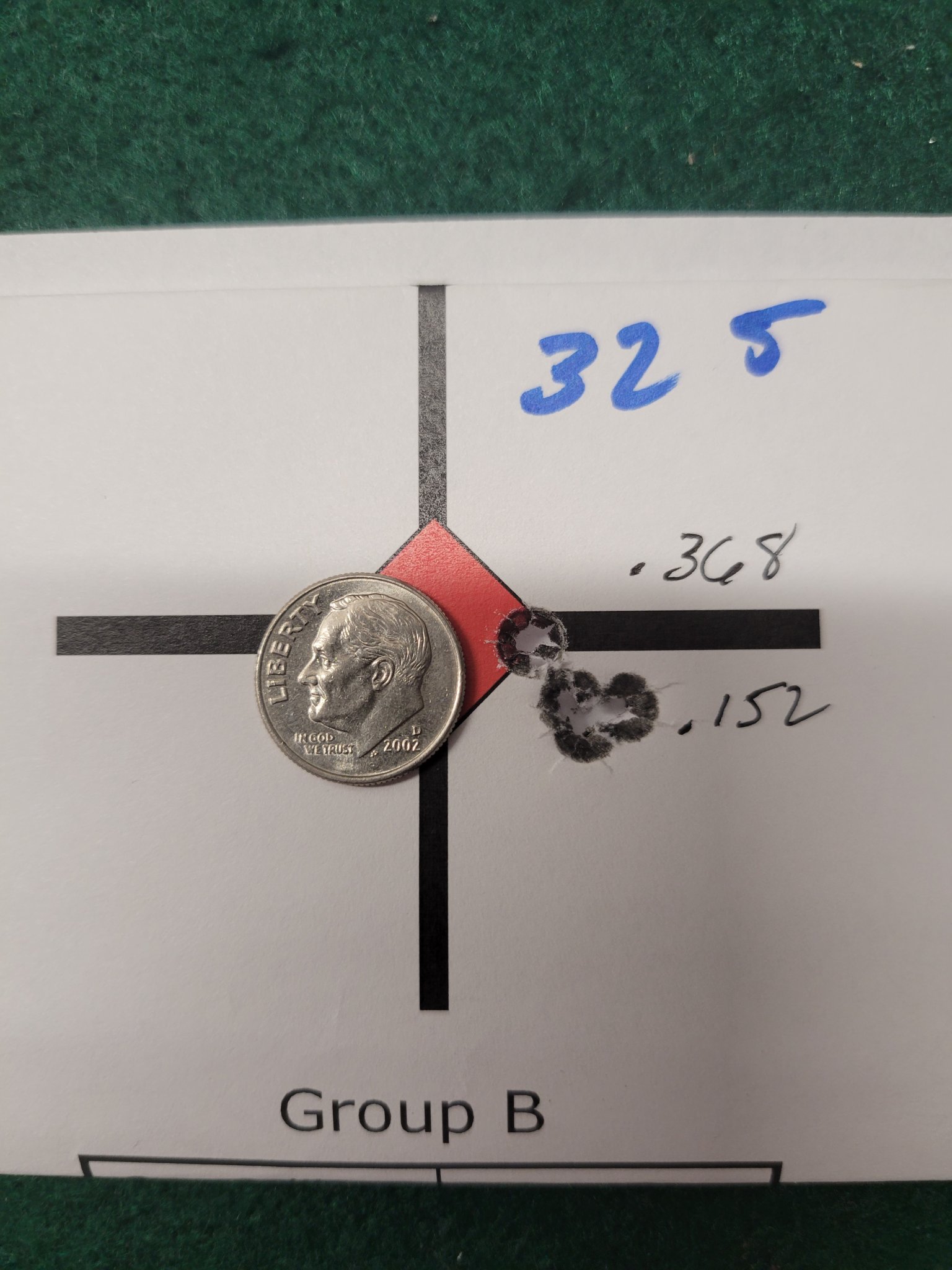

I just broke my first barrel in today. Wow I'm sold.
Virgin alpha ocd brass, H4350 .060" jump berger 109 lrht
Sent 35, 35.5, 36, 36.5
All printed 3/4" and in 5 shot groups.
I didn't Chrono it, but confirming groups at 600y the dope lined up around 2850-2860 which is fine by me, maybe it will still speed up. Either way it was a very easy and fun day because everything shot well.
I'm just stoked I used my regular 6.5 creed mags and they fed perfect, plus I was easily able to stuff x15 of those guys in there with my 419 extension.

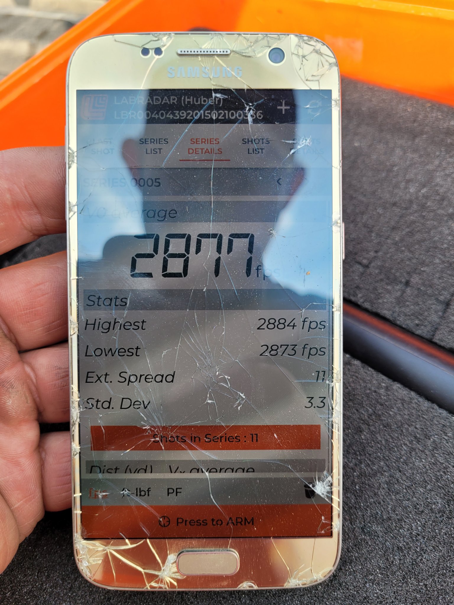

Benchmark 26” 7.5t VCC (Strait Jacket)
Curtis vector
105 hybrid ~ .040 off touch. I eye balled it. I will remeasure for a .060 jump for remainder .
36.0 H4350
Cci #450
Virgin alpha OCD brass just .242 mandrel.
2900fps, 9sd, 21es…only the first 100 rounds through tube so I expect more speed over the next 50-150 rounds where I’ll really check numbers. It shot bug holes at 100 and dope was dead on out to 600.

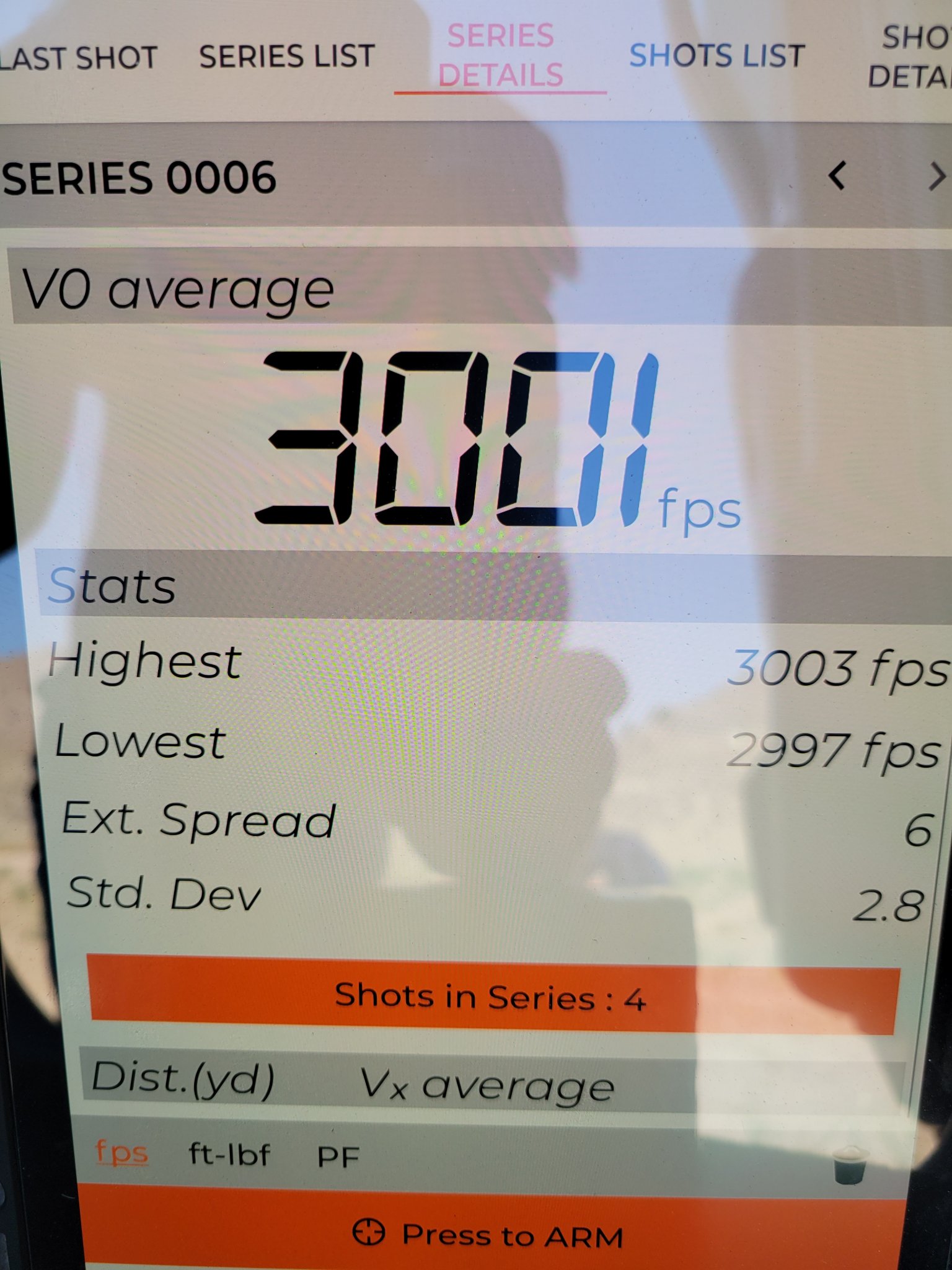

3000fps is smokin' for 109s. There's usually a great node in the low 2900's that would probably treat you a lot better on consistency and barrel life.
The harder you push them, the more finicky they get.

You may wanna slow it down a little. Try and find something in the 2850-2950 range.
Reactions: mr.quick

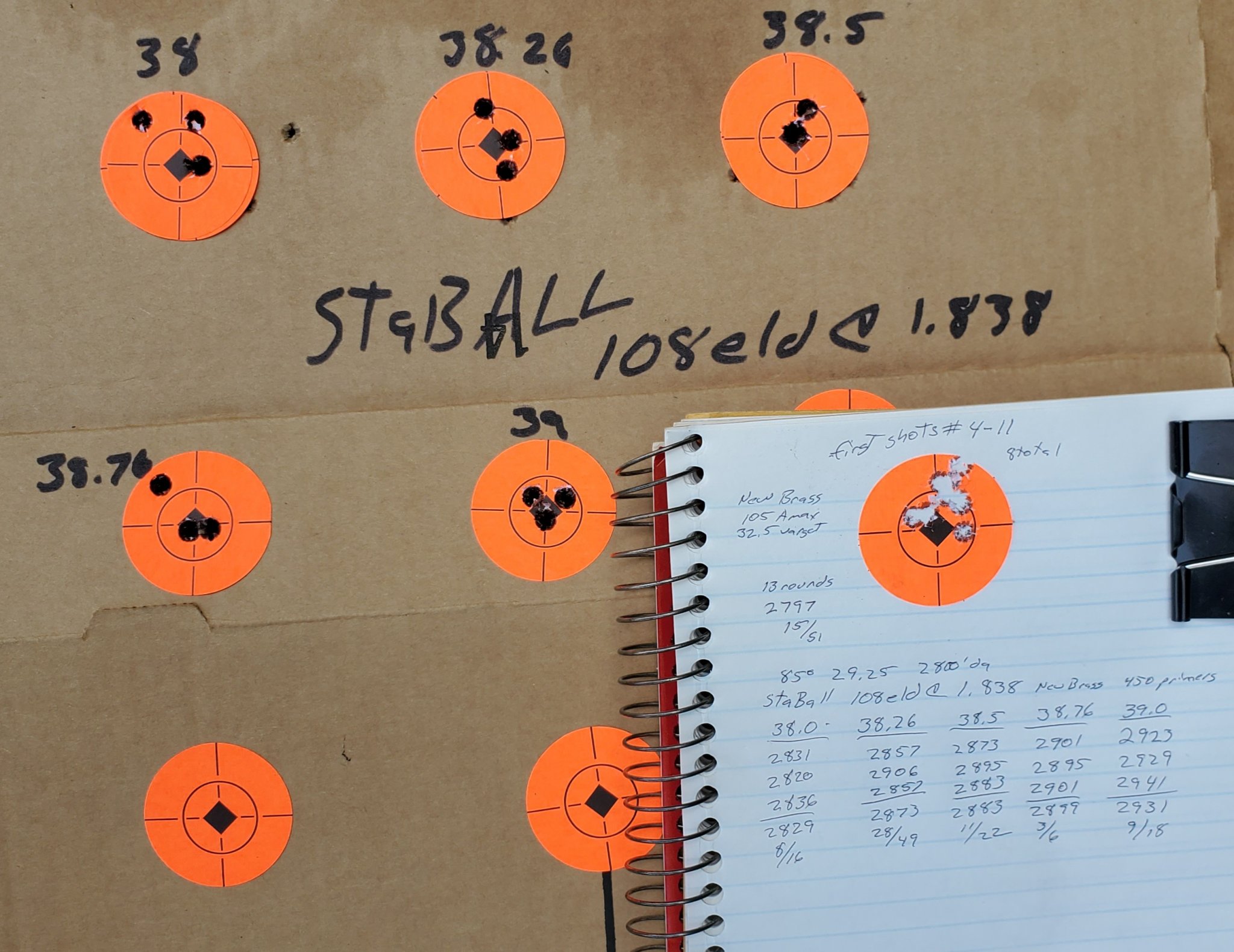

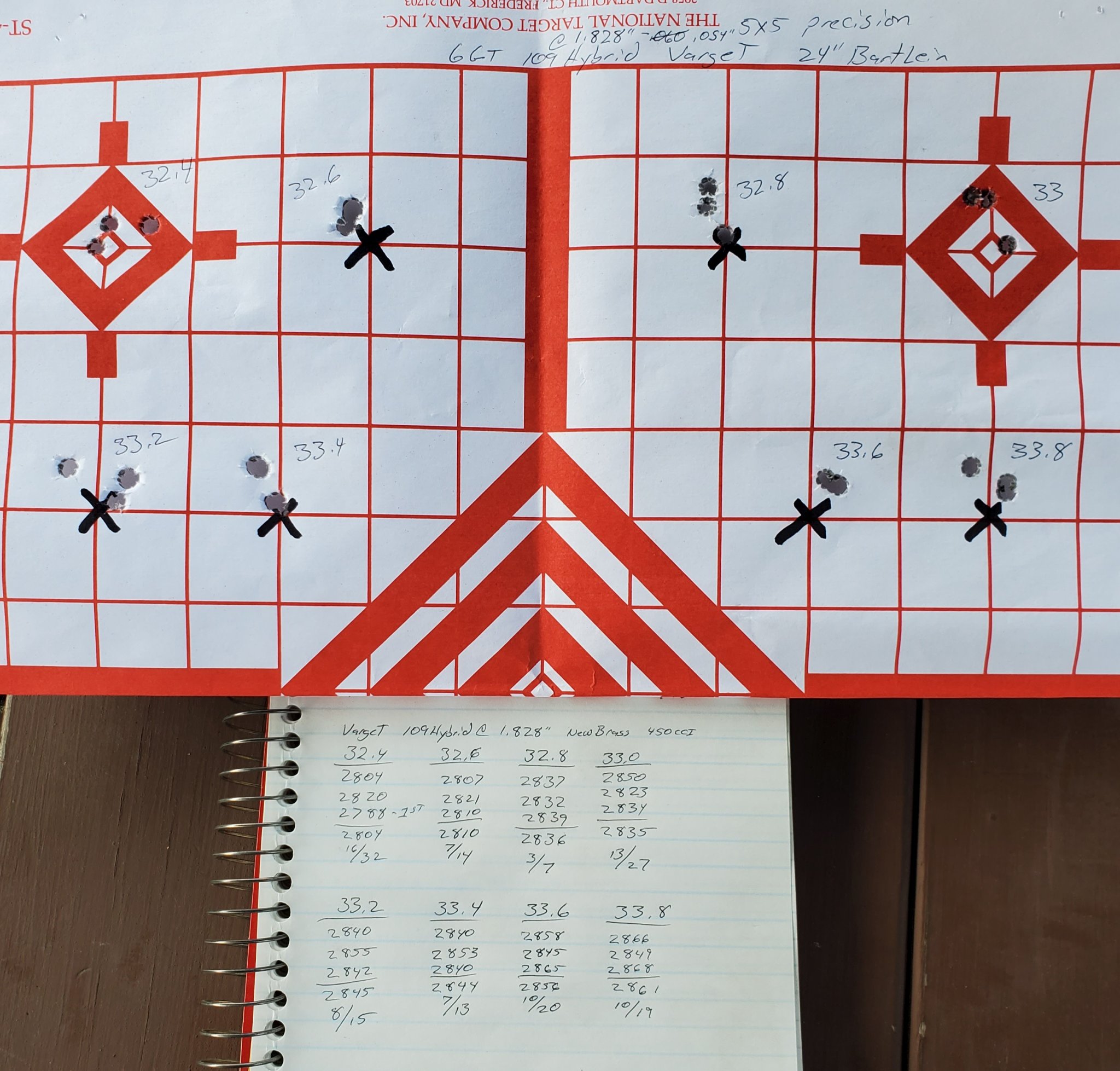

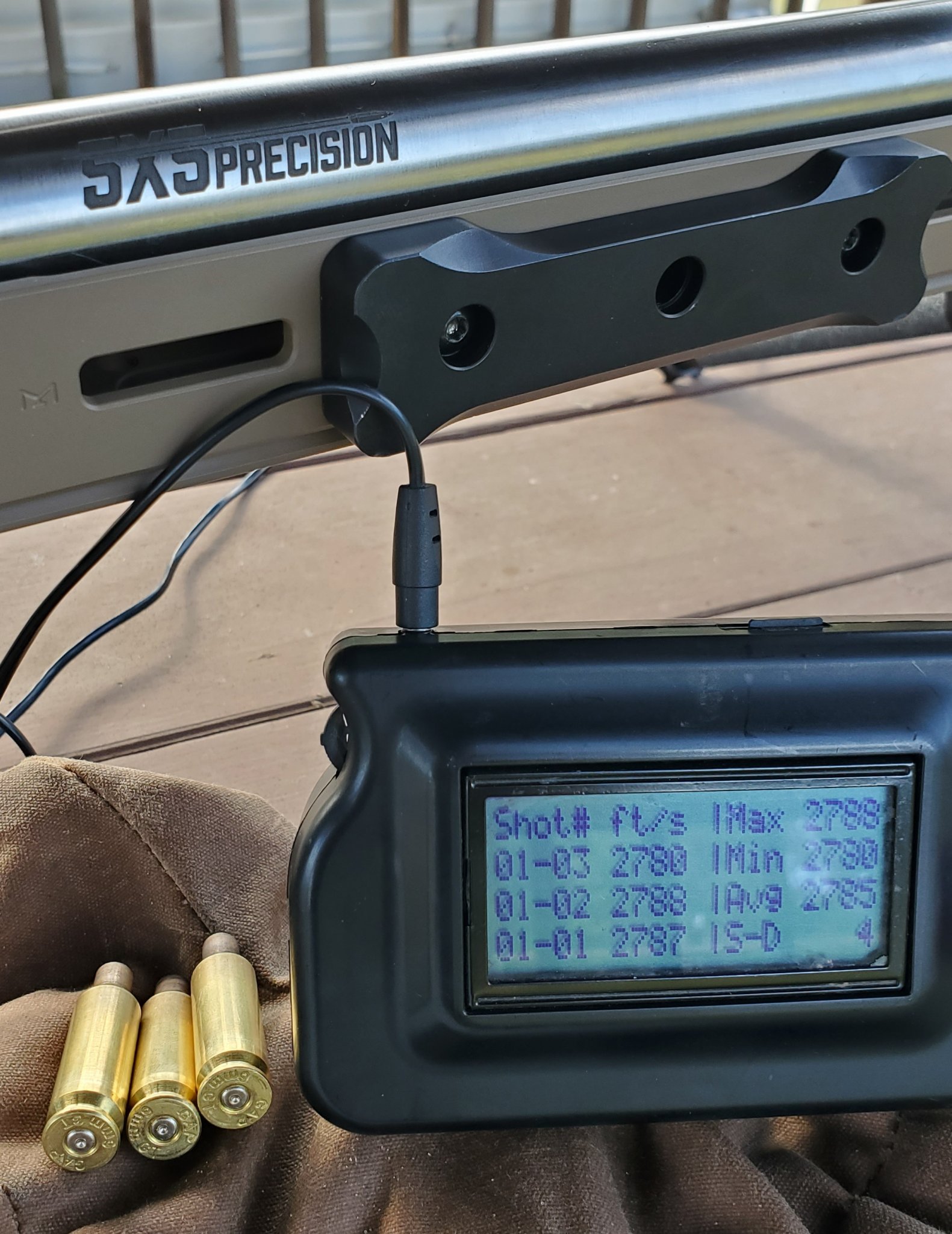

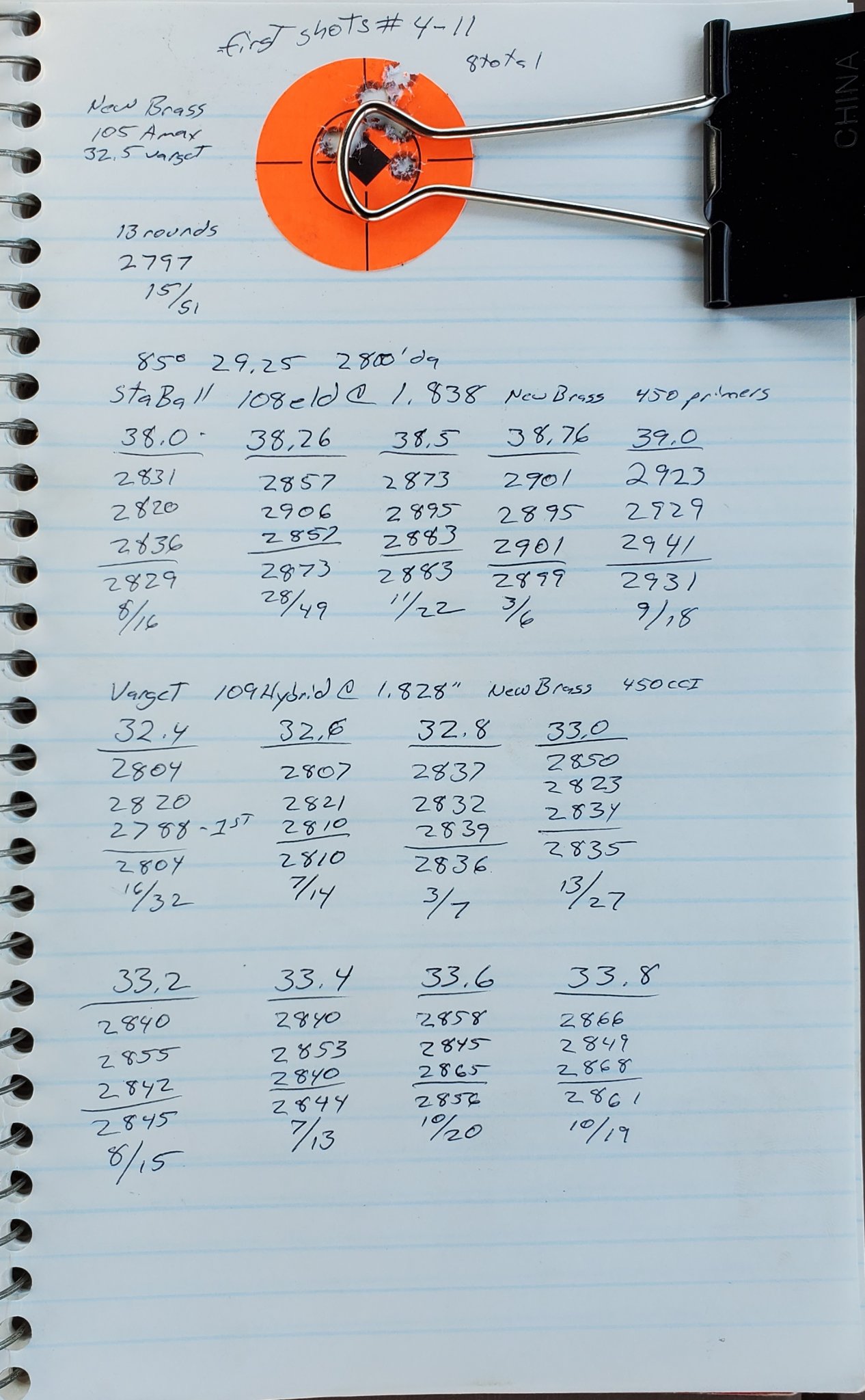

Some data from today:
Hornady 2x brass, CCI 450, Berger 109 at ~.080 off (2.535ish OAL), Varget, 26" Bartlein with 400 rounds through it, 95 degrees outside.
33.2 - 2870
33.4 - 2892
33.6 - 2901
33.8 - 2921
34.0 - 2938
34.2 - 2962
33.8 was right in the middle of a nice steady POI and shot a 3 shot group (I know..) in the .2s. I'd say that's a wrap for load development.
Oh and no pressure signs for any of these loads despite the heat, which was nice.

I'm not sure what you're seeing, but I'm not seeing a node here on this velocity string.
A 100 yard group doesn't mean anything if your ES is so high that you're all over the place at 600 yards plus.
33.4/33.6 are only 9fps apart. Thats the closest thing I see.
I just typed a up a response and hit reply but don't see it here, so sorry if this double taps with a reworded post.
I was looking at the change in POI, which I thought was the idea behind an OCW test. The POI was the same for 33.6, 33.8 and 34.0. I also thought we didn't believe in velocity flat spots anymore?
I didn't write down the ES, but SDs were low single digits, 2-7fps, but only for three shots each, so take that for what its worth.
This is more just info, should someone want to load up some 109s with Varget.

So with me not being able to find varget and wanting to save my h4350, I was able to grab some n140, has anyone messed with it?
I know it's popular with Dasher, and wanted to know if it's comparable? Anyone have a load?
Went out yesterday and fired off a few rounds.
I picked a charge weight in the middle of Hodgdon’s recommended load data and went with it.
24” Hawk Hill with 36g H4350 under a 107SMK yielded 2780.
7 rounds and an SD of 8.8.
This with virgin Hornady brass
Mirage was horrible but less than an inch at 100 yards.
Next up, a seating depth test, but this looks promising provided I can get ahold of more bullets.
Reactions: Birddog6424

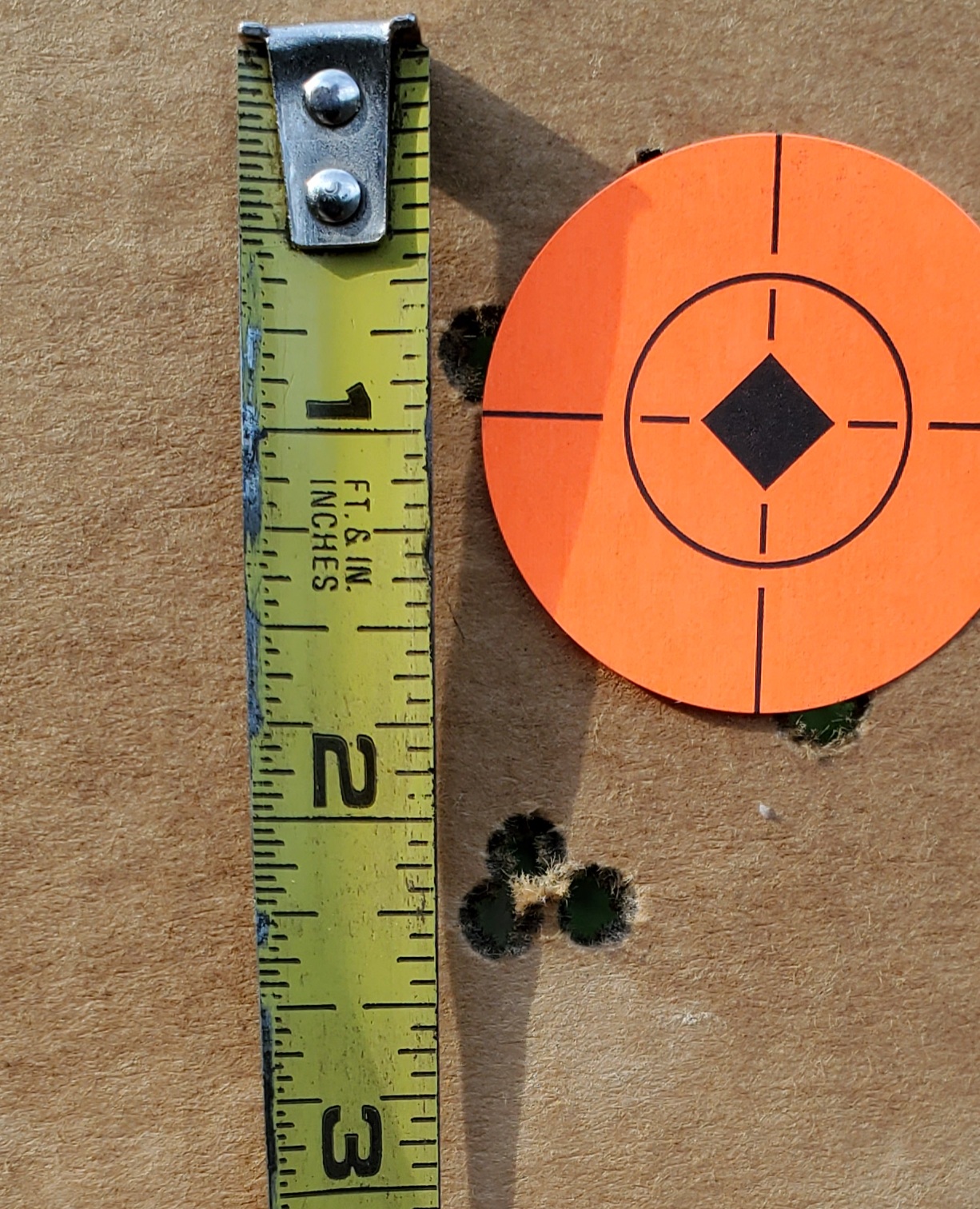

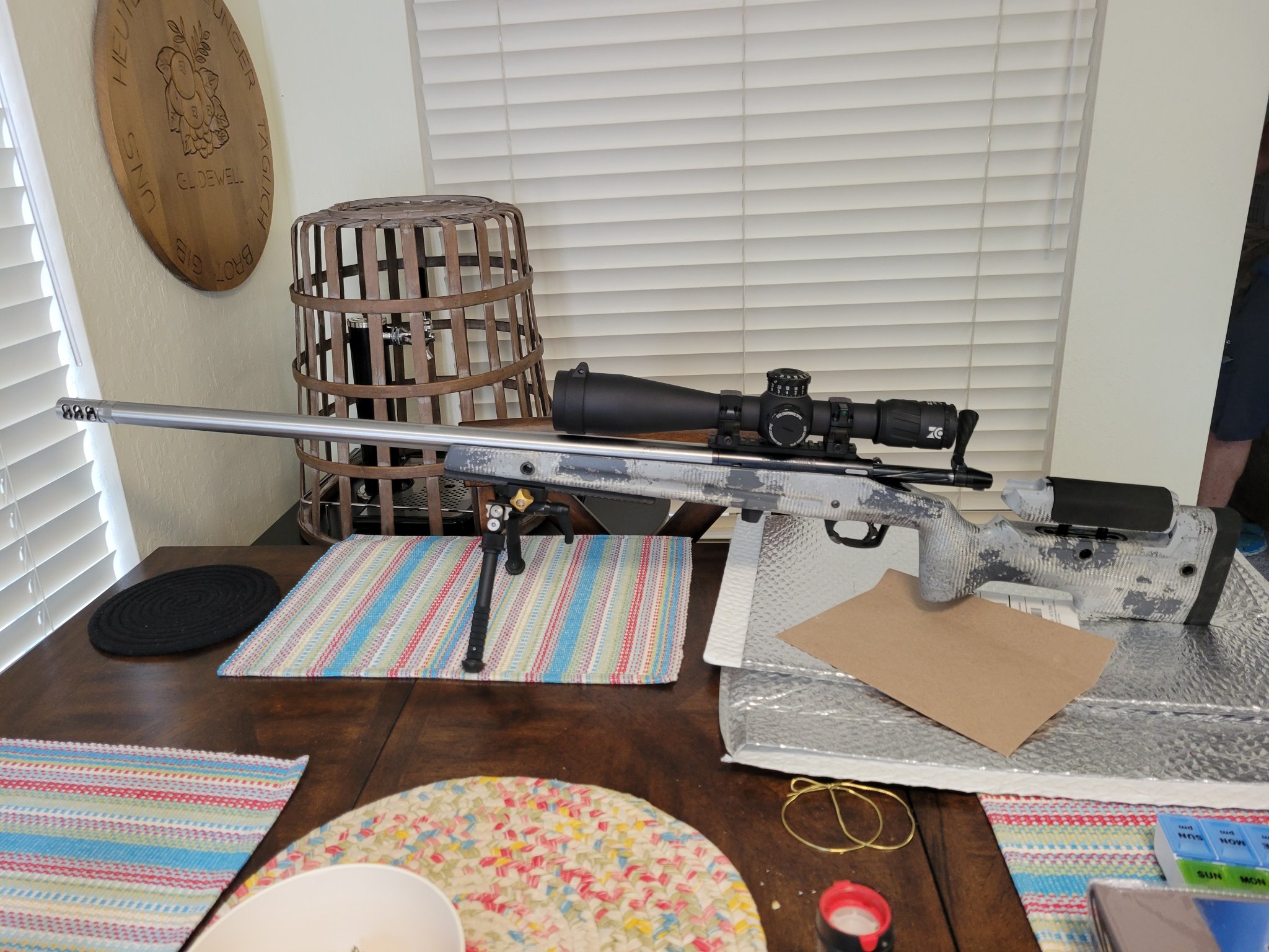

Tried this basic load of h4350 34.5 grains and 107 SMK in two new rifles. Amazing not even worked up and shooting this good. Mirage was horrid, yet still good groups.
13 rounds though this Curtis. Bore sighted, three rounds to hone in on paper then two groups of 5
This Ruckus has 32 rounds through it now. Twenty the other day at a 100 yard indoor range, and 12 yesterday at 200 yards.
